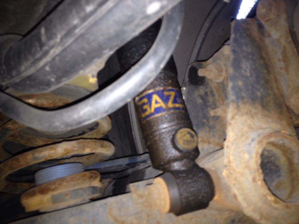

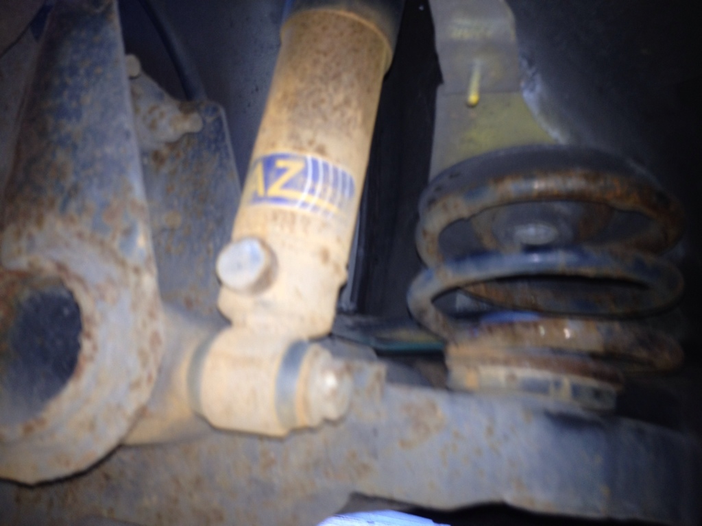

So got my 182 few days ago and was told it is on GAZ coilovers, looked underneath the rear of the car and the shocks are different on each side :s
On the right the shock is black with a yellow spring
And on the left is this shock, yellow with black spring, anyone confirm that these are different models of coilovers? Or what is going on.

The right shock looks like it's greasy with a rusty spring,
and the left looks like a rusty shock with a greasy spring.
Silly question but are you sure they're not just rusty?

Well, one of them is buggered at least. :cool: Looks like the Exxon Valdez ran aground on it.
Springs should be both yellow too. My Gaz were. One just looks really rusty... it's only a PPC on them, so it flakes off.

Thanks, will give them a clean and look again but one must be leaking to be covered in oil, are they worth getting sealed back up or better off selling them and getting standard cup suspension and eibach springs?

Also the one covered in oil/black one is much shorter than the yellow one, is this due to the lack of oil in it?
If there is no fluid to allow it to be held up...then the weight is not supported...so will be a bit lower.

sweet, will ring them in the morning and ask a few question but the amount of rust on them makes me think i should replace them, what would you guys do?

I would bin them and buy a set of spax coilovers from sideways danny.

Erm yeah... they're fucked :dapprove:
If you want it low like it is now then get some new coilovers.
If not, i'd just find some second hand standard shocks and put Eibachs on them.

speaing to Danny about some SPAX ones, think they are the way to go with it
