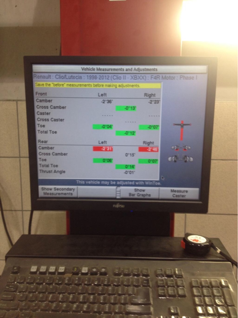

Hi!
My 172 cup alignment in rear wheel is...
Rear left Rear right
+1,5 mm + 2 mm
2,1º camber 1,6º camber
What alignment use?? I want fastened to the asphalt! as on rails
I have a rear shims, a pair of 10` and a pair of 30` for install
Thanks!!

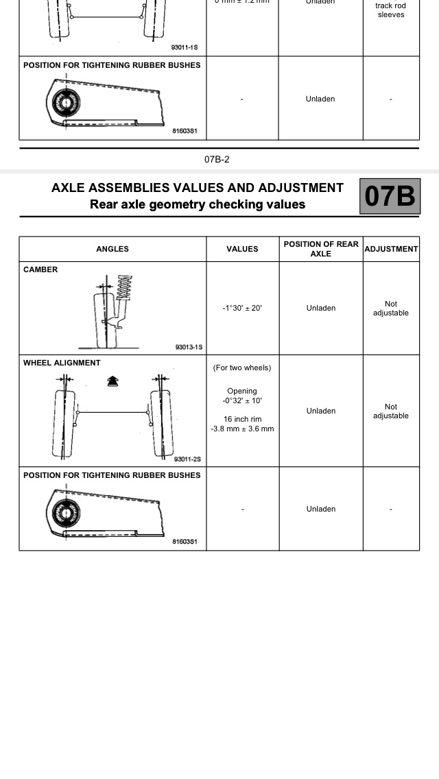

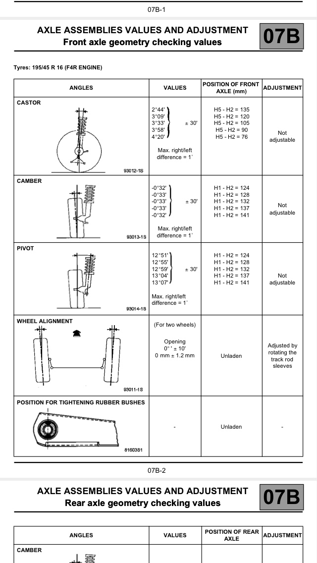

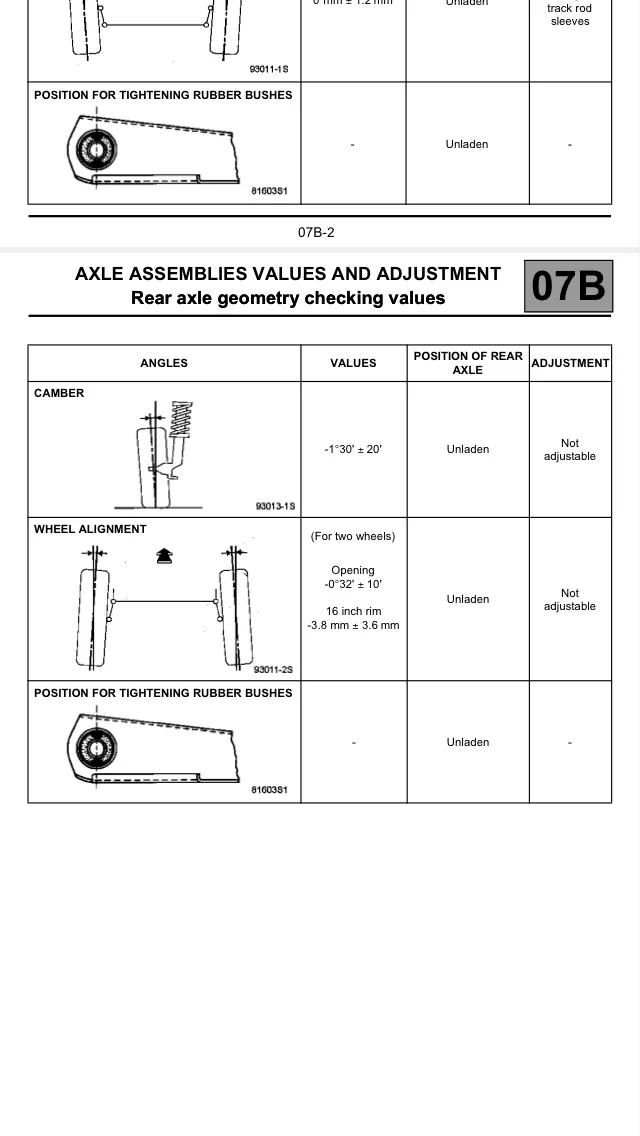

The Clio Trophy website has these alignment settings for the 182 Trophy:
http://www.cliotrophy.co.uk/forum/showthread.php/41351-Problem-with-camber-settings
http://www.cliotrophy.co.uk/forum/showthread.php/45450-Factory-Camber-Settings
Front:
Camber: Negative 0.17' +/- 30'
Toe-out :0.25' +/- 17'
Rear:
Camber : negative 1.30' +/- 20'
Toe-in 0.20' +/- 20'
and the site suggests using 2-degrees negative camber on the front for track use. (All figures are in degrees and minutes.)

  172 Ph1
Track set up
Below are cup standard settings
