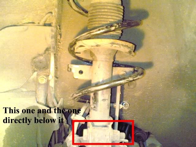

Right are you on about the 2 bolts holding the strut in the hub?
As in these...
If you've removed one the hub sort of puts all its weight on the other bolt if you like. Push the strut away from you and wiggle/pull the bolt at the same time, should come out. If its seized in, lube it, then tap it gently with a hammer, carefully not to damage the threads.
Another way is put the socket on the bolt (with the nut off) and keep spinning it for a bit, either way it don't matter, to try and loosen it off a bit.
