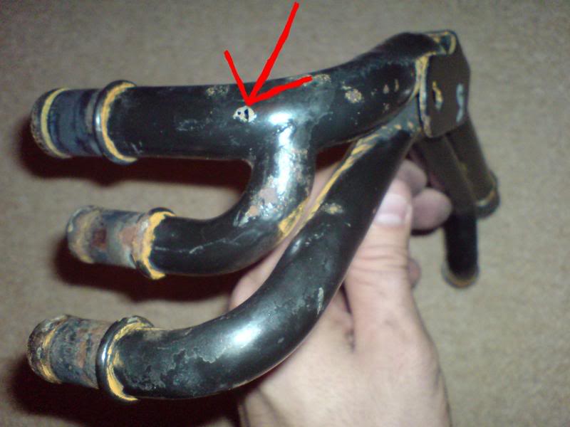

Had this part go on me today, just below my top hose :dapprove:
Its solid metal i think and a small hole has appeared on the corner (the clean bit) of the bend..Thus spitting all my coolant over the floor
Firstly i dont know what the part/pipe is called (so cant order a new bit)
And also how easy is it to replace myself ??
Its a 95 1.8 RSi
Thanks Keith

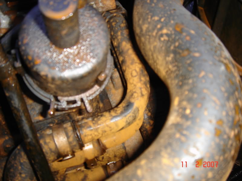

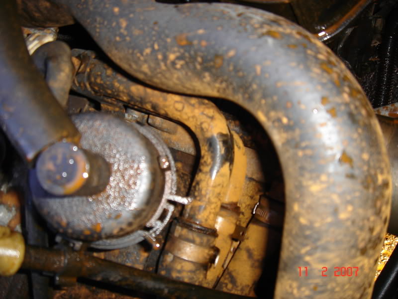

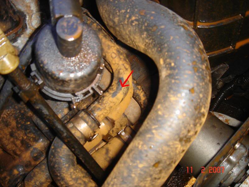

Does anyone know what theis pipe is called etc ?
It Y's off and then a rubber hose connects to it and T's into the bottom rad hose.....If that makes any sense :S
It is just below the rad top hose near the air box.....

Keith,
Looking at the photographs it hard to see which pipe you are talking about, can you mark it on the photograph. Tell me, what year and engine size the car is and I will have a look on the parts slide for you.
The colour of the coolant is a worry though, did you have anti-freeze in there?
I wouldn't go anywhere till you get that fixed properly.

That is the pipe that runs from the heater to the bottom hose and expansion vessel, I can work out a part number for you if you give me the letters (not the numbers) from the VIN

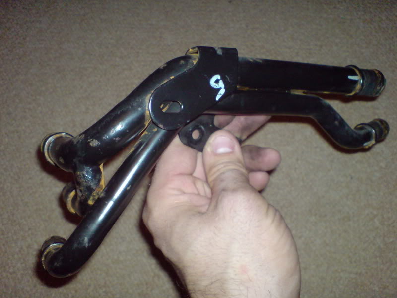

This is the part that has gone and the hole :dapprove:
I think i have ordered the right part from Renault today (fingers crossed) £17 :eek::eek:
Cheers Keith
If its only £17 Keith, thats a result for Renault parts.;)
Thats been caused by years of neglecting to flush and change the coolant.:dapprove:

The part the guy ordered was the wrong one :dapprove:
Have gone into Renault (Taunton) today with the part and the guy says he cant find a parts number for that bit (as you said Brian), he is going to try to sort it out in the morning (fingers crossed)
It was strange that, i couldn't understand why it doesn't appear on the parts list.
I hope they can sort it out for you, if not, find a plumber and get him to solder a joint in it for you.
Have thought about getting it welded/brazzed, but i have found another small hole in it now, so how long before another hole appears somewhere else:dapprove:
I am in the building industry and have also thought about replacing the part completly with copper pipe or even plastic push fit ;)
