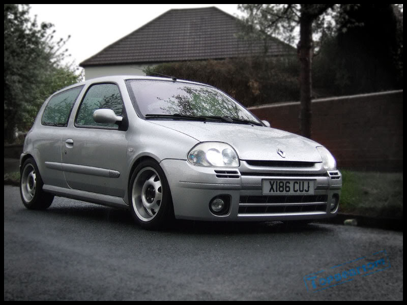

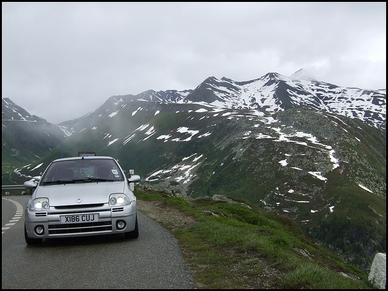

A couple of mine. Not brilliant pics but they give an idea. They are 6000k - id reccomend you go for that temp, its just right IMO.
thanks for the help, the first pic is awesome!, ill have a look on ebay
