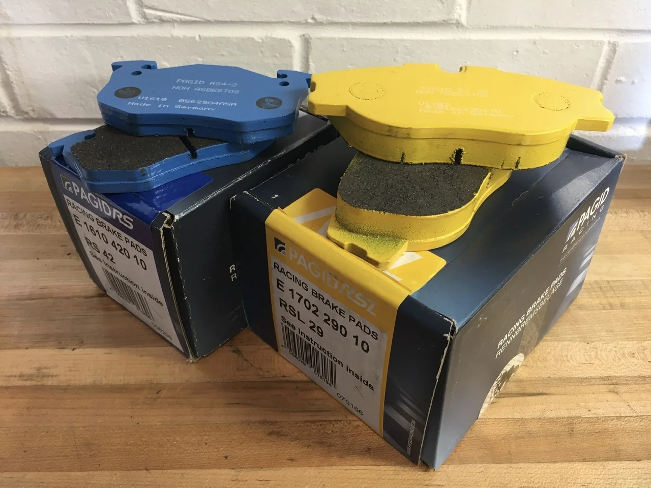

Pads have landed. Whooo!!

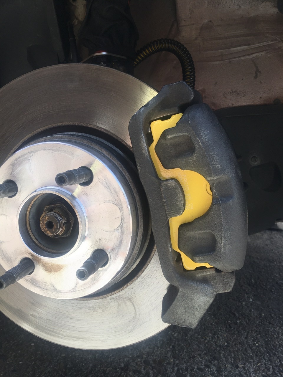

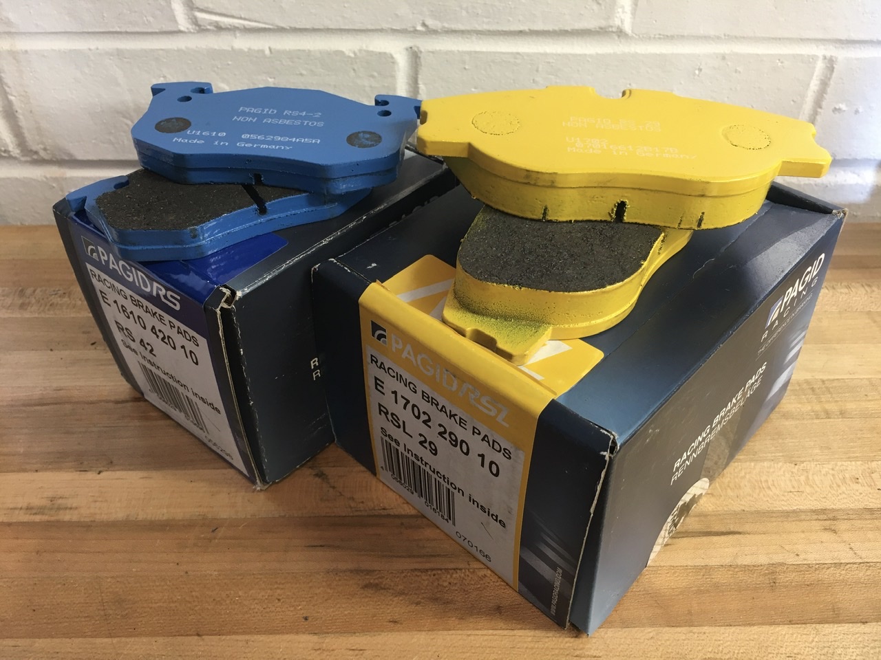

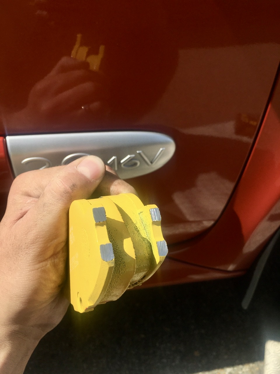

Just to update this.
Pads have been fitted and bedded in to the letter of Pagids bedding procedure. I haven’t run shims in the Calipers almost since new so they weren’t present to remove. As usual with Pagids, you have to dust off the paint from the ends of the pads to allow them to move freely and expand without binding.
I have always done this when using Pagids RS pads and although a bit of faff, well worth it and I’ve never had an issue. The next morning I re-bled the system as the initial bedding is pretty aggressive on the system.

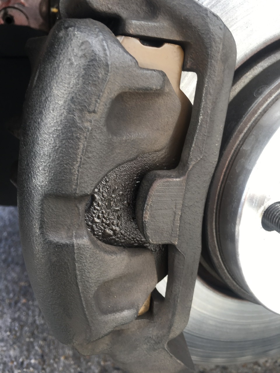

The pretty yellow paint doesn’t last long against a proper thermal cycle either lol.
Obviously they haven’t been on circuit yet but initial impressions are everything I expected. Huge bite, solid pedal and loads of feel. Easily enough to activate the ABS even with R888s.
They inspire the confidence you need when pressing on and the car is absolutely rock solid under braking, tracks arrow straight and despite the obvious weight transfer up front, the whole car hunkers down and pulls up evenly.
Heaps of Initial dust but zero squeal.
So far, very pleased with my purchase.

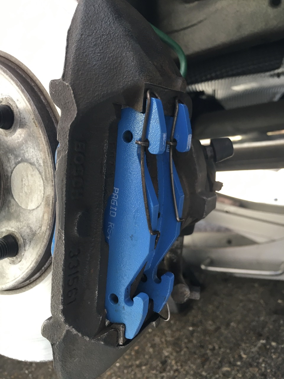

Mega pad choice @frayz I've ran the same in the Megane but ended up with RST3 up front and 29s on the back, The 42s absolutely annihilated my discs and wheels on the rear when used on the road but the track performance was mega. Even more so with the RST compound on the front axle
I’ll see how I go, Pagid said they wouldn’t be horrific for what I wanted. But if I find they’re eating discs and wheels, perhaps I’ll swap to 29s on the rear too. The 29s are easily my favourite pad that I’ve ever used for performance, disc life and non corrosive dust.
Don't get me wrong, it was probably the best setup I used on the car coupled with the aggressive RST pads in terms of balance and braking power/modulation but they just wore too much when not upto temps
29s are a superb pad, been around a long long time, Got them on the APs on the front of my E92 and not sure what to go with next. Used btcc pads are pennies but I may try the RSL1 next, simialr life but a bit more bite and power which I found the 29s lacked sometimes
I find 29s go off if they’re not being used hard enough often enough and take a bit of a pasting before they come back again.
I know what you mean though, they don’t have that instant axle snapping of a Carbon Metallic pad. But I prefer the feel having slightly less grab. Probably because I find it easier to use aggressively.
When I swapped to PF01s I had to completely change my braking style as they were probably too aggressive for my style...
But if you want ultimate power, they’re mega!
