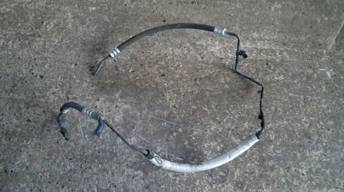

It's the metallic (alloy?) section on this pipe in the picture below:
I'm assuming it's low pessure as I managed to stop the leak with a jubilee clip and bit of rubber. If it's high pressure then my bodge it repair was better than I thought!

I think thats the high pressure line

Update: just called my local Renault specialist who helped confirm it was the low pressure pipe I need (got the wrong pic above so you were right Papalaz). Cheaper and easier replacement than the high pressure side though they wouldn't commit to saying how long they expected it to take.
If its gone on the metal pipe personally id measure the diameter, cut the damaged section out and put a join in, as long as theres enough room around it you ahould be fine, if it was the high pressure id swap the lot, but not for the one thats gone on yours
