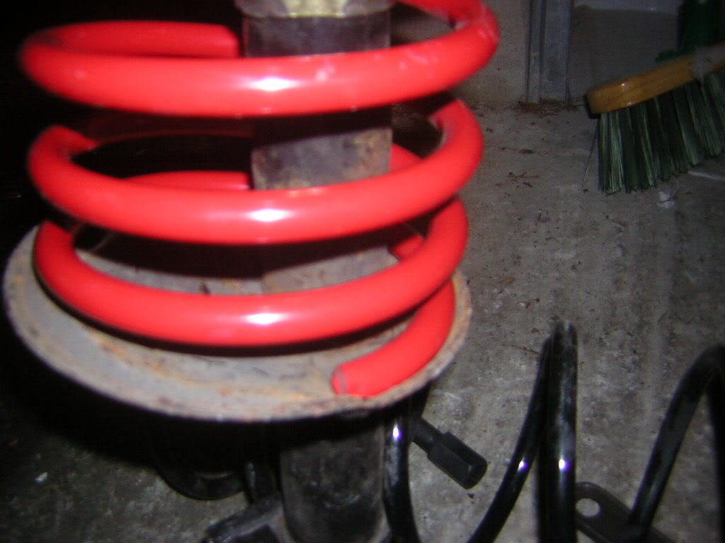

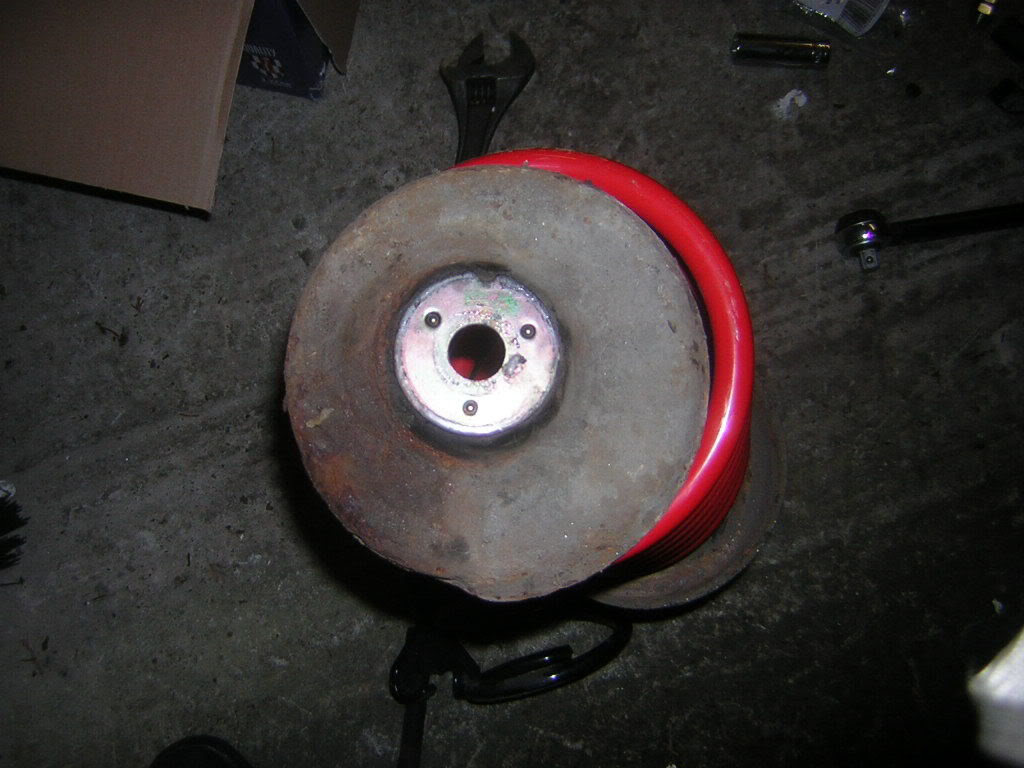

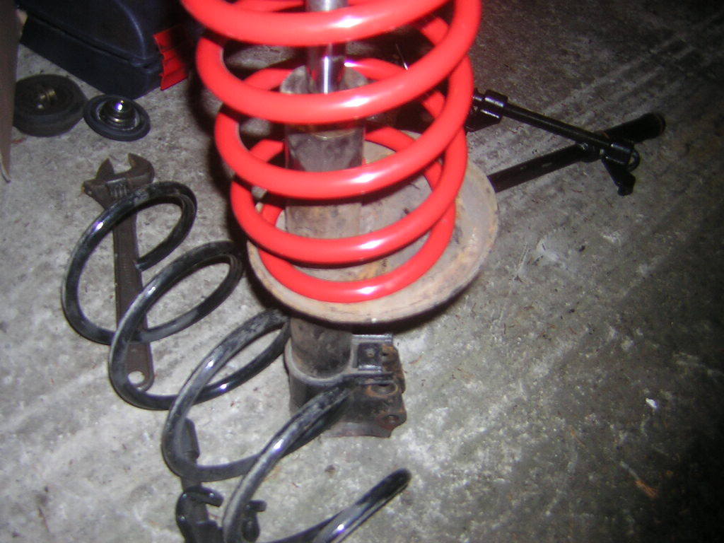

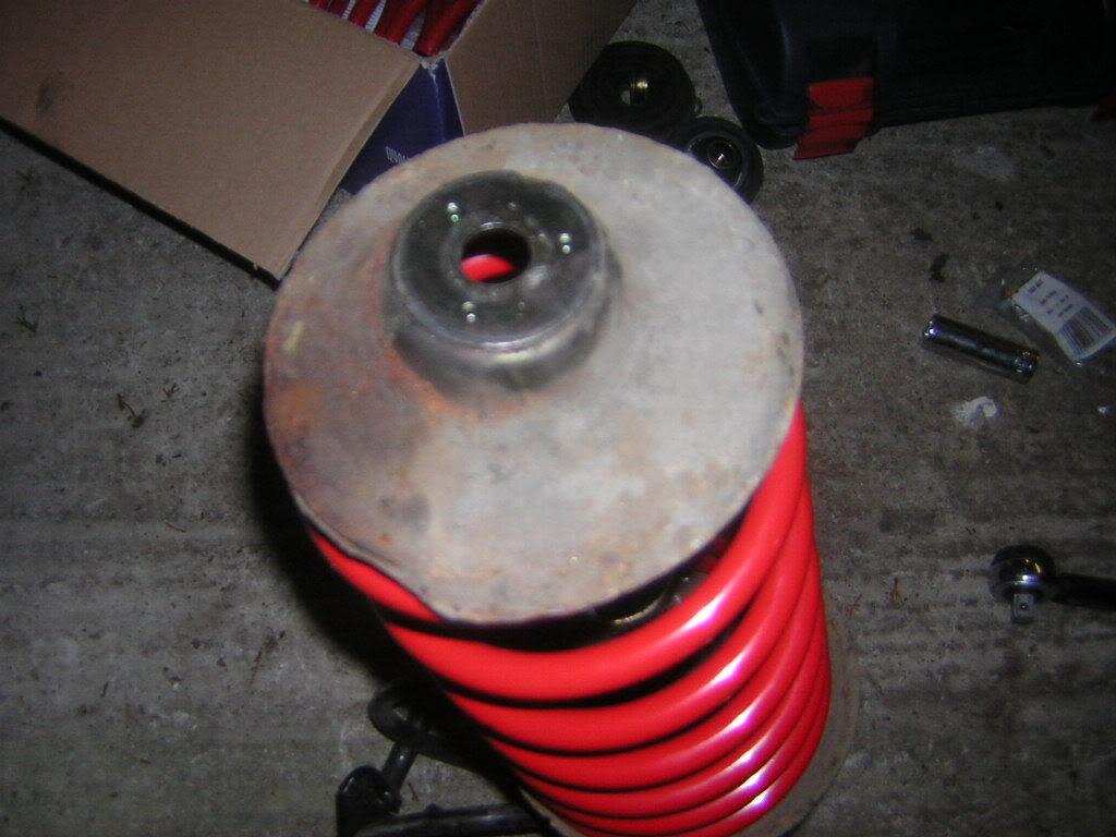

Holy mary mother of god, Think i made a f'ck up, help
Pics (correct way up, wrong fit)
Upside down, Nice fit

yeah it will as the springs are progressively wound i.e they use the same amount of metal as a normal spring but they are closer together at the top. the top of the spring is the bit that adsorbs the impact first that makes it harder. I cant give you any more info as Im not that experienced.

lol, springs dont work like that. actually sitting here crying with laughter hahahahahahaha
as long as the springs are both the same way up it will be absolutely fine

But I thought If you get springs progressively wound as it gets tighter closer to the top has the effect of giving the spring increasing resistance the more compressed it gets? which is why they should be the right way up. As it says in the instruction manual fit them the right way up, I'm no mechanic and I dont want to scare you but I would like to know if you do. (I personally dont want to scare you I'm just giving you back some info)

Can a springs overall length be different when the same amount of force is applied to it but it is up the wrong way.........no.

And you think that by putting the softer part of the spring at the bottom that now the stiffer part of the spring will compress first beacuse it's "at the top" - the same part of the spring will compress it will just be at the other end of the spring.
A spring will compress the same length in total for any given force regardless of which way round it goes. but somehow you think that the spring has a small chip inside it that controls the way it behaves because it's upside down.
"Oh look I'm upside down - I'm now going to defy the laws of physics and compress the stiffer part of me first."
They say only one way up because of how they fit into the shock - as clearly demonstrated by the original poster.

oh my actualy god!!!!! if they are progressive springs, the soft part compresses first no matter which way up the spring is. if the springs will only go one way, that's the way you fit them. As long as they're both the same way up it will be jst fine
