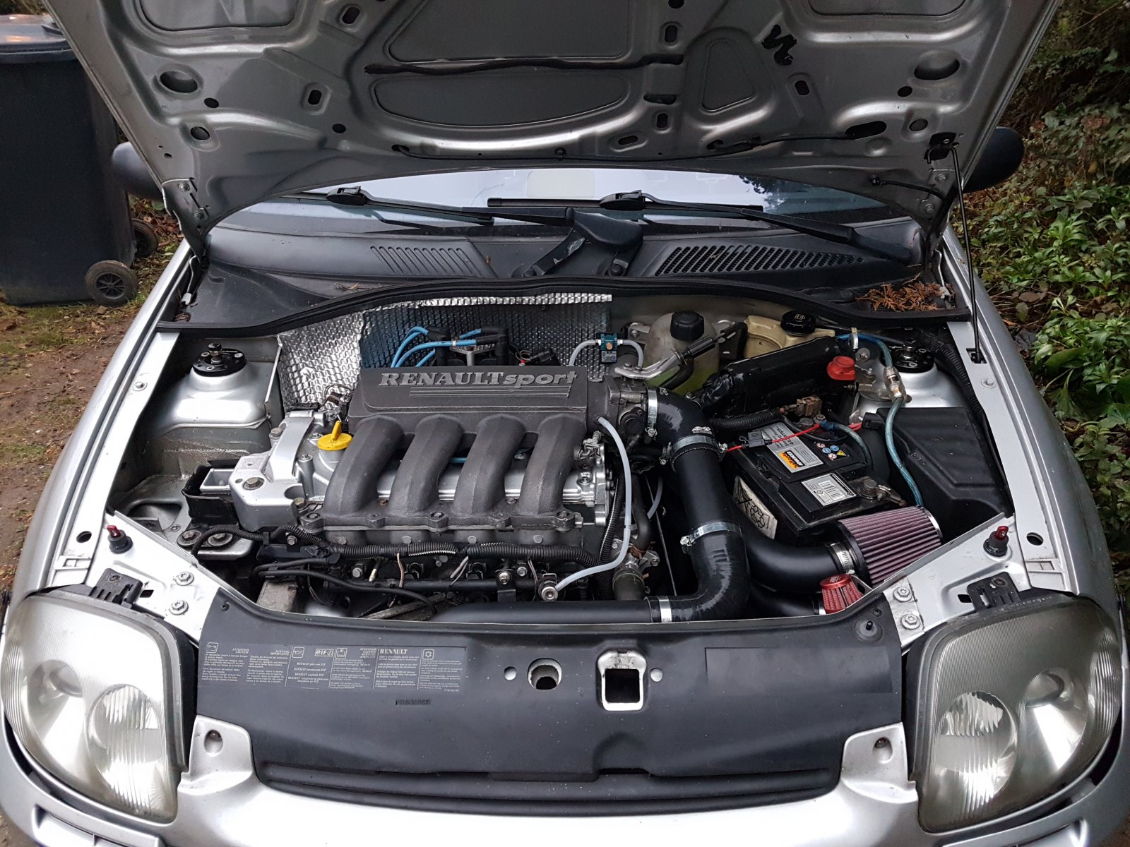

Just finished my conserving my brothers ph1, all done on the driveway by me and brother. Been a great learning curve, goes for mapping next week, car runs great on the bace map so hopefully all goes well.
Spec is:
Lower compression engine (thicker head gasket)
Garret gt2560r
Adaptronic ecu with boost solenoid and switch for maps
Engine dynamics pipework
Homemade oil pressure and temperature sender using a Honeywell pressure gauge and k-type thermocouple, still needs wiring and coding into the arduino
Stack boost gauge
Hopefully get around 250bhp
