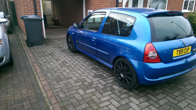

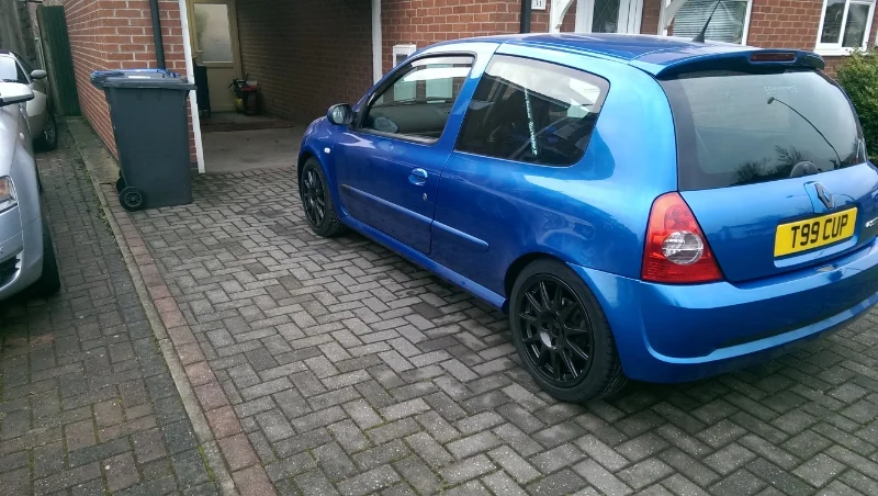

-Finally got round to replacing the Track Rod Ends with some Lemforder ones (which I meant to do weeks ago).
-Had my Road wheels refurbished in Anthracite Grey at the Wheel Specialist in Burton and had some Uniroyal Rainsport 3's Fitted.
Just ordered some Smoked Side Repeaters as the blingy silver ones stand out a bit with the dark wheels.
Just needs an oil change and alignment before bringing it back out to play March/April time :) roll on some Track Days!
