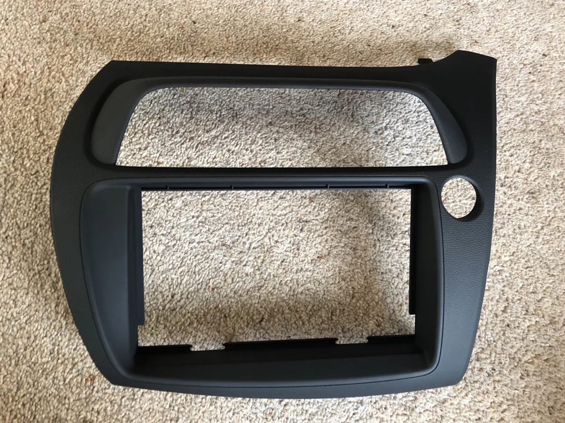

I really need to find the Honda double din fascia, but can't seem to find a genuine one anywhere!
Winner.
Yeah I snapped this one up within 10 mins of it going up. They do occasionally pop up tho on fb or ebay

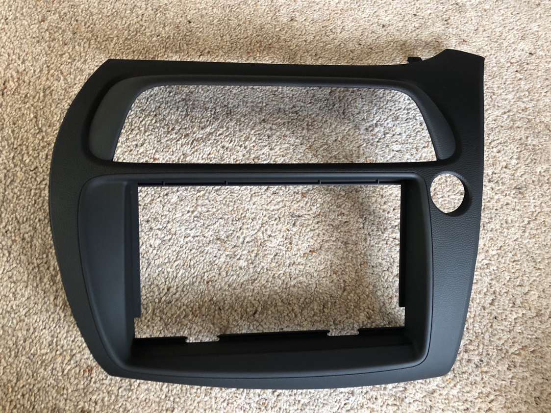

My day has just improved! I took a chance and spoke to Cox Motor Parts and gave them the part number, Wayne was able to locate the fascia for me! I will have one on Tuesday! It's expensive at £134, but i will be much happier with a genuine Honda one.

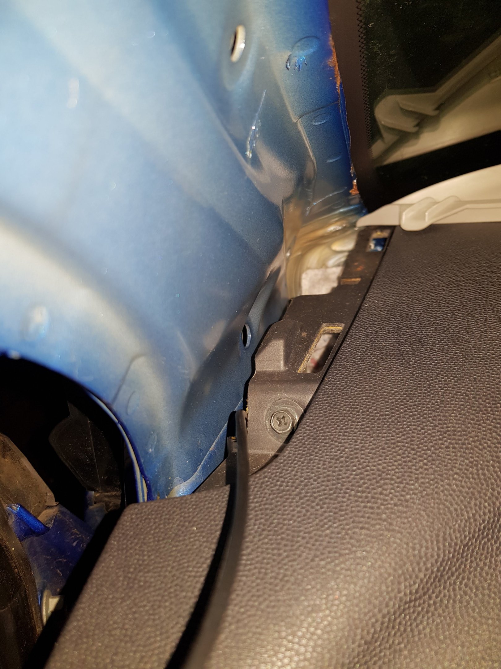

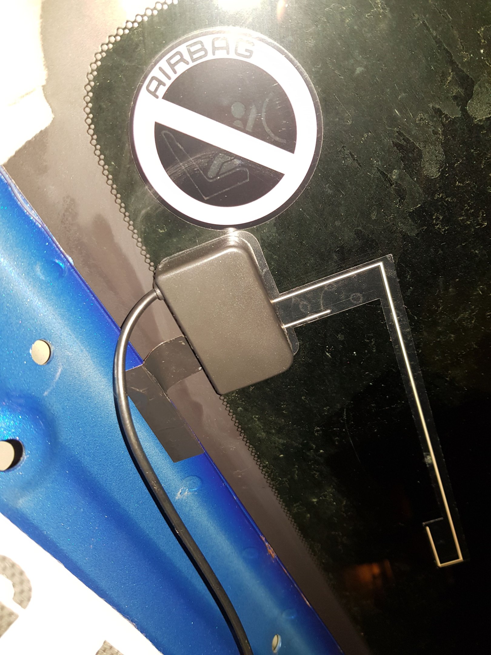

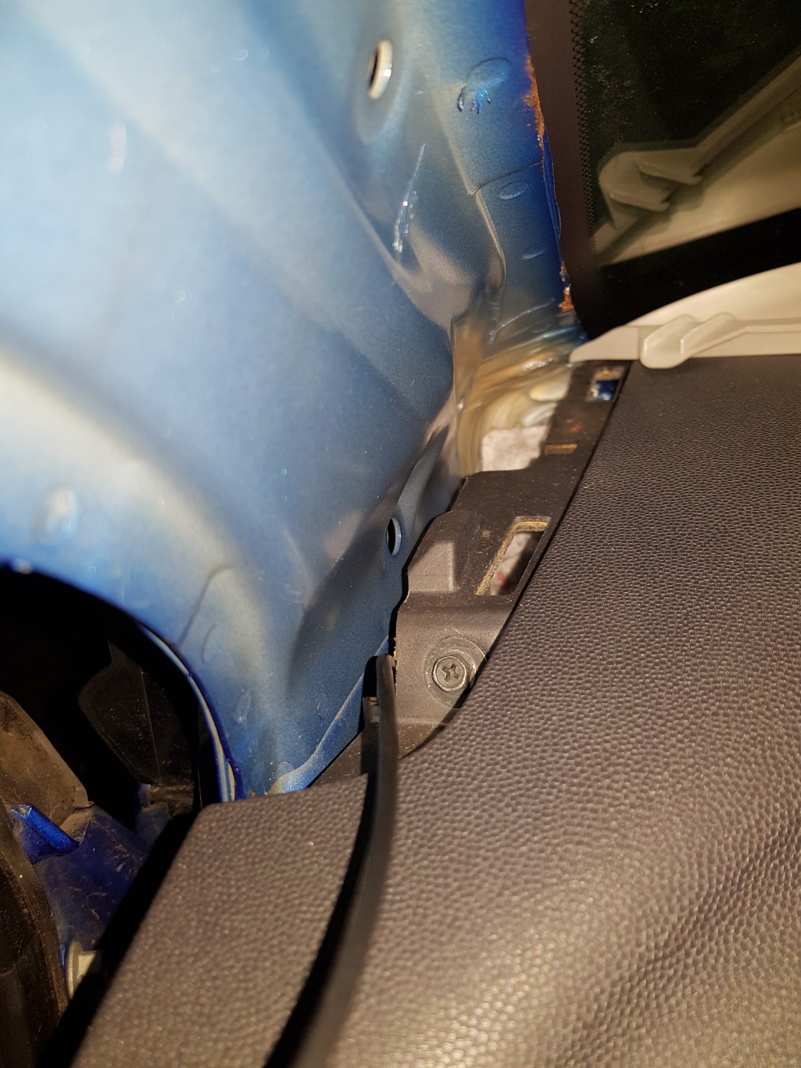

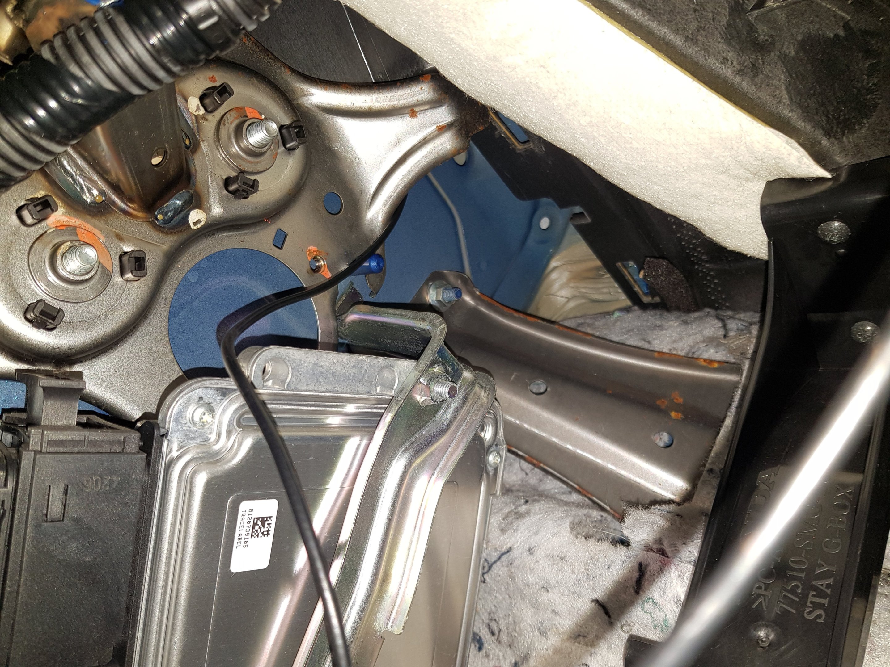

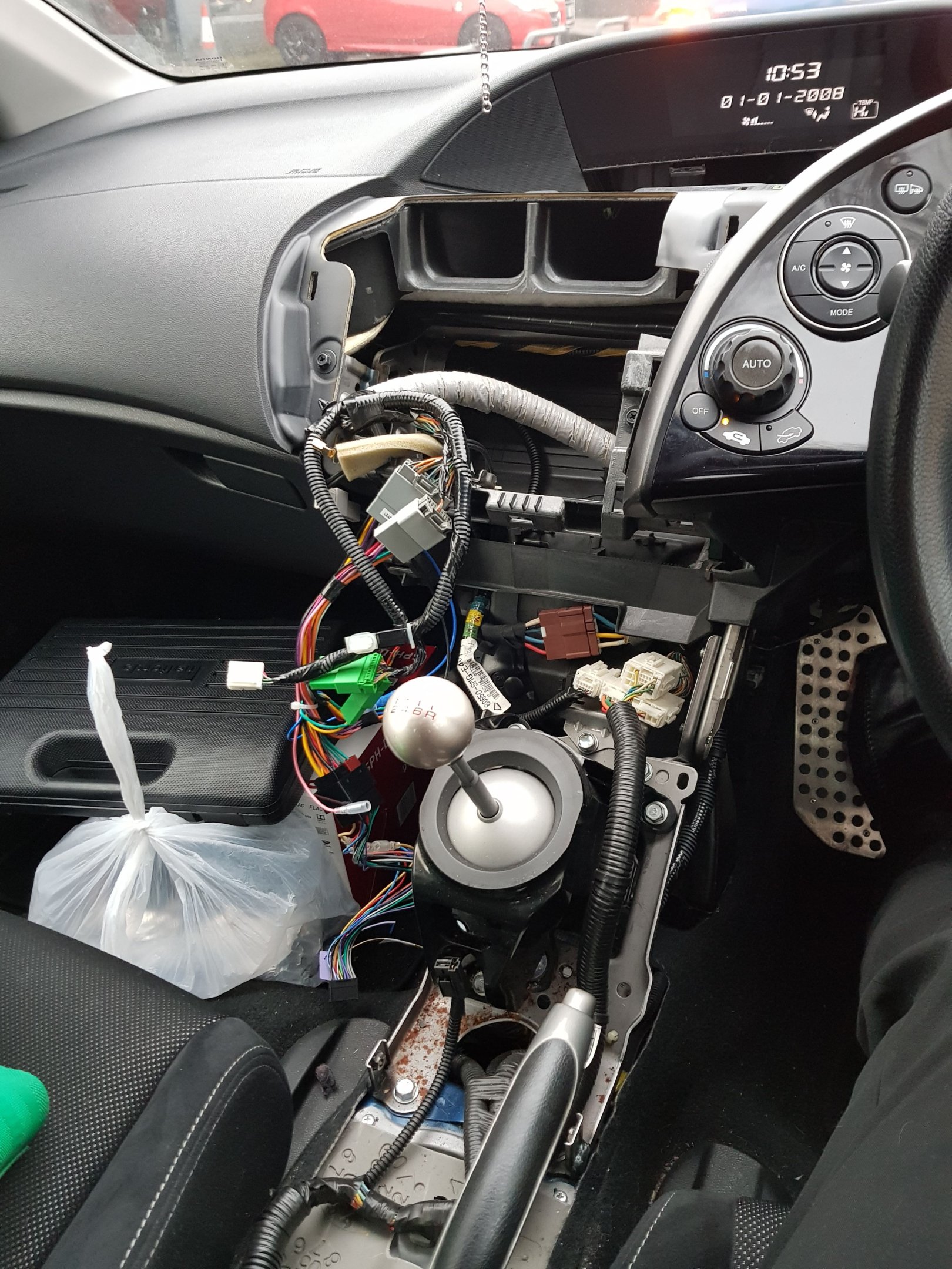

Dam I have been defeated.

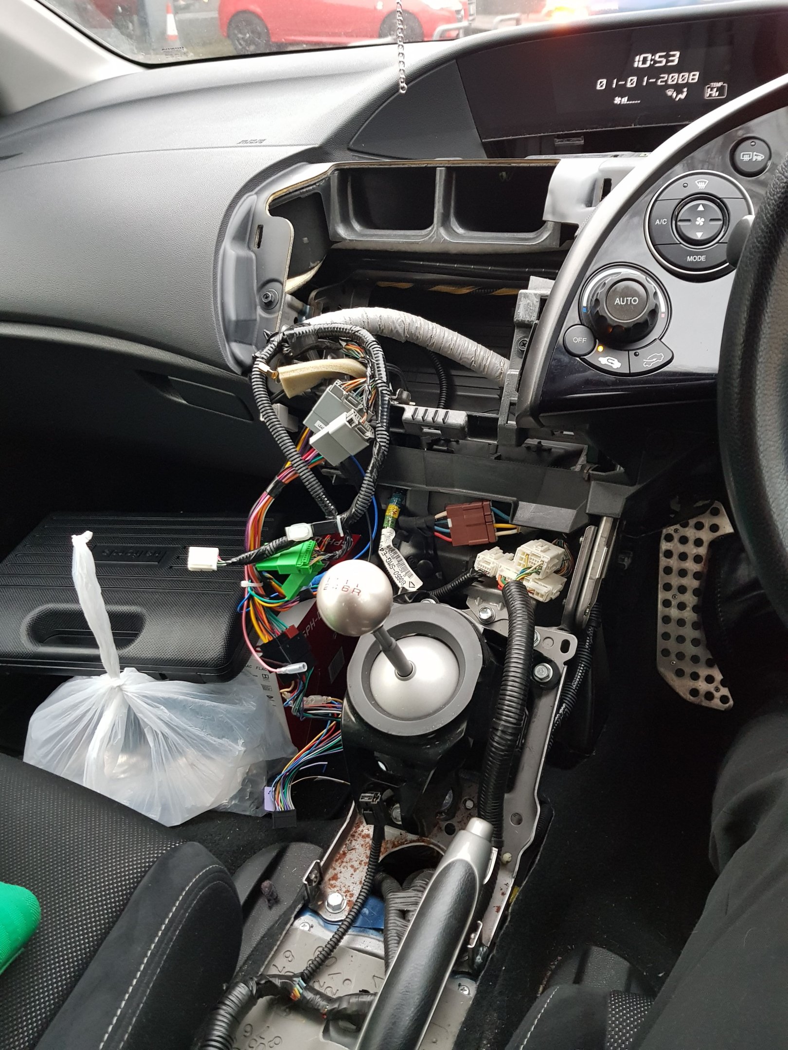

I did all the hard work of getting the old stereo out, I ran the wires for dab aerial and mic. Plugged it in upgraded the firmware ran a test on DAB all good. Sadly I can't get the stereo to attach to the cage I got. I didn't order the one @Danith linked me I got a different one and that's what's screwed me. So In the end I had to stop and leave it all unplugged untill I sort another cage.
Al_G
  Honda S2000, C63
Which one did Dan link?
Rojer

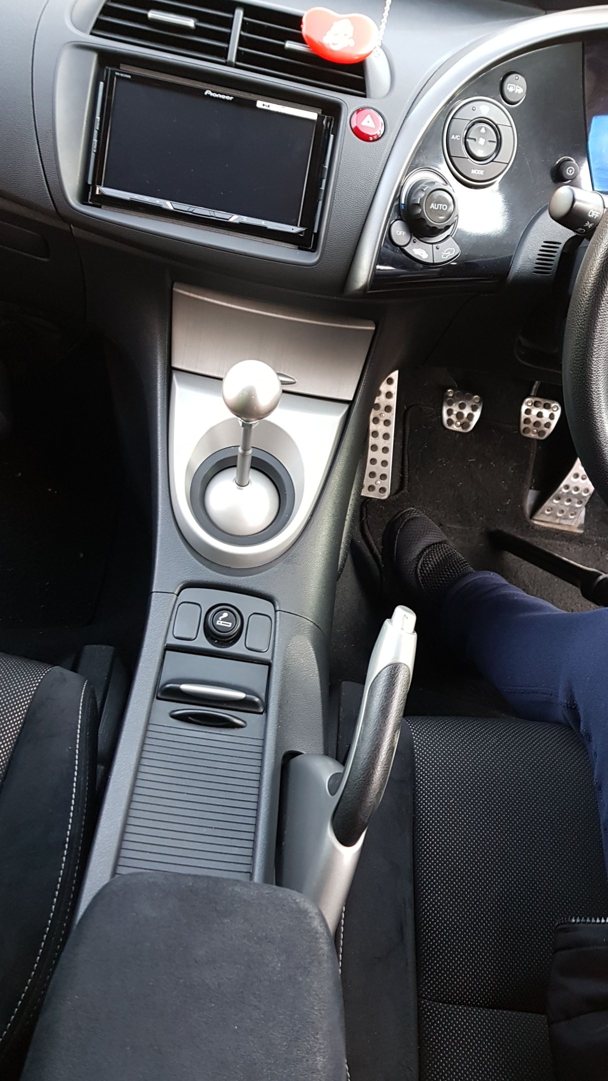

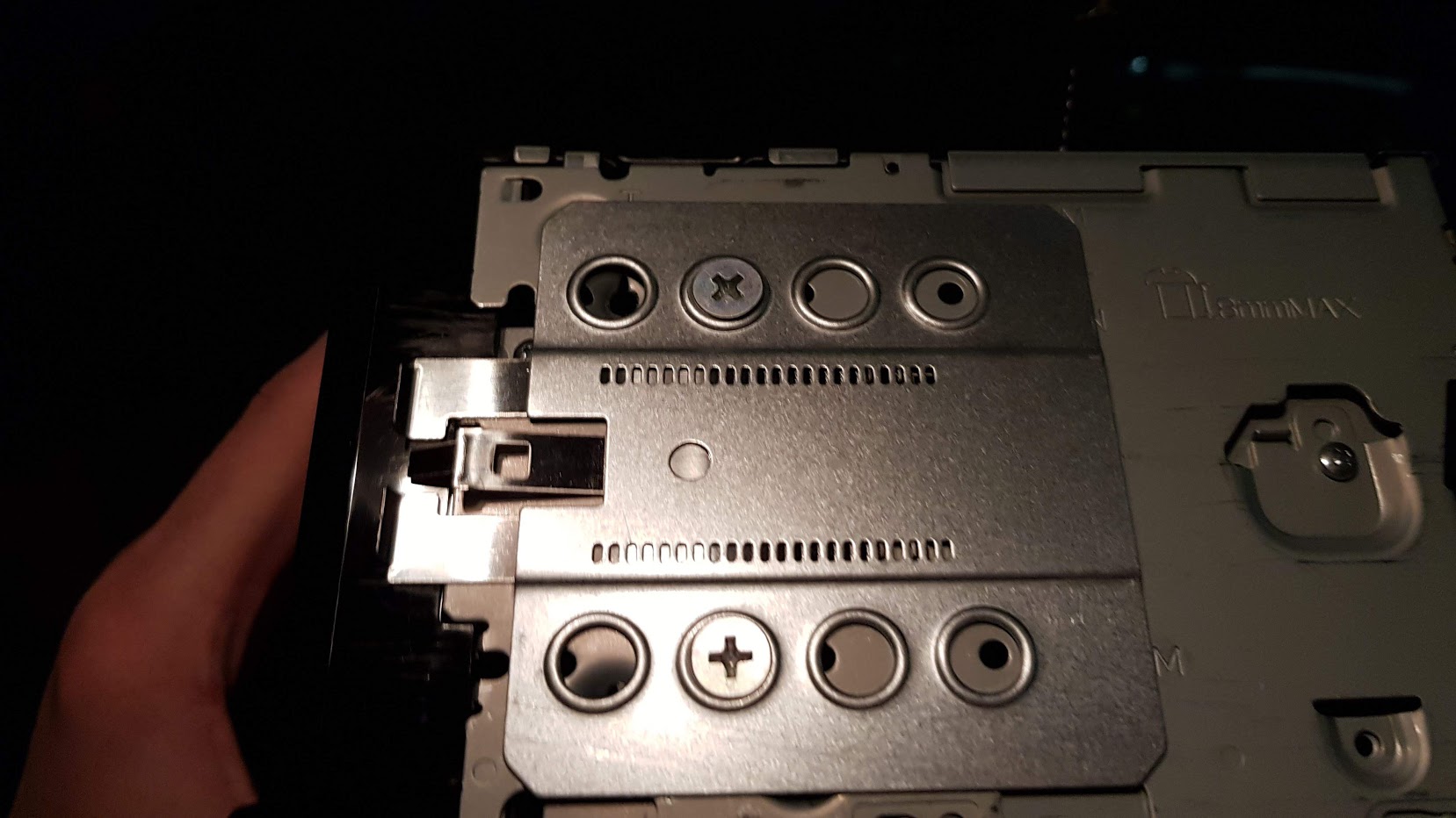

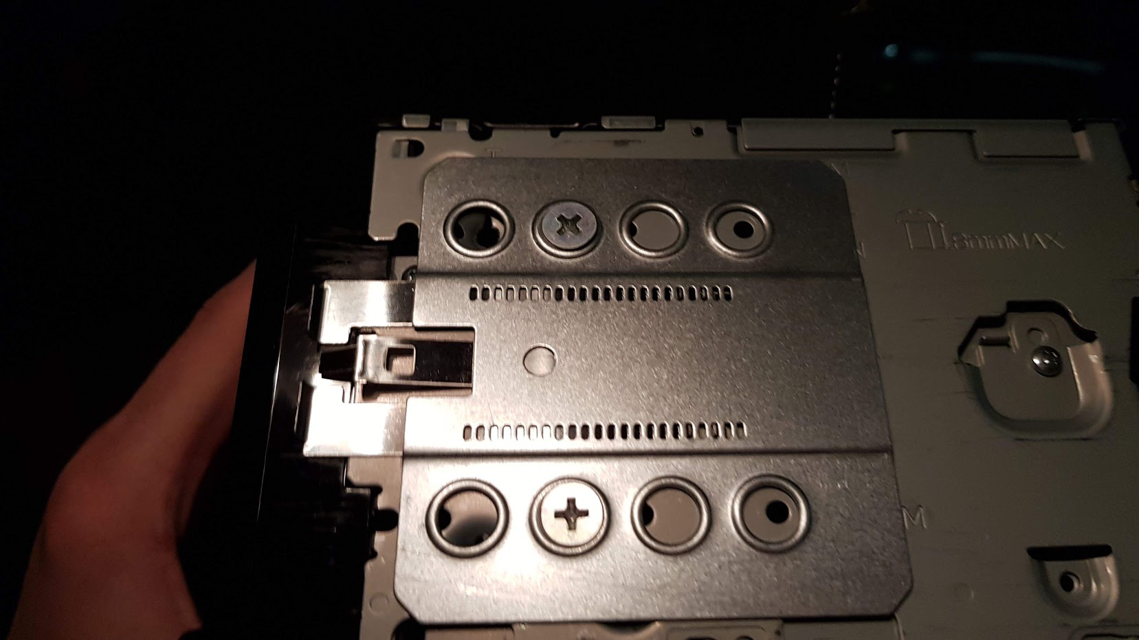

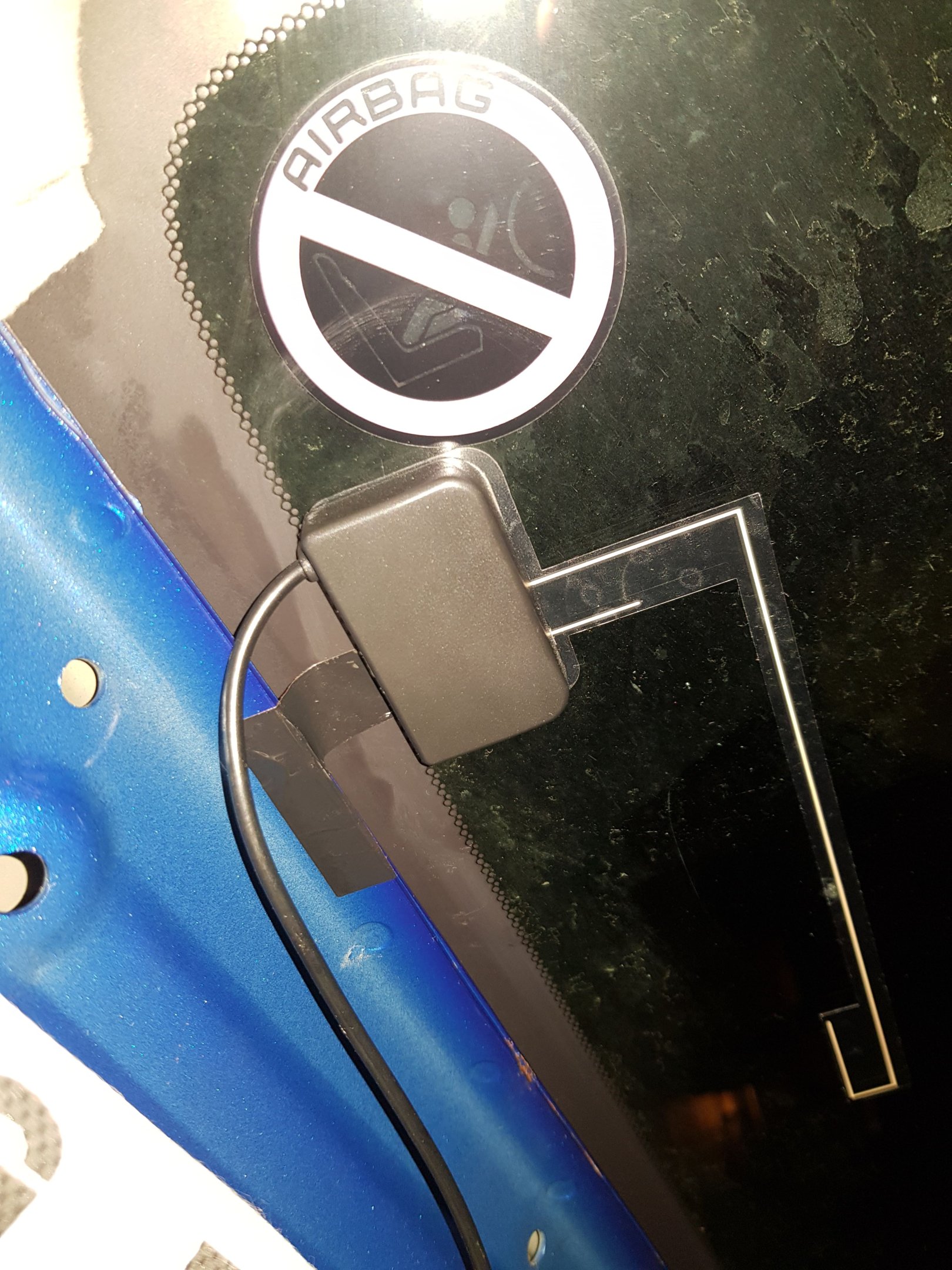

So thanks to some help from @Danith i figured out how the brackets fit to the stereo. I will put it in on my lunch break i think. Just a couple of photos of how i ran cables etc and how it stands currently lol. Just ran the DAB aerial and mic along the factory wiring into the stereo area, wasn't too bad of a job.
I can now offer lots of advice for anyone else doing this in an FN!
Al_G
  Honda S2000, C63

Looks good that mate! Was the pillar trim easy to remove in the end?

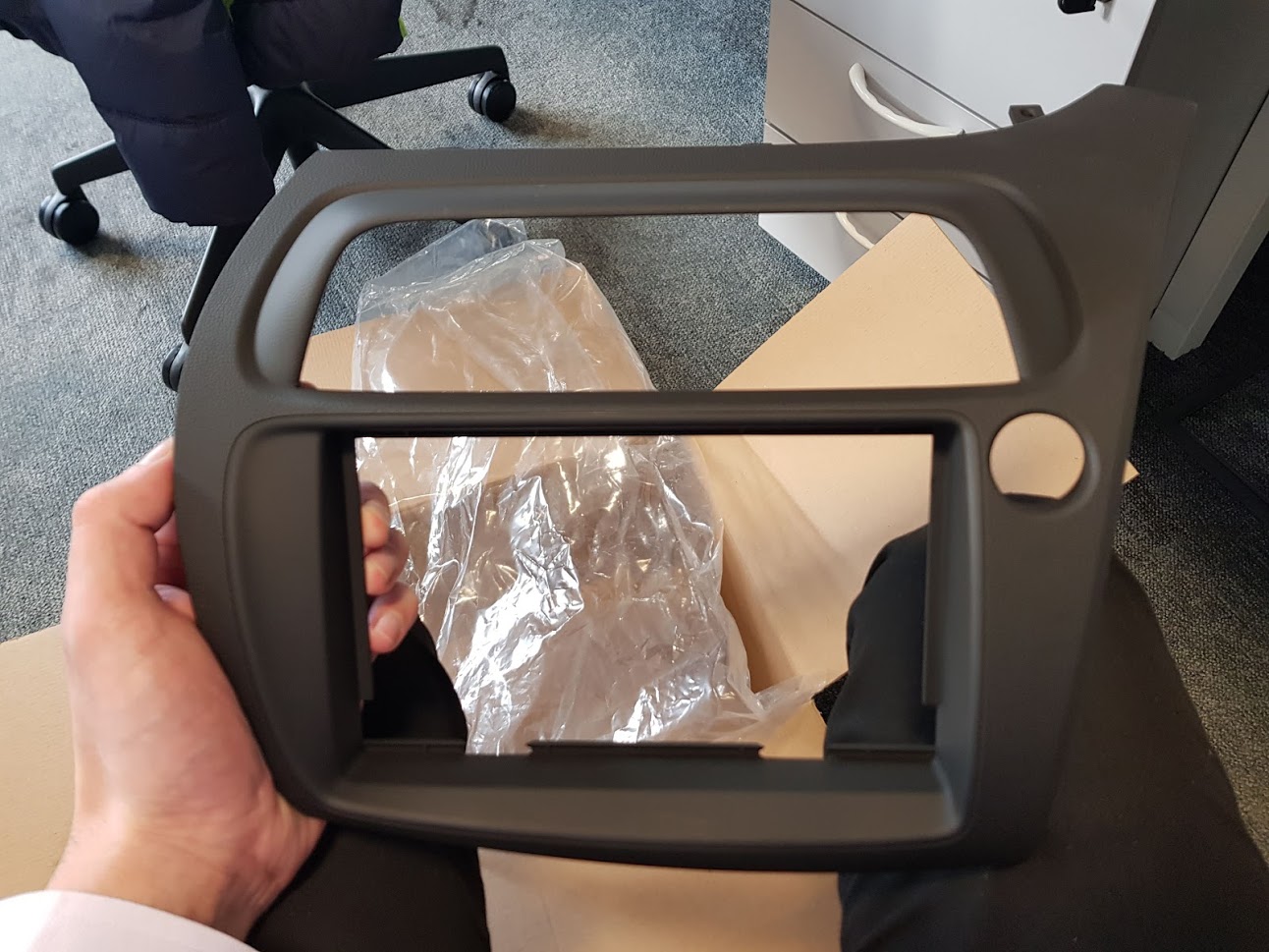

My facia arrived this morning. Looks perfect.
Yer easy, just give the airbag logo a smack and then it just pulls off nice and easy.

Quick question mate, if you don't mind...Which cage did you purchase off eBay? Did a cage come with the head unit meaning you only used the brackets and release clips from the ebay cage or did you use the whole lot?
Sorry for all the questions.
Rojer
My headunit came with a cage, but it was too big for the Honda surround as it only takes 103mm cages and even then I had to trim a little and it was tight. I used all the brackets and stuff that came with the headunit but because it's so tight it's probably never going to come back out lol would of been good to trim a bit more. Try and get a cage that's not riveted on the outside!
Al_G
  Honda S2000, C63
Ha! When you say trim do you mean the facia or cage? I’m guessing you used the brackets and screws that came with the eBay cage?
Rojer
Fascia unfortunately. If you have a different style of cage it might work out better.
