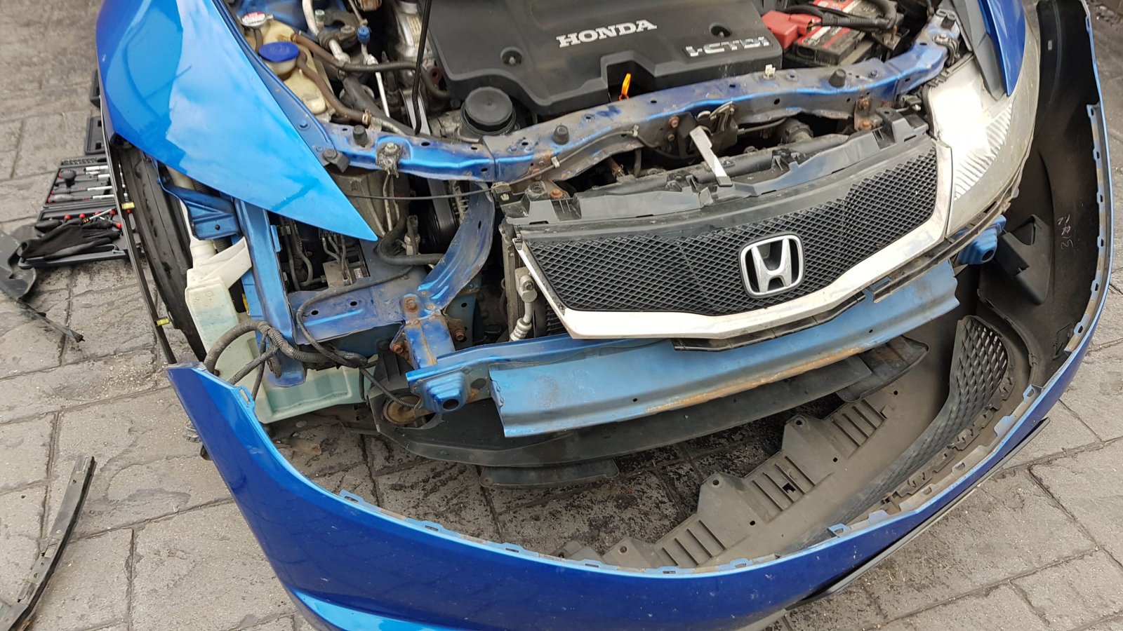

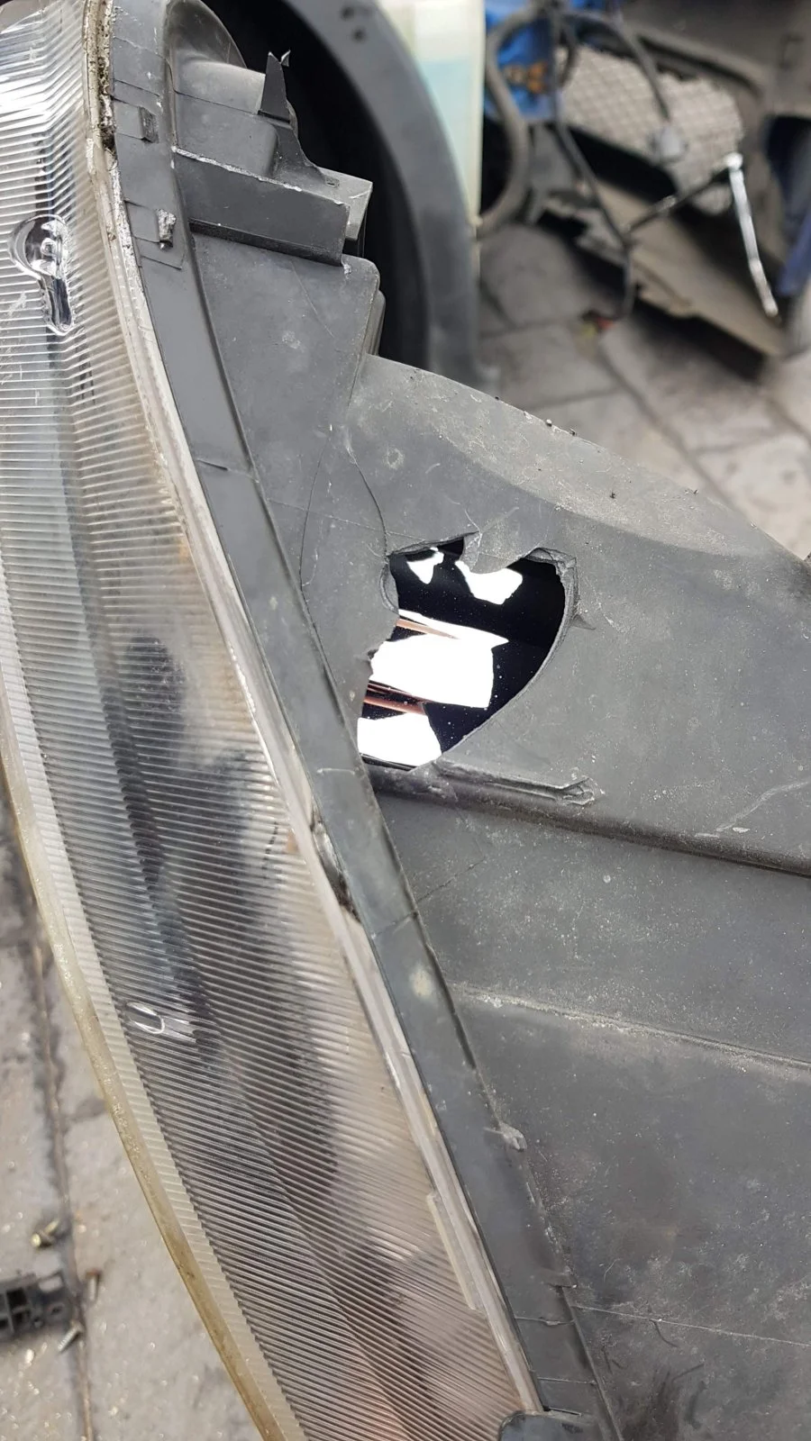

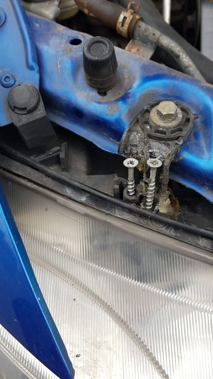

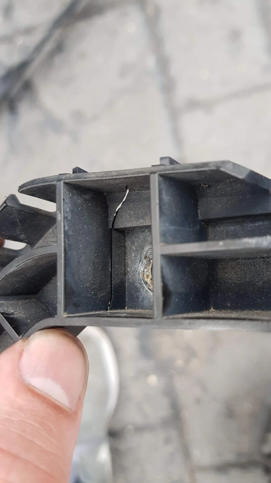

Not to much to report on the car, done another oil and filter service with genuine parts around 1k ago. Seems to be running well. I did notice an issue with alignment and panel gaps and decided to investigate yesterday, i was not impressed with what i found!
Luckily it doesn't look like there is any structural damage behind the light. I gave it a good look over and everything looked original so just a broken headlight and a few brackets/clips etc. Previous owner must of bodged it before i bought it then the bodge gave way and i noticed it!

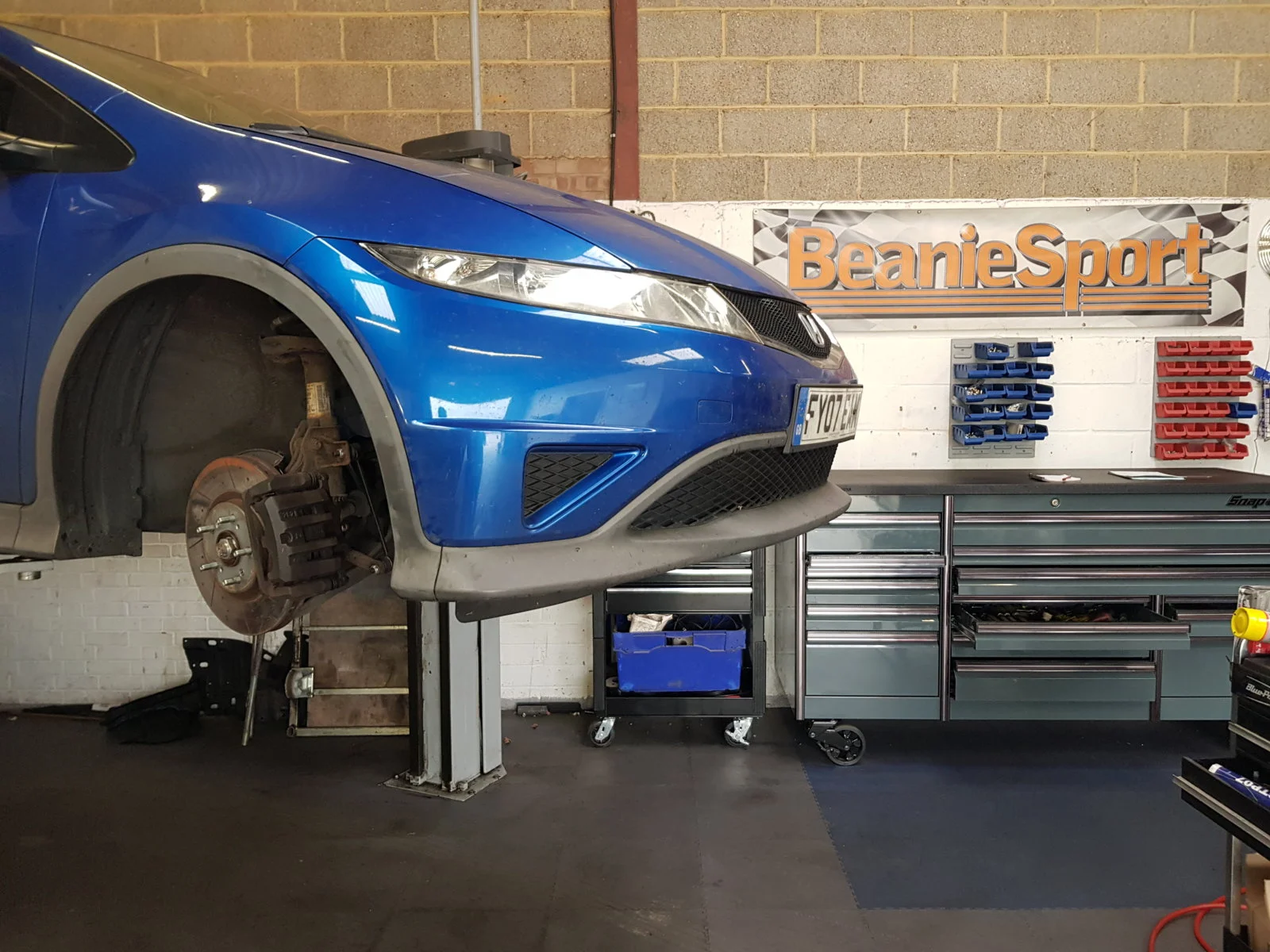

So this morning I was very hungover and took the car to Chris at Beaniesport to have the brakes done. Parts to swap were calipers, discs, pads, Goodridge lines, Ferrodo fluid and 15mm spacers.
Had a look around at the rest of the car underneath and it all seems good. Job went without issue. The pedal isn't as firm as I thought it would be, I was thinking it would be rock hard, but still has quite a bit of travel. Did bleed it a couple times to be sure and that's just what you get it seems.
Another chunk of money down the drain for not that much gain it would seem, but to be fair I haven't really tested them properly so maybe once I try a bit harder I will notice a difference. Just thought I would get a bit more instant bite and a firmer pedal.

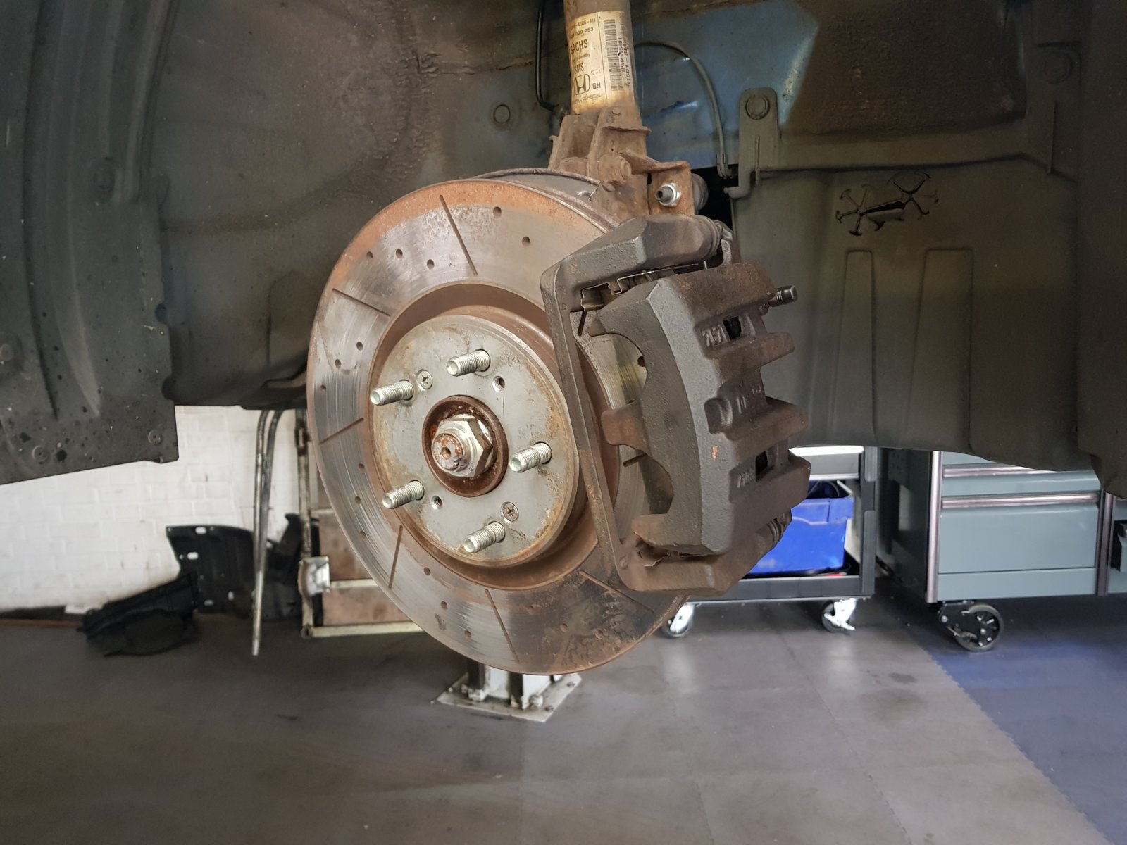

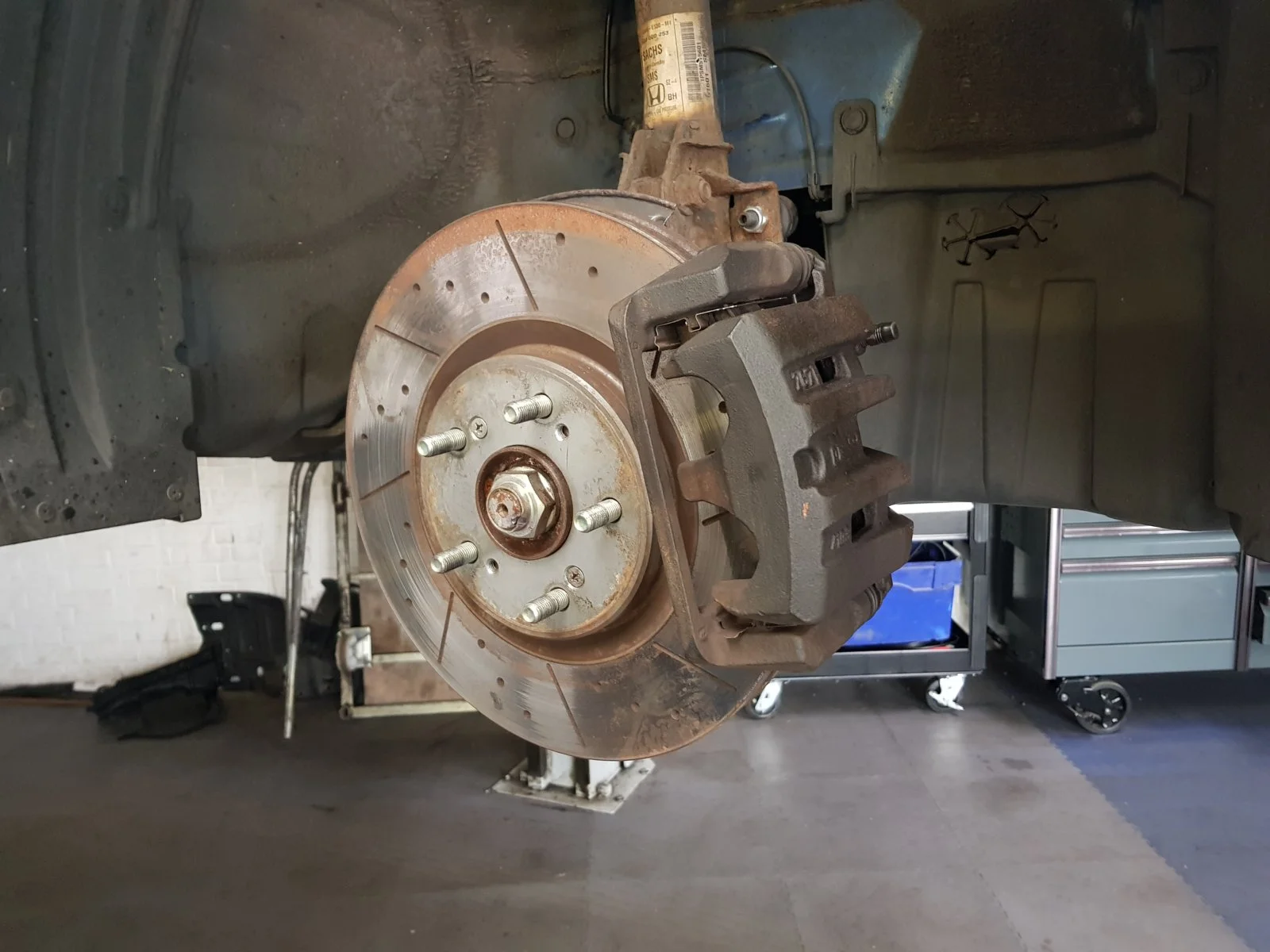

I have been investigating the vibration issue a bit more on the car, turns out (so far at least) issue was with the discs, which in turn has been caused by sticky/stuck caliper carrier pins. Took both of them off this evening and the bottom ones were pretty stuck, but this is where it gets strange! I took all the pins out cleaned them best I could with some brake cleaner and a cloth. The bottom ones had a rubber bush on which had clearly swollen and the top one was quite a bit shorter, no bush. Any who cleaned them up and they didnt particularly want to to back in, the bottom ones seemed to go in further and the tops ones around half way. Fitted new discs and pads went to put the caliper on and it wont fit because the pin wont compress enough! So new discs, old pads, put it back together and the pedal felt alot better so took it for an extended hoon and no vibrations, however by the end of the drive I had a little bit of squeaking from the drivers side and sure enough temps were far hotter on that side. I guess when I checked temps before they were both stuck and that's why they were the same. Interesting that the pads hadn't worn unevenly either. Also when it was fitted I asked Chris did they all move alright, yer yer they are fine! Wait till I see him.
So what I want to do is get new carriers and pins etc. Will see if Honda do them or find them online. If not will try just new pins and see if that sorts it, hopefully it wont kill the new discs in the meantime. I hope this is the end of the vibration saga!

Glad you got it sorted, it's annoying when you cant find the issue. It may be that your carrier may be full of crap where then pin sits in, if I remember how Honda brakes are setup that is?
