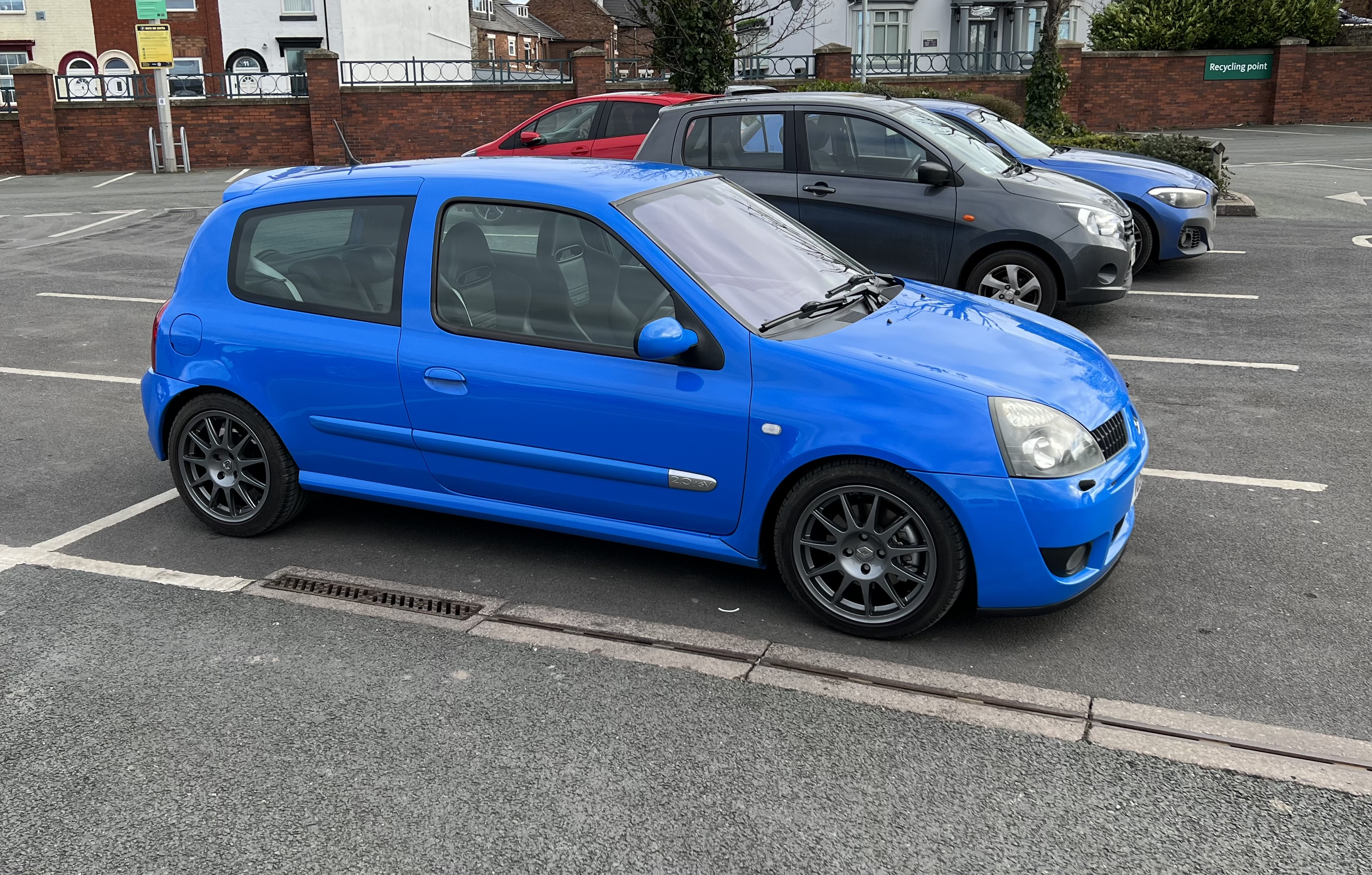

Quick snap of the car I took when I pulled over 5 mins from Blyton.
Still need to give her a proper machine polish, not been feeling up to doing much work on the car at the moment.

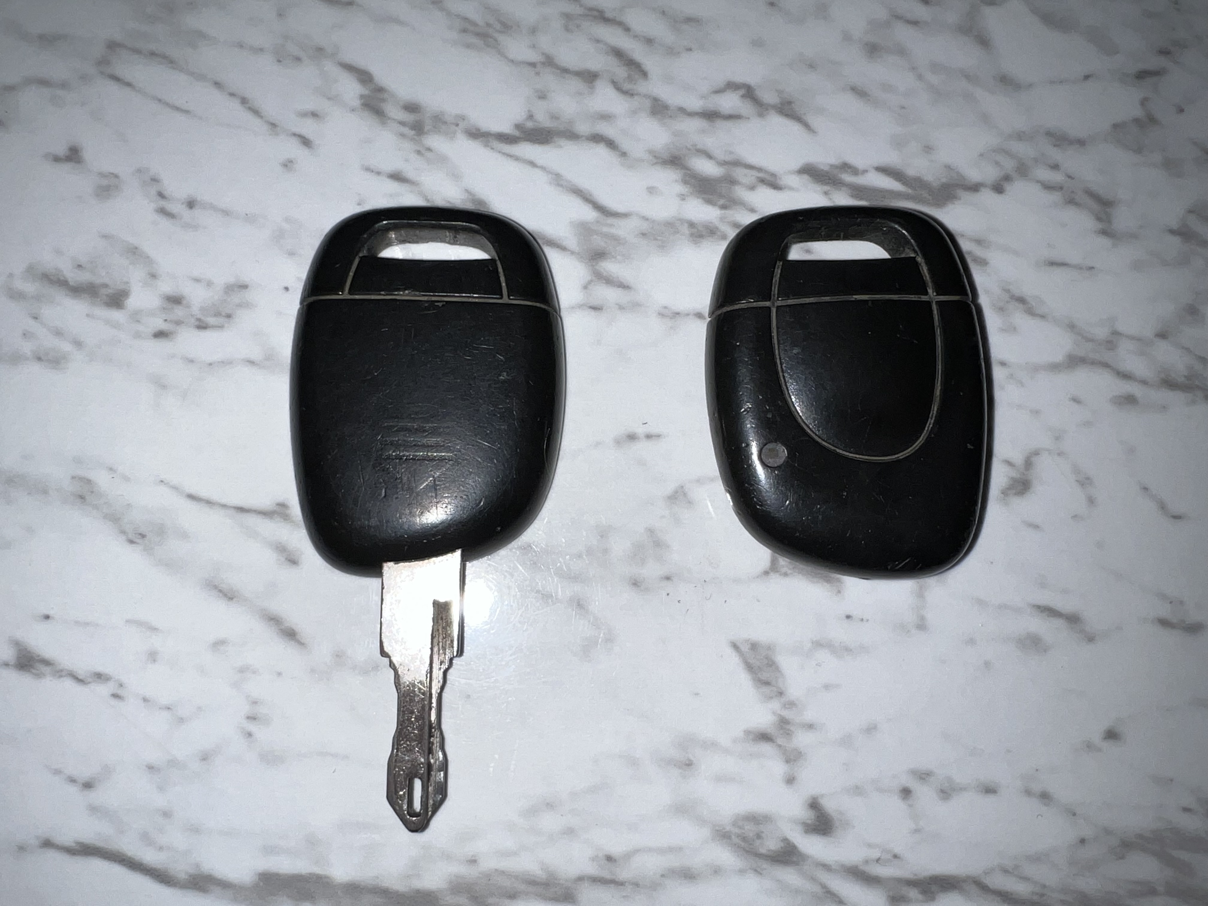

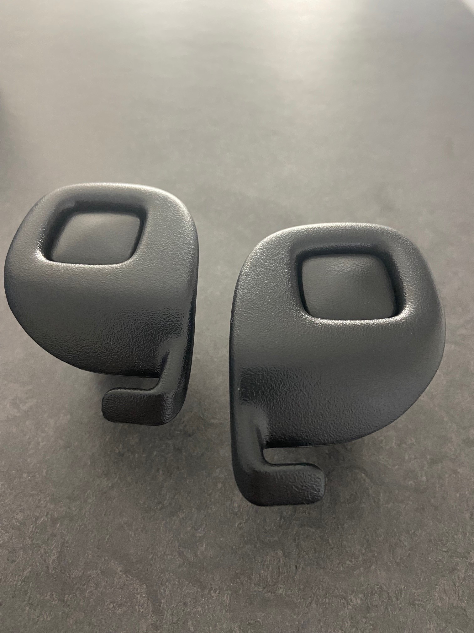

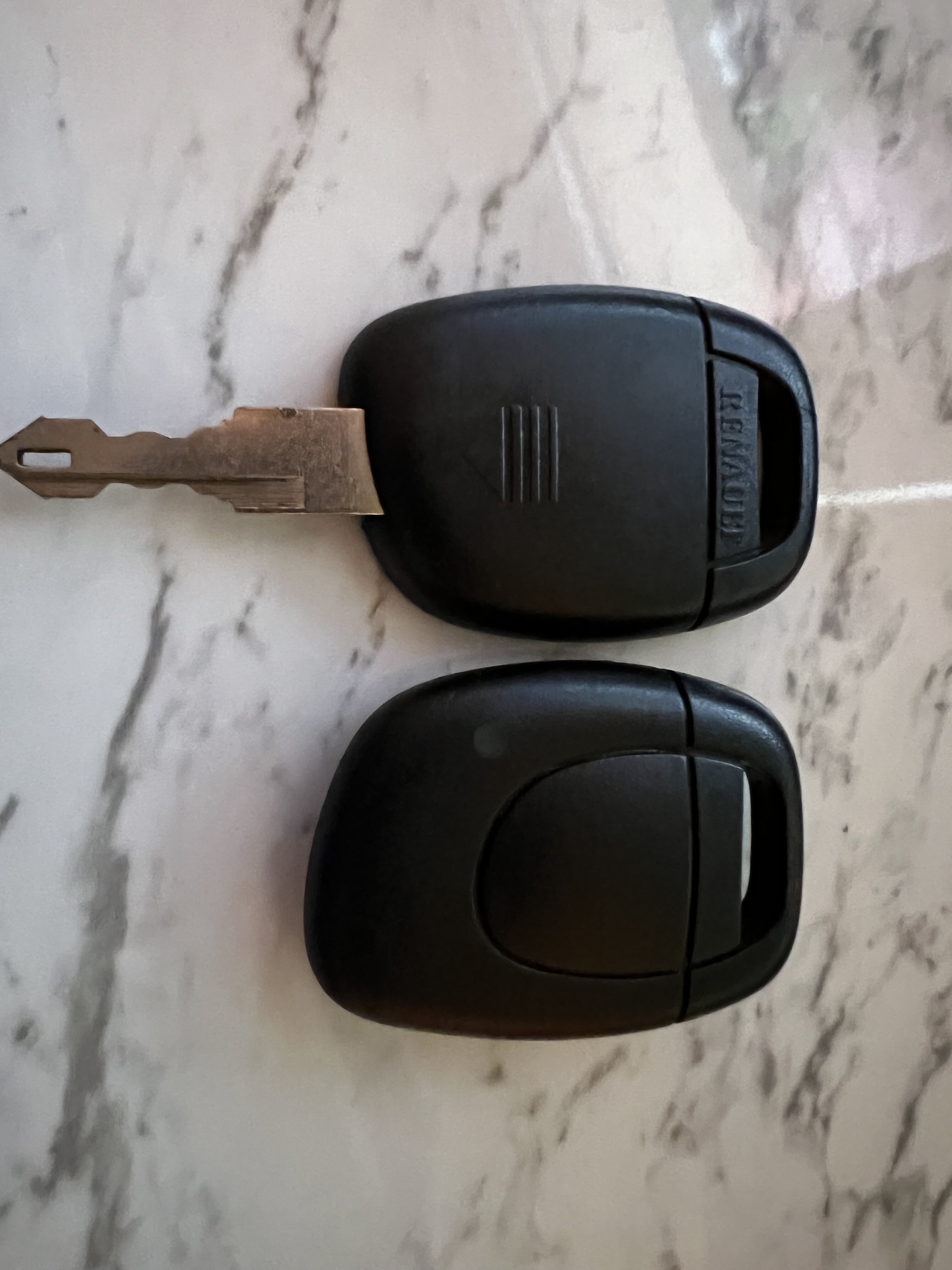

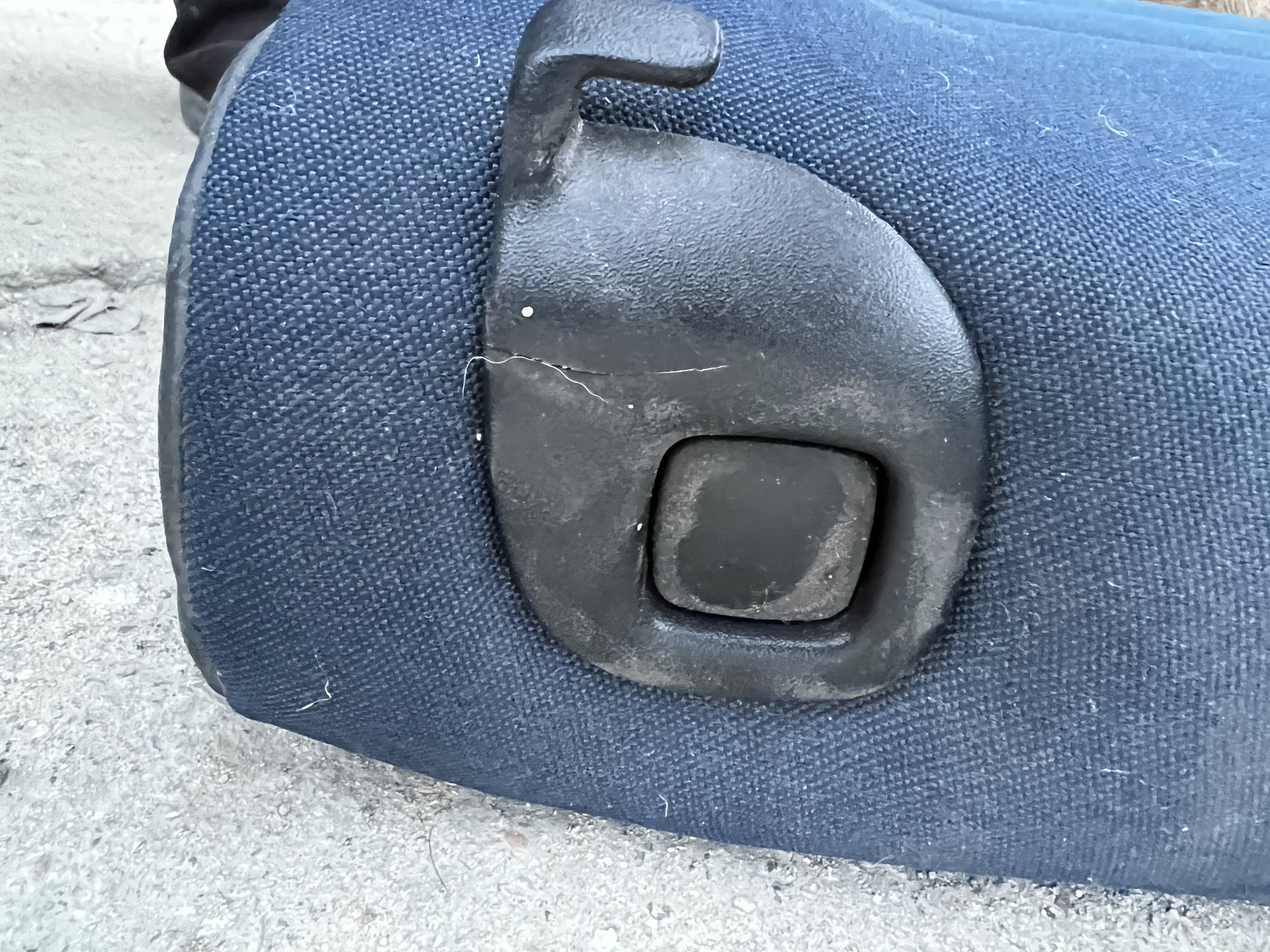

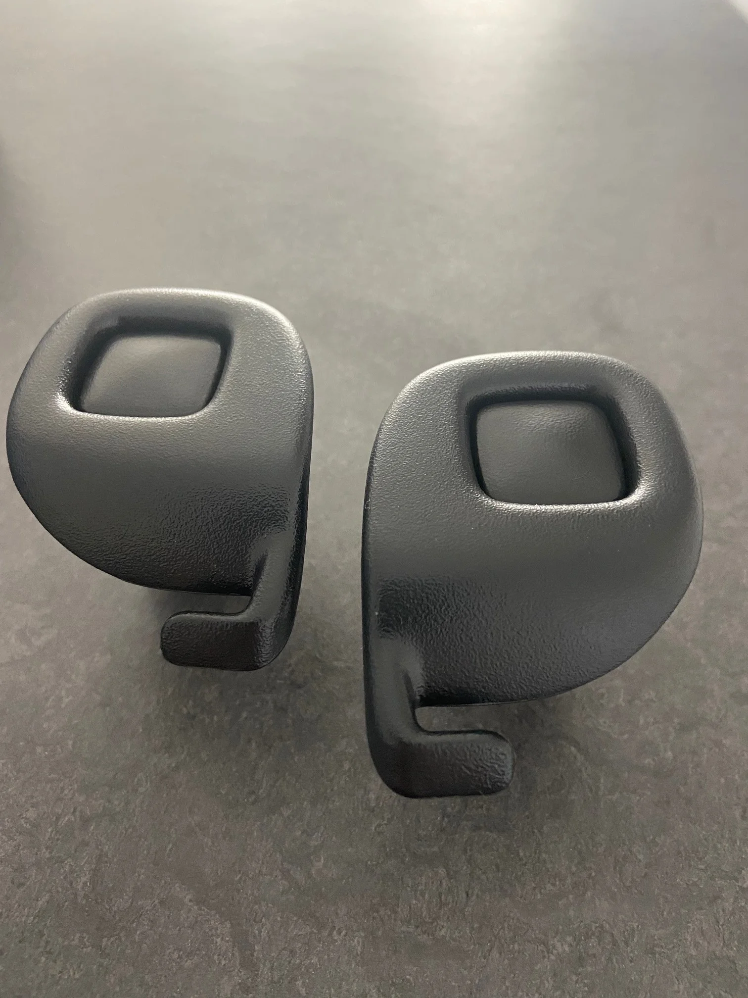

A really small thing that's bugged me since I got the car, the main key is really worn down, so much so that the textured Renault logo on the back and down arrow have been worn almost completely smooth. I know you can get replacement plastic housings cheap, but they lack the Renault logo on the back so I've never been particularly keen on them. I have looked for 2nd hand ones a few times but they're usually even worse than mine and have usually been attacked with a screwdriver or something at some point to try and get the key open to change the battery. I did stumble on this on eBay though, a nearly perfect genuine key. Swapped the blade and circuit board over from my key and I feel much better, I also stuck a rubber case over the key to protect it, not sure if I'll keep that though.
Old:
New:

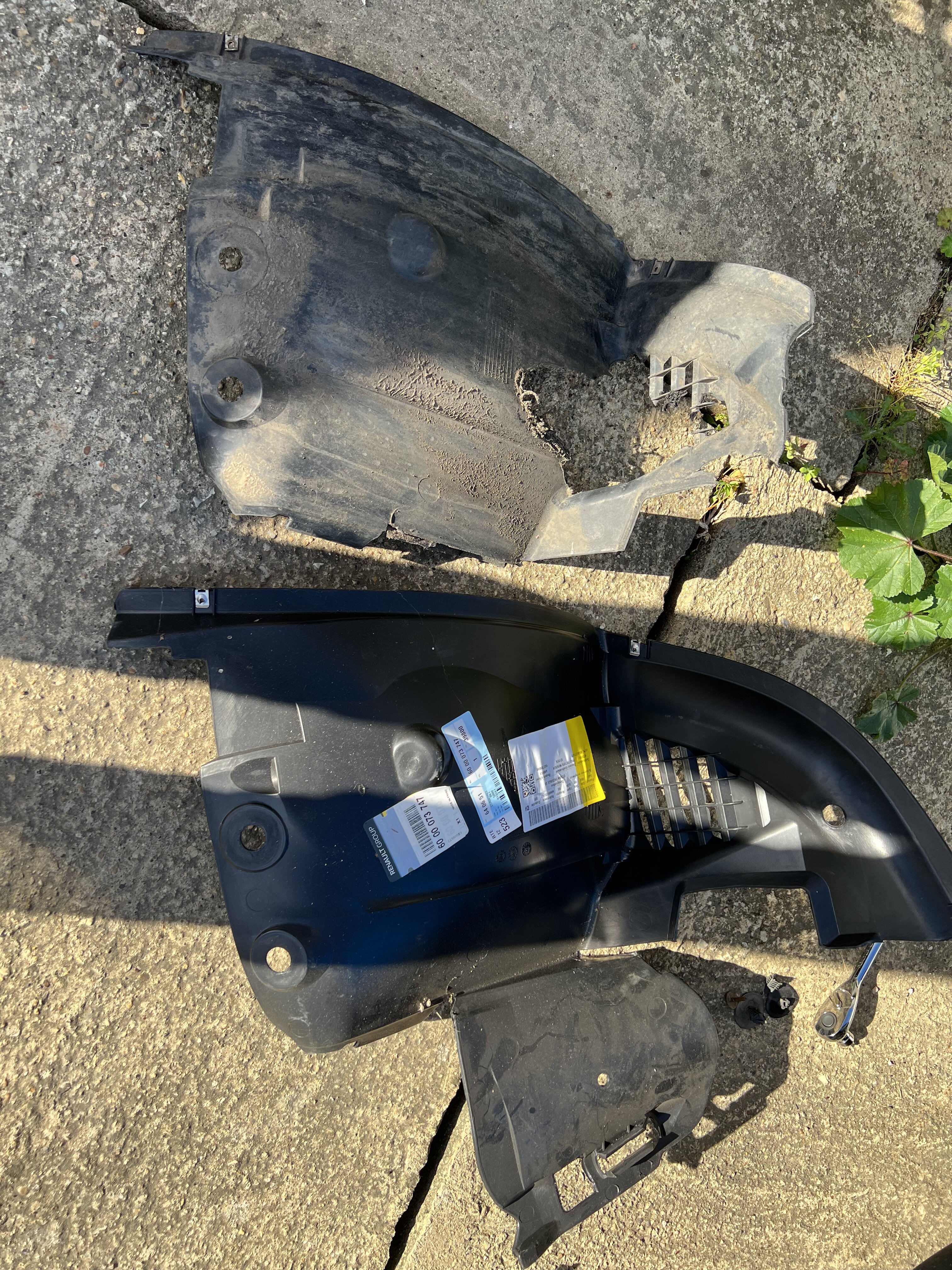

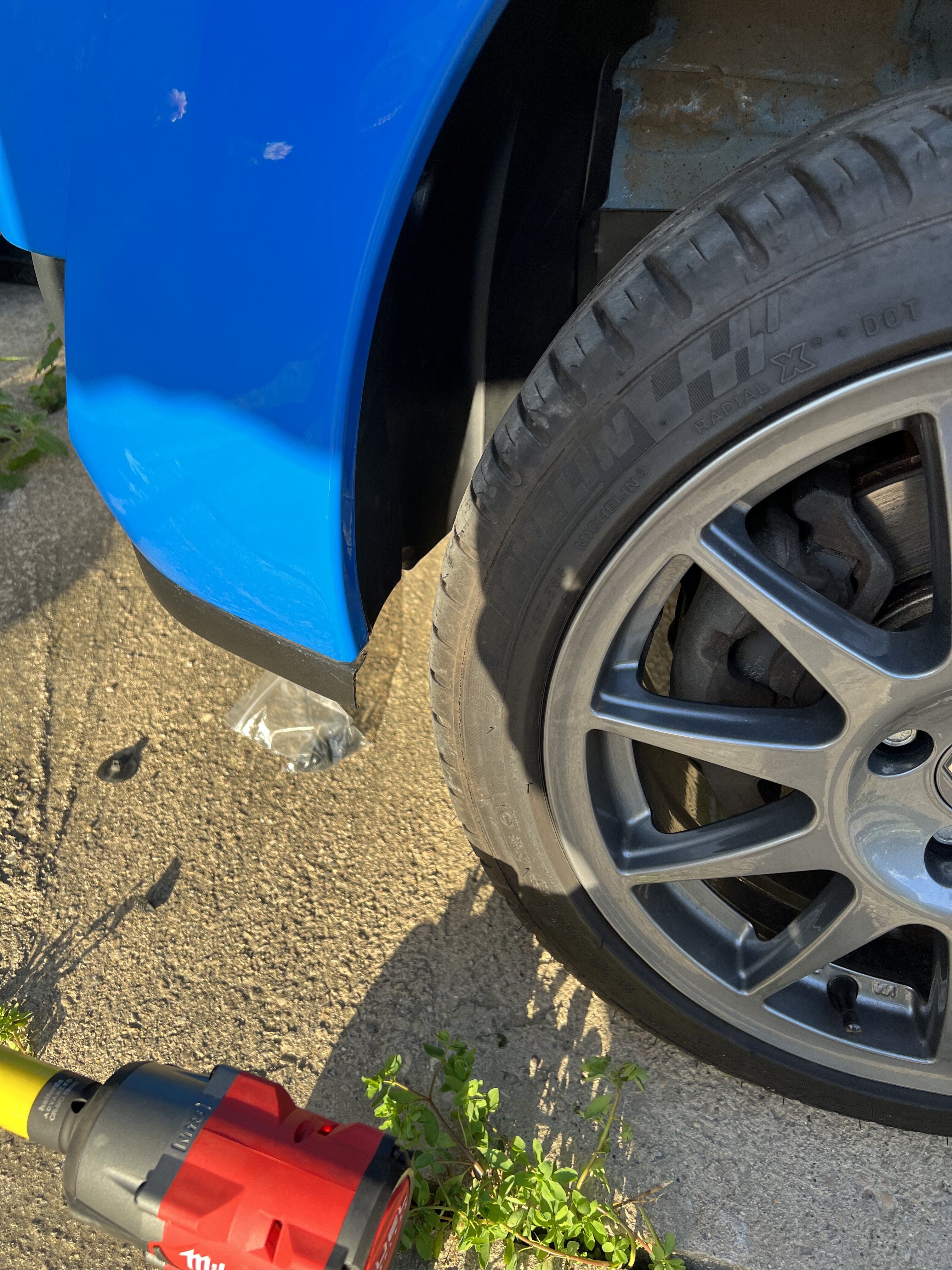

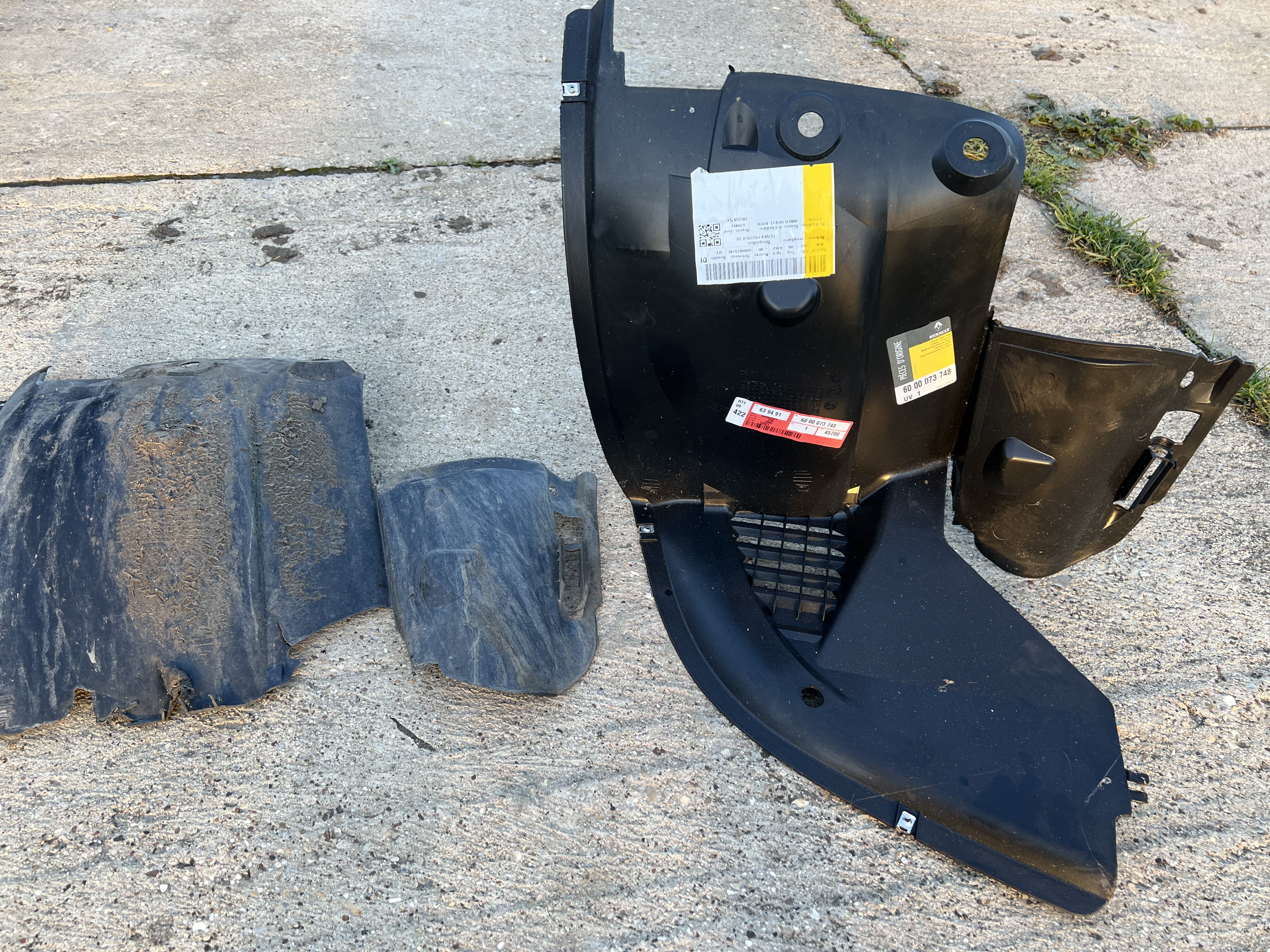

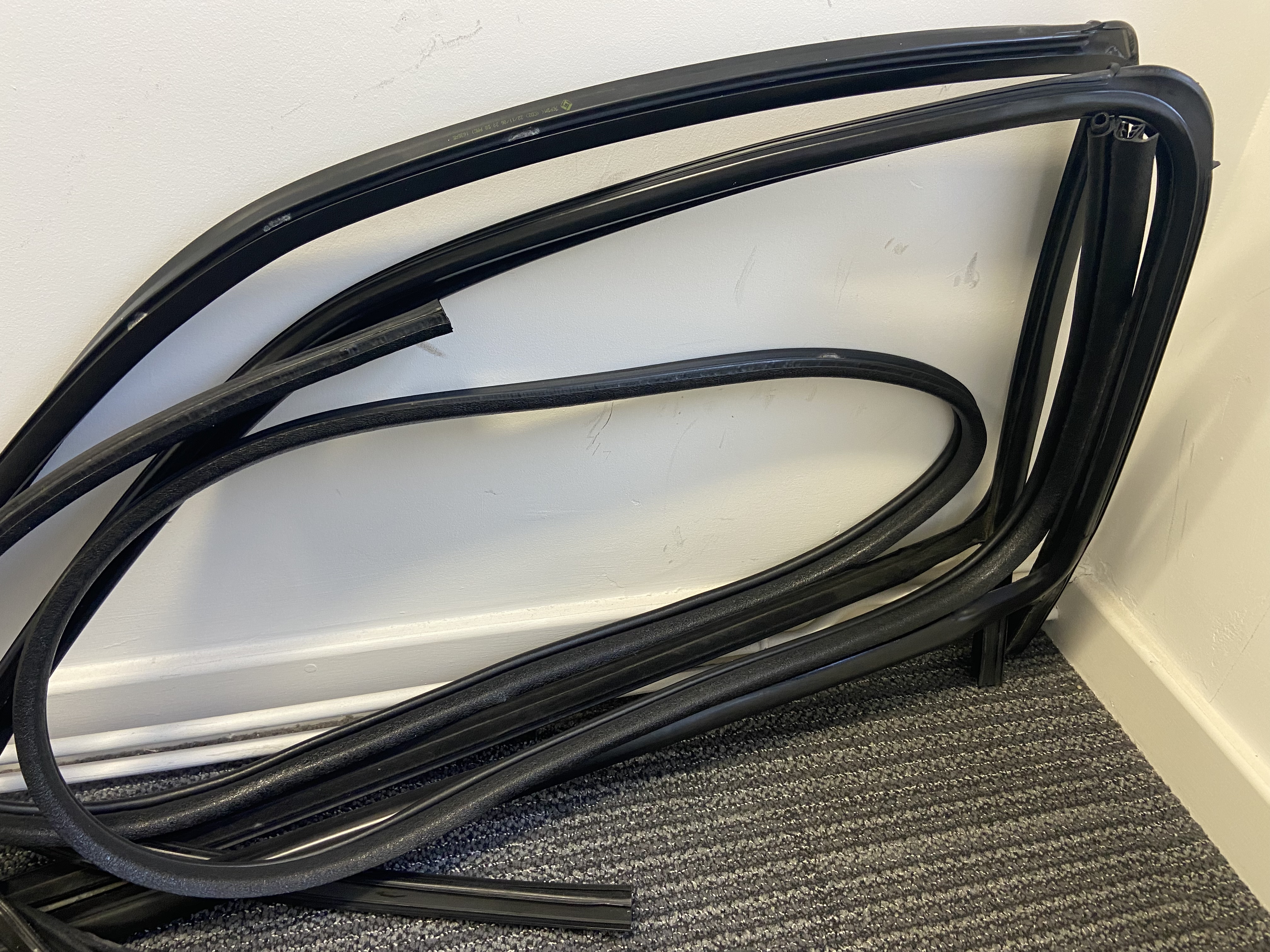

I've had a brand new set of front arch liners (the front portion) for a while now, mine have definitely seen better days so I hunted both sides down which took some doing as they're NLA and nearly impossible to come by now.
Ignore the storage dust, I did clean them up a bit before I stuck them in. I couldn't find the fir tree clips I ordered though so I had to re-use, I'll order some more and stick them in soon as mine were quite mangled. At the same time I replaced the screws around the arches with some nice marine grade stainless ones I bought, better than rusty fasteners, but I'm not sure about the silver. May end up spraying the visible ones in RB if I really want to be anal.
I definitely need to give my arches a good clean out, as well as take my side skirts off and clean up the sills. I've got all the stuff to do it, I'm just a bit lazy at the moment.

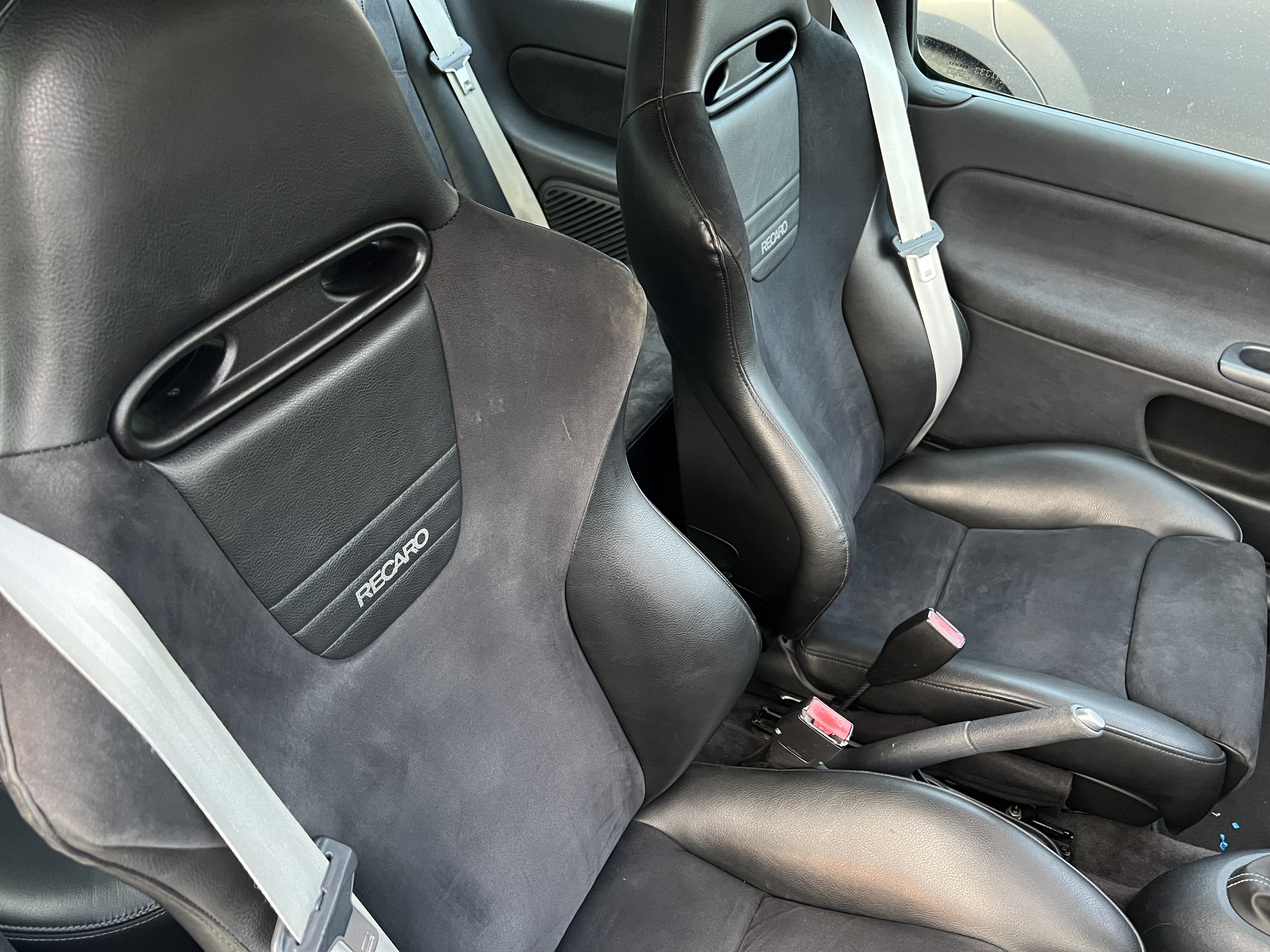

In more major news, I was tempted into buying the very nice trendlines that @Don’t call me Dave had for sale and I'm really glad I made the 5 hour round trip to Gloucestershire to get them, not just because Russ is a great guy and it was great to meet him, the seats are in great condition with just a bit of a mark on the drivers bolster which I can live with, and came with the revered Jon Foz subframes which lets them sit nice and low in the car.

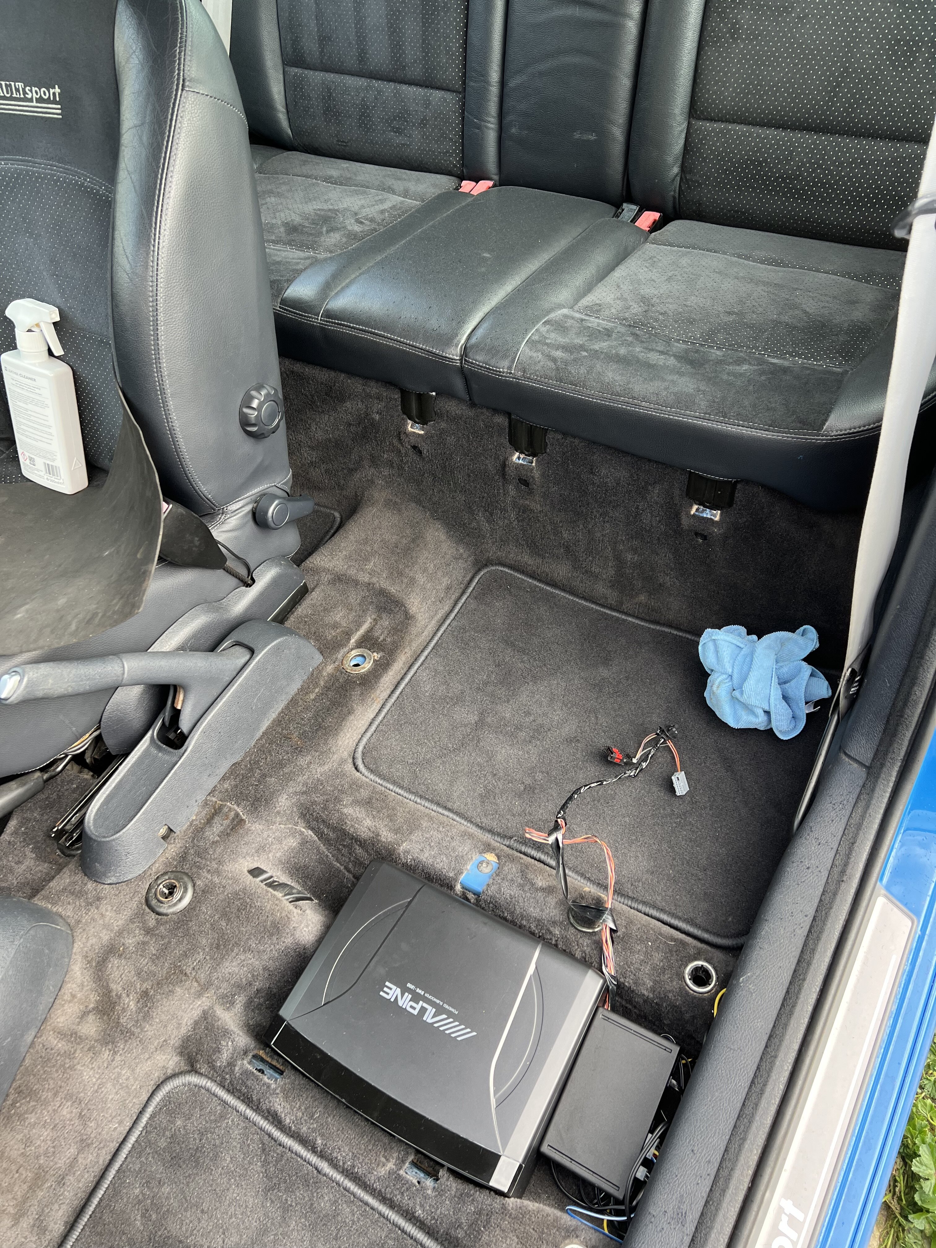

I've been getting a bit fed up having my head right up in the headliner, so these should solve that nicely. I've always liked the standard seats, they're nice armchairs, but I'm 6'4" or so with a slim frame so I can feel myself slide on the seat in corners when pushing on which doesn't inspire confidence. I did like the idea of leather pole positions, but I can't justify £2k on seats however I frame it. I figure these will hold their value and I like the idea that even though these came out of a Megane R26, they could've been optioned from factory on these cars. I'm not about to put pov spec back seats in though!
For future reference, they do clear an Alpine SWE-1200 sub no problems even on the Jon Foz low frames. I also vac'd out under each seat as I had them out.
We did have a go at coding out the airbag light with Russ's RSTuner, but we couldn't get it to work for whatever reason even though it seemed right on the config. I stuck the driver's seat in and had a go this week and did manage to get the light out with some fiddling. Credit to Henk at @Fastchip , I bought the airbag module Thursday evening and had the code to unlock it on mine by 10am Friday morning.
In terms of driving with the new seats, they feel significantly more supportive and in a much better position. It's really given me more confidence in corners, when you don't slide about in the seat you can feel what the car is doing! I'll need to do some more journeys in them to see how they fare on a longer, less spirited drive, but loving them so far.
They also look the absolute b****cks in my opinion, so I'm really happy with them. Will also be keeping the standard seats if the time to sell ever comes.

seats is one of the things I really want to do in mine. Can’t decide between trend lines or fixed back buckets.
either way it looks mint! 👍
Clio_fool
Whan I put the standard seats and steering wheel back in mine it really showed up what a terrible job renault did of the driving position! That key was a good find👍.

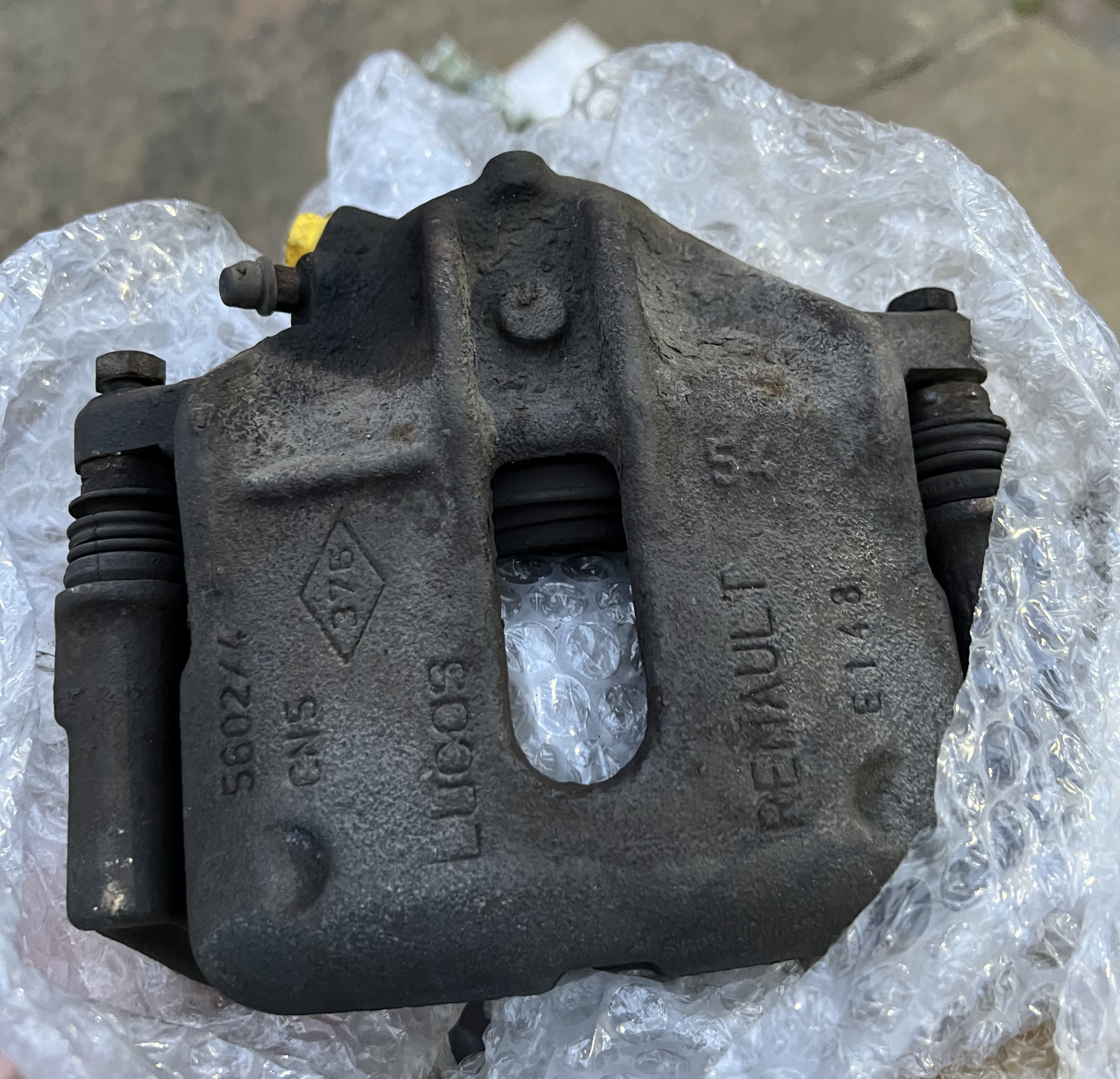

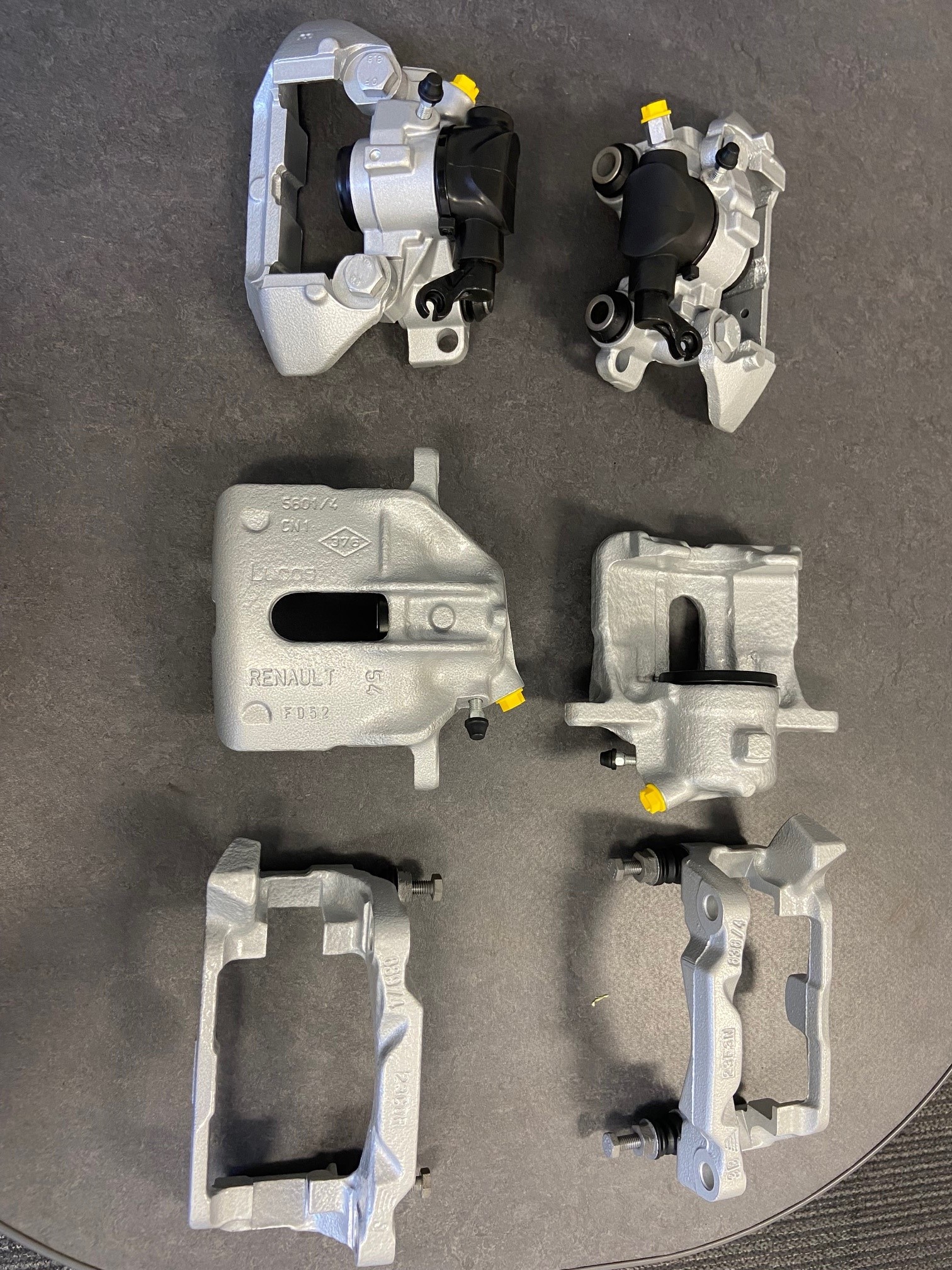

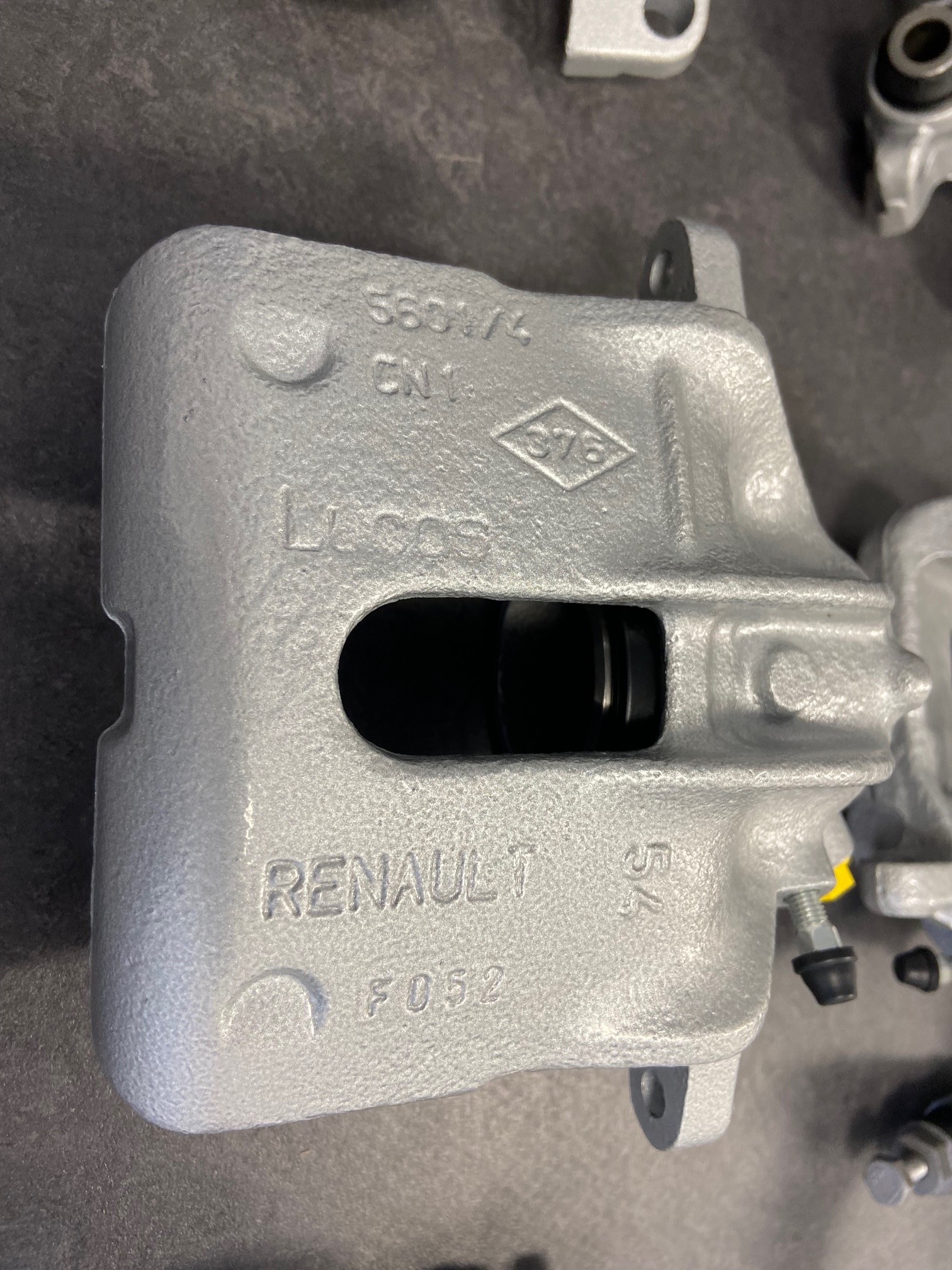

Had my refurbed brake calipers fitted, annoyed I didn't get any pictures of them before they were fitted, they look excellent, really happy with the finish and it feels good to have all new seals etc. as well as proper powder coat that should last. I went for silver just to keep the OEM look, I was briefly tempted by red, but I think red looks a bit silly on standard brakes.
Only issue with the originals was the driver's side rear caliper being a bit sticky causing the handbrake to be a bit weak, didn't notice anything when driving. Could've got away with a cheaper fix I'm sure, but I'd rather do it right, especially with brakes.

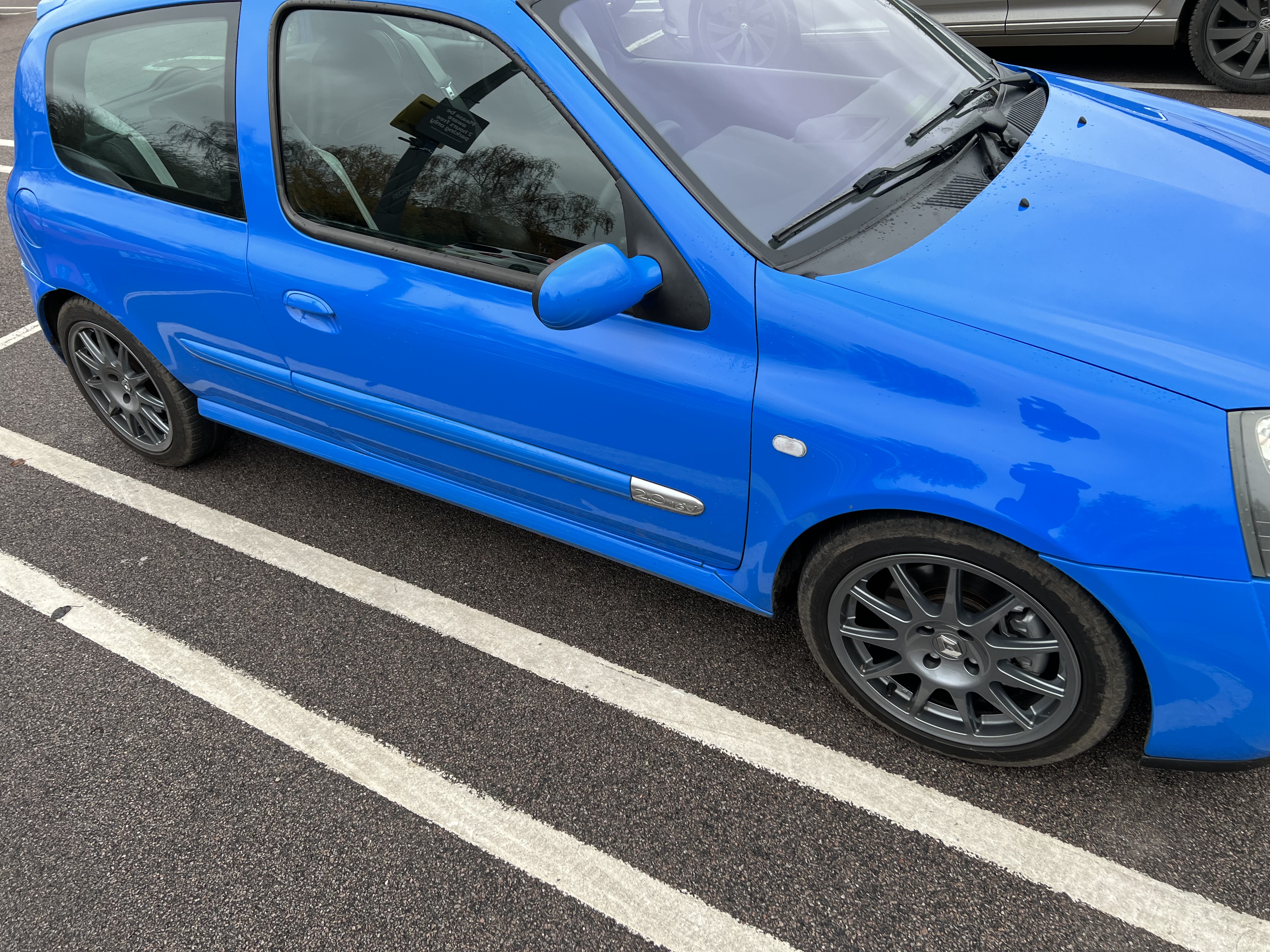

Impossible battle to keep the car even slightly clean at the moment, weather obviously crap, plus there's some ongoing building work at home, so the driveway is a mess and I'm forced to park on the grass a fair bit.
One of the old calipers, not in bad nick really, ideal for someone else to send off for a refurb.
The car a couple of days after a clean this weekend, apologies for the shitty picture.

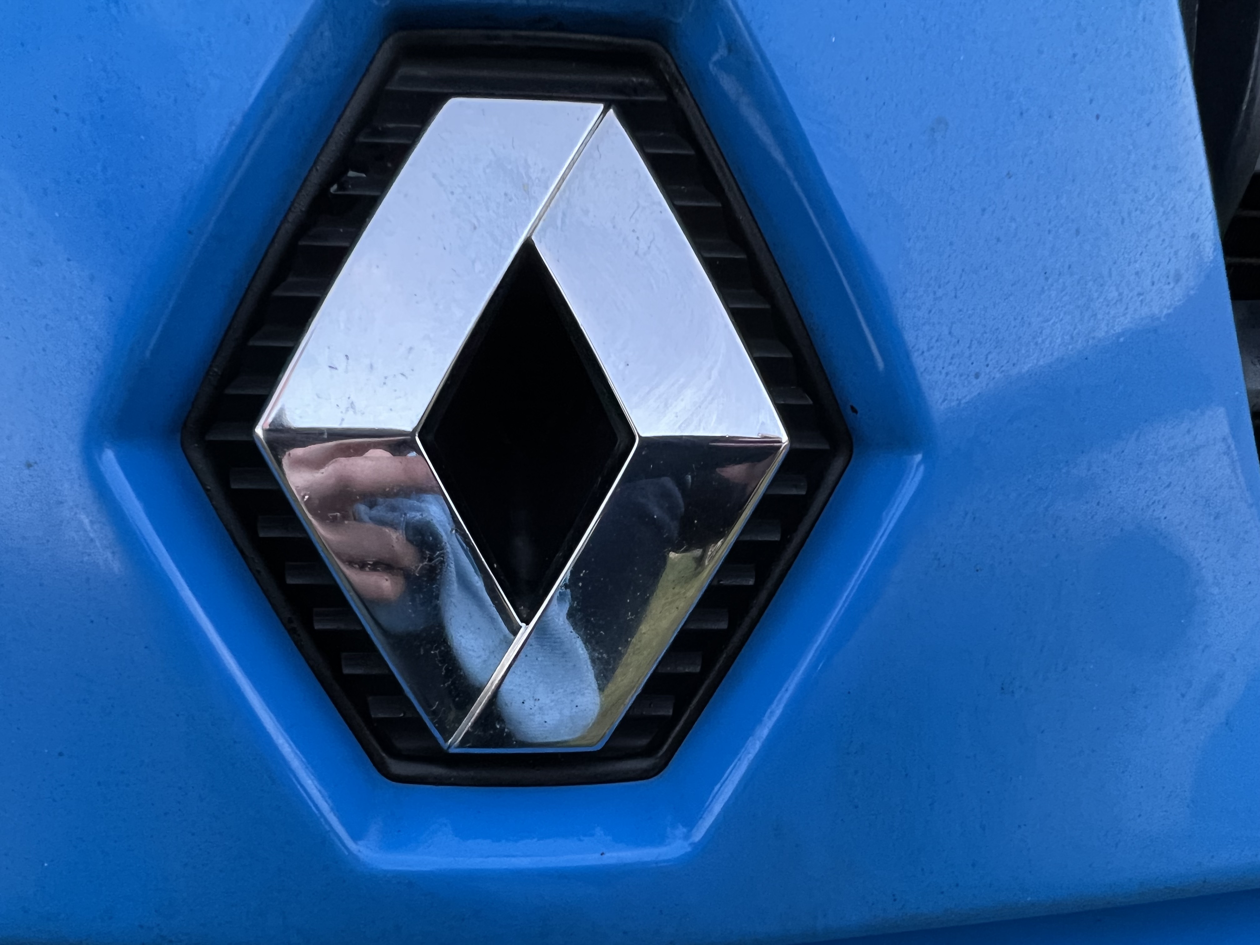

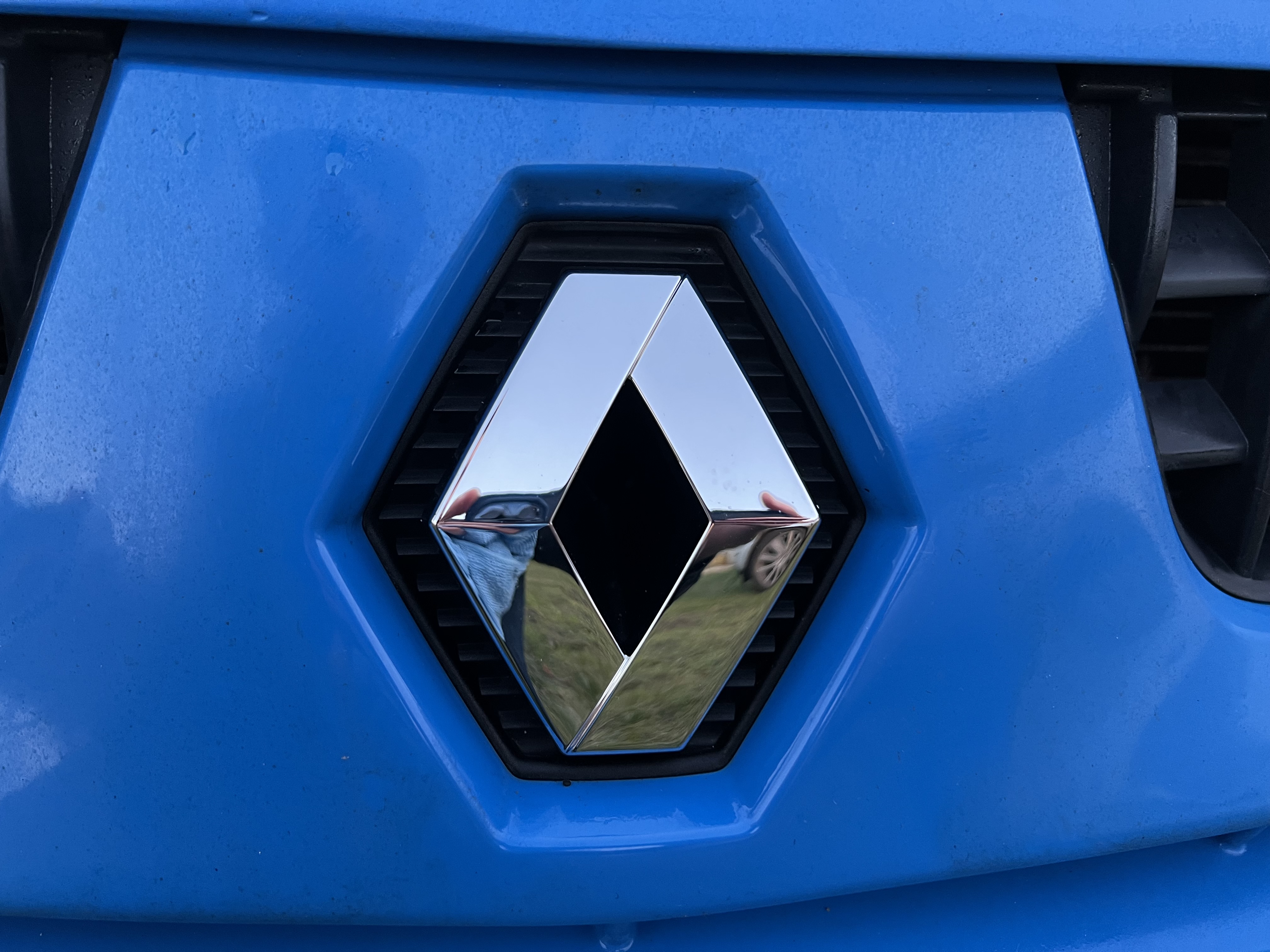

New vs old front diamond (8200027424):
Ignore the mucky car, this was a few weeks ago, old badge wasn't bad, just a bit marred and stone chipped.

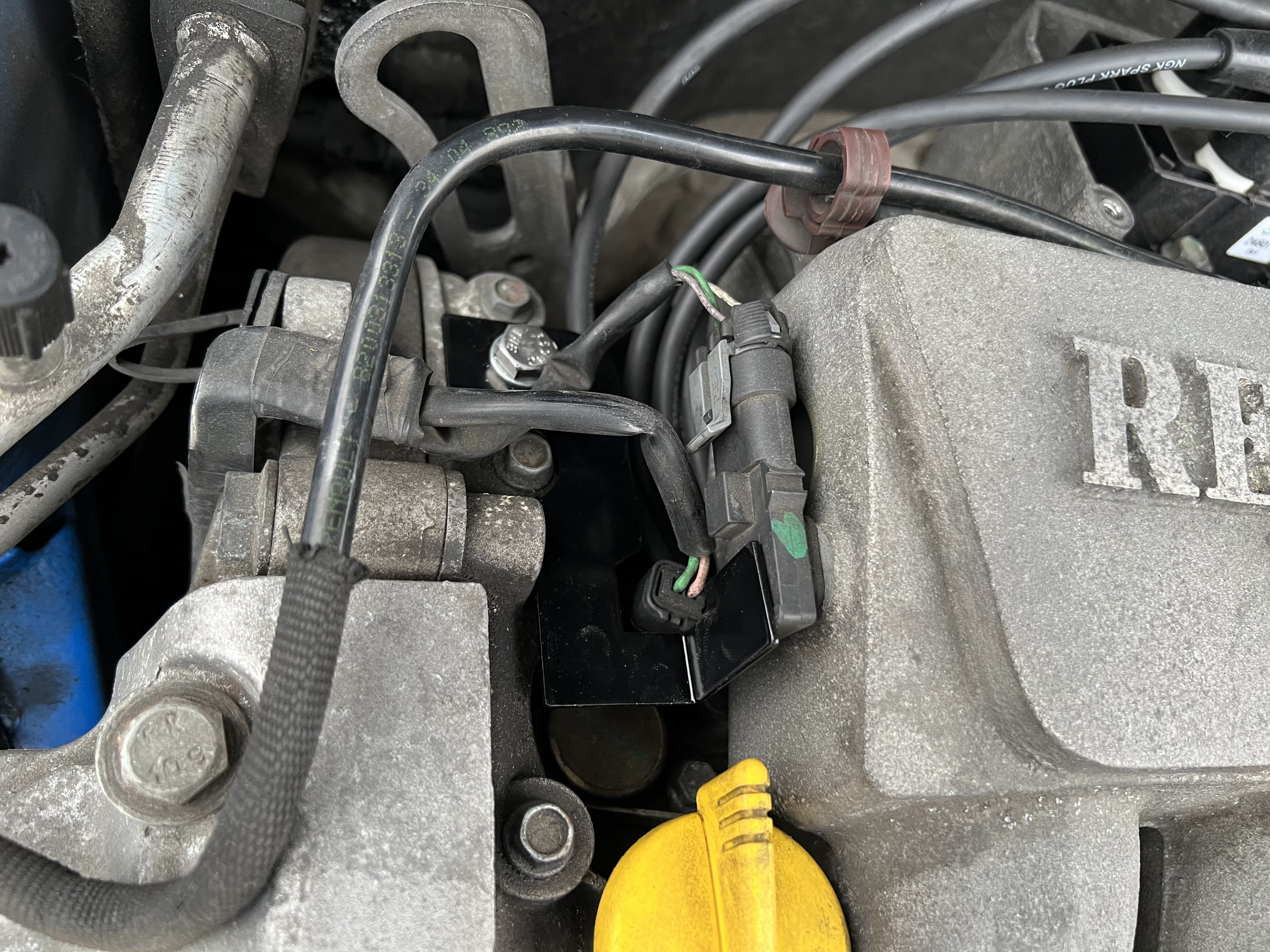

CFAB MAP sensor bracket:

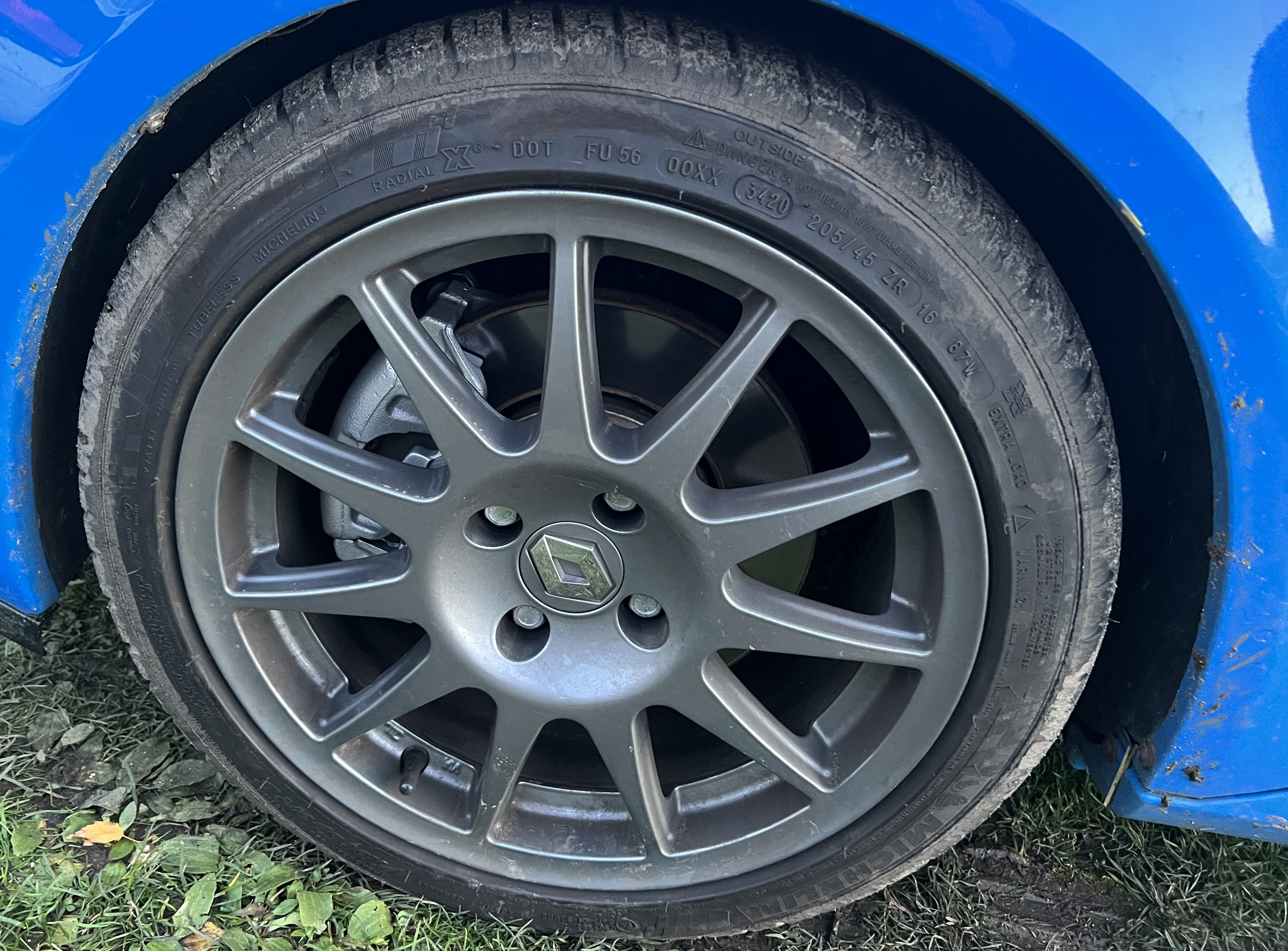

Lovely, you've convinced me to go back to Turini's on the RB.
Initially I wasn’t a massive fan when I bought the car. I didn’t hate the original wheels on my arctic, but once I had the turinis refurbed I think they look stunning. Definitely a reason everyone seems to run them on mk2s.
Would definitely suit your RB, it’s perfect. Almost doesn’t seem right when I see them on the standard wheels now.

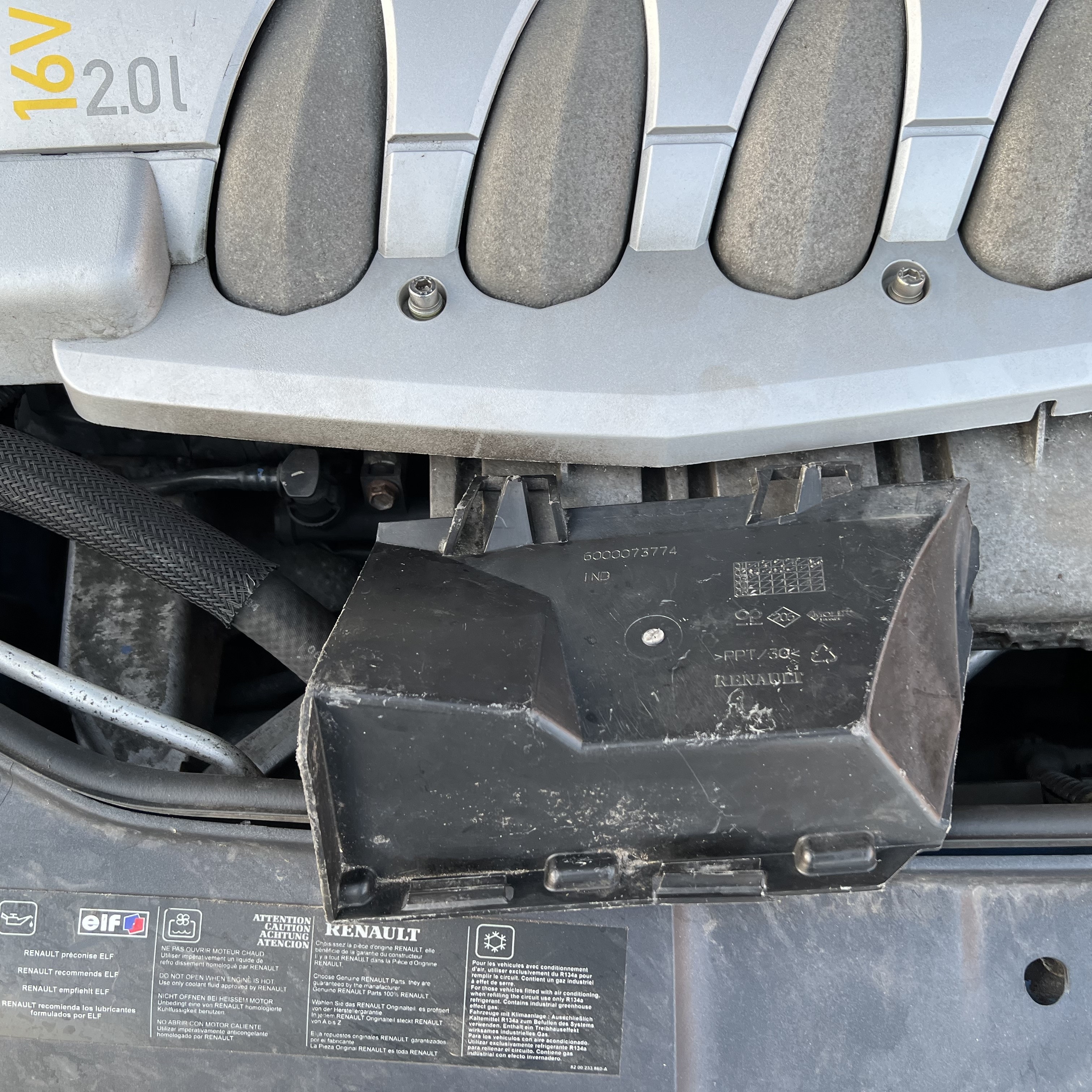

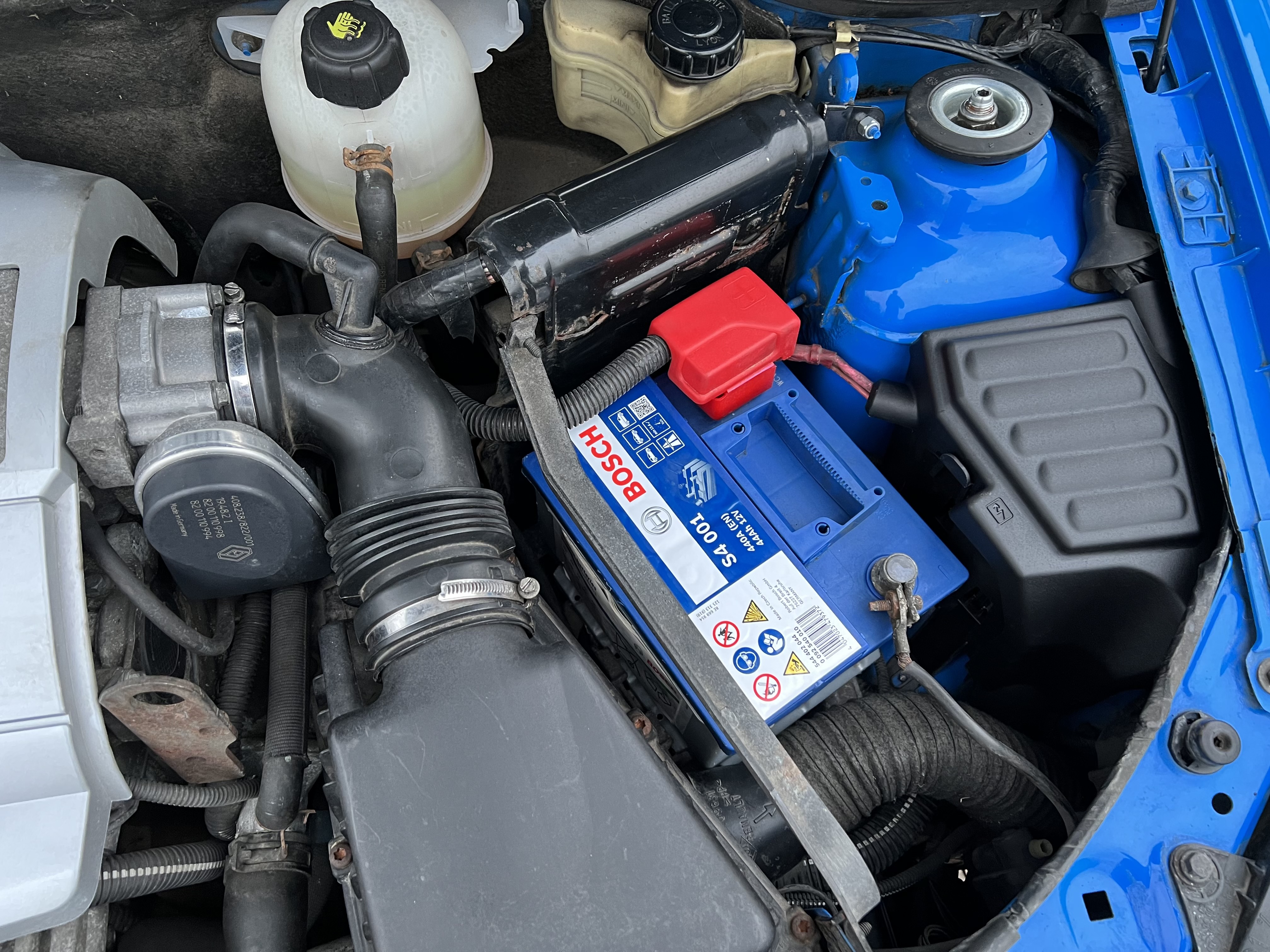

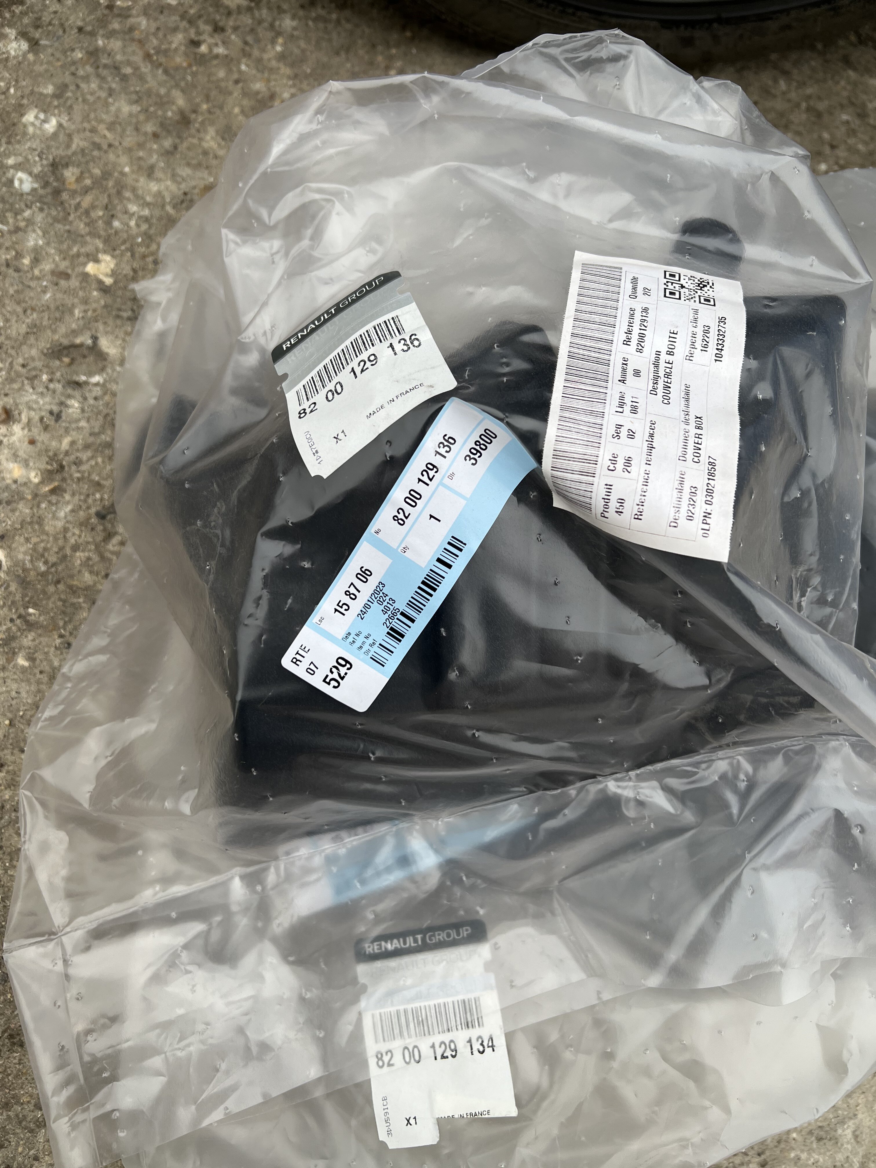

Did the first step of my little engine bay tidy up today, the broken clip on the lower fuse box cover has annoyed me greatly since I got the car. Ordered a new lower fuse box cover new from Renault and I figured it would be silly to only do the lower cover, so the top was ordered at the same time. £50 or so later and picked them both up.
Before:
Part numbers of upper and lower covers in case anyone wants to do the same:
Getting the old lower cover out was a proper pain, it's so tight in that area and you don't have a ton of cable length to play with, obviously got to be quite sympathetic with the cables too, last thing I want is an electrical fault. Had to unclip the fuse holders that were clipped into the cover, unscrew the two 10mm nuts and then unclip the cable that's on the outside of the box by the inner wing and then gently wiggle it out.
Getting it back in was similarly painful, both metaphorically and physically.
Worth it though, new covers installed:
Gave the engine bay a quick spritz of APC and a wipe down while I was there too. Nowhere near a proper clean, but just to bring some shine back. Still plenty to do under here, but got to start somewhere. The engine hoist eye needs sorting, so do the ECU brackets and airbox screws.

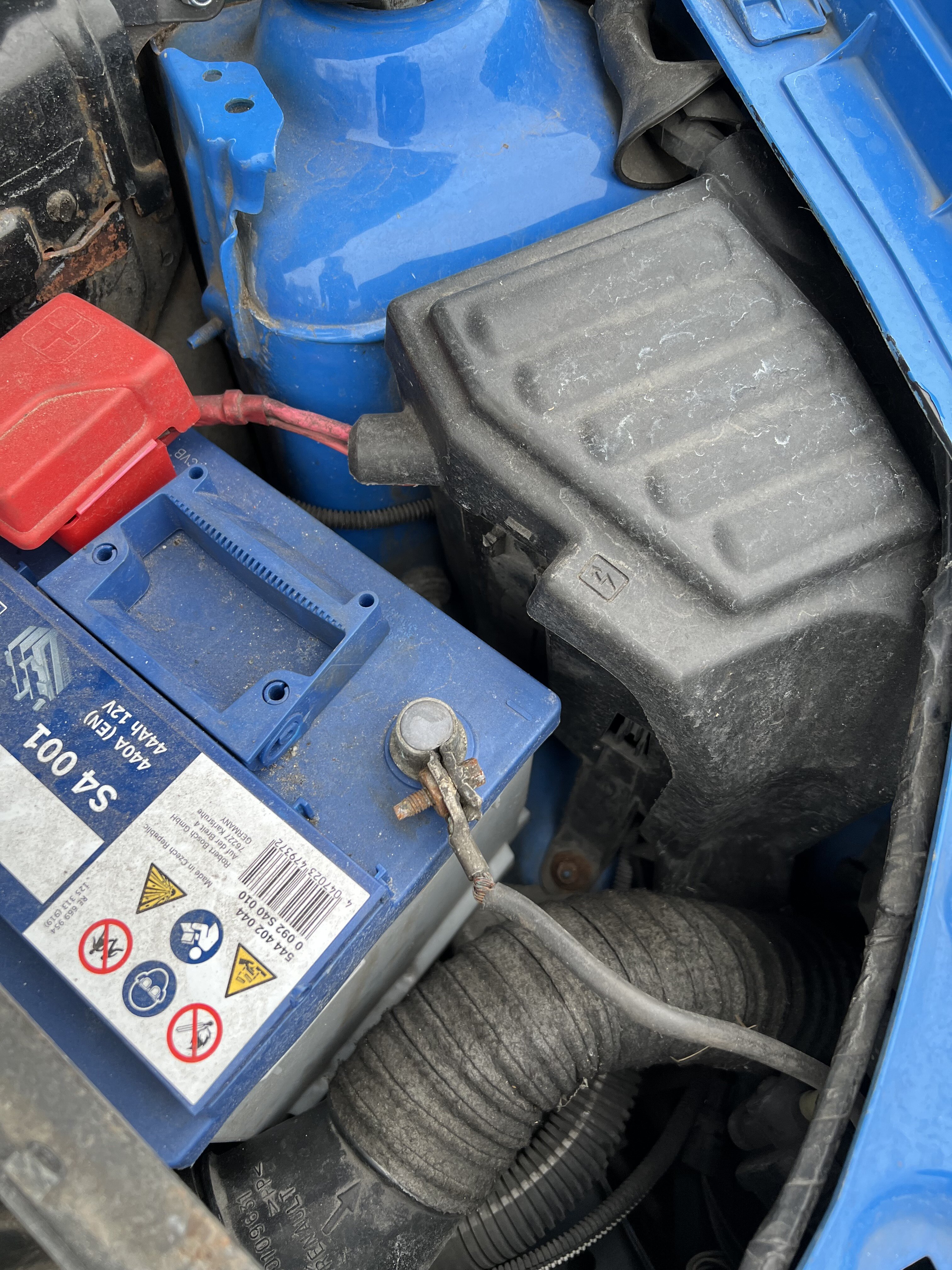

Checked the car still fired up once I got everything back in, had the battery out so had to pair my phone, set the clock etc. When I first put the key in the red immobiliser light stayed on, I feared the worst but didn't panic, gave the car a few seconds to recalibrate, tried again and the light went out and started up just fine, no lights on the dash. Success.
Going to have a crack at another tiny thing that annoys me far more than it should tomorrow, although that's already going wrong and I've done nothing more than the prep for that, so will see how I get on.
Edit: Also left the bottom 10mm off as it felt like it was rounding off while I removed it, it's properly corroded. Box is super solid with just the one in, so will leave it as is until I can get a new one.

Definitely a good investment buying new. I scoured the universe for a good second hand one for my old BG and the clip broke off putting it on 🙈 I paid £30 as well. 😭 Now whip the engine out and get into all the nooks and crannies 😂
hopgop1
Yeah I similarly had a look for a good used one, but none seemed to be in great shape and would've cost similar to new. Think the bottom cover was £26+VAT, but don't quote me on that.
No chance I'm taking the engine out :ROFLMAO: , I can barely put in a set of arch liners. Would love to do it just for the OCD factor of having everything perfect in there though.

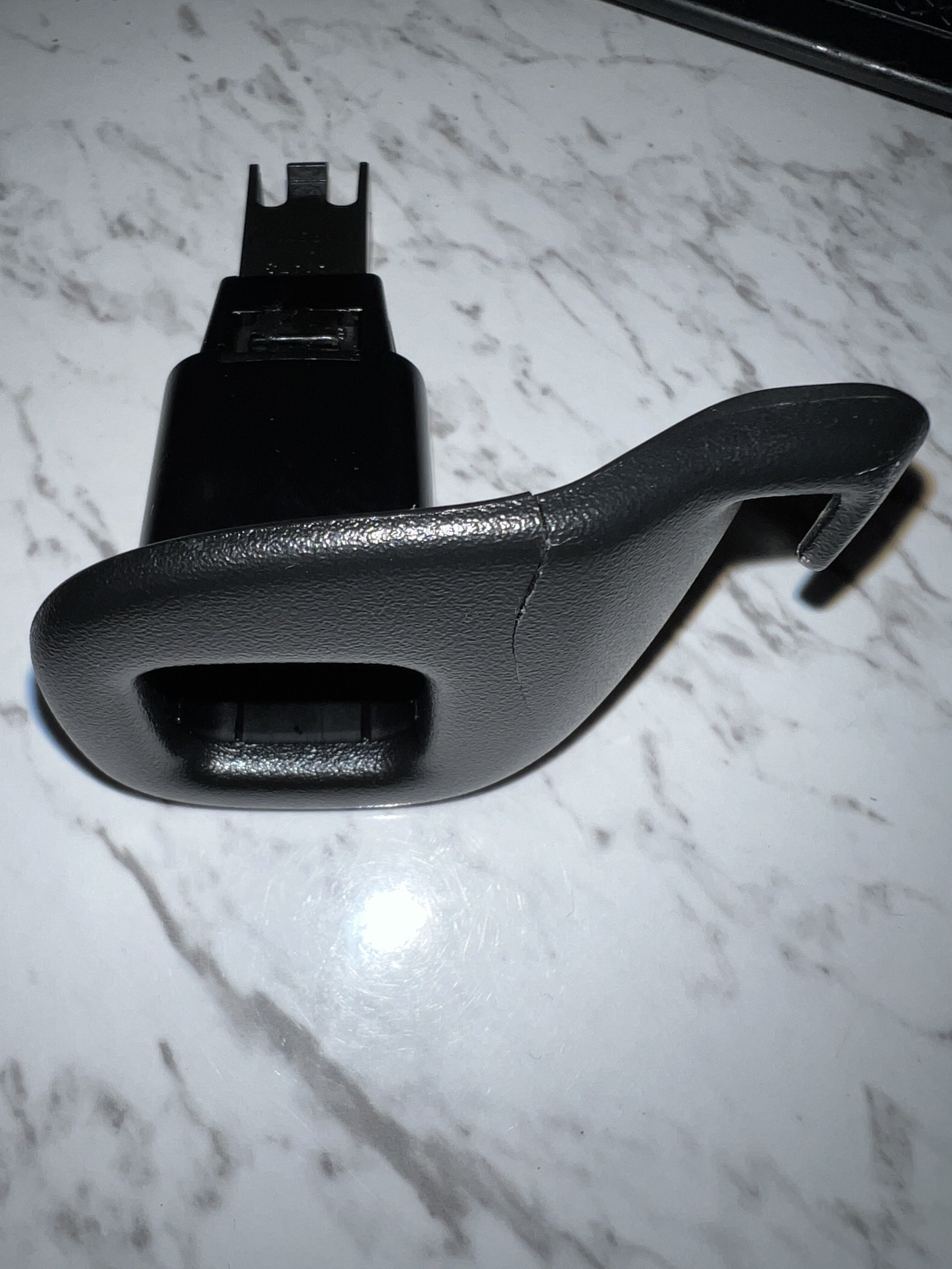

In other news, while I was in Shropshire for a week I picked up a passenger rear seat from a boggo spec Clio for £10 purely to harvest the seat release button from it. The seat smells like wet dog and I also didn't realise until I got it home that the little protrusion from it for the reat seat belt is cracked.
It's better than my current one that's completely missing, and I'm hoping that as I don't use the rear seats for much of anything it'll stay in tact for a while anyway. As much as I love the car, I cannot bring myself to pay nearly £40 for a brand new button from Renault. I just hate looking over my shoulder and seeing it broken off.
Crack visible on bog spec seat:
Removed and cleaned up, ready to be fitted:

I'm impressed with mine, the rear calipers were a bit sticky when they were first put on, but I think I probably had some uneven brake pad wear from the old ones being past their best. Cleared up after a week or so.
Plus they look excellent in silver IMO, I was half tempted to go for red, but I think the loud colours look a bit silly unless you've got big 4 pot brembos or something. Silver goes well with the silver accents on the car anyway.

I managed to find a beautiful pair of rear seat releases on one of our trade in’s - for an imbecile like me they took some getting out.
I’ll watch out for some more and drop you a Pm
Yeah please do, passenger side is what I'm after, but I'd take a pair if you find another set like that. My cracked one will mostly satisfy the itch for now, but a cheaper replacement than an £80 pair from Renault would be much appreciated.
I didn't have a clue how to get them out either, of even if you could, but found a post here that details it pretty well. Basically unzip, pull the cover off the back as much as you can then get a long screwdriver to unclip each side, while pulling out from the top if that makes any sense for anyone else wanting to do the same.

Nightmare for me - the car had been sent to the Auction’s and was on my pre-sale sheet - so of I headed to Manheim Leeds to see if they were any good - all I had was the key in my hand which I used as to saw the back cloth so I could push them out.
I also got these window surround rubbers of another trade in as mine had very slightly bubbled - drove the car back to my bodyshop in Huddersfield to get them removed and then headed back to Leeds - well worth the effort as there £150 per side.
