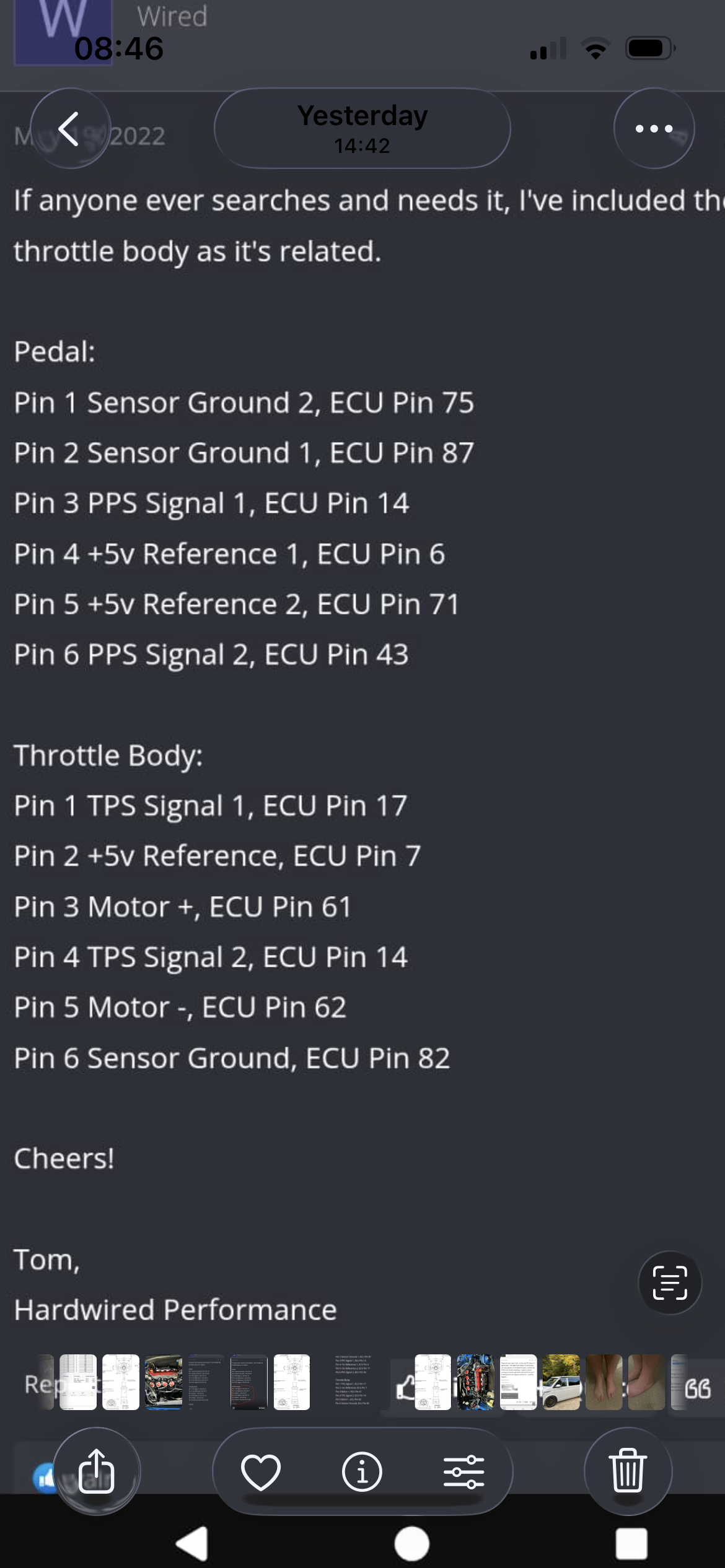

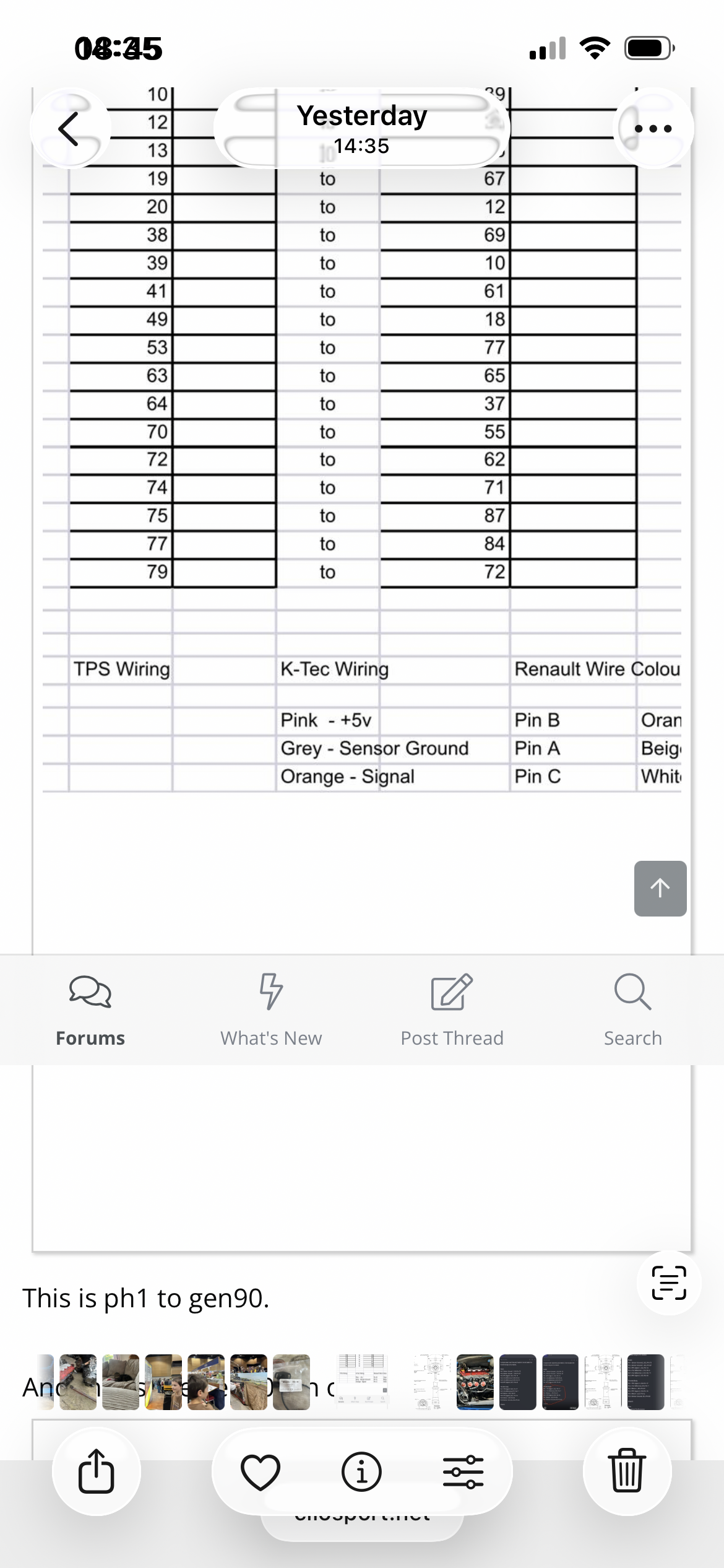

I’m using these diagrams here.
So orange in pin 1
Grey pin 6
Pink pin 5

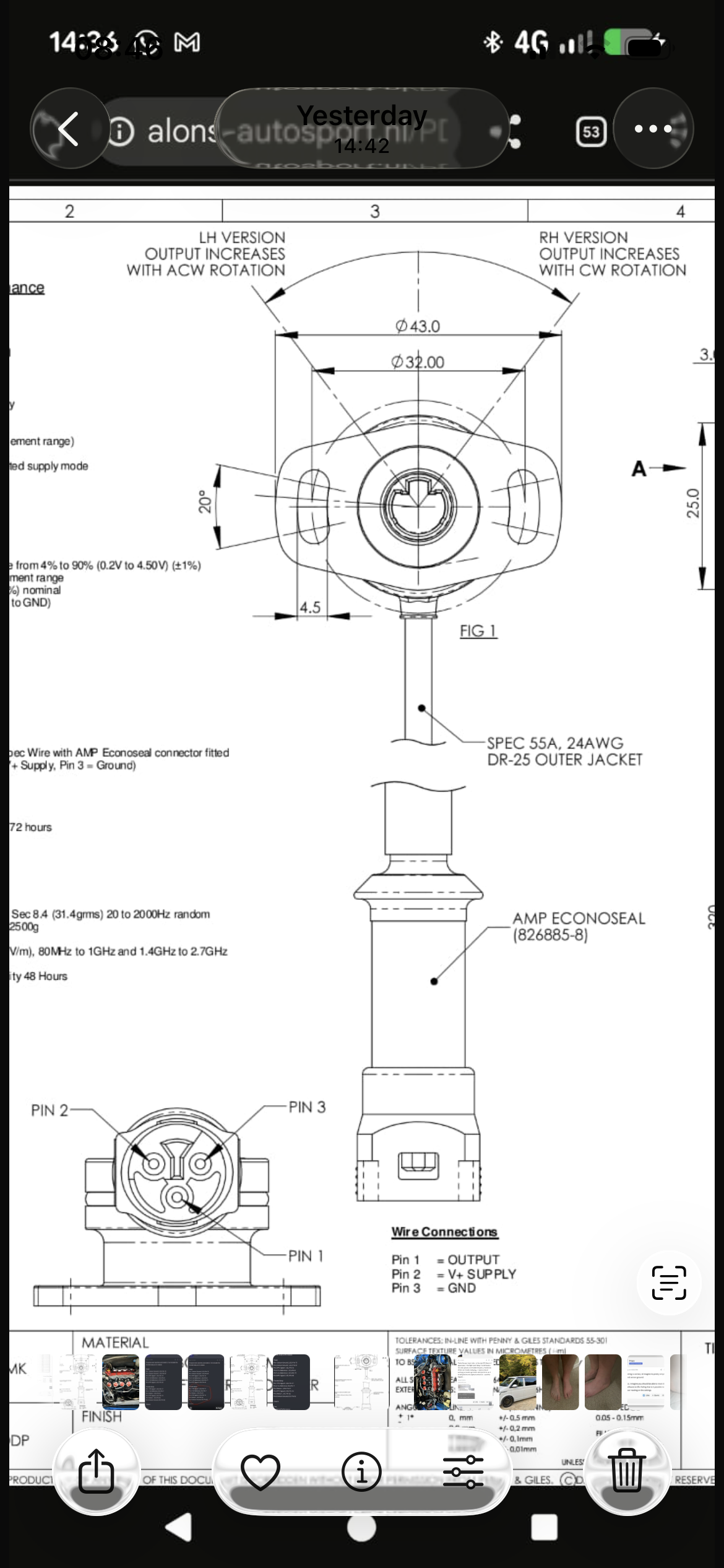

Only thing i can think of is the tps sensor with kit is supposed to be mounted on other side of bodies. Can’t test as aircon is fitted.
Ant1
Brembo! Brembo! Brembo!
Decided to bite the bullet and buy a Jenvey RH/LH TPS and lump f**king around. £250 mind so bit of a shitter.

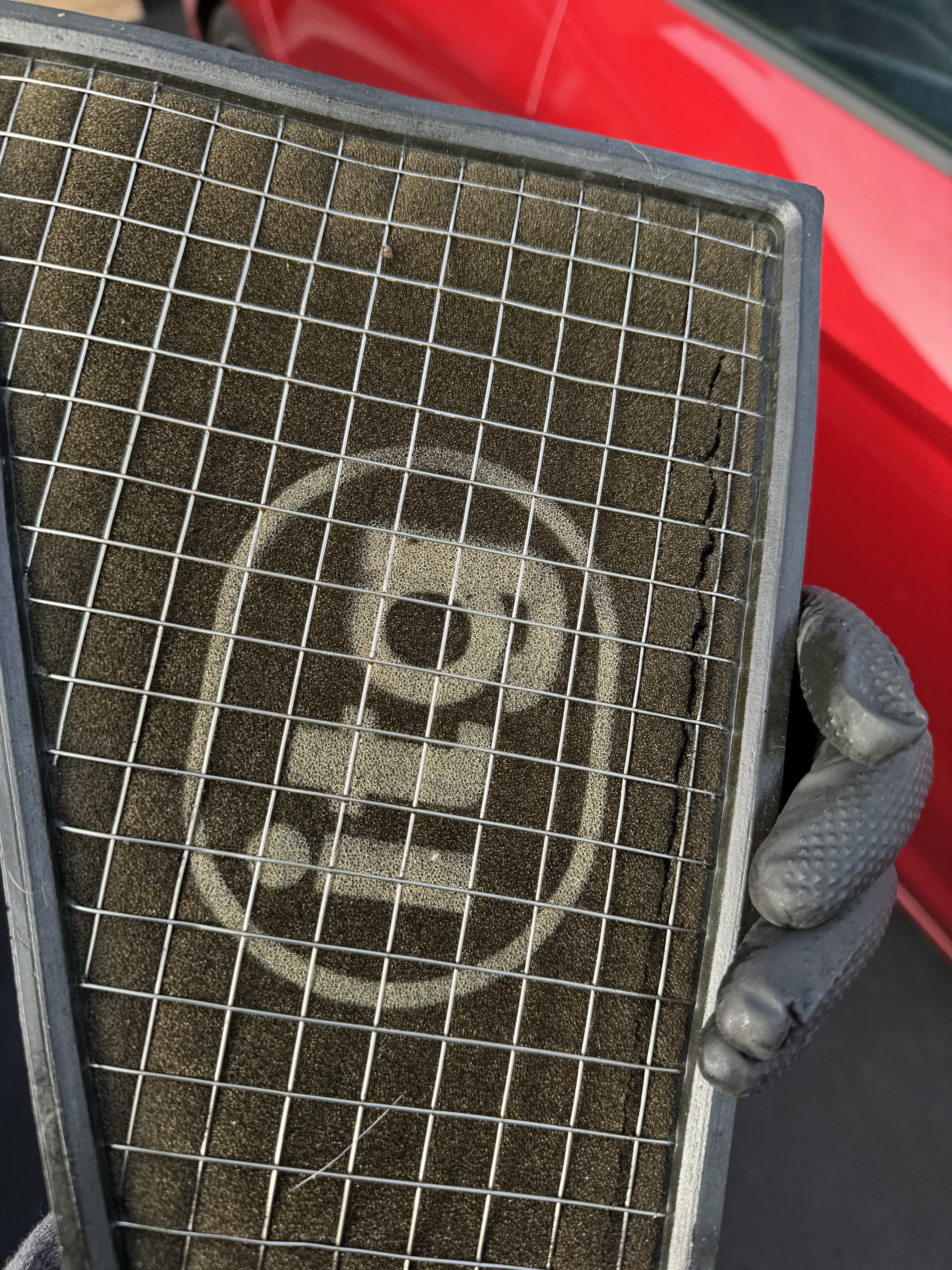

Interesting - kit was supplied new in 2019 and not fitted until now.
Any chance i could have model or link for the newer filter?
Cub.
Probably be fine, just keep an eye on the inside of the trumpets and check the state of the filter periodically.

Hopefully the new filter is much improved. Just keep an eye on it. When it breaks down, it can also result in the internal metal gauze breaking away and being ingested. I would expect things are a lot better now.

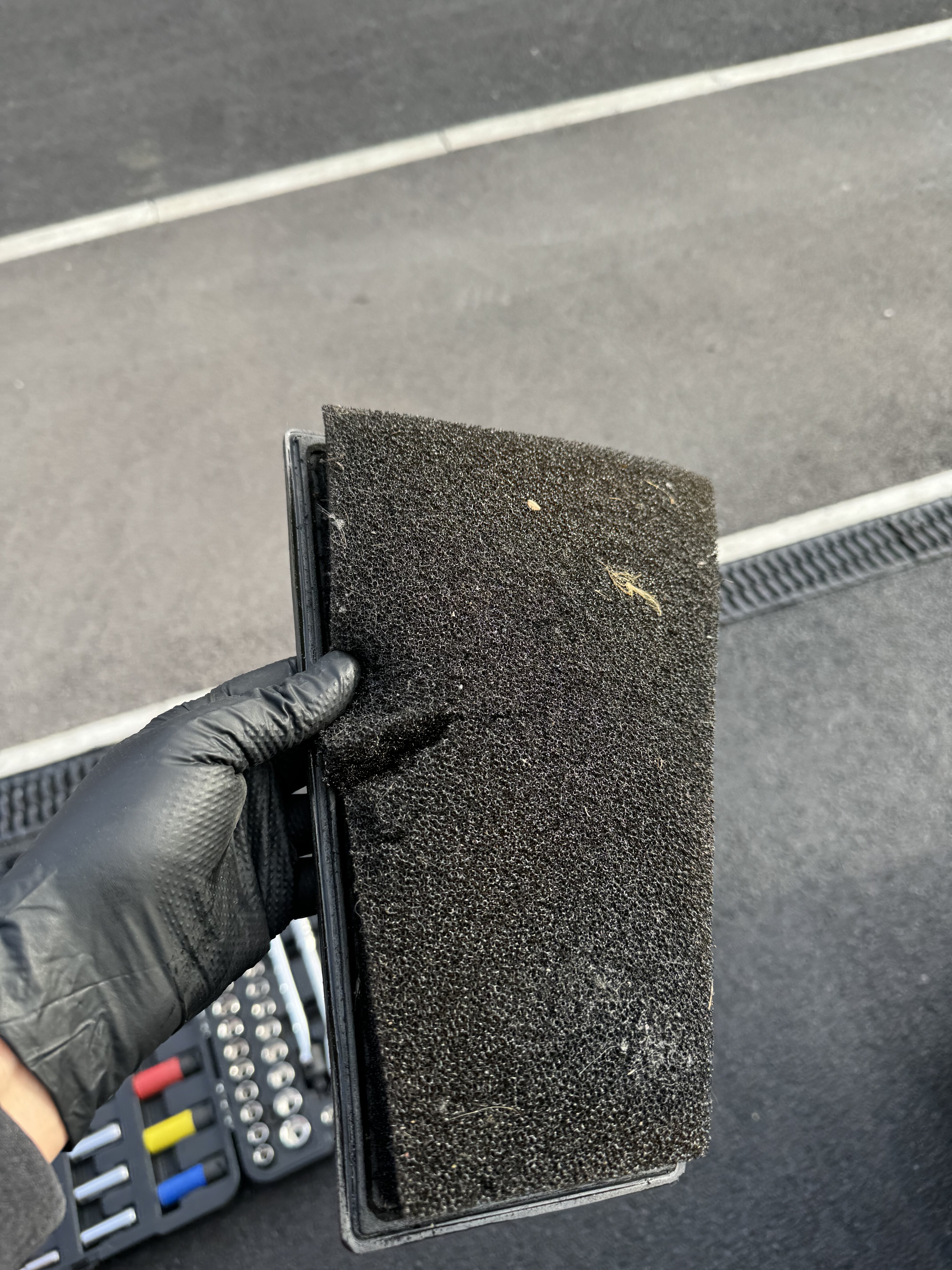

Foam type filters are pretty rubbish but I suppose you are pretty limited to what you can put on bodies. This was my ITG panel that I removed from mine, it was falling apart in my fingertips.
