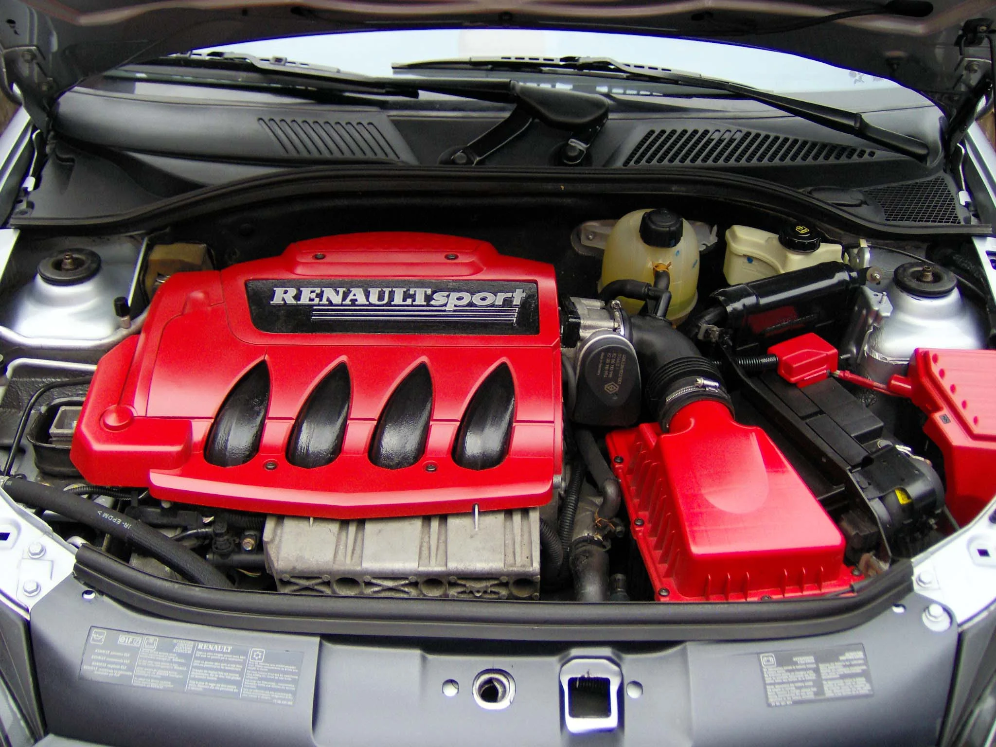

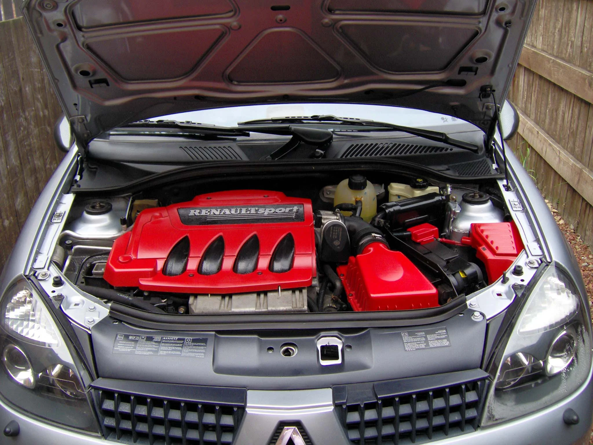

Just done mine today, only gave it a quick rub over before using a plastic primer. This covered a multitude of sins and dried quite fast.
Then gave it 2 quick coats, paint was same basic colour as primer.
Once done I used a matt spray varnish so that it didn't have a crazy shine. Did the top of the air filter and fuse box as well.
Not too shabby me thinks for nearly 85K

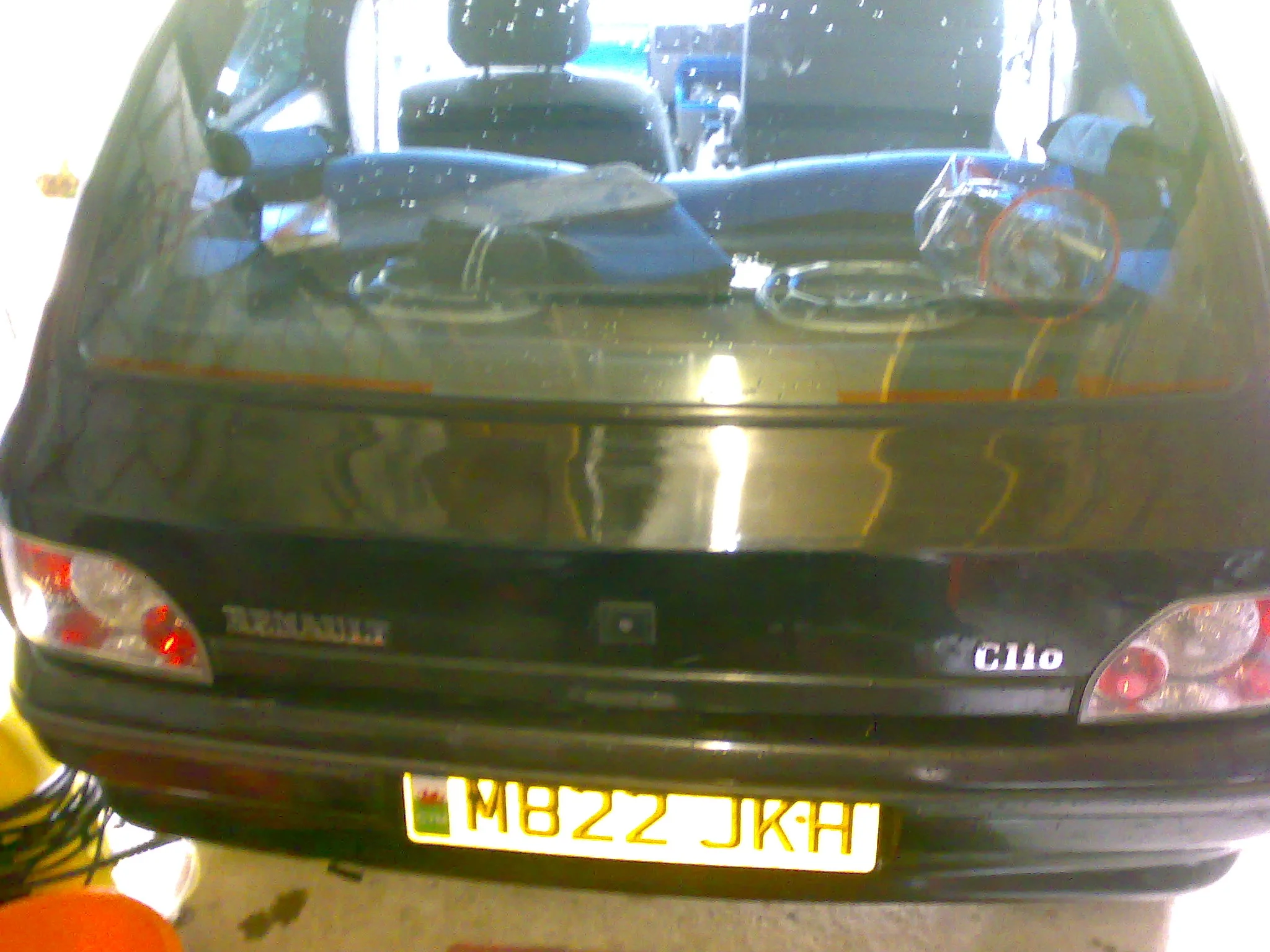

lol well he is one of them half a job kinda guys, starts something, cant be bothered and ends up rushing it, btw heres a pic of me boot now iv sprayed it and taken the wiper off, what ya rekon FMF ??
