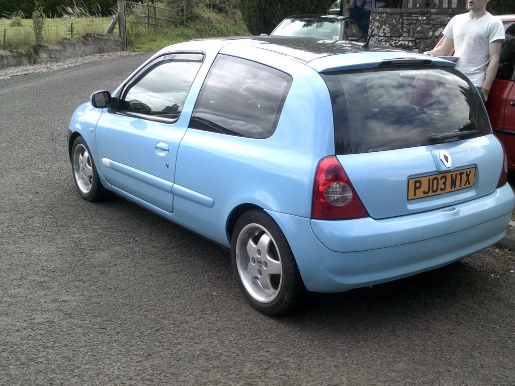

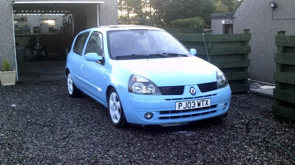

The wheels i have have just been sent away to get refurbed and sprayed but on a test fit they seem to sit roughly the same as the dynamique wheels i have on at the moment. I was thinking 25mm spacers all round or would that push them out past the bodywork and then be illegal. As i said though just want them to be as close to "flush" as possible.
Couple of pics to show what i mean better.
New Wheels
Originals on car atm
I'd say they're a bit wider than the dynamique wheels.
25mm might be a bit too much, can't really tell through pics.
Get a tape measure/ruler and see where the wheels would sit if they were 25mm wider.
I'm beginning to think that 25mm might be too much but i might just wait till i have coilovers. will have them ordered in a fort night so once their fitted im sure the measurement will be more precise.
