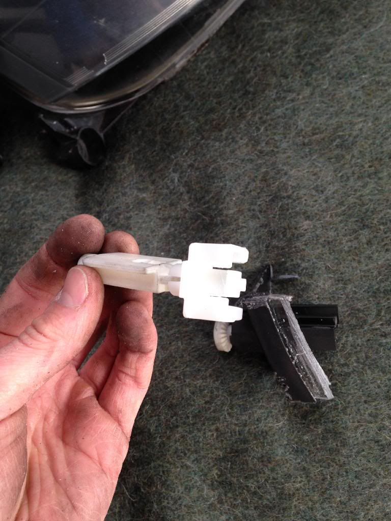

Got 1 spare headlight I can tear to pieces. Got 1 broken adjuster in the xenon.
Not sure how to take the other one apart without breaking the bits. I know the 45 degree cog on the back is pressed on to the adjuster shaft but what kind of tool to you use to take that off and put it back on.
Cheers

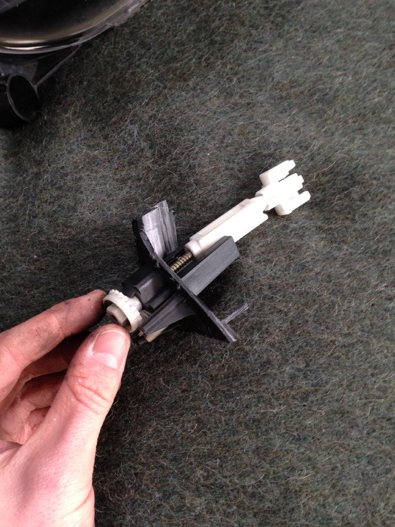

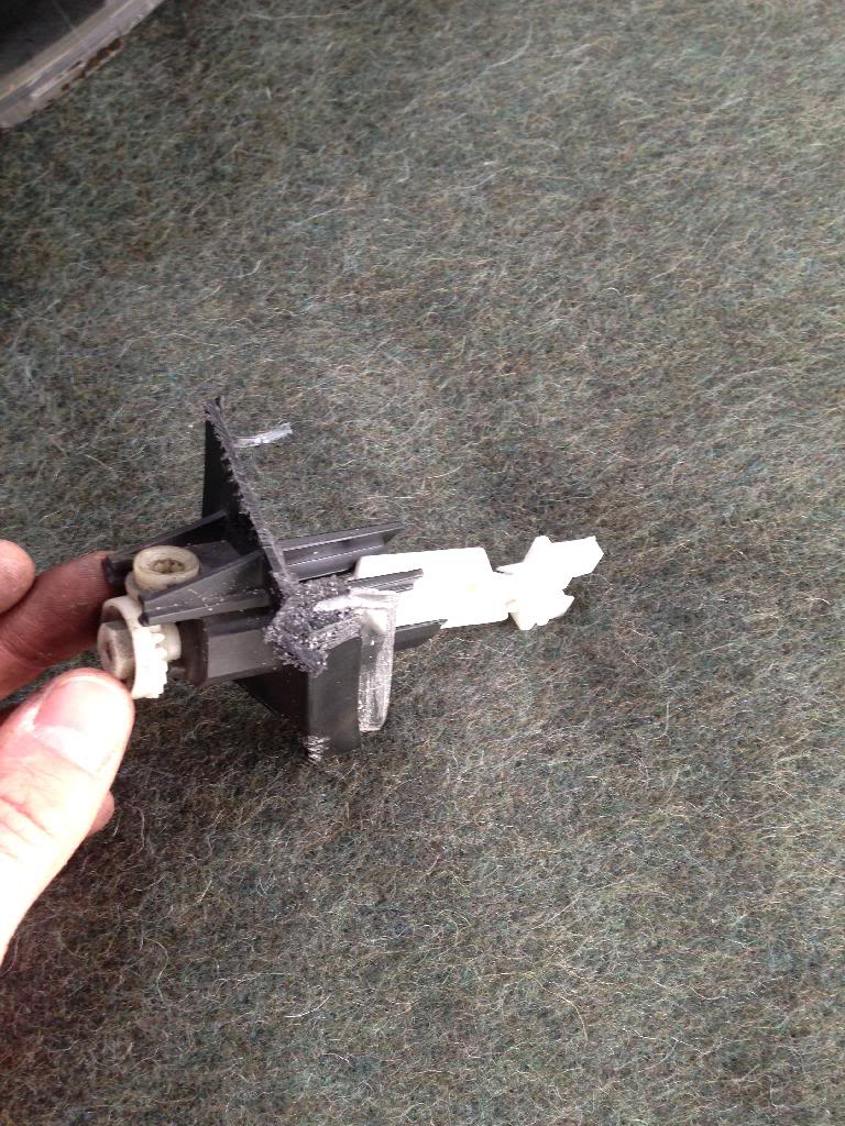

Just to tie this up. After a dream about a schematic diagram of the headlight I managed to sort it out today. I cut a square around the adjuster on the old headlight and got the clip off.
You can then remove the slider part and with little fingers and some fiddling get it placed in the groves. Screw it in using the adjuster and then once it's in far enough pop it back onto ball cup on the reflector
