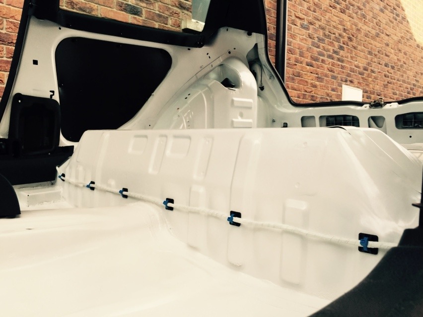

MarkX Car M4cp/CooperS/172cup May 25, 2016 #2 I used 4 cans of white high build primer and 6 cans of white in mine iirc My roof isn't done though

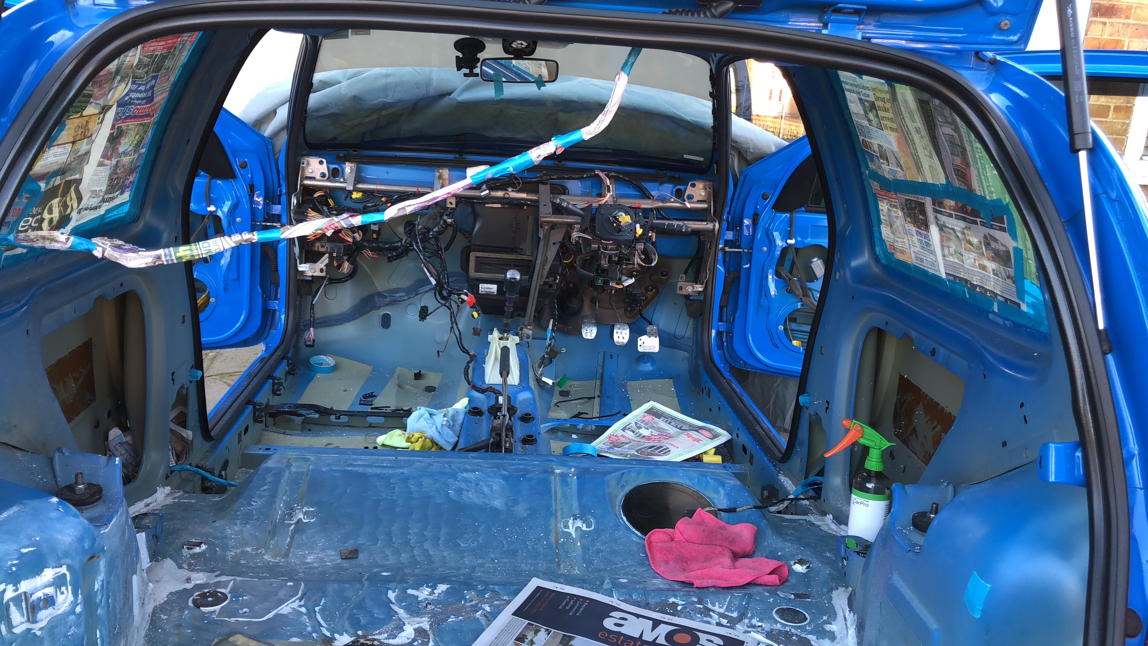

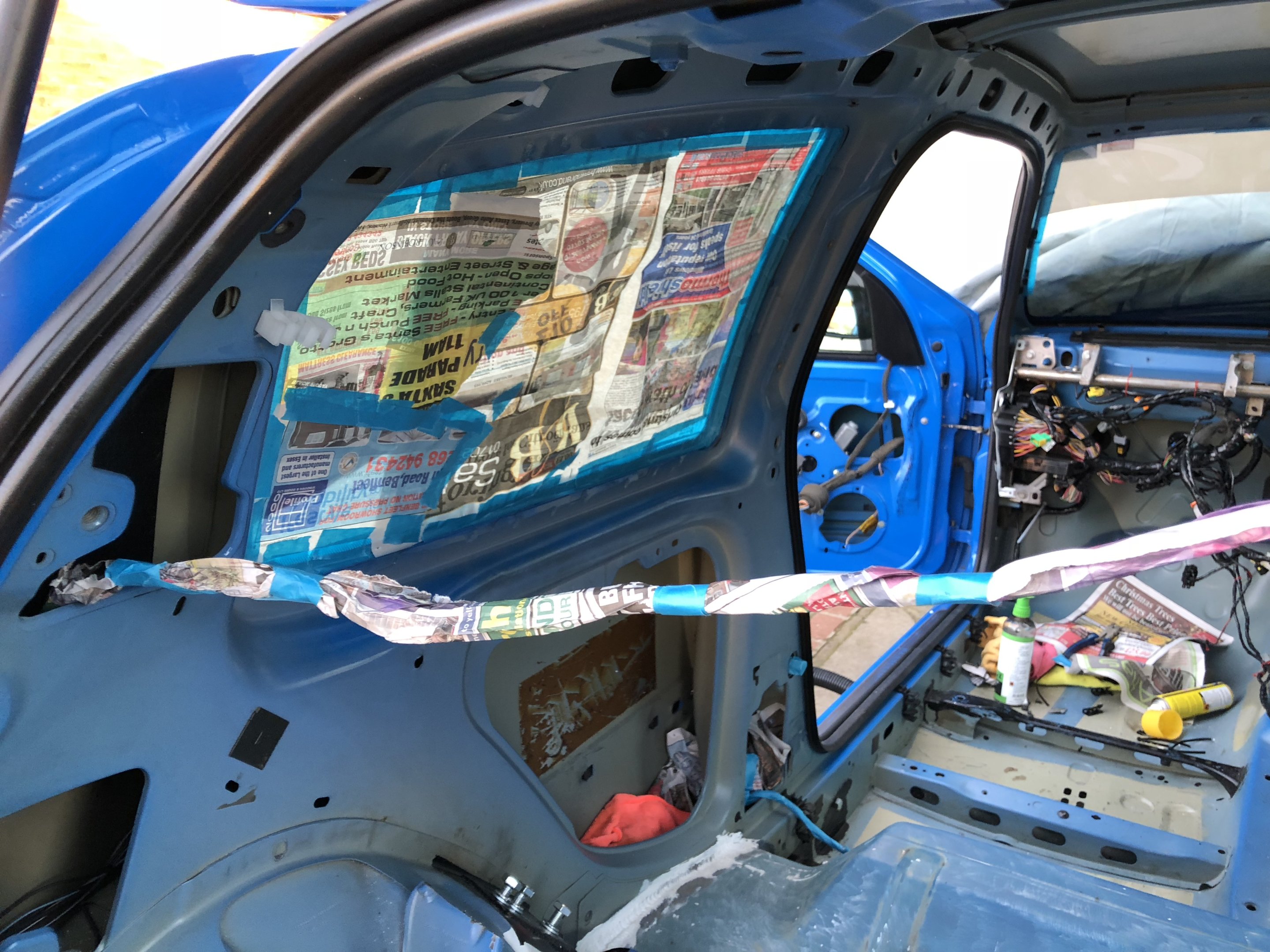

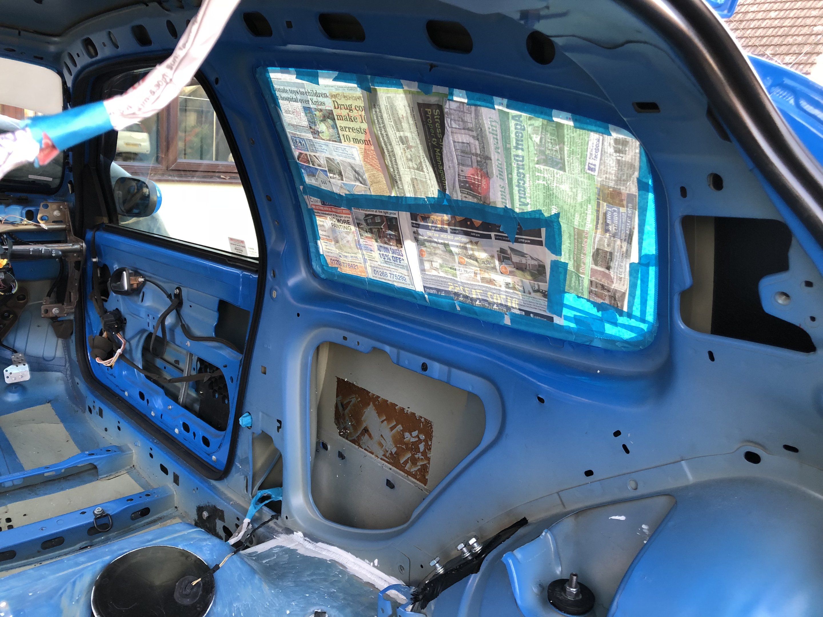

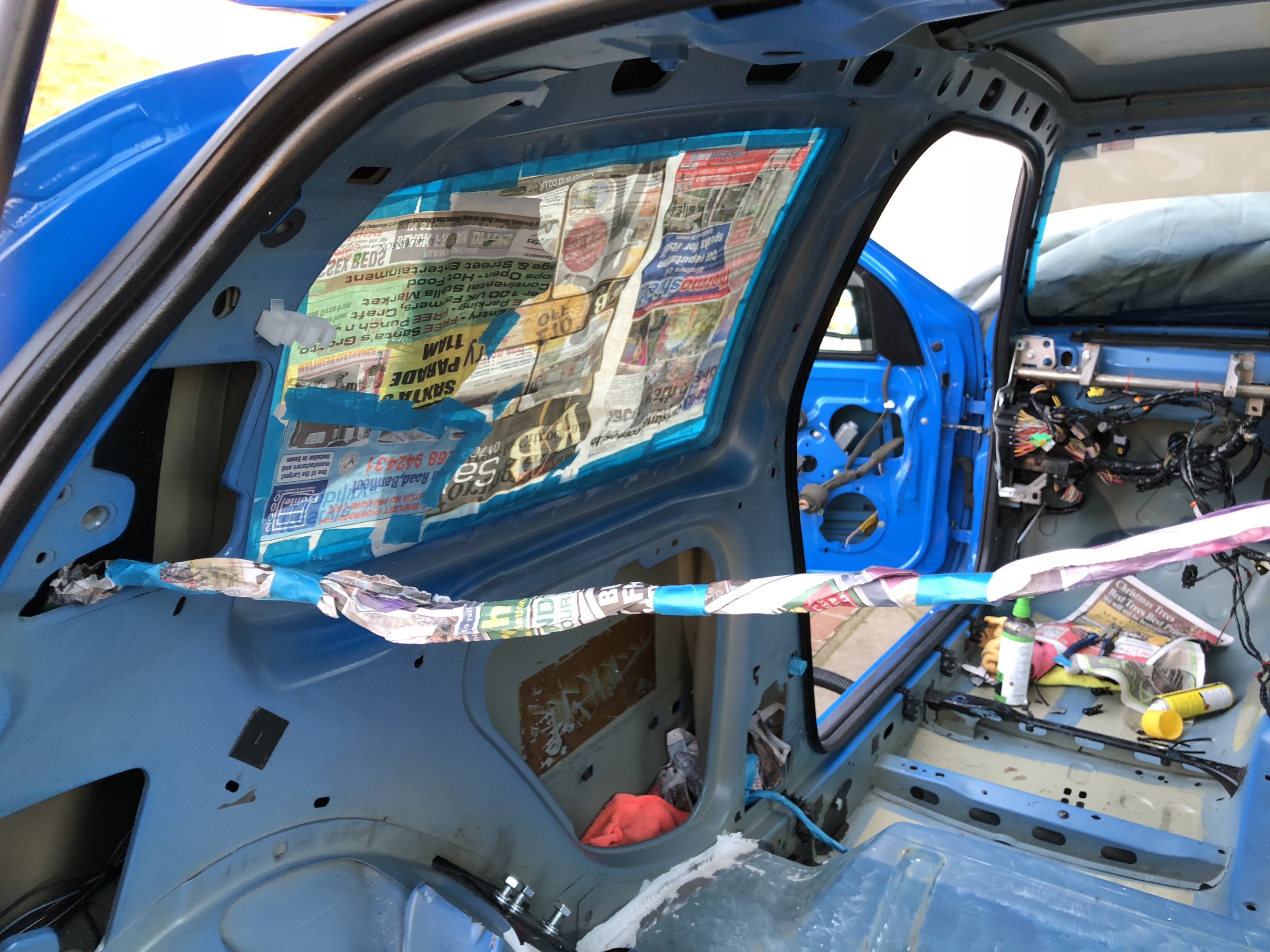

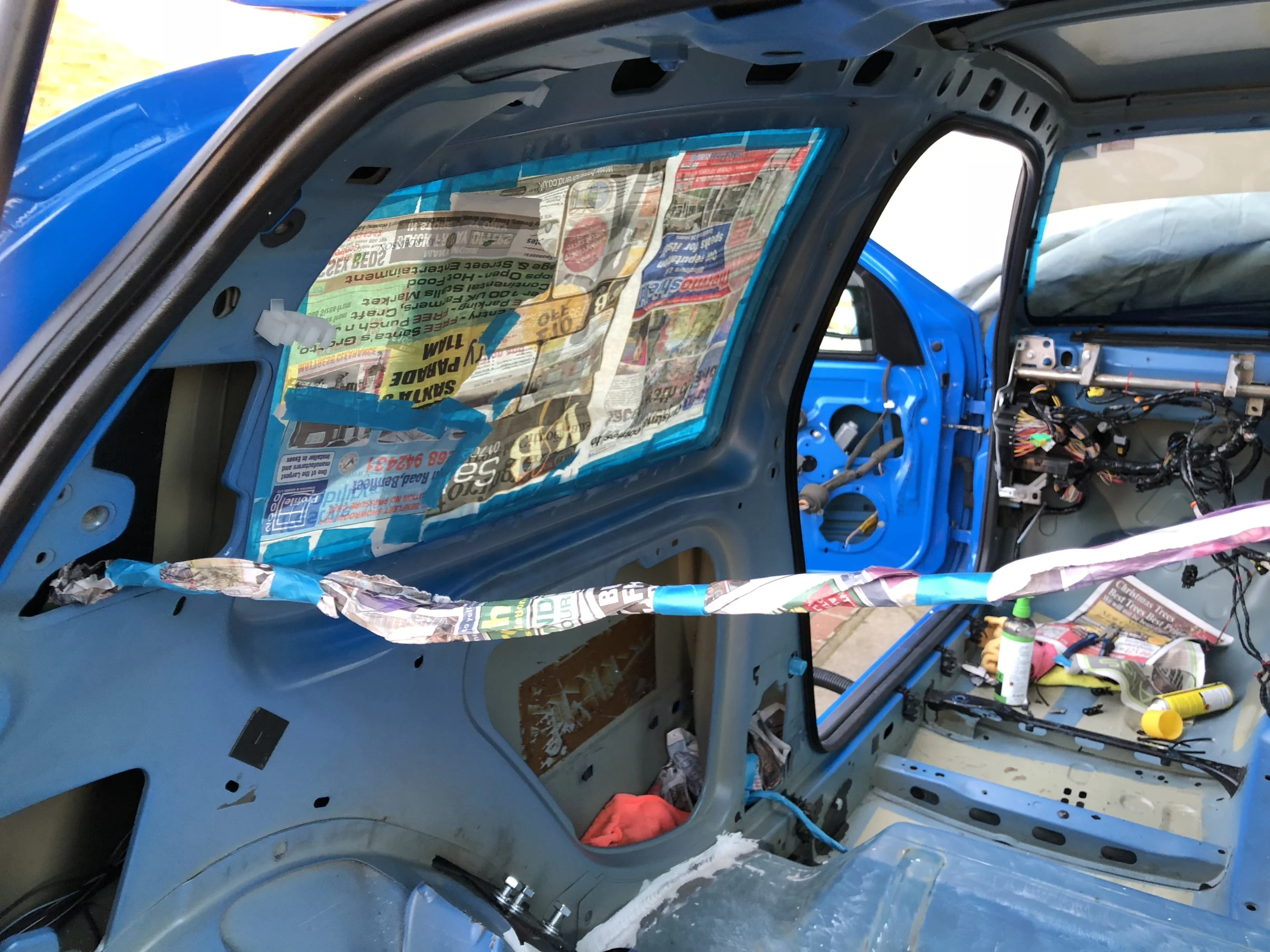

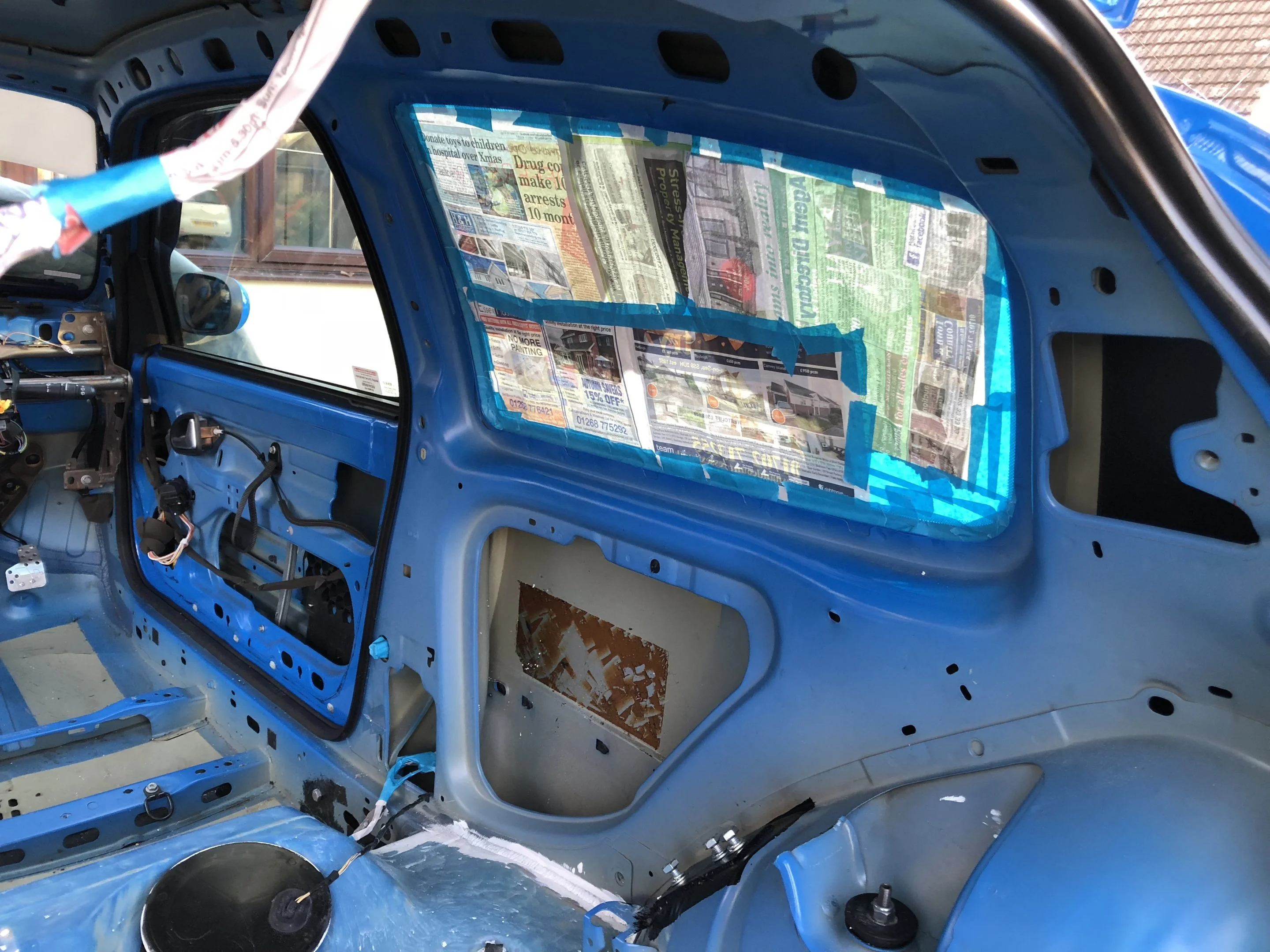

I Inequality Street Car Golf 7.5R & Clio 200 Dec 2, 2017 #4 MarkX said: I used 4 cans of white high build primer and 6 cans of white in mine iirc My roof isn't done though View attachment 1279565 Click to expand... Big bump! I’m prepping to spray my interior now. Do you have any pics of it all masked up? Did you remove the seals to the boot/doors? Did you spray the doors/boot? Attachments A8A240A6-7ED8-4904-8A34-893DEF431EEF.jpeg 853.3 KB · Views: 152 691E59A9-A57A-45FD-9C4F-036B64969DEE.jpeg 849.4 KB · Views: 146
