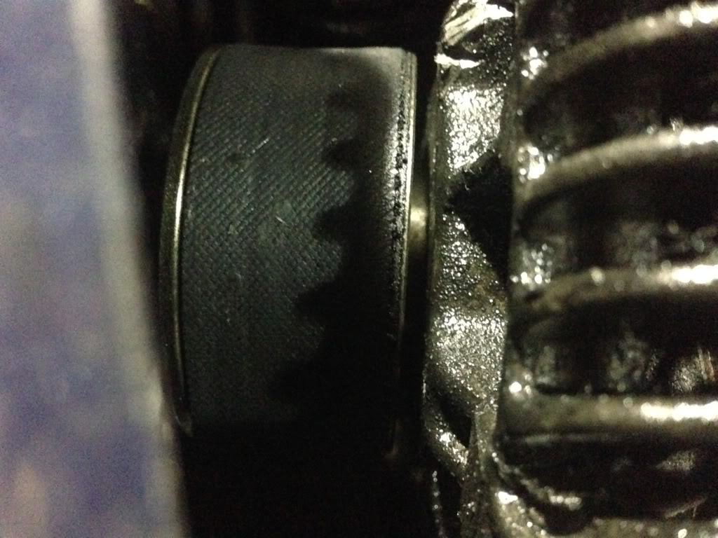

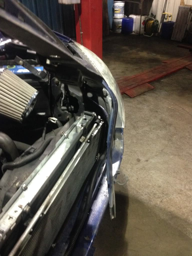

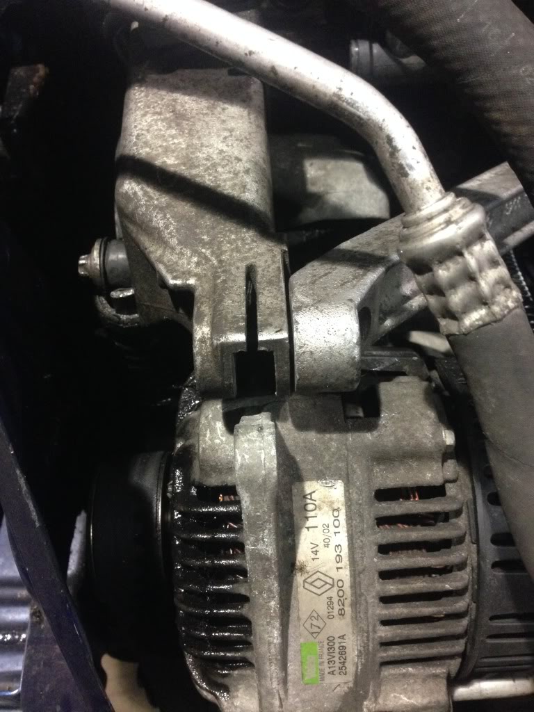

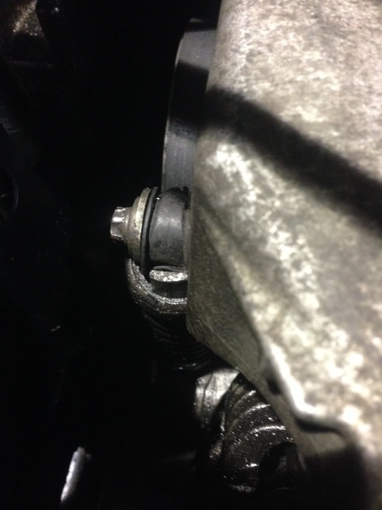

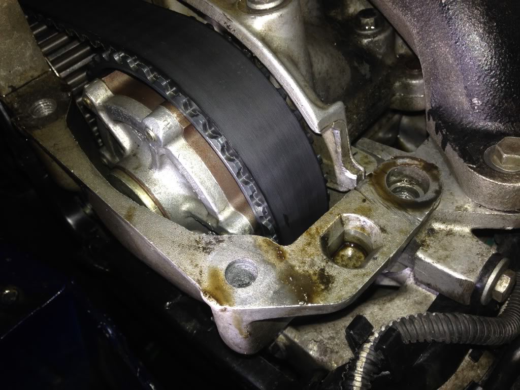

Right, little update with this. I had it in yesterday to replace the aux kit and faulty alternator
I have ZERO doubt in my mind the timing is out. I found so much stuff bodged, broken or just missing on small simple stuff that if they can't do that, then what chances do they have of doing the timing correctly?
Pics of some stuff:
Bent slam panel
Bolt missing from the alternator
Tensioner broken
Belt starting to wear/fray
Stripped threads in the cambelt cover/oil leak from the camshaft oil seals (can also see vague marks from previous belt change)
Having driven it, rear shocks knackered, terrible tyres causing other issues.
