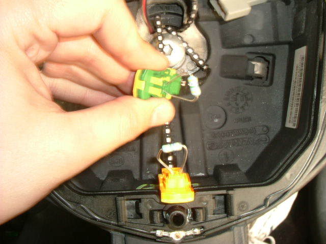

Anyway I though I would see if the airbag light remains off before I go any further. First thing I've noticed is that I have two connectors unlike all the pics I've seen.
Placed my 4.7ohms resistors as shown above, but no joy as the airbag light comes on.
HELP - Someone must know how to do this!

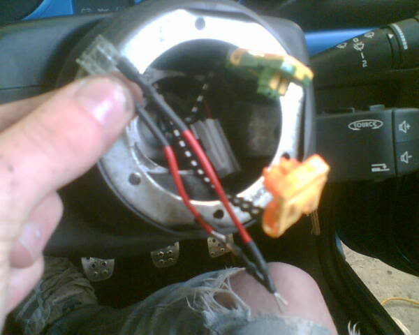

One is for the horn, airbag and cruise control if fitted ??
So just follow the wiring and see what goes to what?
Gaz_
  Extreme mode
that looks right, thats how i did mine :S
Yours has the same connectors as mine.
Maybe if you have a digital muliti meter, set it to ohms and see what each connector off the airbag reads......... then get resistors to suit. Maybe the 182 has diffrent values to a 172, but cant see it?

I used 3.3ohms, thats what i was advised. When you put them in fold the wire back and twist it back around itself, gives it a better 'contact' in the plug. I didn't do that initially and the light came on, went back and refitted it and its now off.
Perhaps the dumb sh1t at maplins gave me the wrong resistors?
Don't own a digital multi meter - are they expensive?
Did a google search on resistors and found a usefull site that explained everything I needed to know and confirmed that the resistors purchased from Maplins Croydon were not 4.7ohms but 470,000 ohms!
Popped back today and got the correct ones which were a lot smaller in size!
And the good news is that they worked first time, no warning lights on my dash!
