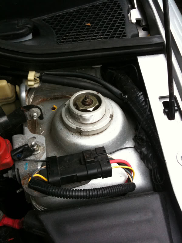

Do you have to undo the top large nut, then undo the "body" with a cspanner?
Also, what can I expect to find underneath? Anyone got a pic not fitted?
Pic:
I presume, its undo the centre nut - drop the strut out, C spaner to remove the collar and remove from underneath.

Dave, does that central nut not have to come off first? the big bugger? Because I couldn't even move the outer "ring" with a c spanner whilst it was on there.

Outer ring should come off without undoing the inner nut. Best way to loosen them is to get a flathead screwdriver into one of the grooves and then hit it anti clockwise with a hammer.
Id say remove the big outer nut too. Then the whole strut should just pull through from underneath.
C spanners are crap, get some large grips or turn them with a screwdriver and hammer as said.

dont touch the nut until the strut is out. JUST remove the outer lock ring with either a C-spanner or a drift and hammer if necessary

Ben - Thanks a lot for the pic, brilliant.

the nut being on is holding the spring in compression. If you remove it, the spring will go ping and extend to full length. Makes less difference on coilovers, but still shouldn't do it.

One last thing, what stops the bottom of the mount from spinning when I try to undo the top?
leave the car on the ground and the weight will hold it still. Prob want to loosen the center nut a turn at the same time too, just dont remove it yet
The central nut holds the top mount onto the strut and keeps the spring in place. It is NOTHING to do with removing the strut from the car. This is the big lock ring round the outside that you need the C spanner for. Some people thought it wise to use locktite on the threads so this may be the problem

The only thing that was getting me, was that it looked like that lock ring wouldn't come out without removing that nut, but if you say it does, then fair play :)
