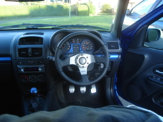

His guy's well my airbag has deployed and i have taken it out i was told by. Brian R that I may need the whole clock spring capsule and that is going to cost me a good bit of £££. On top of the secend hand airbag and having to get the serv/airbag light reset. So how easy is it to go from this.
To somthing like this

All so if im going to use a aftermarket steering wheel do i need a new airbag module ?

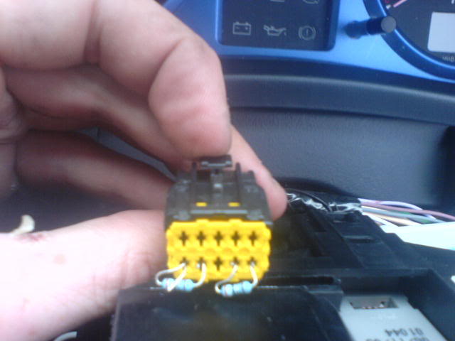

And in the pic i cant seem to find the wright plug to fit the resister's in i dont sem to have this plug
Ill have to take some pic's and see if you guy's can tell me the right one to fit the resister's to
