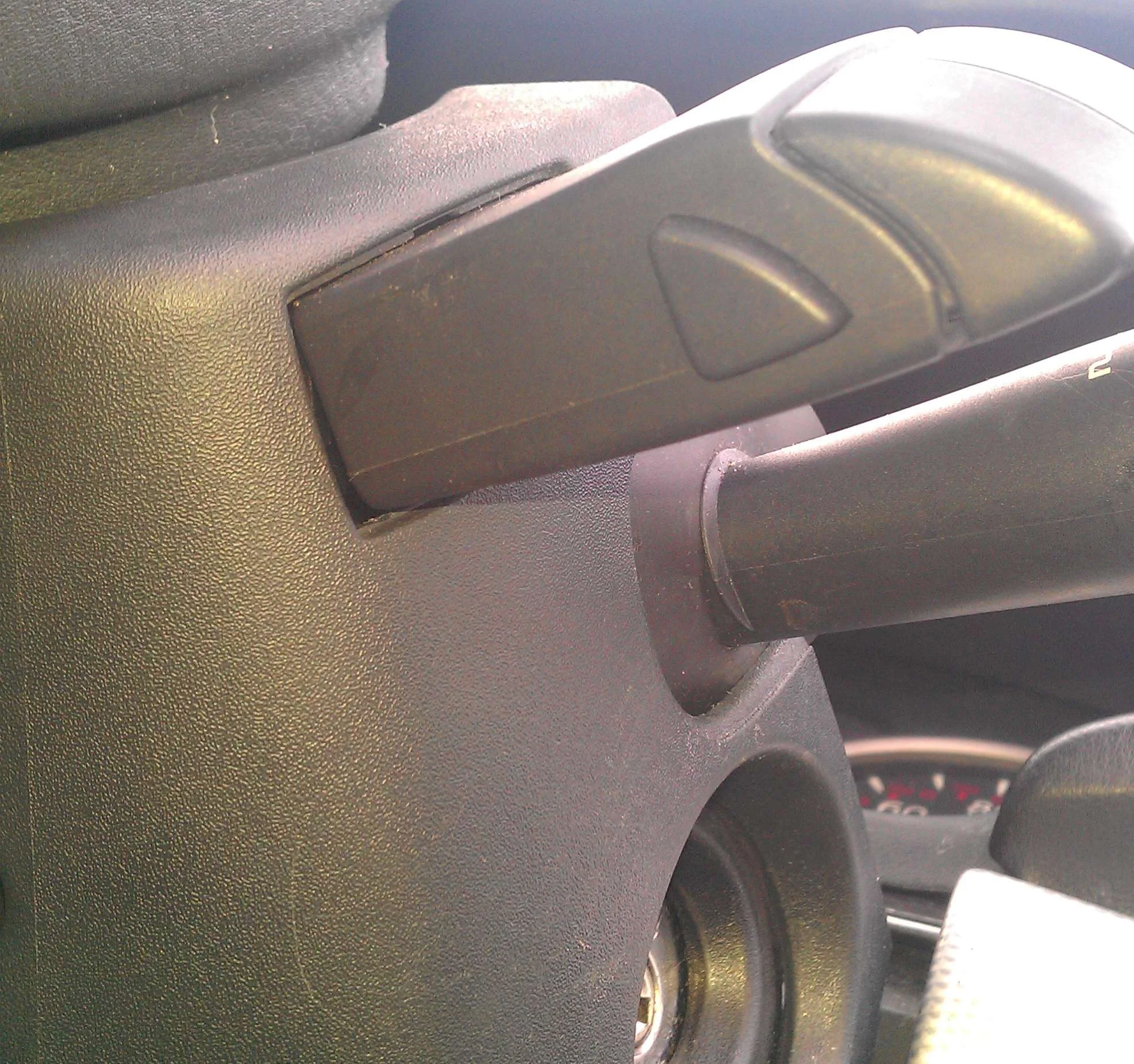

I am looking to fit a Sony stalk adaptor lead to my Clio, I can remove the upper casing round the steering wheel but the bottom bit of casing gets stuck over the stalk control bcos of the raised buttons!
I just need to know, how to remove the stalk control or can I remove the the bottom bit of the casing without breaking it?! As the gap is not big enough to fit over the stalk control buttons!!

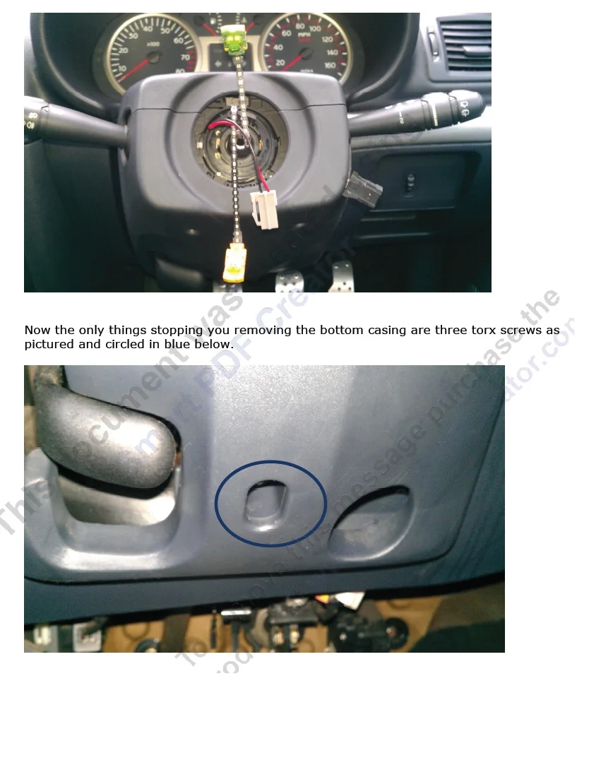

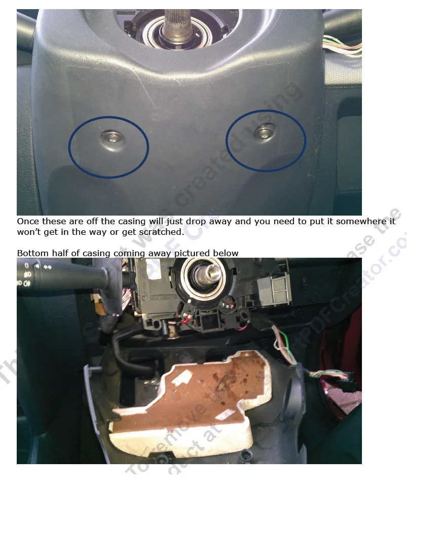

Bottom casing come off with THREE screws, one right down the bottom of the casing, two sunk into the middle.
They're all T25 torx bits if I remember rightly.
I'm after exactly the same answer but I can't see these 2 torx screws under the stalk you're talking about (see pic), there's nowt there.
I have taken out the three torx screws I think you are refering too from the cowling/casing which is fine and the casing comes loose but it's still stuck on the radio stalk.
Not sure if this is a model dependant thing, but the point I was trying to make was that I had taken the 3 torx screws off from the casing under the steering wheel already but that it was stuck on the radio controls. Same as original poster
Have done it now following some advice found on google. If you read what Kevrsi was saying it was that the stalk was held on with 2 torx screws which is why i posted a pic of my stalk saying where are the torx screws :dapprove:

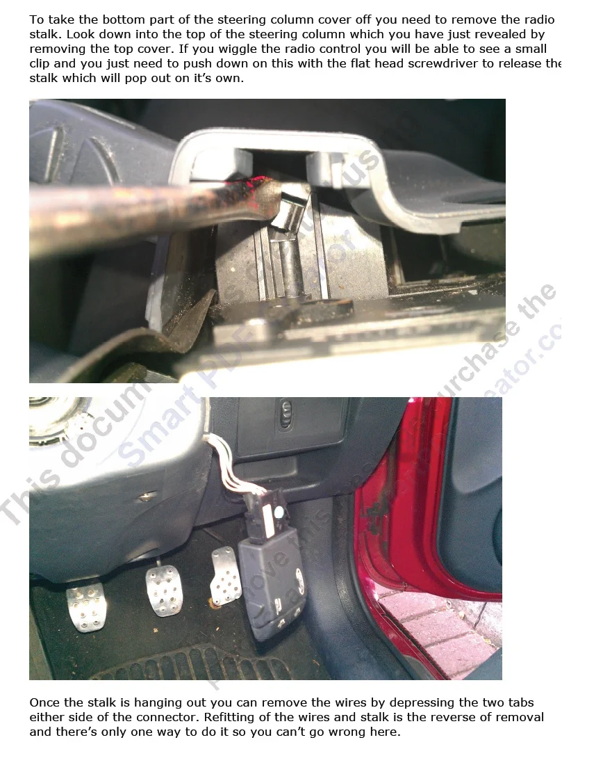

The way to get the casing off on a mk2ph2 at least is to undo the 3 torx screws which live under the column as you pointed out Rob, but you also have to take the top casing off and use a screwdriver to release the radio control stalk.
What your looking to know is that there is a clip on the radio control stalk at its base that needs pushed in which will release it and then you can unclip the electrical connector
