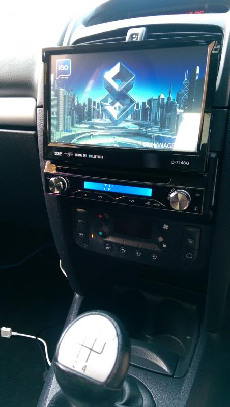

So i've got my new head unit fitted and working but it's not secure, it move forward a little bit when you drive, and you can just push it back in.
It came with this little piece of metal with holes in it, but not sure where that goes ?
Can i secure it with that little strip, or do i need something else to hold in it place properly ?

Doesn't look like you've bent any of the metal prongs to hold the metal sleeve/cage in place. Judging by the pics anyway.
I have indeed not bend anything, i assume i was suppost to ? Do they just pull outwards ?
Take the sleeve off the stereo, put it into the cavity, bend the prongs on the bottom downwards, top ones upwards and the side ones outwards until the sleeve is secure, then pull all the cables through re install the heAd unit.
