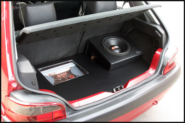

one option is to make a false floor mate, this then holds the sub securely, my brother and i made one for his saxo

Agreed, get a sheet of MDF and use your boot carpet as a template to draw round and then cut the wood with a jigsaw (an electric saw) ;)
Also a couple of bits of 1" x 1" bits of wood attached/screwed to the underneath of the MDF going from back of car to front of car (lengthways, not widthways) to allow your speaker/ amp cables etc unde the fake floor.
And then you can place the Mdf Fake boot floor in your cars boot with the boot carpet on top of it and you'll never know difference (apart from the boot being a few inches short depth wise) between that and the normal floor.
Then screw your sub to this False MDF floor with 90 degree right angle brackets :)
And if you really wanted you could drill a few holes and cut a line in the boot carpet above the holes in your MDF floor to let you amp cable dissapear under the floor out of sight to where it goes (the headunit or amplifier) and if you have an amplifier you can make the speaker, RCA(phono type audio leads), and power and earth wires dissapear under the floor to the headunit, Earthing point and Power supply ;)
The only thing about having a full size MDF boot floor is you'll have to ditch the spare wheel. or cut a square out the MDF and put on a hinge on it to access spare wheel. But you may have to screw amp onto the back of seats to do this if you have one.
And have sub to the left side of boot against rear left wheels arch.
Or the other option is to cut a bit of wood big enough to sit over spare wheel area(As Terry172 mentioned) and do the same as full size false floor above but on a smaler scale ;)
Or copy the floor above if you don't want to secure it with right angle brackets and would rather use the wooden floor to hold it ;) 90 degree
