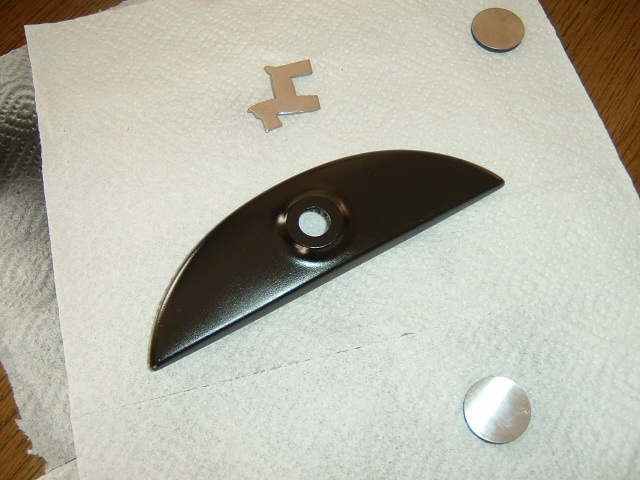

well this is why I needed to take it off....sprayed that plastic trim...
Nice one I needed to know this :) That plastic bit in the pic has gone really grey on mine. Is that gloss black you sprayed it? Will be good to see some pics of it fitted.
