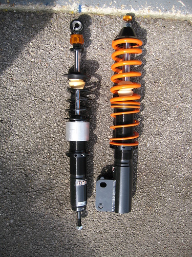

How would you get AST coilovers from a cup packed 182 to fit on a 172 cup?

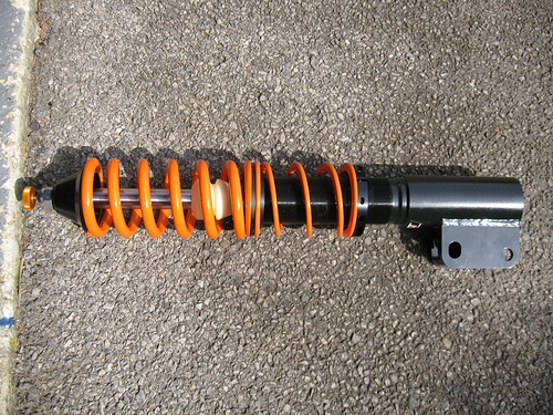

Got a feeling ASTs have the lower hole slotted to suit the different fitments. There's definitely one setup like that, not looked at a set for a few months, anyone got a picture maybe??
I was told by pstation that the fitments were different depending on the model.

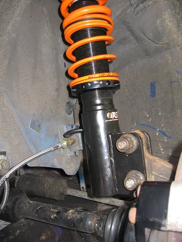

they are my pics!!
As for the original question... swap hubs, or have the bottom hole machined to fit the 172 hubs.
bottom hole machined is easily and quicker..i know someone that do it and still have any problem..
