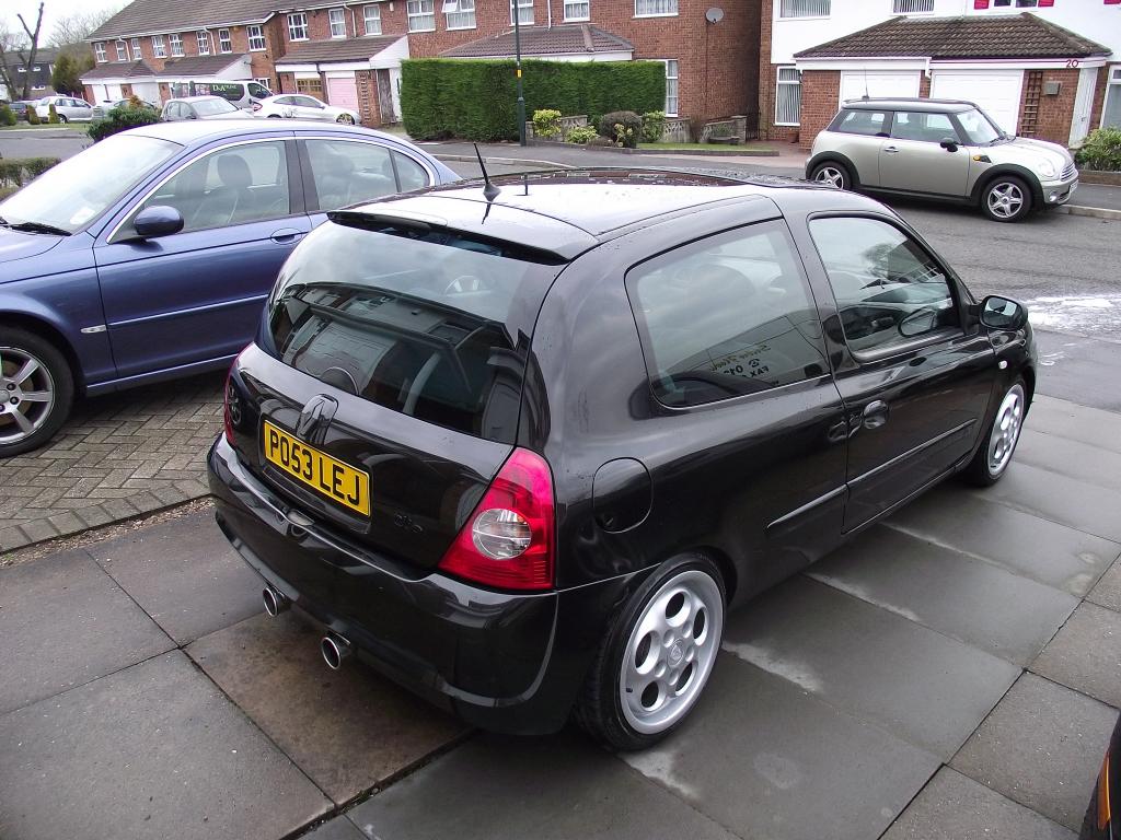

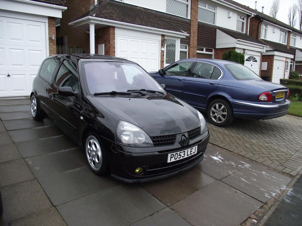

hub spacers on, pro speed exhaust. clio on porsche teledials
Car  Focus st170

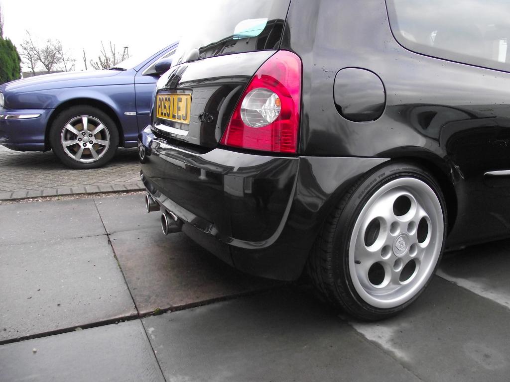

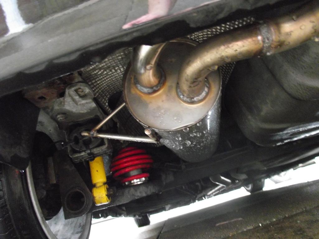

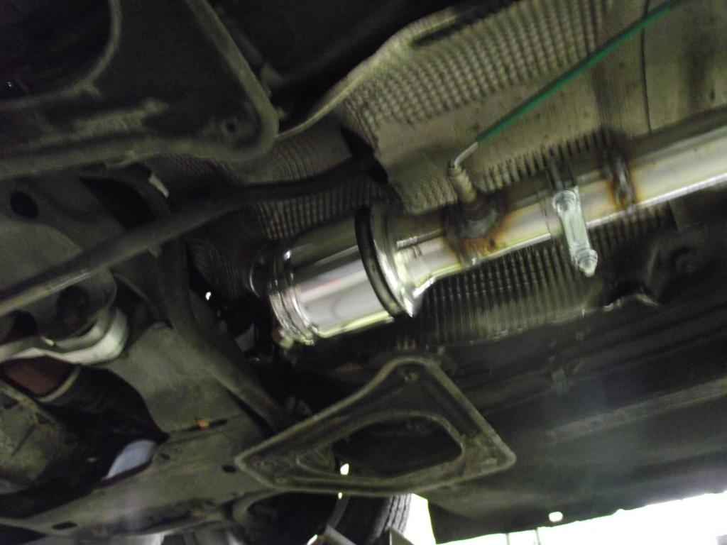

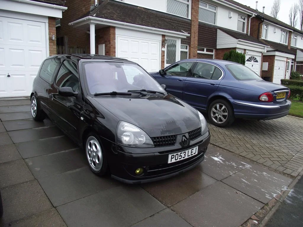

got my hub spacers on and my catalytic converter had decided to empty its self into my crappy k-tec exhaust. so on Wednesday i went down to pro speed exhaust in Cardiff and got my self a 182 style exhaust. pro speed did a amazing job! highly recommend them grate bunch of guys.
the piks...
Not sure, could grow on me. That lambda senor wiring looks properly stretched, and one of the exhaust mount bolts are missing?
the hub spacers fit but are a little tight with the hand brake cable. mine are 15mm 2 dagree camber. used m10 1.25 thread bolts 45mm top and 50mm bottom. if they are to long the bolt sticks threw and stop the drum moving
