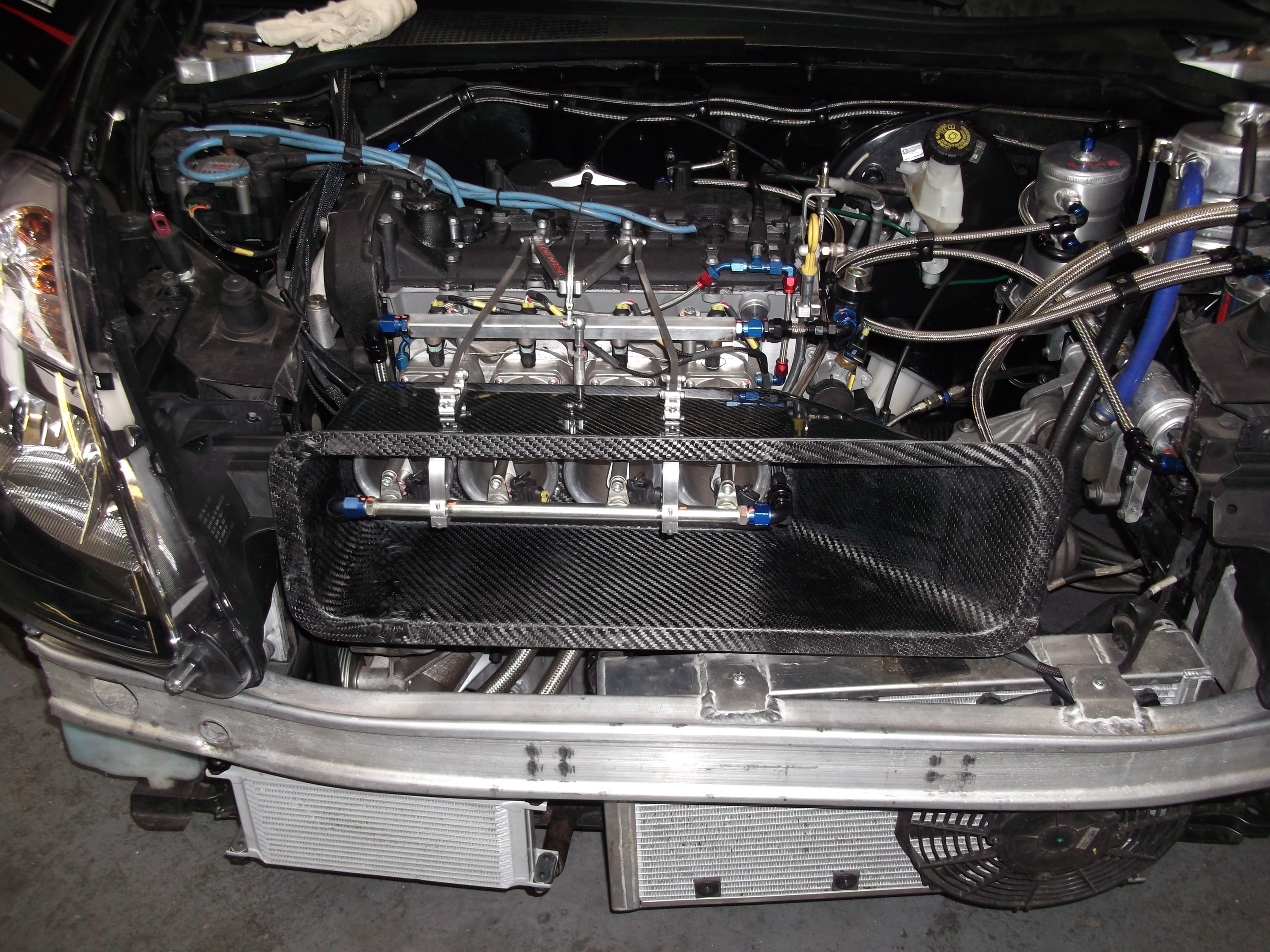

From memory i believe the top boys in france moved the inlet ports up in the head massivley, the stock port position just couldn't do anymore than 250beans
you don't seem keen on naming anyone LOL!
Do they block off the water gallery between the valves to straighten the port?

LOL here's a glue then. The guy that designed my cams and did the CNC port flow maching, also did the heads on the 2 x F1 world championship winning Mercedes engines while he was in charge at Ilmor 1991- 1996, I am sure that you can work out who it is from there.
He disagrees with your statment that the ports have to be moved to achive more than 250BHP. heres a link to one of his F4R heads at work, not as high a spec as mine but close.
http://www.youtube.com/watch?v=I2B5Lkp0Au8
I am sure you will agree while the near 280 BHP is pretty impressive whats really inpressive is the fact its done at only 7600 RPM

Is there much power to be gained from not driving an alternator (and presumably gearbox) when bench testing?

Just found this thread whilst searching for big valve heads, what did this engine finish making?
And regards who did the headwork, it says:
Well no Ilmor engines won between 91-96, it wasn't until 98 and 99 when it was under the Mercedes-Ilmor banner. Though I assume you are talking about Mario Illien maybe?? Highly unlikely he'll port me a head (Google says he's probably busy consulting for Renault F1!) but if I went to Ashford Motorsport who apparently used one of his head on that 279bhp engine linked, then I presume Ashford must be 'the' place to get a big valve head from? I'm massively sceptical of that power at those revs mind.
