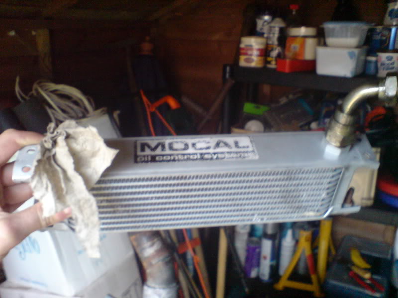

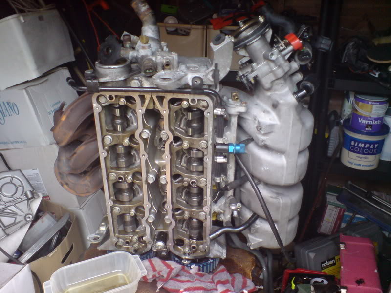

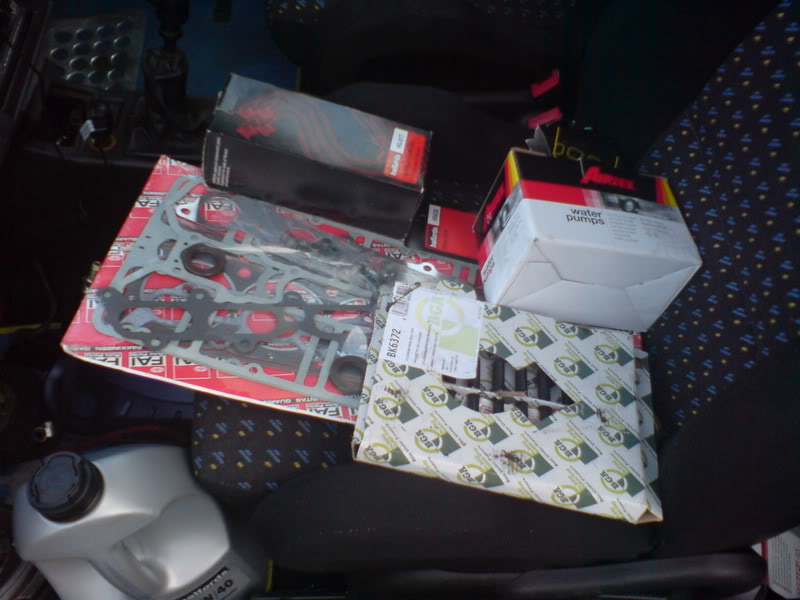

Fetched my Hill power 2ltr engine today. It Boasts piper cams, adjustable vernier pullies, ported head and external mocal oil cooler. Engine built by no other than Nic Hill:cool:
Being dropped in tomorrow/monday!
N.D.Hill Engineering...

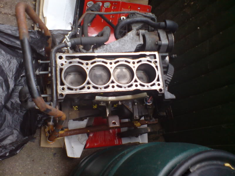

Head off for inspection and new HG.
Oil Cooler...
New shizz..
Called Nic estimated power is 180bhp ish so should be good fun! Watch this space for updates!
Cheers
Amir

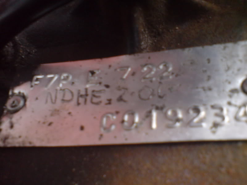

Its stamped F7P which is the Clio 1.8 16valve engine, not F7R which is the williams 2.0 engine.

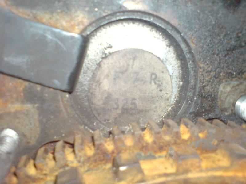

Before people start sayin its a 1.8 cause it says 'F7P' Nic changes the plates over for insurance resons i assume, its an F7R for sure, supportin veins on the rear say it all and there is a stamp on the side sayin 'F7R':cool:

Why post a pic of the engine plate saying F7P if you knew people would say thats a valver engine :s ?

If you look on the pate it does actually say 'NDHE 2.0l' Thought peolpe might see that....

Not a re-bore, actual F7R
i only said that cos nick told me by the way!! it was in the days when a 2ltr was dear to get hold of, so a few 1800 were made into them! wasnt picking faults! it will be righ if he did it!! hope it goes well!!:cool:

I'm pretty sure its just the crank because a 2l crank in a valver block will give you a 2l engine. iirc one of the best combos is a valver head with a 2l megane bottom end because of the valver cams being a little more wild than the F7Rs. If the bore was different you wouldn't be able to do that.
  Looking for a ph-quick...
Im sure the bore is different, you cant put a 2ltr cran in a 1.8 iirc. im sure some guru will confirm this!
pistons are something like 2mm bigger, the crank wont go in a 1.8 because there isnt enough room for it to go round, just changing the crank would give 1970cc ish, the rebore makes the rest i believe.

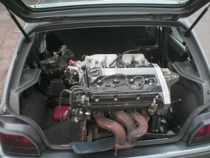

Hehe! The element of suprise! Tomorow, old engine out, (cup of tea) clean bay, fit new steering rac (buggered p/s pipe), (cup of tea) fit oil cooler. Prep engine for monday when its having a head HG and cambelt (cup of tea), throw it in!!! woooooo

Also as midge said the 2.0 has both a wider bore AND a longer stroke than the 1.8.

Update, Old engine is out, old rack is off rain screwed things up big time but clutch, gearbox and starter are all fitted to new lump. Its being built up this afternoon/this evening, pics to follow!
