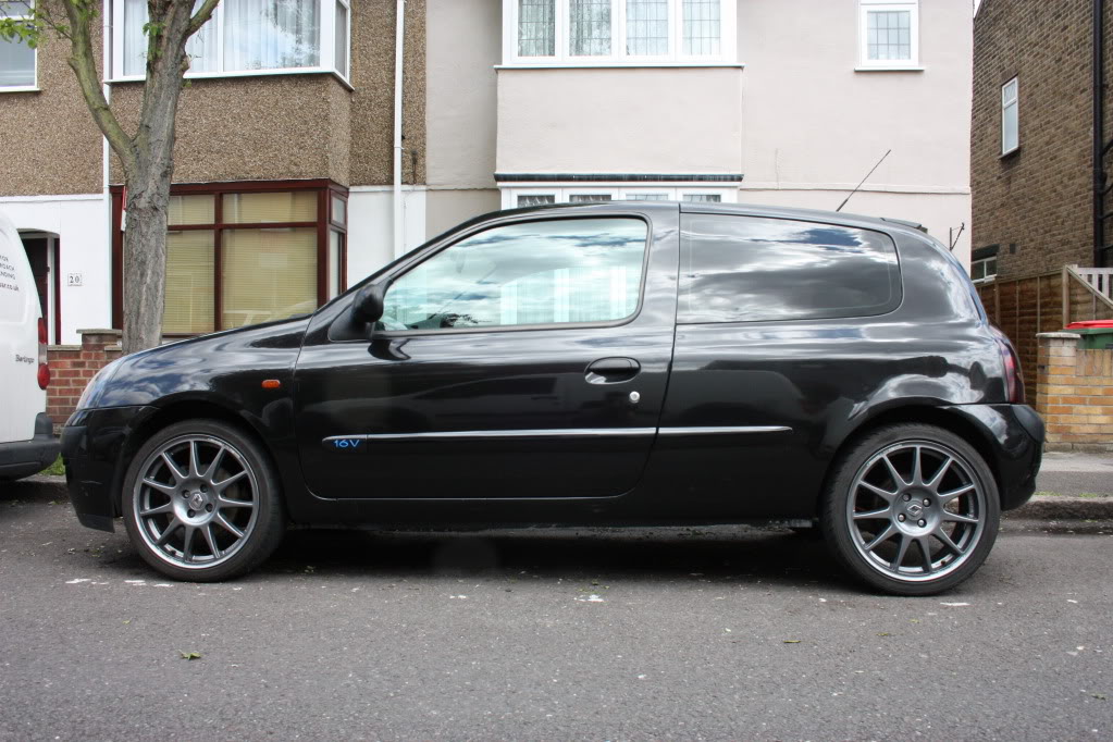

As promised :
Looks nice, still prefer smaller wheels though i think :eek: each to their own though! god i'd love a set of those wheels.. how much did they cost you? definatly needs lowering :p
  1.2 Dynam & 182FFCup
Cheers man, they cost me around the tune of 500. Not a bad price either. Someone off of here, can't remember his name for the life of me though.
Shame it's only a 1.2, can't wait to whack em on a 172 of my own.
I will lower, just when I get enough info to assure no scrubbing :p
Fair enough, yeah not a bad price that at all! Are you after just some springs or a set of coilovers? springs, 35mm would probably do you tbh... whereas if you're after coillies just buy them and then play around with the height once fitted :)
