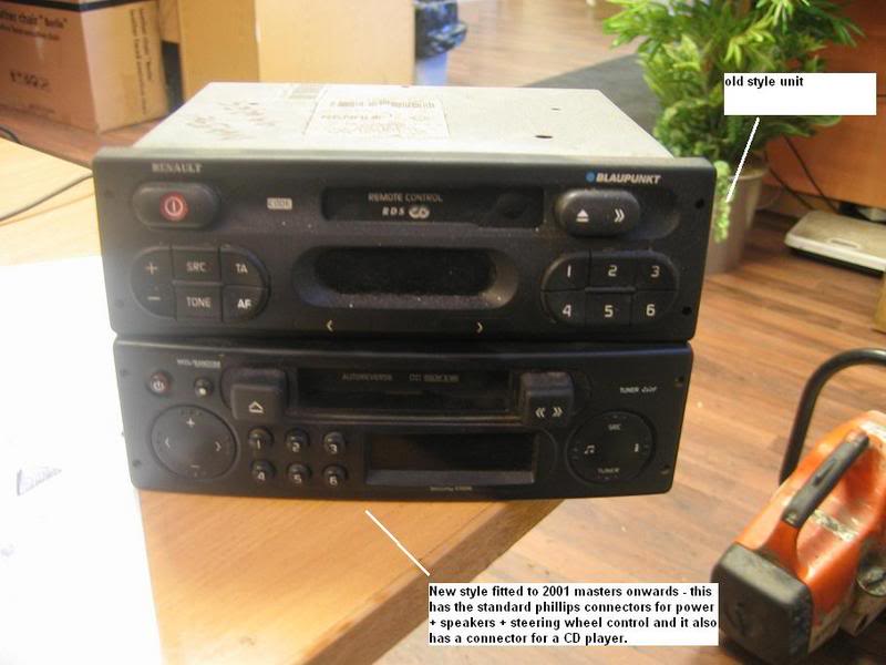

I am changing the cassette player in my master van(told you it was sad). It's a 2000 year and has the player with the built in display. I want to change it to the tuner list cd player with seperate display. Have already added extra dash pod, has any one already done this? I want to know if my wheel control will still work or if i need to get the one from the cd player. I understand thier will be wiring to the display to add but i intend to cut the loom from a rite off at work. Any advise would be great. Thanks nuppy.

Your Van has EXACTLY the same set up as a late Clio with the display and steering wheel controls, so look a the various posts on the subject.
There are parts available from Halfords and various on-line stores.
Why dont you just fit the alpine 6 stack to the tape player ?? .... if yours is the older blaupunkt unit it wont work but if you swap it with the newer phillips 22DC229 you will be able to use the radio / tape and CD and this head unit comes with a built in screen
