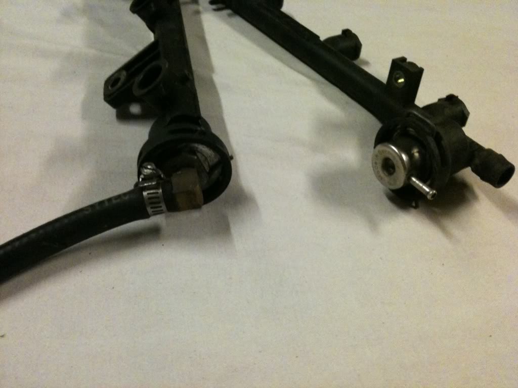

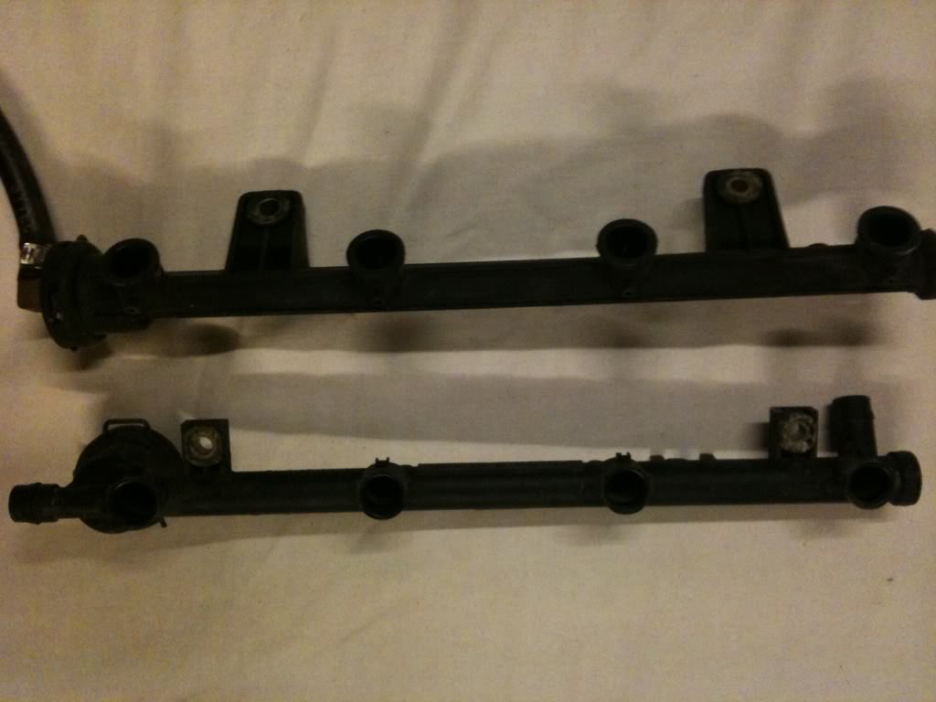

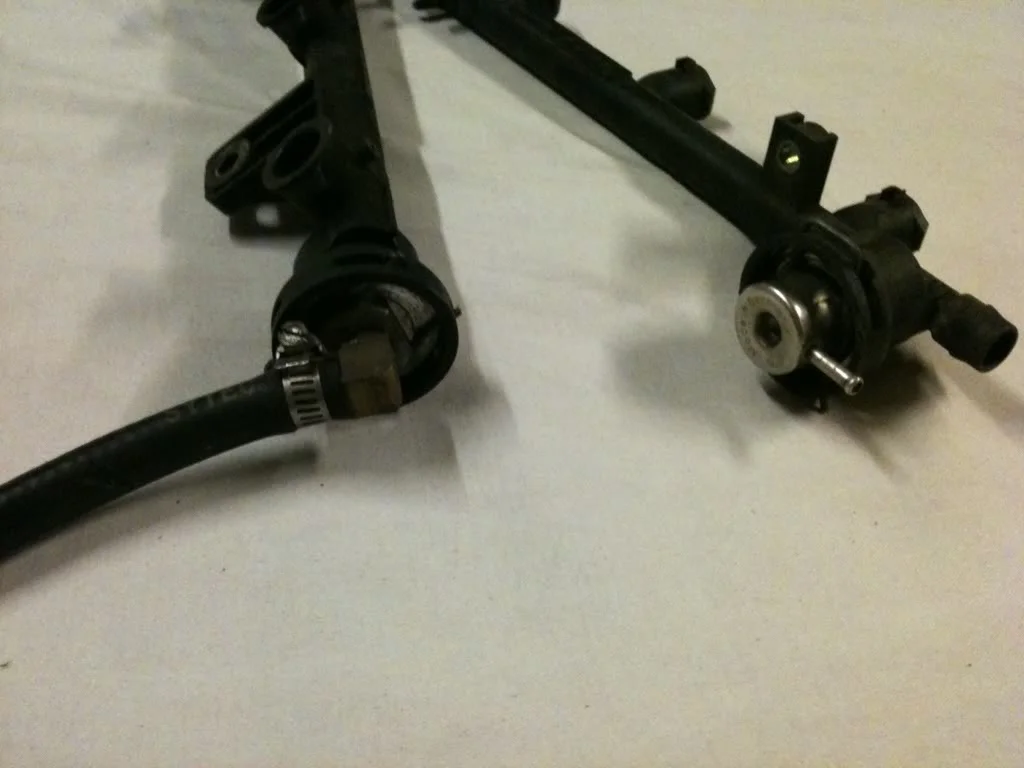

so the clio rail fits with regards to injector positions but it wont mount onto the standard head bolt mounts...
is it safe to assume i can make some brackets to fit the clio rail or am i being a bit fick there?
Thats a bummer, I'm not sure what he did to get it to fit mounting points wise?
Are they far out of alignment?
the clio rail has the mounting points more towards the end of the rail where the F7R rail is closer to the middle.
i could probably mount it with some brackets but im unsure wether that would be advisable?
I'll have a look for the thread on RTOC and see how they did it. Can't see any problems with making a bracket? As long as it's secure
thats my thought too. cheers :) failing that i supose ill have to use the megane rail with bosch injectors and see if i can fit the clio FPR into it
Grab a pic of it mate and post it up or pm me. If its got a FPR fitted to it then it should work fine. I was under the impression that you had a non return fuel rail similar to what's fitted to a 172/182 and meg 225
ok ill see if i can get a pic of both of them now.
edit:
clio on the right, meg on the left...
and the mounts as you can see here...
clio on the bottom
no but i think it goes through the FPR.
goes in 1 end all the way through the injectors to the FPR then back on itself in another part of it towards the inlet but comes out 3/4 of the way there
I'll have to look at the pics on my Laptop when I get home. If it has got a supply, return and vacuum port then there's no reason not to use it. What injectors are normally used with that fuel rail, Siemens, Bosch etc...?
bosch i bilieve. i think it has a vaccum port (cant think of anything else the pipe coming off it can be used for)
it deffinitley has a feed an return tho, you cant see it in the pictures as its upside down
Well your laughing then mate, stick a 3 bar FPR in there and grab a set of bosch injectors. Unless the Siemens dekas fit then you could just stick a set of 630cc's in there and you'll be fuelled all the way to 400bhp+
