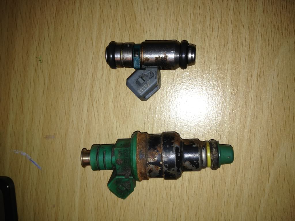

same sized o-rings each side but huge diffrence in size :(

Check the dimensions lower down the page they look as though there very close, try and grab similar measurements to see what, if any difference there is

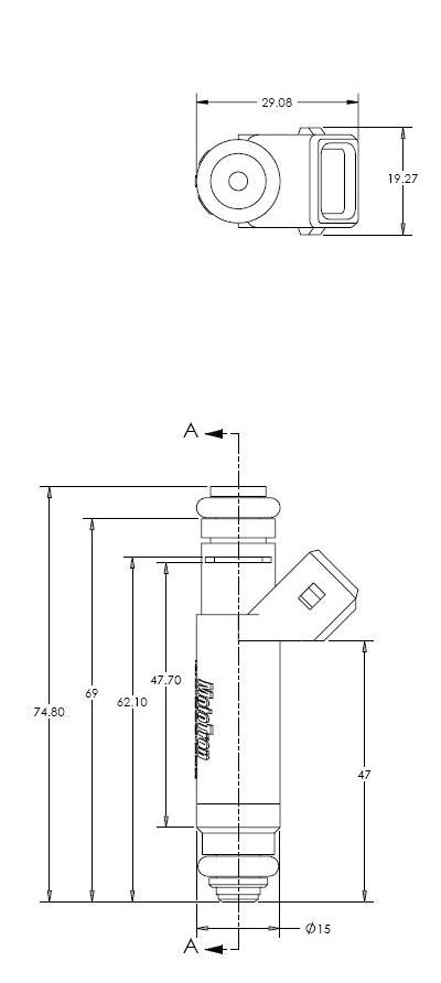

lol its not on there! ive looked several times for dimentions :p
i did find this however which means theyre 4mm too short.
sure i could make them fit!
  Trophy,R26,GSXR1000
I used those exact injectors on mine and spaced the injector rail out to accomodate them, never had any problems with them. Think they were about 70-75% duty cycle for 374bhp. Should give you plenty of scope for big power especially with you going down the VAG gearbox route.
