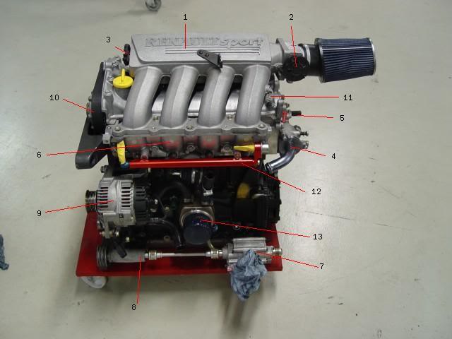

Hate to be a pain but anyone got any pics of the bolts?
1-Plenum
2-Throttle body with TPS (throttle posision sensor) on the far side
3-Map sensor
4-Thermostat housing
5-Coolant temp sensor
6-Manifold
7-Dry sump oil pump
8-Dry sump oil pump drive shaft and aux belt drive pulley
9-Alternator
10-VVT phaser pulley
11-Air temp sensor
12-Fuel rail with FPR (fuel pressure regulator on nearisde) and injectors
13-Oil filter on water cooled oil cooler takeoff.
Coilpack, at the risk of sounding a complete numpty, where is it? Brake servo line? Whats a carbon cannister?
at the rear of the manifold, which you cant see.
The coilpack is in a 6x6" sort of square recess...the plug leads will go to it so you can find it easily.
The Brake servo line and carbon canister line are at the rear of the plenum aswell, just next to the throttle body.
Dont have any pics of those specific items sorry.
