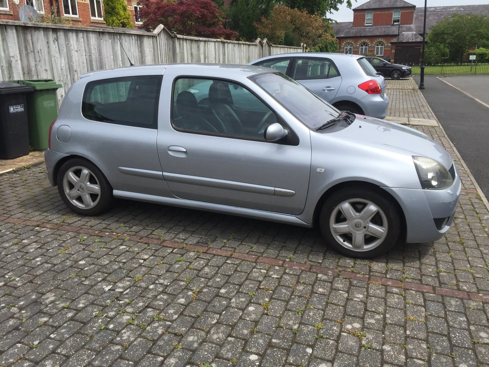

Hi All and welcome to my Clio Mk2 172 build.
To give a brief background, ive had a few cars now which ive built/modified mainly for 'stance' and 'show' purposes, ranging from Civics, e36's to my most recent being an R34 Skyline. As ive gotten a little older and bored of the show scene, ive had an itch to get into some track driving. This is one area i have no experience in but have seen a large shift of people moving from the typical 'show' builds to building track cars and having an absolute ball at track events. I wanted to see what i was missing out on!
The key for this project was 'Cheap Thrills'. I didnt want to spend a fortune on building a track car, i wanted something i could have some fun in and not worry to much about breaking/damaging the car.
Looked at a few options, mainly the likes of civics/ EP3's. However they were a slight price bracket above what id consider entry level track fun. I then started looking into Clios as i was aware there was a large following of these little cars esecially in regards to how cpabile they were on track.

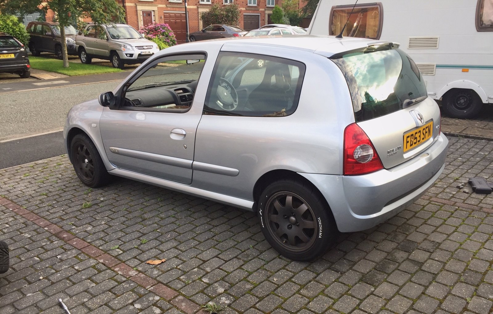

So with a few weeks of looking around online, i found a nice clean base located not too far from home. Long story short, the car was everything i wanted. Struck a deal and £900 later, i was the proud owner of a Clio 172.
What did i get for my money? Lets take a look....
1423655
1423656

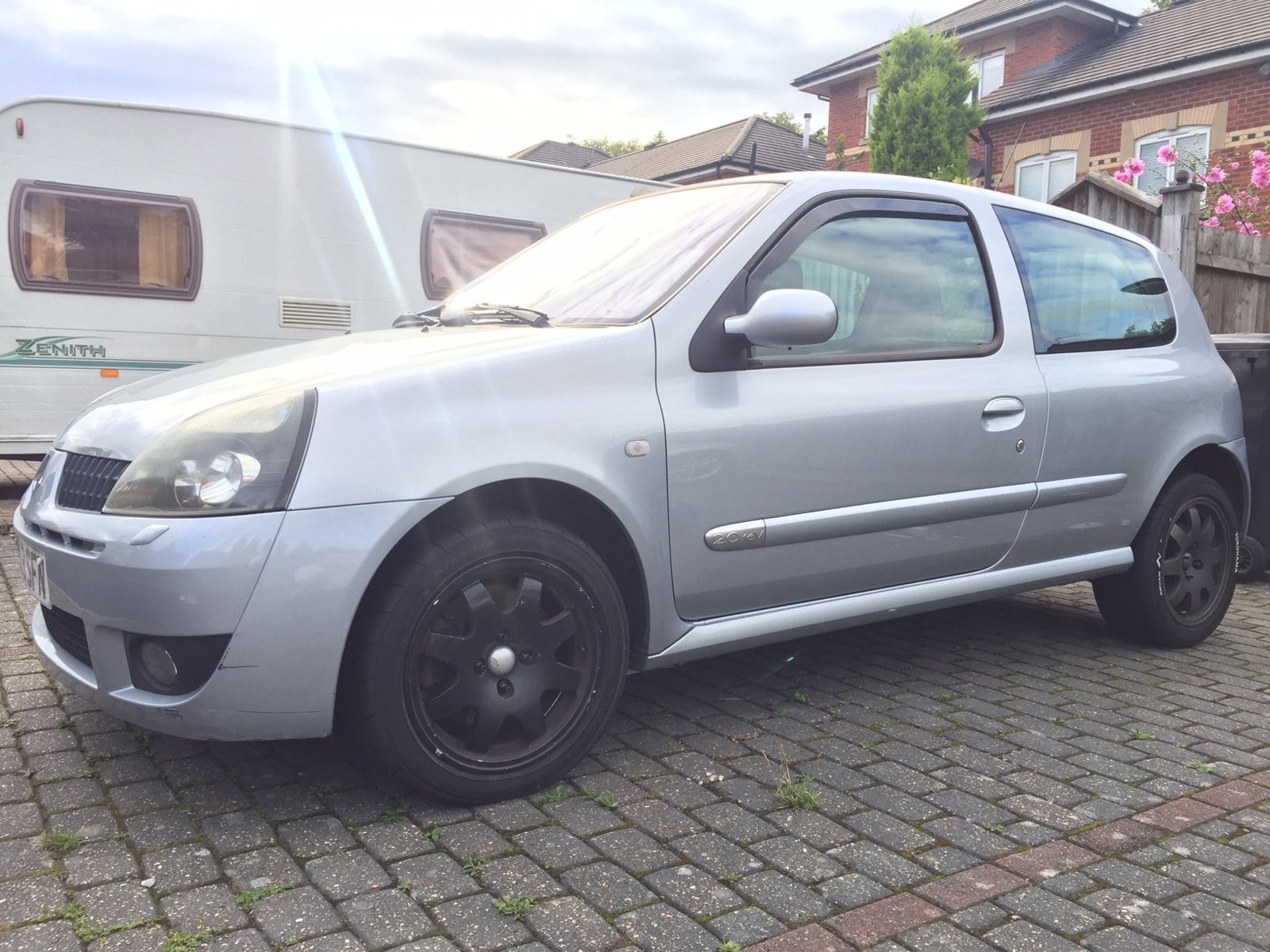

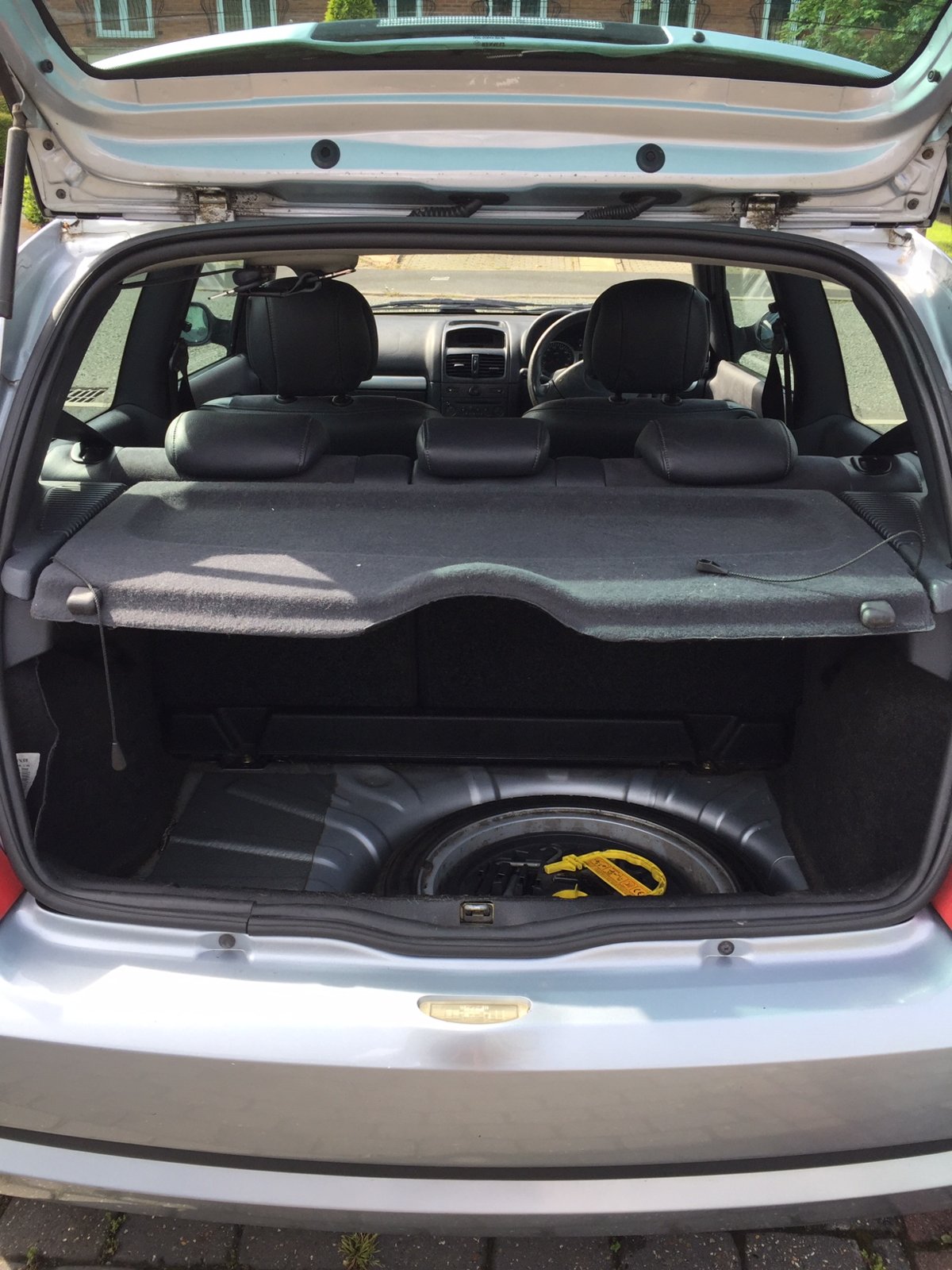

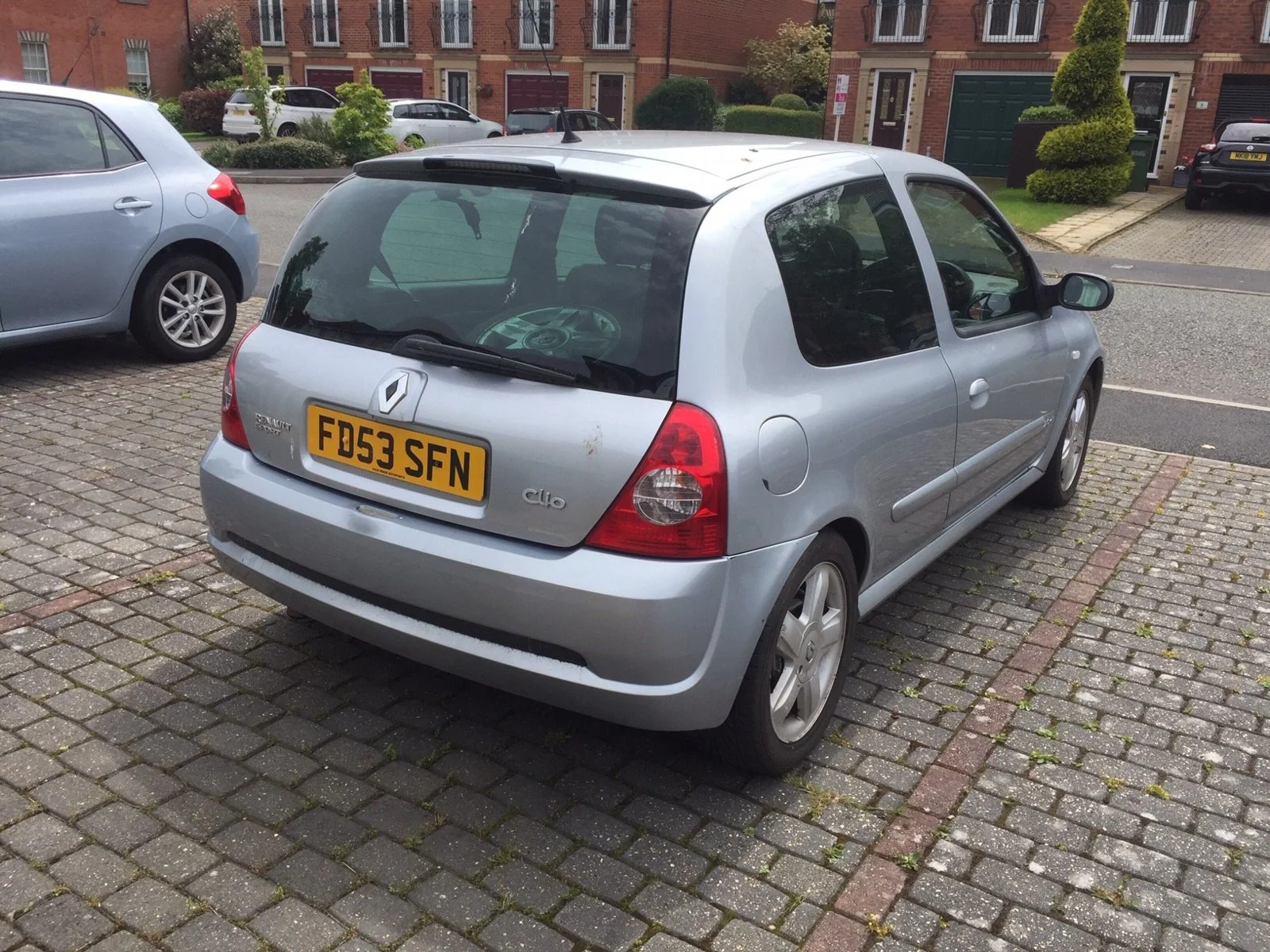

The car itself is a an Iceberg Silver Ph2 172. It has 99k on the clock and not long ago had its belts and dephaser done. The car is currently on a set of 15's but did come with the full set of RS 16's in the boot. Which i have now sold for £100. So all in, the car currently owes me £800.
Looking forward to getting started o nthis project. Any advice is welcomed as to what mods i should look to do before getting her on track. Will post updates as and when!
Please, don't cut the rear bumper. If you want to go all 'track style' and cut it, I'll swap you my one with cash.
The struggle to find an uncut iceberg silver 172 rear bumper is real.

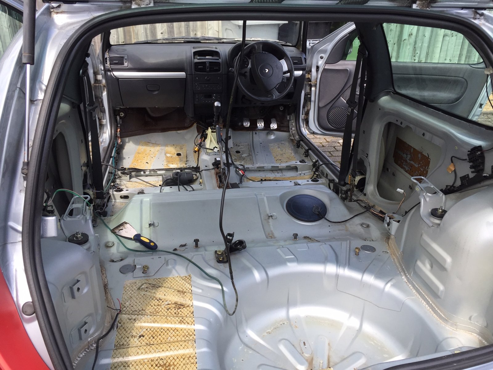

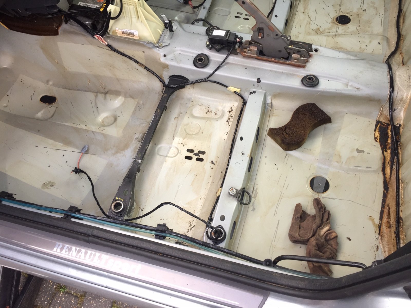

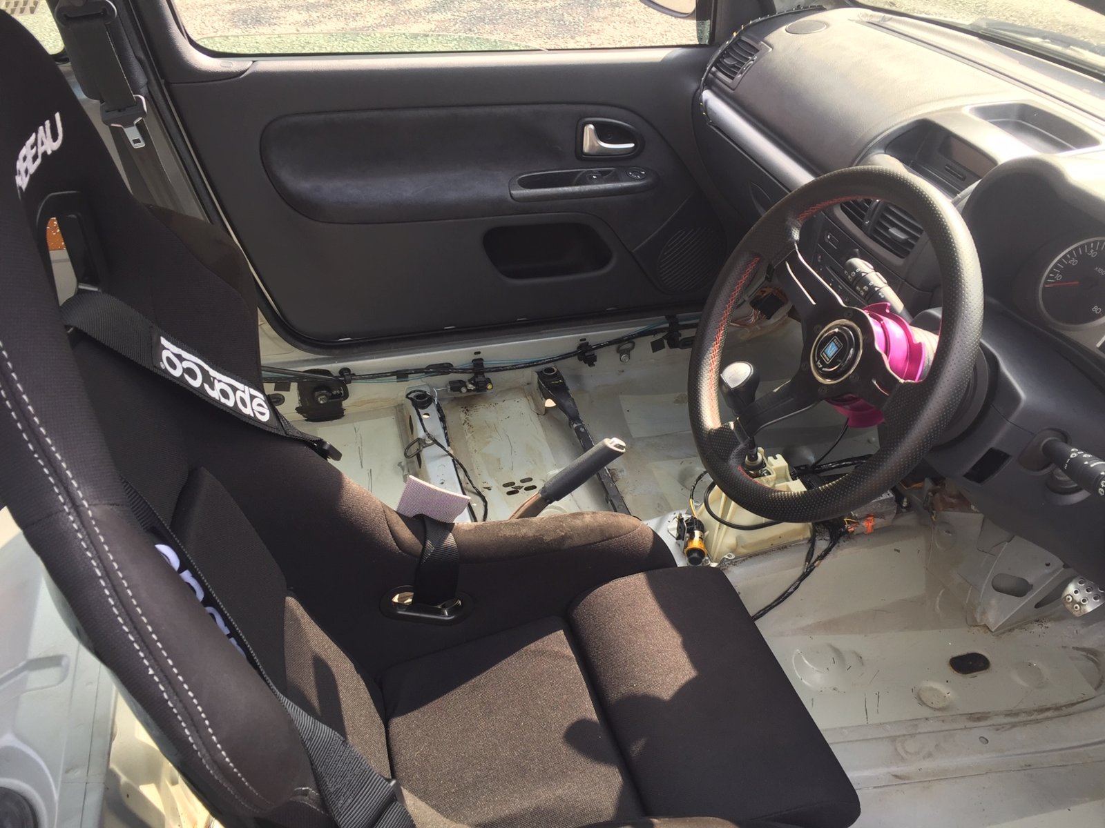

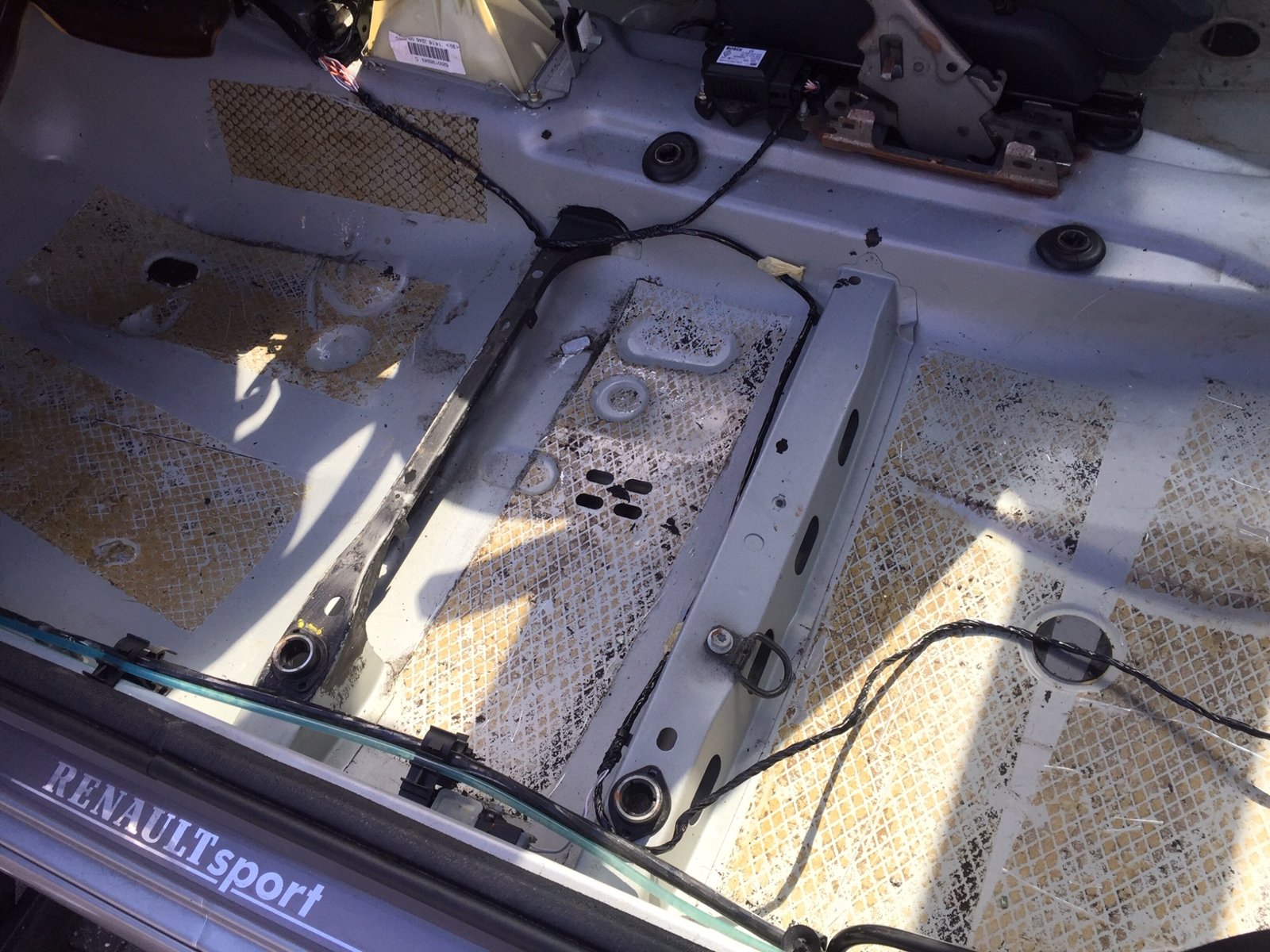

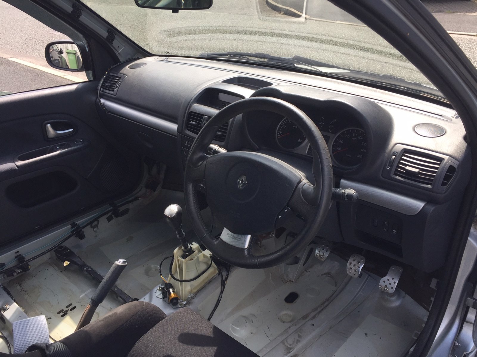

Started gutting the interior today. After reading about these cars online, it can be really pricey chasing power so ive decided to go heavily down the lightweighr route as its generally free. Removed all the rear interior, seats and roof liner. Figured if im going to go lightweight, may aswell do it properly. Out came the heat gun and scraper. Removed all the sound deadening and weighed it all at the end, was suprised to find that the sound deadening alone was 10kg in weight.
Started today like this....
1423663
And ended like this... (I have since put the front seats back in until i buy some Corbeau Clubsport bucket seats)
1423664

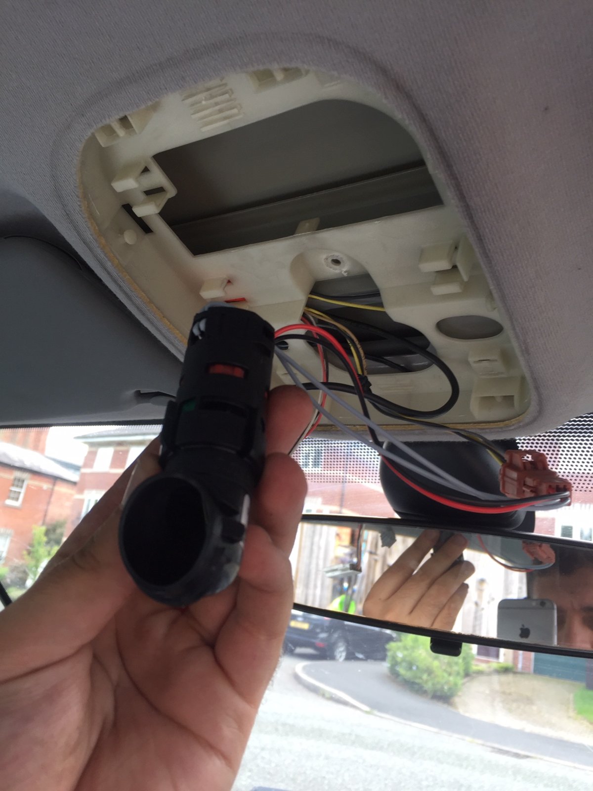

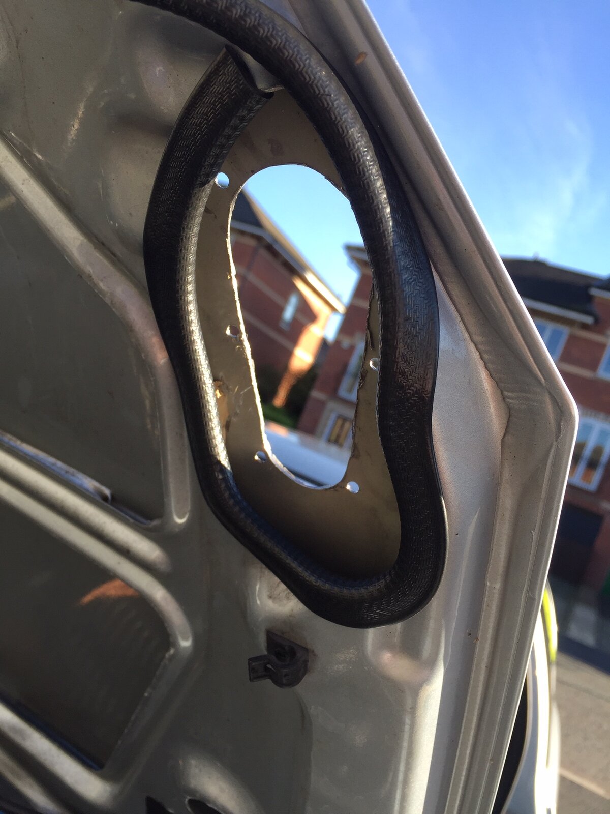

WHilst removing items, i came across this within the roof light modul, if anyone has any idea what it is? Doesnt have a bulb inside....
1423665

How different does that look on none sport wheels. Awful lol.
Hope the plans go well.
Dont worry, new wheels are on the agenda!

ps the module you found next to the map reading light is a sort of temperature gauge for the climate control system. It has a little fan in it which makes an annoying buzzing sound

Thanks for letting me know whta tthat module was. I can remove it now knowing it wasnt anything too important.

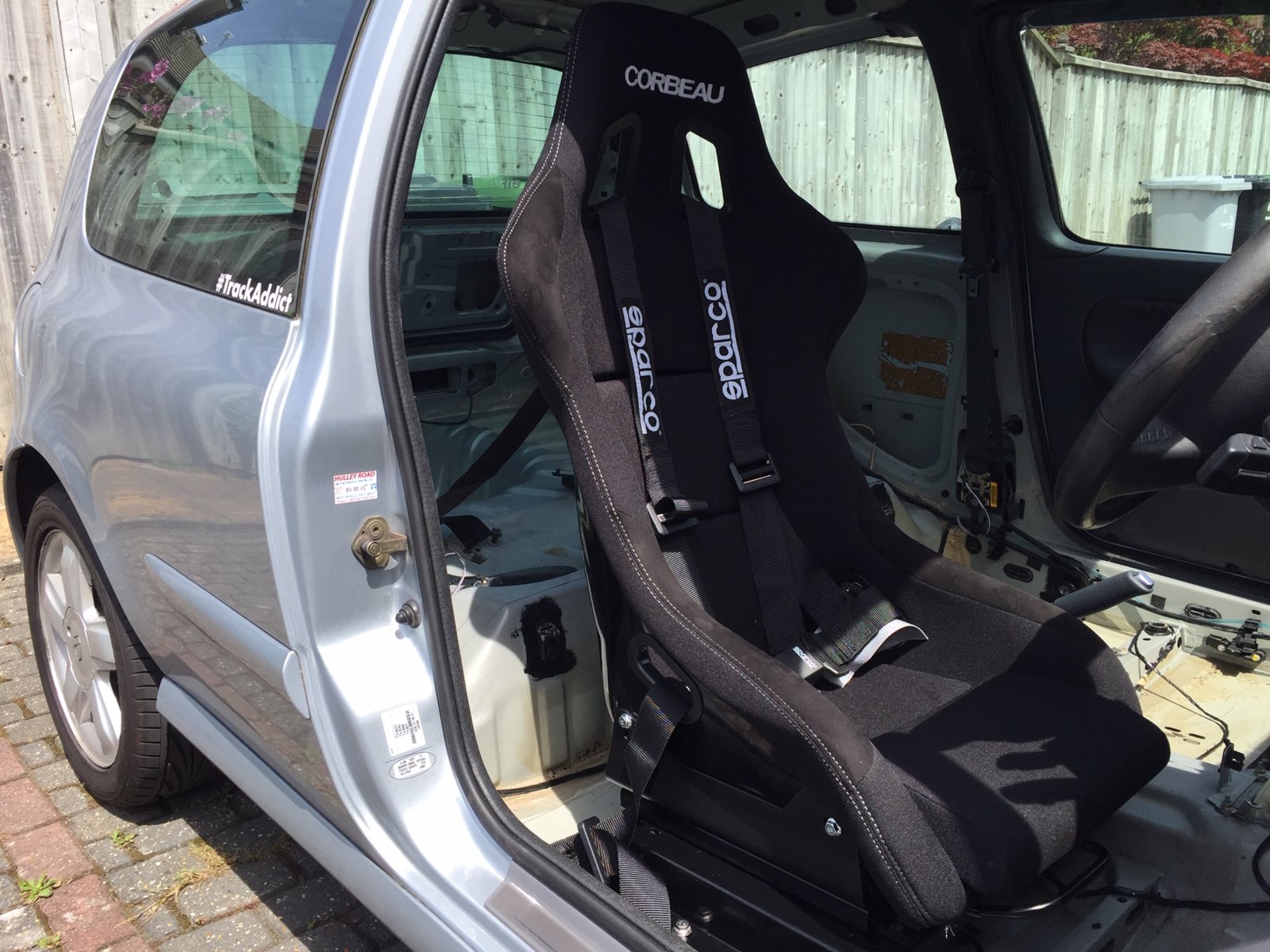

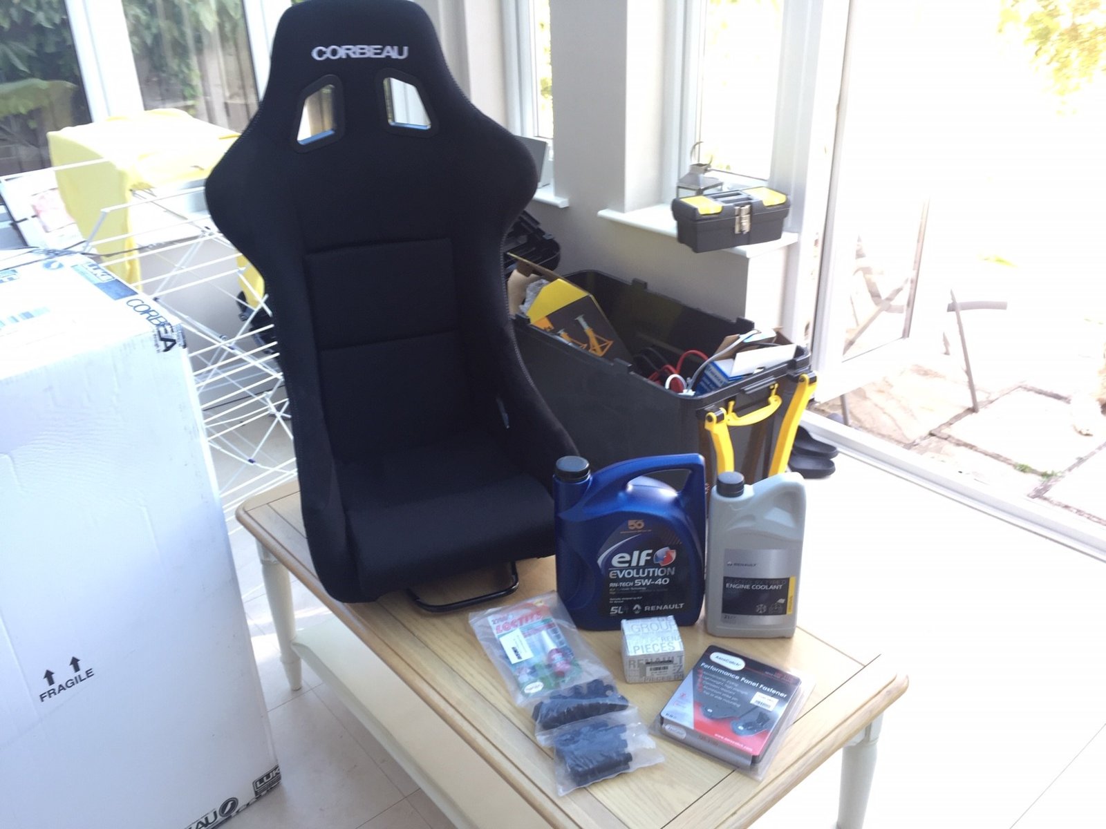

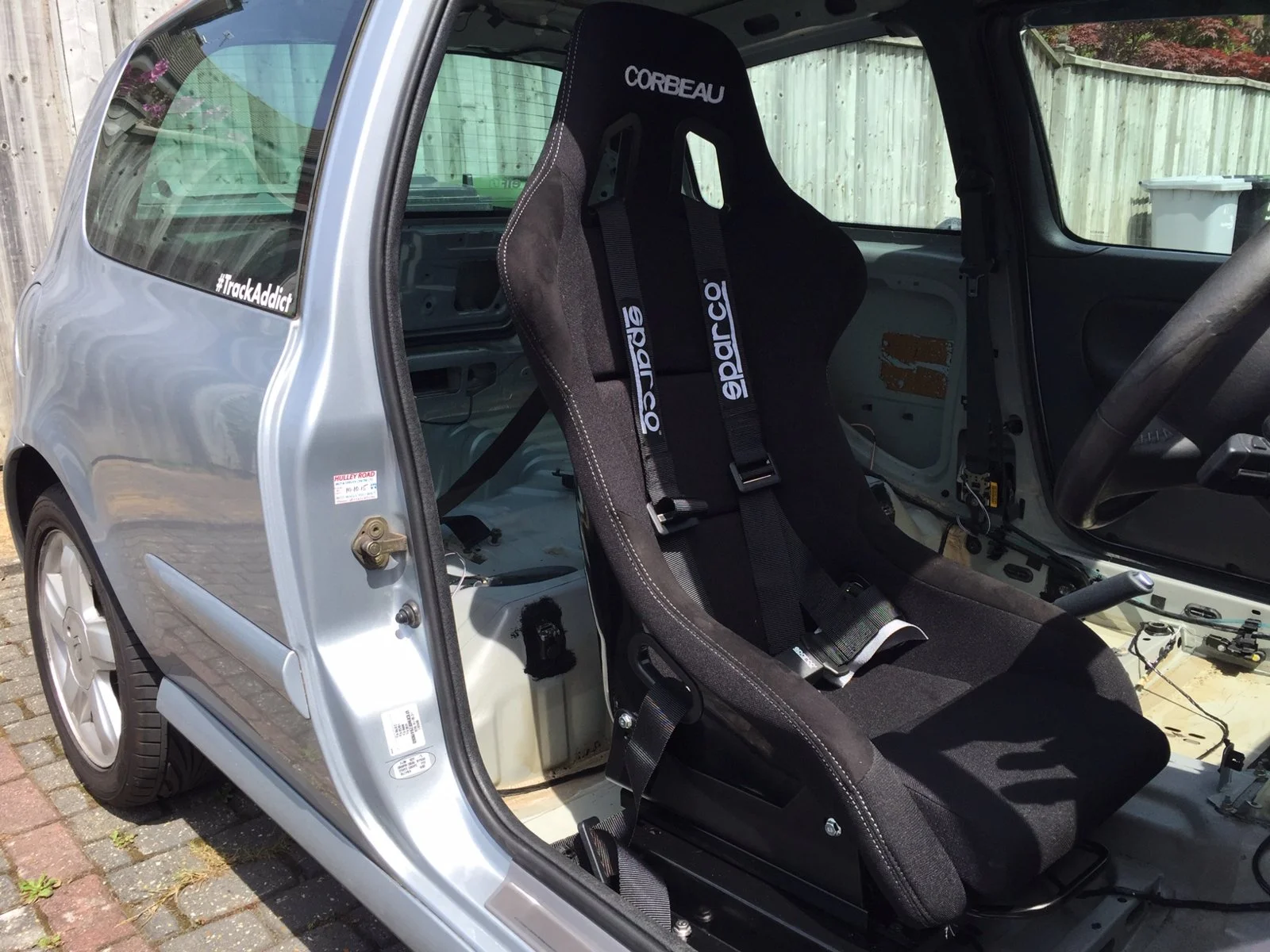

And the main present to myself, the Coreau Clubsport. After reading a few feviews on this seat, i figured it would be a good choice. Im currently waitng for the OMP subframe mount to come from Kam Racing. Hoping that will be here tomorrow.
1424039
Hoping to spend a few more hours on the car this coming weekend (weather is looking promising). Need to scrub the inside of the car to get rid of any left over residue from removing the sound deadening, and hopefully get the seat and steering wheel fitted.
*Update*
Spent a little time on the Clio last week. Started by getting some white spirit and scrubbing the left over residue that the sound deadening left behind.... started with this..
1425638
And ended up like this... I did this with the whole car including the roof.
1425639
Just requires a quick wipe over with a wet cloth now to get rid of the mucky brown tint its left behind.
And finally, i spent some time mounting my new seat & rails to the omp mounts. Those who have done this will know what an annoying fiddly job this is. Chucked it in the car. Also found a new Sparco harness that never made it into a previous car of mine so whacked that in with it. Bolted it to all the origjnal seat belt points for now until i get a rear cage to mount it to.
Really happy with the outcome so far.
1425640

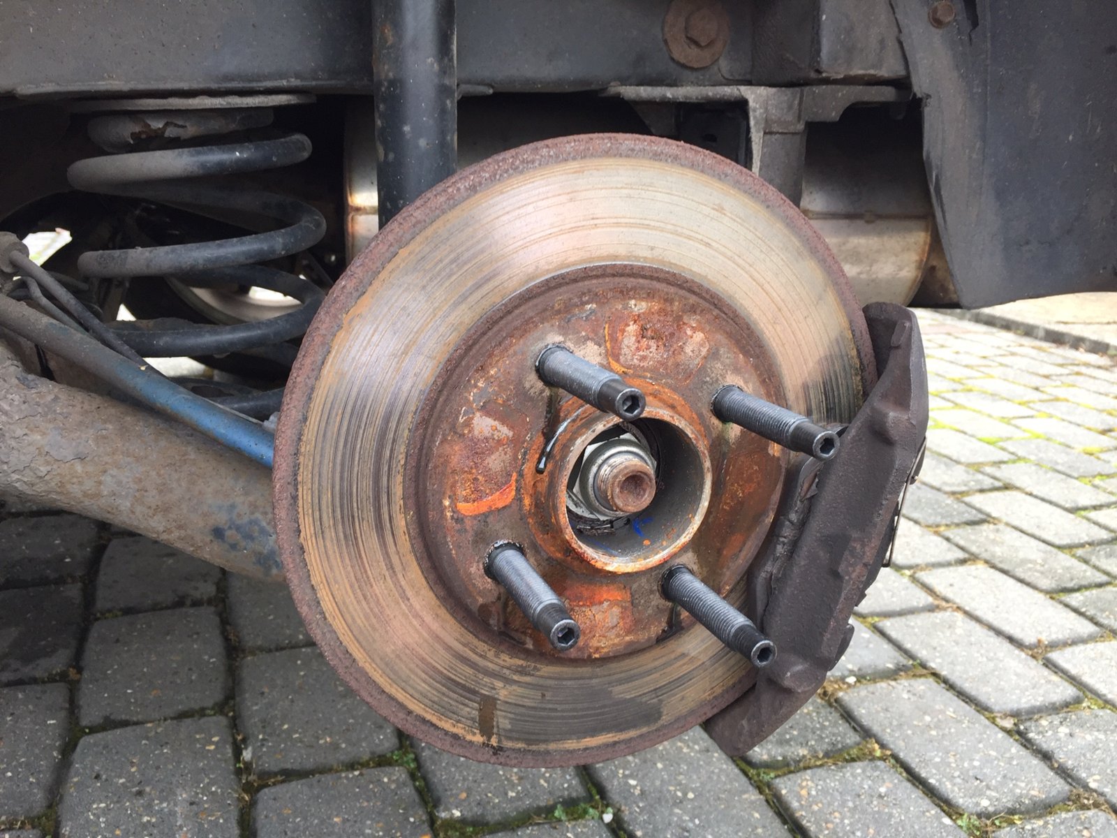

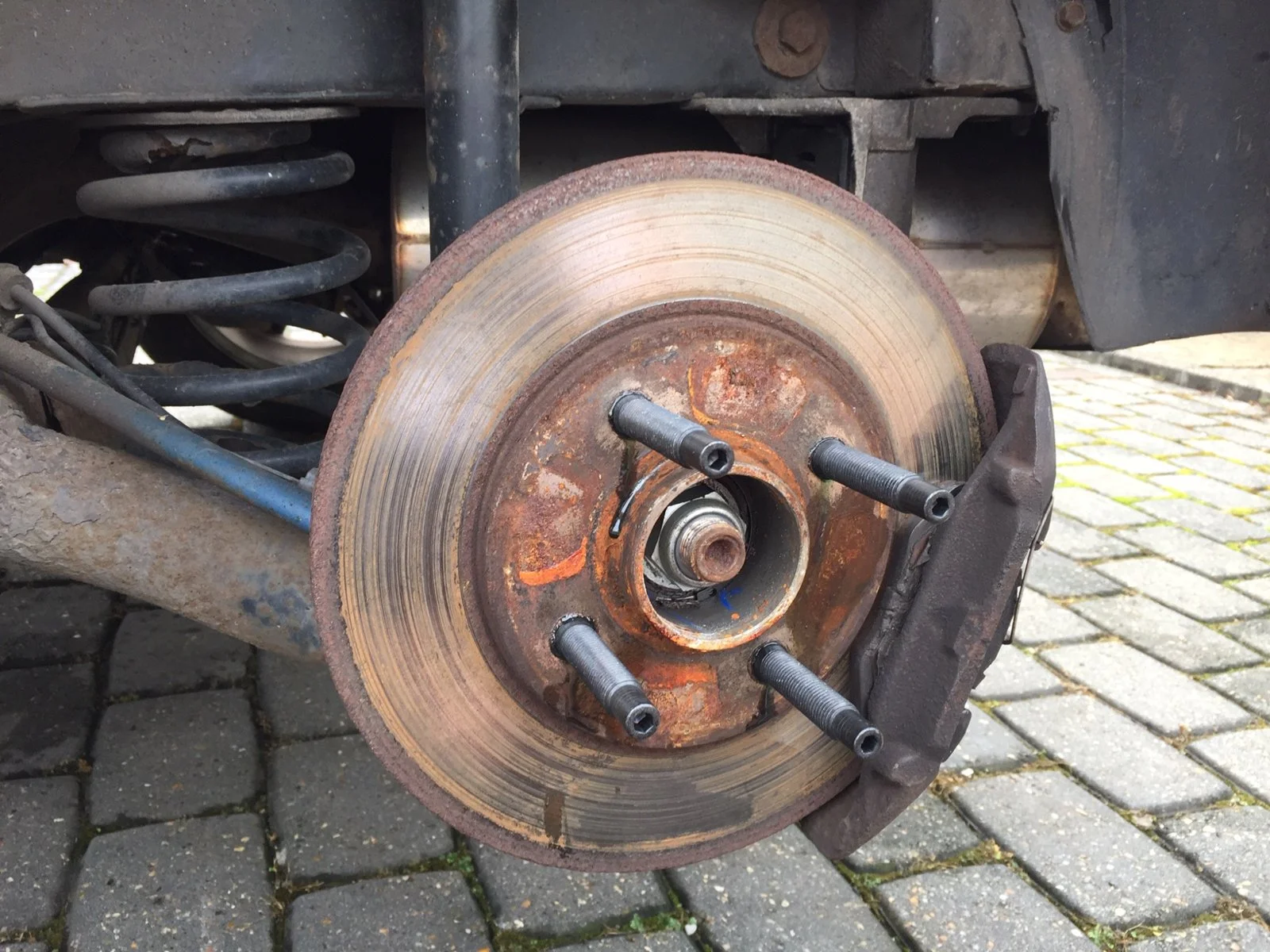

Stud conversion, new wheels and tyres.
Potentially looking at doing a track day mid August and still have a long check list to get through.
1427493

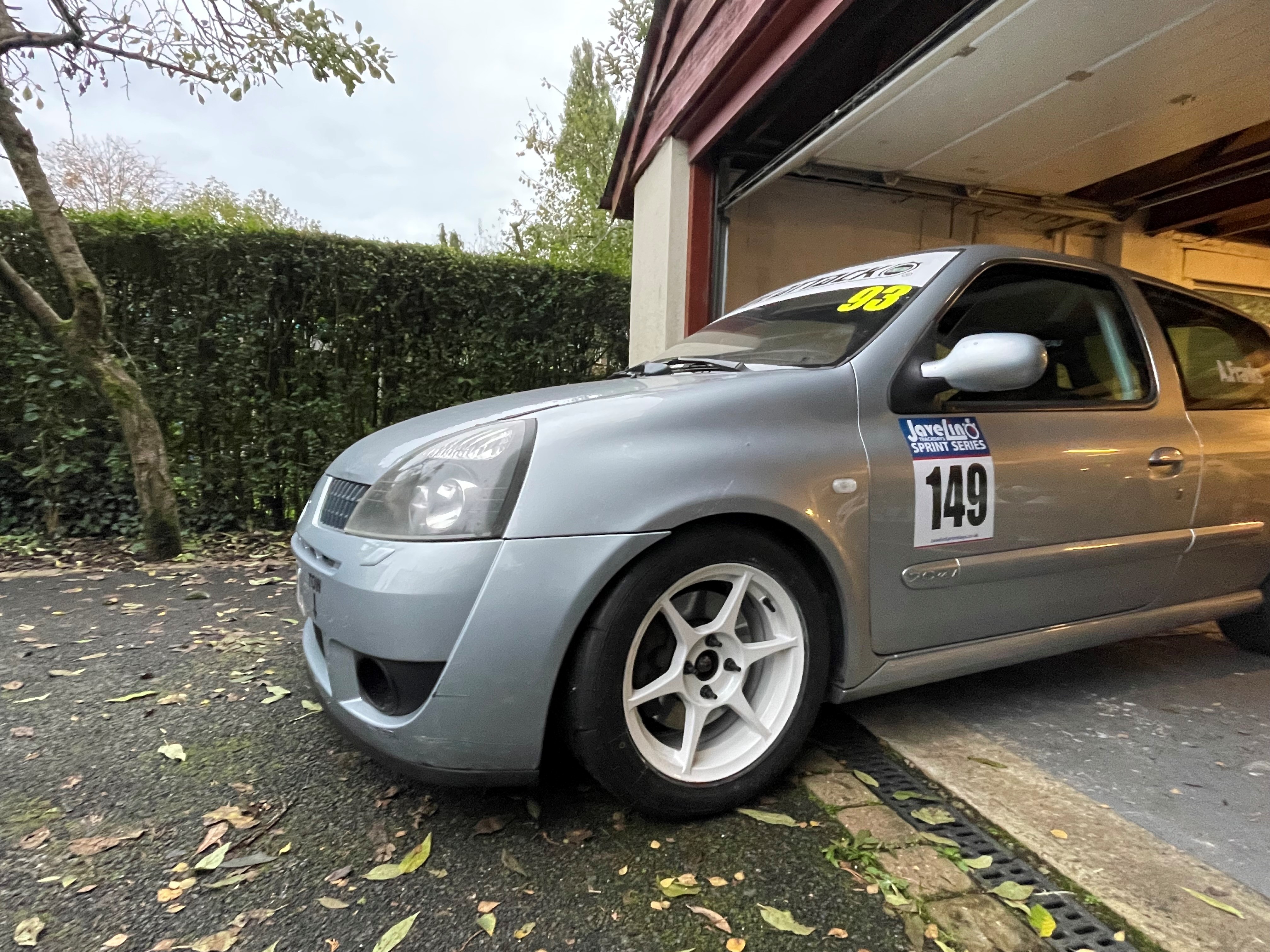

The stud conversion really is an easy straight forward job. These studs are also long enough for me to run a spacer should i want to in the future.
Then came the wheels. I looked around for a good few weeks at different options. After reading a lot of builds, it seems everyone goes for the same sort of wheels. Team Dynamics, Speedline 2118's or the OZ F1's. These are all nice wheels but i wanted something slightly different. I came across an old set of Clio Williams wheels. From what i can gather, these are relatively hard to come by so i snatched them up. Theyre currently wrapped in a set of AD08R's with plenty of life left.
The wheels themselves are rough and do need a refurb, but the plan is to put them on for now. Do a track day with them, then eventually send them off to be properly refurbed in white.
1427494
1427495

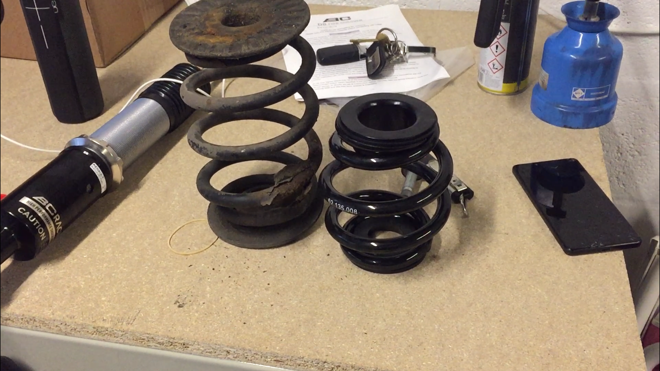

Really happy with the wheels. However it has highlighted the need for coilovers. I think once its sat lower, with the wheels refurbed in white. It should look really smart.

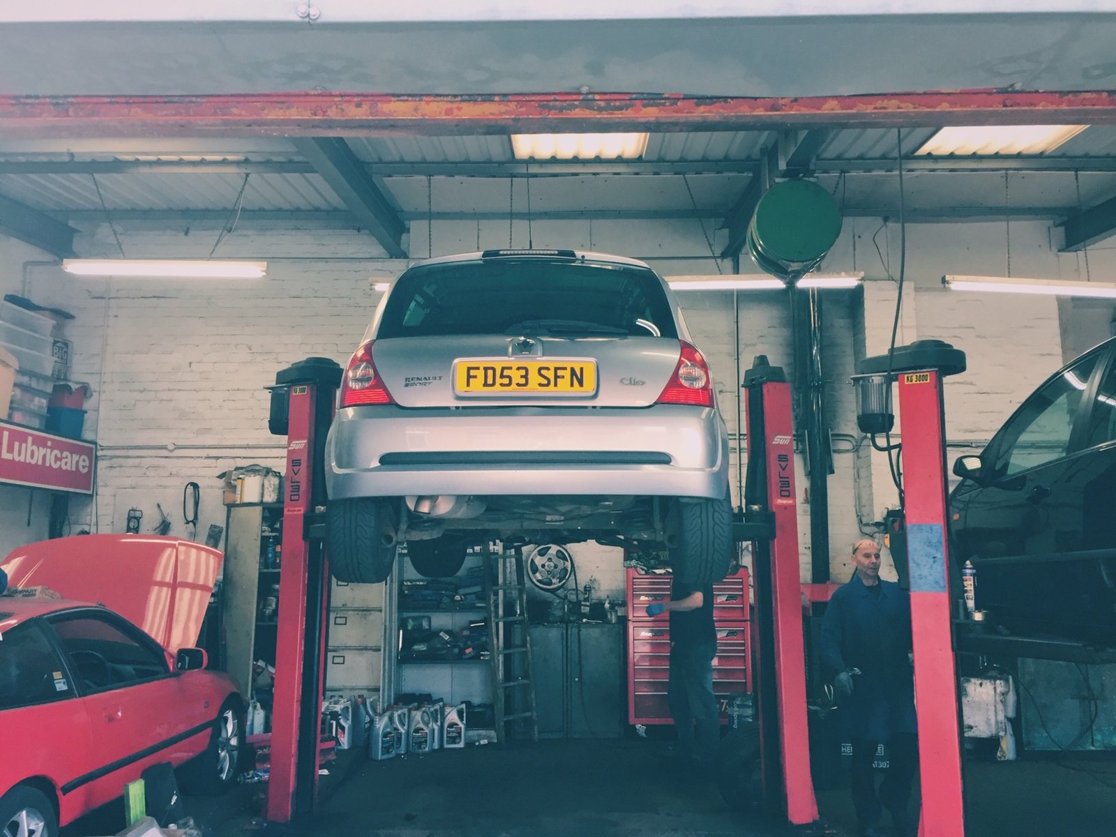

Took a day off work last Friday to make more progress. Used a friends lift and gave the car a bit of a service. Jobs included:
- New engine oil
- New Oil Filter
- Draining the brake fluid and filling with Motul RBF 660, then bleeding the brakes
- New coolant
All of which im hoping will keep the engine and brakes happier when im on track.

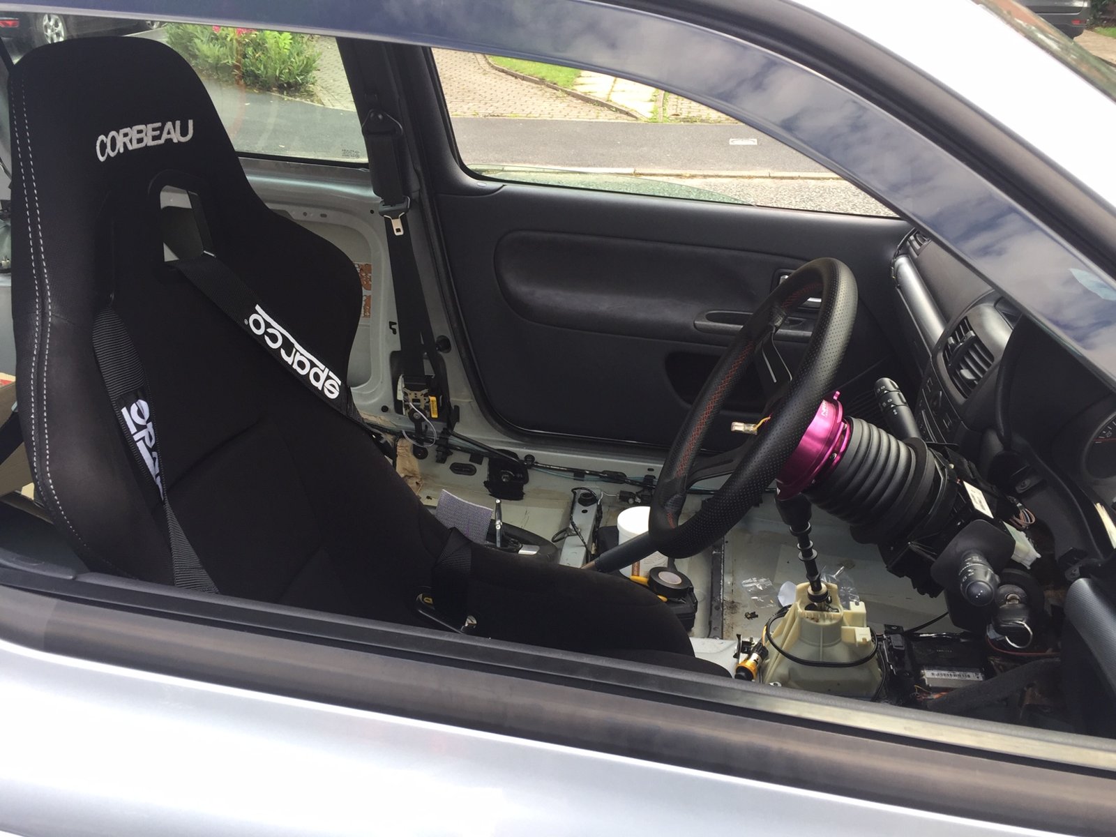

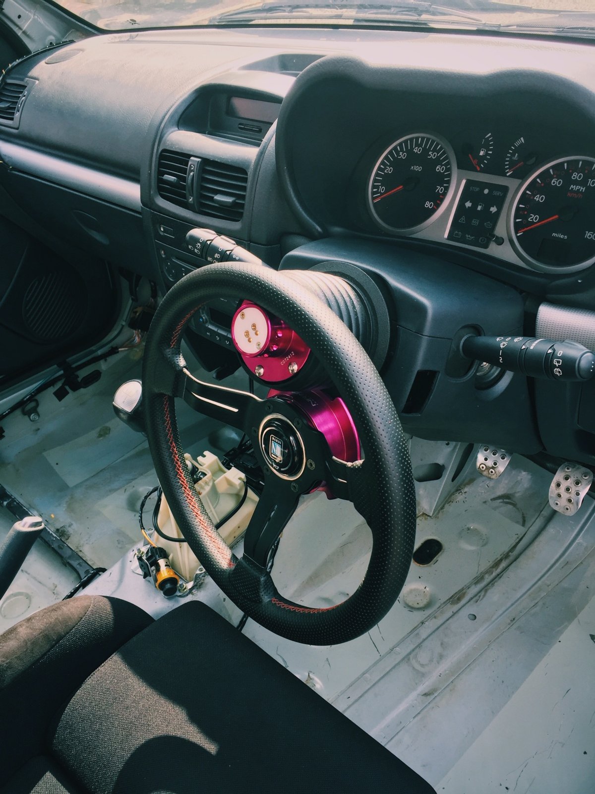

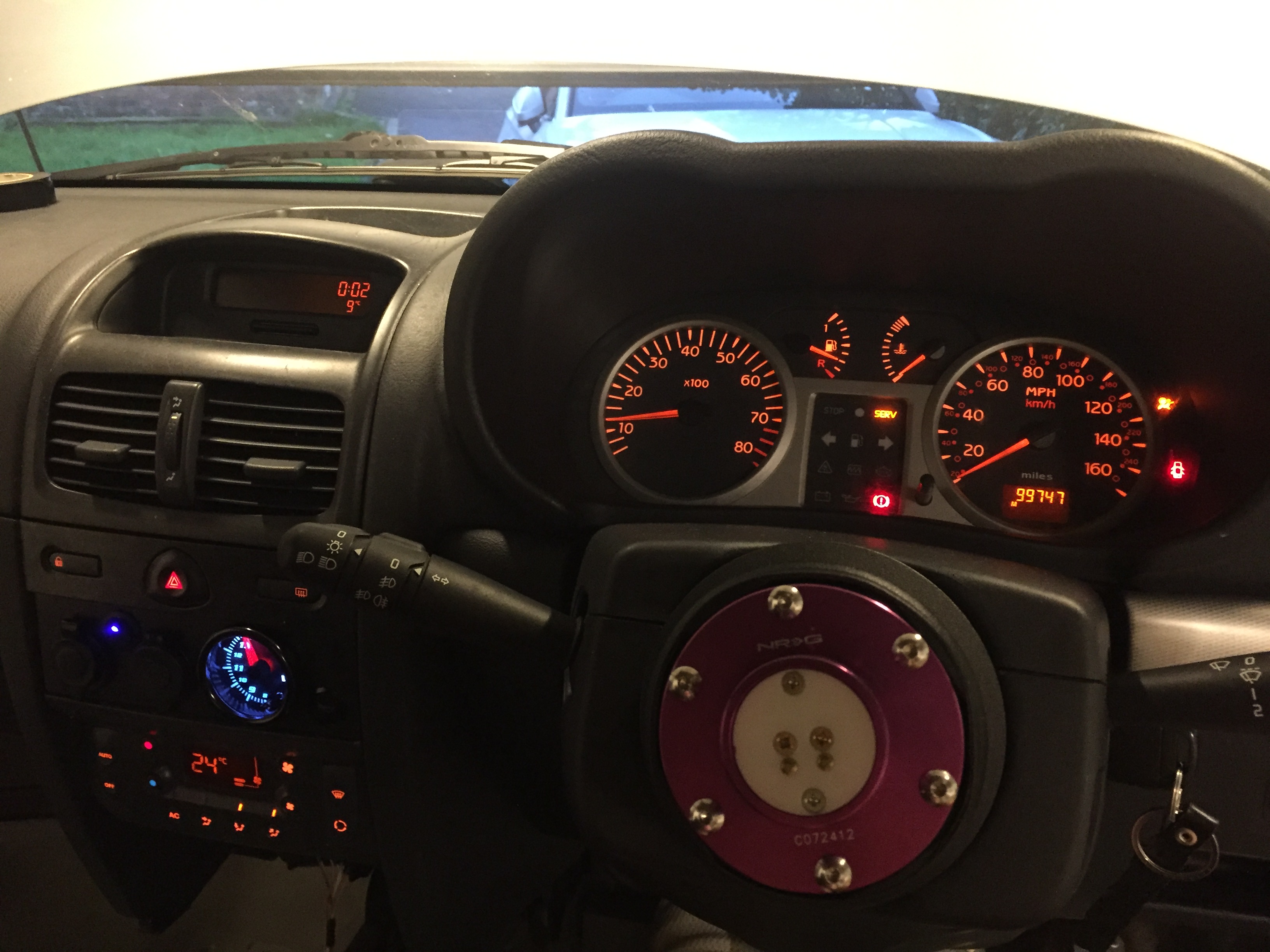

I then set about changing the horrible melting stock steering wheel.
Before:
1429076
After:
1429077
The set up is an OMP Boss attached to an NRG Quick Release, which is then attached to a Nardi Deep Corn 330mm wheel.
Its a set up ive ran in a few projects in the past and works well. Main reason for the snap off, is just so its easier to get in and out of the car now that i have the bucket seat in.
1429078
Sits much closer to the driver
1429079

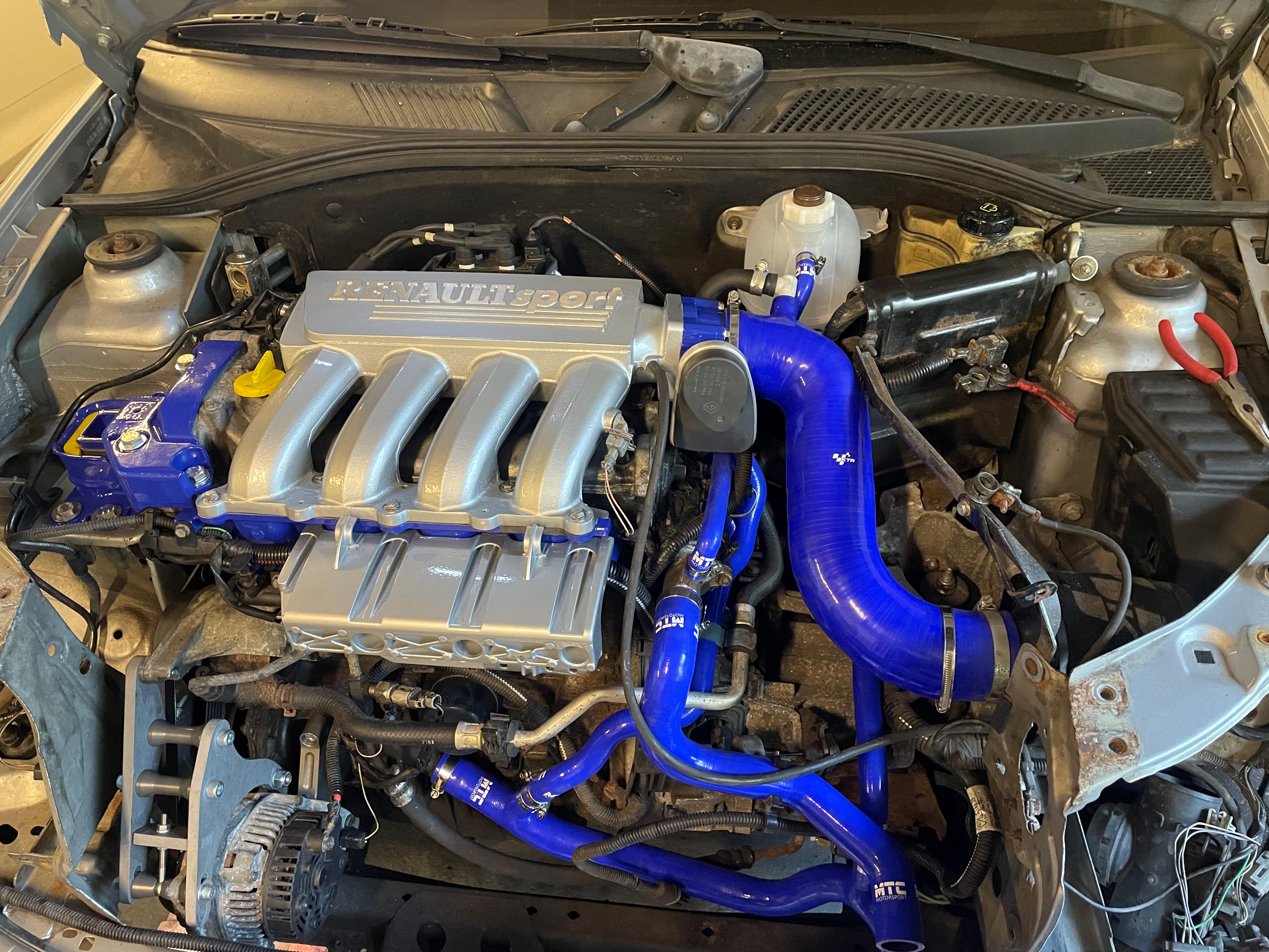

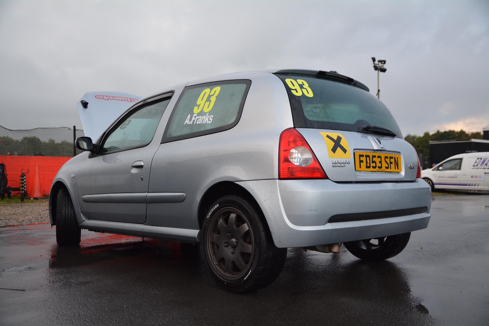

After the last update, the plan was to attend Oulton Park for a track day on the Saturday 17th August.

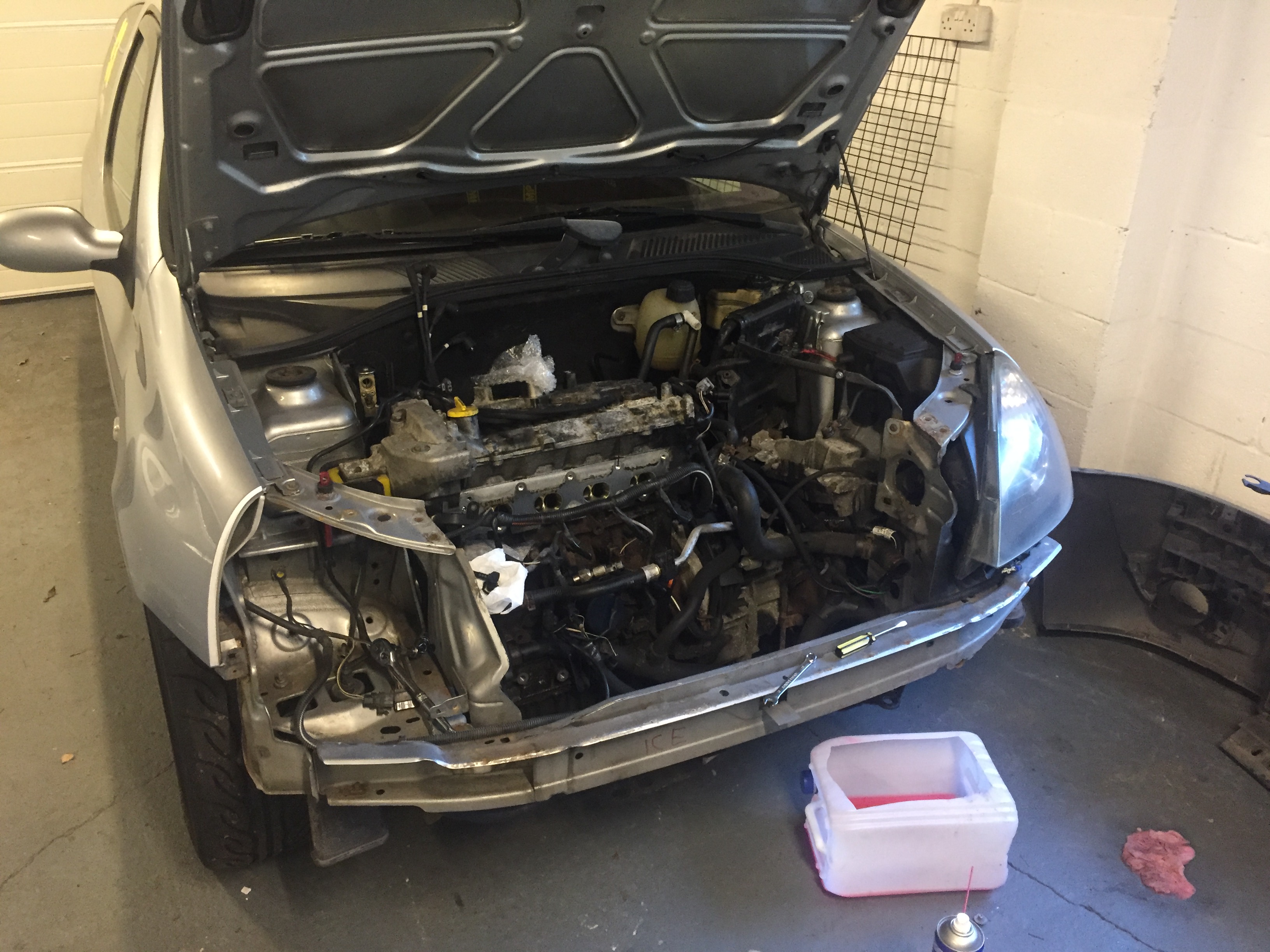

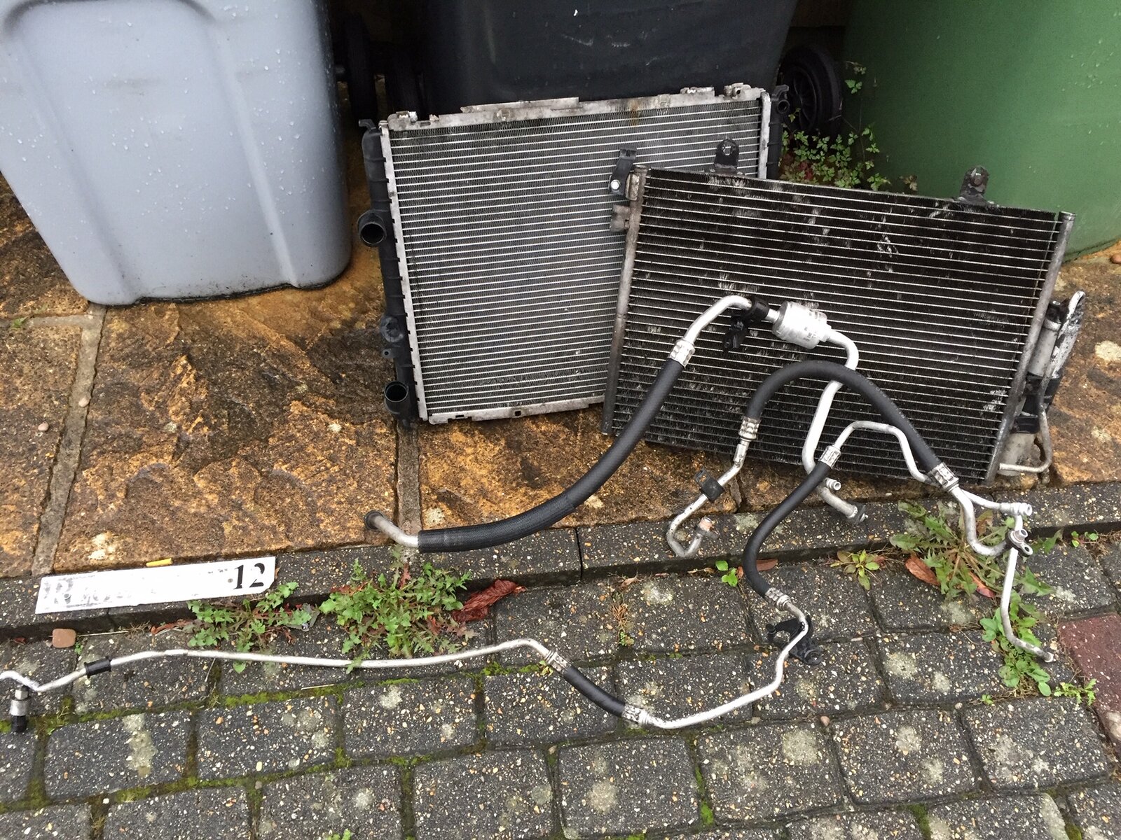

However, 2 days before, disaster struck. I notice whilst doing a bit of testing, that the car was leaking coolant. Upon further investigation that radiator had completely had it. Up against time, i grabbed a deal on Euro Parts and collected a new radiator the next day.

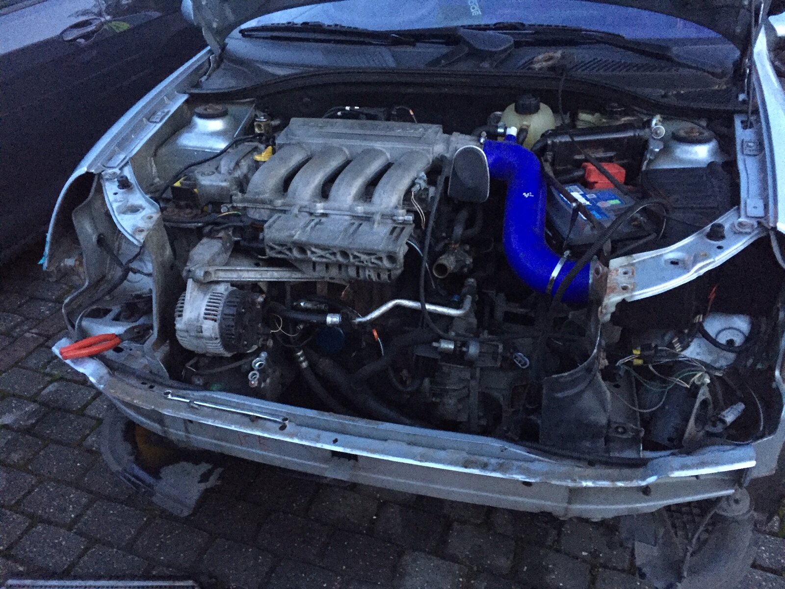

Started stripping the front end and noticed the old radiator and the A/C radiator was completed rusted out. Im suprised it was still on the car, the smallest of pushes saw the whole thing fall out. Im glad i caught this before it happened on the road. Figured while the front of the car was off, may aswell remove all the piping for the A/C.
Radiators and piping removed...
Quickly dropped the new radiator in.. and at 11pm the night before the track day, it was all bled, tested and back together. Happy days!

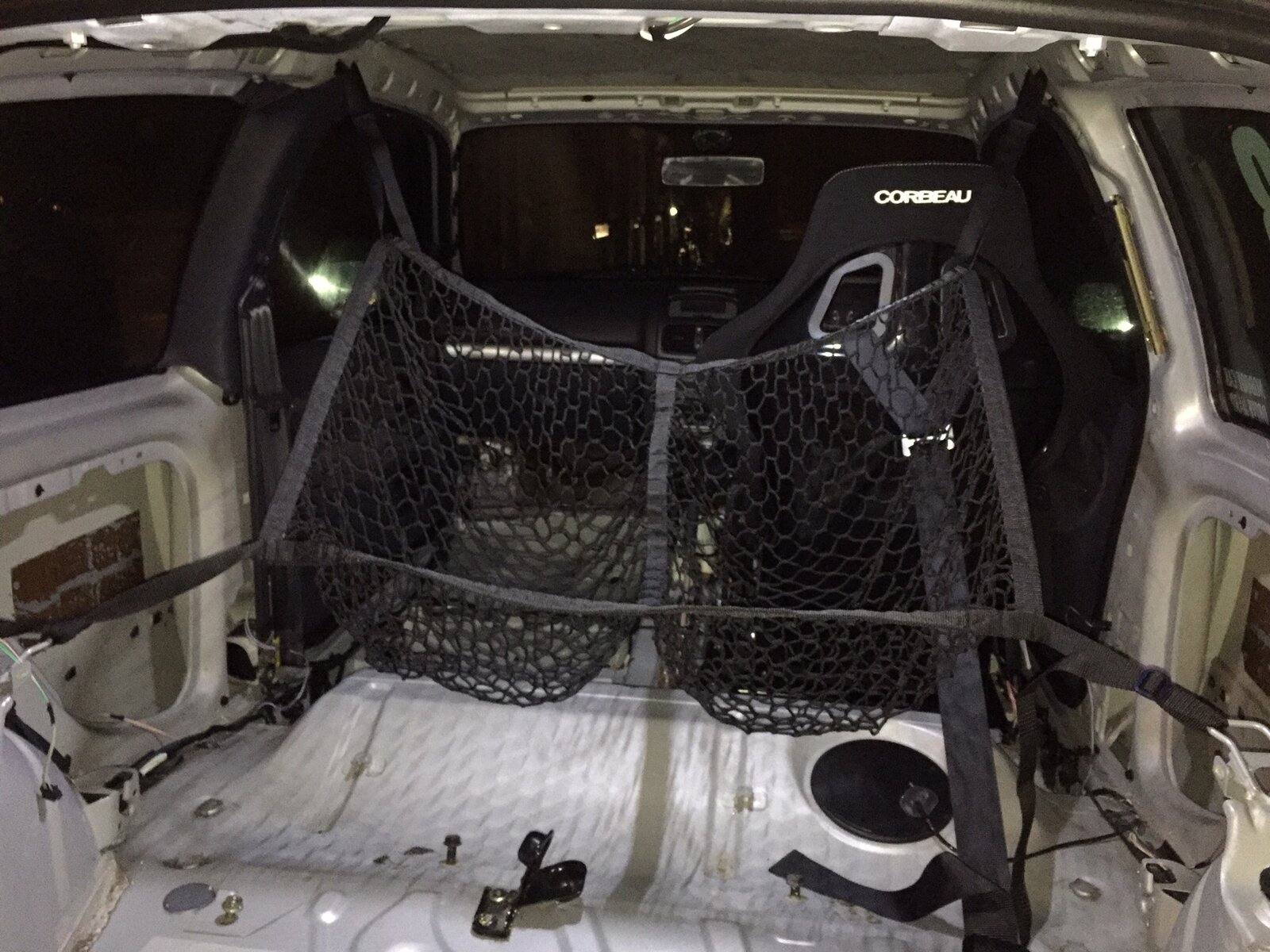

Also added a helmet net which id be meaning to put in the car. Really handy for carrying luggage/helmets etc to the track when you have a stripped interior.

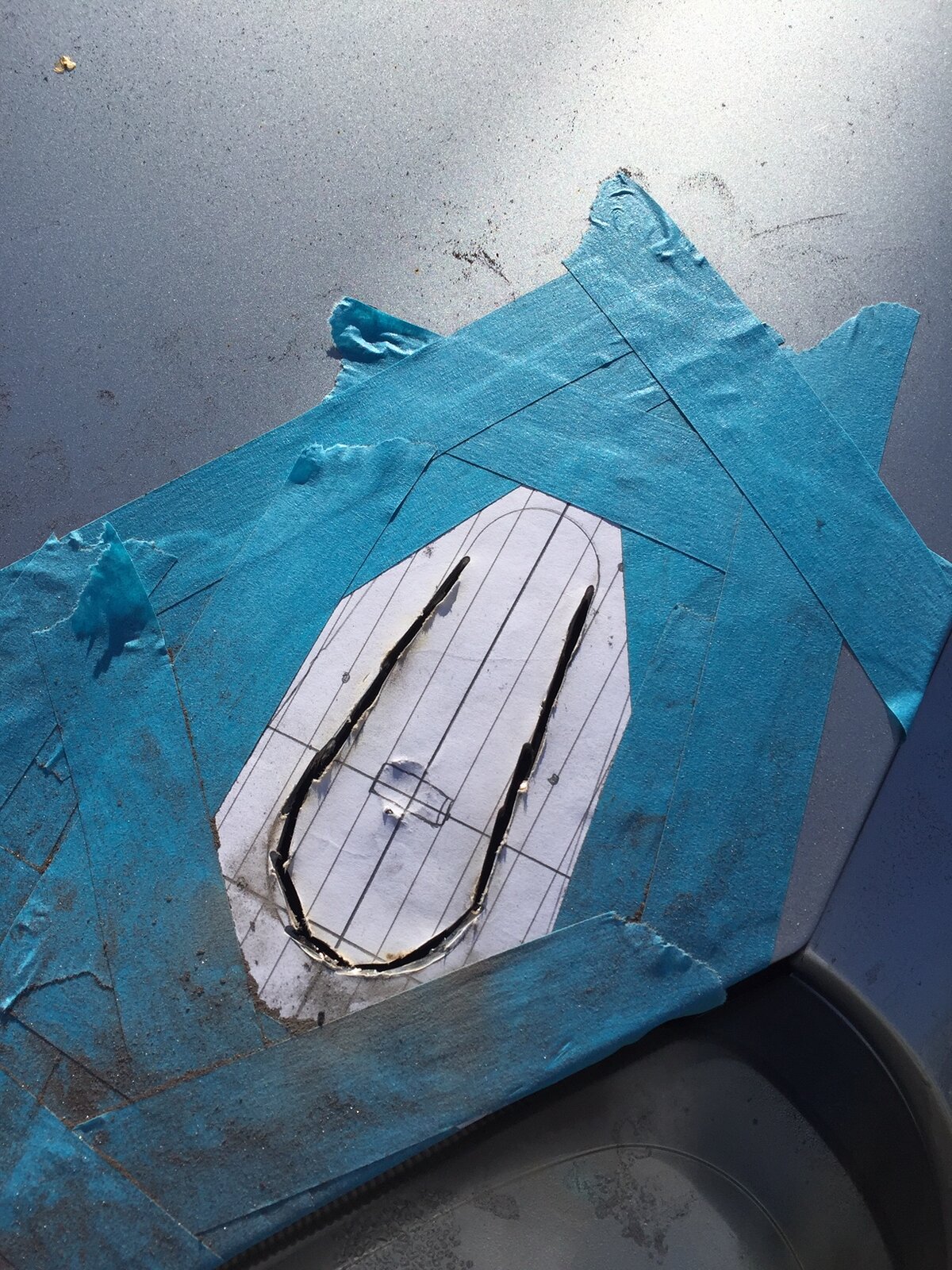

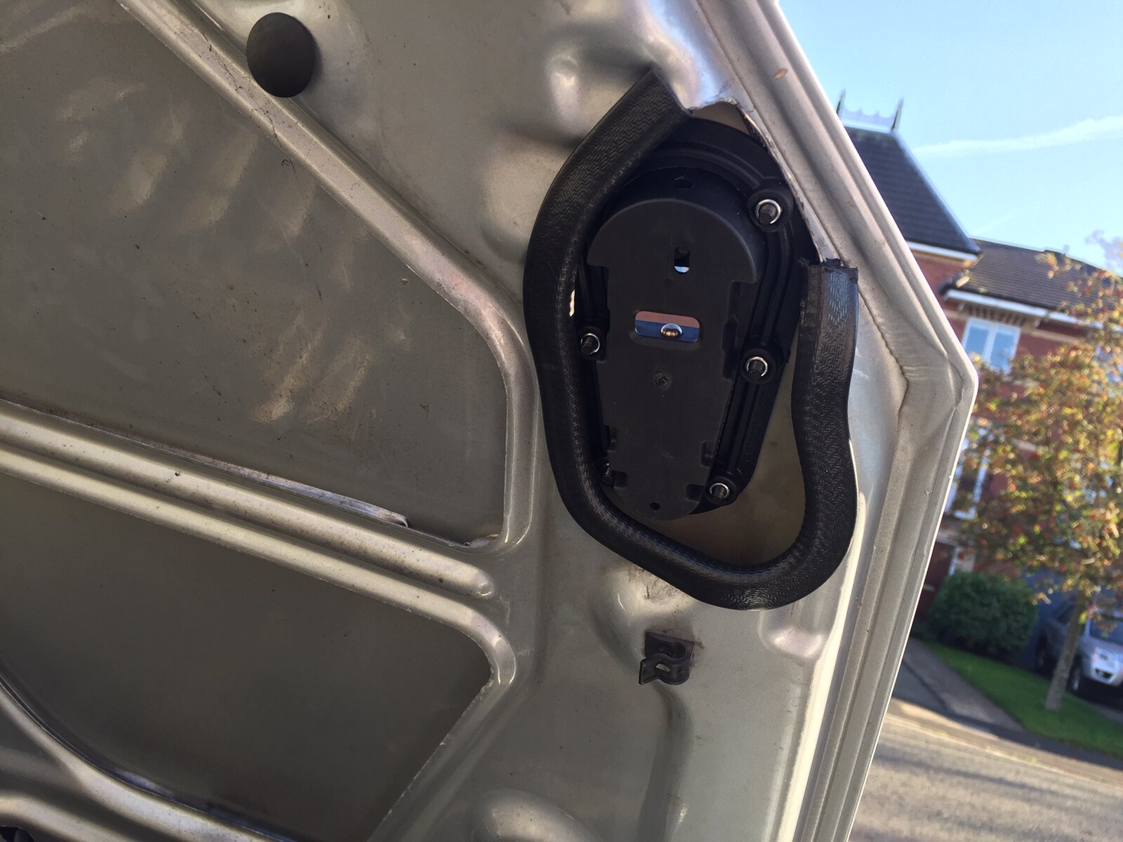

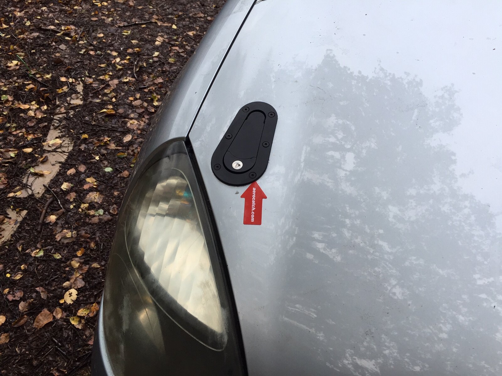

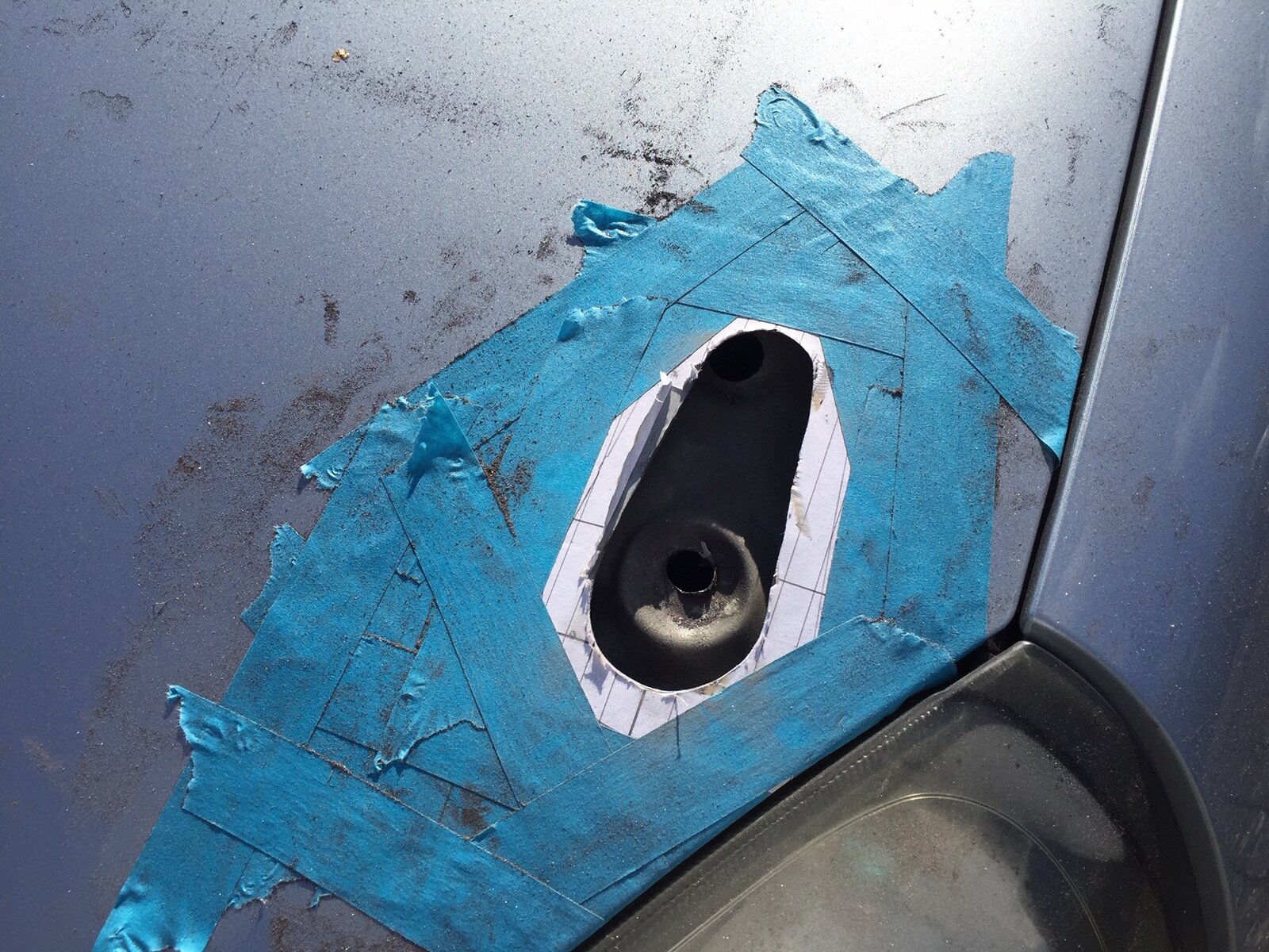

Went about fitting some Aero Catches. I drew up a stencil on paper then measured it up on the bonnet and set about cutting it. I personally used a dremel with a disk to cut the initial shape. Then using a sanding wheel on the dremel, I then smoothed out the hole until it was smooth. Now of course there are two layers of metal on the bonnets. And the layer underneath must be slightly larger to allow you to slide in the backing plate for the catches. See below:
Once id cut the underside of the bonnet. It had sharp edges and didn't look tidy enough for my liking. I smoothed it back and added some thing plastic edging. Tidies the whole job up and removes the risk of maybe cutting your hand on exposed metal when lifting the bonnet.
Once id cut this to size and added the catch, it looked like this
once id completed both sides and adjusted the height of the pins, they were fully secured and working. My only advice to anyone wanting to put these on their cars. Make sure you spend extra time and care measuring it so it lines up perfectly with the pin underneath.

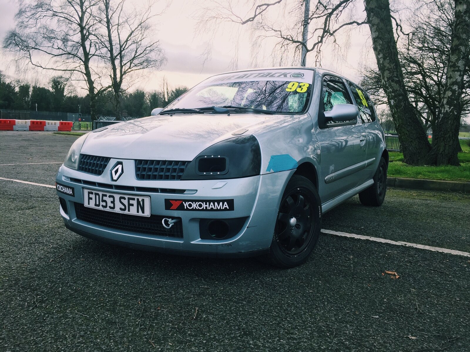

Been a while since i did any more work on the Clio. Still keen for a lot of track time this year. Lots of parts waiting to be fitted but waiting for the weather t obrighten up. I don't have the bonus of a garage, so waiting for dry weather is key.

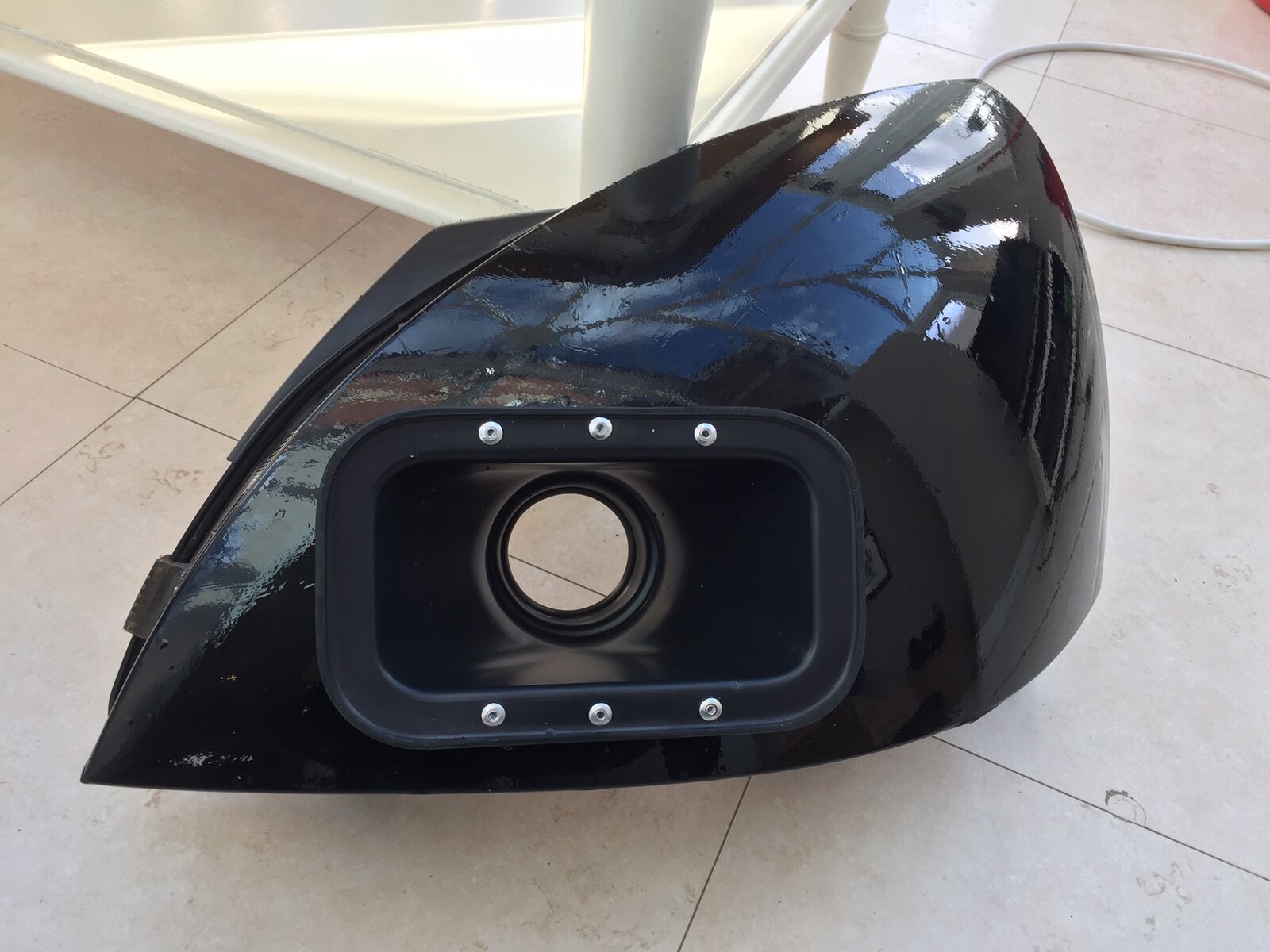

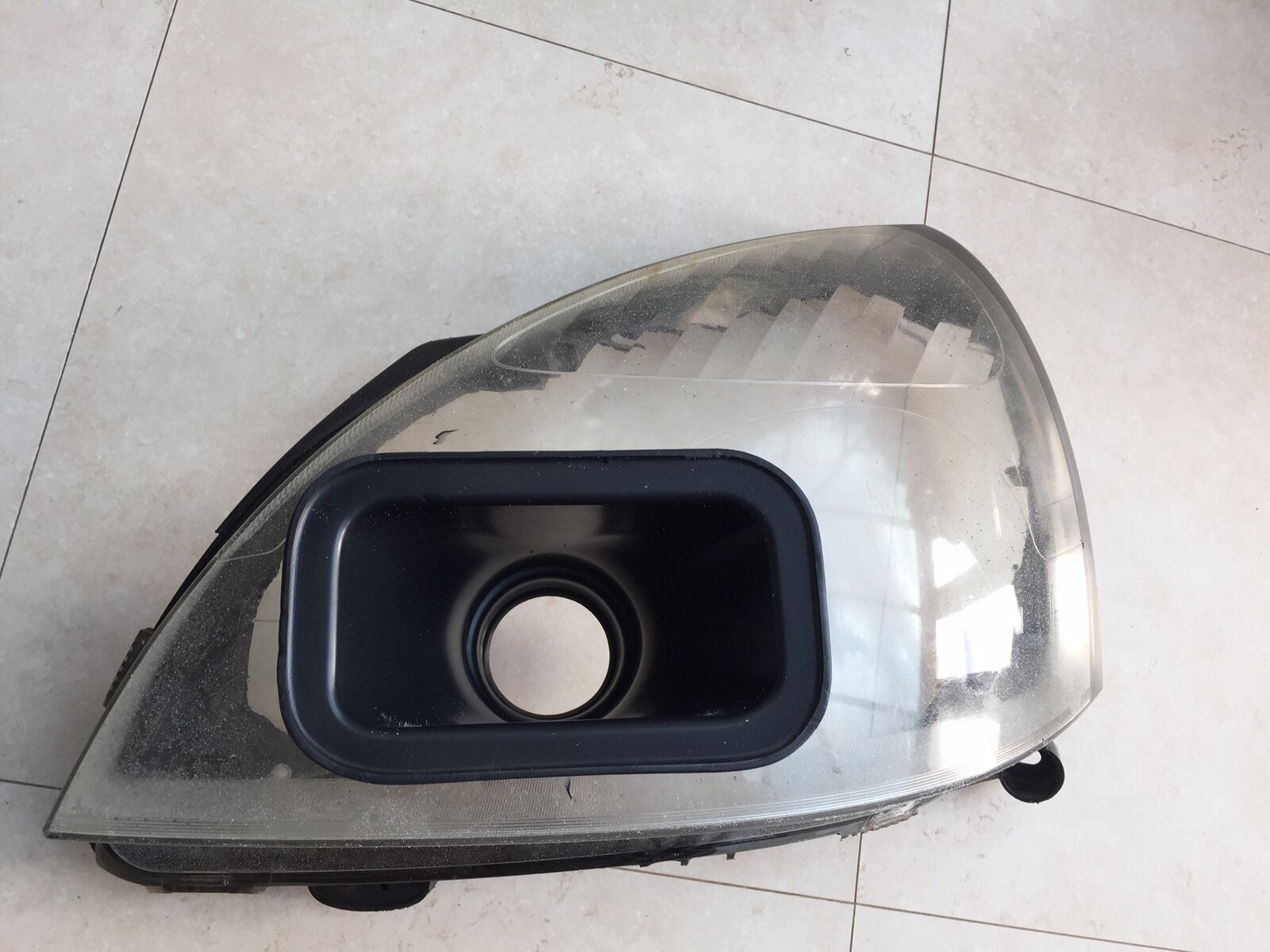

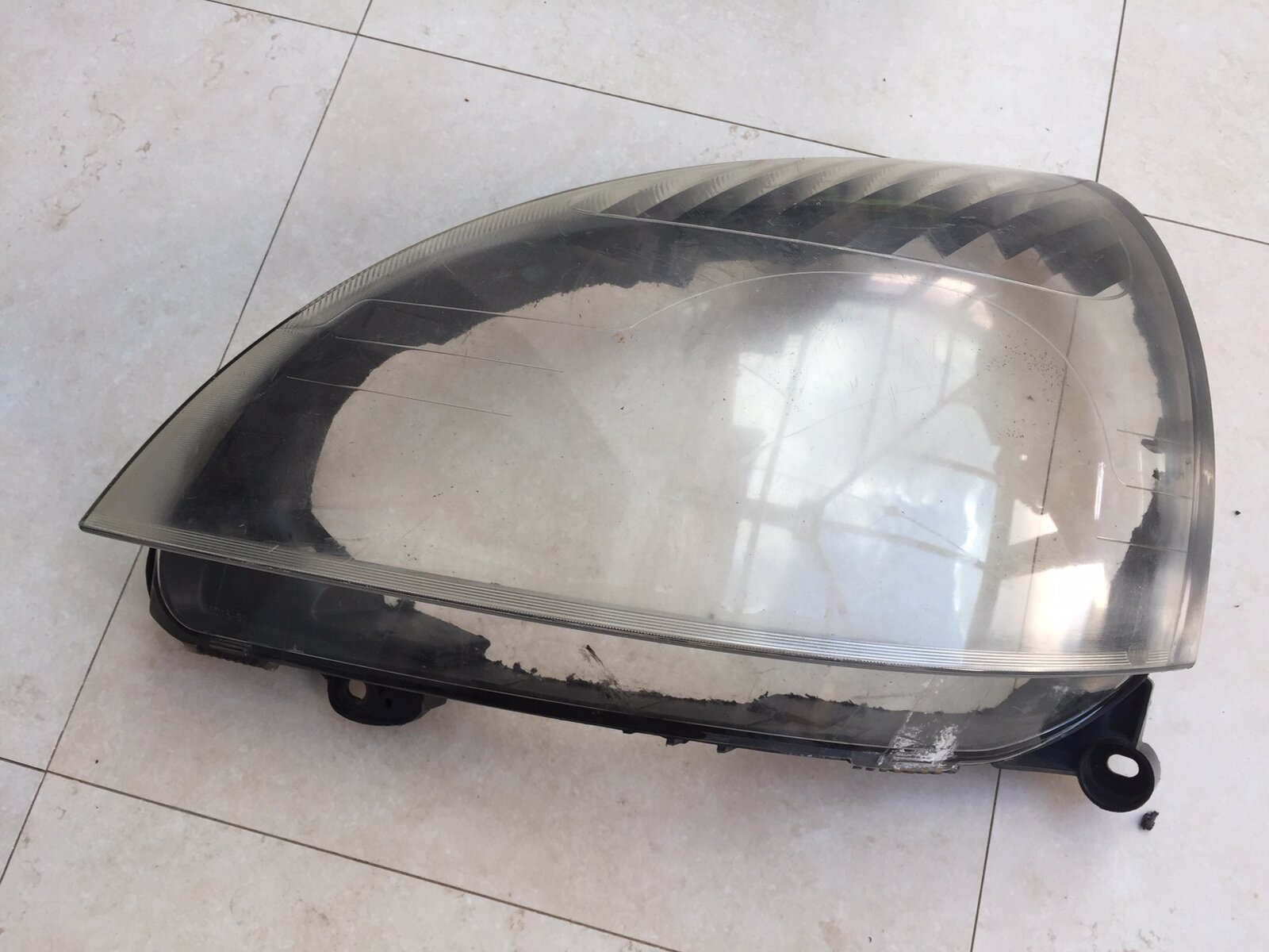

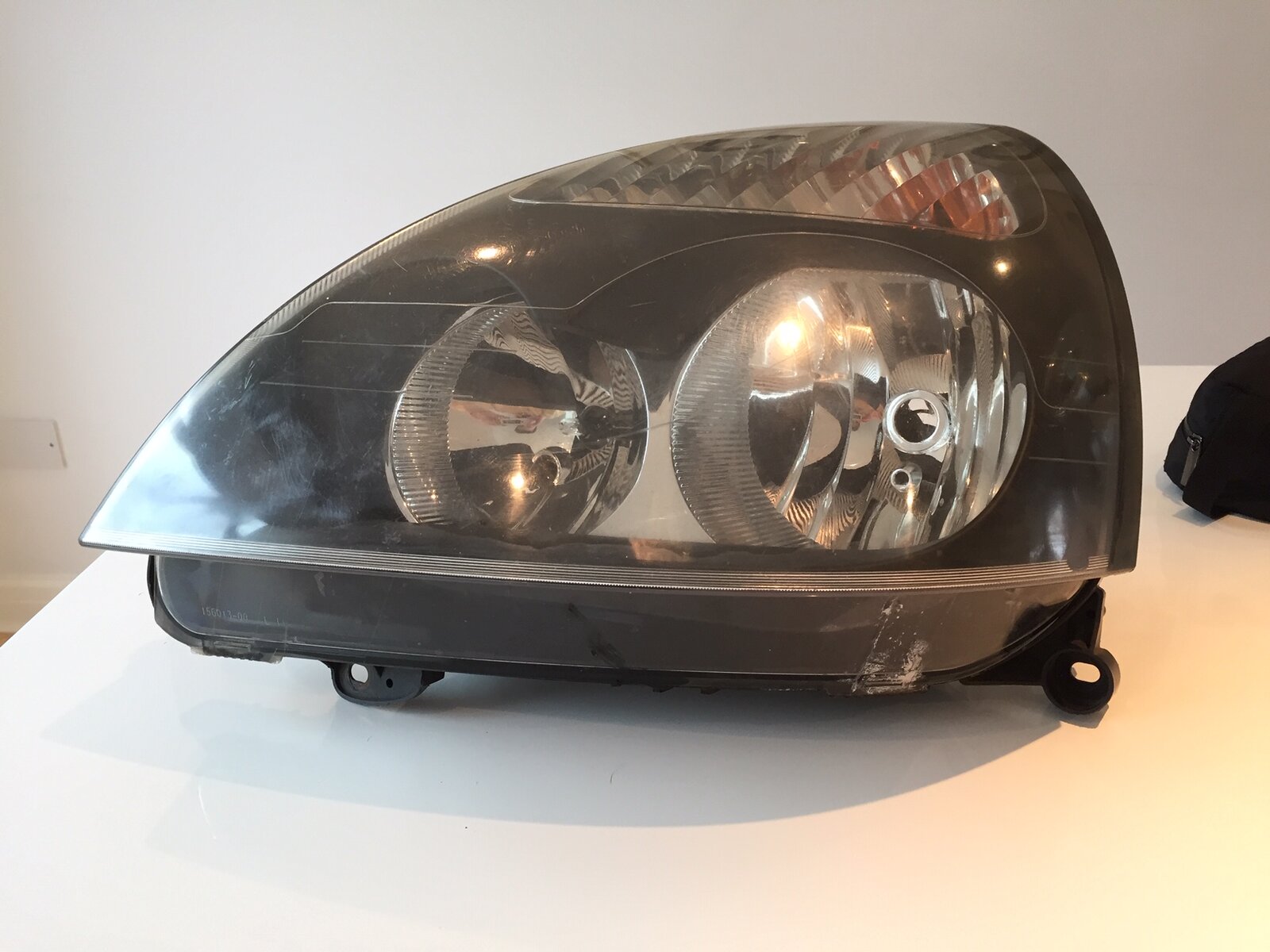

Decided to day to build something indoors, decided to make an air feed out of a spare headlight.
Started with said headlight...
Gutted this insides, cut everything out bar the plastic tabs which are needed to fit it to the car.
Started cutting a hole to make way for an air duct piece on found on ebay... dropped it in..
The to finish up, i wrapped the headlight in Black Vinyl and riveted the duct to the light.
The wrapping part was a lot harder than i thought, in hindsight i think paint would have been better. Not the tidiest job but it will do the job!!

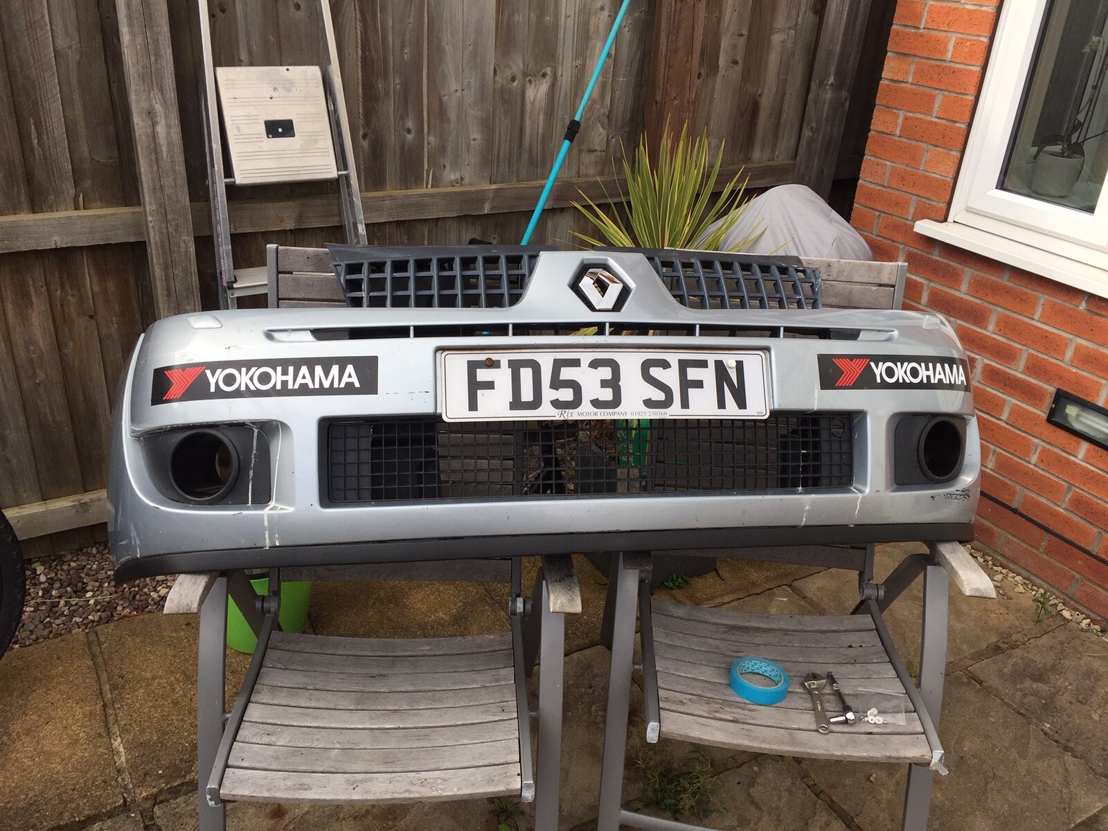

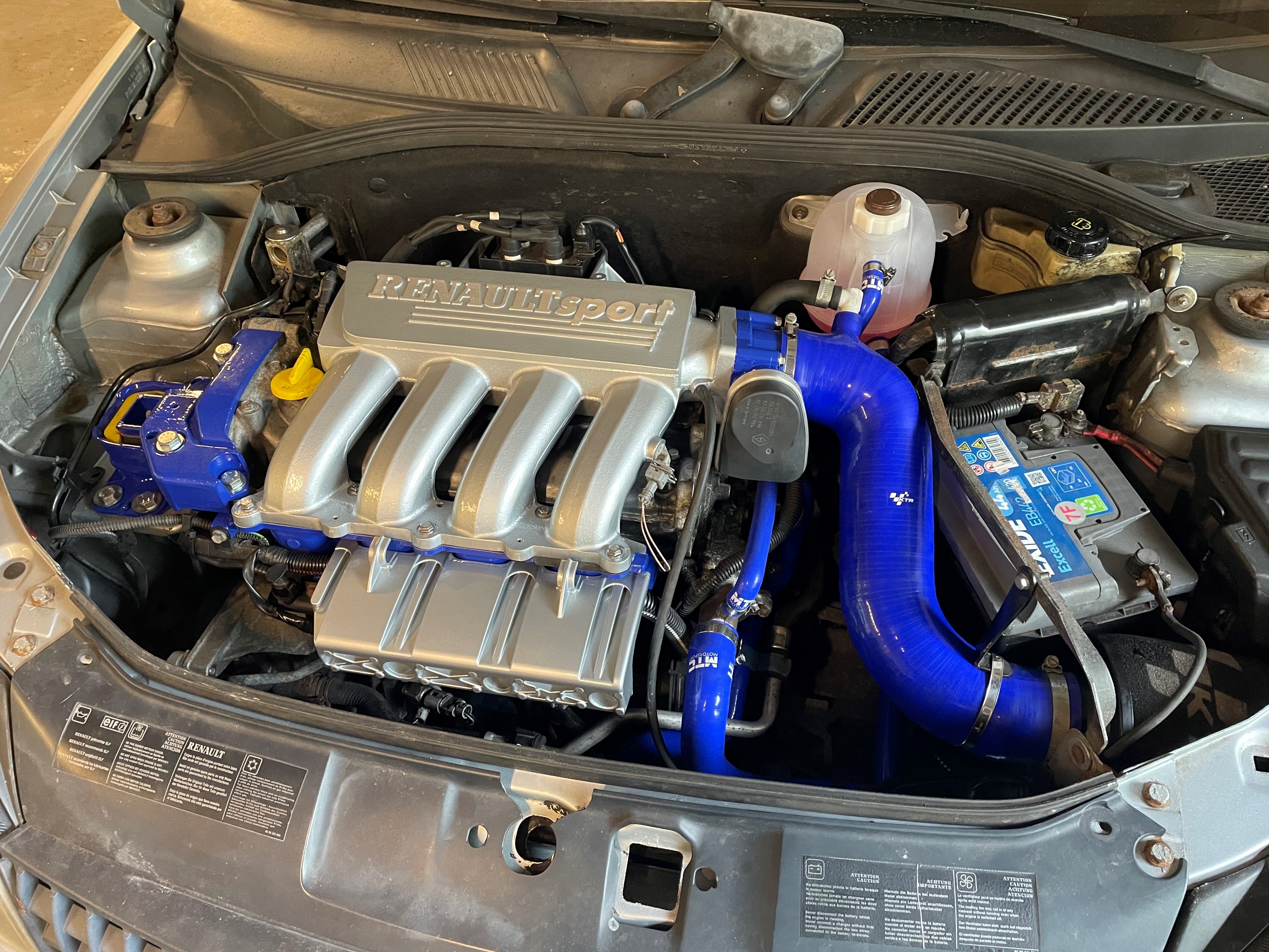

A few more smaller modifications. All to help with keeping temperatures down and making the car lighter.
First up, i removed the bumper, removed the fog lights and fitted some tubing. Seen a few people do this, makes sense to me feeding air straight to the brakes. I've also removed the arch liners so the air flow can go straight to the brakes.
Also added the Skoda Fabia front lip and trimmed it to fit.

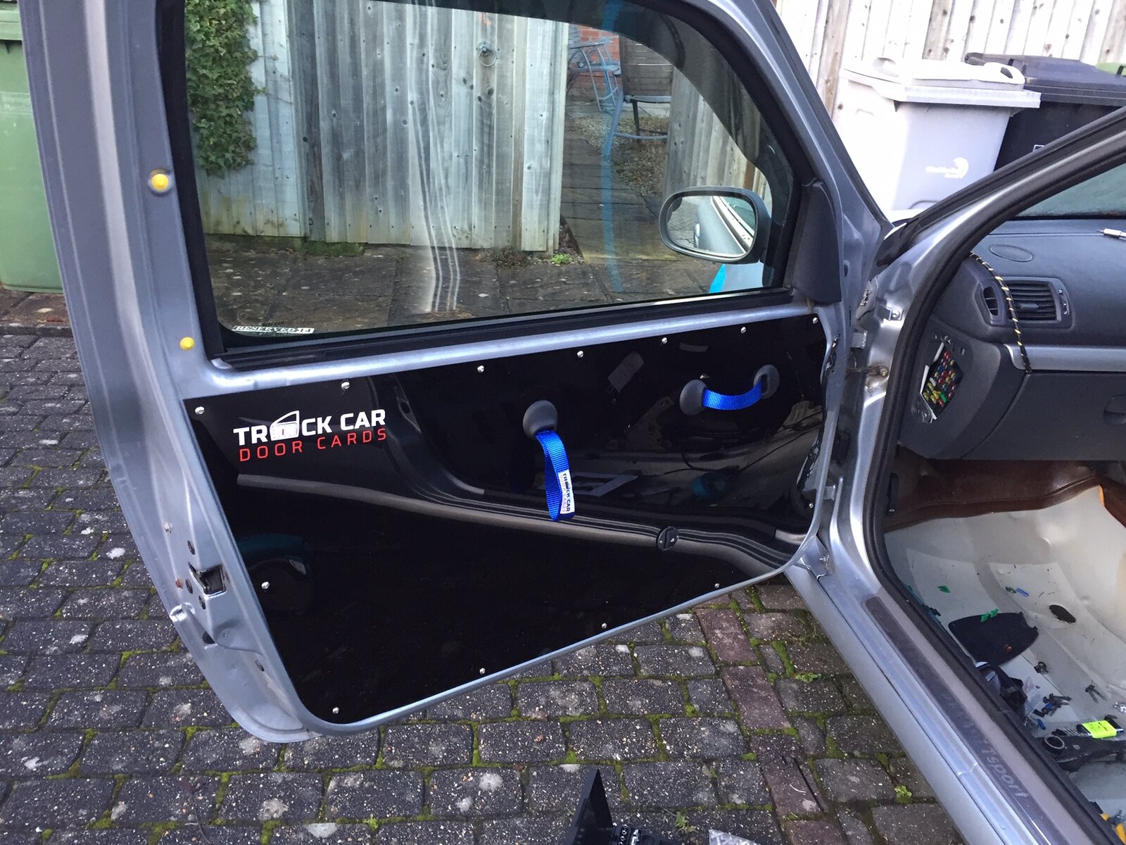

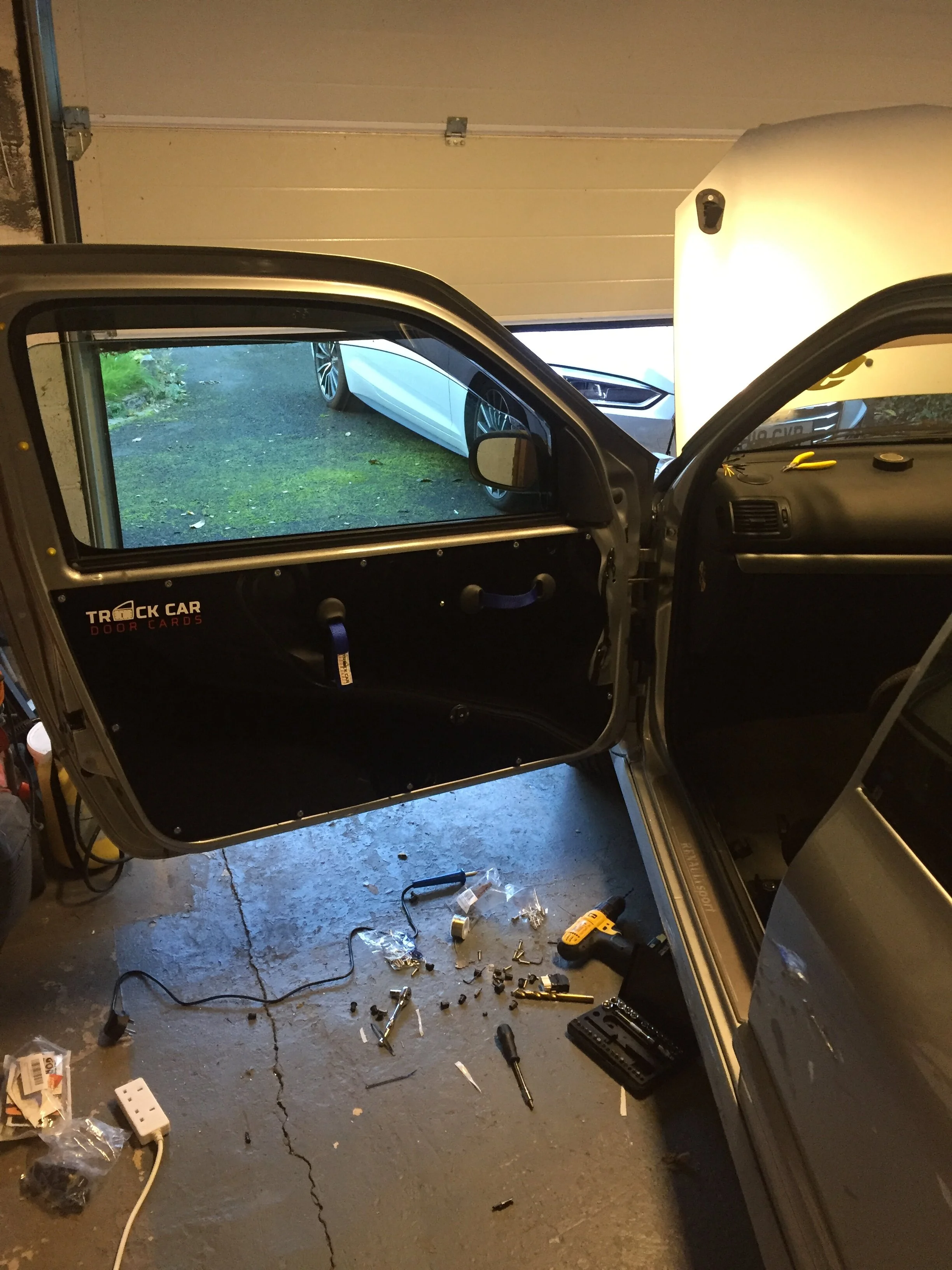

Next up was the doorcards, relatively straight forward fit. Takes a lot of weight out of the doors.

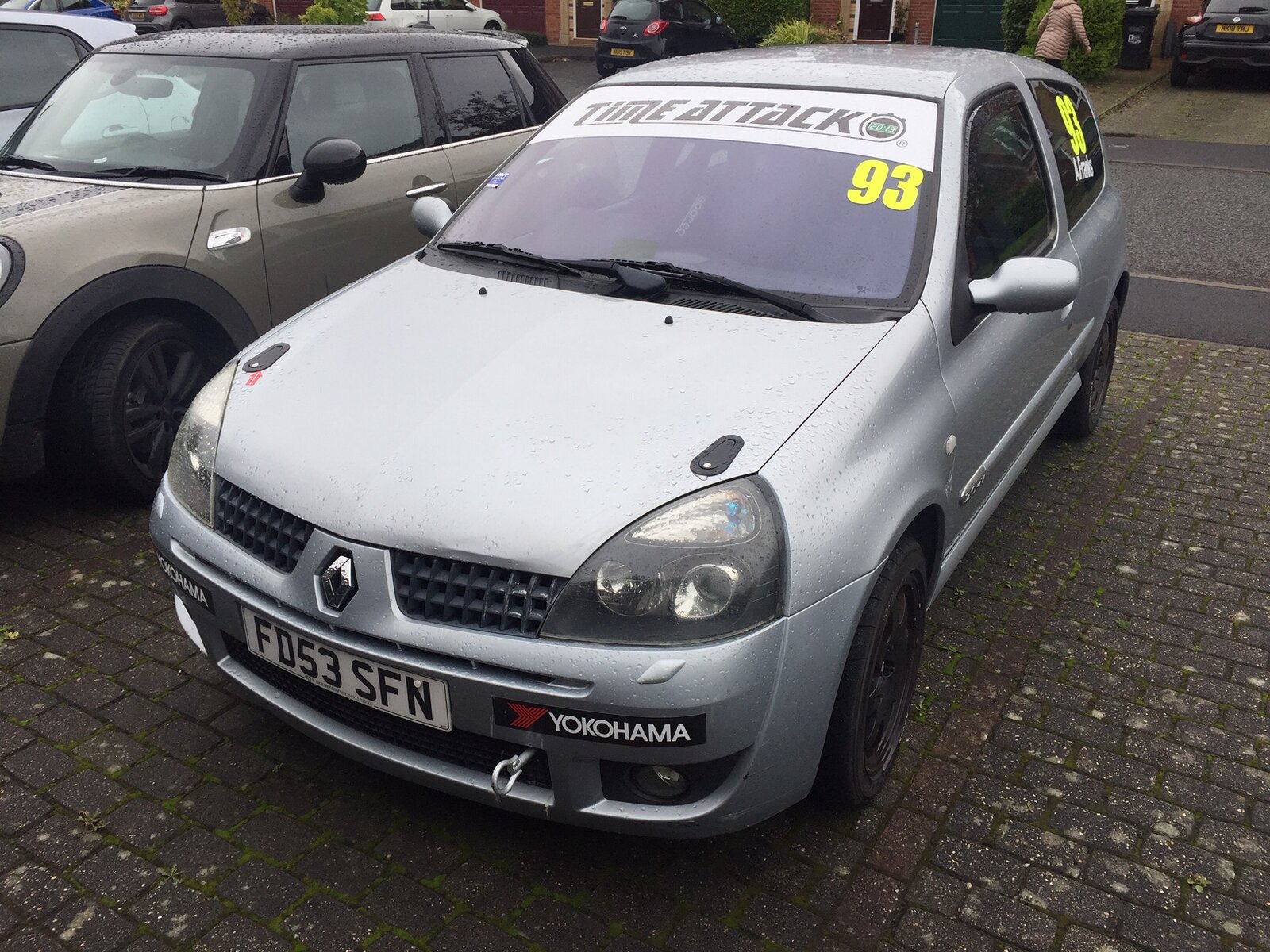

And finally, with all these bits done, i booked on at Oulton Park. Car performed well. Still need to address the suspension & brakes. Both could do with an upgrade. This will be done soon along with a roll cage.

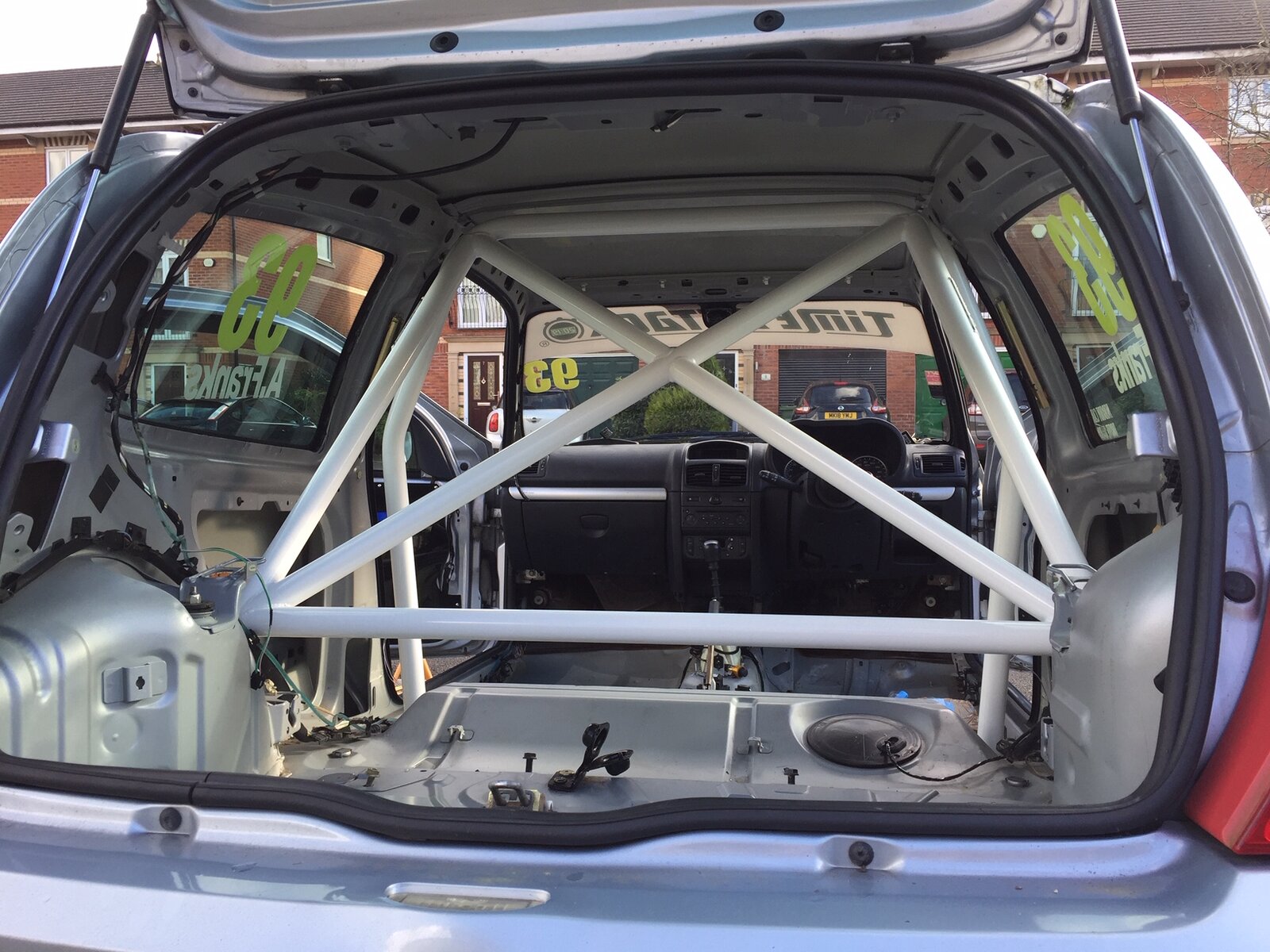

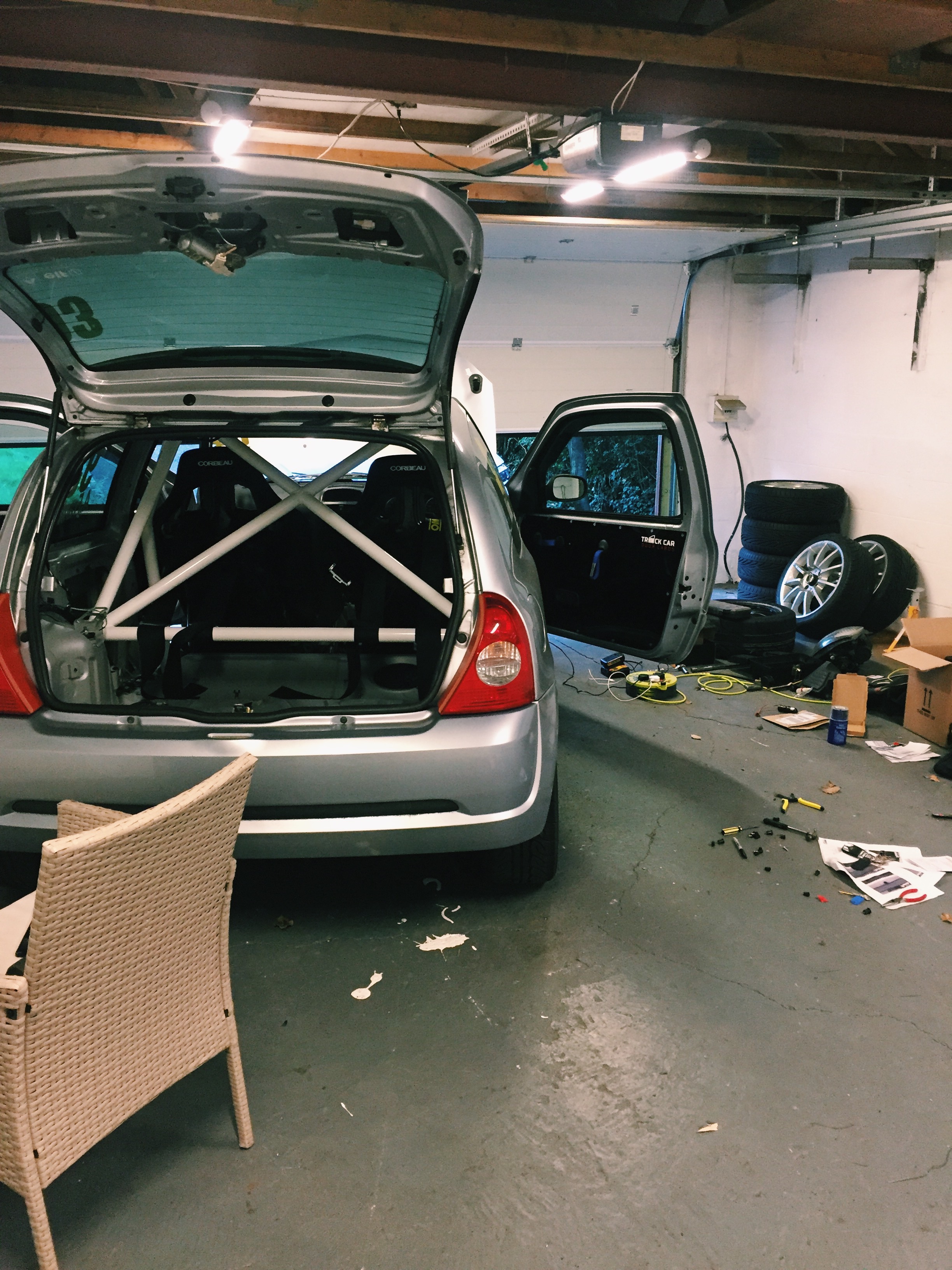

Decided the weather was dry enough to start fitting my cage this weekend.
Will get more pics in when the seats and harnesses are back in! Looking to get the wheels refurbed in white to match the cage.

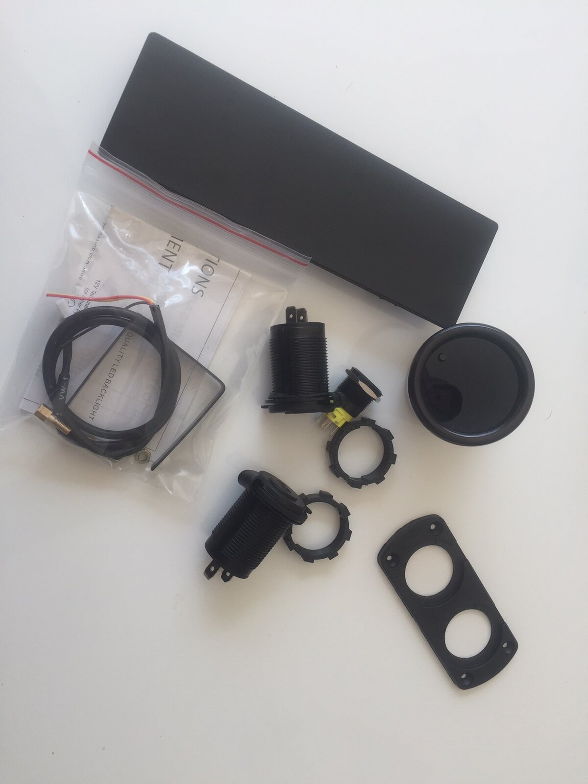

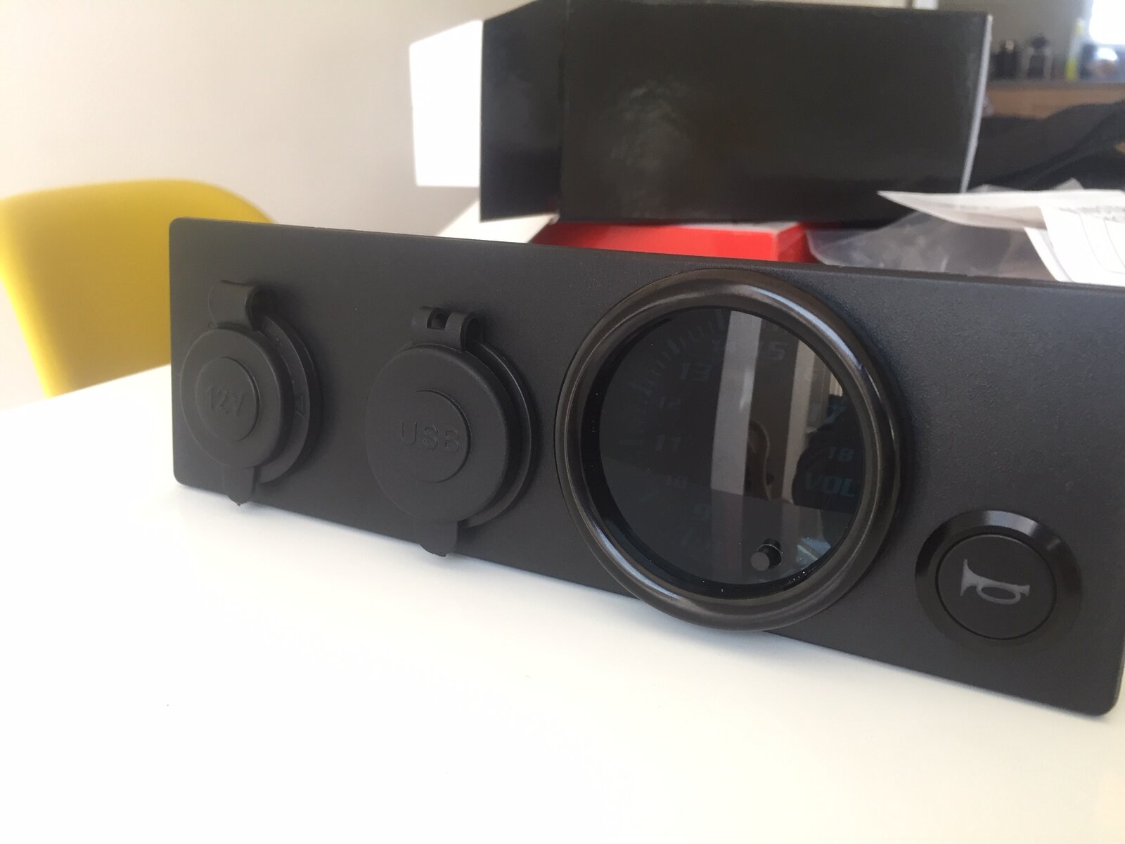

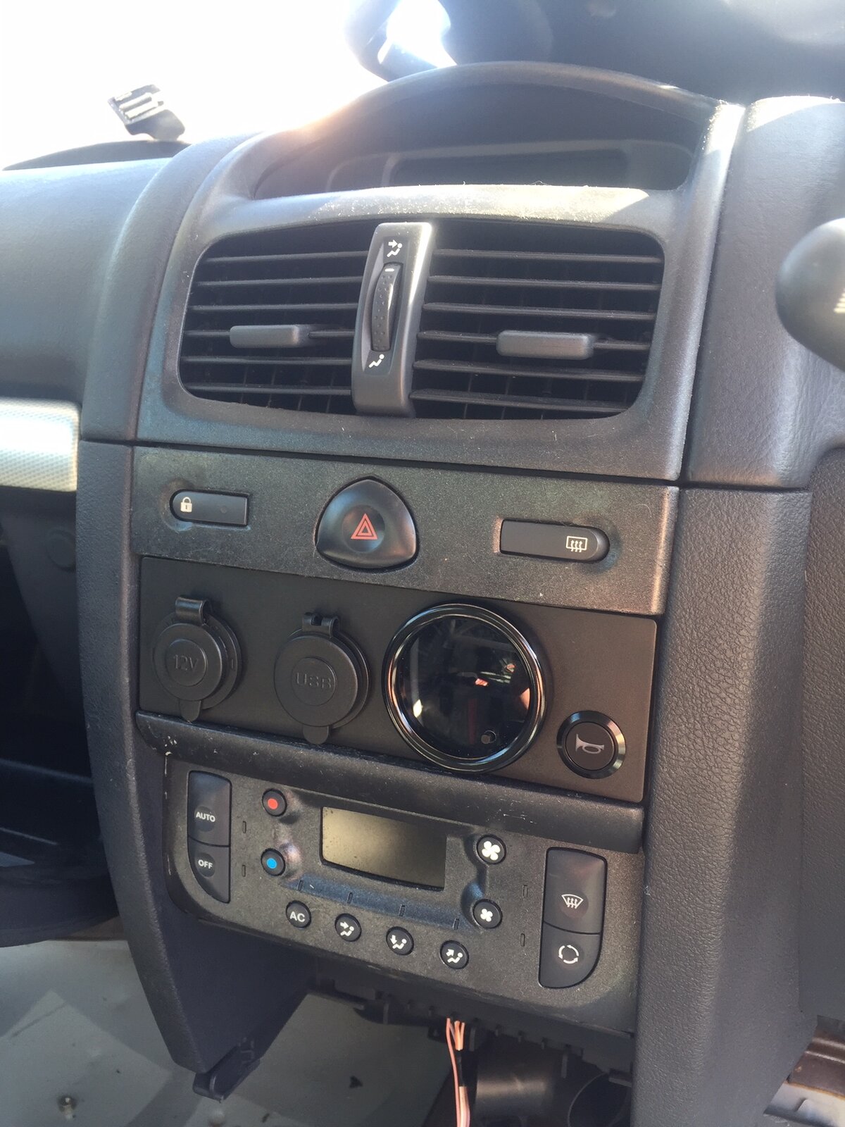

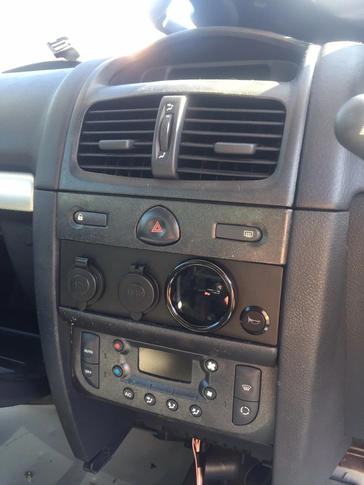

During this process, i got rid of the radio and figured id make something to replace it.
Started with a head unit blank plate and few random bits and bobs id gathered off ebay.
Carefully cut and drilled out a few holes and that gave me something looking like this...
Features a button for the Horn, a voltmeter, a USB socket and then a normal cig lighter style power outlet. Should be useful for charging my phone when out and about in the car. Looks better than a hole in the dash anyway!
Just waiting on some red and black wiring i the post so i can make a little wiring harness to power it all. Will be using the original wires for the stock cigarette lighter to power it.

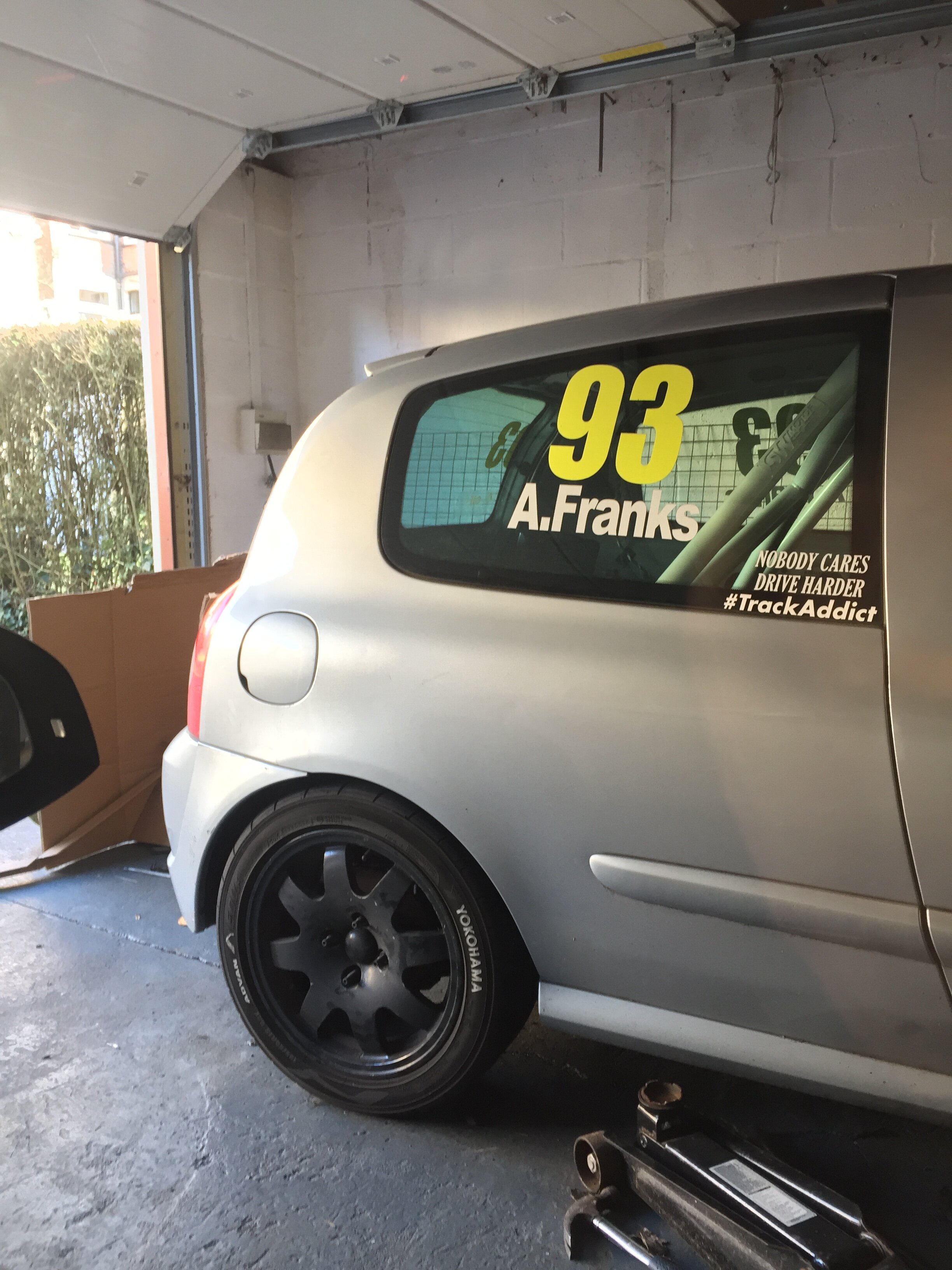

Since the last update, i finished installing the cage, added another seat and installed OMP 6 point harnesses. Then went to Oulton Park! Car drove well but still highlighted the need for better brakes.

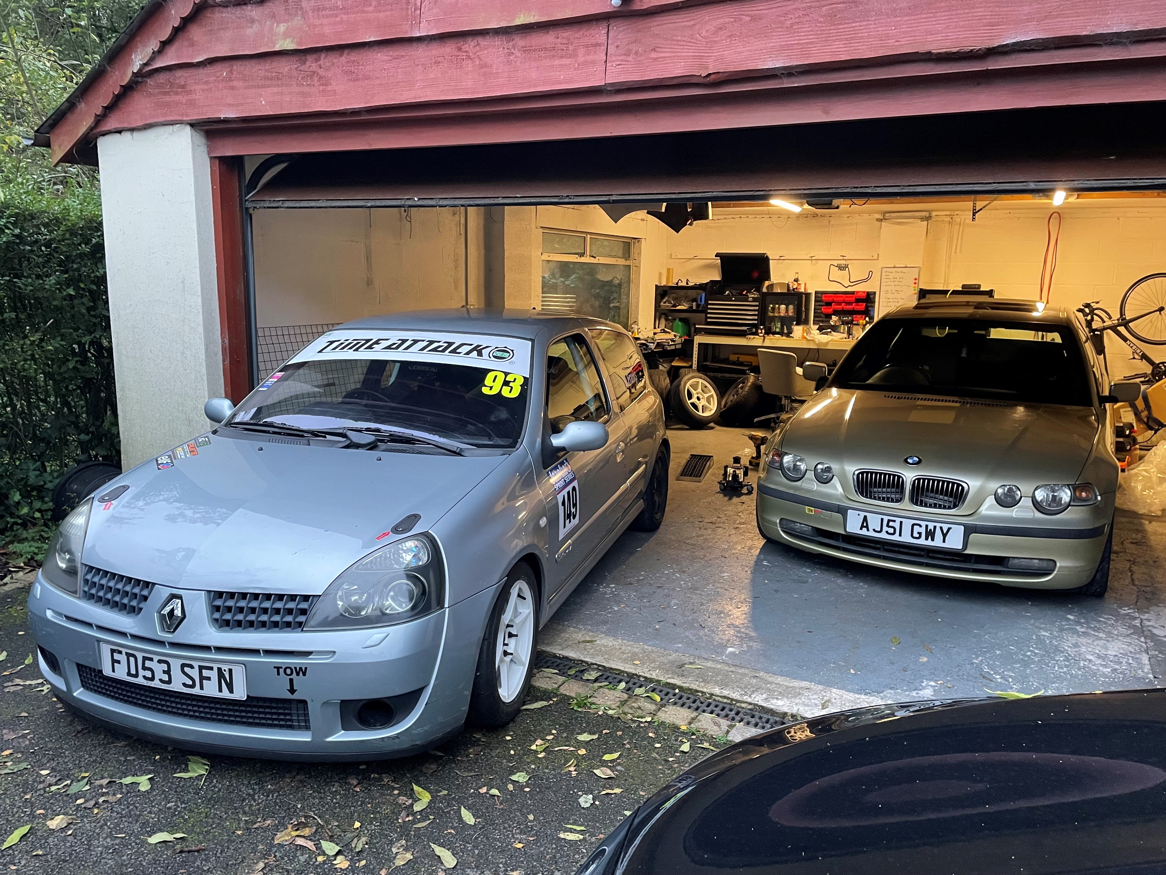

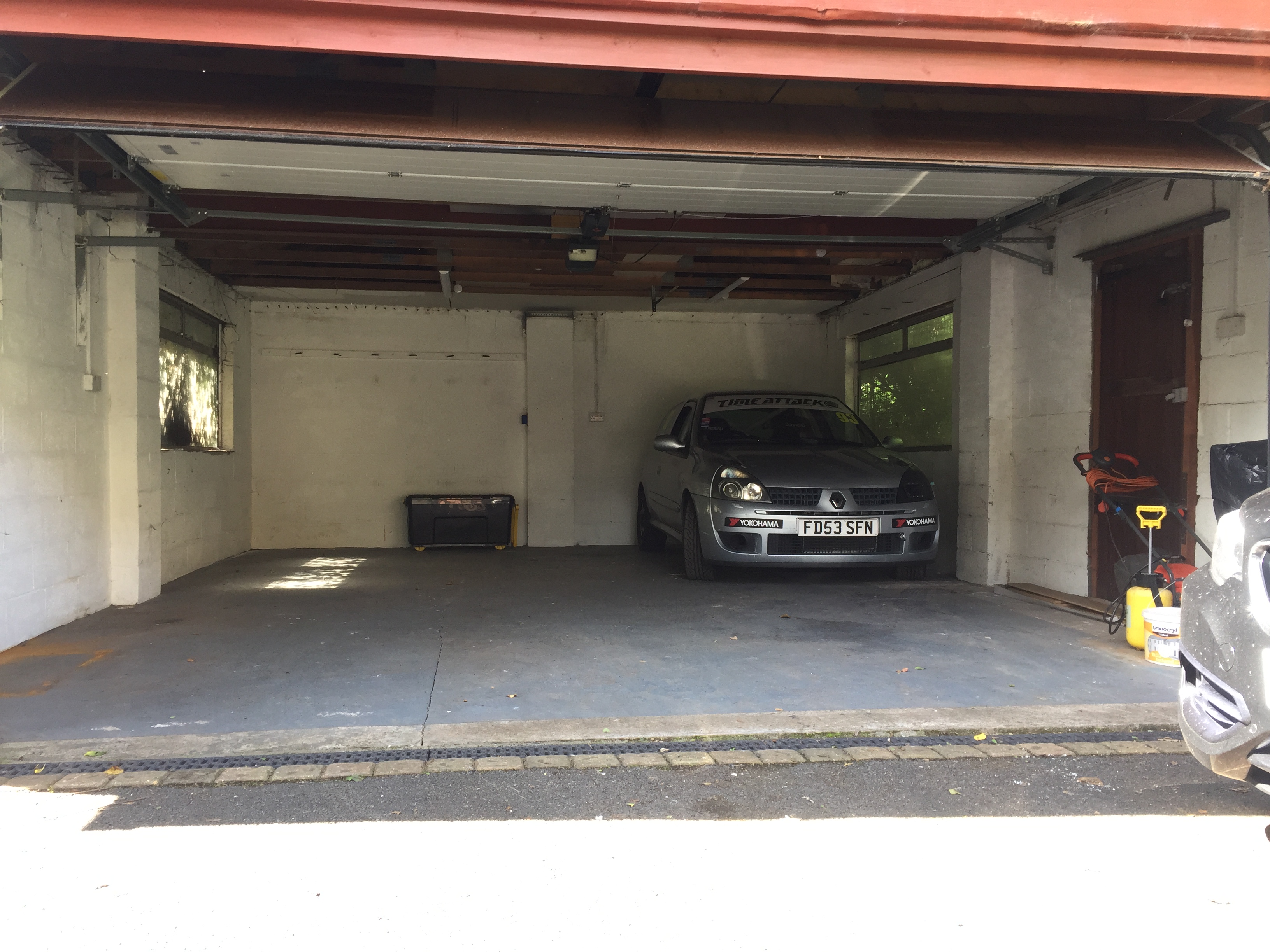

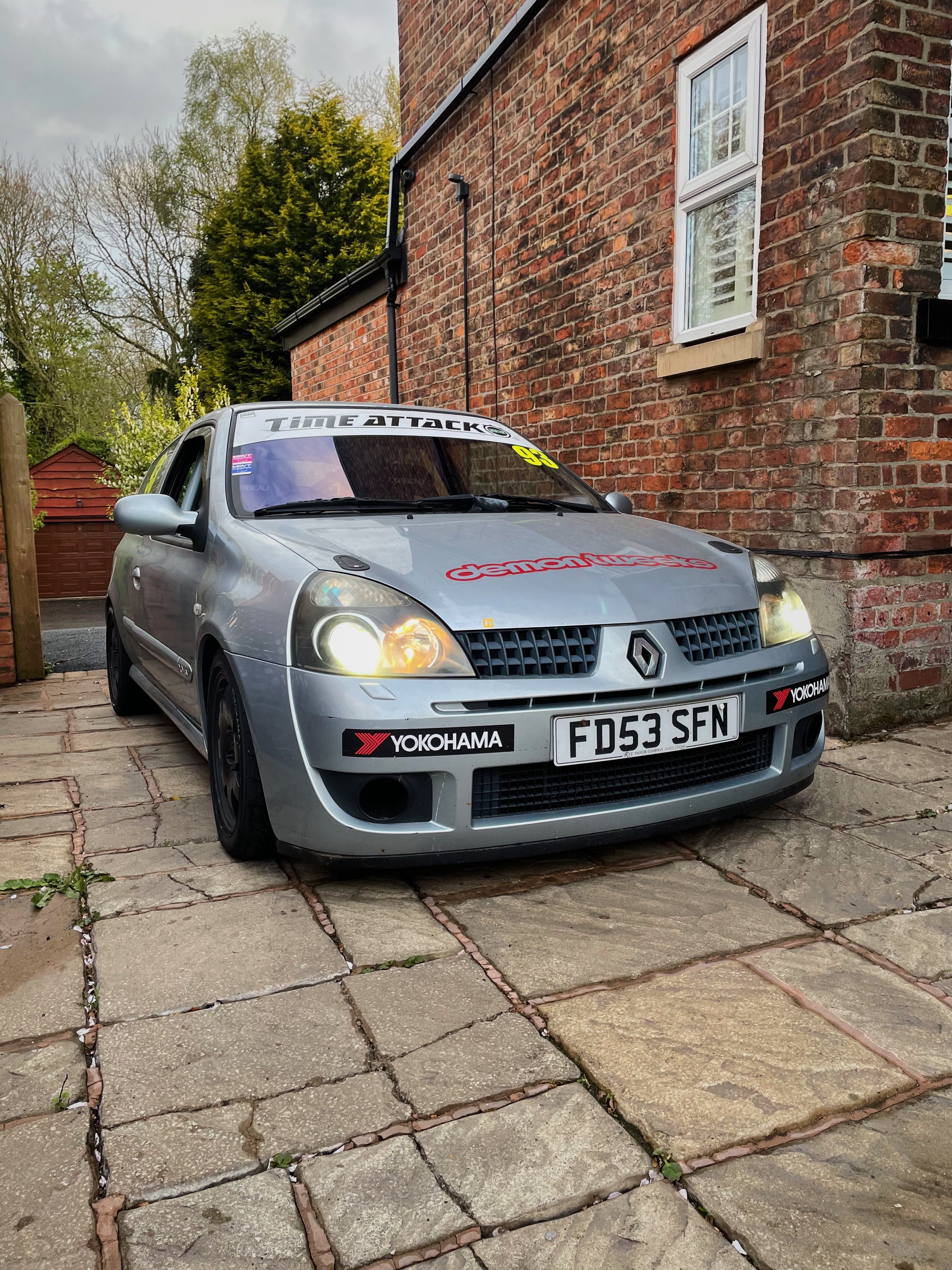

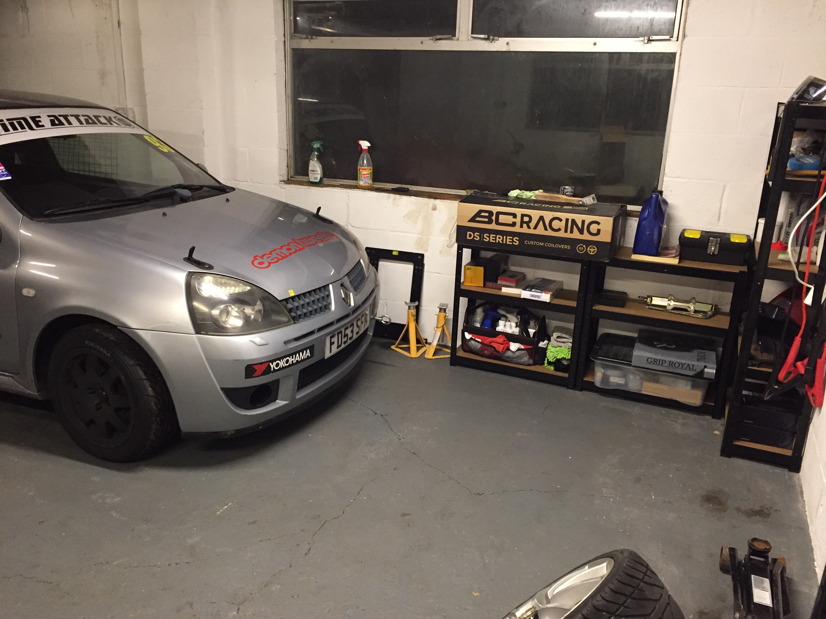

Currently renovating an old edwardian semi which is taking all of my time up. The downside is that i currently have very little time to spend on the Clio. The upside is i now have a proper garage to work on the clio no matter the weather.
Tucked up in its new home. This garage was a great selling point to me with the house. So much room for activities!
Playing catch up here, but within the last few months ive finished a few more bits on the car. New Ferodo DS1.11 pads and Brembo HC discs on the front from @George@RTR_Parts . Great price and service, would highly recommend him. Ive since used this combo on track and im yet to experience brake fade which is just what i was looking for.
The below mods have also taken place recently:
- I also removed a lot more unnecessary wiring from inside the cockpit.
- Refitted the doorcards with more robust M6 well nuts and bolts.
- Added another seat.
- Added a pair of 6 point harnesses and all eyebolts/mounting parts.
Few photos of the recent work. Can see the replacement headunit piece i made with the voltmeter all working here.
Can also catch a glimpse of the cage,seats and harnesses here...

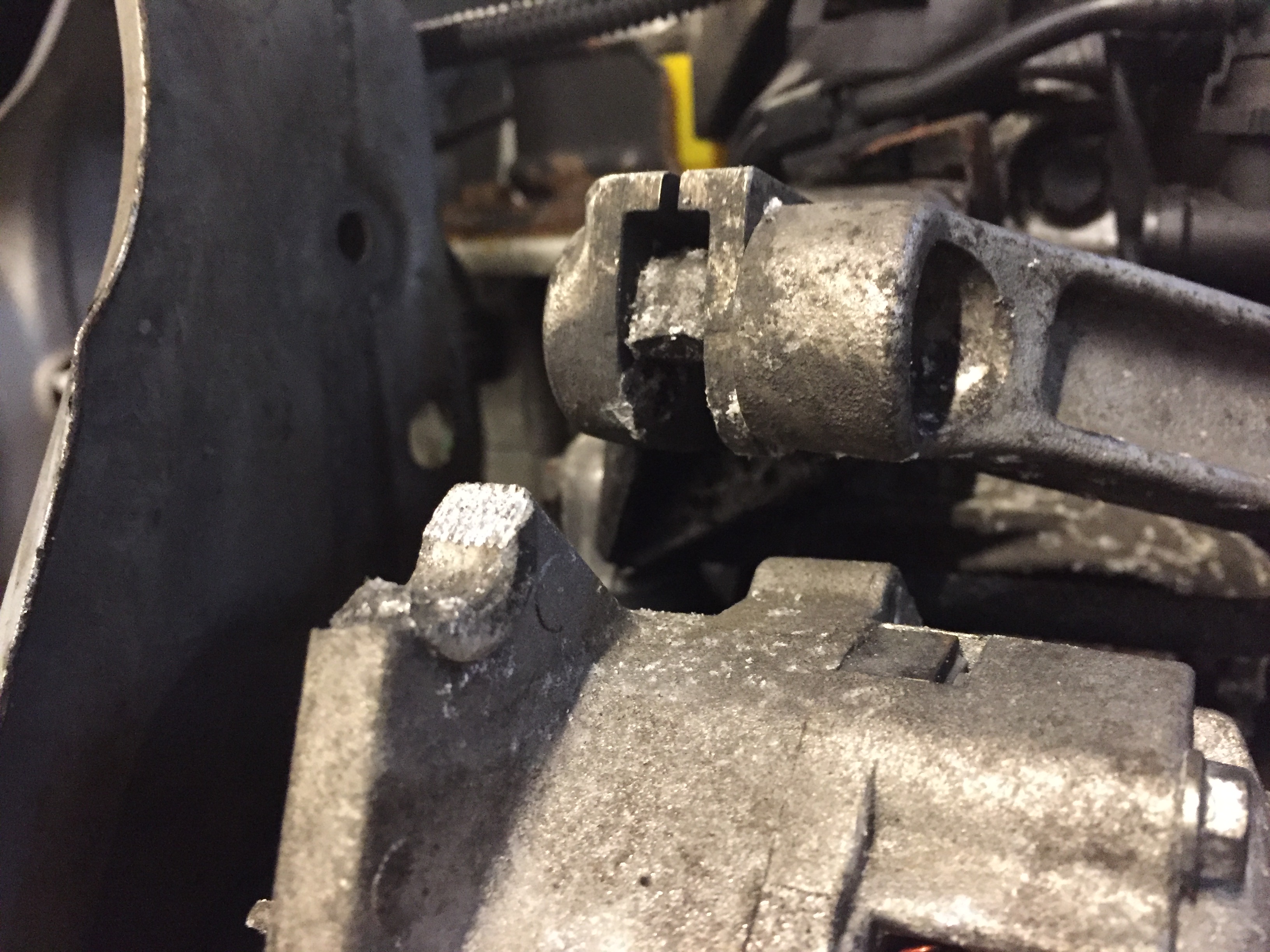

That was until the last session of the night..... the car had to be towed home. Turns out the bracket holding the alternator snapped clean off. Meaning there was no tension on the aux belt and more importantly, no water pump running. Which ended the night there. Hoping there's no further damage to the engine after the big overheat on track. But it looks like i may need to tear down the front end and install something more robust to prevent it happening again.
Ive seen Pure Motorsport do an A/C delete kit which comes with a new design to the Alternator bracket so i think that will be the upgrade route to go. Any advice would be welcome. If anyone else has heard of this part breaking before and has found a resolution/tougher part?
Thanks!
*Update*
Finally got round to doing my 'winter strip down'.... towards March.
Following on from the last post, the arm on the alternator broke clean off. Upon further inspection it would seem one of the bolts holding it on started to bemcome loose causing it to rattle and eventually snap off. Currently on the hunt for a new Alternator.

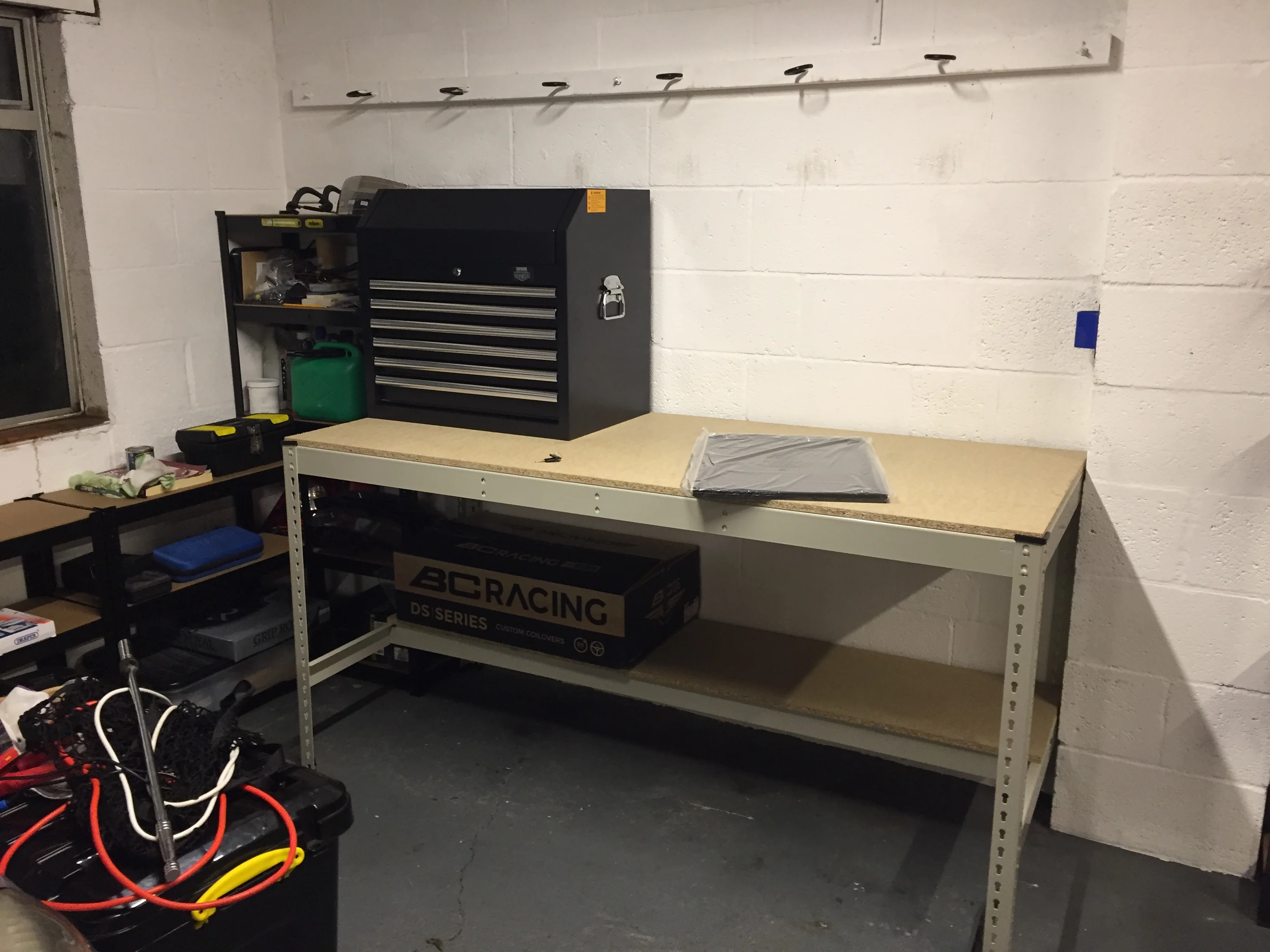

Since this work needs to be done, i decided to invest some money into storage and and a work bench in the garage, so its all ready to tear the car down.
The tear down began...
The plans are to send off the inlet, throttle body and other parts off to MS Engineering to be gasflowed and portmatched. This will also be powdercoated. Also going to be completely removing the A/C, and installing the Pure Motorsport A/C Delete kit. Hence why the spring tensioner and a/c compressor have been removed. I'll then be added a new blue hose kit and big clean up. Chuck it back together then take it somewhere to be mapped. See if we can squeeze any more HP's out.

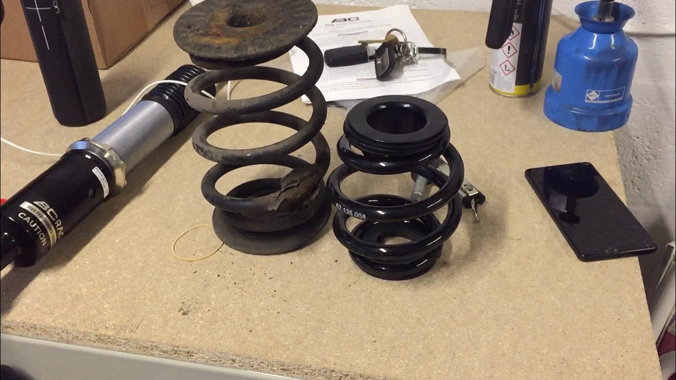

You may have gathered from pics that theres a big box of BC racing goodness. These are are the DS series, so a bit more track focussed. I went with 10kg fronts and 8kg rears. So should feel really planted going forward. These also came with new solid top mounts.
Ive installed the rears for now. Sits perfect and will allow me to move up to 205 tyre on the rear. I will install the fronts once the engine is back together.
Spring comparison for reference.
Hopefully the next update will see a lot of the engine back together and one step closer to being driveable again. Looks like track days will be back open soon so there will be a real push to get this finished.

Found a few hours this bank holiday weekend so got cracking.
The work done is as follows:
- Removed the a/c compressor
- Removed all brackets and spring tensioner
- Install the Pure Motorsport A/C delete bracket
- Replacement Alternator
- New shorter Aux belt
- Installed an MTC Hose Kit
- New Coolant Bottle
- Installed all the M.S Engineered parts. Gasflowed and Portmatched Upper inlet, lower inlet and throttle body. Also the fuel rail protector. All powdercoated.
I chucked the radiator on and fired it up. Seems to be a misfire which i traced down to one of the wires running to the injectors has split. Ive already bought a spare loom to replace this part of the wiring from.

After this i took the car to a Javelin Sprint event. The weather was horrific and to top it off, the car decided to give me some issues. The £15 replacement alternator i fitted a month before turned out to be crap. So with no power going to the battery, my day was cut short. Remind me to always get a refurbed/new one and not cheap out on important parts.
Photos were good though.

And a picture next to one of my mates track projects. 325ti compact.
