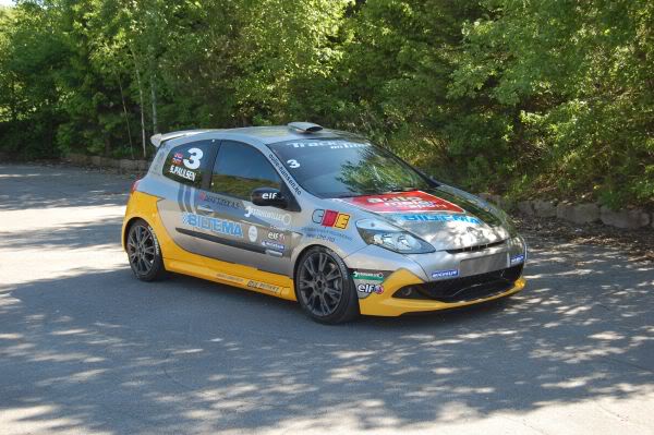

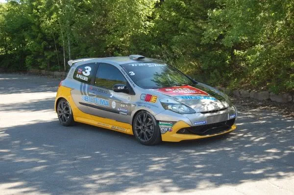

I'd have gone straight out and bought something like this. Then would have put all my spare time into testing and getting all the drivers upto speed, getting in a few sport and saloon races in during the season......

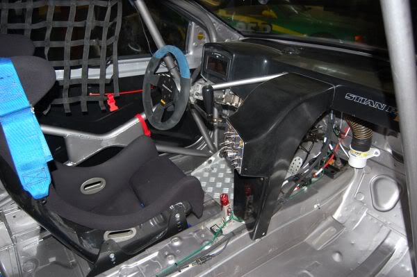

That pic has given me some ideas for a switch panel and dash thanks. As for buying it yes I could have but then I would not have had the enjoymnet I have had over the past few days working on my project or the lessons im learning from doing that either. If I bought anything it would be This :D
When I have some experience I will.
We have the R-Sport switch panels in stock as we've swapped so many out for membrane panels now.
If you buy an X85 CC car you still need to find 15K - 20K to make it an endurance car so its not as cost effective as it first seems. There's an interview between VBH and myself floating about somewhere where I discuss the costs of a proper endurance X85 but summing up to run it as a pro car for a 24 hr it's £30K of costs and another £60K to build one from a new X85. A standard X85 is not a competitive 24hr car unfortunately.
Can you do me the dash too? ;)
The dash is very limitied, it's a crippled MM DDU unit so doesn't have 90% of the functionality of the retail version. It's also TFT so you can't see it in direct sunlight. Much better option is the GEMS OLED units which are fantastic and we have used them in an OEM and two motorsport projects last quarter with great success.

No I meant the dashboard not the dash unit :)
The black GRP dash section the X85 runs? It's LHD for a start and attaches to the roll cage in the X85. It's also really expensive for what it is (circa 450 quid if memory serves).
If you want one doing our carbon shop can knock you something up in GRP for not too much more and it'd be RHD as well ;)
