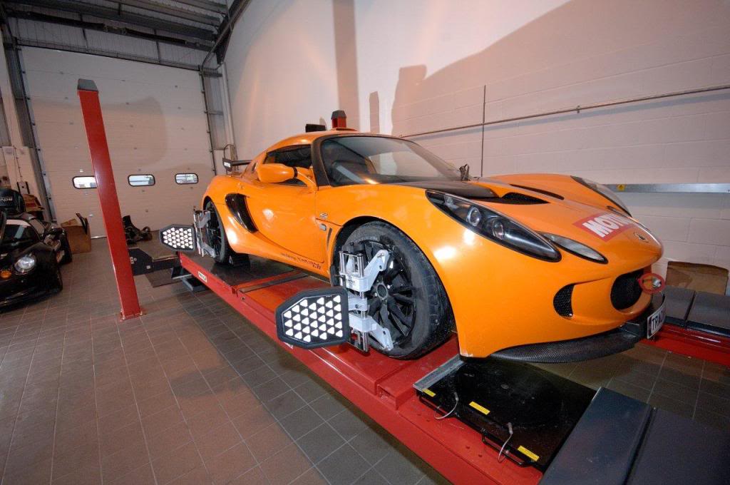

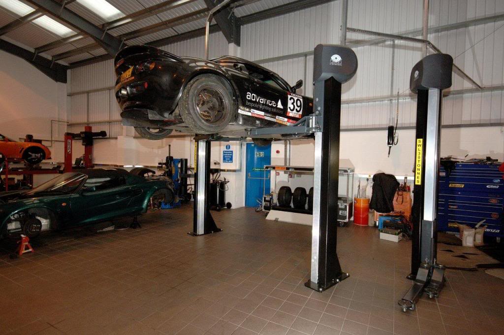

You'll have to pop and see our workshops as we've got some lovely kit these days:

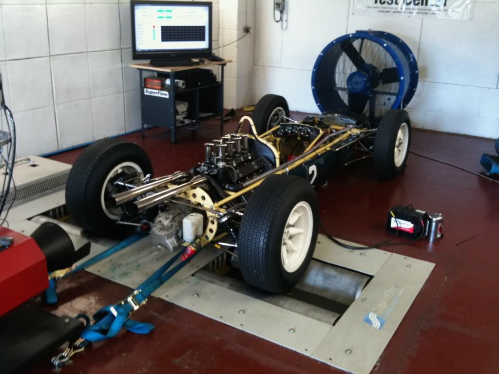

Engine Dyno:
Chassis Dyno:
Chassis Setup Rig:
Service Centre:
Can't wait to see your NSX out again, the NSX is one of personal favourites and in all likelyhood will be what I swap my current Cerbera for later this year. If I don't see you before I'll see you at Britcar, think it's Aston and Lotus for us this year.
All got a bit willy waving in here didn't it.
Anyway good luck whatever you do mate and thanks for bringing the thread here, there is a lot of knowledge in a small place.
I know Englebert loves a bit of workshop bling so that was mostly for him!
It's an old BRM F1 on the chassis dyno 1.5L V8, 11K RPM rev limit.

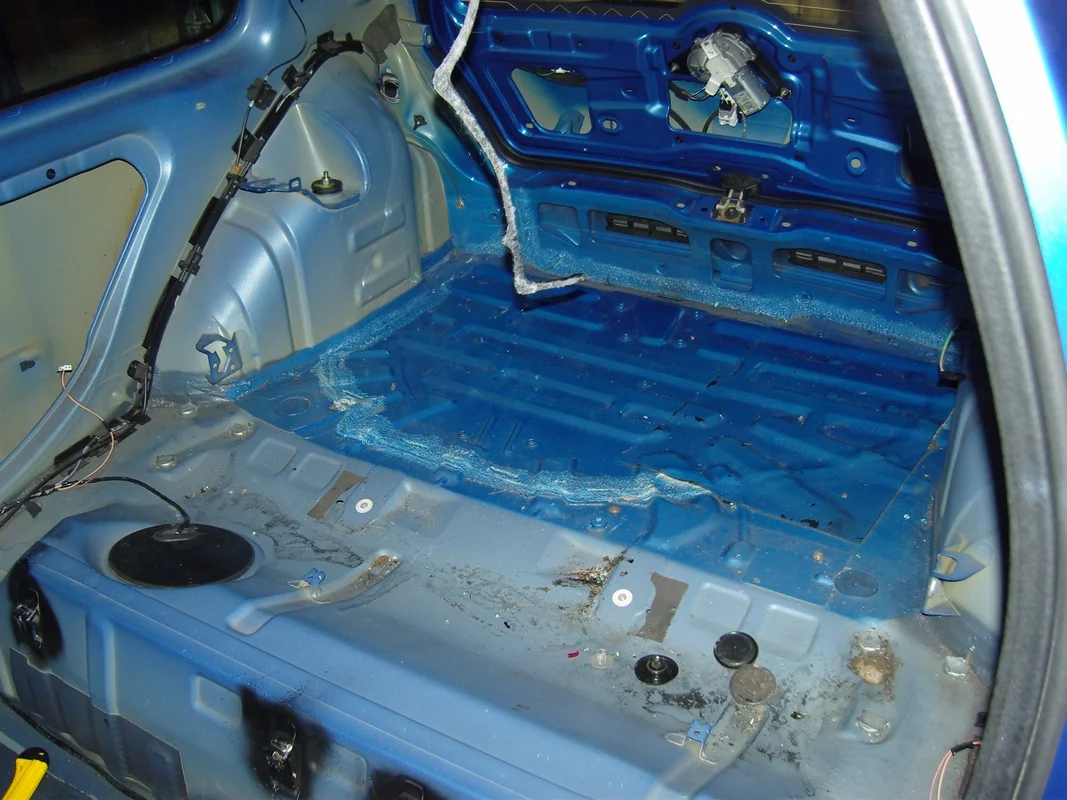

Here is today's update. Been busy this morning with Chris as next week I go back to Switzerland so progress (and updates) will be much slower after that :( Anyway here goes.
Chris helped me today so here he is. Top bloke who also has a Clio.

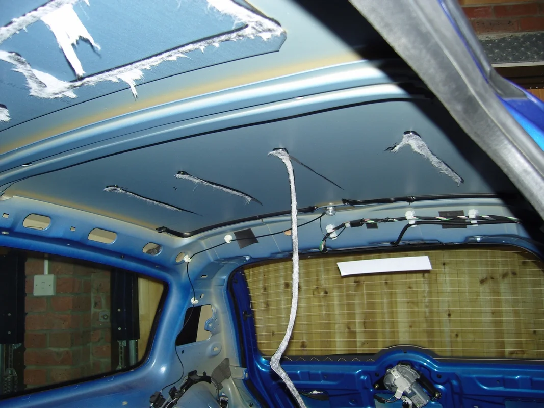

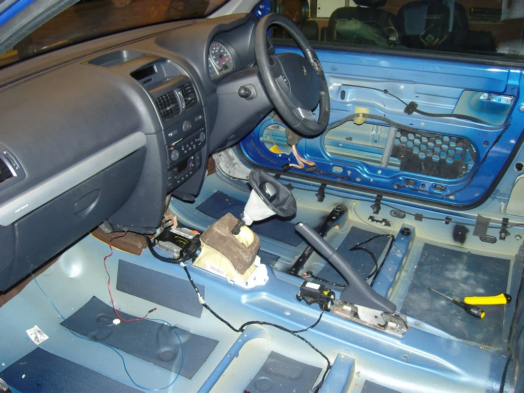

Getting there with the stripping, dash out next.
Rear stripped, Must take my grinder to all those brackets next.
Roof bogeys

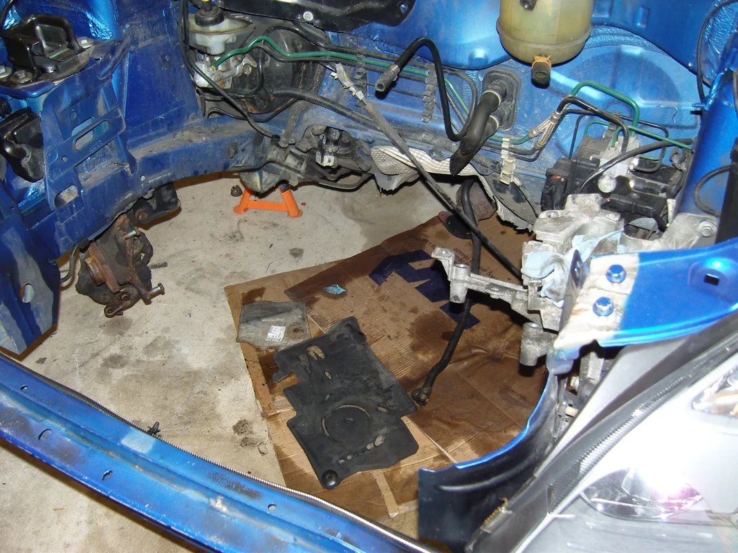

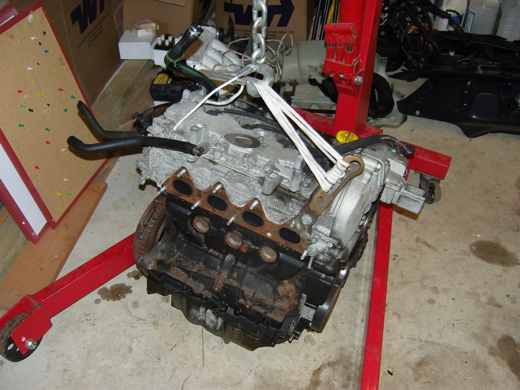

Engine out now
And on the floor

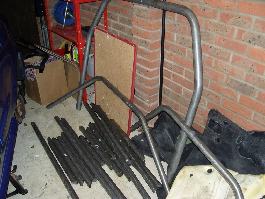

Oreca Cage

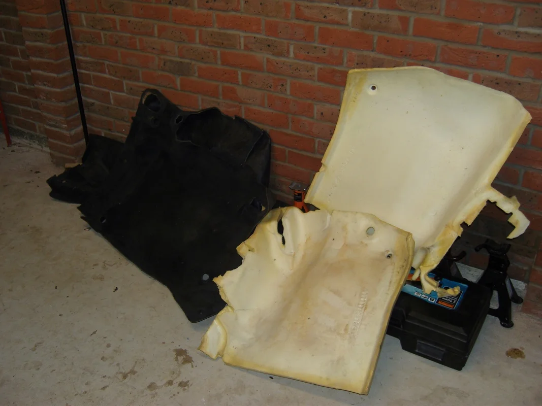

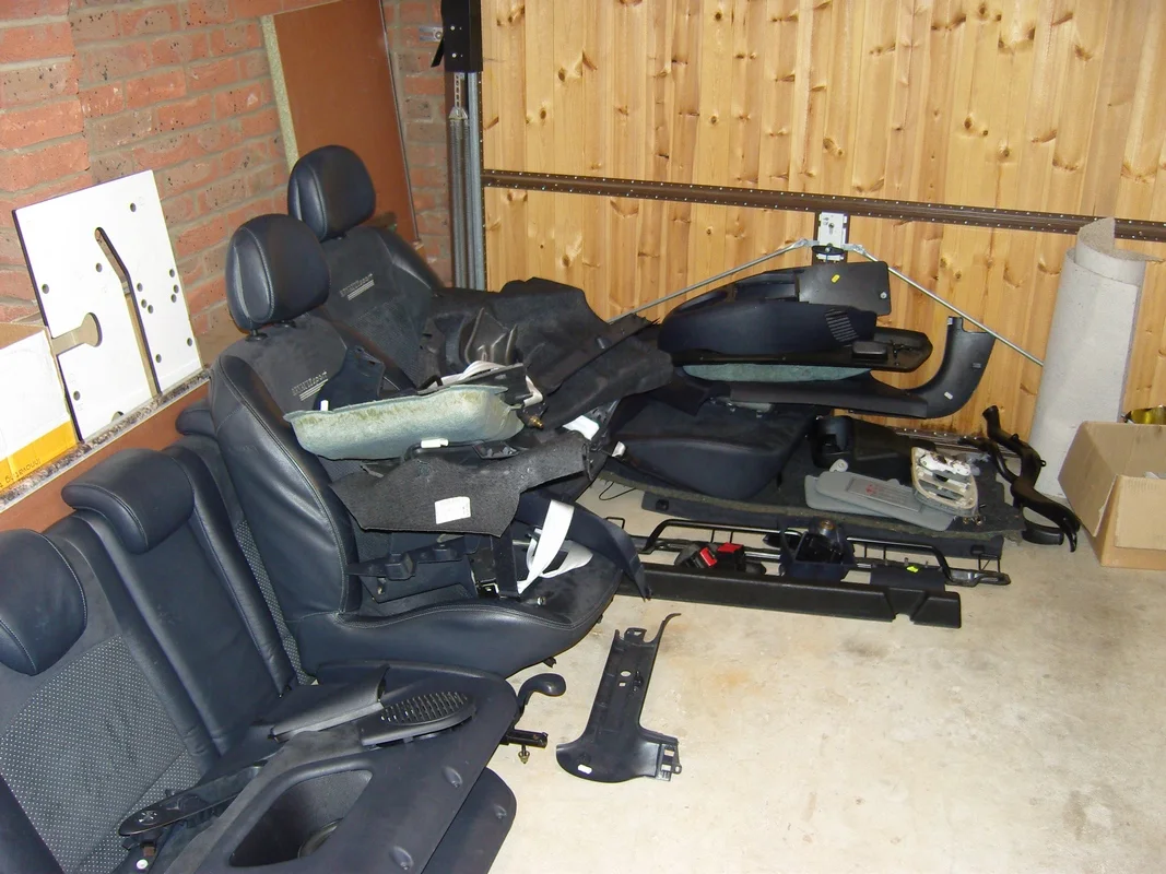

Plastic crap and seats.
More crap and carpet
So quite a lot done today. I have taken a perfectly good road car and reduced it to scrap value in less than 24 hours, mmm nice.
Next on the list is dash out and interior clean out ready for cage to go in. Going to take the sub frame and assorted engine bits to the powder coaters tomorrow and generally clean everything up.

2. Would you take that big panel off the roof? If so how as it looks like it's been welded (glued on)

2) I wouldn't go messing with the roof. Slightest crash in clios and they like to crease :S. Keep a bit of strength up there.

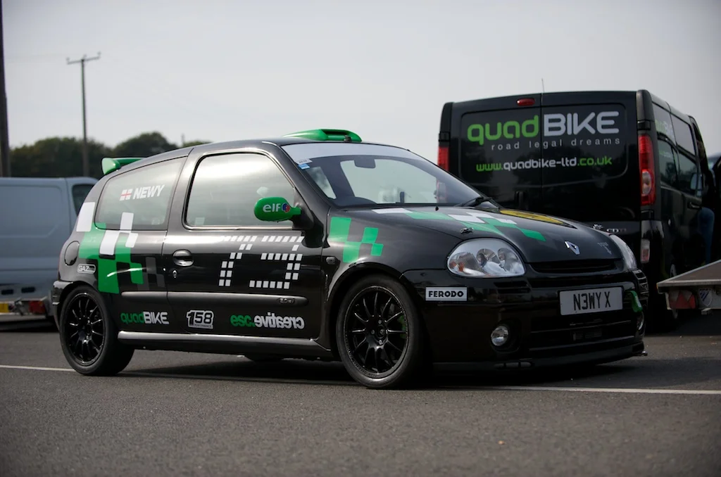

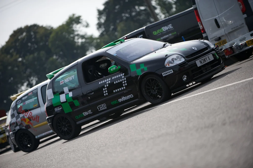

Here are some pictures of Chris and Nicks clio's
Nice side view
Engine shot
Front Side with Chris car in background
Chris car
Racing
Mark.
Yes we have a color theme going on here :) Mine will be blue and lambo orange. Nick's doing a design for me which I will post up when done.
