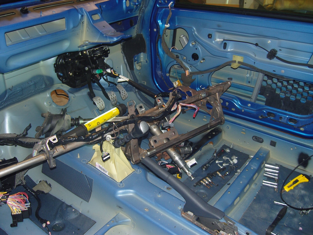

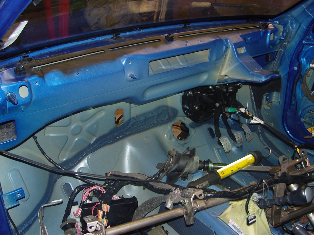

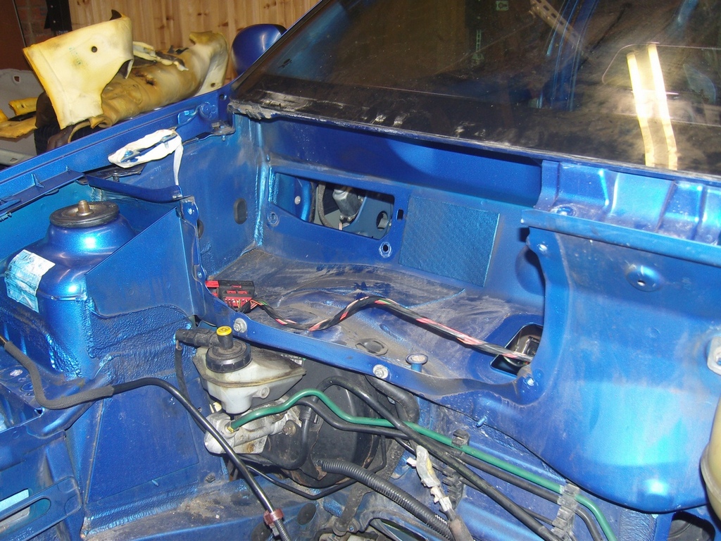

Lots has happened since my last update and I left my camera in the Uk so only have these pics today till I fly back on 4th feb. I will do a better update then :)

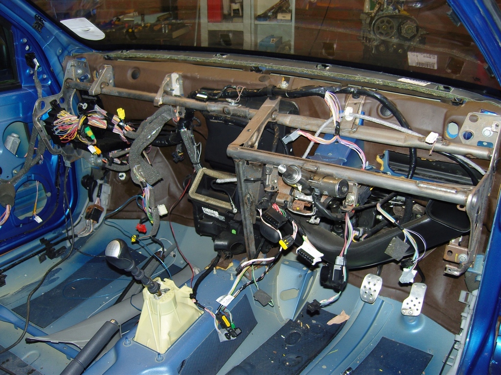

Im guessing this s**t needs to come out :)
That's much better
What about losing the dash too while we are at it.
Cooking with gas

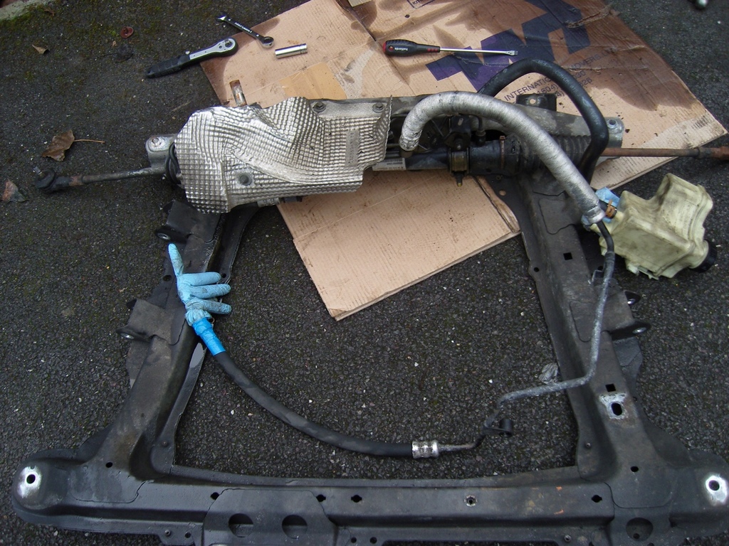

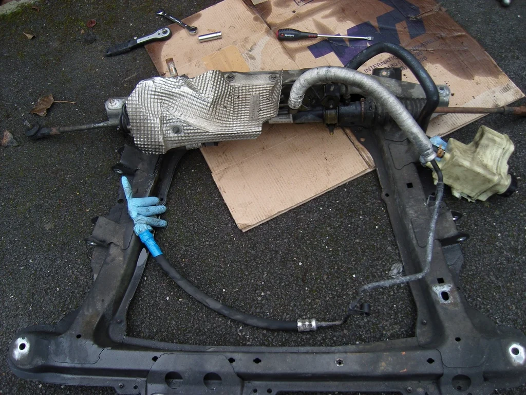

A very dirty subframe
And all this off to the powder coaters along with the subframe

The car is now completely stripped inside and out. The axle is off and all brakes etc with everything at various stages of blasting and powder coating. Once I have those bits back I can start building up the bottom with axle back on and new brakes and suspension. Then it's roll cage welded in and plastic windows in etc.

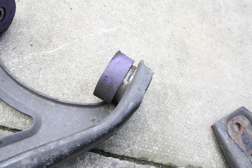

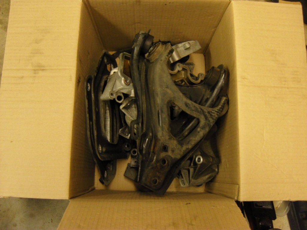

Yes sure am the box of bits was taken to my mates press first to lose the old ones before powder coating :) Going to add a Whiteline at the rear too. Front hubs are being blasted and then adding new upper and lower ball joints and new bearings both sides. Might aswell replace everything whilst it's off eh.
Oh right good, I dont know if you know but you will have to tac weld the new metal sleves from the polybush kit to the wishbones. So you might want to get that done first then get the wishbones powdercoated, that way they will last longer :)
Yes I saw that but why do you have to tack them in? Not like they are going anywhere once it's bolted up tight.
They're not a tight fit in the same way as the standard bush. They will move very easily giving the polybush nothing to locate in, and the metal sleeve will gradually cut into the subframe
You HAVE to tack them in, if not the bush gets foooked for some reason. 100% have to tack them in mate.

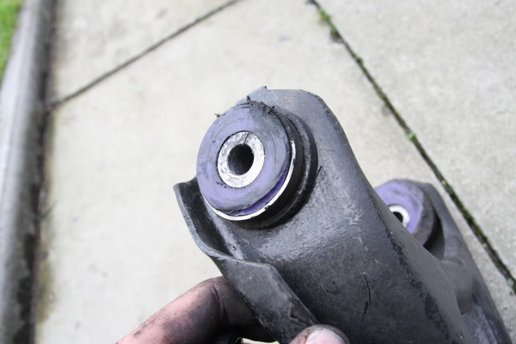

The sleeves do move quite a bit if not tacked, mine did over a years use on track. Although it sort of shows some (well, a lot) of the stuff on this forum is b*llocks as I was told not to bother, then this happened. Whipped them off, adjusted, welded and refitted. Done another 16 months without issue. They looked like this once moved..
