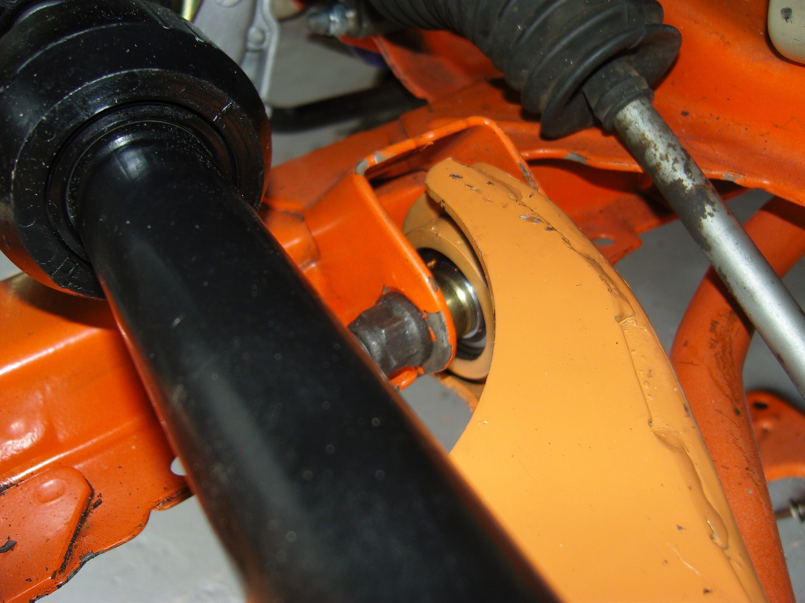

Ye I had the same problem with the powerflex bushes. I've spoken to them and they are going to revise the design and are putting thicker sleeves in. They are sending me a set in a couple of days so will put the pictures up as soon as they arrive. Plus im getting them for free :)

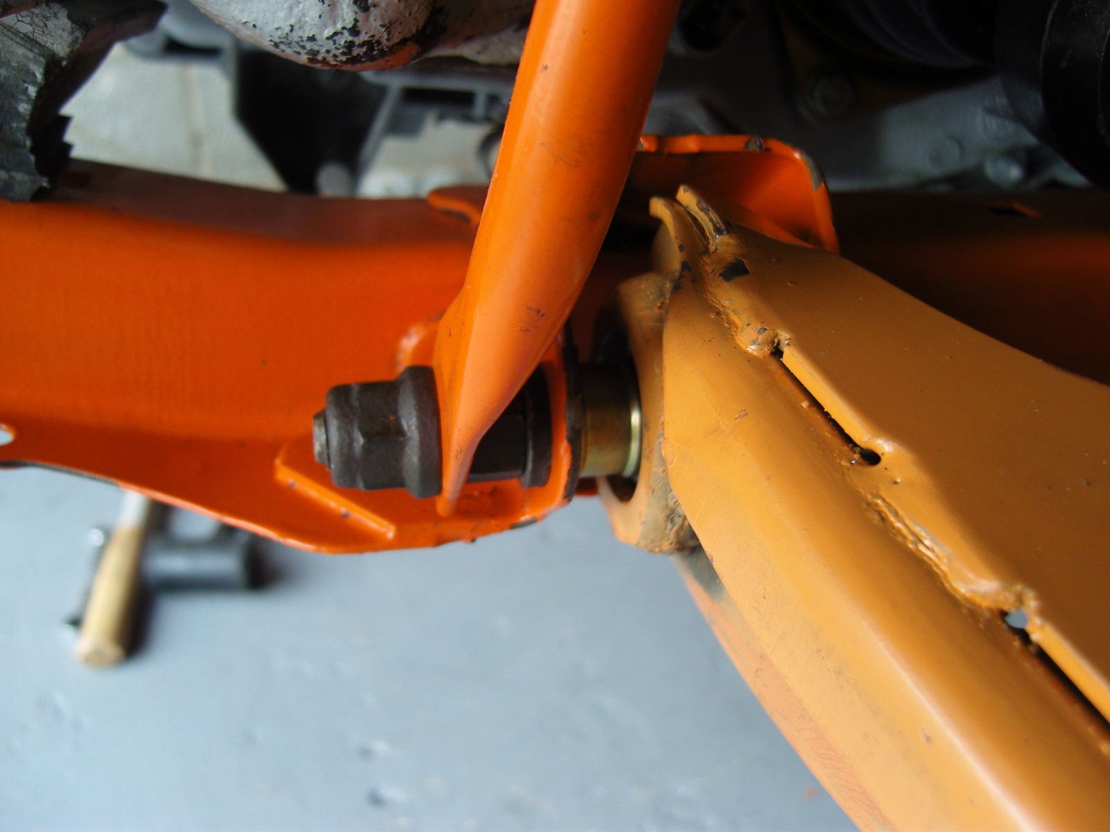

So I had a good day on Saturday in the garage and got loads done. The new wishbone bushes were a bit harder to fit than I thought so took a bit longer and then i got the wrong orange paint but I'm sure no one will notice ha ha.

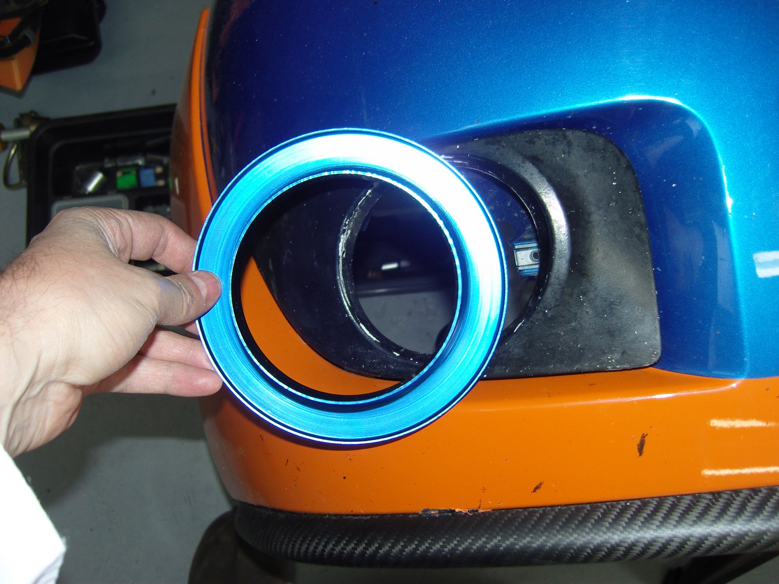

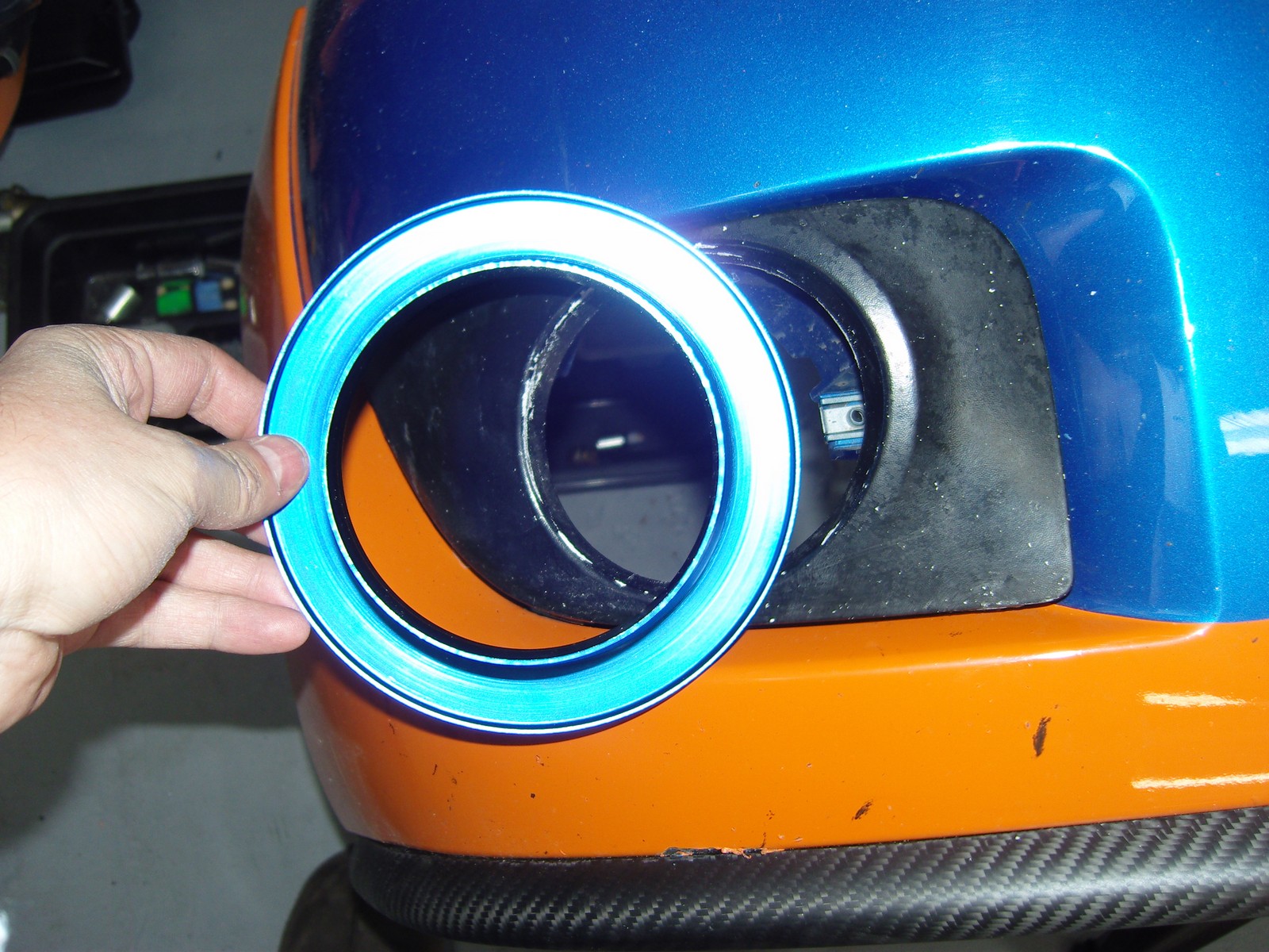

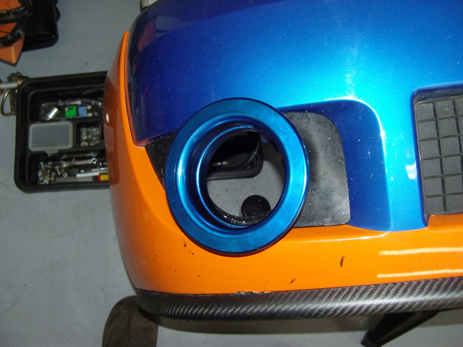

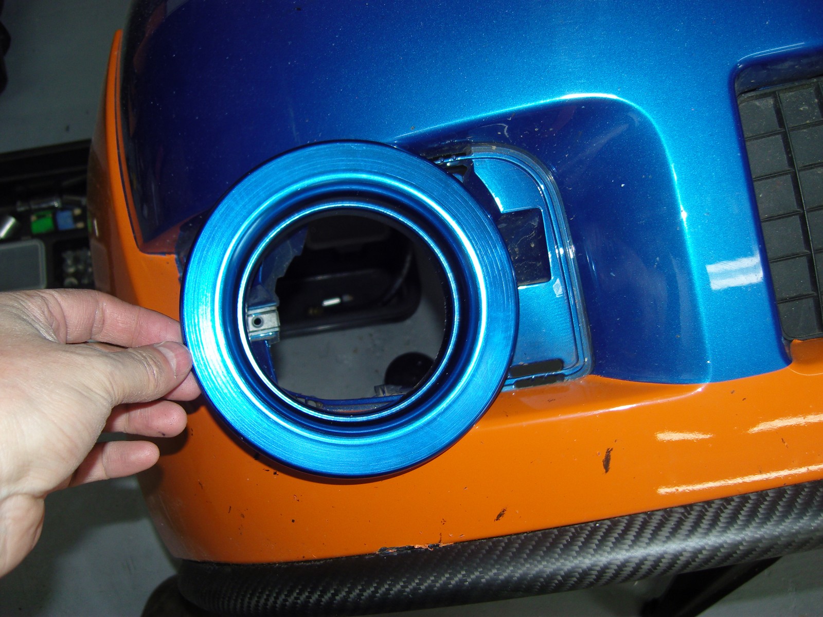

How do i fit these as they are 102mm but look way too large to me.

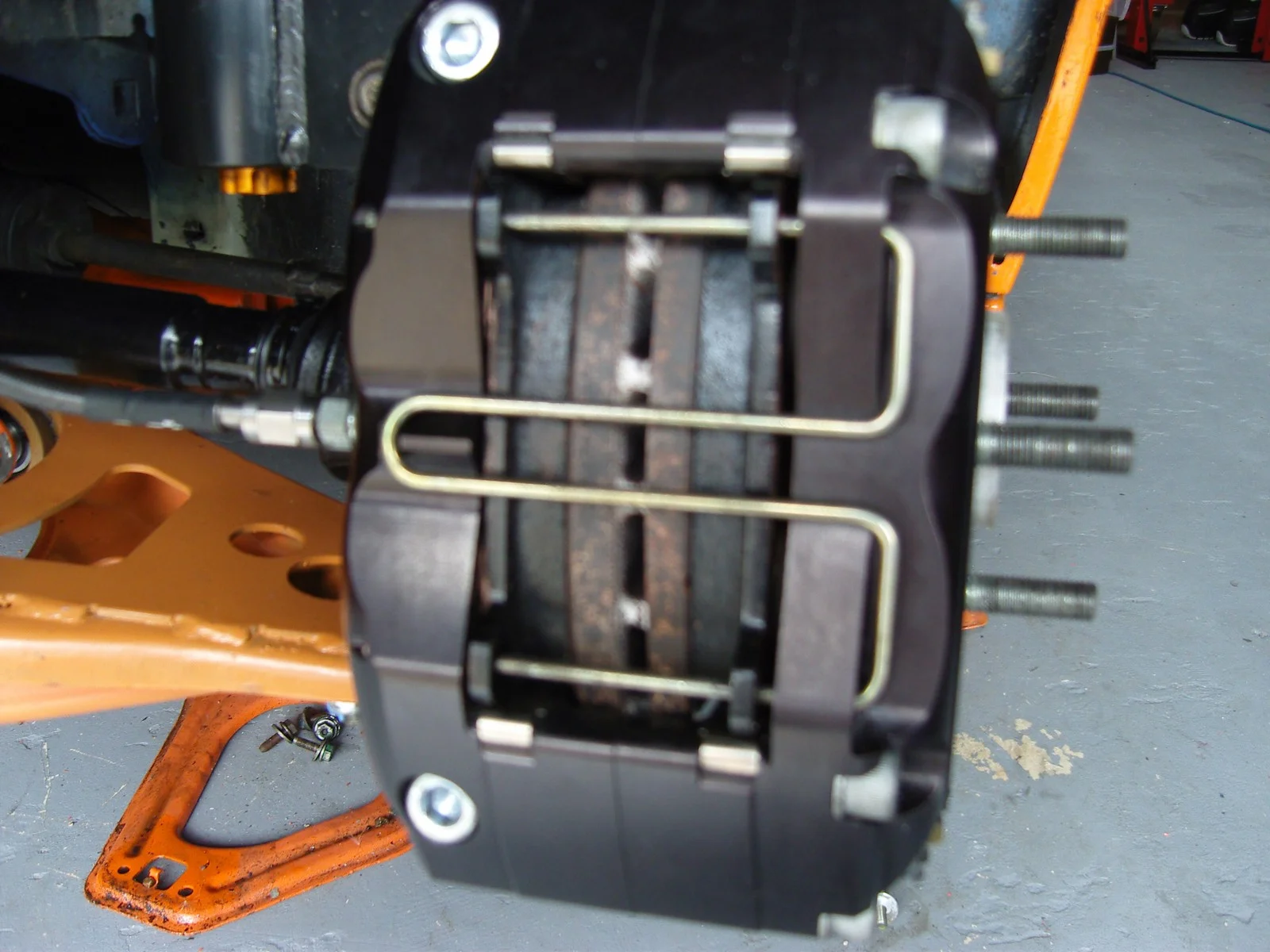

Some softer Mintex brake pads

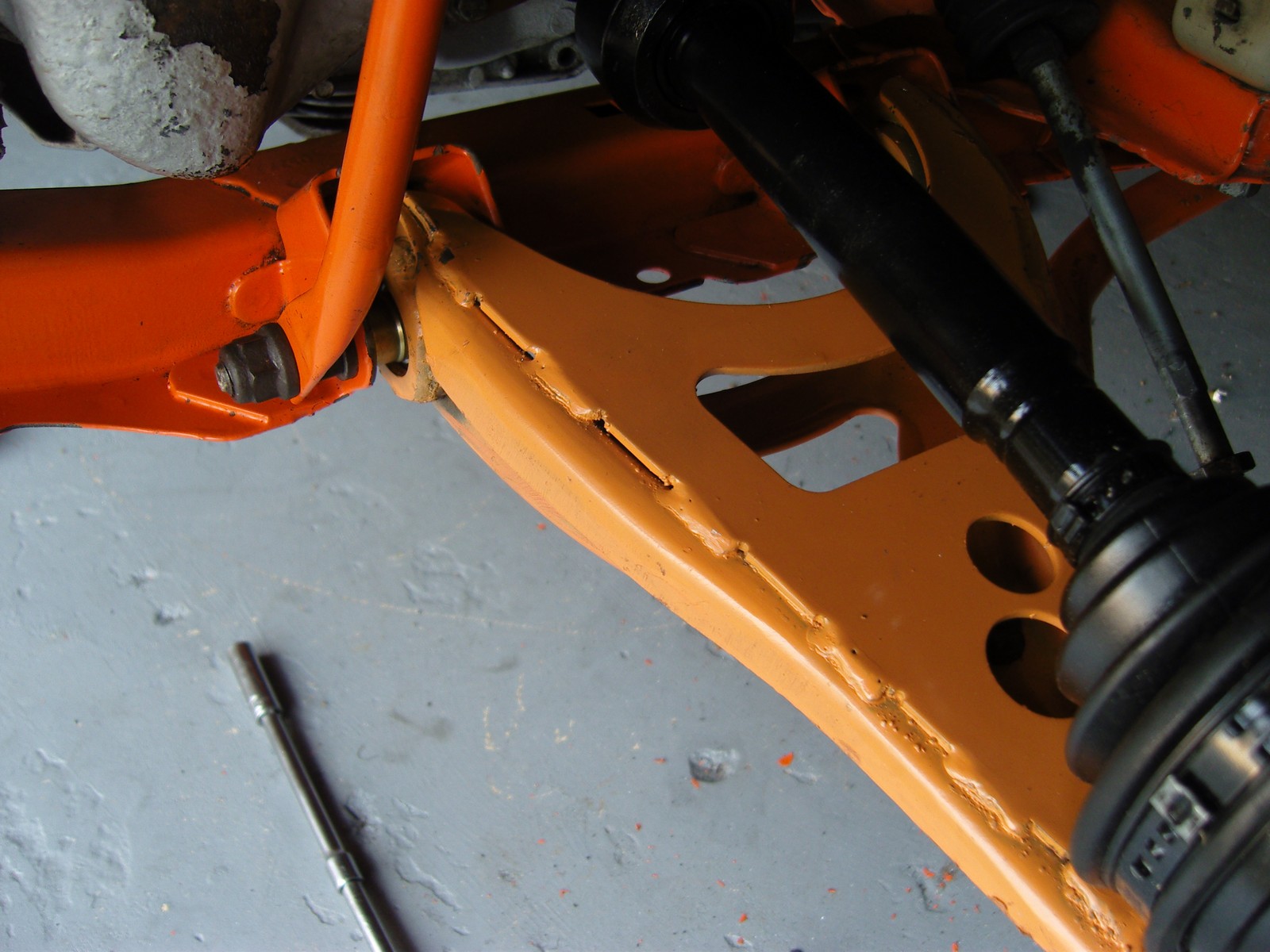

My nice new solid wishbone bearings and stiffening plates and new Renault drive shafts both sides.

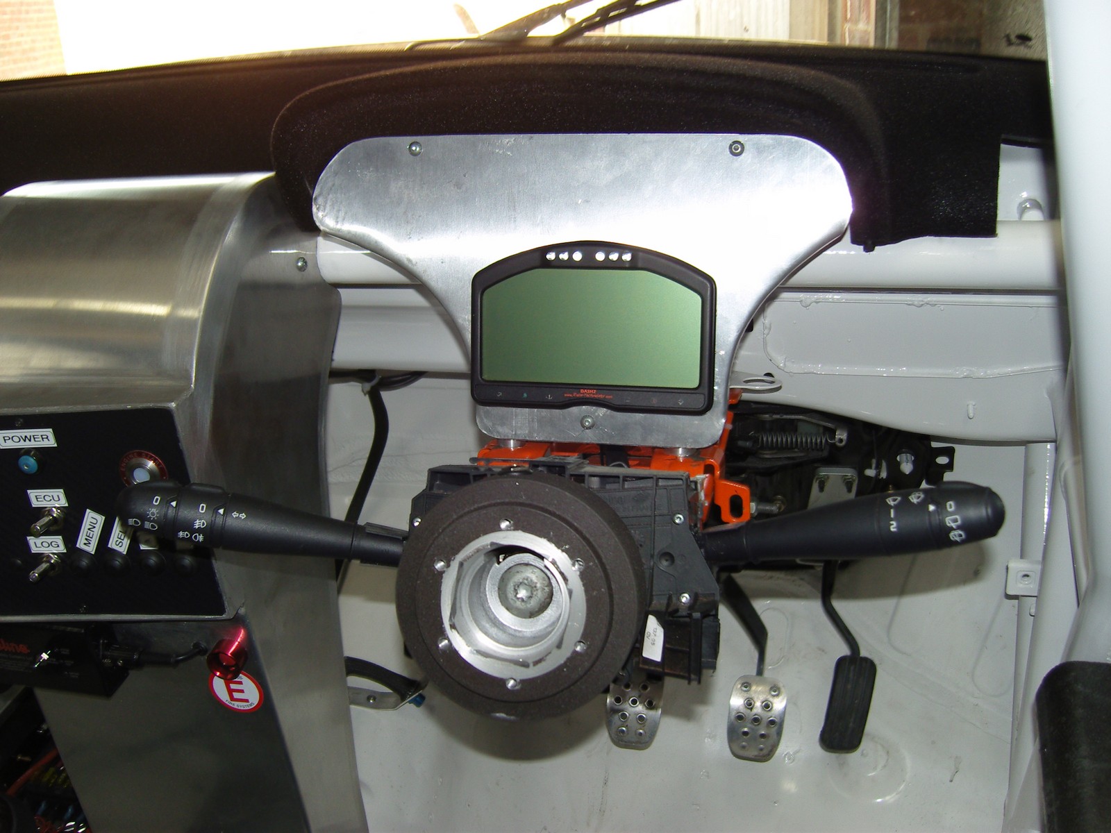

I wanted to lower my steering column so added some spacers but then had to make up a new dash panel to lower the dash doh

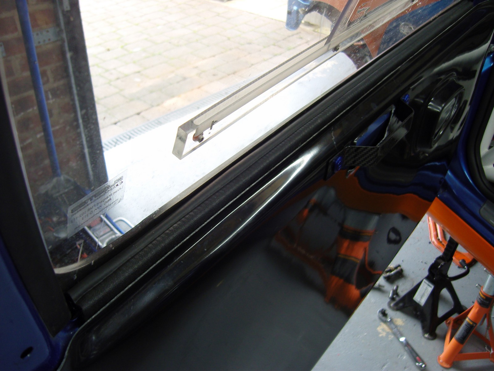

Fitted some nice carbon door handles and also some rubber trim to stop my side windows rattling

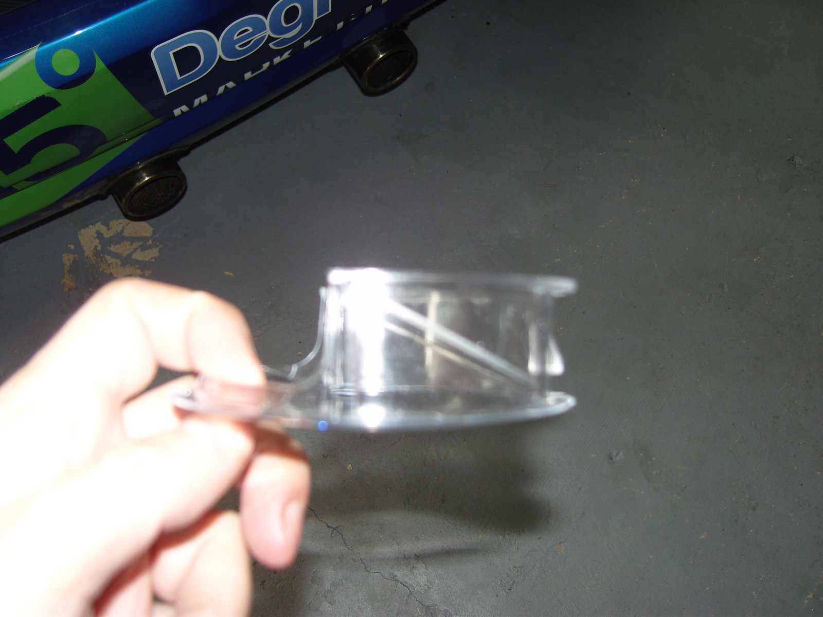

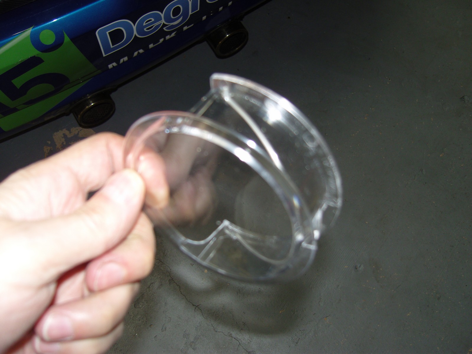

Finally how do I fit these pop it vents?
Mark
You need the 76 mm ones, did the same thing got 102 then reduced the size..76 fit the hole fine
and the pop out vents...squeeze the open ends towards each other and just ease it into the opening...it's really flexible...
Some nice work there.
I'm still debating what to do regards wihsbone mounts, I bought the powerflex ones ages ago, they're in but the sleeves haven't been welded so not commited to anything, might enquire about the revised ones.

some good work there, PITA about the air feeds, i actually need to purchase some larger ones as mine are too small for the fog holes in the phase 1 bumper, where did you get these ones?
