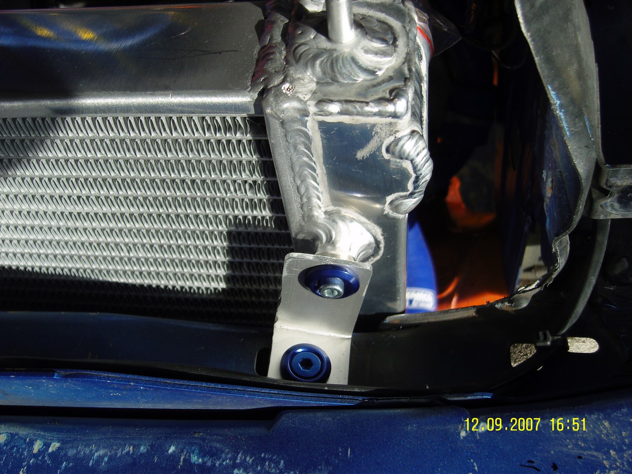

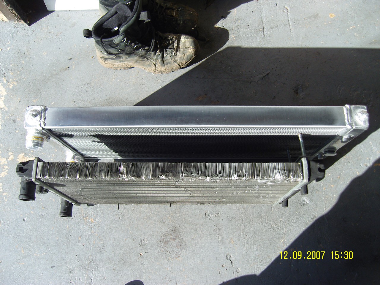

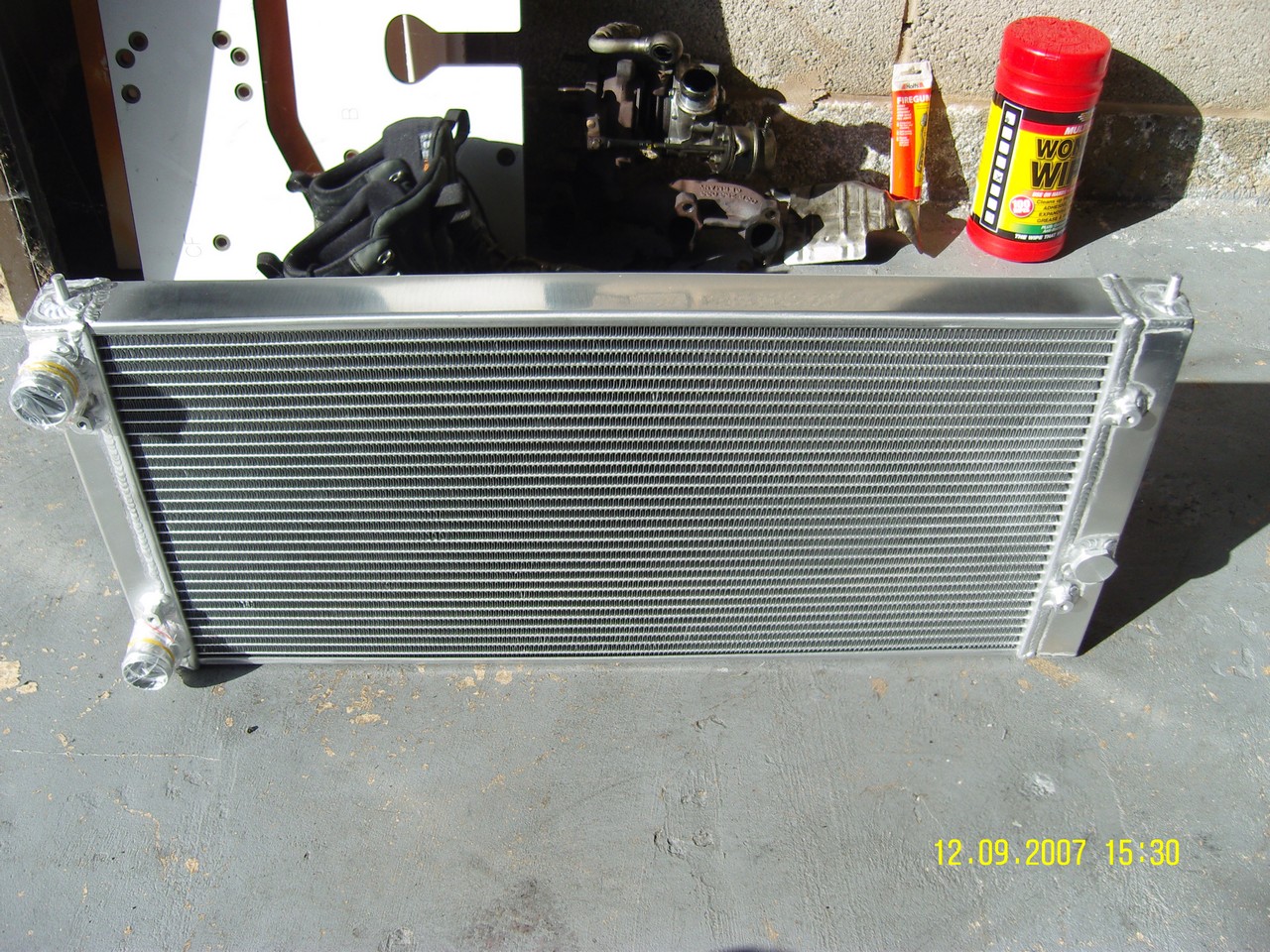

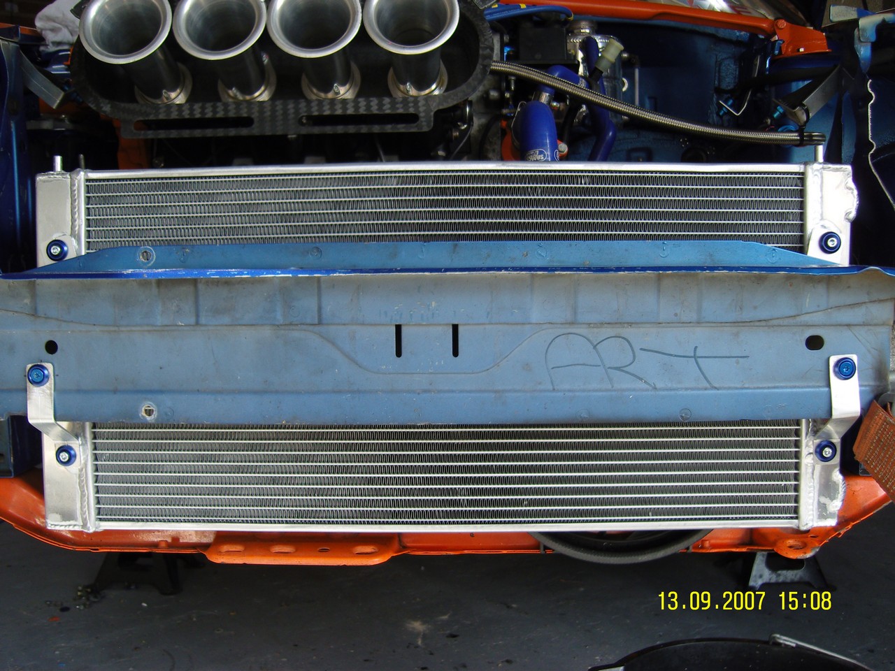

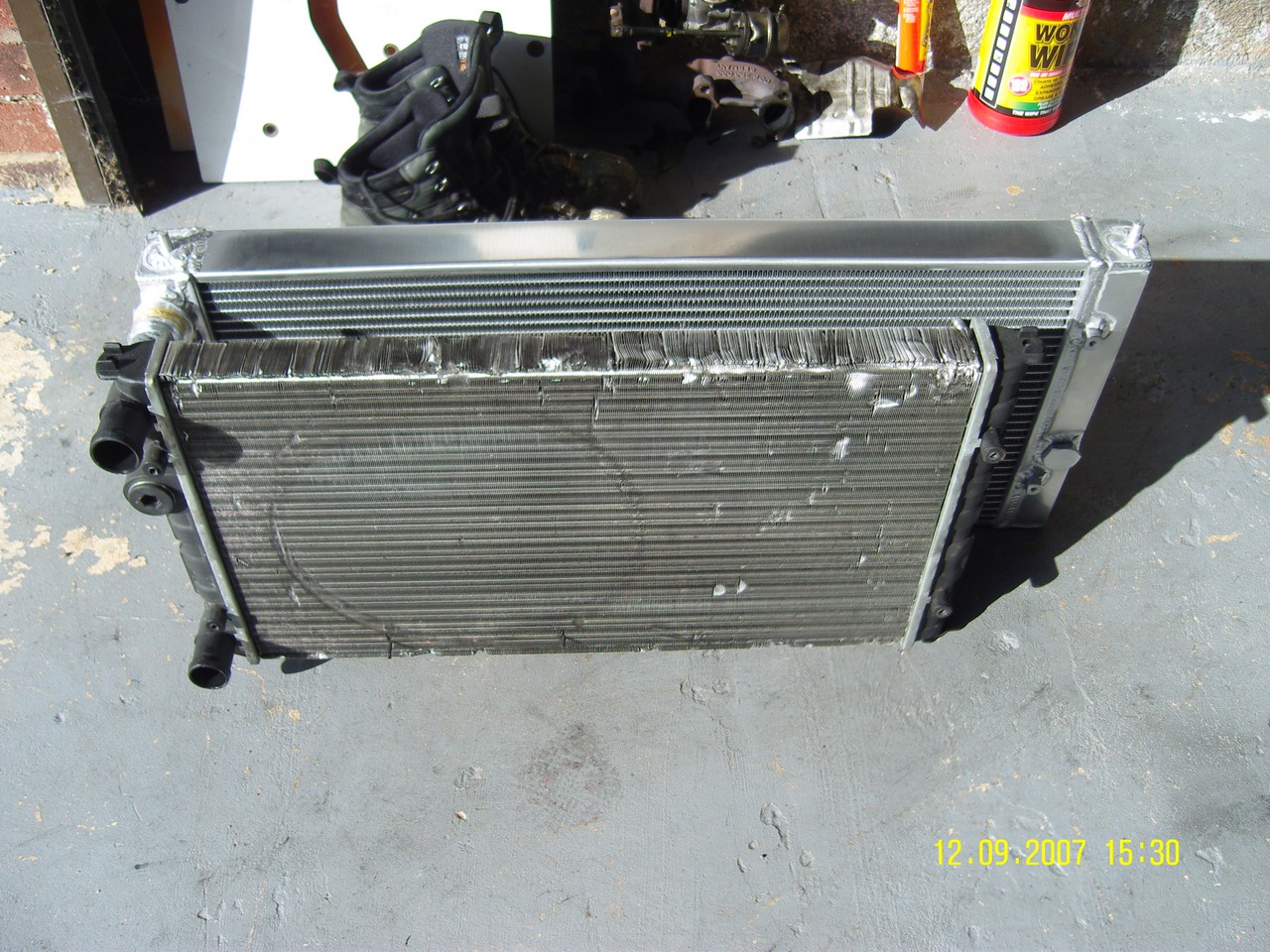

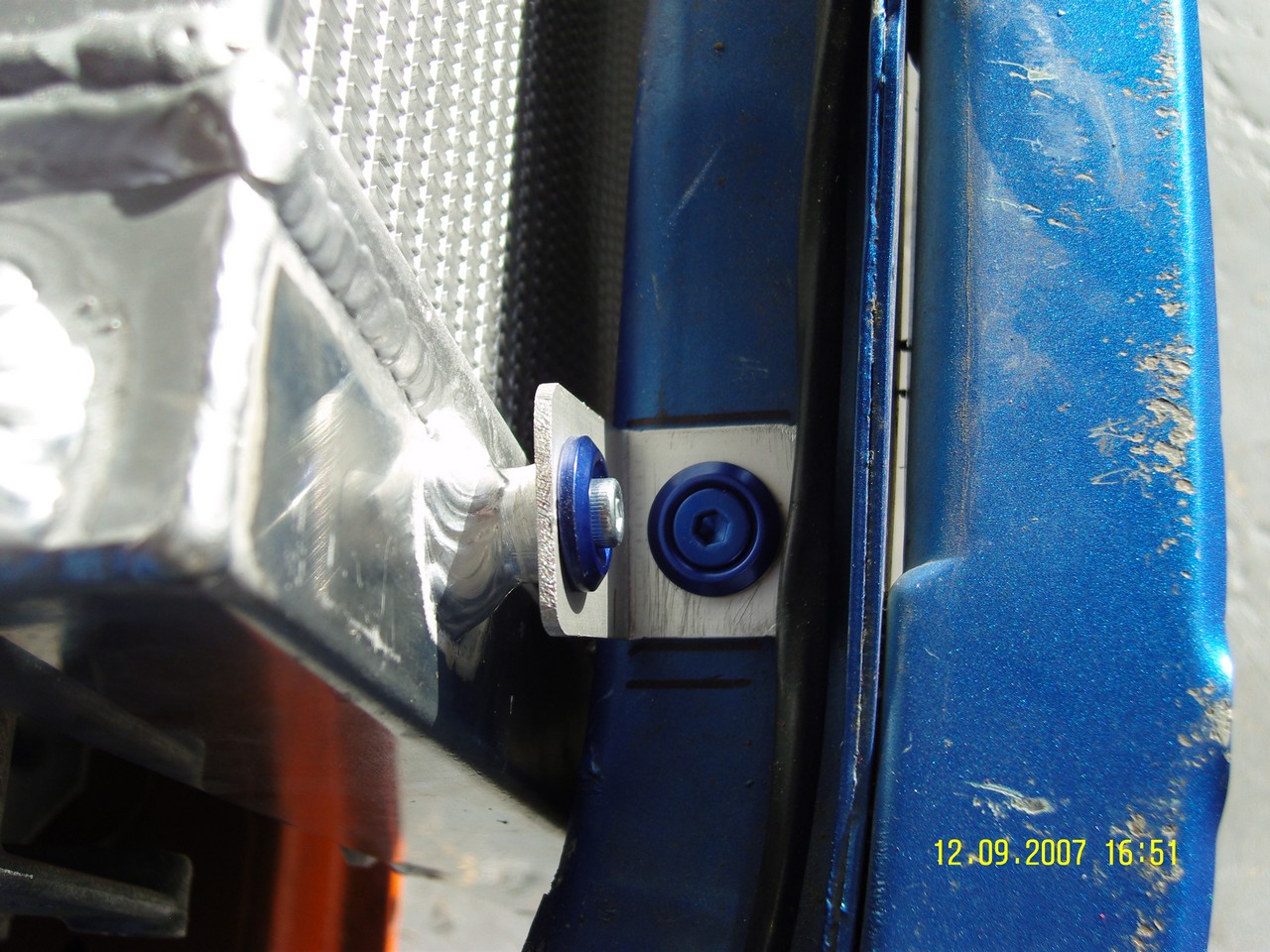

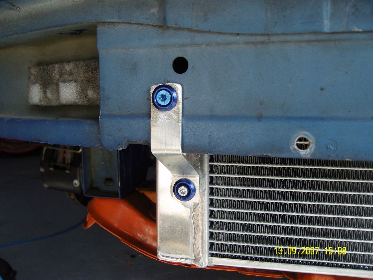

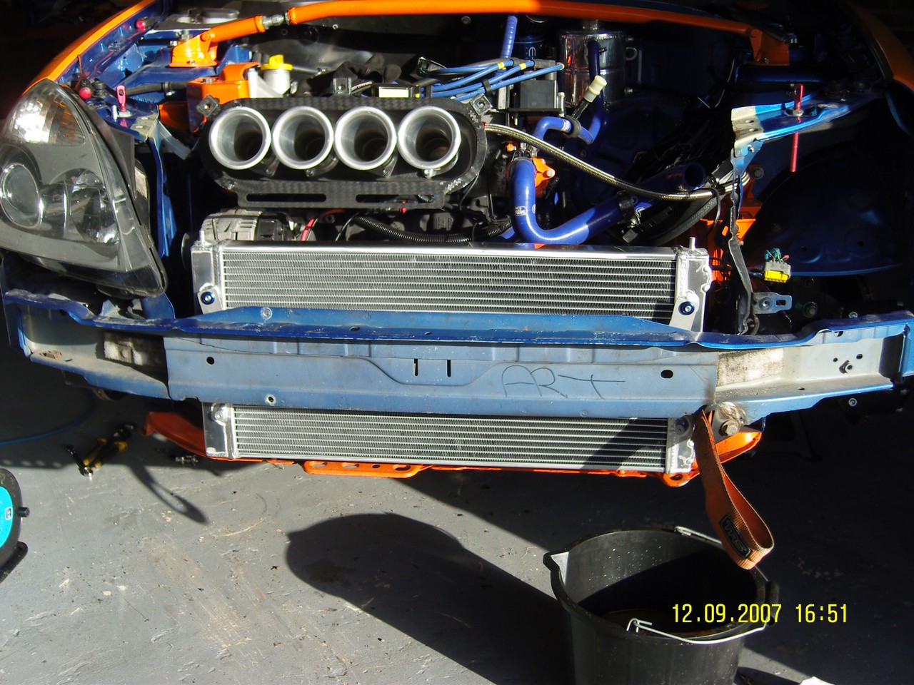

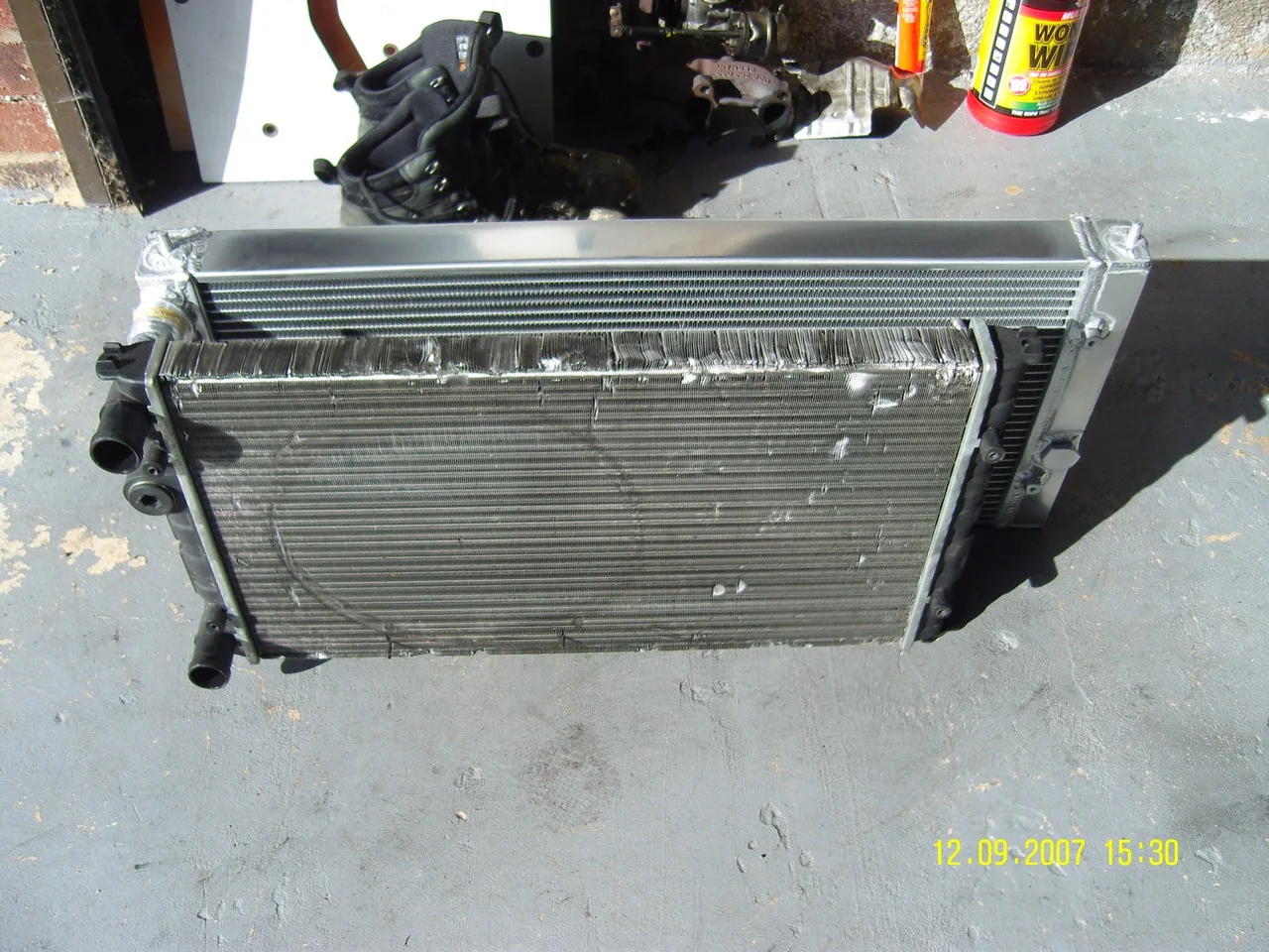

So I have made a start on my new jobs list. First up is my new ally race rad. The car was running hot at Cadwell so I have binned the small Polo rad in favour of this Golf item :) Mmmm ally welding, I like it a lot.

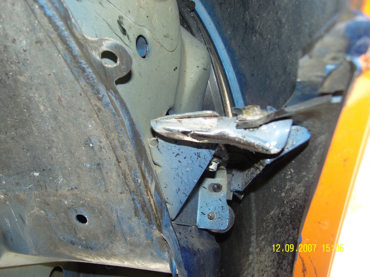

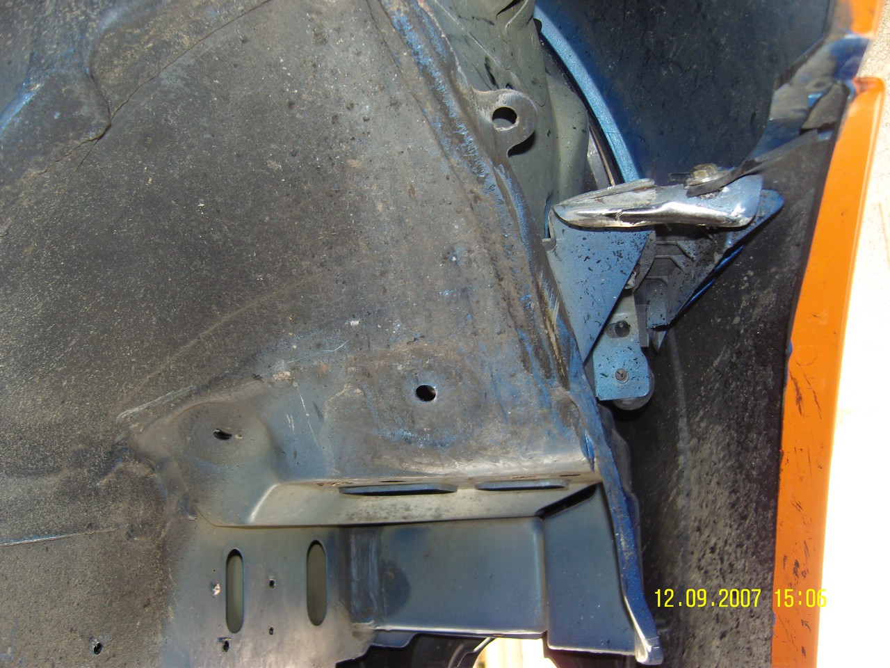

This pic you can see where my tyre has been rubbing the wing mounting

Radiator looks very nice, are you willing to say £ and where from?

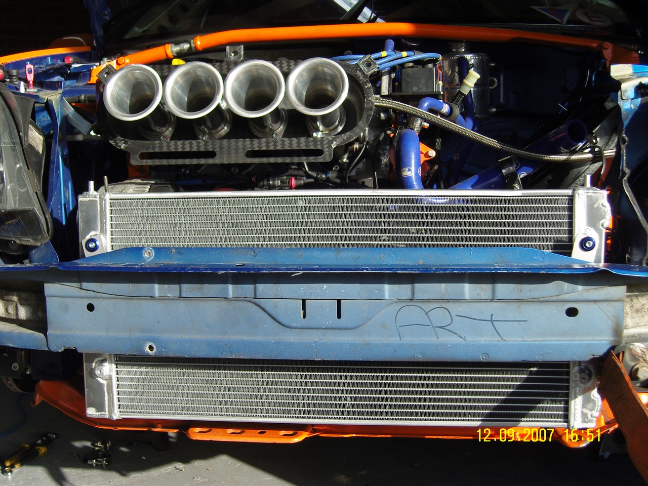

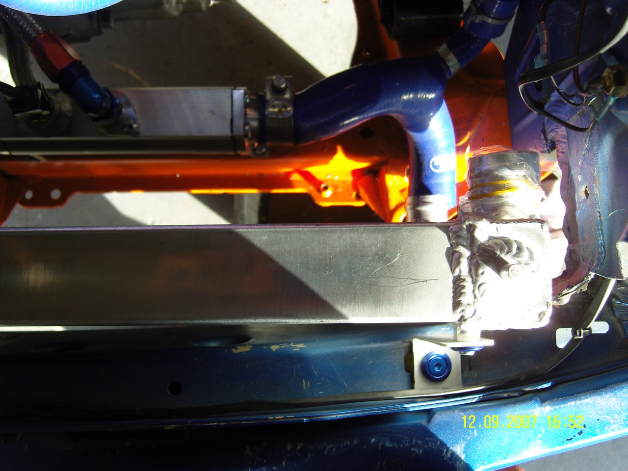

Not sure if this is likely to be a factor but you can see in those pictures how much of the core is blocked by the cross member, I know you dont need to have the whole core exposed to air flow, and the exit from any radiator is more important than the entry but that said, a few holes in the crossmember as many others are now doing might help make better use of the surface area available.
  BMW Z4
It was £164 from off of Ebay. It's a golf one. If I drill the crossmember it will weaken it in a crash wont it. I thought they got funny about even removing the crash plastic out of the bumper! I am sure it will be fine as it is as the polo one was also behind the cross member and this one is much wider and thicker than that one. I only changed it because on a hot day like Cadwell the car was running hotter although it didnt overheat mind.

When you refer to "they" getting funny, who are you refering to?
Putting a few flared holes in it probably will weaken the crossmember slightly but if you consider how thick it is in the first place.
Could be wrong but I recon Renault want to spread an impact across the front of the car and therefor send it down both chassis legs hence why that bit is so strong, if it writes the car off they're not bothered, it's all about occupant safety. With a cage, proper seat and harness, things are a little different, i'd rather any damage was localised.
I'm keeping the plastic crumple bits, in the event of a relatively light impact there's a chance those could avoid or minimise any metal damage.
They as in the scruts. I don't know myself but was told by someone that they were funny with them over removing the honeycomb from behind the bumpers. I can't remember who that person was so I might have dreamt the whole incident.

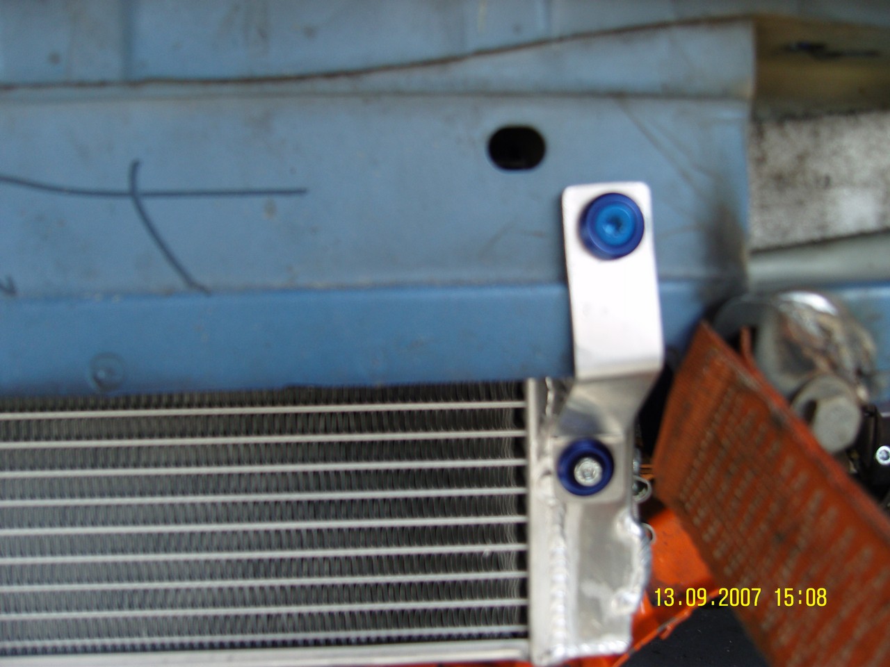

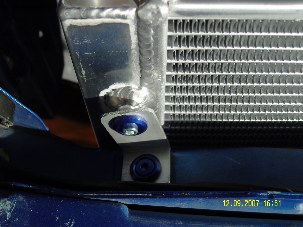

Nice rad Mark and thanks for the link! Doesn't it need to be mounted with some rubber mounts to allow movement with heat?
I have got the same wheel arch problems now i'm running the 205's will get investigating :)
