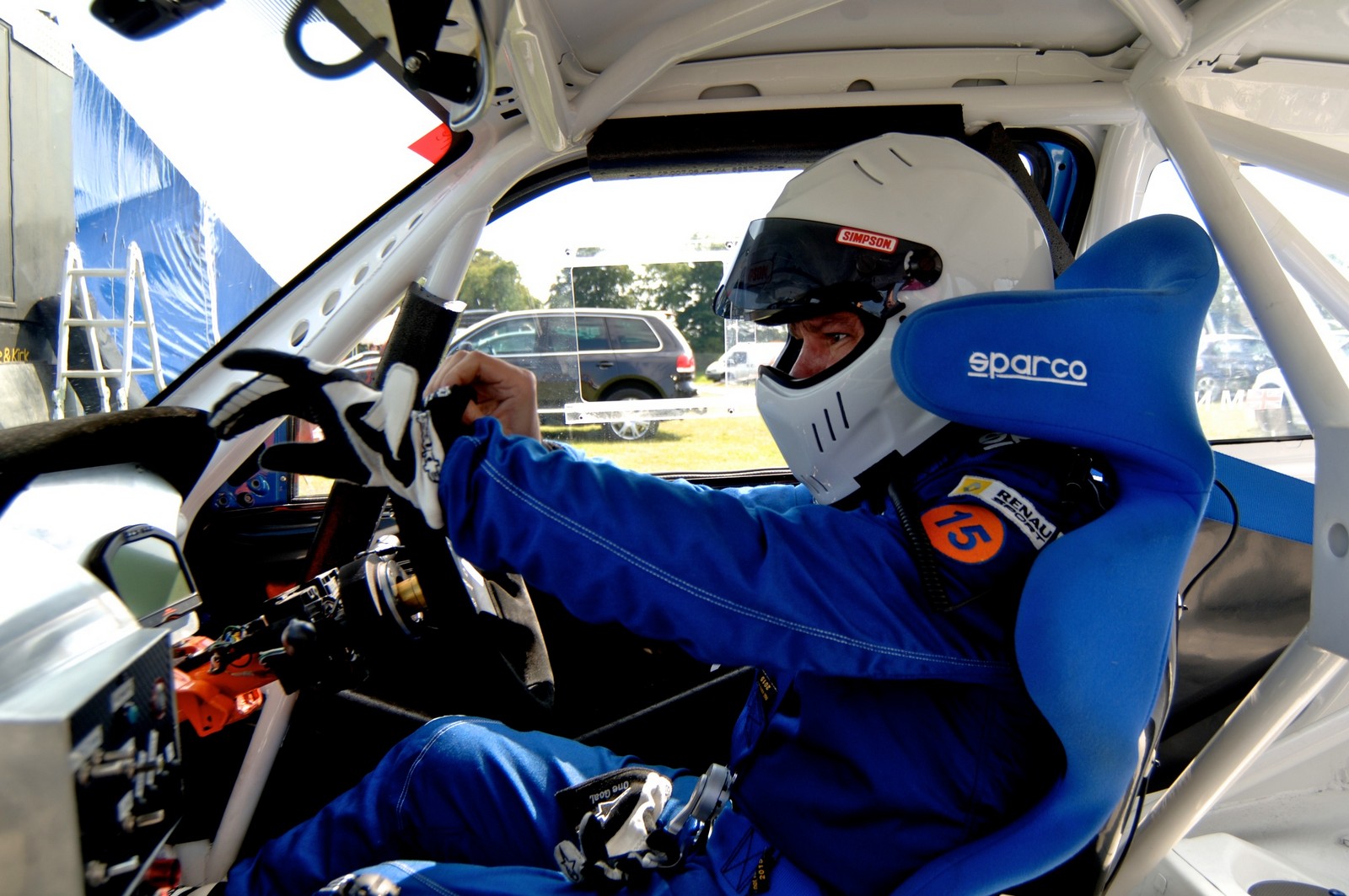

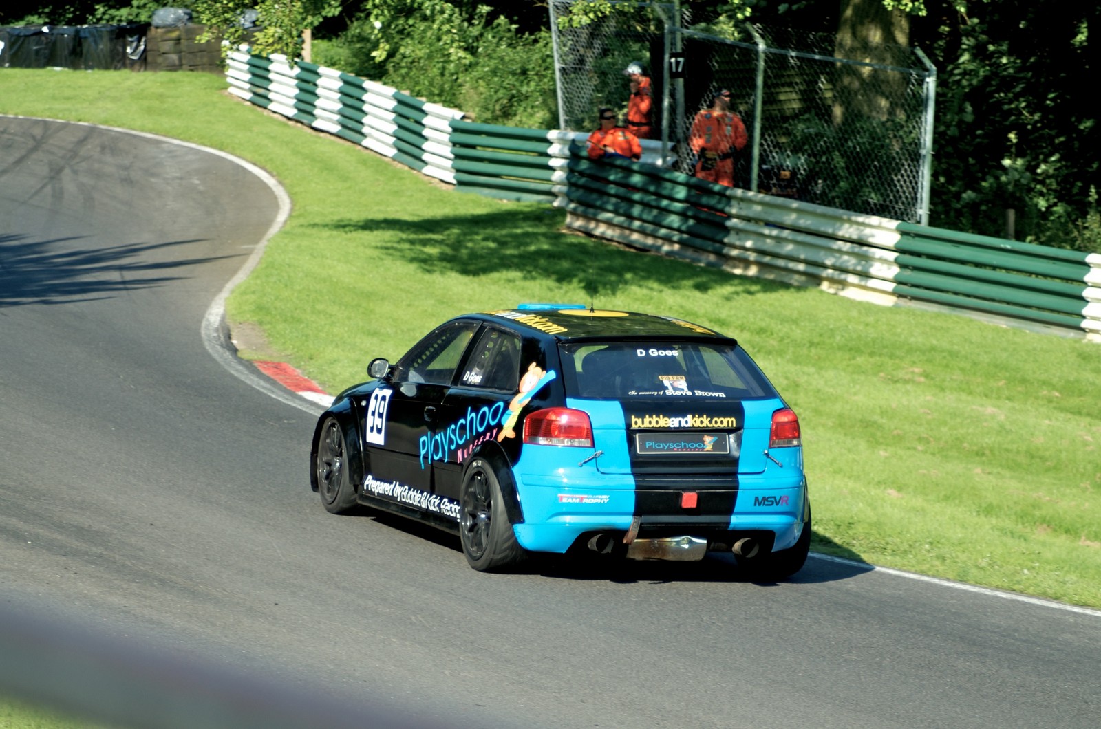

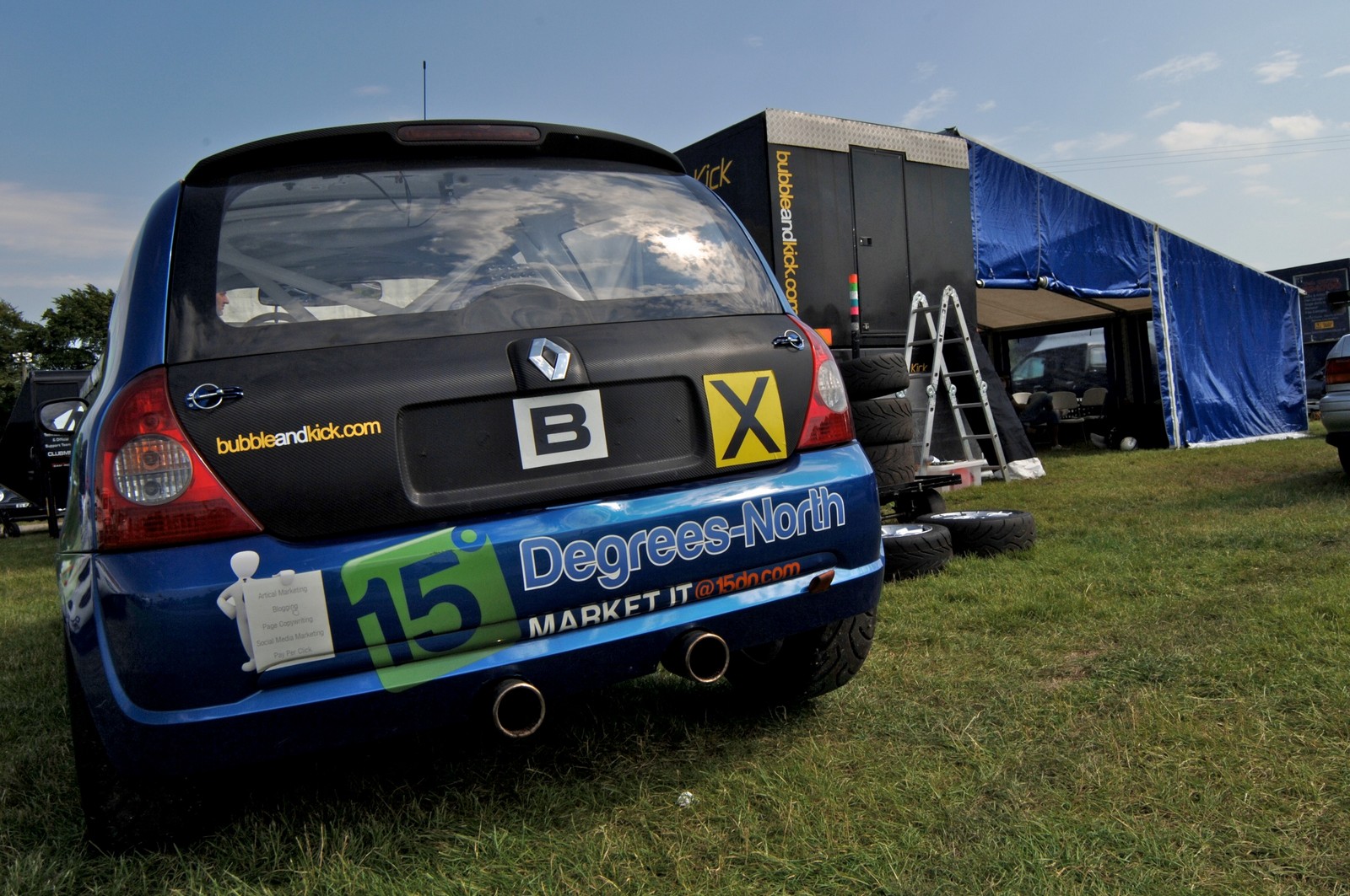

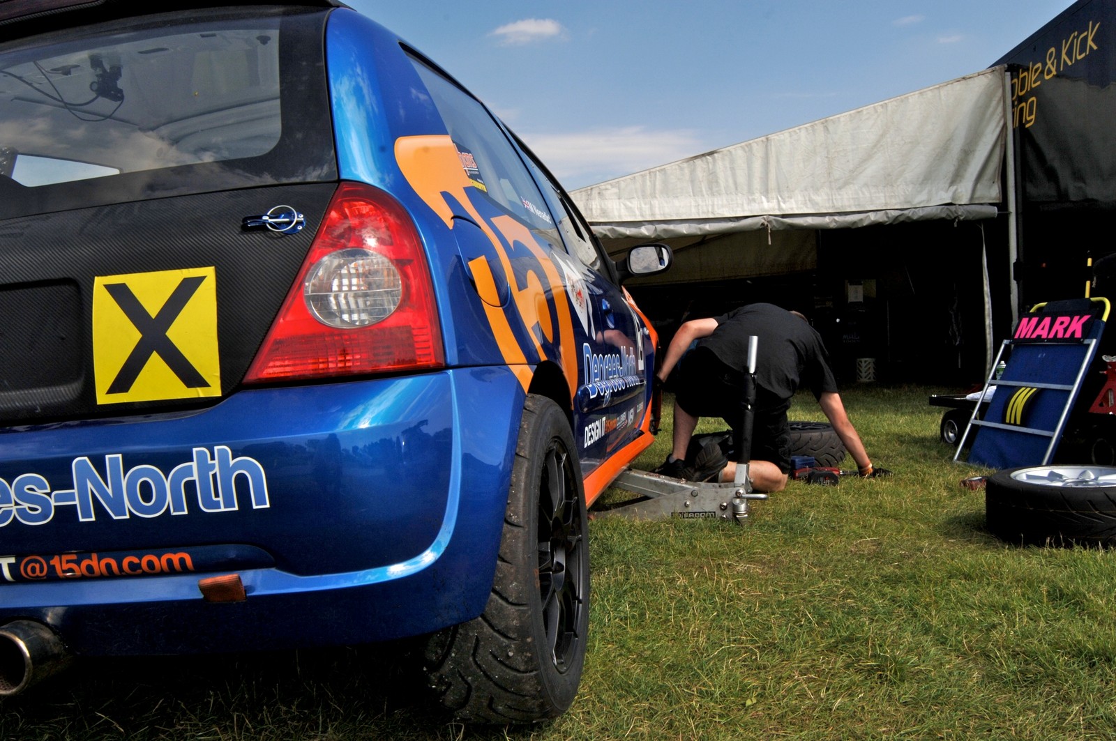

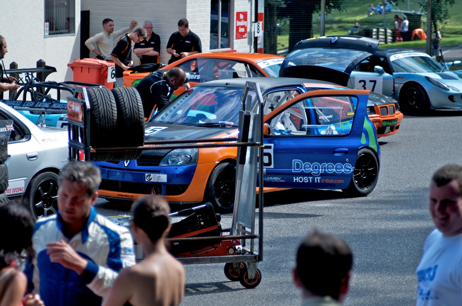

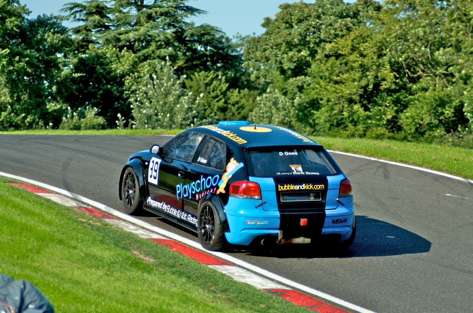

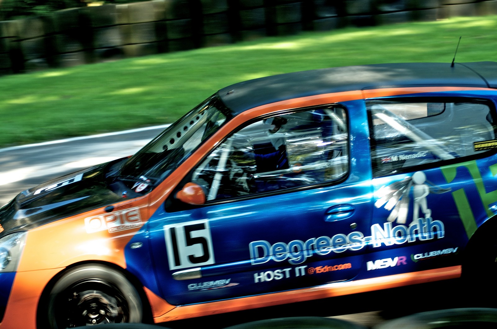

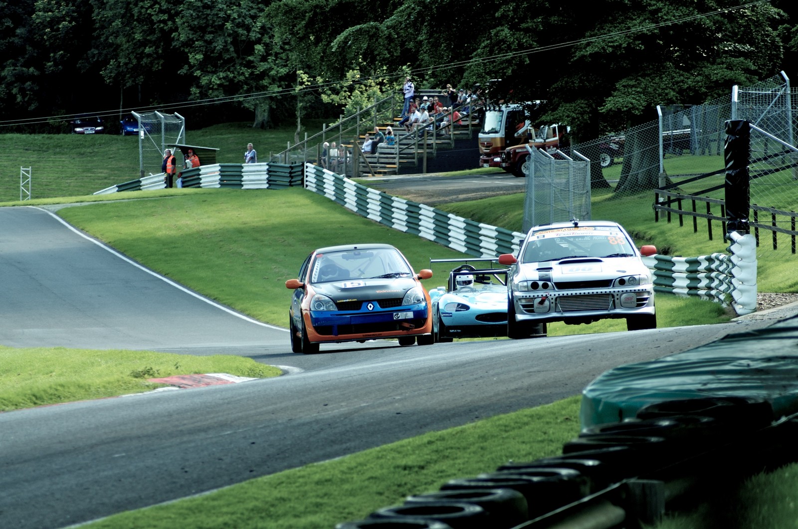

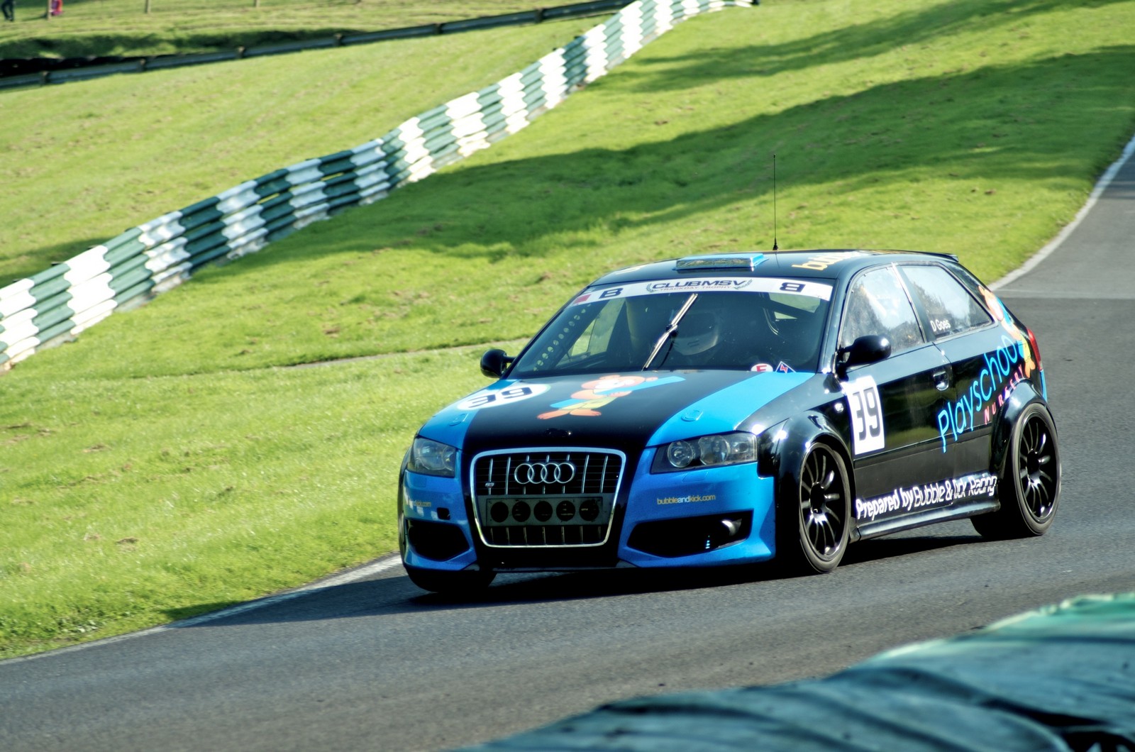

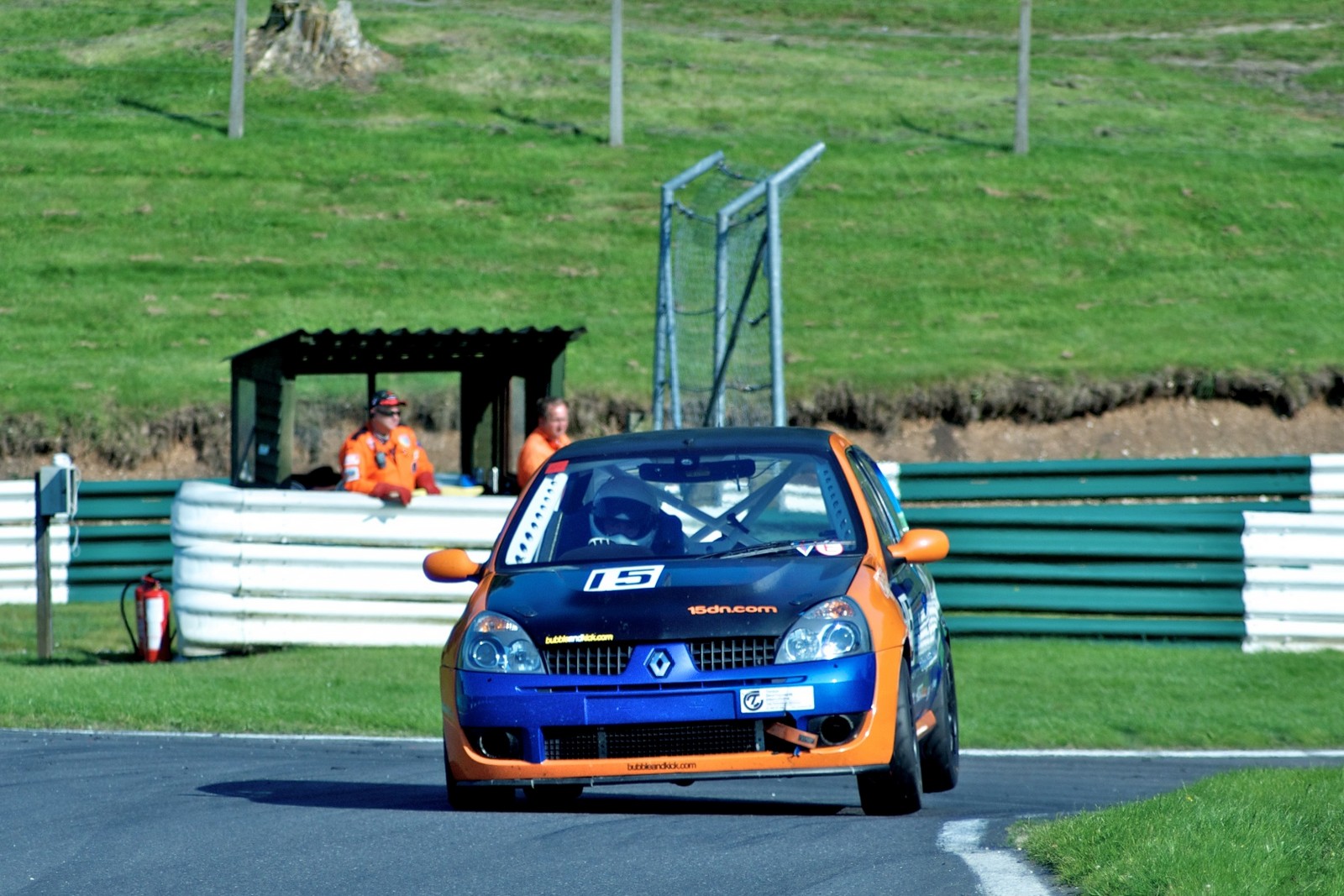

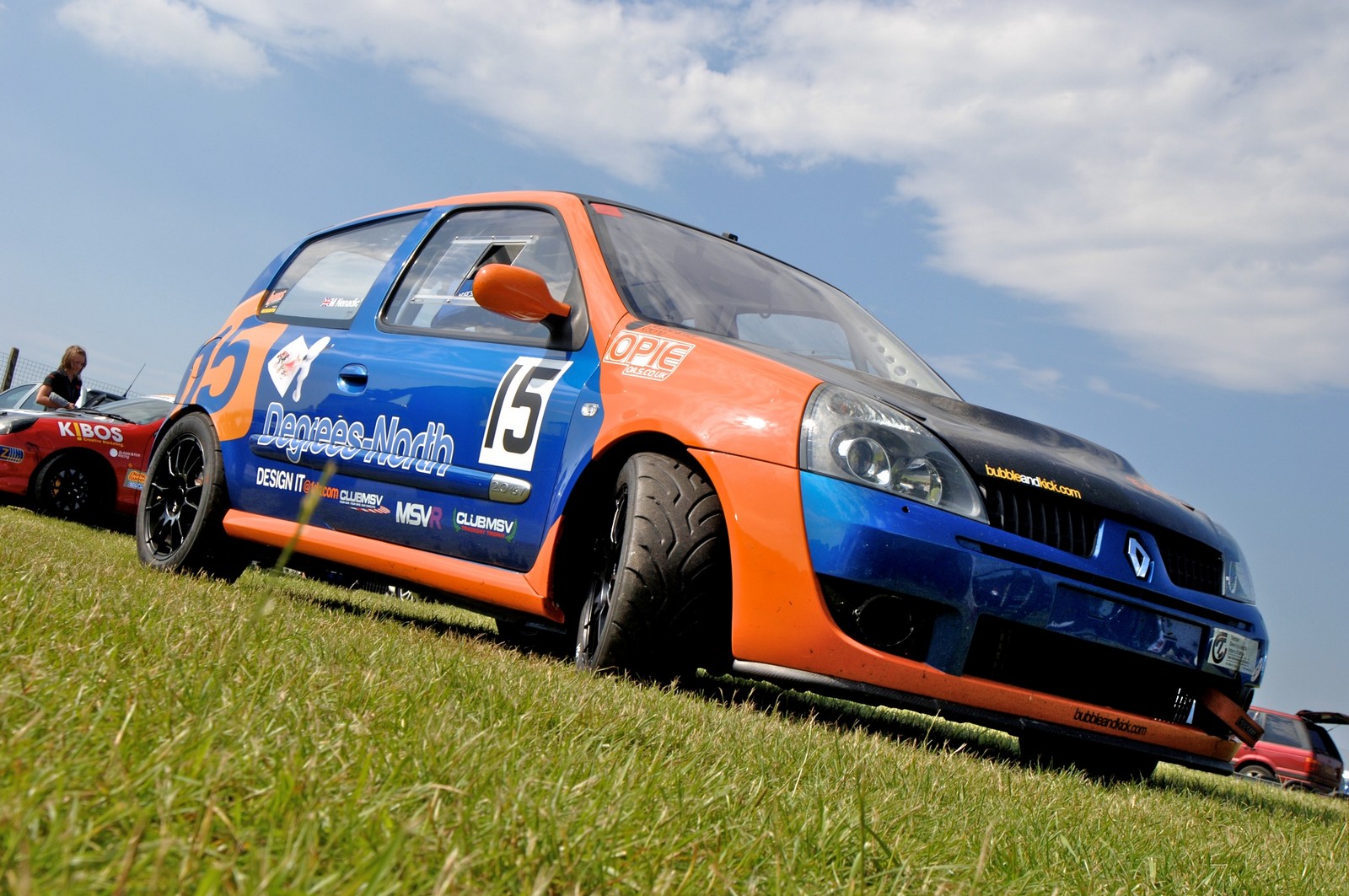

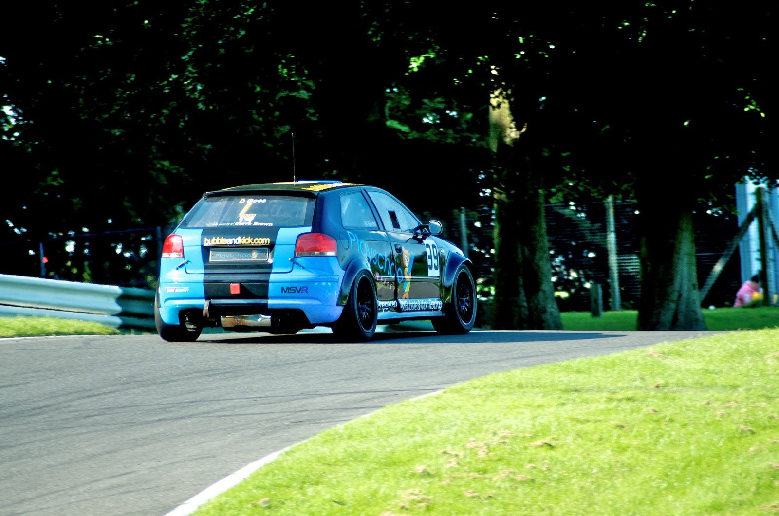

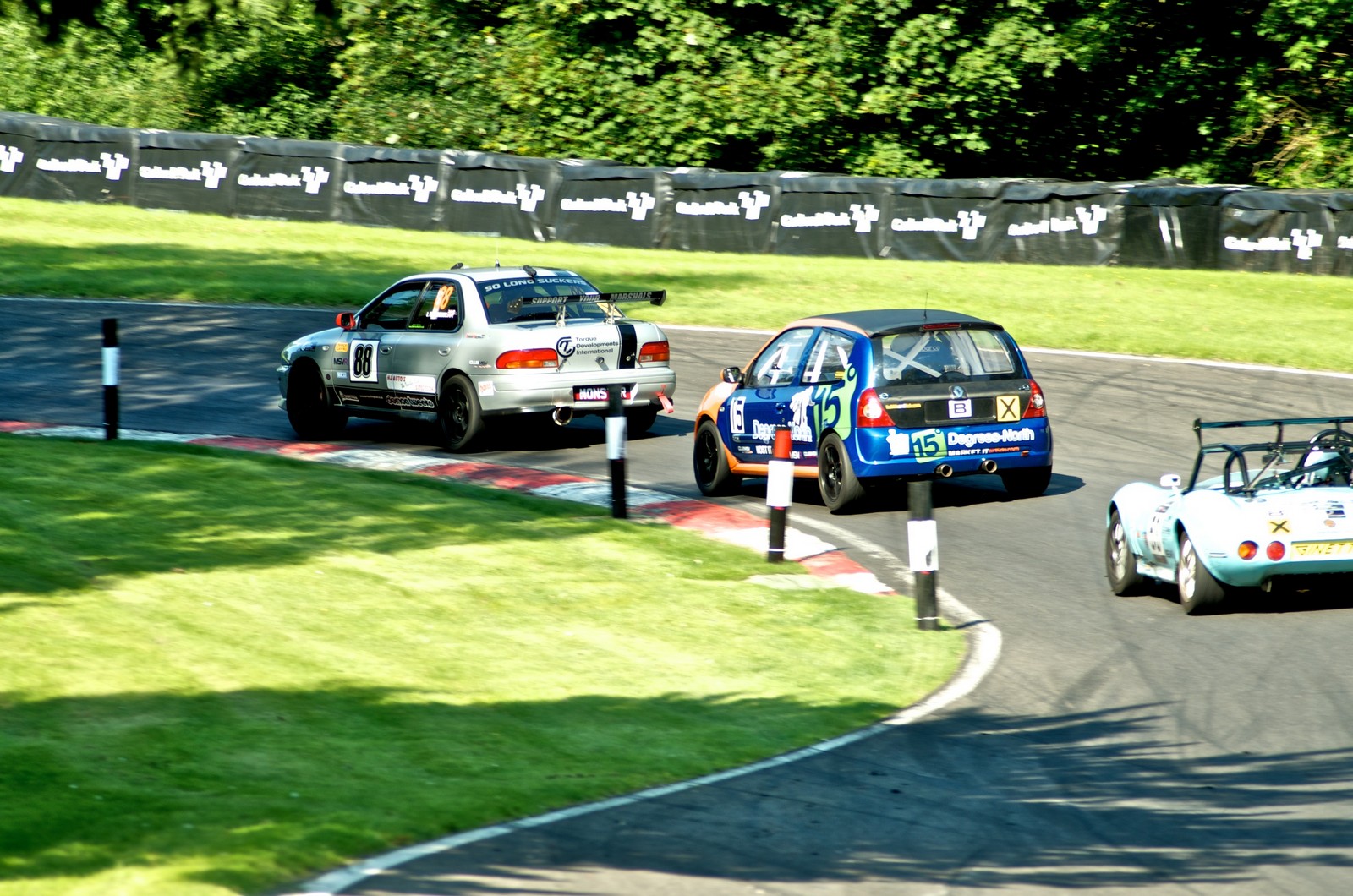

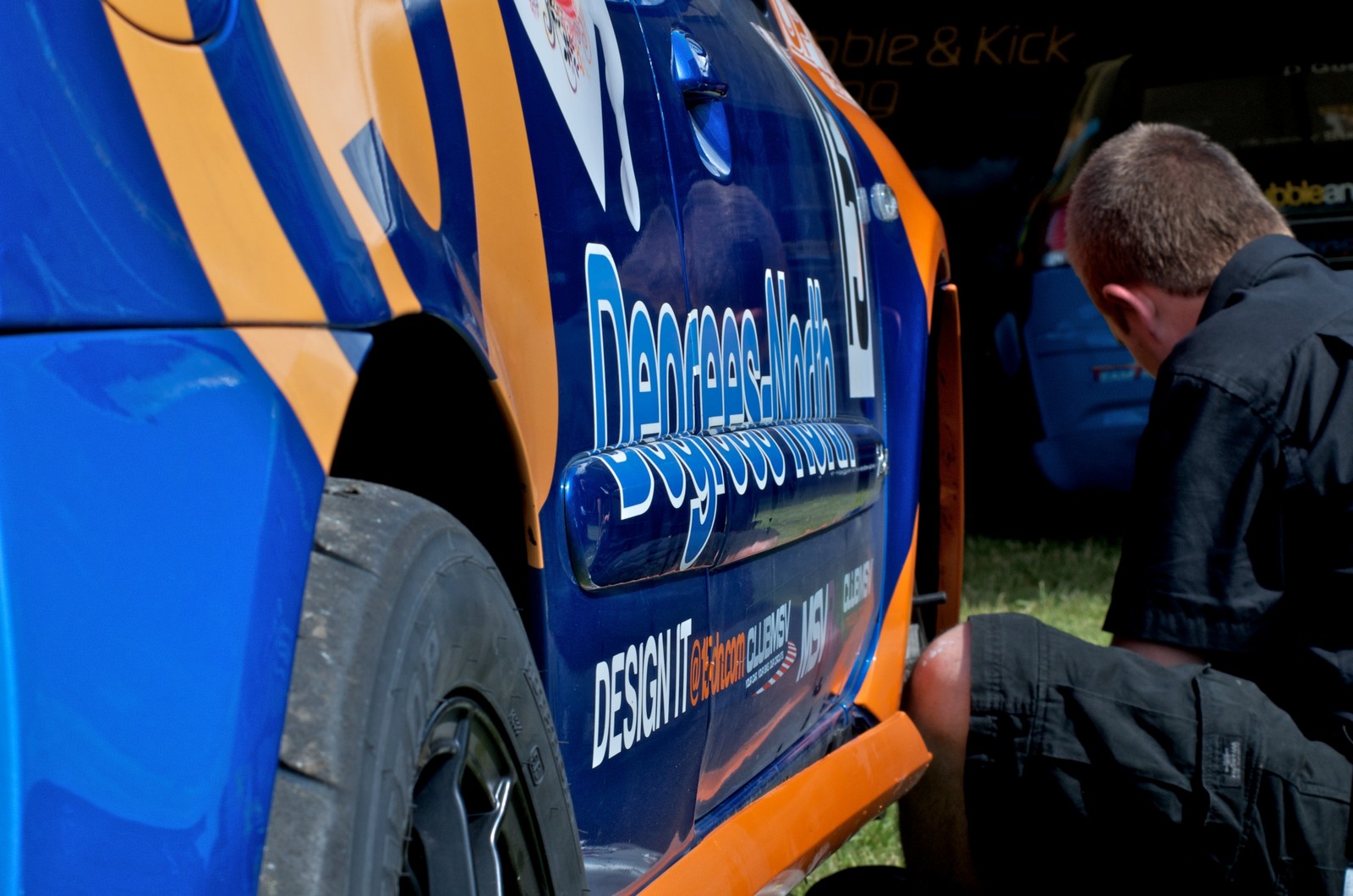

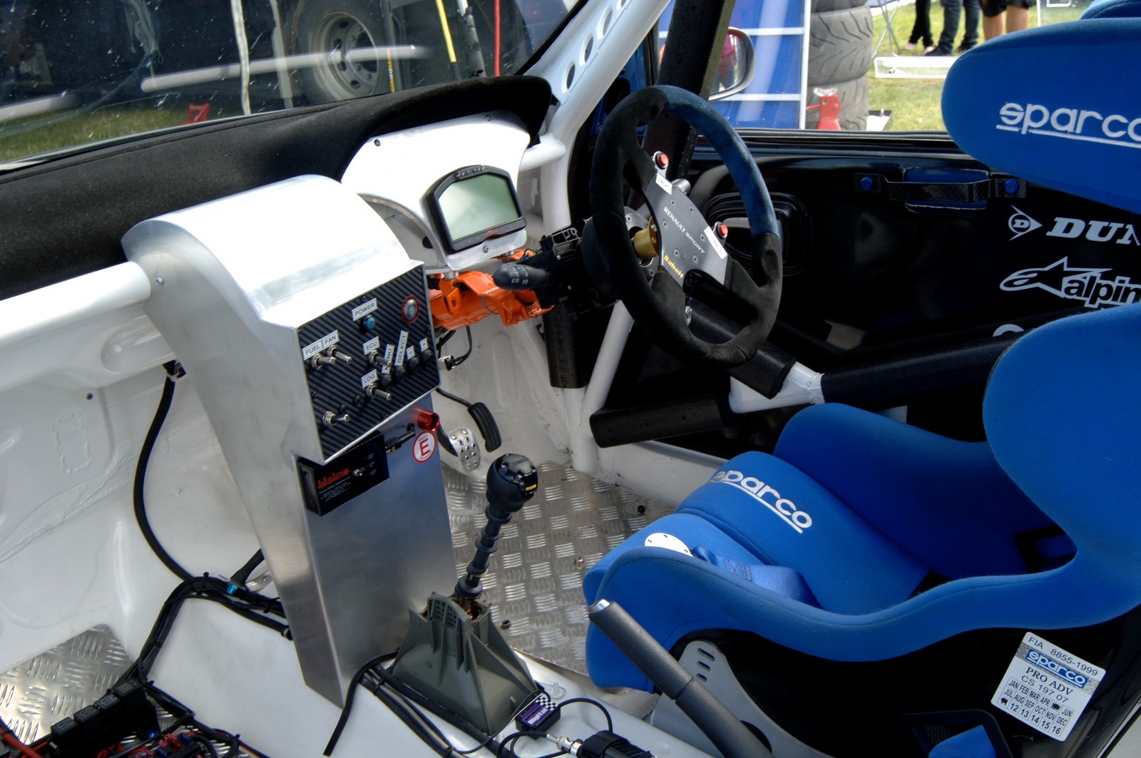

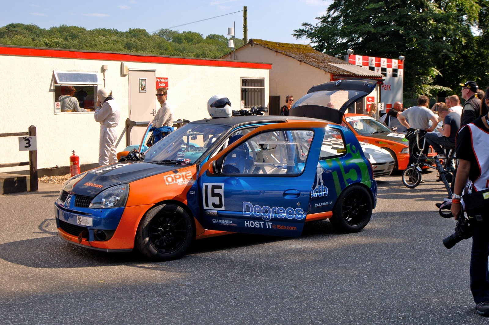

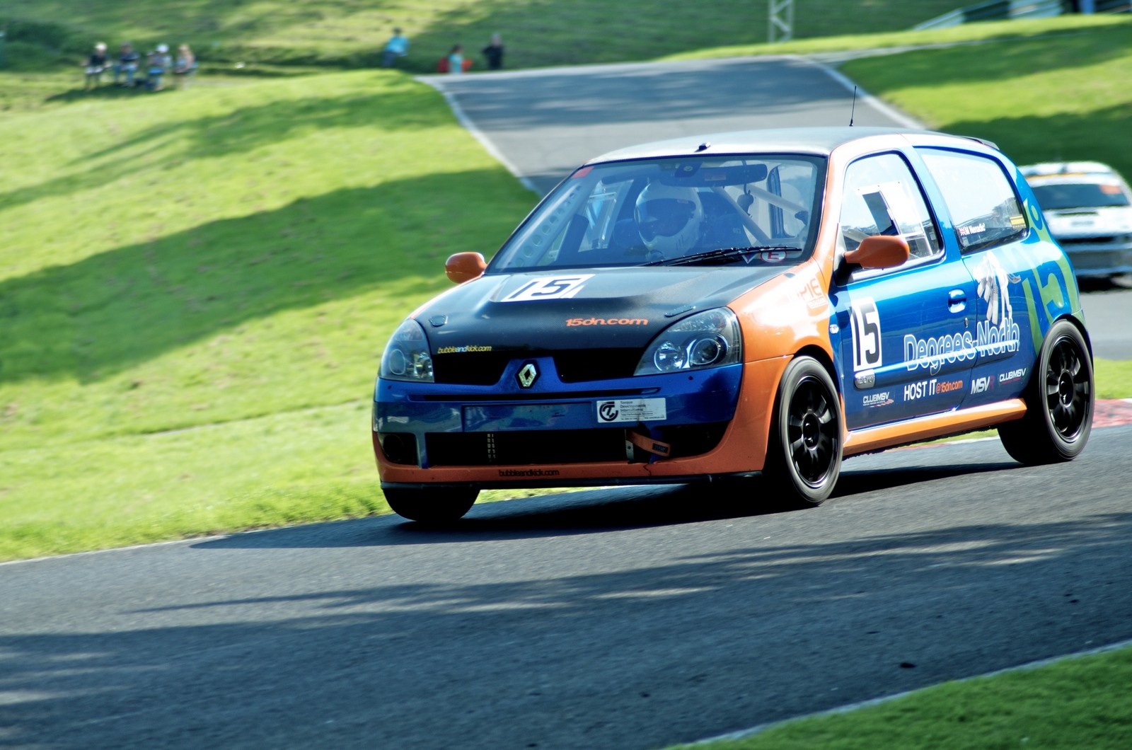

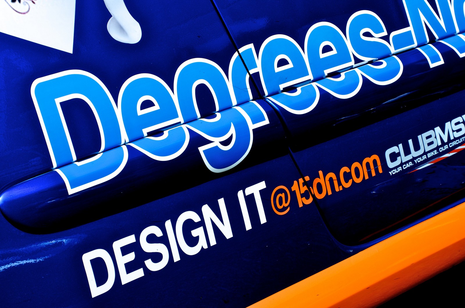

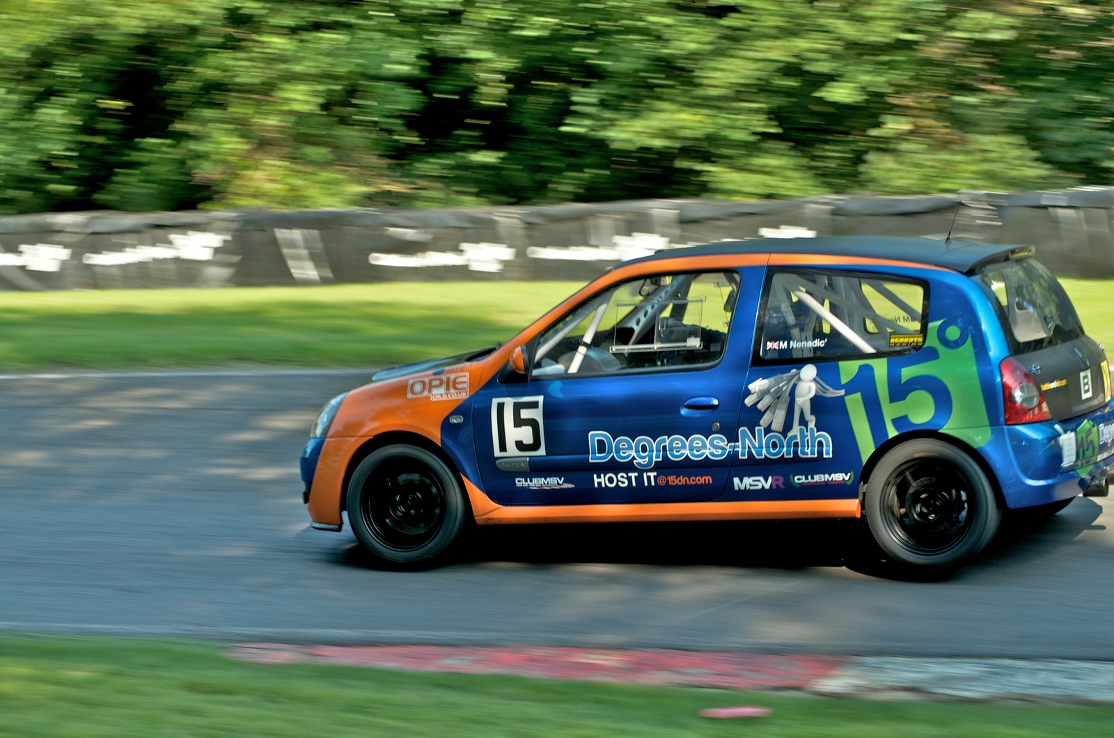

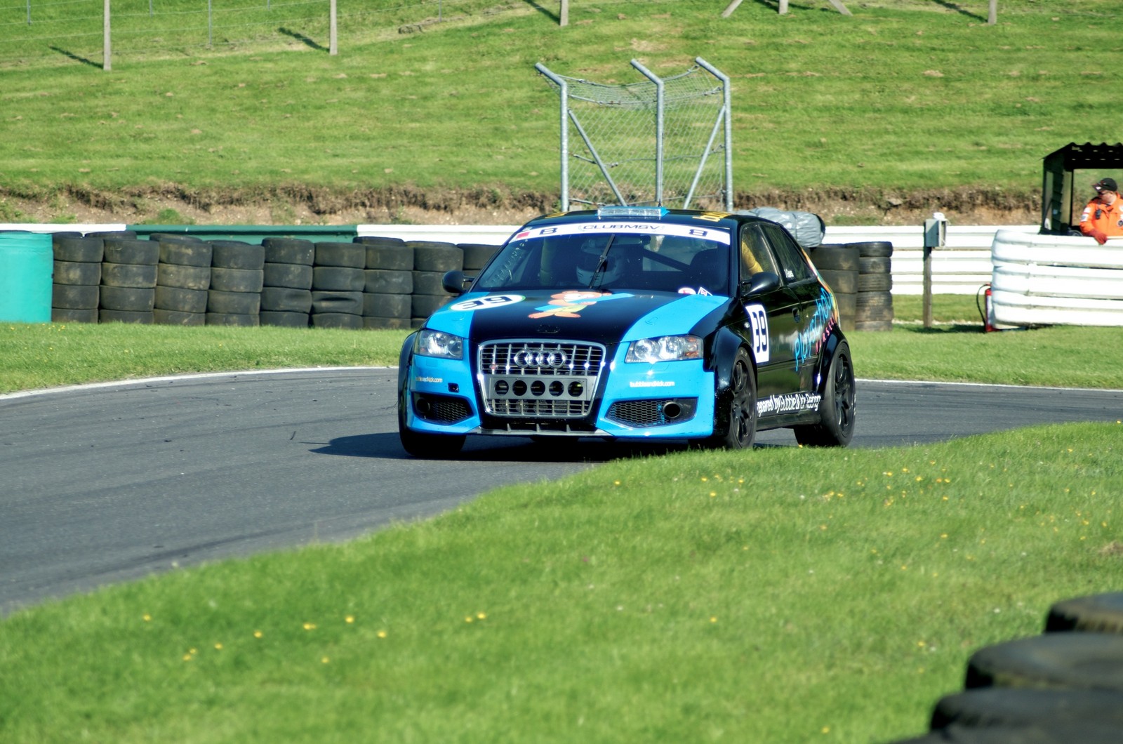

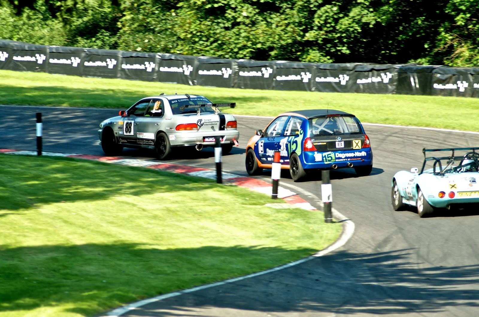

A few pictures as promised mate :) A few more, along with others from the day at my Facebook page - www.facebook.com/2007bc (please feel free to Tag/Share yourself in the photos!)

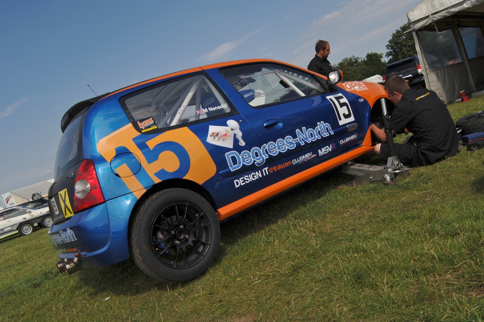

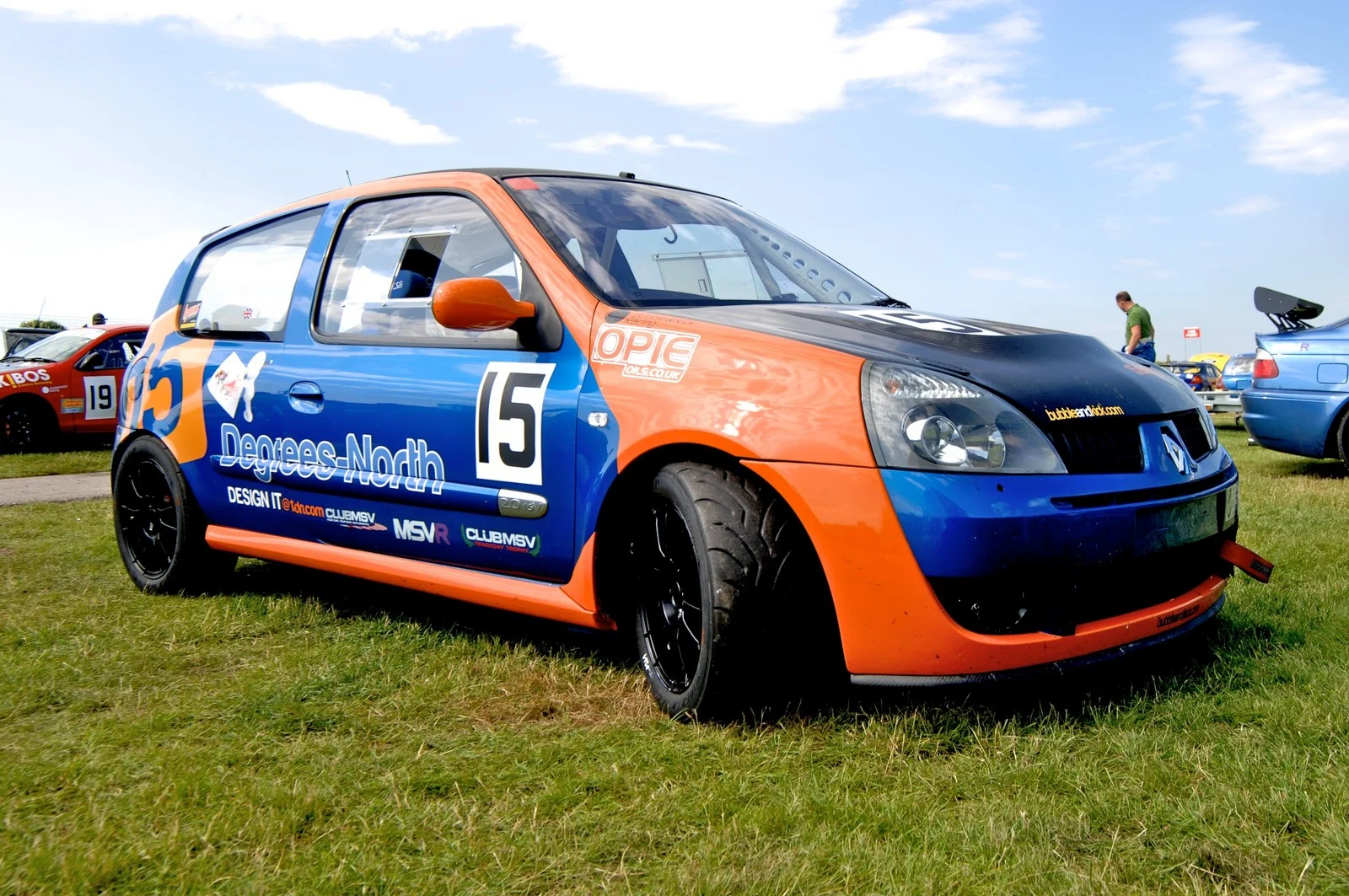

Here are my pictures taken by my mate Nick.
Here are my pics from Cadwell..

Don't know how I missed them but just seen the photo's from raceday in your post above looks great :)
The problem with going even lower is you affect the kinematics even more so roll centre's, bump steer and various other things. I would also be wary because of how it was catching on various bits of the car when under load. The car did look to roll a bit coming in towards the Mountain complex but it can't be a bad thing as you still won lol! If you stiffened it up then it probably wouldn't catch so could lower it more but if it were me then I would just leave it as it's obviously working well as is :)
