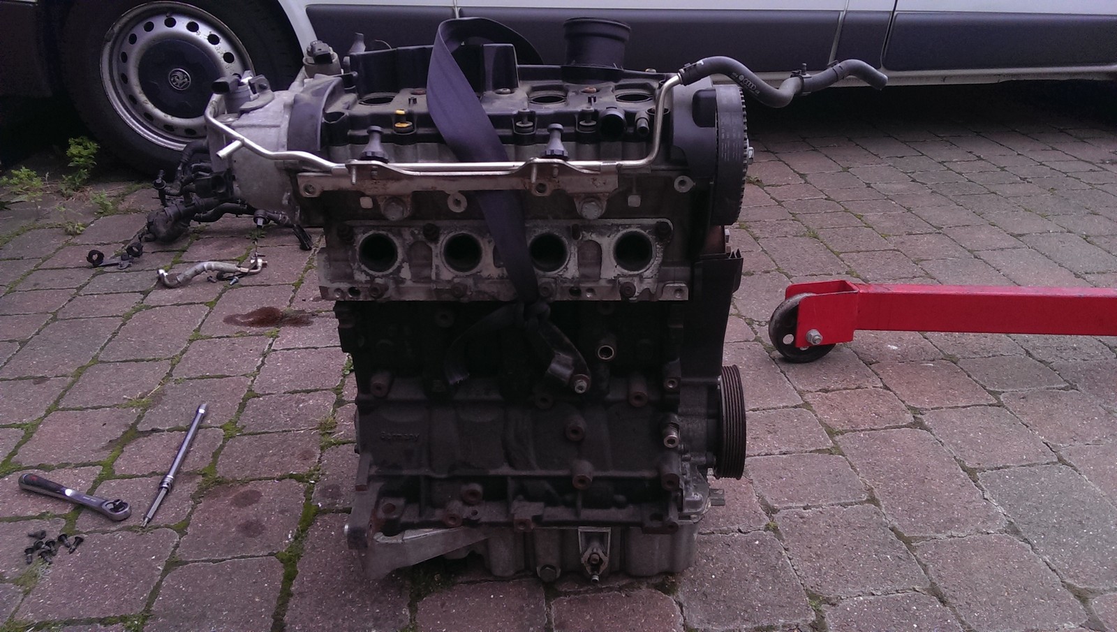

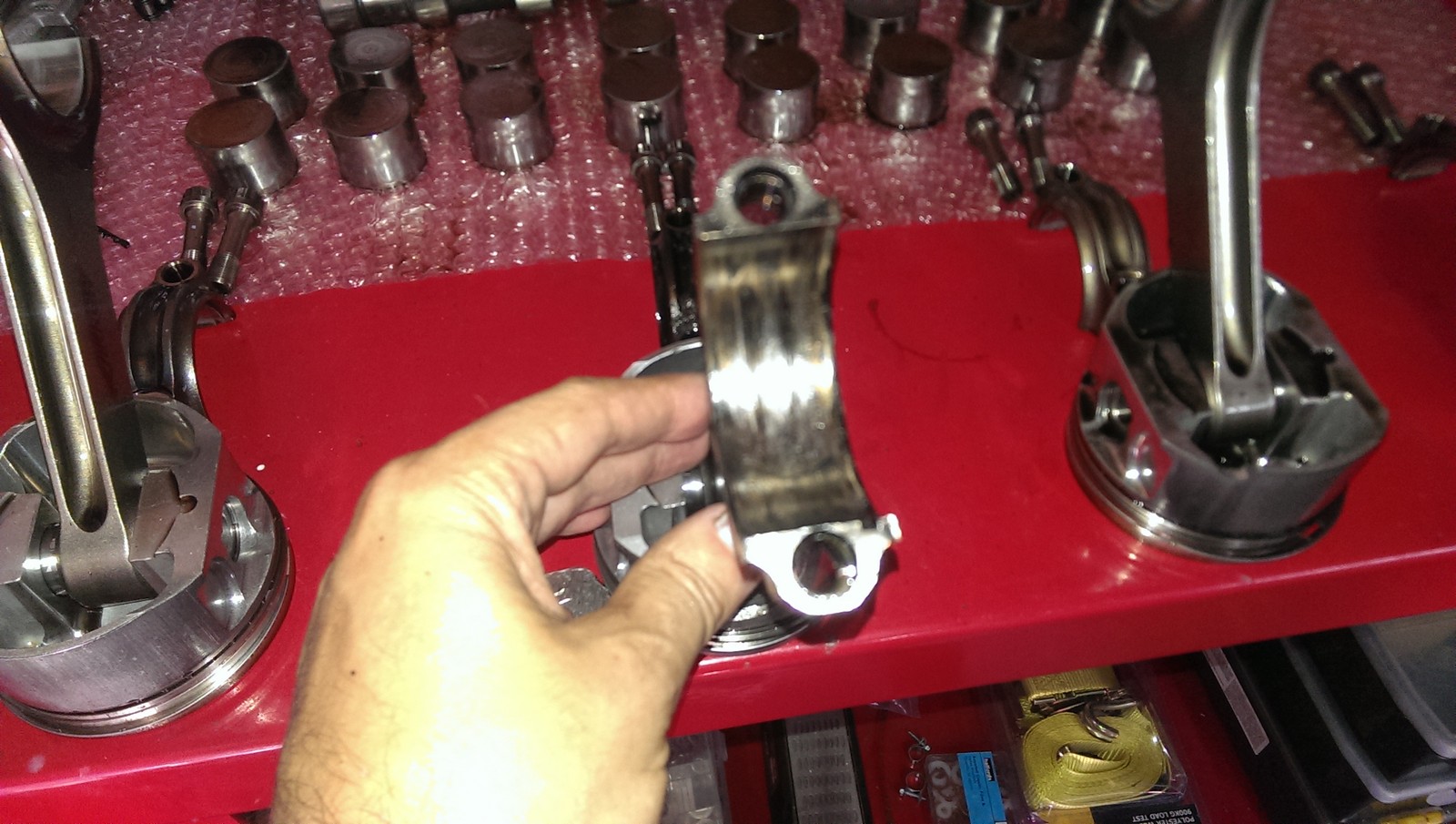

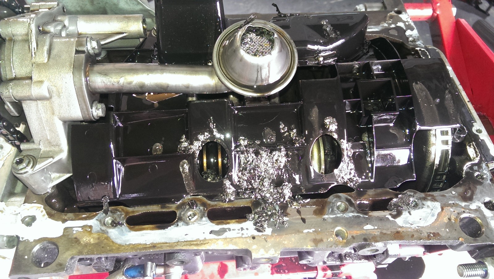

Engine Strip
Big end destroyed
Rod fucked and both either side according to Arrow
Block fucked
Piston busted
Piston hit head underside fucked
Great
Total rebuild :(

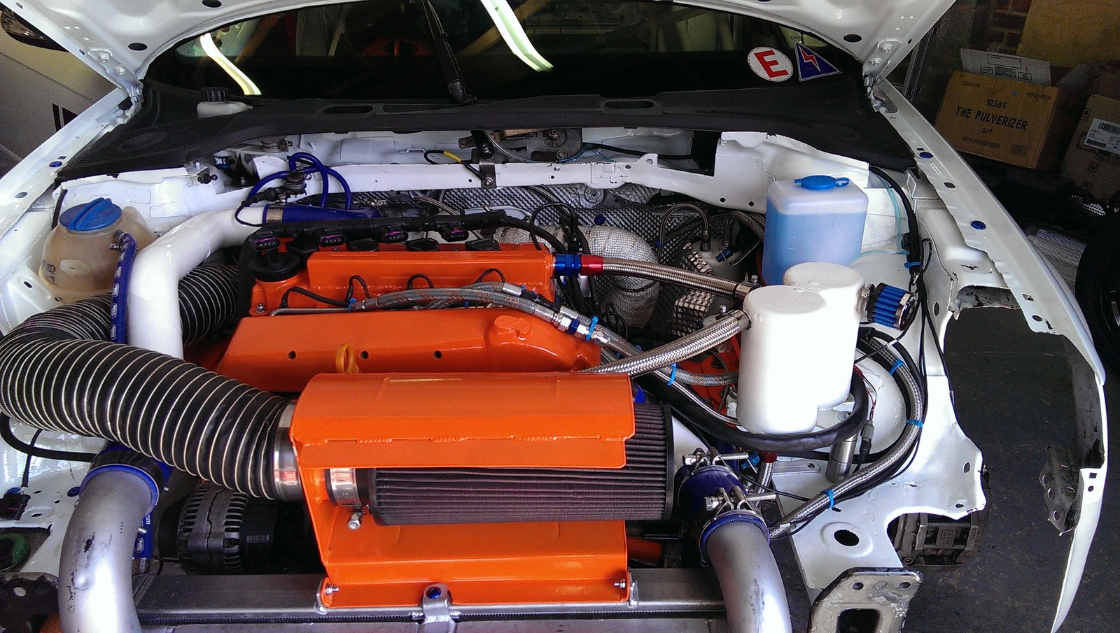

Ceramic coated Turbo, Mani and downpipe
Electric water pump
Evans waterless coolant

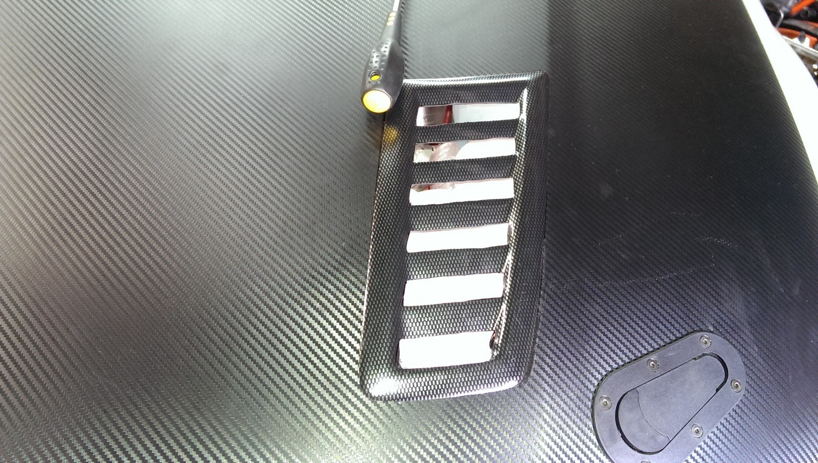

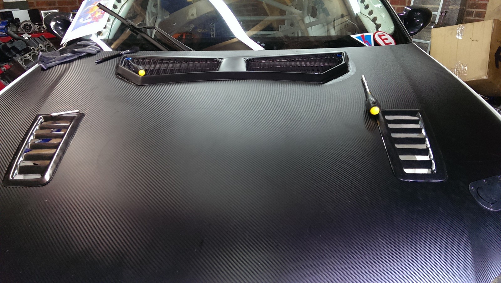

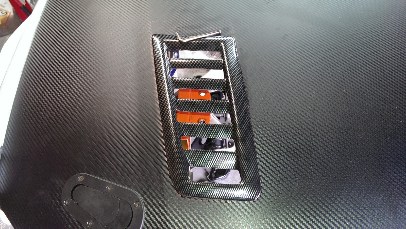

Vented bonnet
19 row oil cooler
Remove water cooled audi oil cooler
Bit more heat shielding
That lot should sort my overheat issues out nicely.

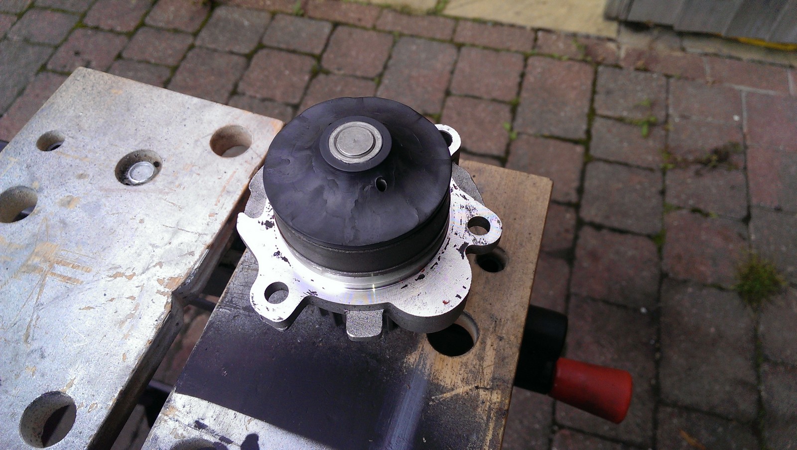

A friend of mine had issues with the water pump on his audi TT, the vanes came loose?? Or span in the shaft??
I cant remember exactly now...
Definatly sounds like a catalogue of gremlins for you... onwards and upwards as they say!!
The plastic empellers fall to pieces.

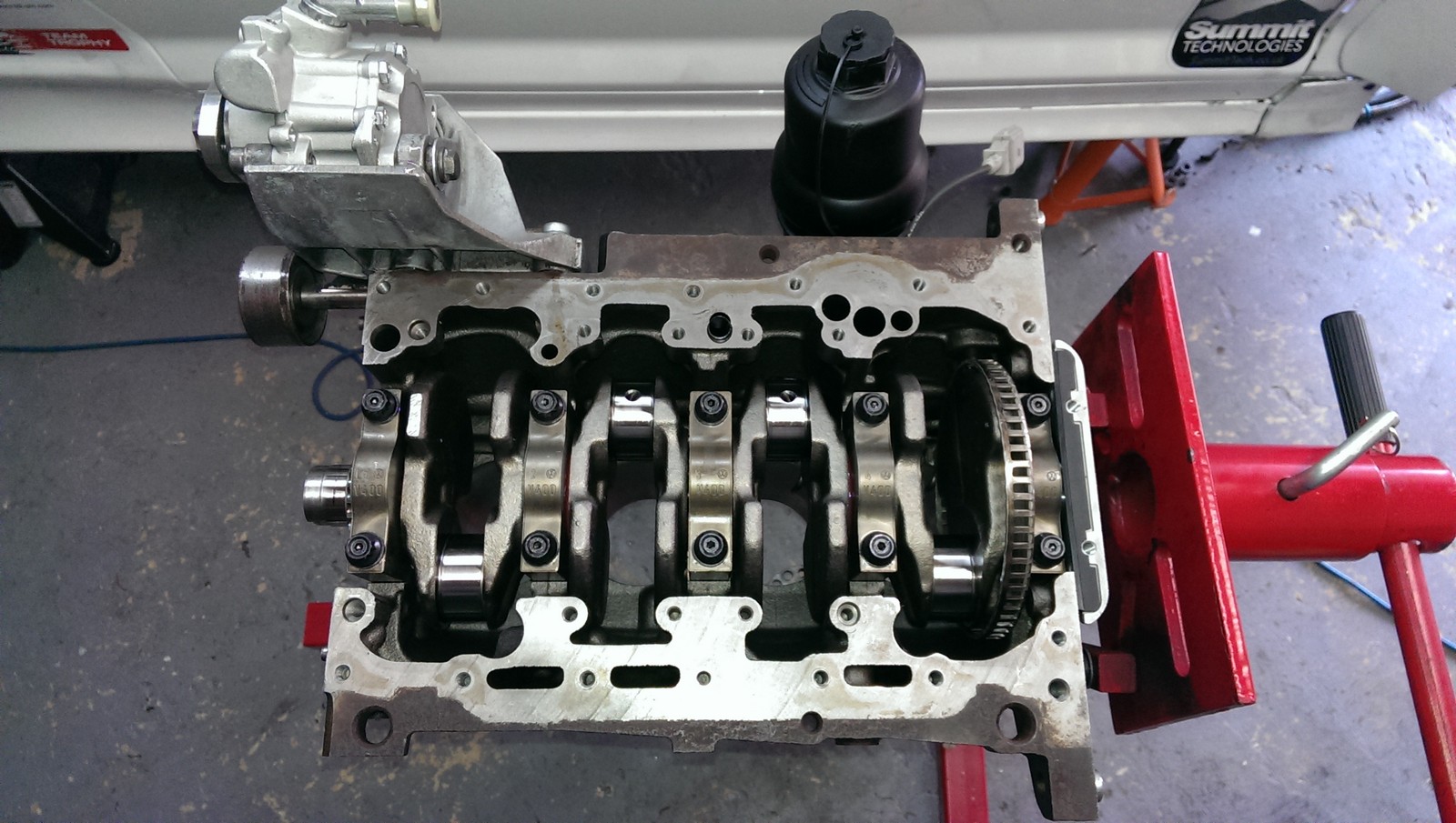

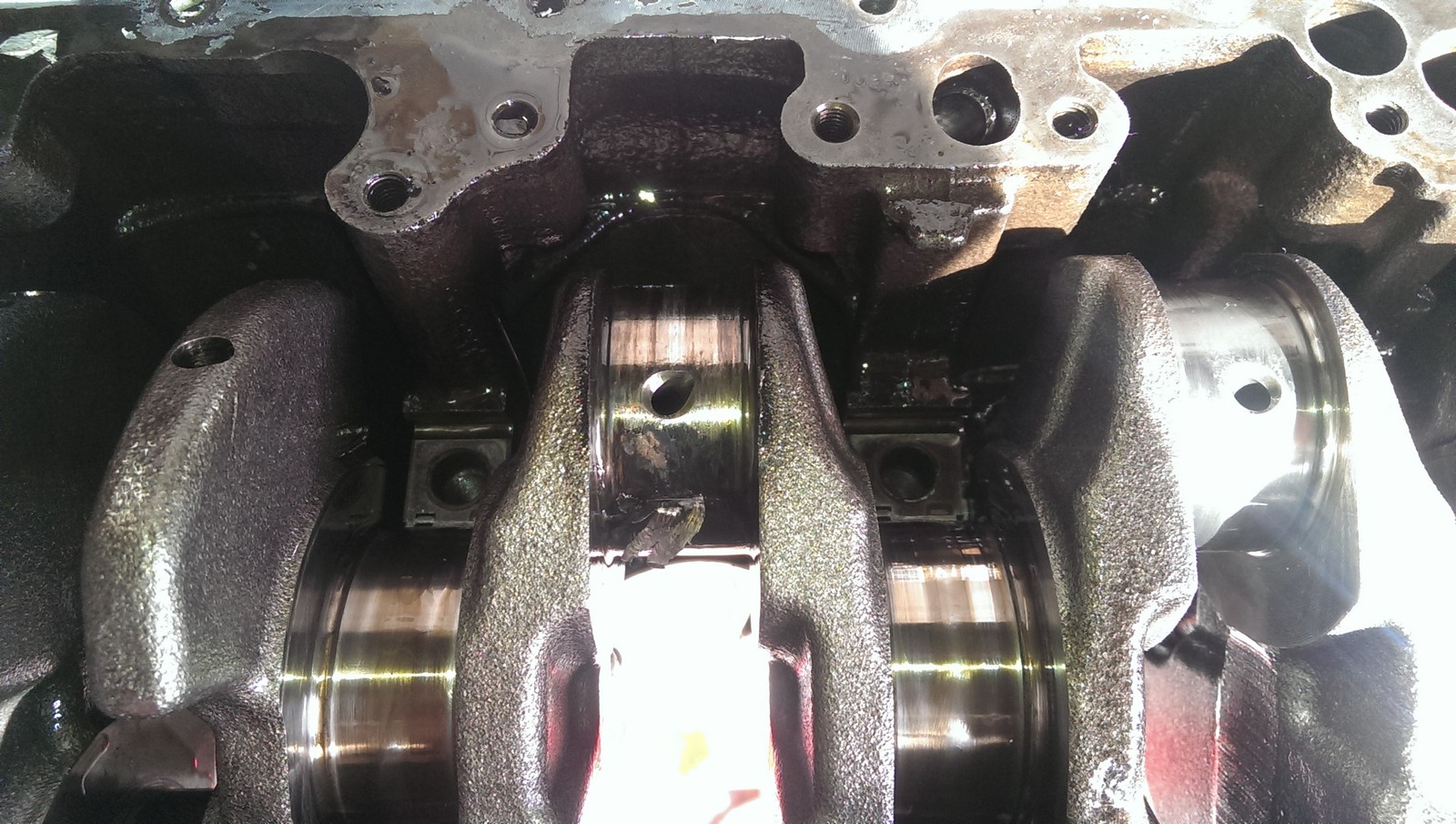

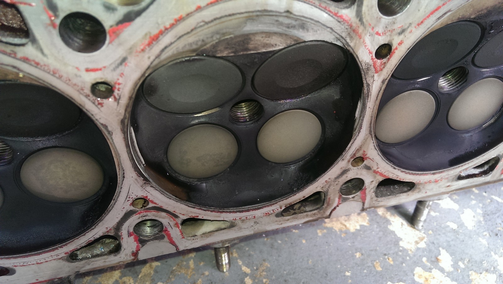

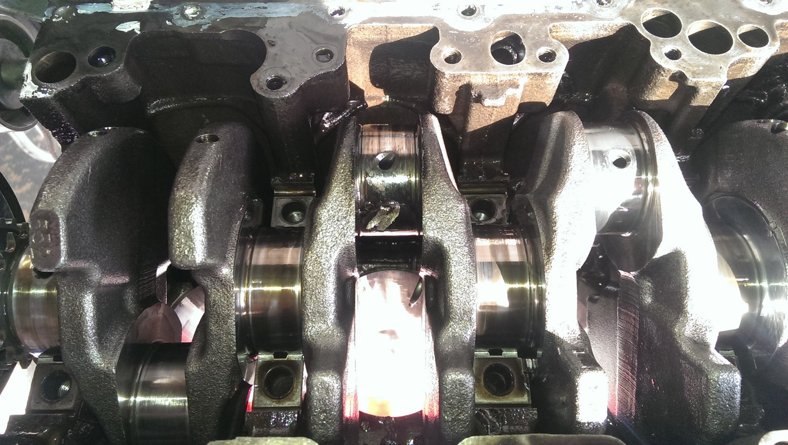

So some more pictures for you.
A nice shot of the mess you make when you overheat an engine! Dont do it.

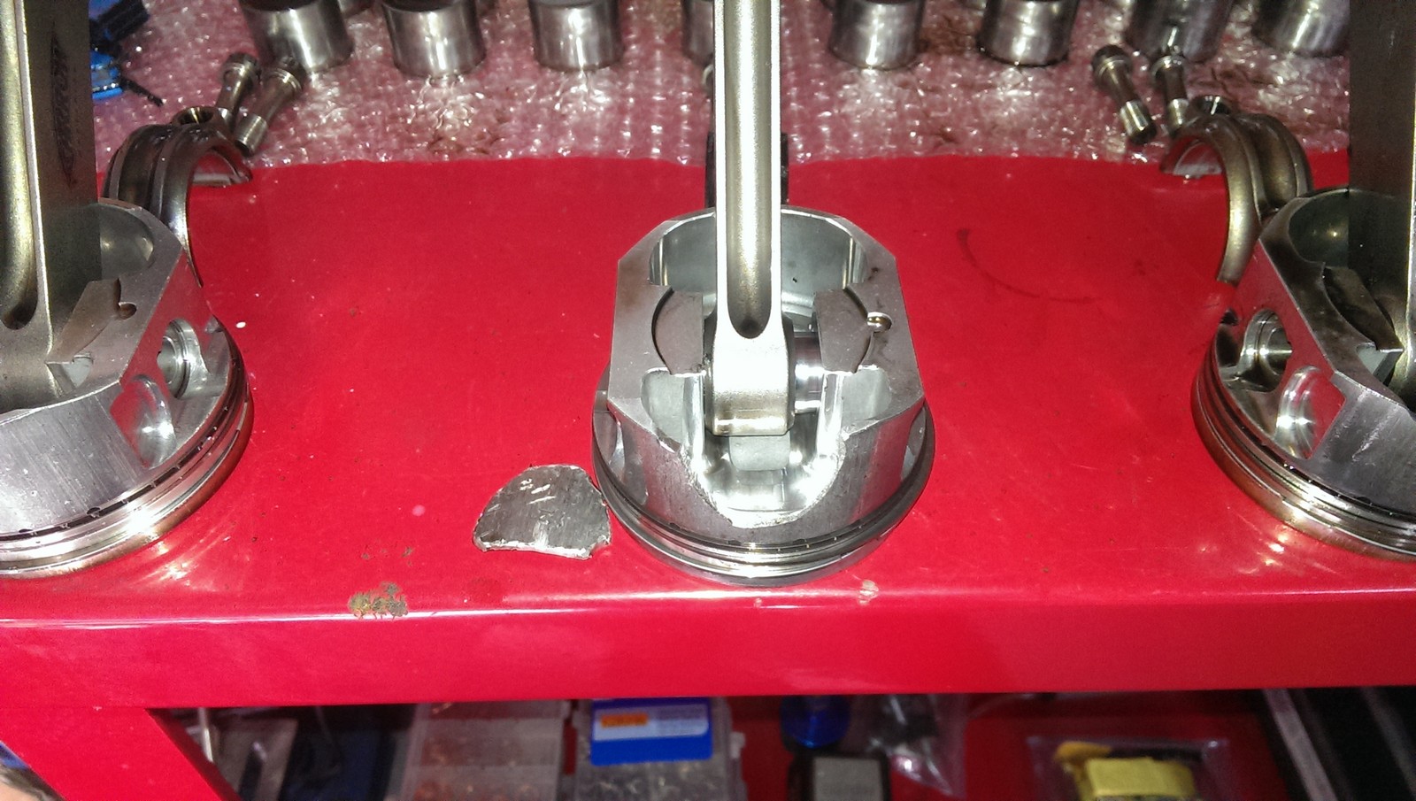

The piston had hit the head as you can see
And knackered the crank too
And then bust the piston
And the rod for good measure

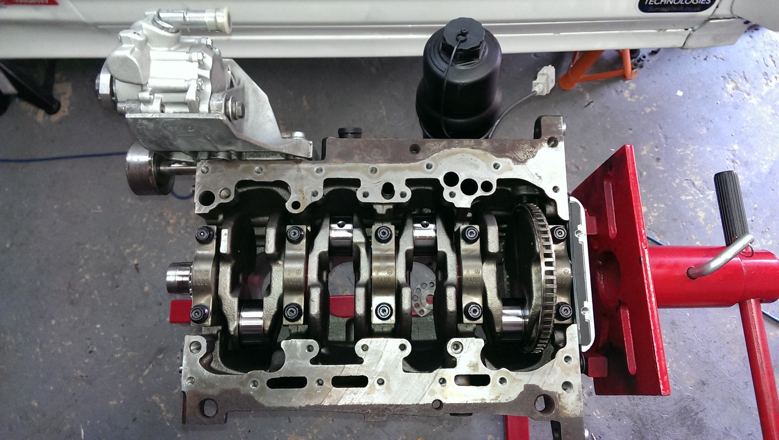

My new engine block BWA £195 quid non runner. A risk
A vaneless water pump
I dont think I will have a heat issue anymore

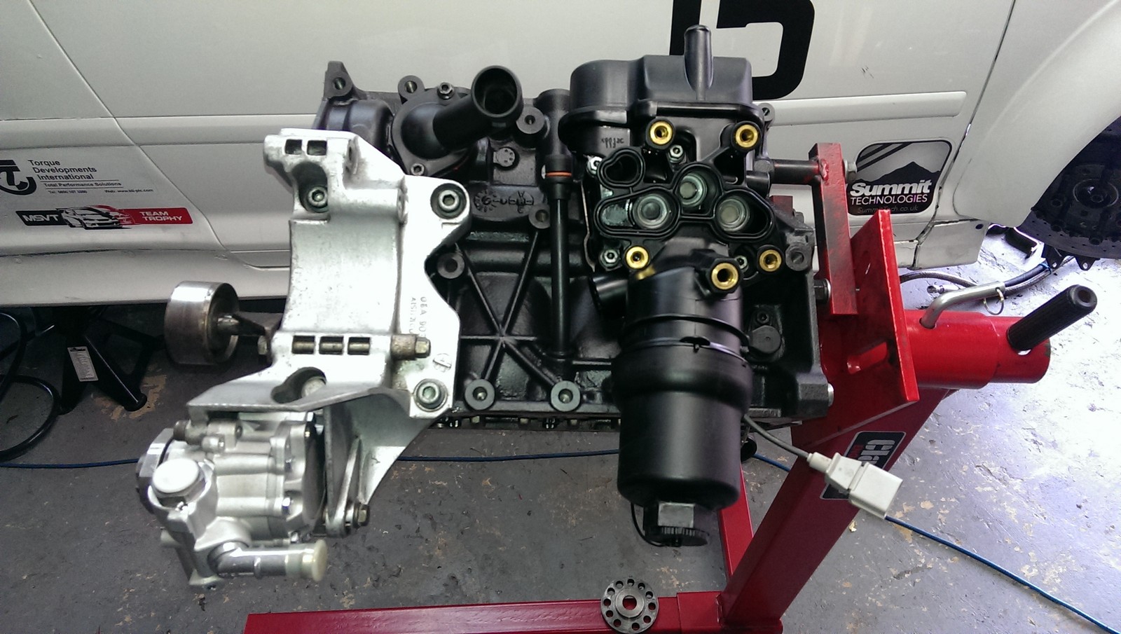

A hopefully metal free oil filter housing
My new crank fitted. This had the smaller oil pump chain wheel on it. So I pulled it off with my puller and tapped on the AXX bigger one.
More to follow...
