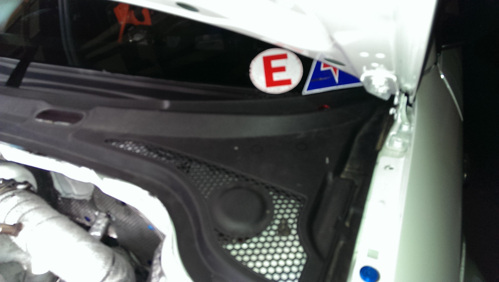

Remove buttons from front plastic scuttle and make ally panel for them to go on because the front scuttle dont fit. Even though it is the right one for the car and Crispy and I got it to fit and then fitted the buttons to it. 4 hours at £60 an hour plus VAT!

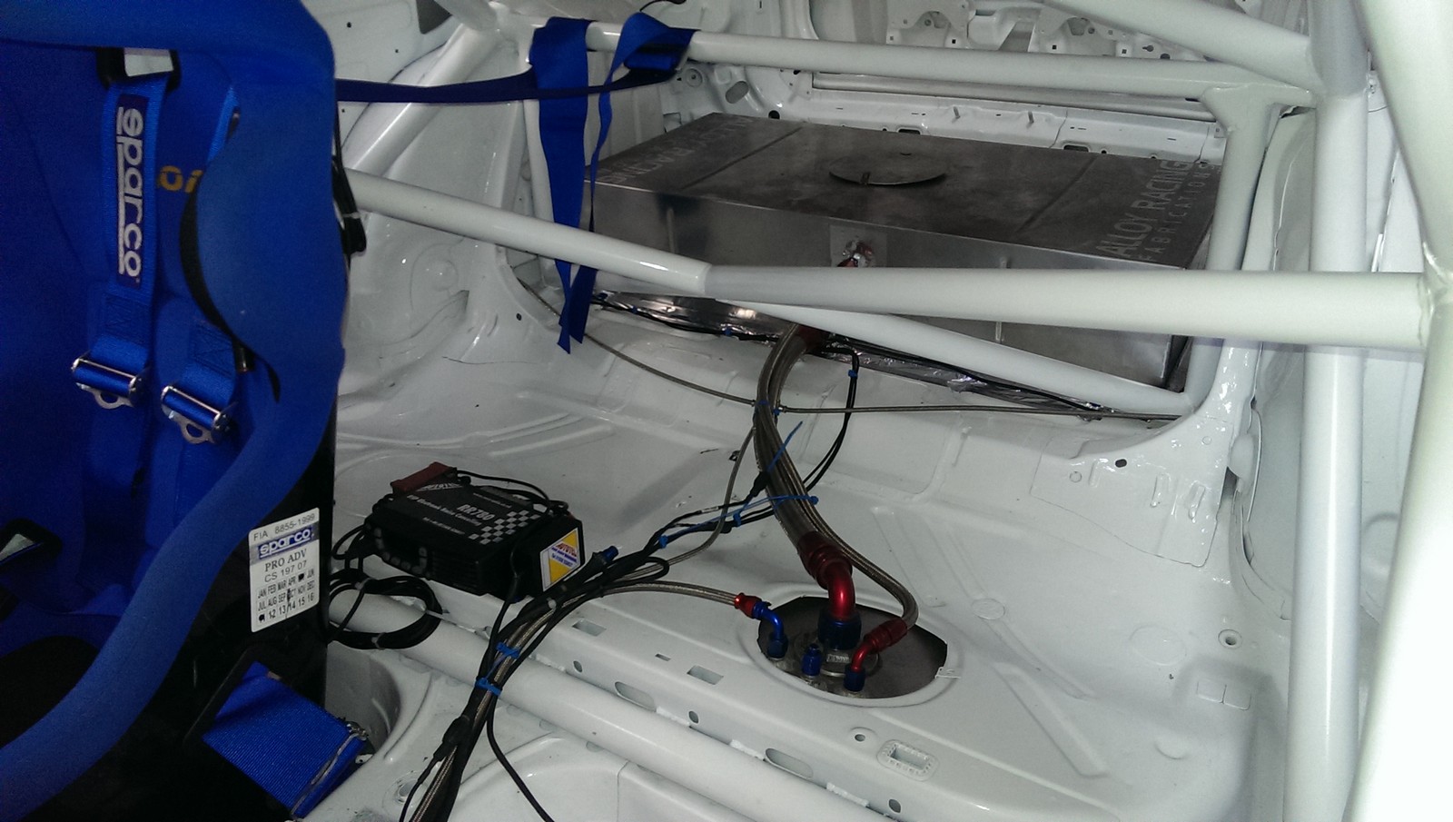

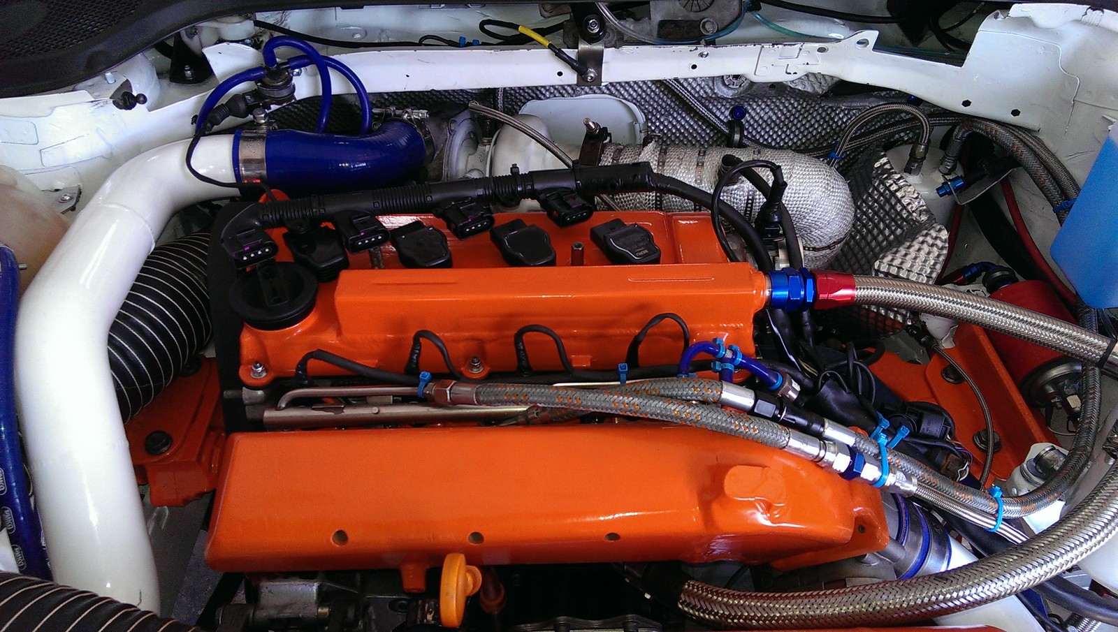

So some more pictures for you.

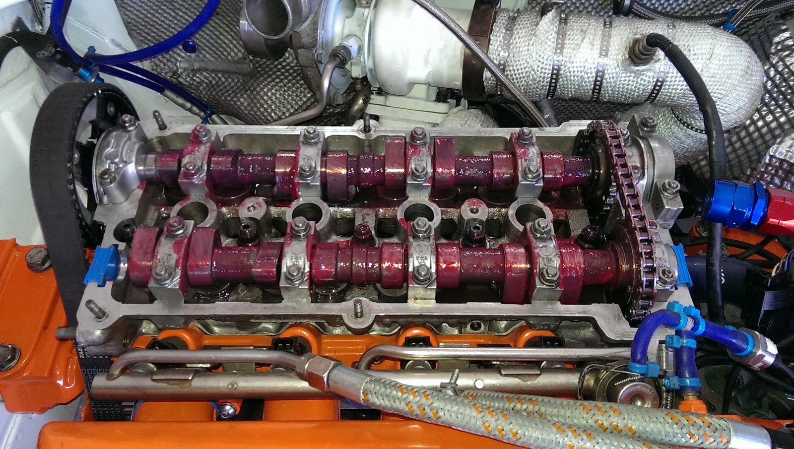

A nice shot of the cams installed with gaps set. I got sick of the sight of these LOL. Hydraulic lifters FTW

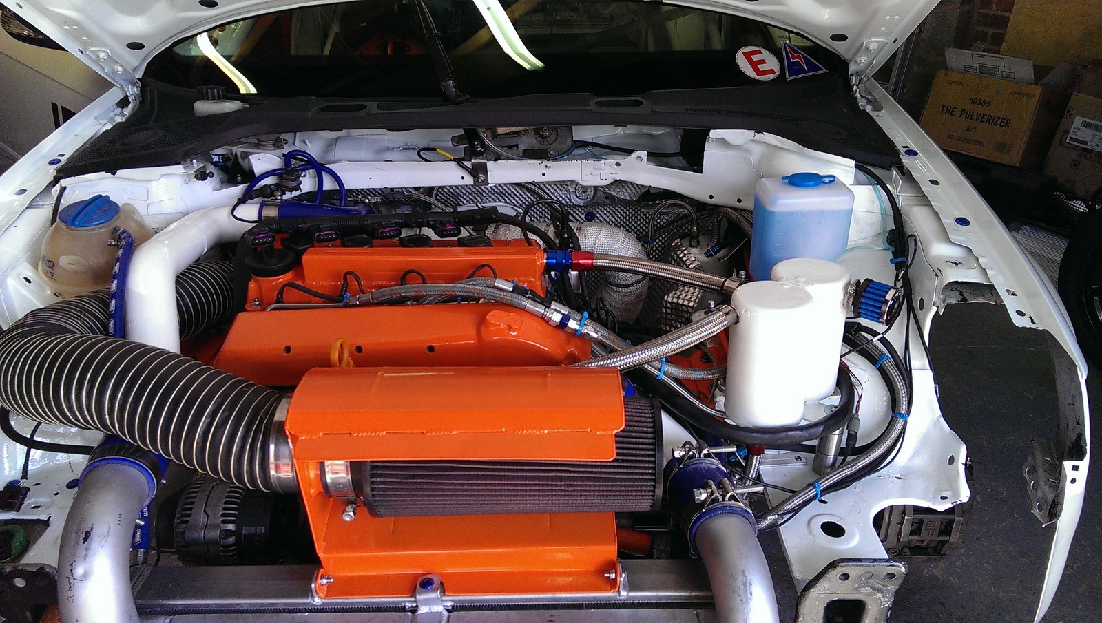

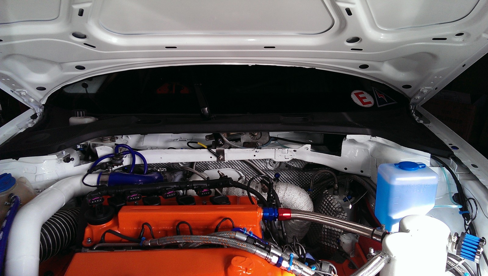

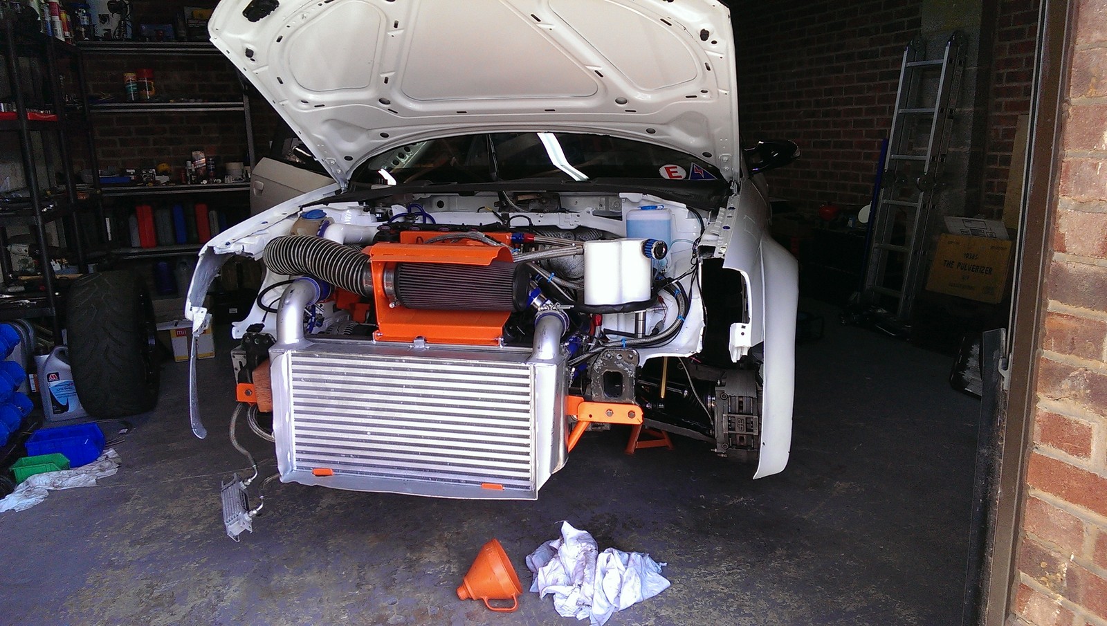

A finished front end

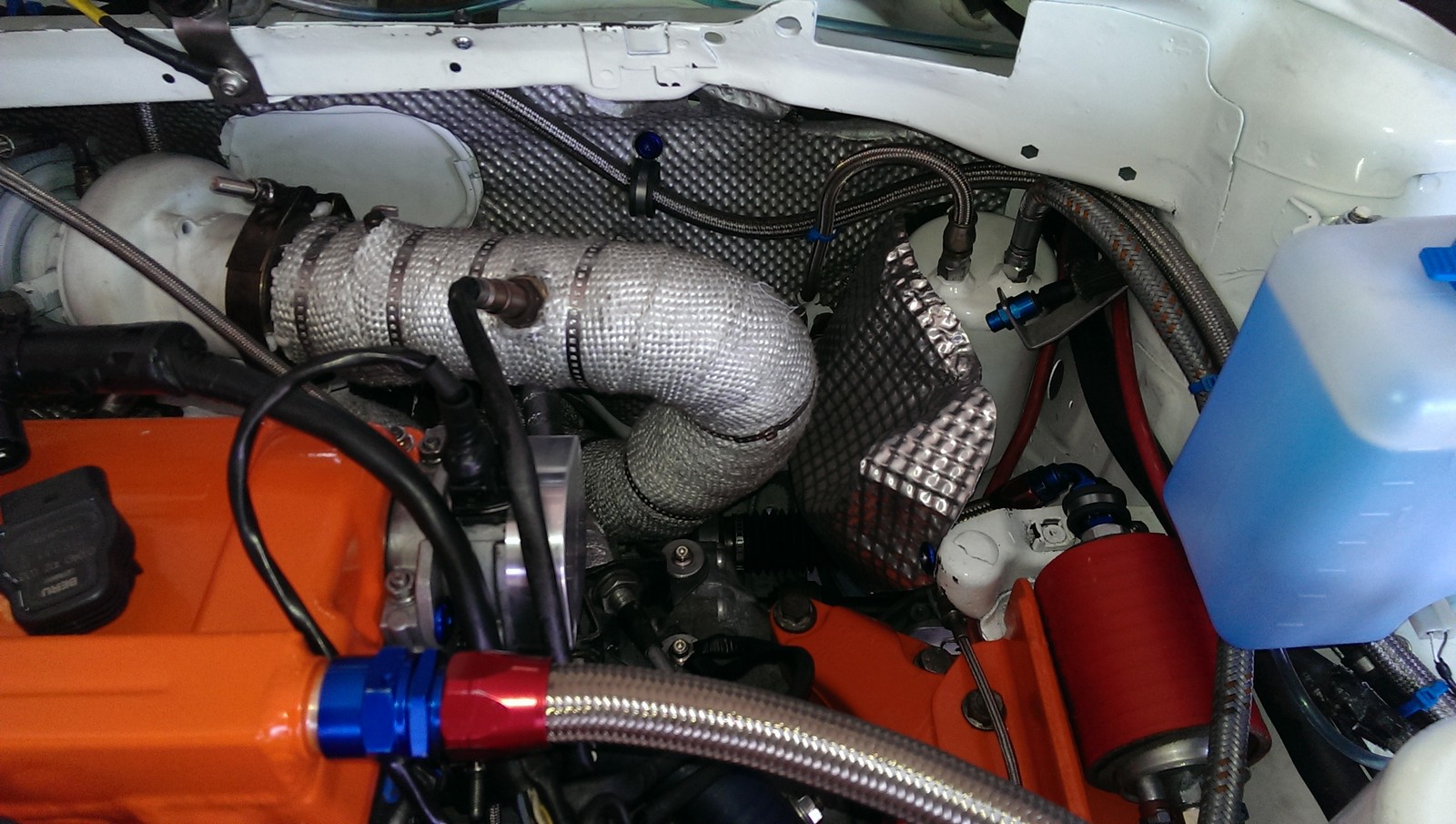

Th heat shield for the swirl pot

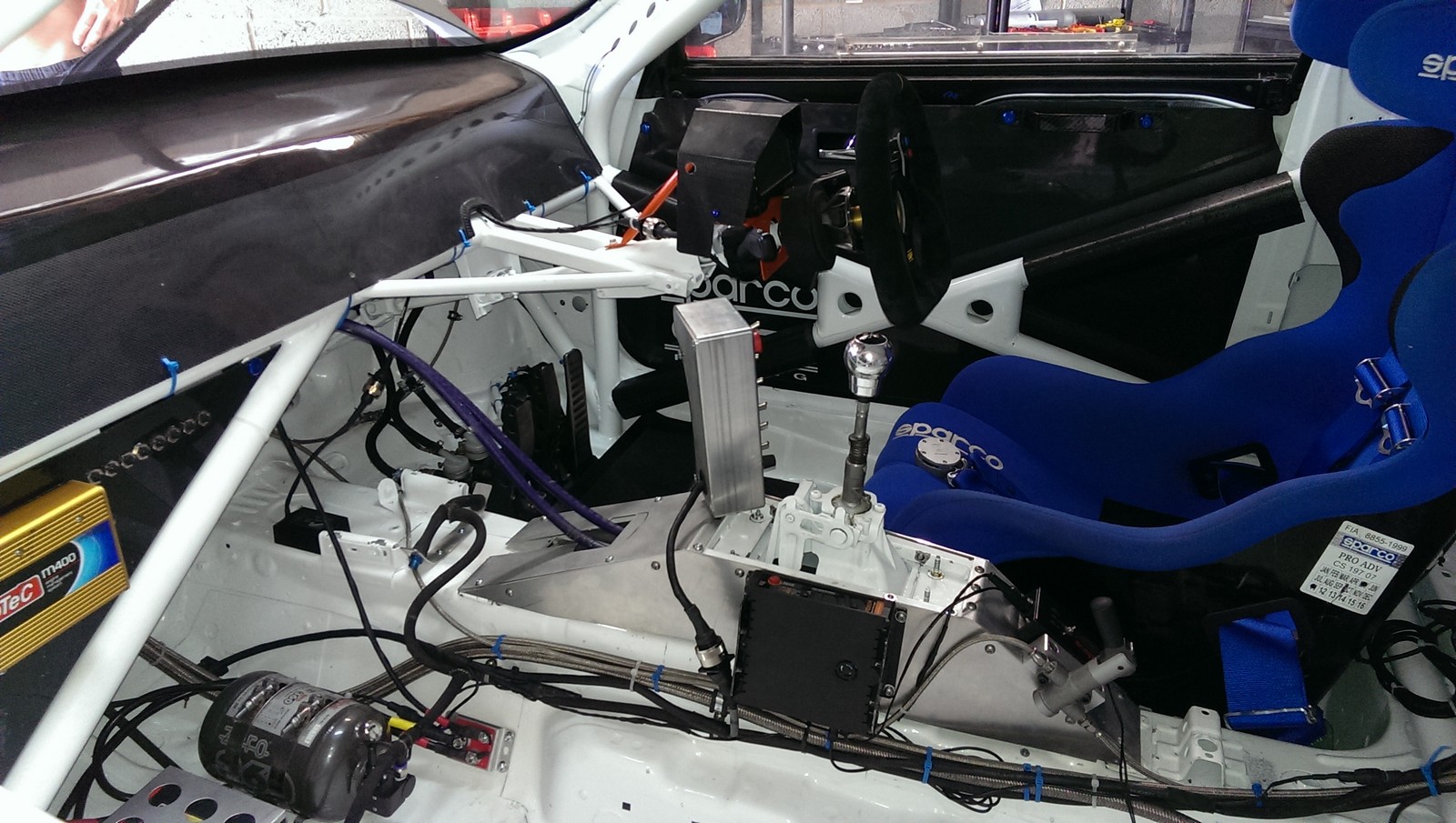

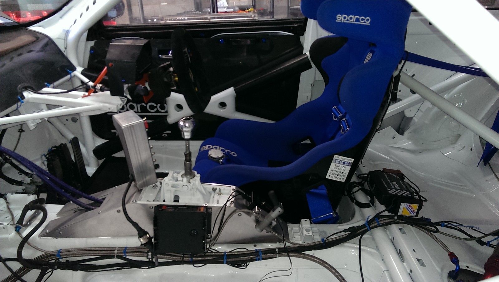

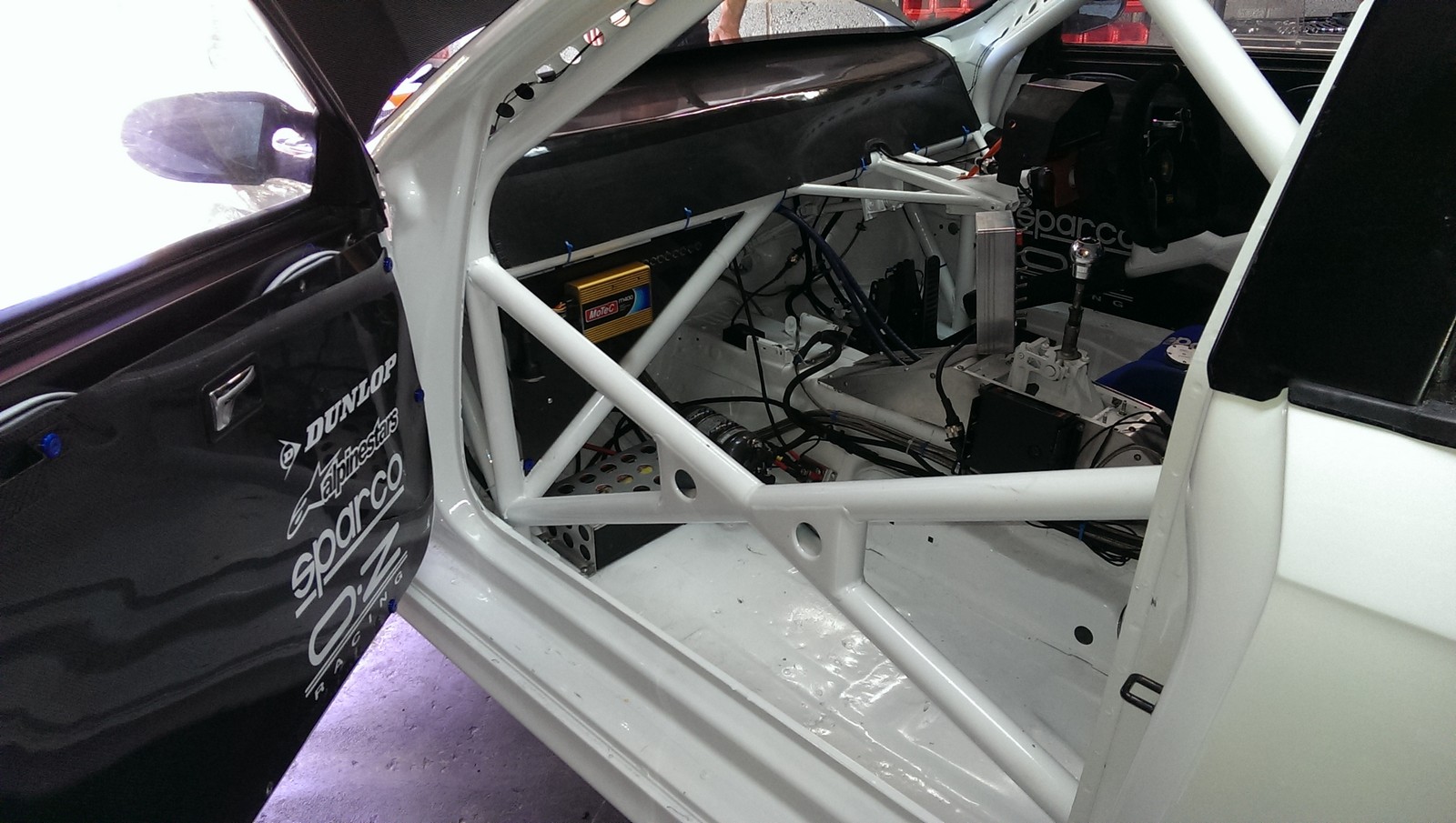

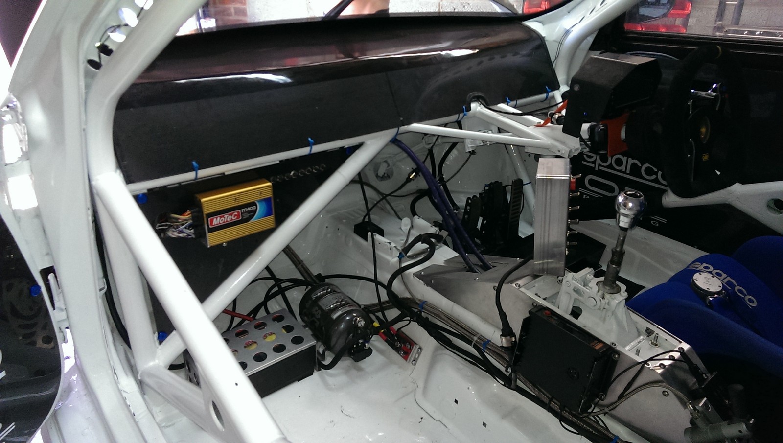

Passenger side wiring station nd MOTEC

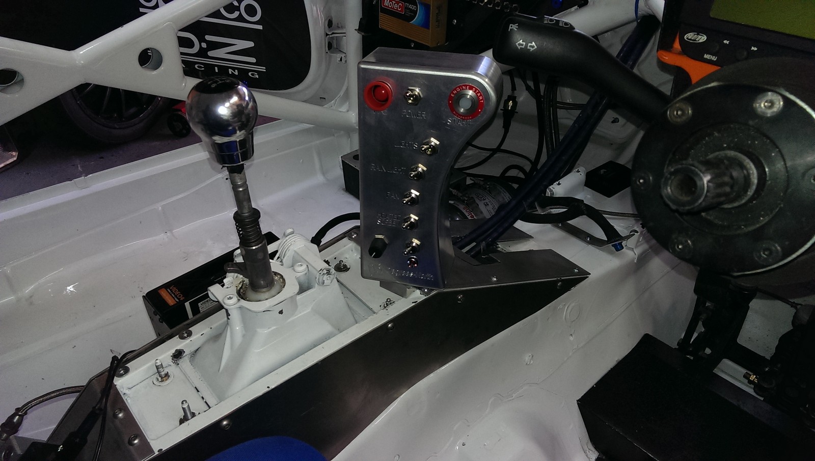

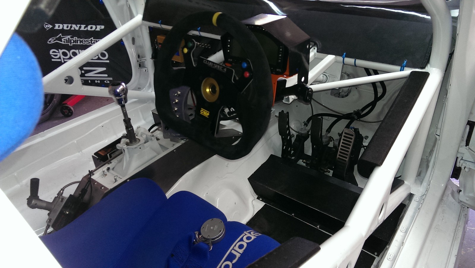

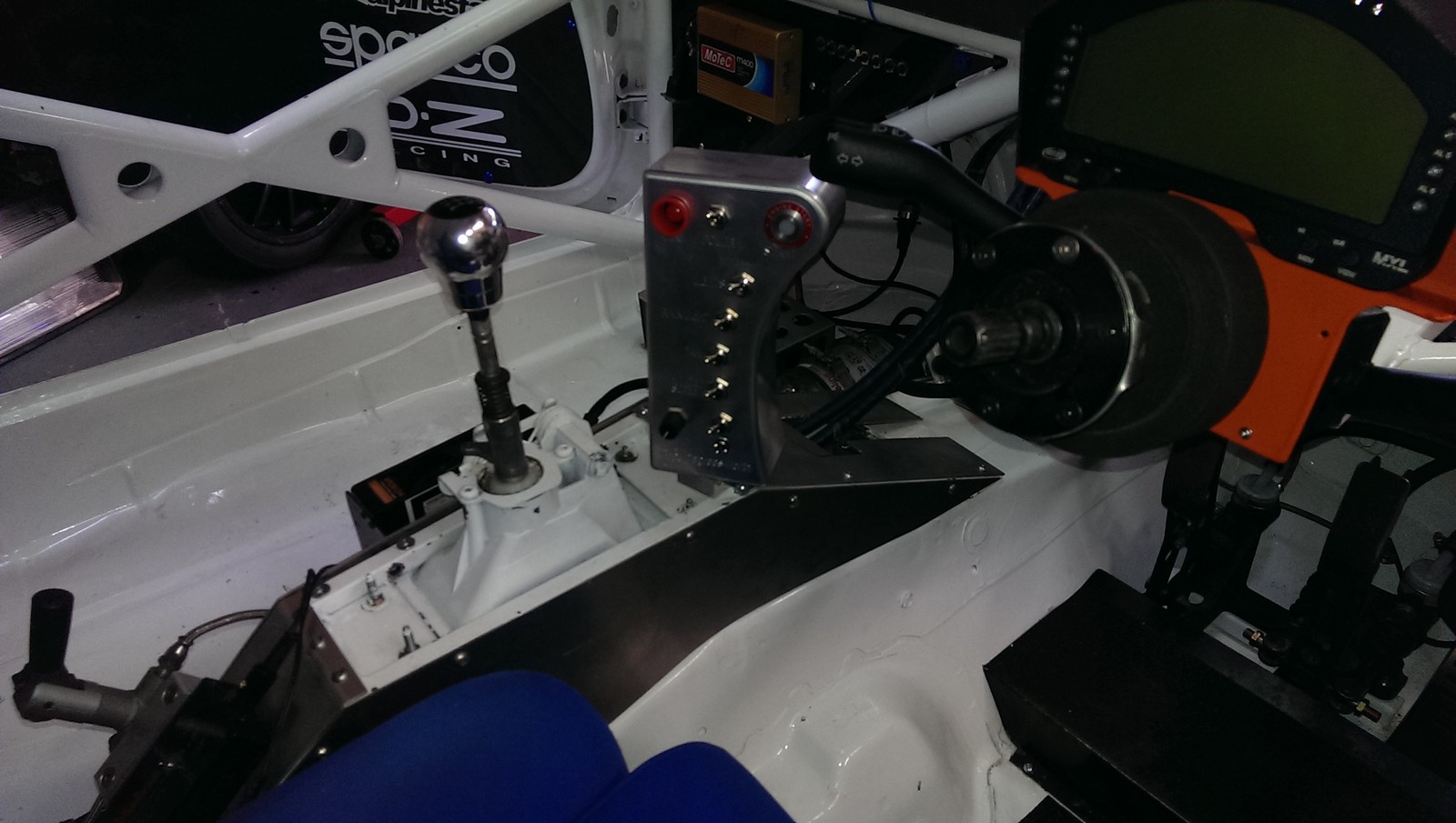

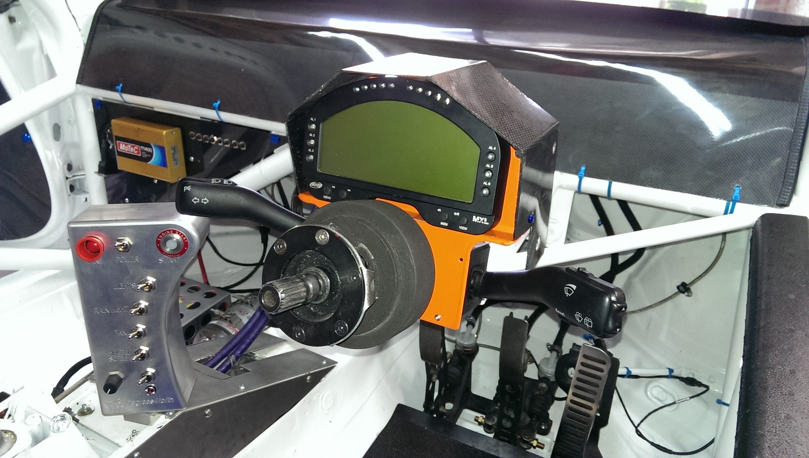

Switch panel all working now
Haldex control knob is the bottom one with a light to tell me when its activated. I have an overide on the steering wheel.
My AIM dash
The scuttle buttons
