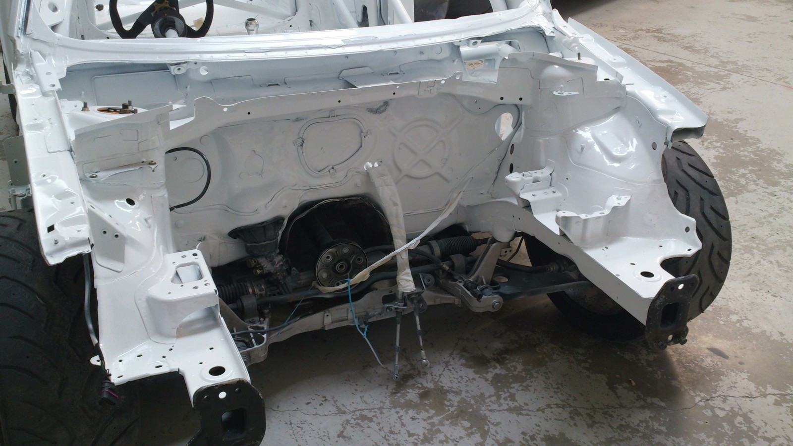

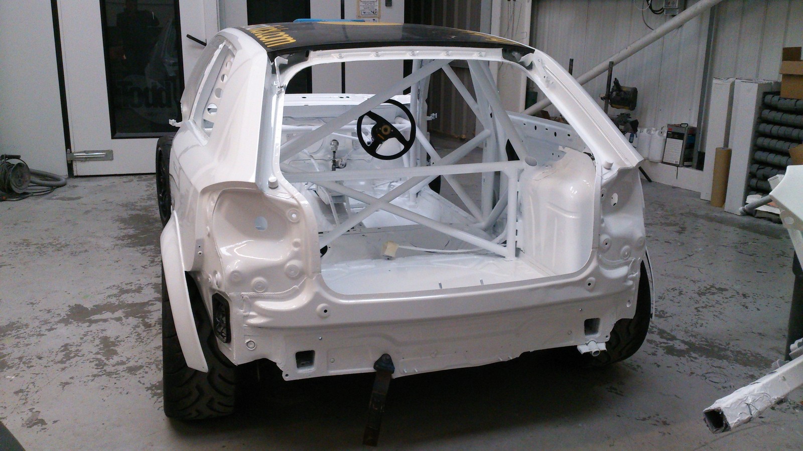

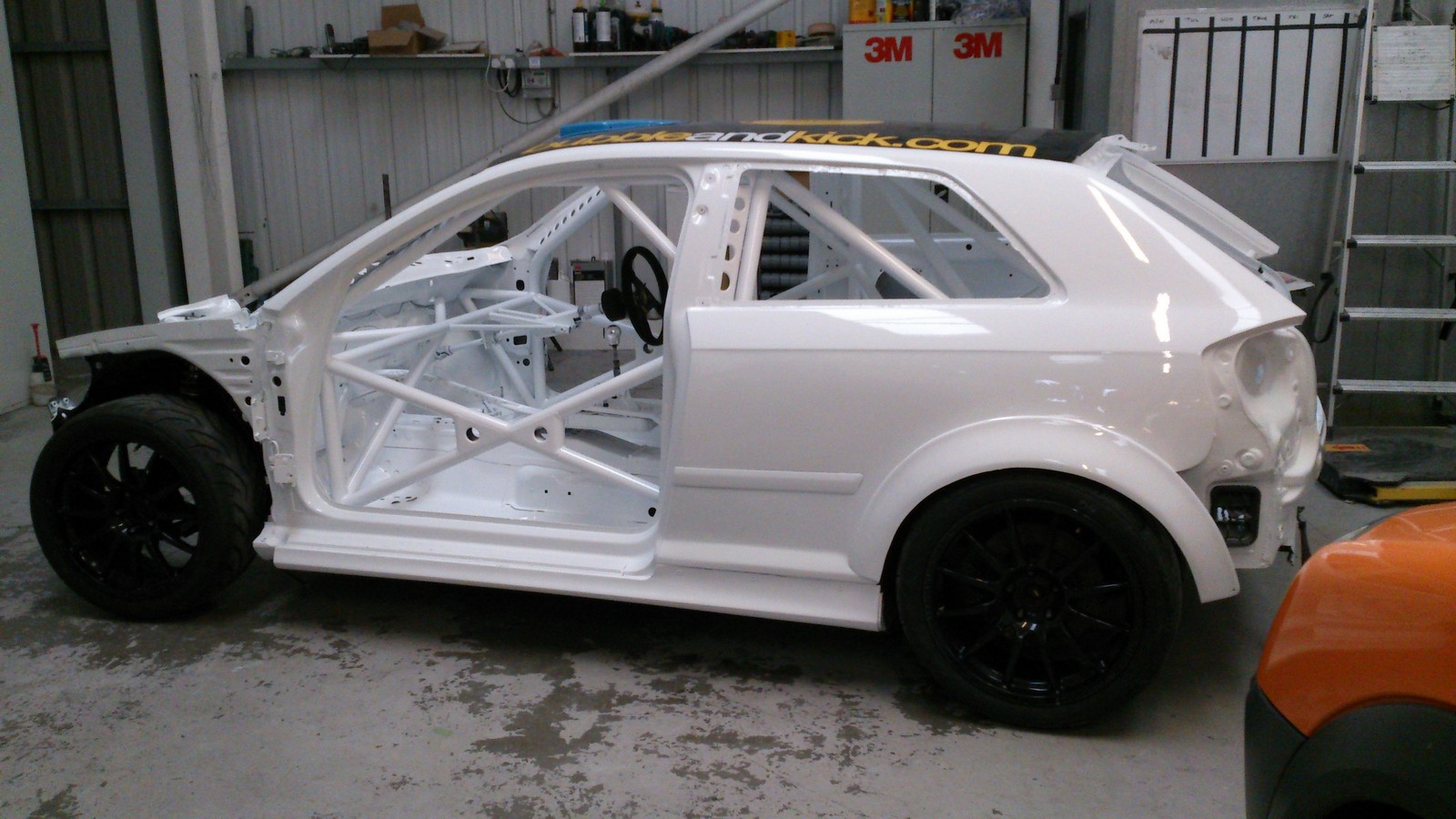

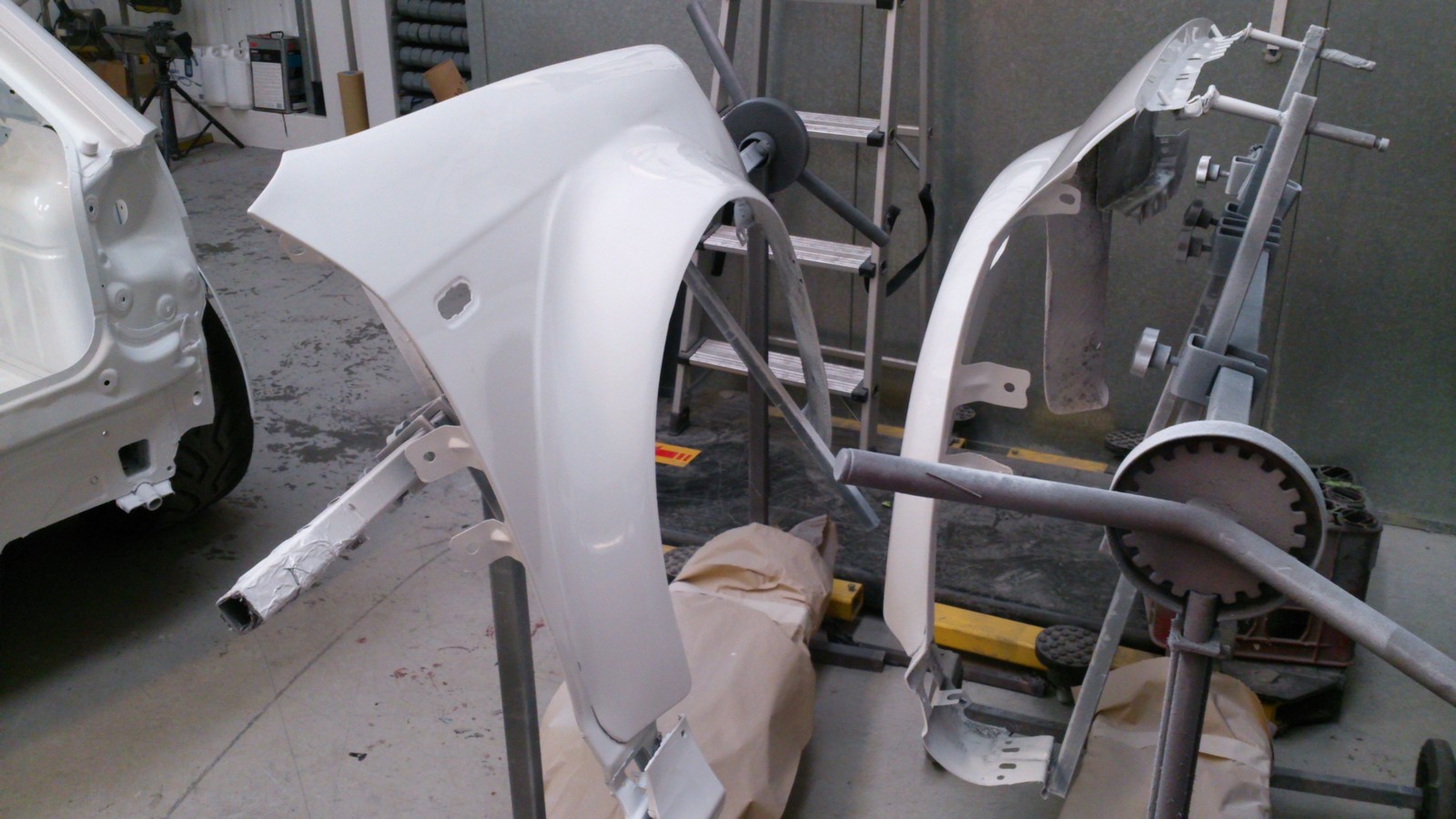

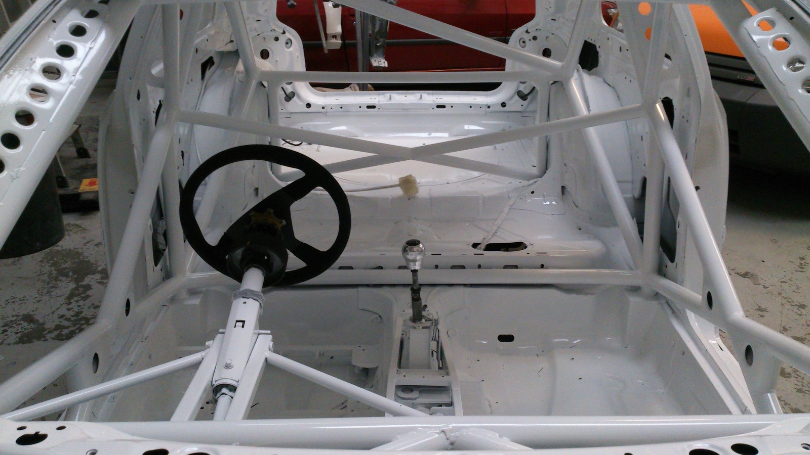

So I popped to the bodyshop to check on progress. Nearly finished...
I think I might get my pistons tommorow. The car will be at the shop another week and then it can come back for rebuild. Oh I got my spares package today. My garage is FULL of Audi parts LOL.Will be selling a load of them too. Got a new 1.8 engine, only done 17k.
I took the decision to refit the steel doors and tailgate. This will help me with the weight and also make the car a bit stiffer. The carbon doors are a bit flimsy and the tops peel back on the straight which is annoying. I might also fit the steel bonnet back on too.

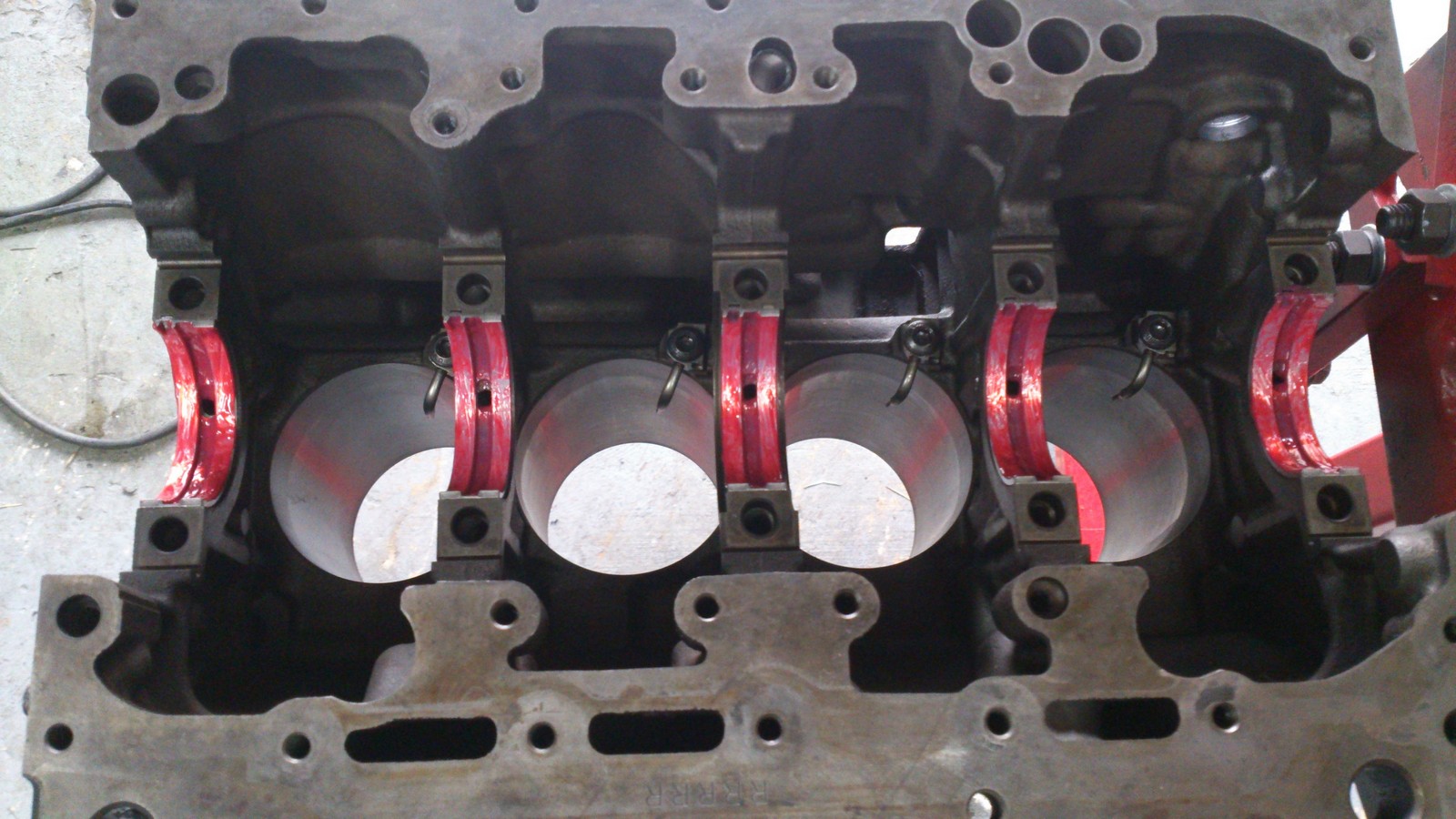

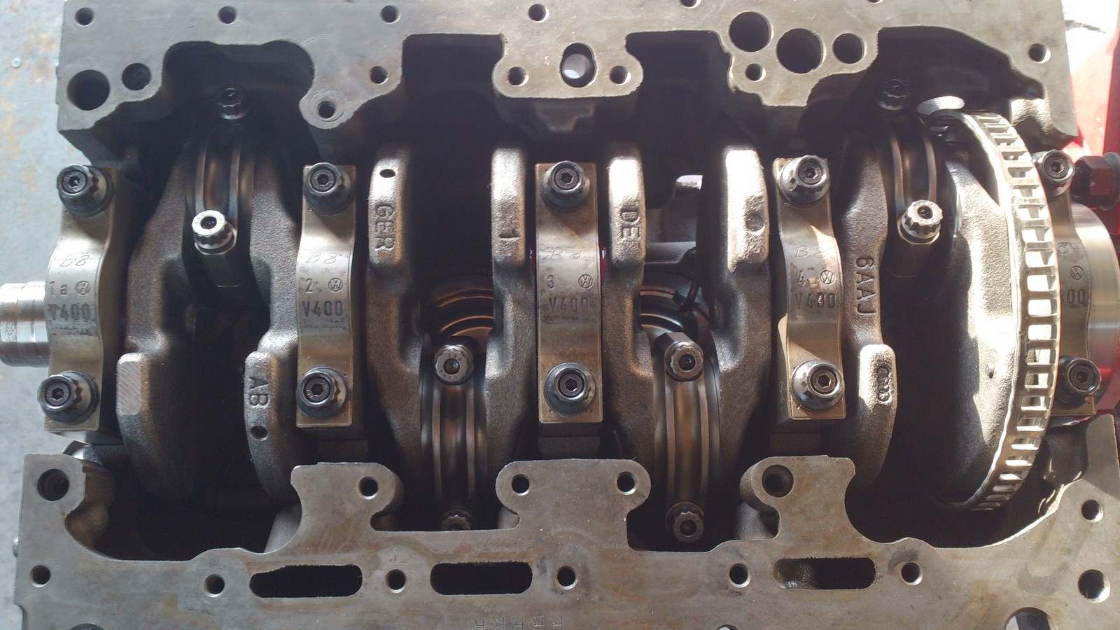

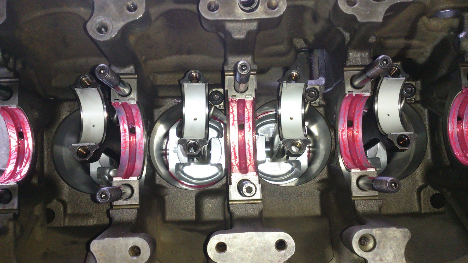

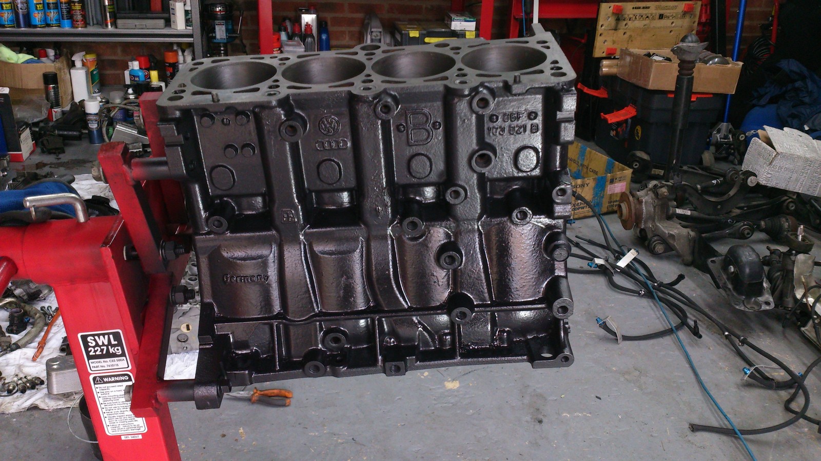

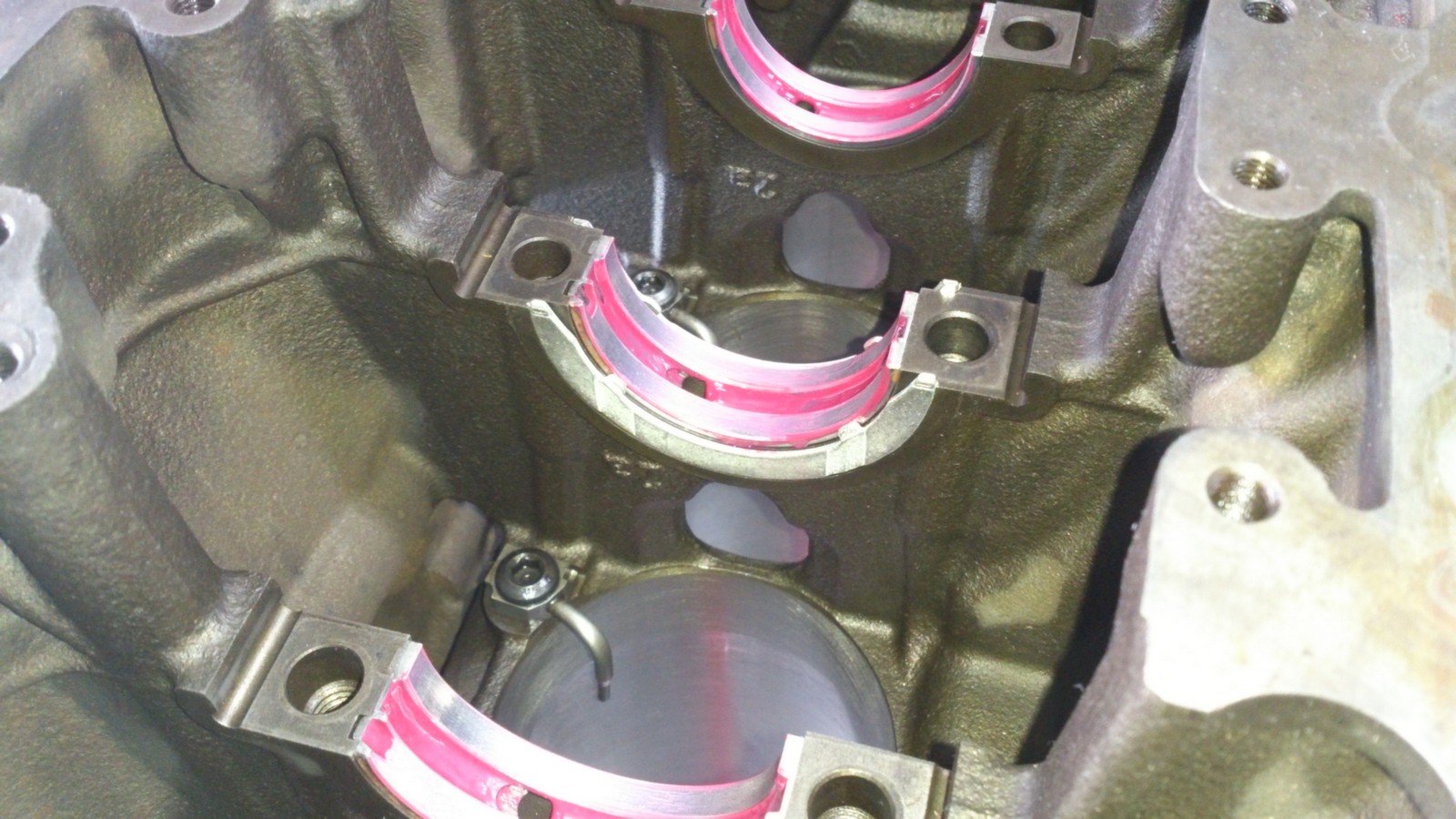

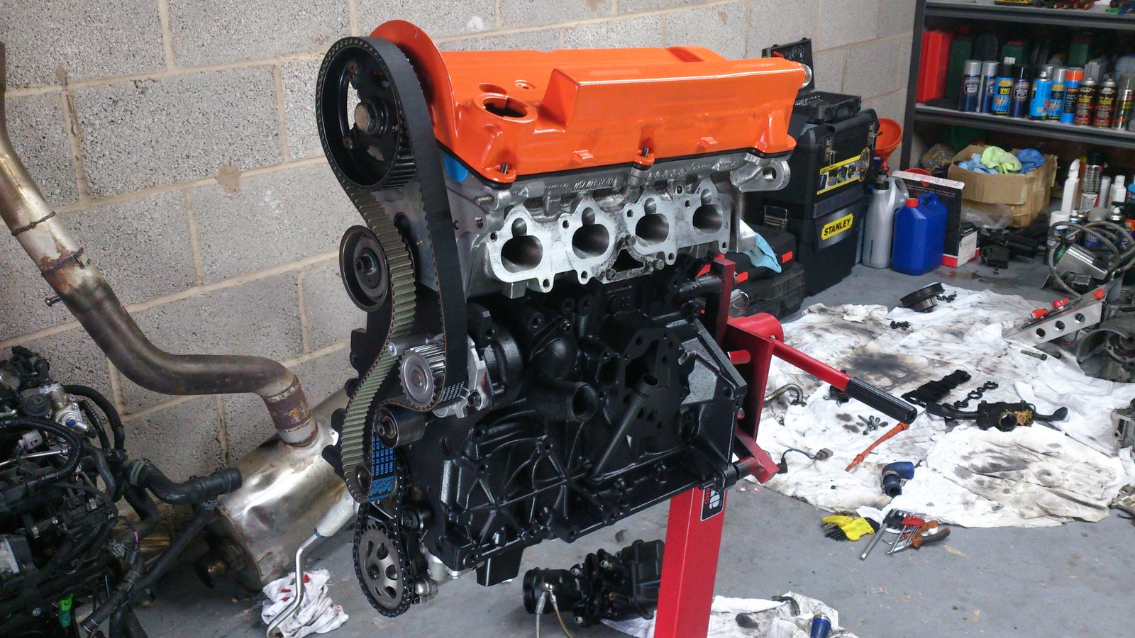

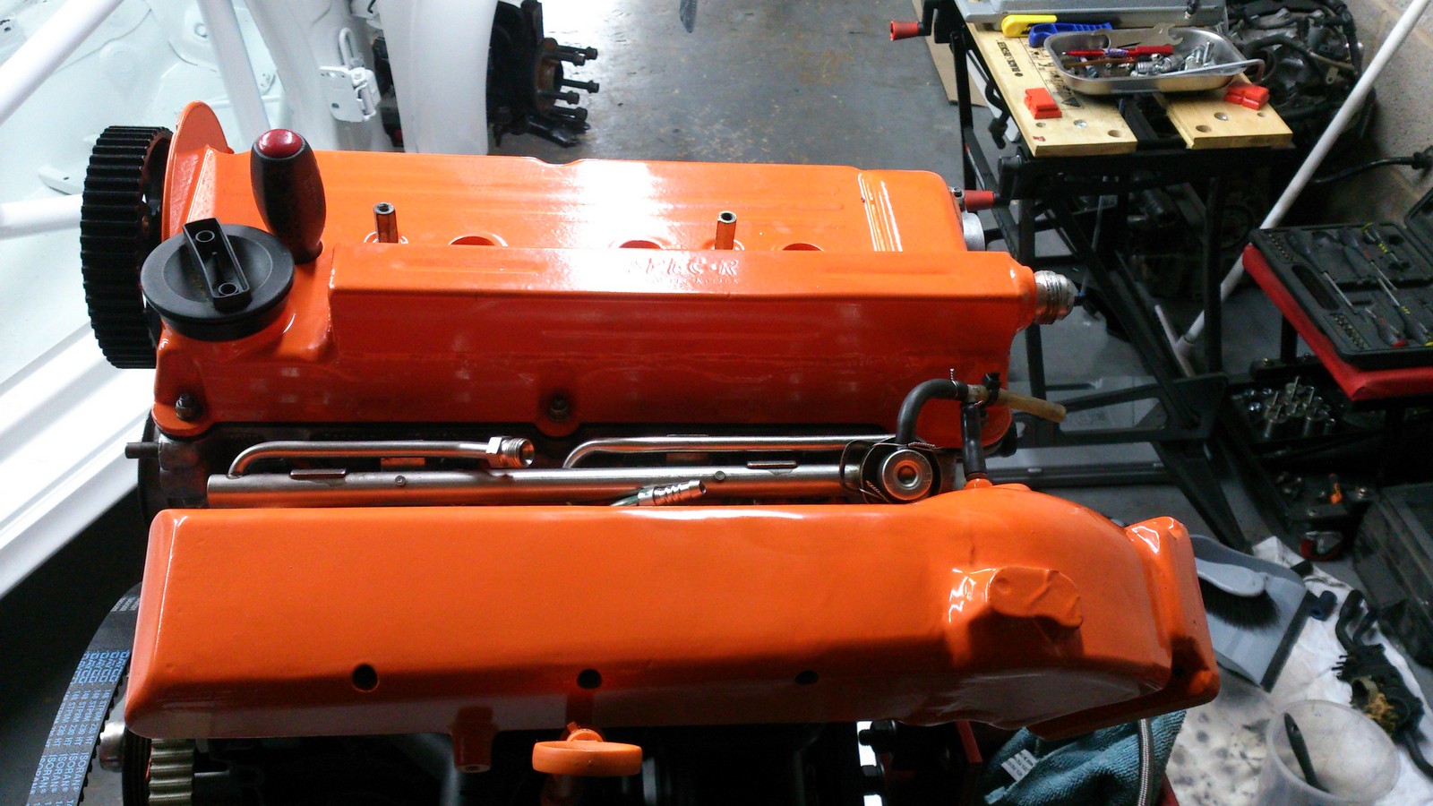

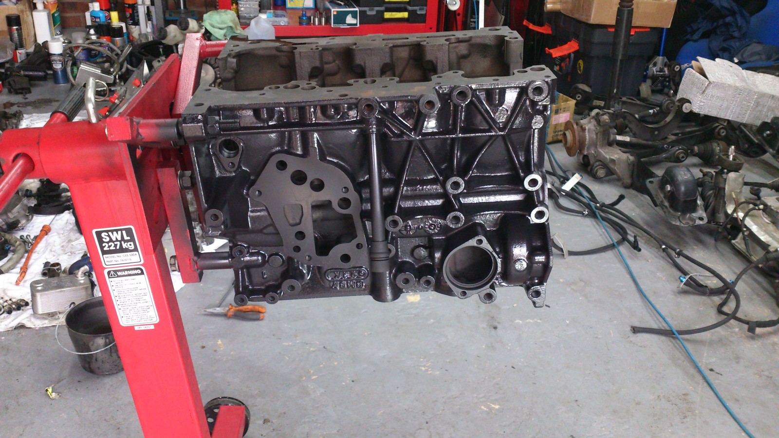

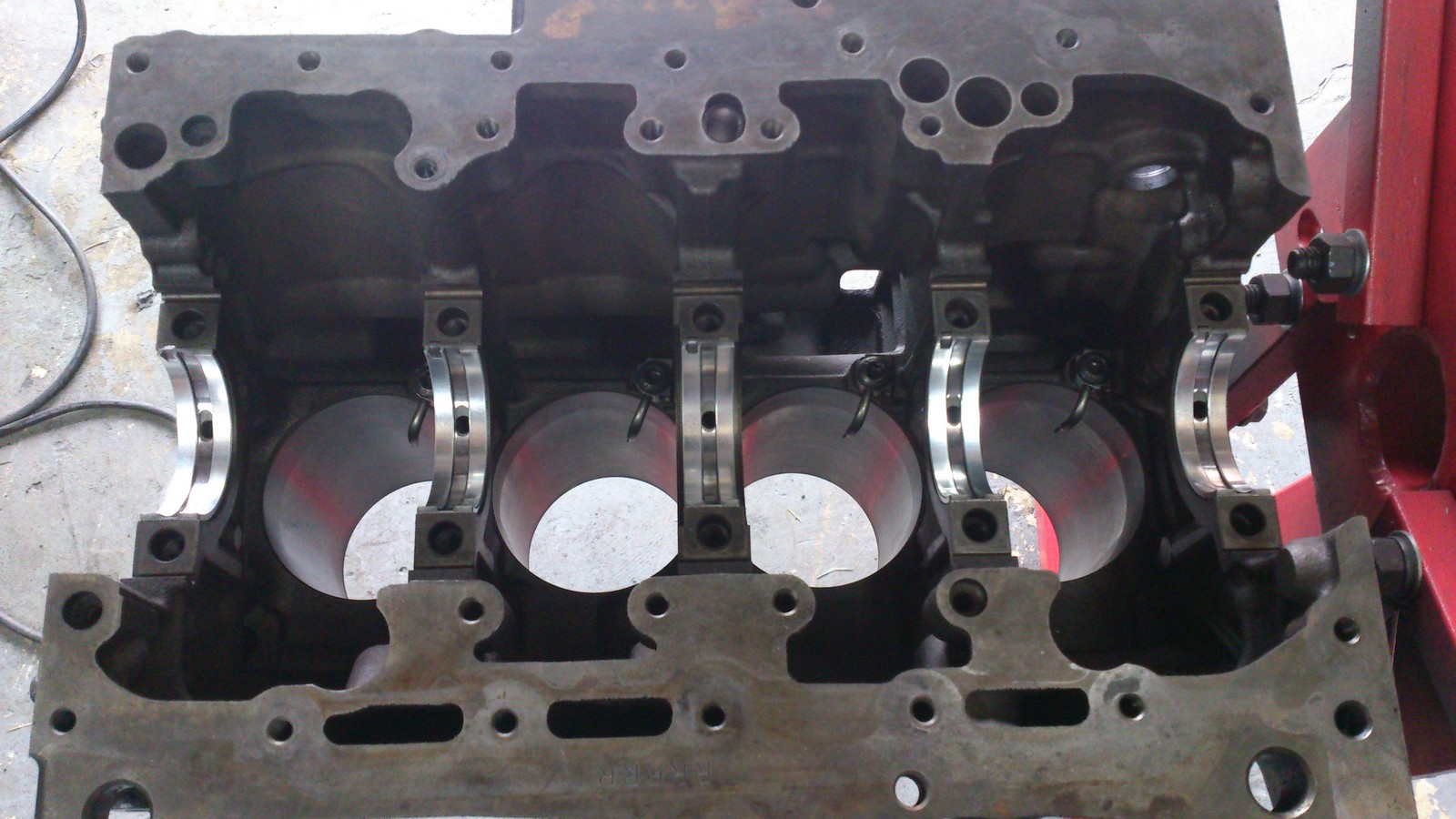

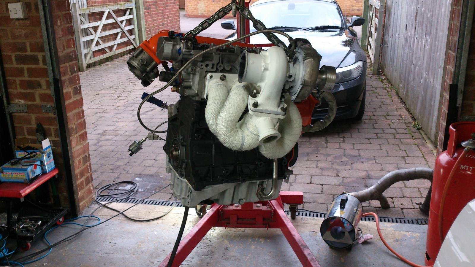

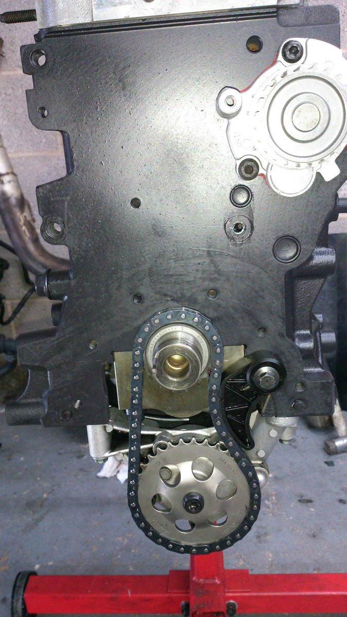

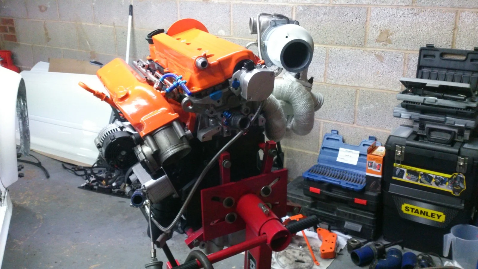

So I started rebuilding the engine today. The block had already been prepared and painted ready for install.

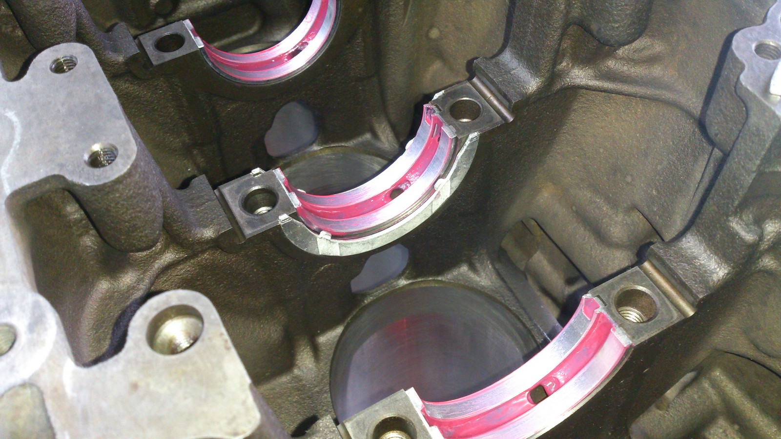

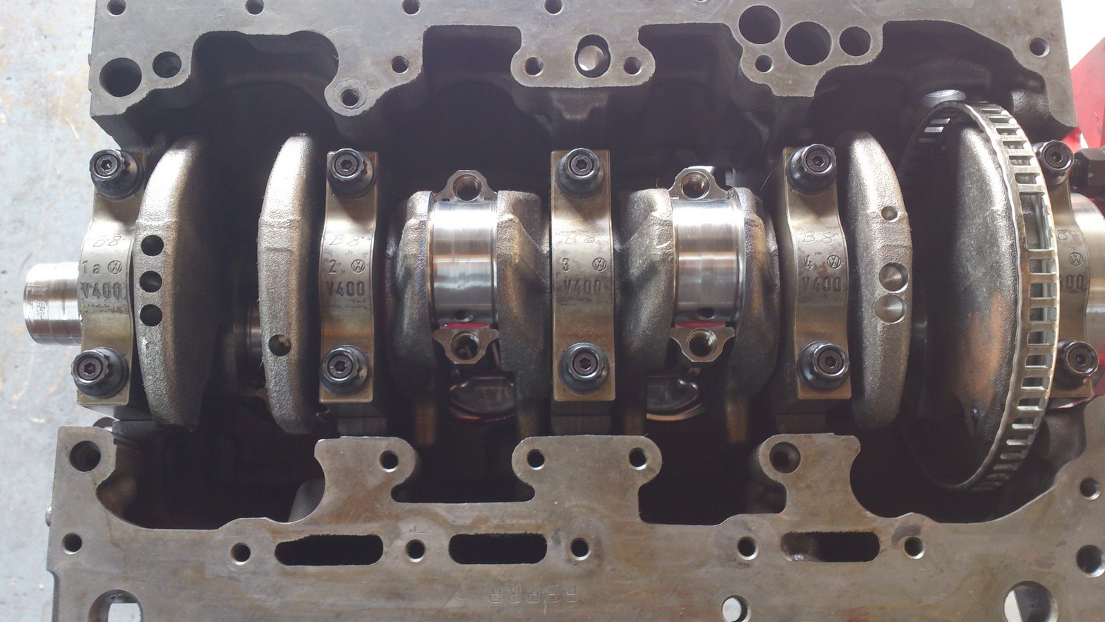

Shells fitted ready for crank
Engine rebuild paste liberally applied

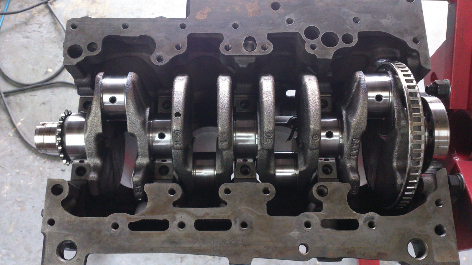

Test fit of crank after a good clean of the journals
Bloody thrusts are the wrong ones Dohh. The ones that came out are 2.44mm and these are 2.00mm

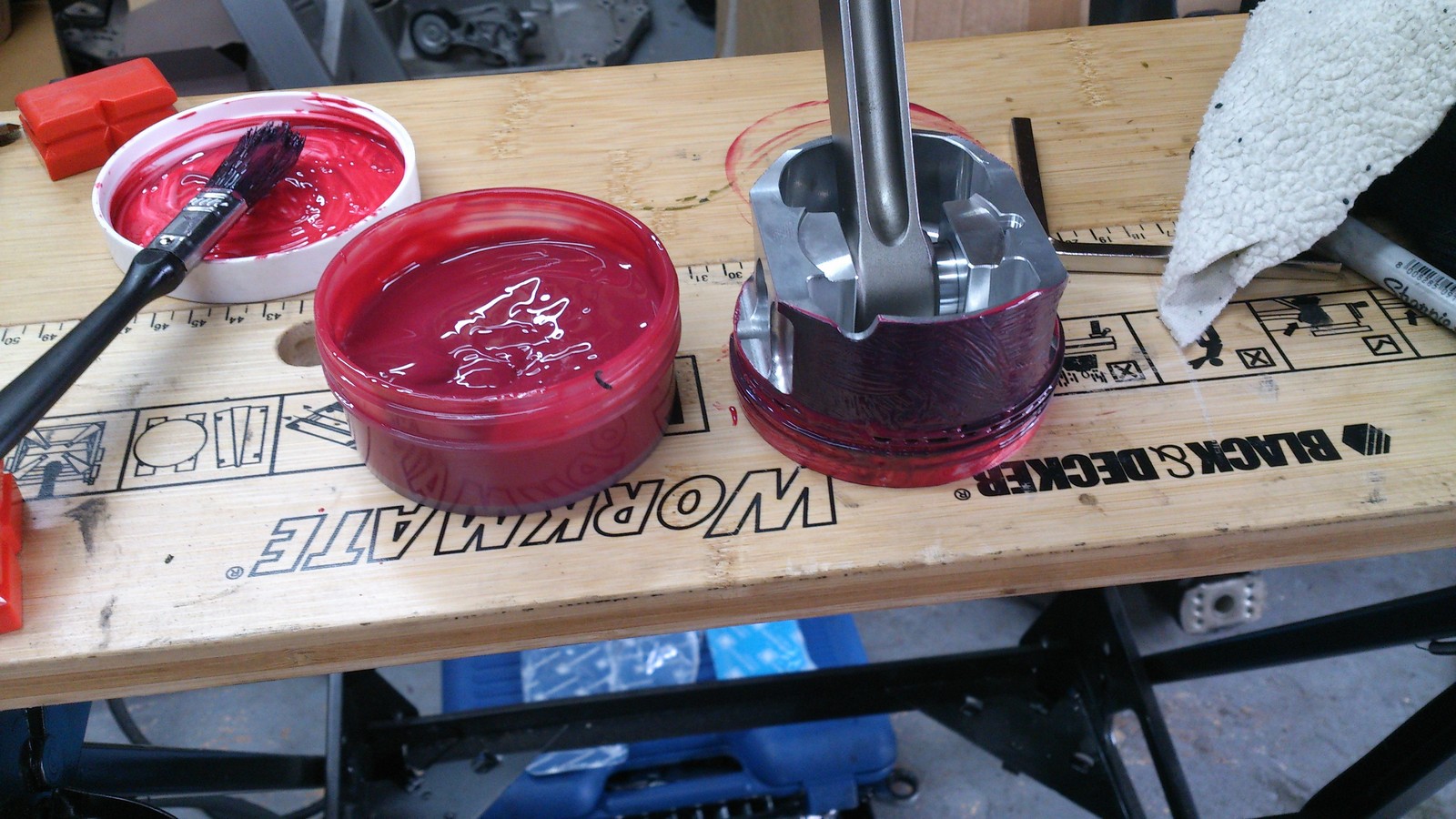

Ill fit the pistons then as I cant do the crank now

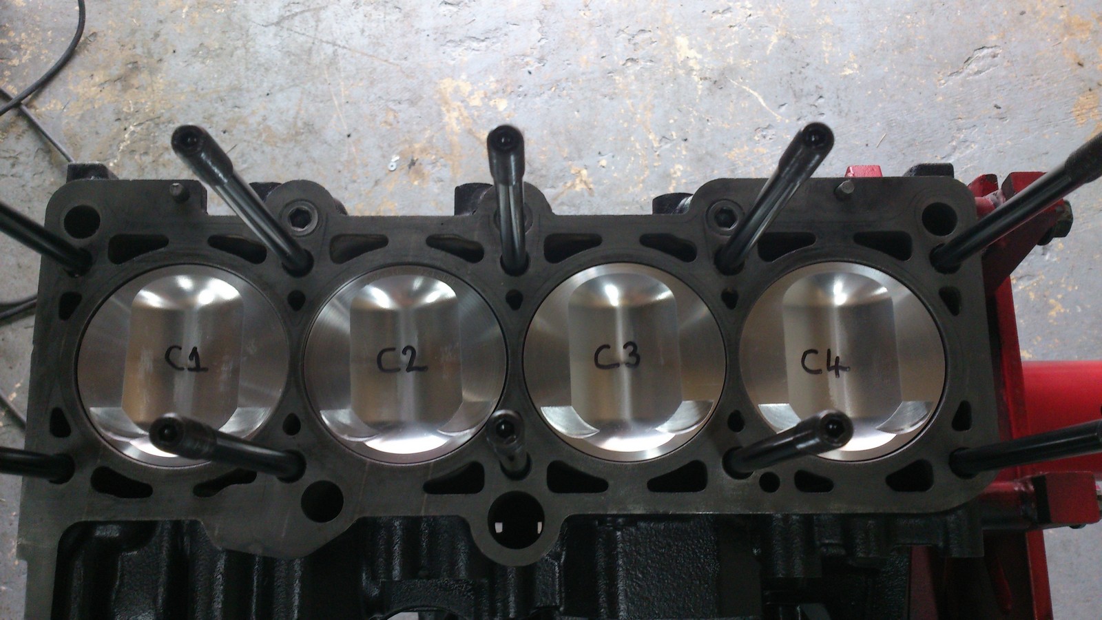

Pistons nice and snug
Nice
Ill get new thrusts tommorow so I can finish it off. I cleaned loads of parts ready to go back on.
Mark.

Yeh im annoyed about the thrusts as I would have got it together today but for them :( I always get at least one wrong part no matter who I'm dealing with doh! WTF!! Pistons look nice in the bores though. I am assuming that at 2.44mm they probably started off as 2.5 and have worn a bit.

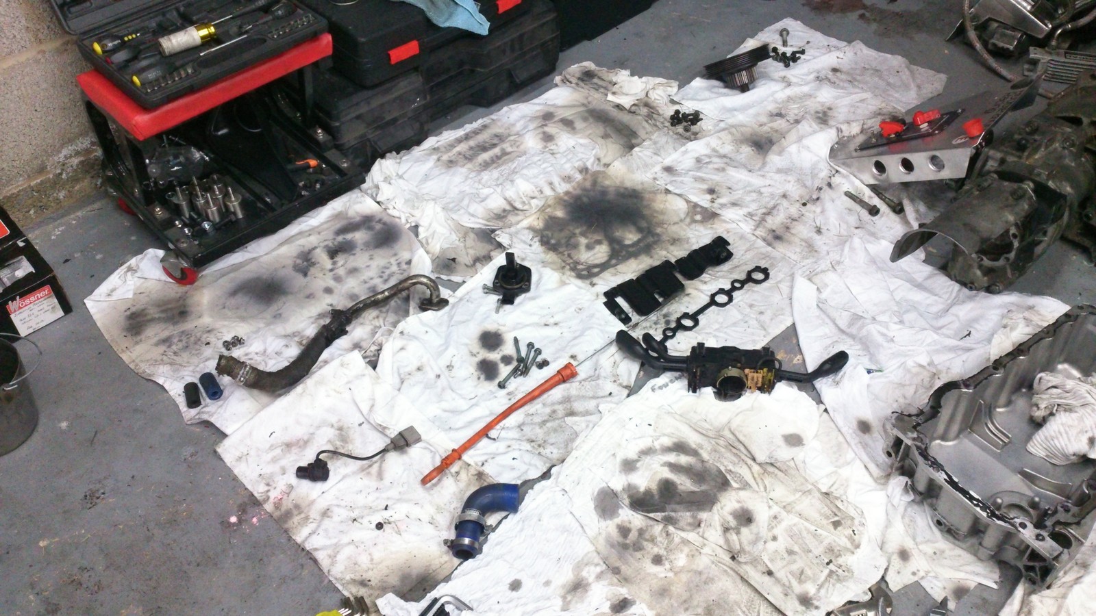

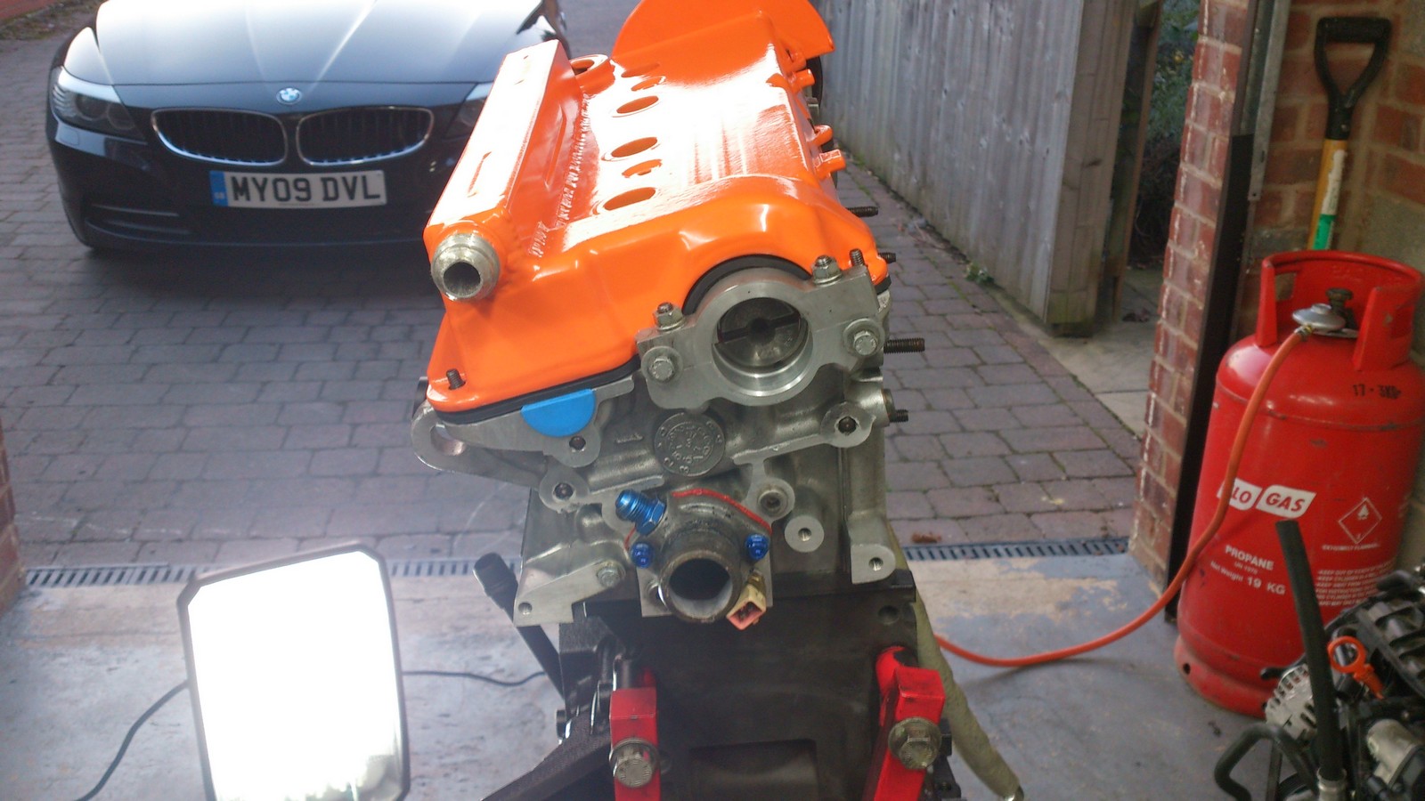

So I got a bit more done and as you can see the dirty parts from the floor have turned into clean parts on the enigne
Crank looking good all bolted up now.

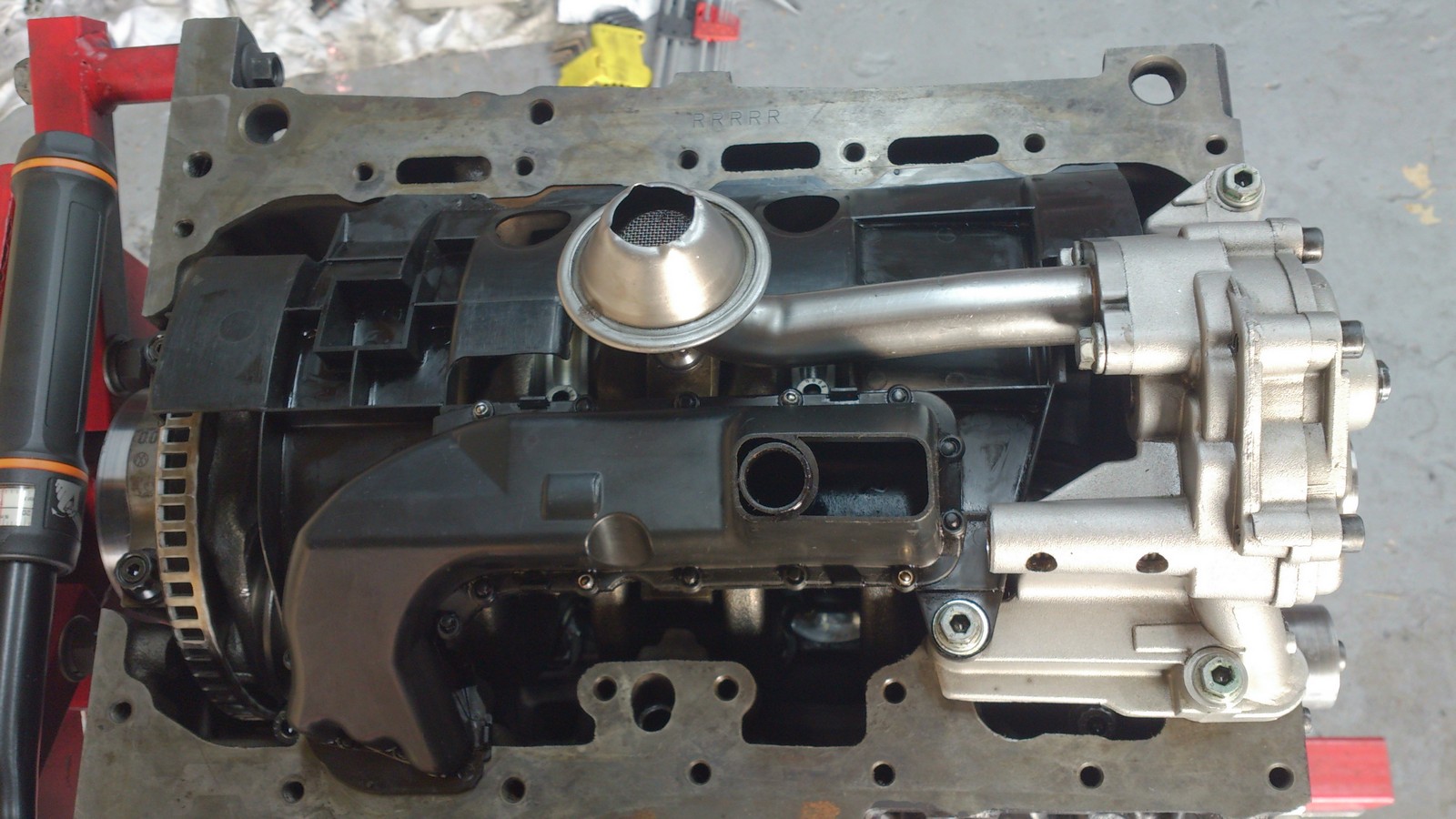

Oil pump fitted

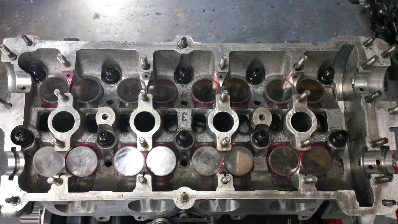

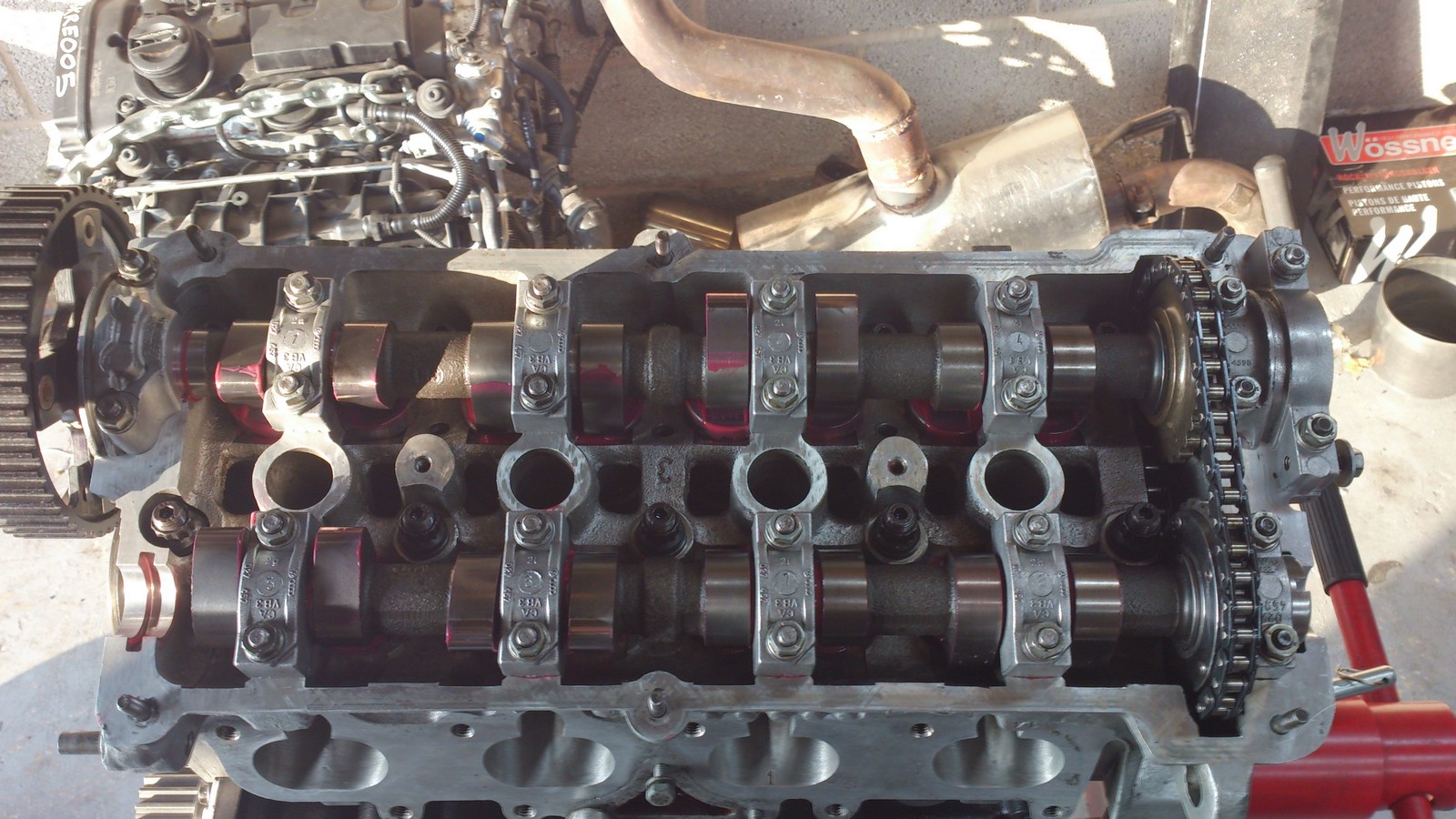

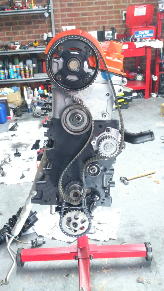

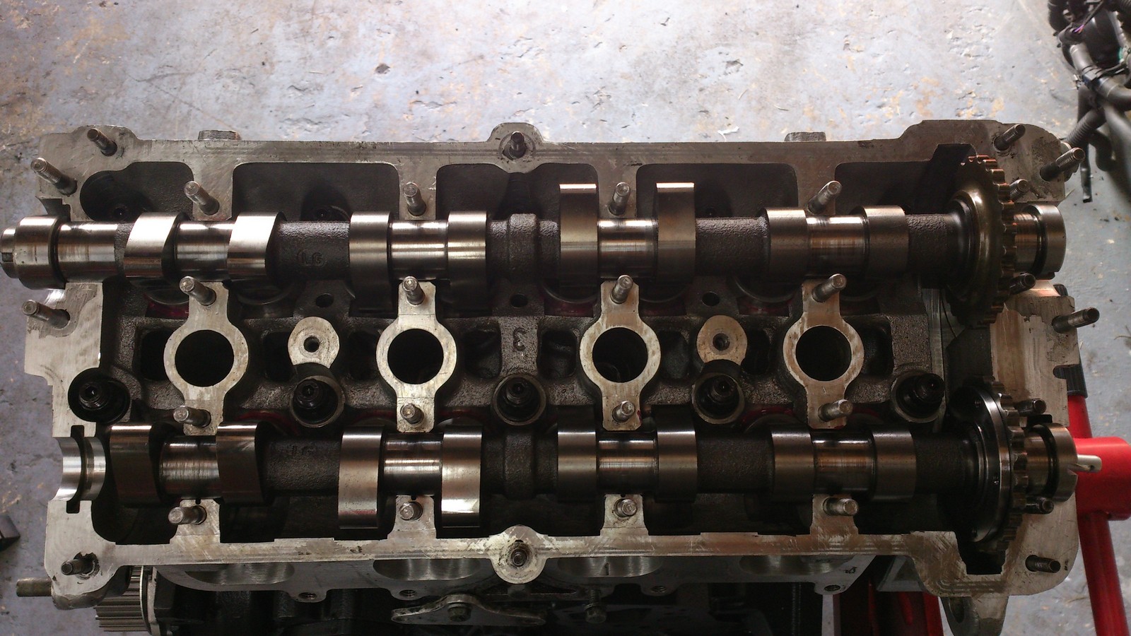

Let's start on fitting and timing up the cams then
My parts pile seems to be getting smaller
Ill get some more done tommorow as the selant turns up at Audi for doing the sump and new studs for the exhaust manifold. I am going to fully build the engine and gearbox up so i can just slot it back in in one movement. Then I only have to connect the exhaust and gearbox shafts up

You don't say! Still whatever works, whats the oil pump from? as its sans balencer shaft assembly.
I have no idea. I would have to ask Keith at Dialynx as he built it originally.

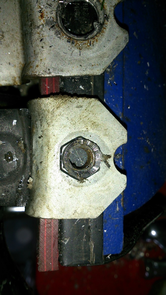

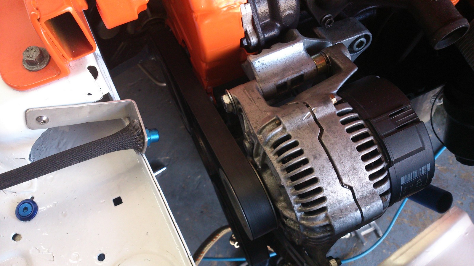

I just noticed the key on the crank pulley is to small, either that or it has worn/snapped. The pulley can move back and forth a bit. Better get a new one.

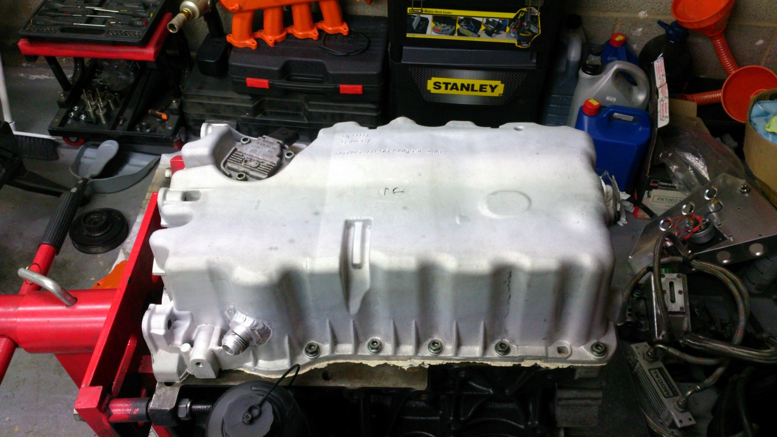

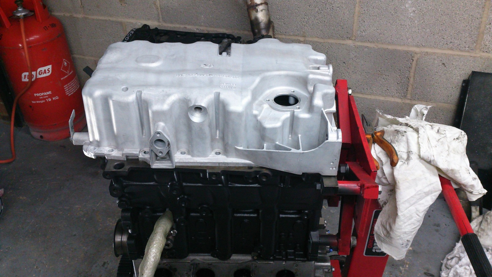

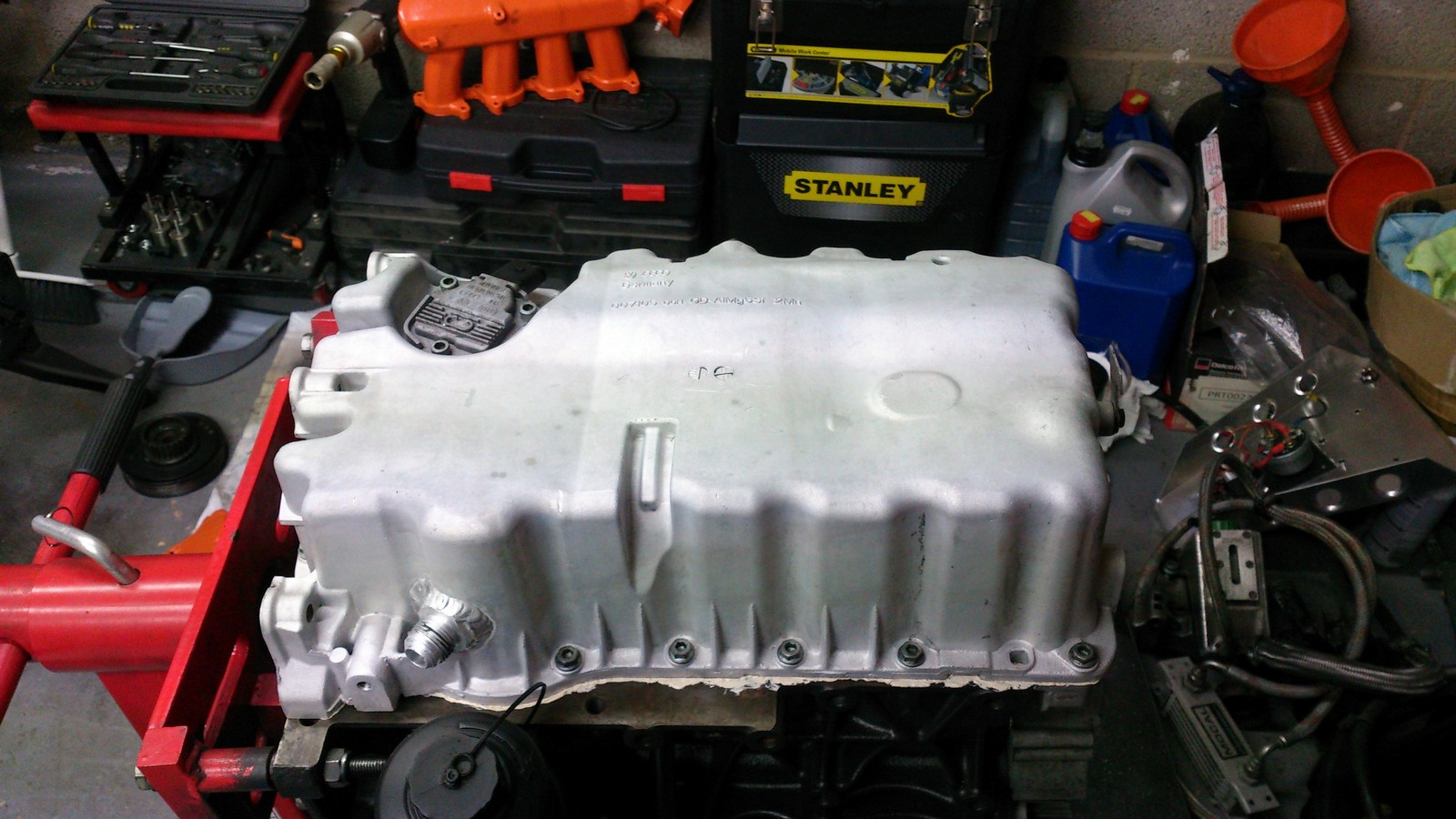

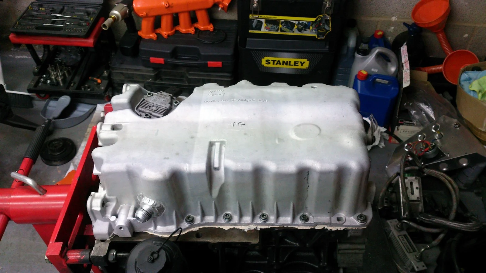

The car is slowly coming together. The engine has been a ***** though, so many mis matched parts on this engine it's a joke to get the right parts for it but im nearly there! The timing belt is off a Mk2 golf gti 16 valve LOL. 147 teeth.

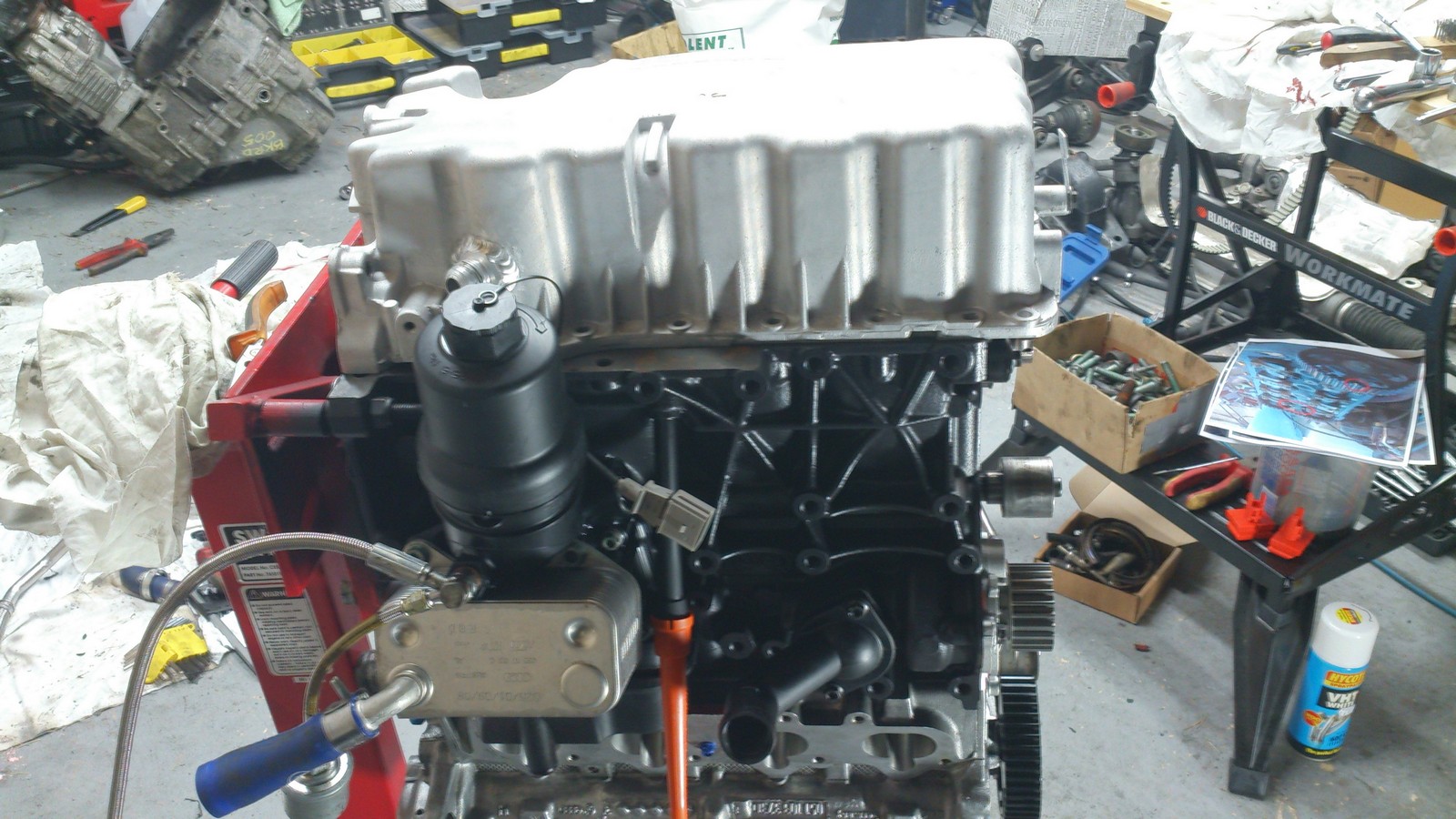

Sump dry fit and also nice and clean thanks to Ally clean

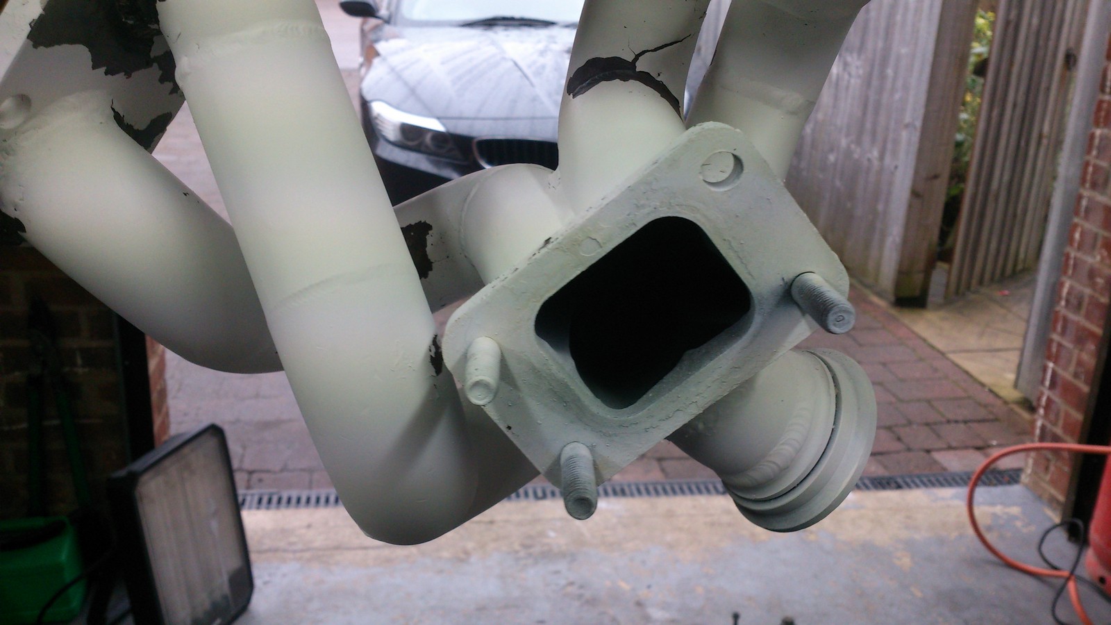

Manifold being tidied up
Sump fitted
My bottom pulley had a knackered key in (fault number 50) it so I bought a new one.
Now that engine looks better huh?

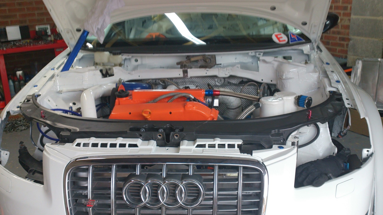

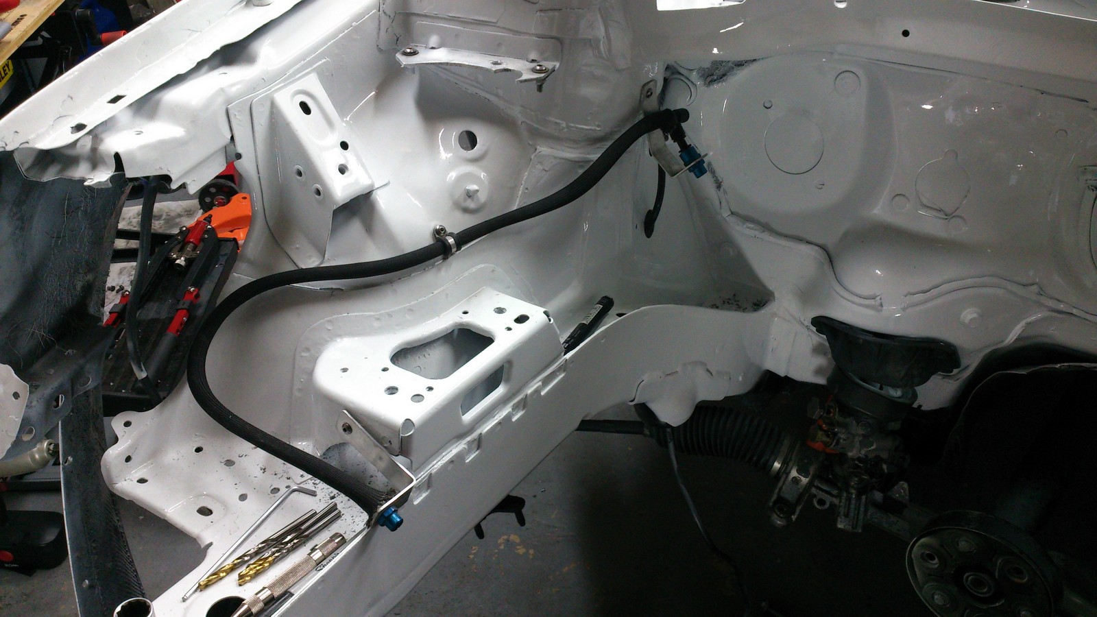

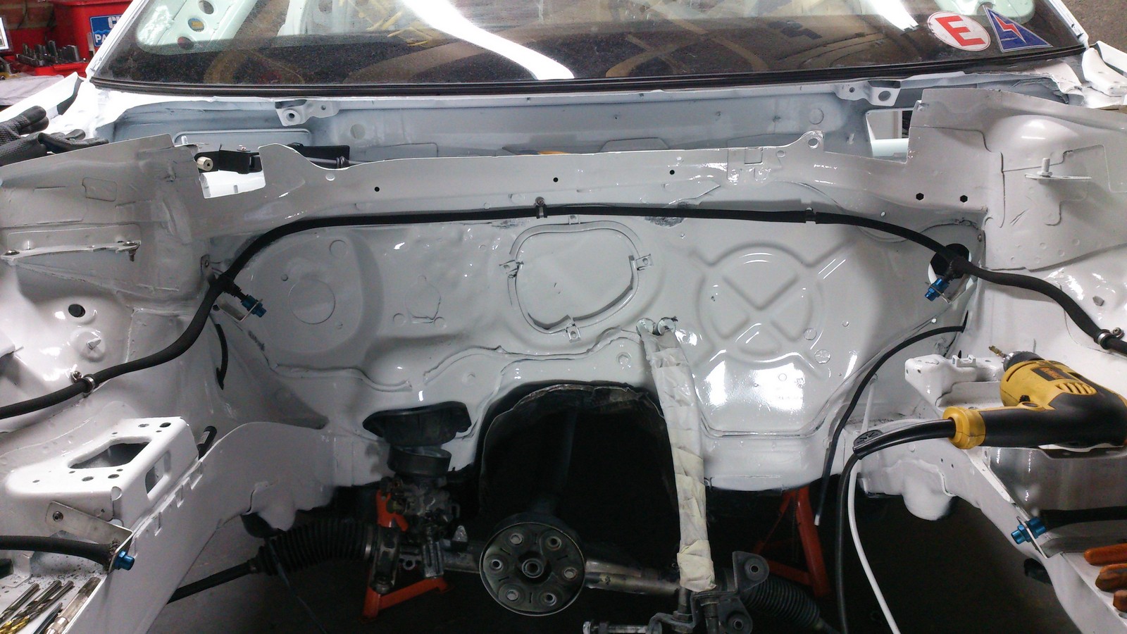

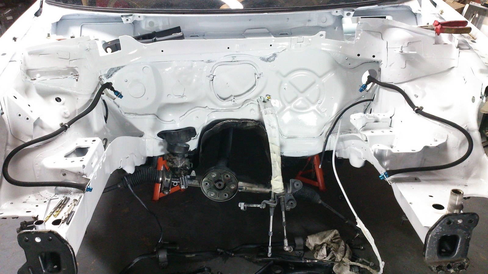

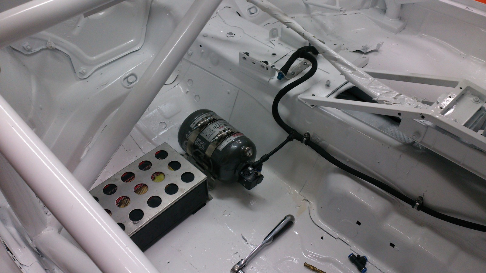

Fitting the fire supression system in. 4 nozzles to the engine bay

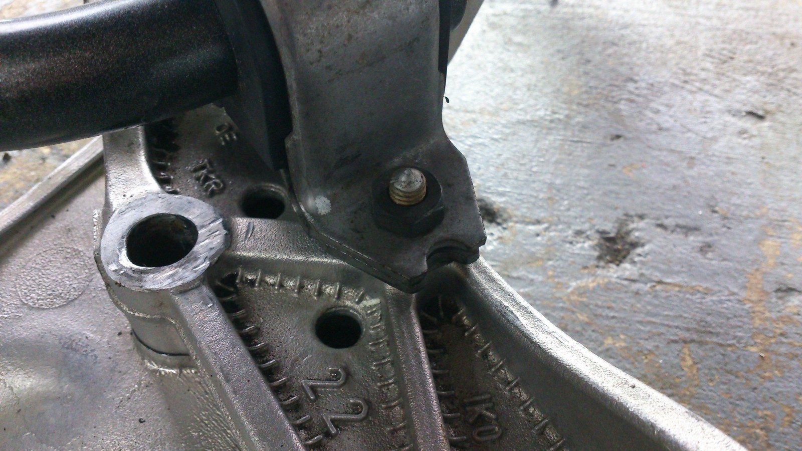

My subframe being modified

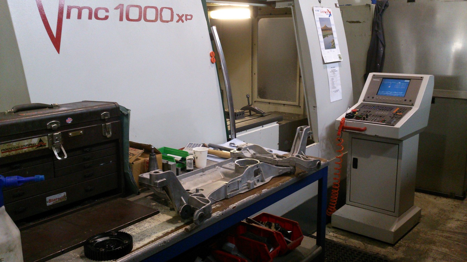

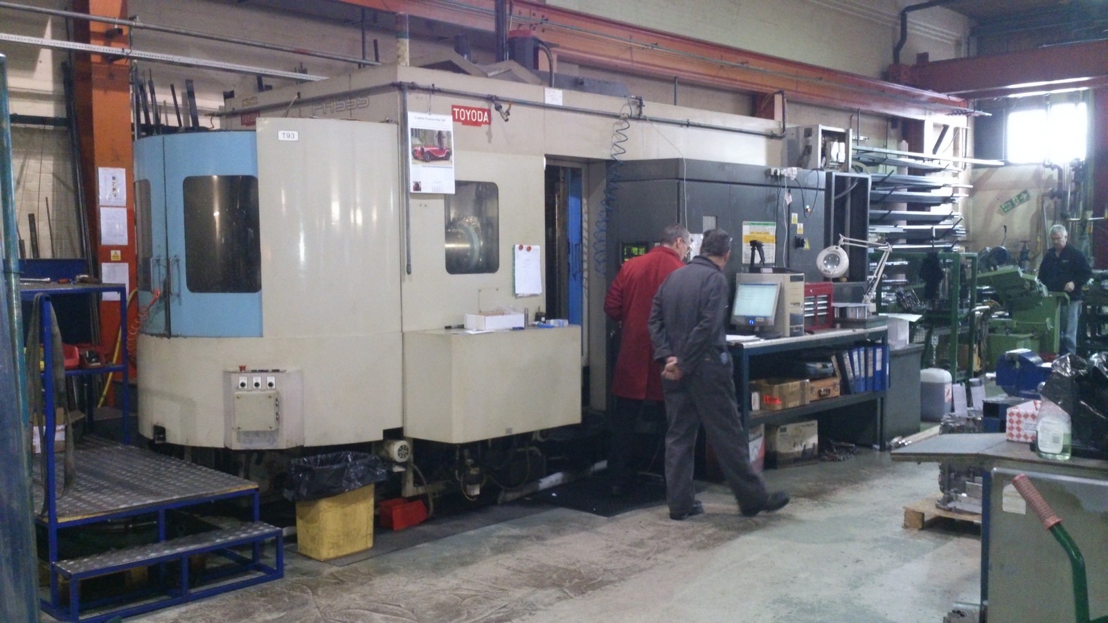

My mates rather large lathe, this is one of 3 this size!!

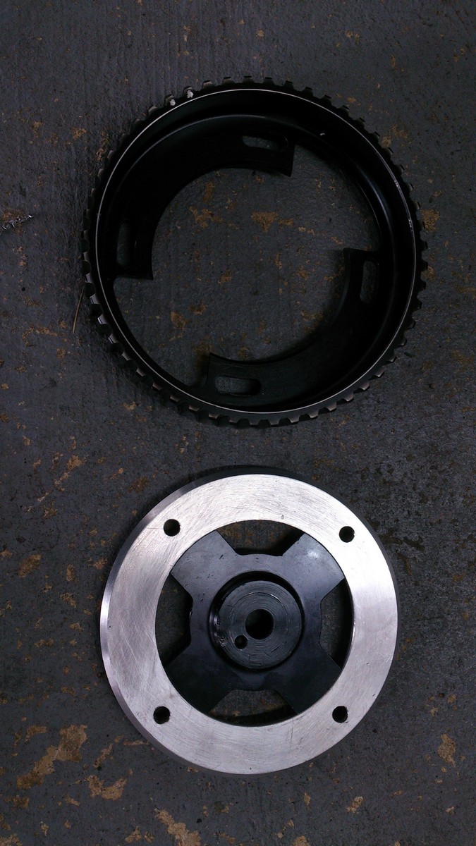

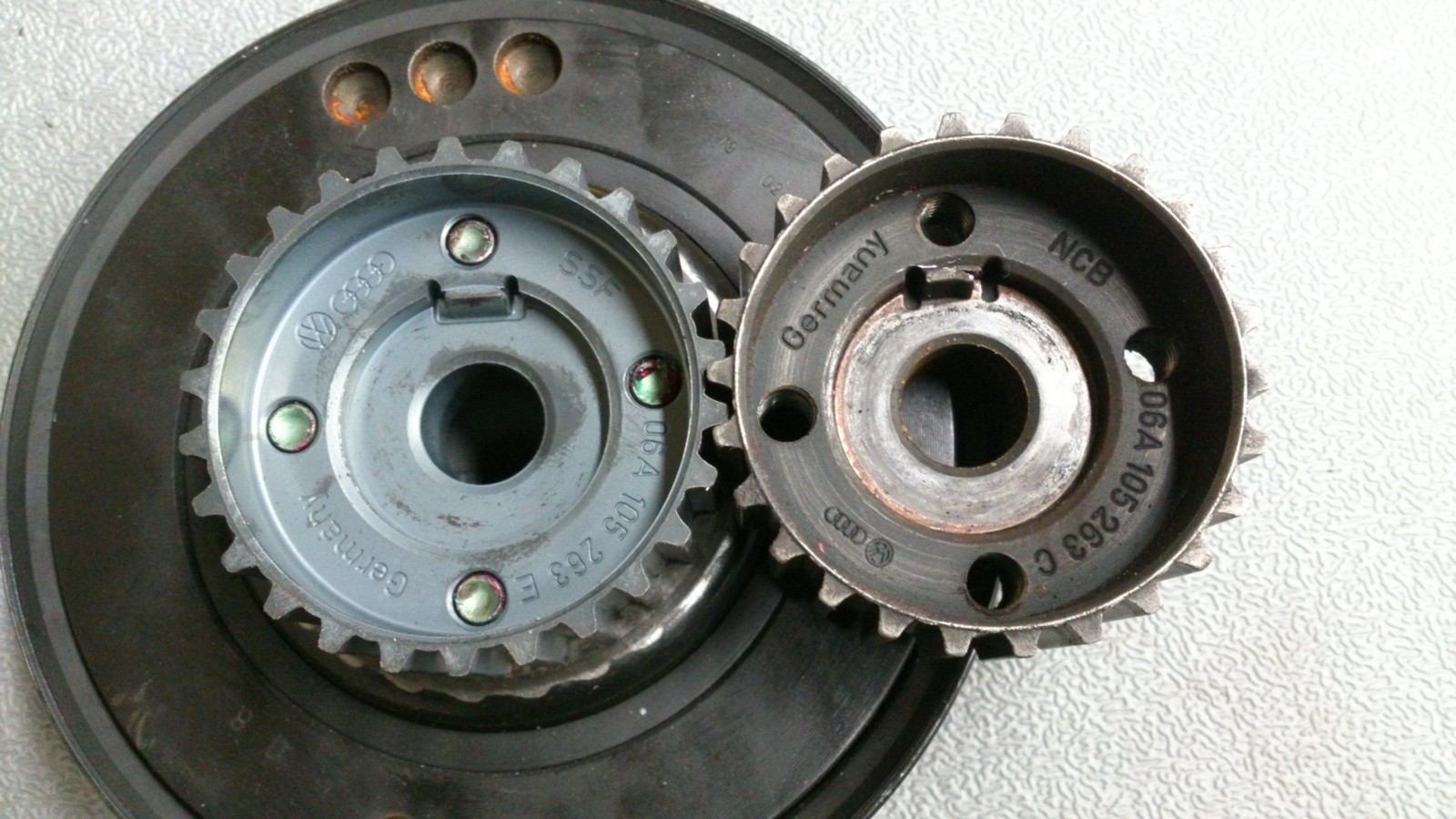

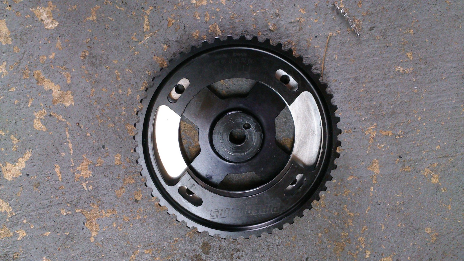

My modified cam pulley to bring it out 3.5mm so the belt dont lip. This is because the Audi 80 head does not line up correctly with the bottom pulley. The cam pulley was on the wrong way around to counter this but that was not an elegant solution for me.

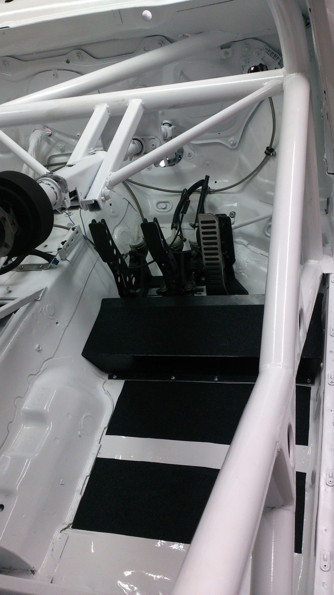

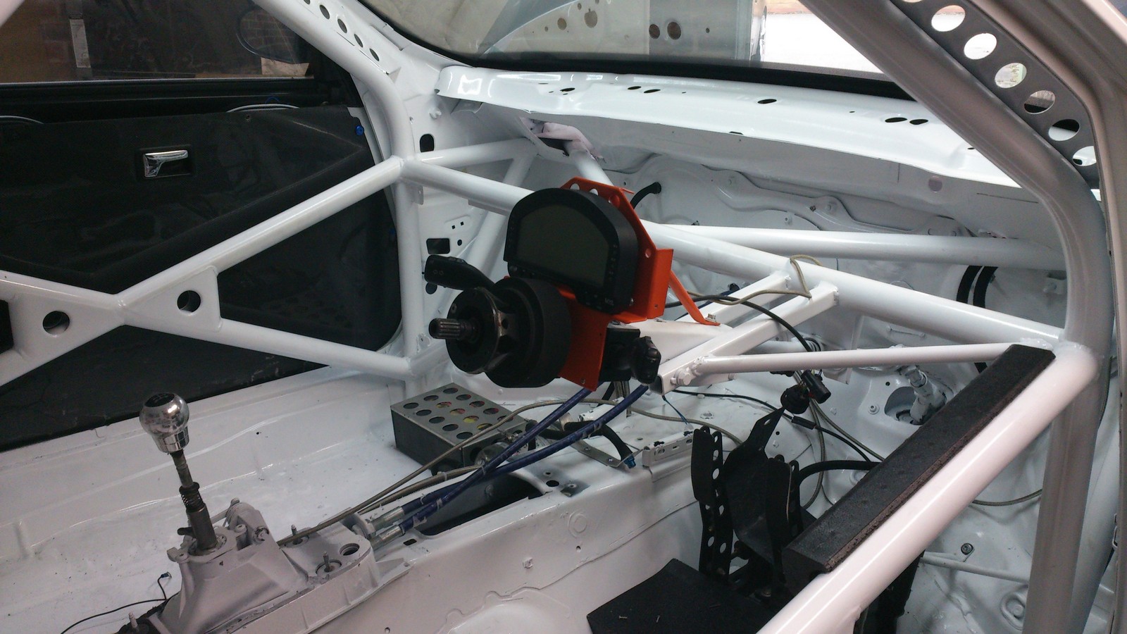

Peddle box fitted with some anti slip flooring.

Looking good, nice to know someone with machining facilities like that!
One point however, the fire extinguisher nozzles in the engine bay arent installed the way they're supposed to be.
You need to feed the T-piece from the bottom, not side entry, as it is just now the rear nozzles will not deliver much gas as it will basically just flow straight past the branch on the side.
I've got exactly the same kit in my car and spoke to one of the guys at lifeline about alternatives to using a T as it can be difficult to accomodate in a lot of installations. They do a Y-piece which will still deliver equal amounts of gas to both outlets and is easier to fit.
  BMW Z4
That's an interesting point. Why do they sell the kit with T pieces if they dont work and flow past them? Seems a bit anal that! I will get some Y pieces as to feed those in the engine bay from the bottom will be a f**king pain the the f**king arse of bending pipes etc.

  Audi A6 & 172 Cup
It says in the installation manual they have to be installed with the feed at the bottom, or at least the diagrams show the pipework configured like that.
I bought a wee pipe bender on ebay that does various sizes, 3/16 for my brake pipes, and it also does 5/16 which was perfect for bending this pipe, granted you can bend it easily with your thumbs but the pipe bender makes a neater job of it.
  BMW Z4
I managed to change em around with not much bother, thanks for the heads up.

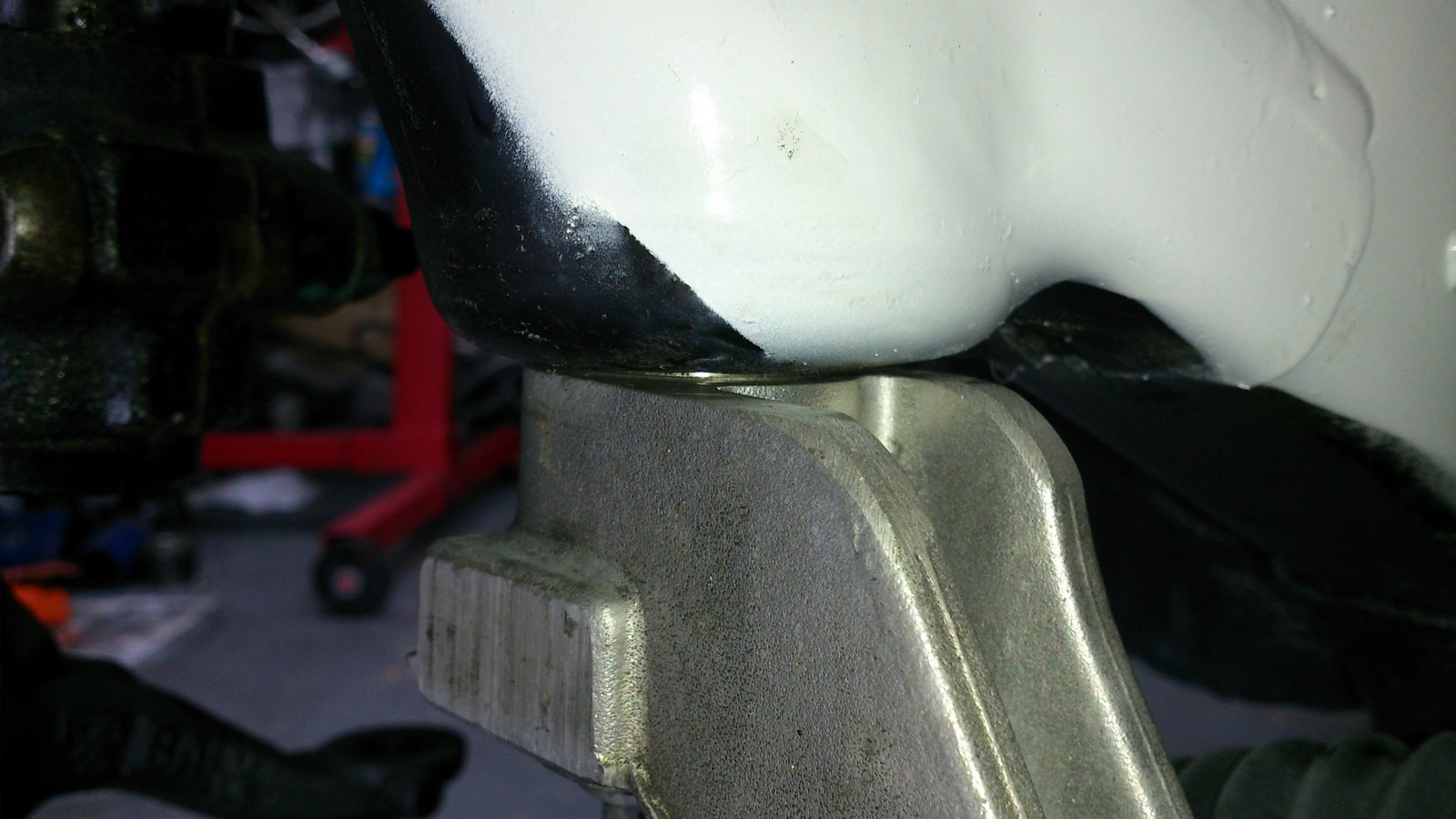

Man there are a LOT of jobs on this rebuild. It has been more work that I thought simply because I remove something and see it needs redesigning so its taking a lot longer than a normal reuild would. Anyway here are some parts I had made

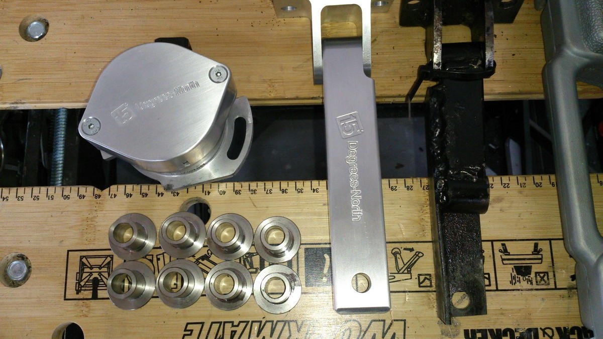

My stainless subframe mount kit, a much better solid dogbone and a nicer cap for the hall switch.

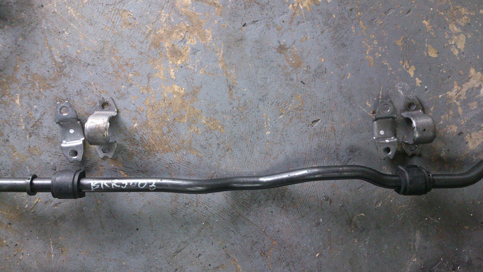

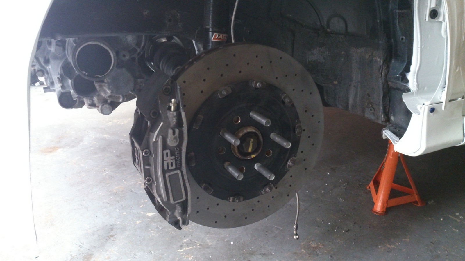

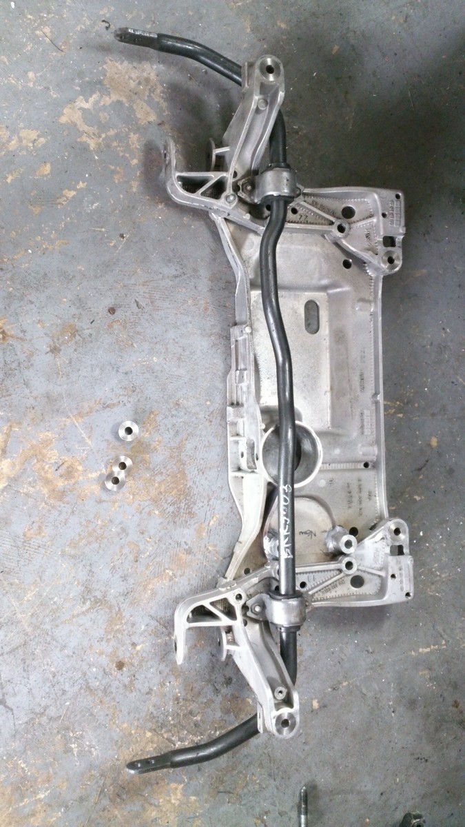

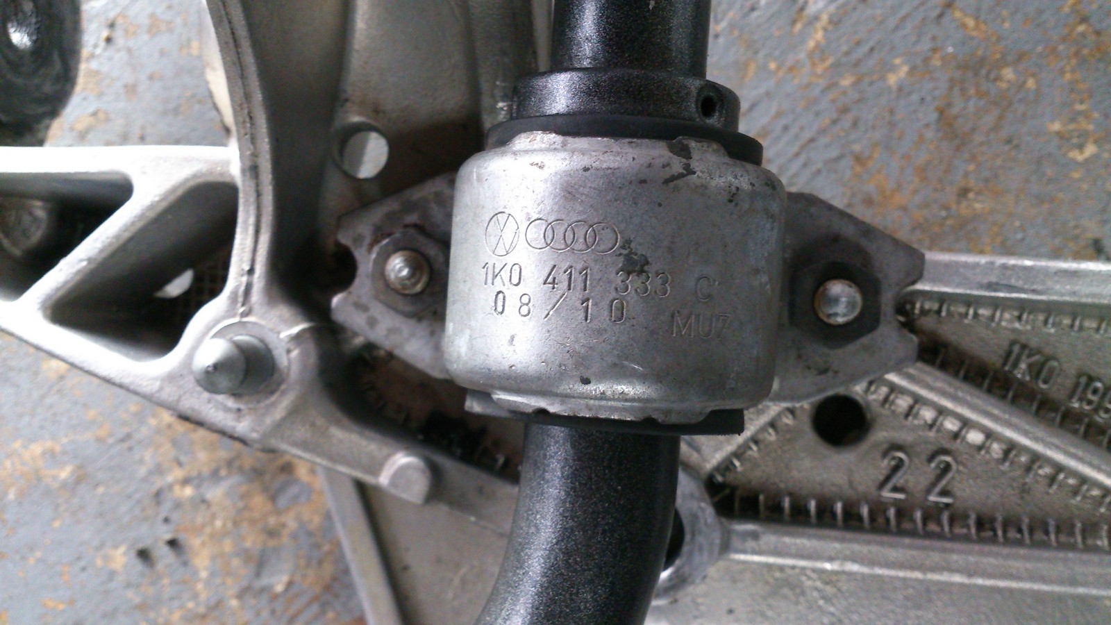

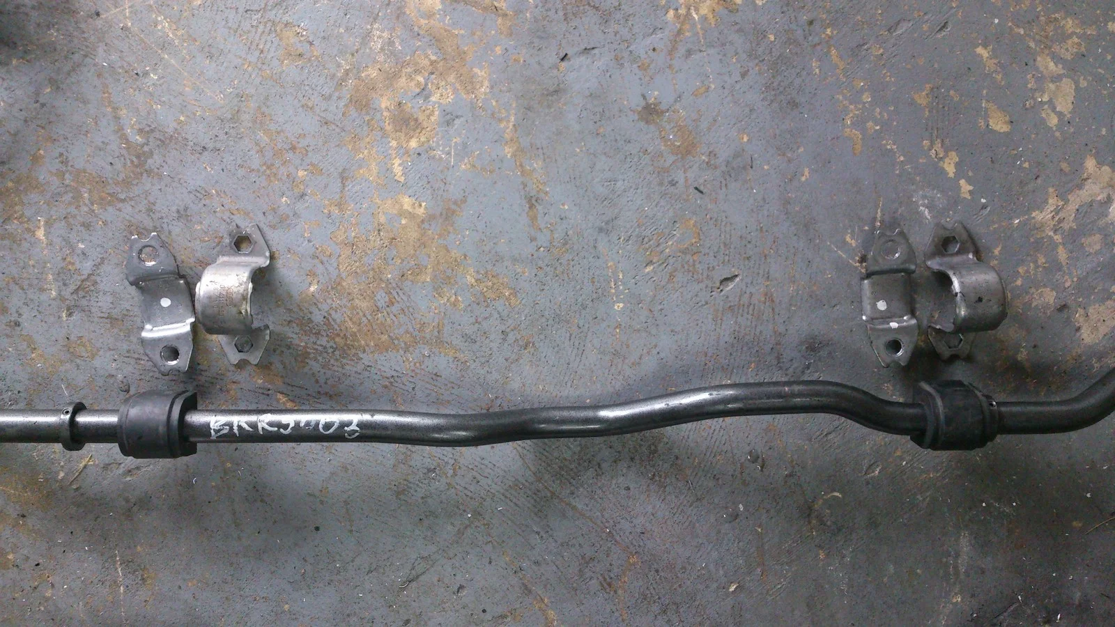

I decided to fit the H&R anti roll bars I had lying around. For this of course you re-use the standard mounts.
If you are careful you can drill out the riv nut using a 13mm drill and still use the nut part again

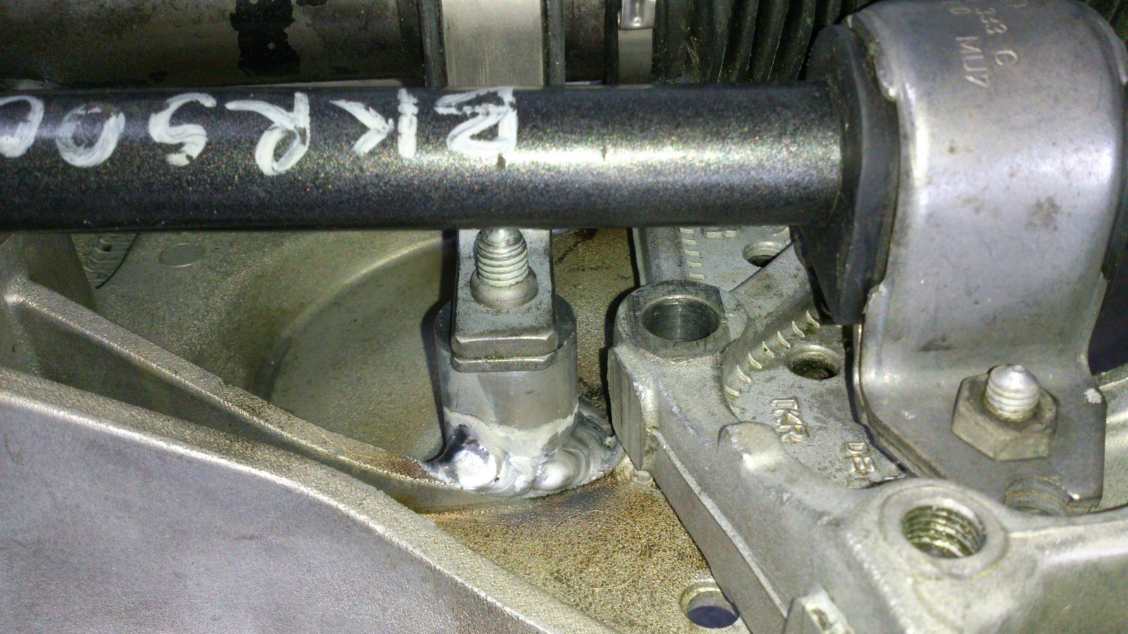

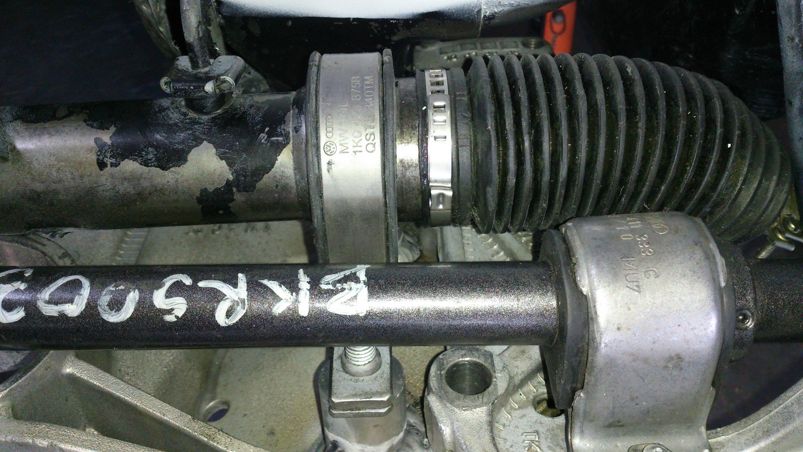

This is my modified subframe so the mount for my rack does not push the gaitor off the end like it was before!
My bushes fitted. 1mm stainless. You have to loosen the whole subframe for these to fit nicely

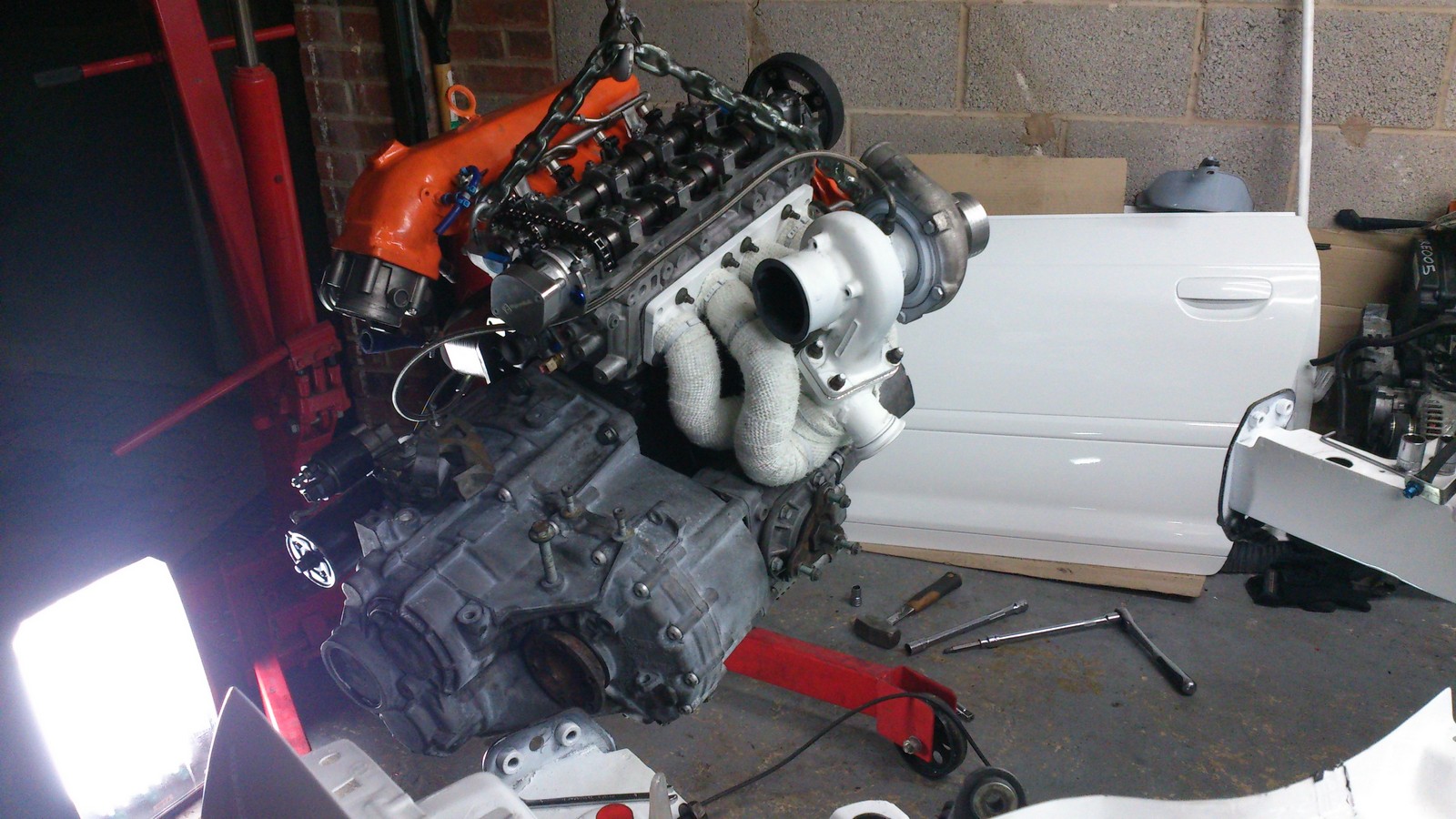

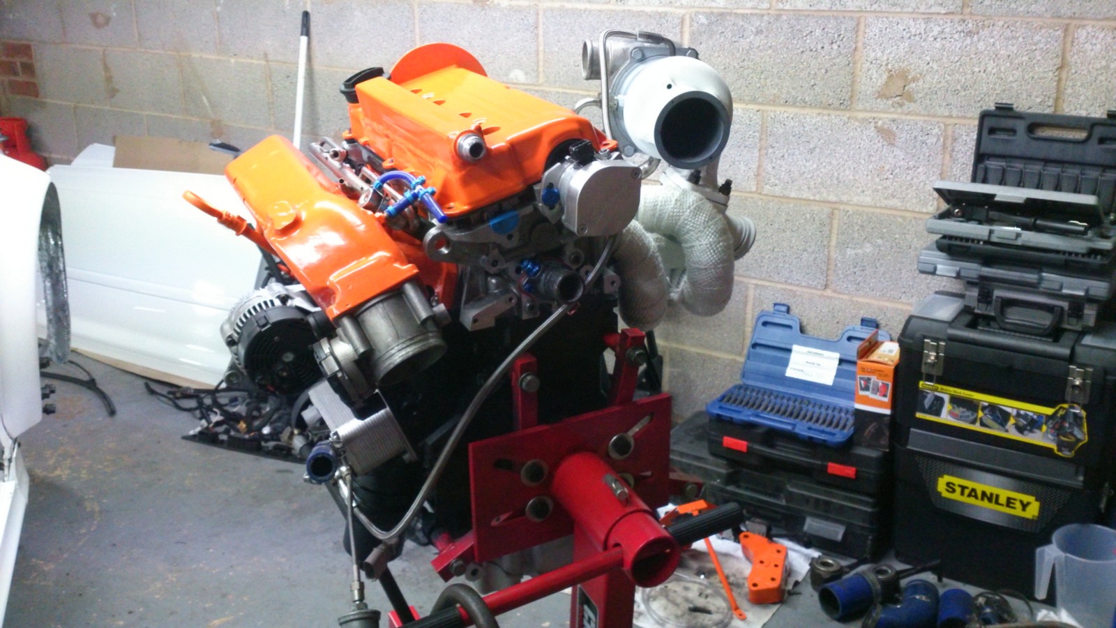

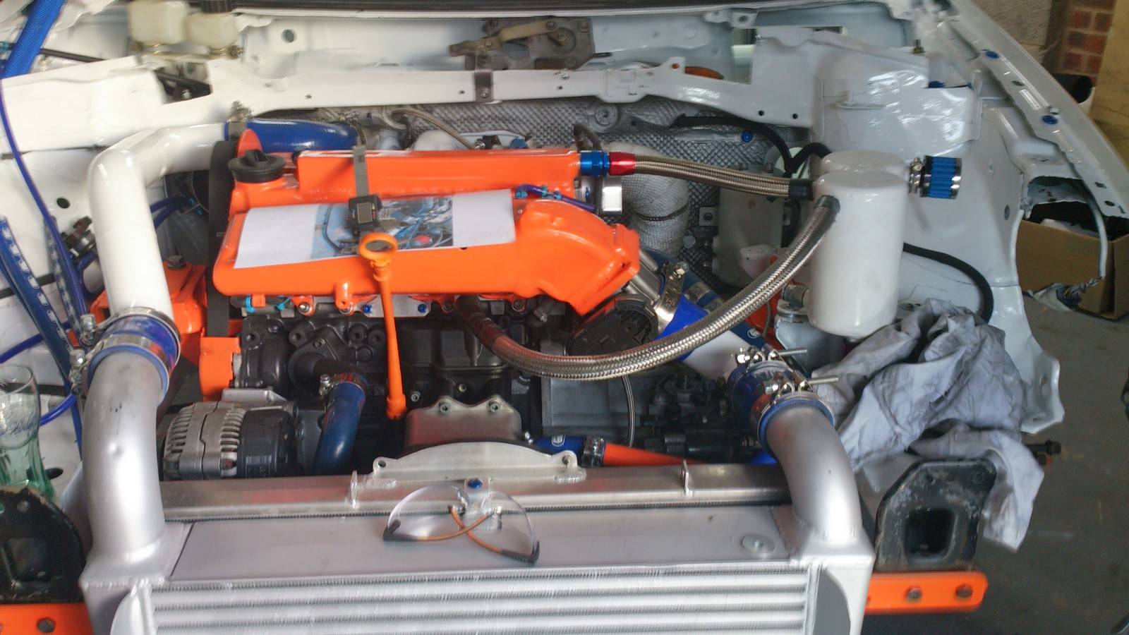

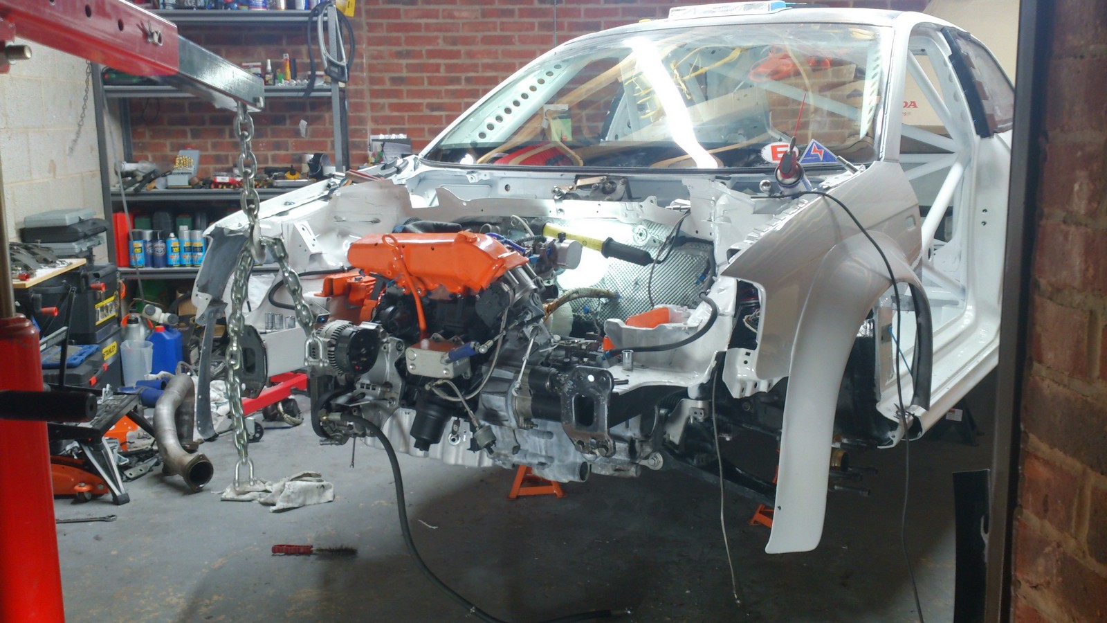

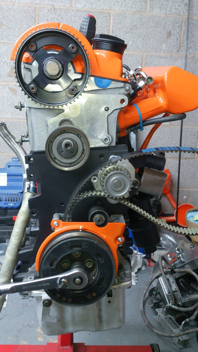

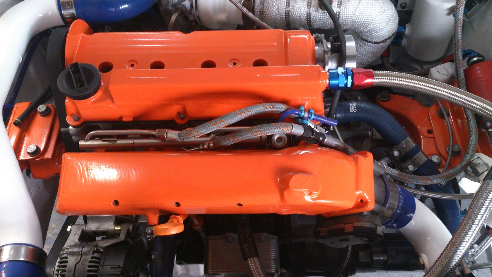

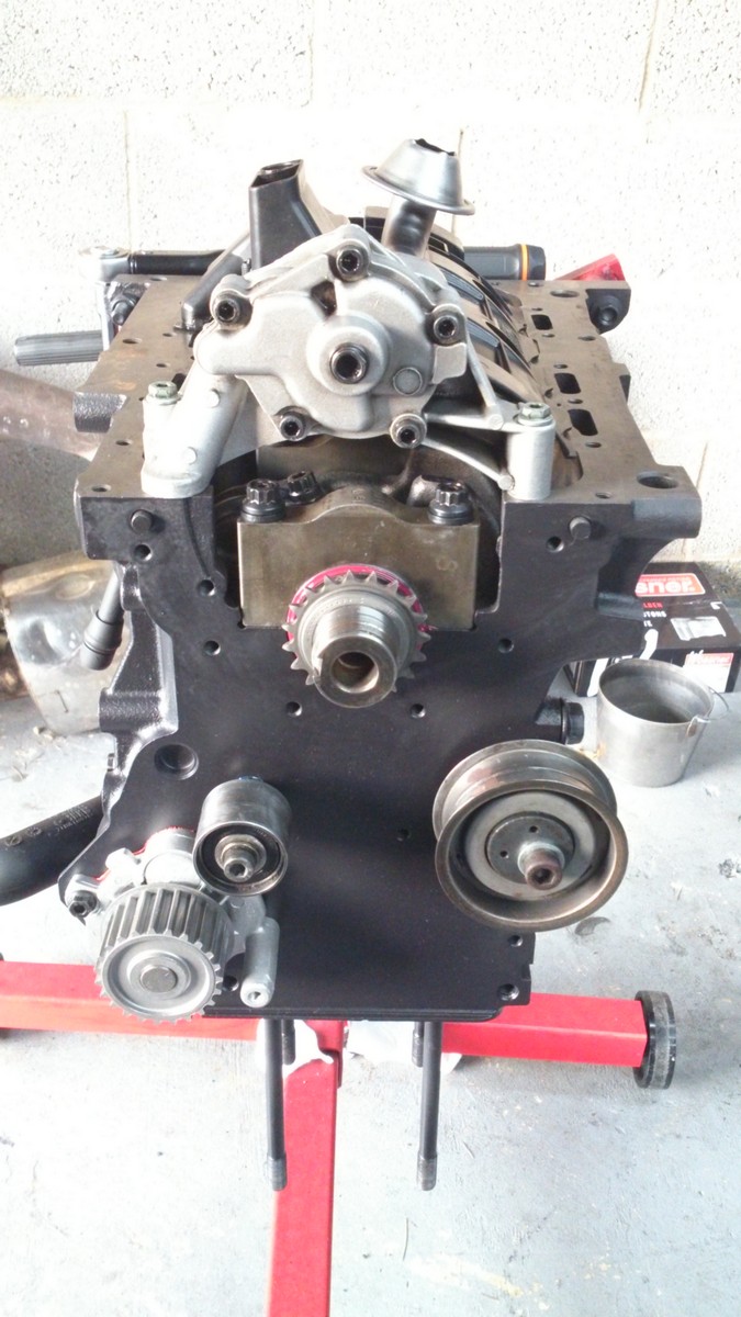

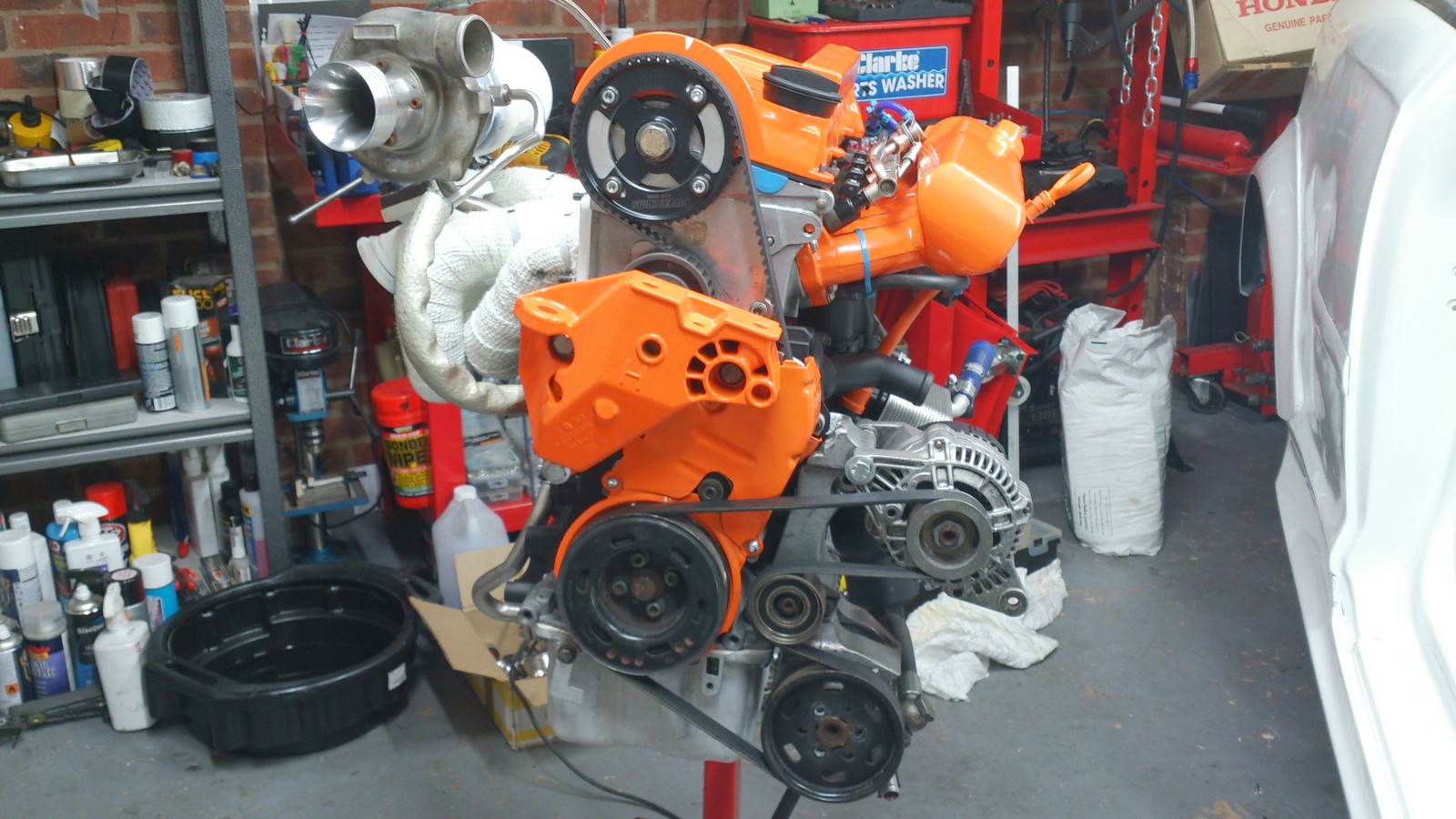

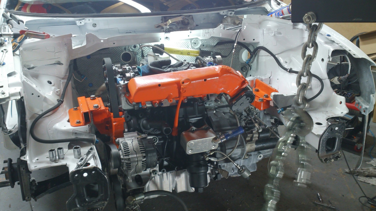

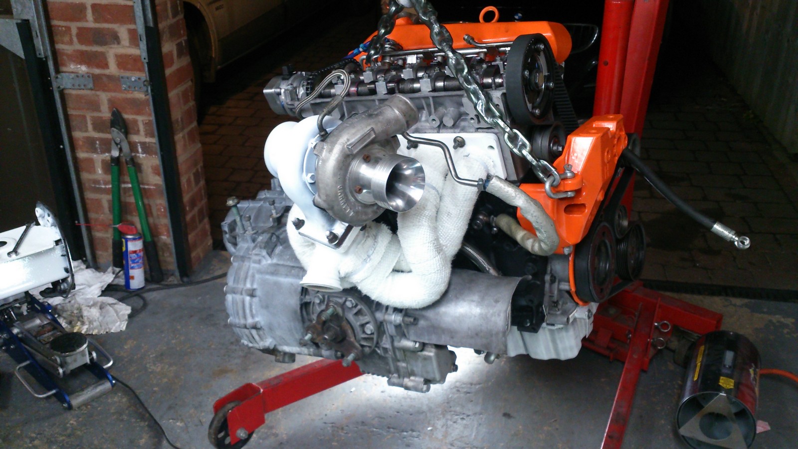

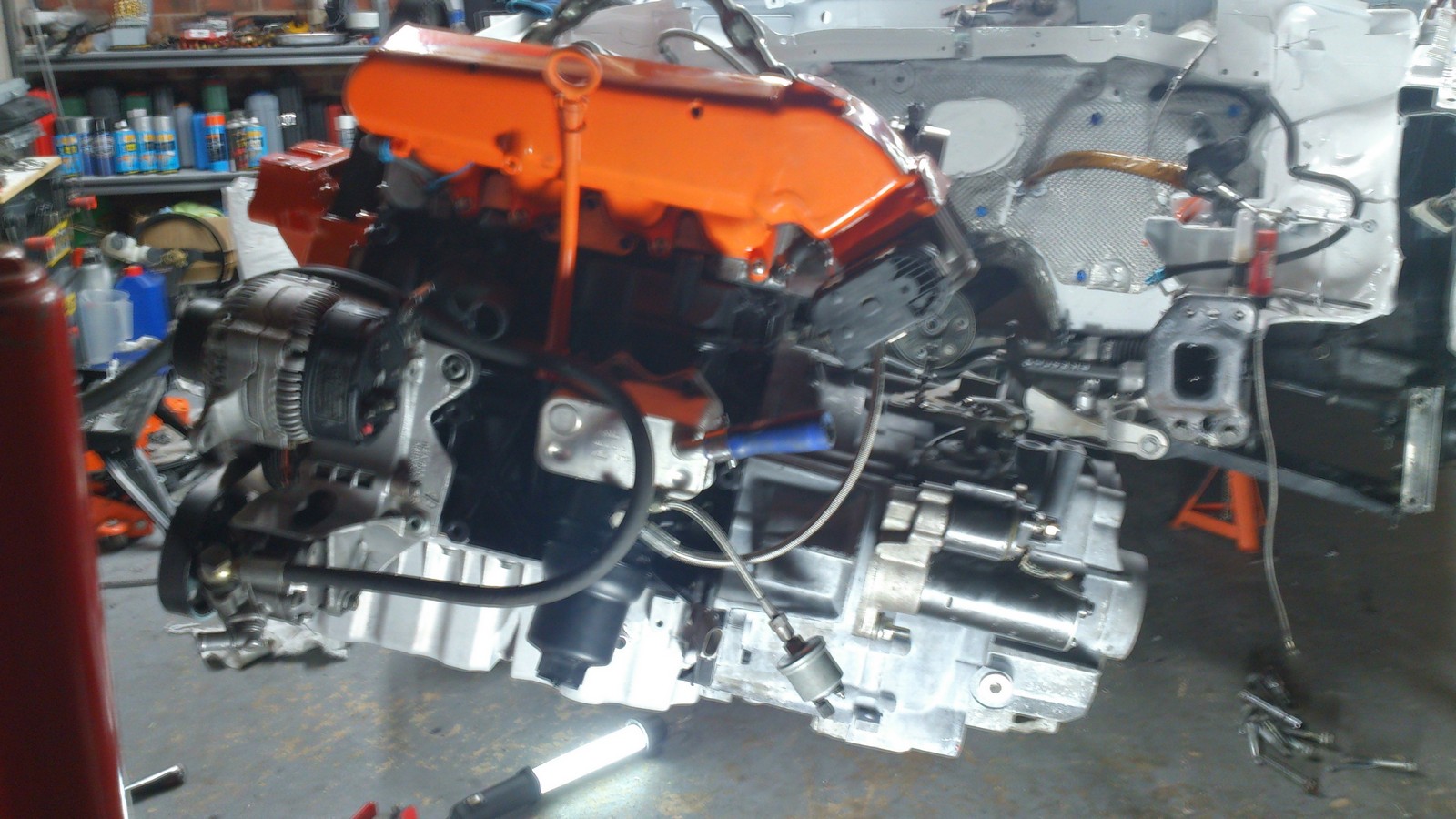

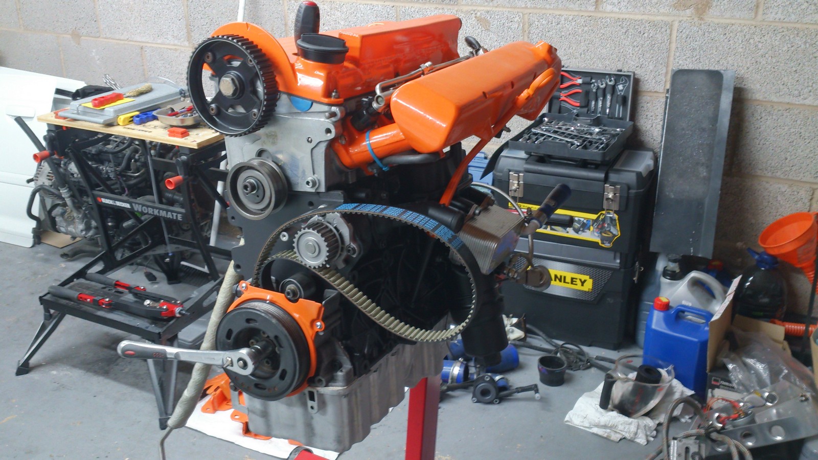

This is the engine just about complete
And back in the car

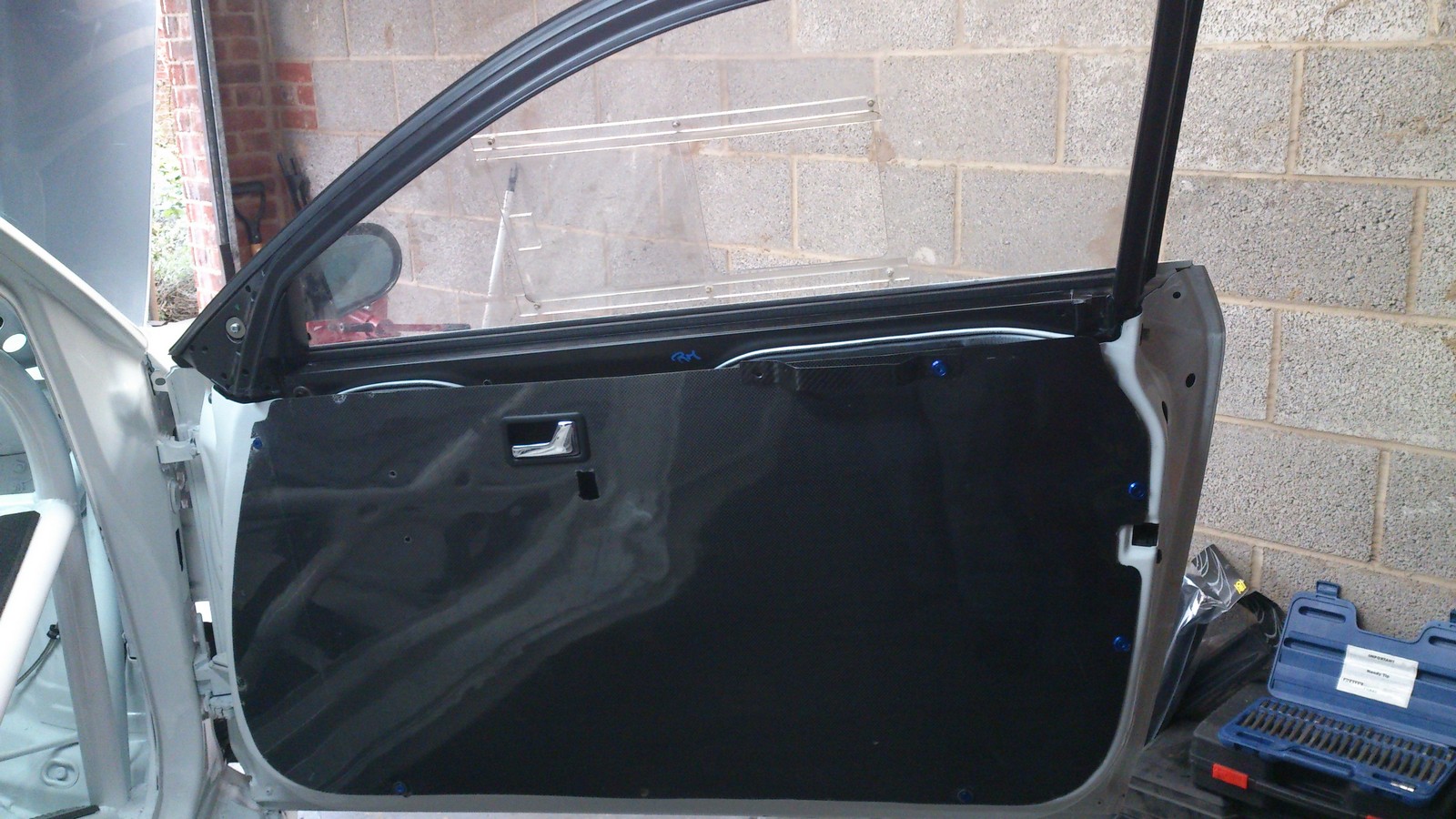

1. Carbon door cards need fitting by using M6 riv nuts and M6 blue counter sunk with blue washer I guess one in each corner, Door centres can be cut out but leave room for mounting door card and door frame mounts
2. Carbon door handles need fitting to top centre of doors with M6 riv nuts and blue fixings

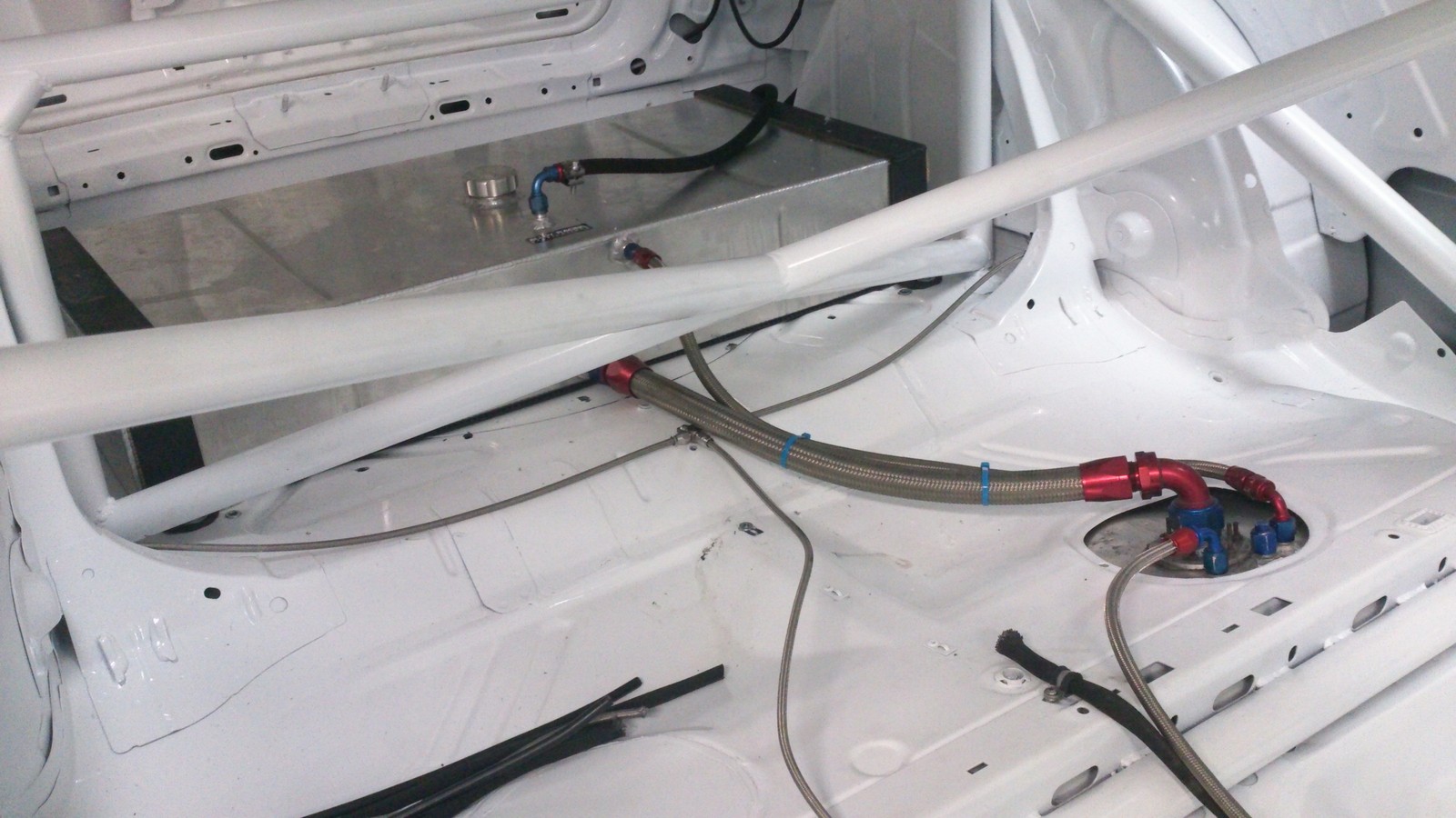

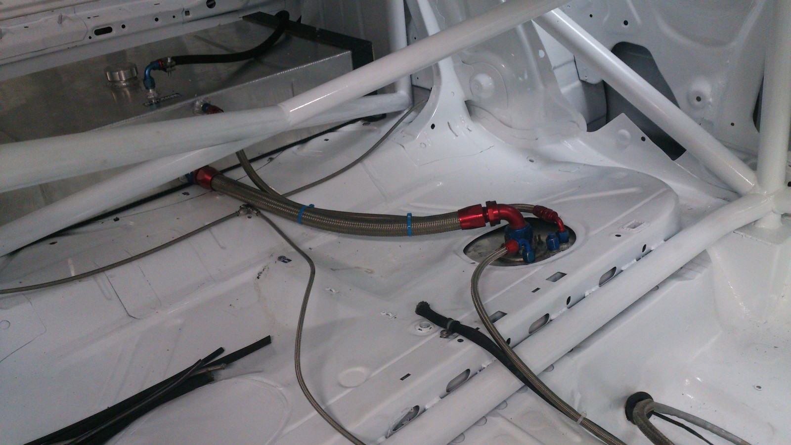

Fit rear fuel pump and filter back underneath car on the hangers
Run pipe through car secured with M5 riv nuts and P clips
Pipe in swirl pot in engine bay and high pressure fuel pump in engine bay

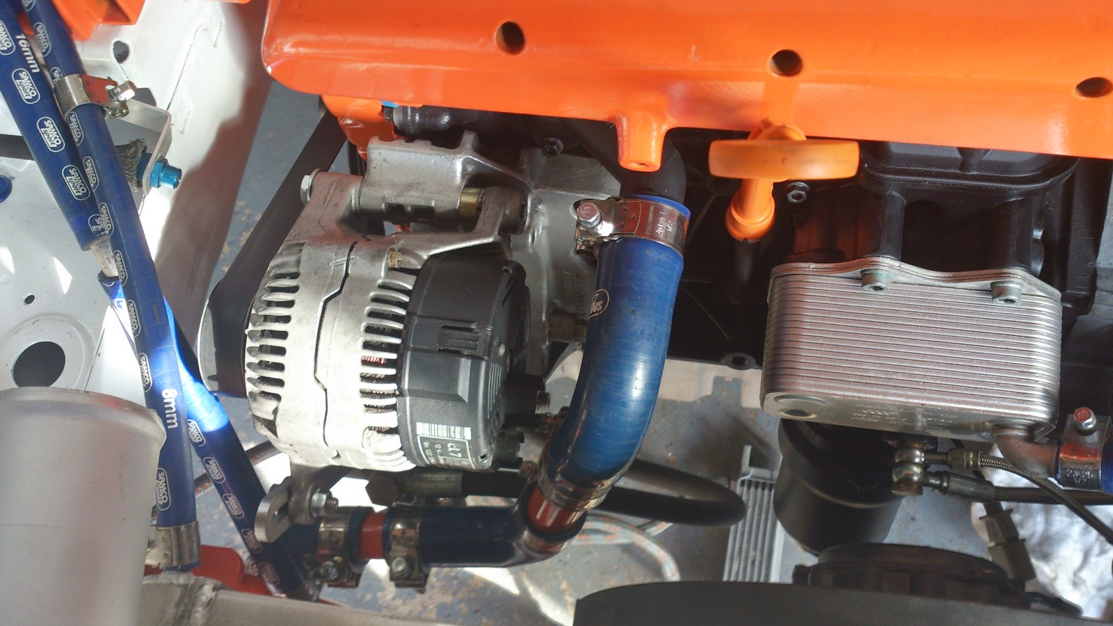

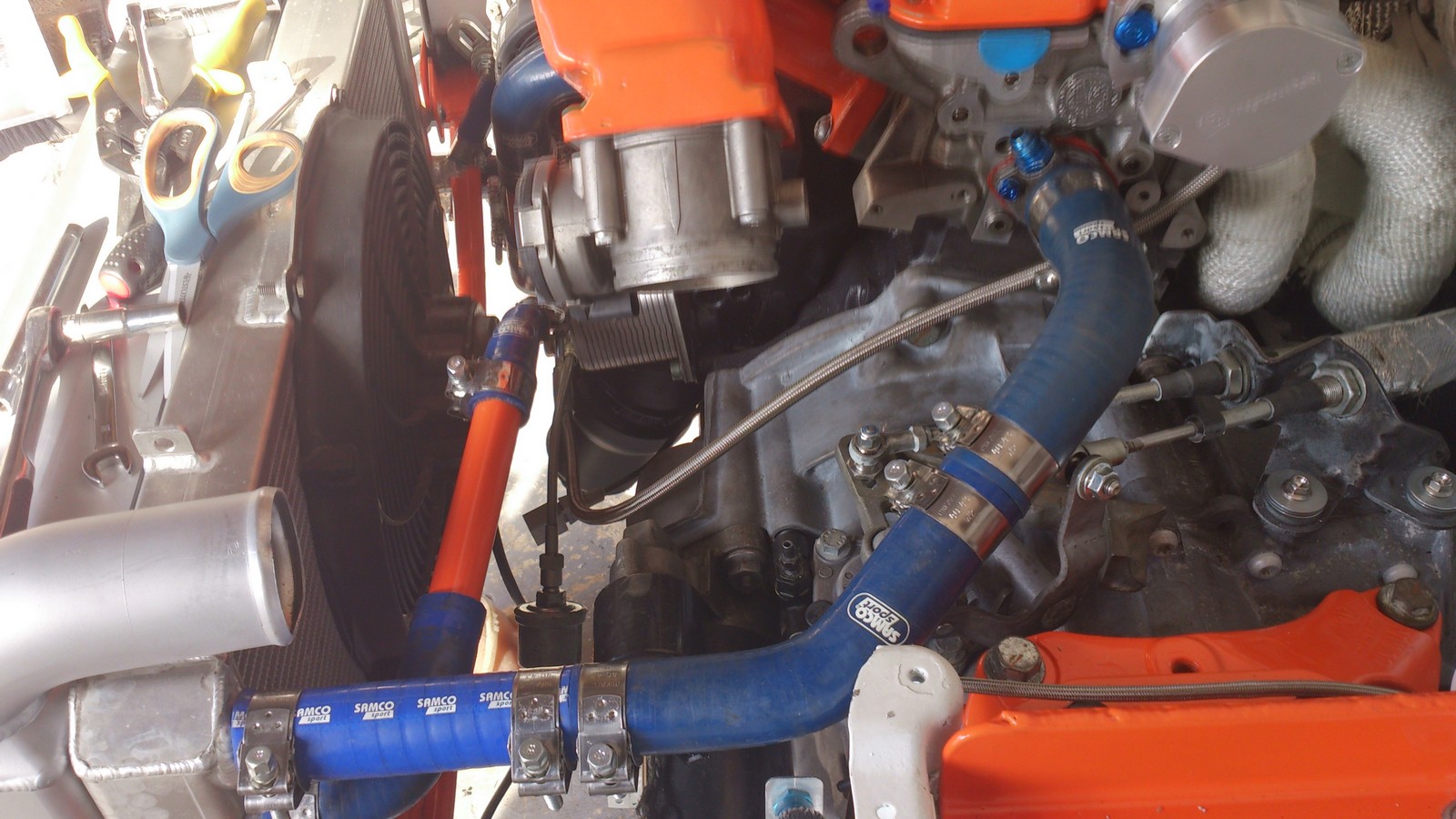

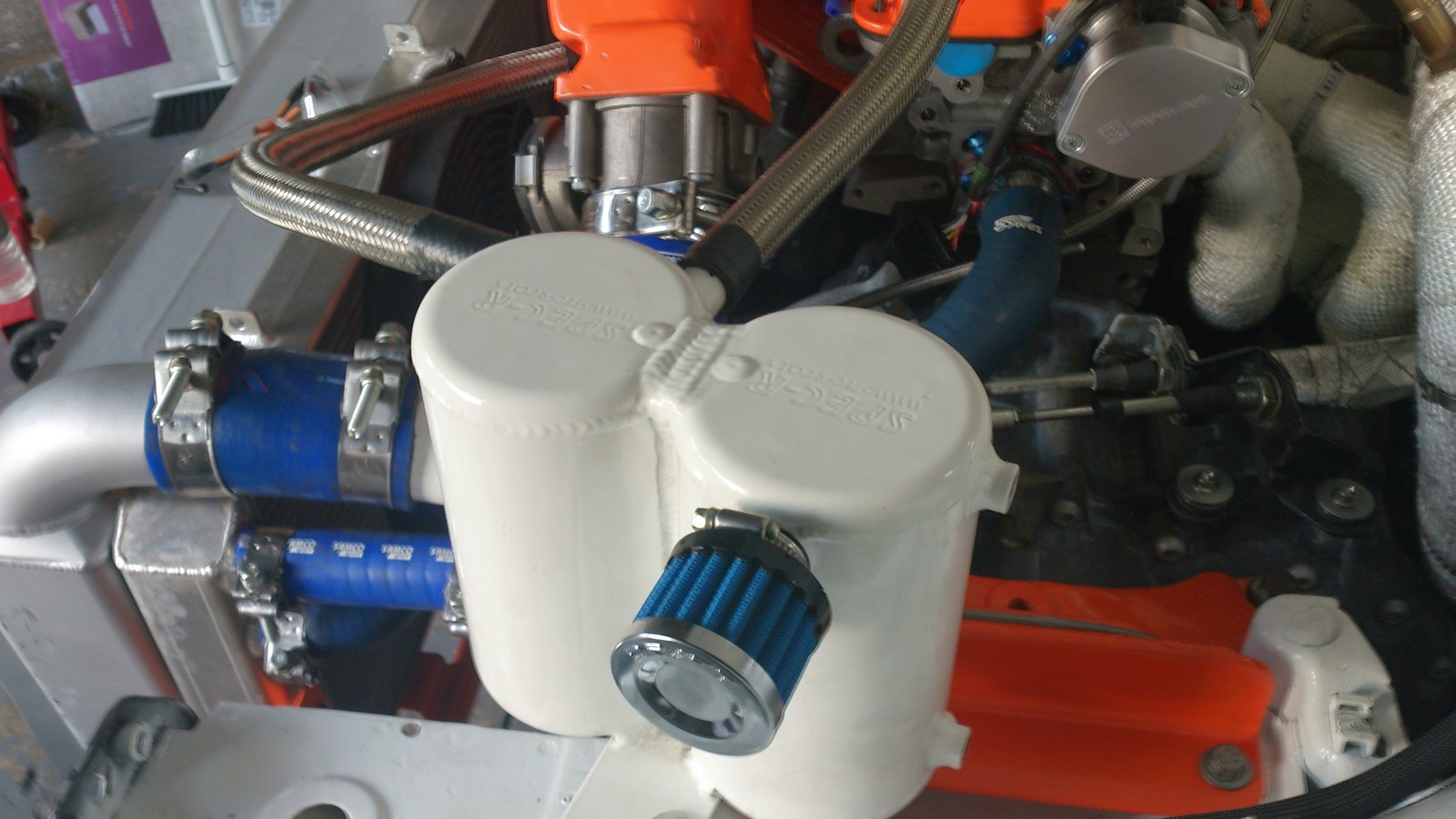

Lots of progress and I am on the home stretch now
At last! This has been a much bigger build than I imagined (arnt they always eh)

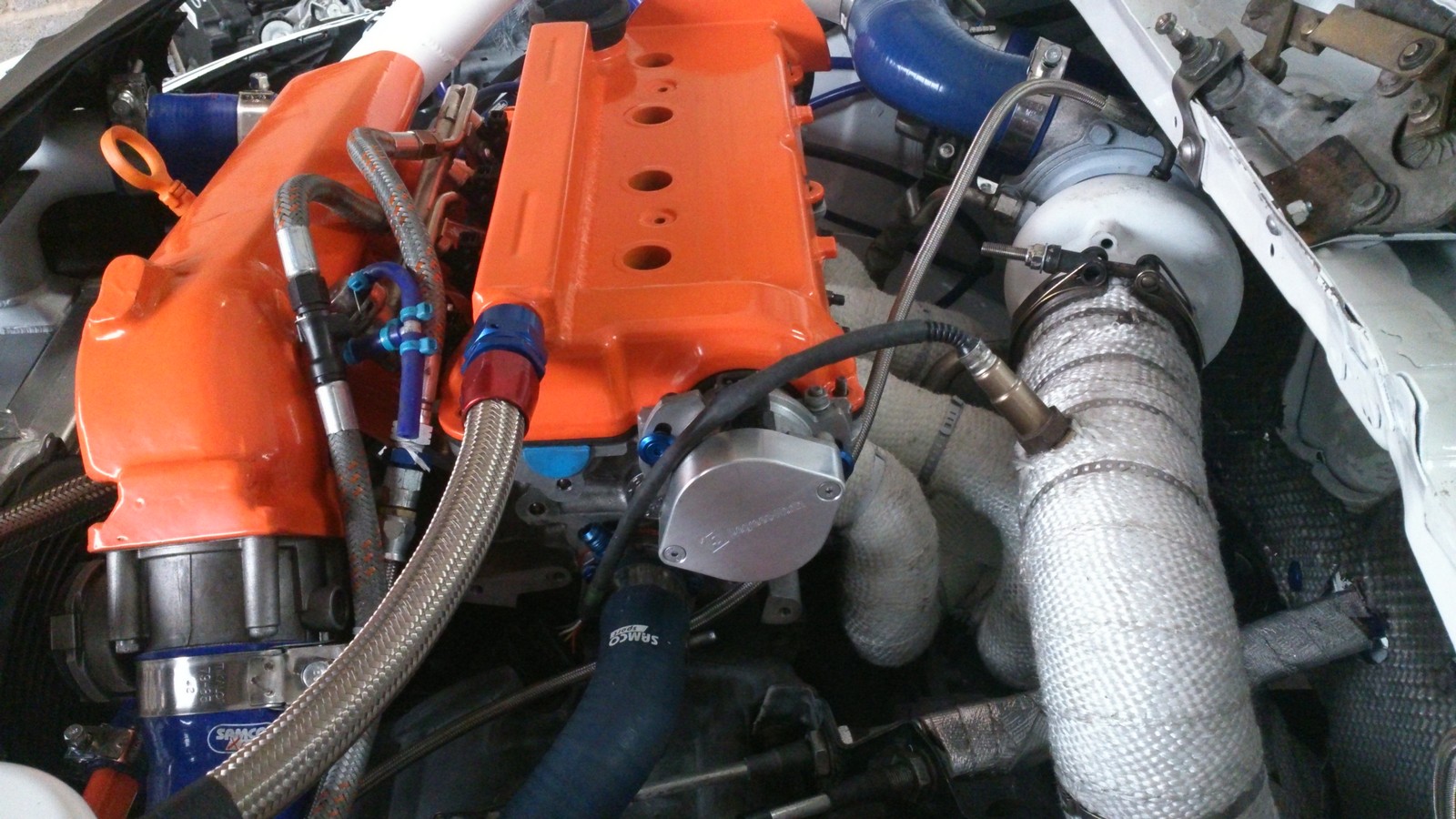

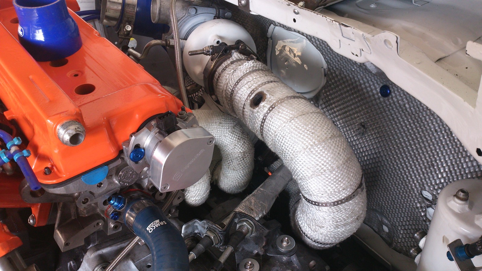

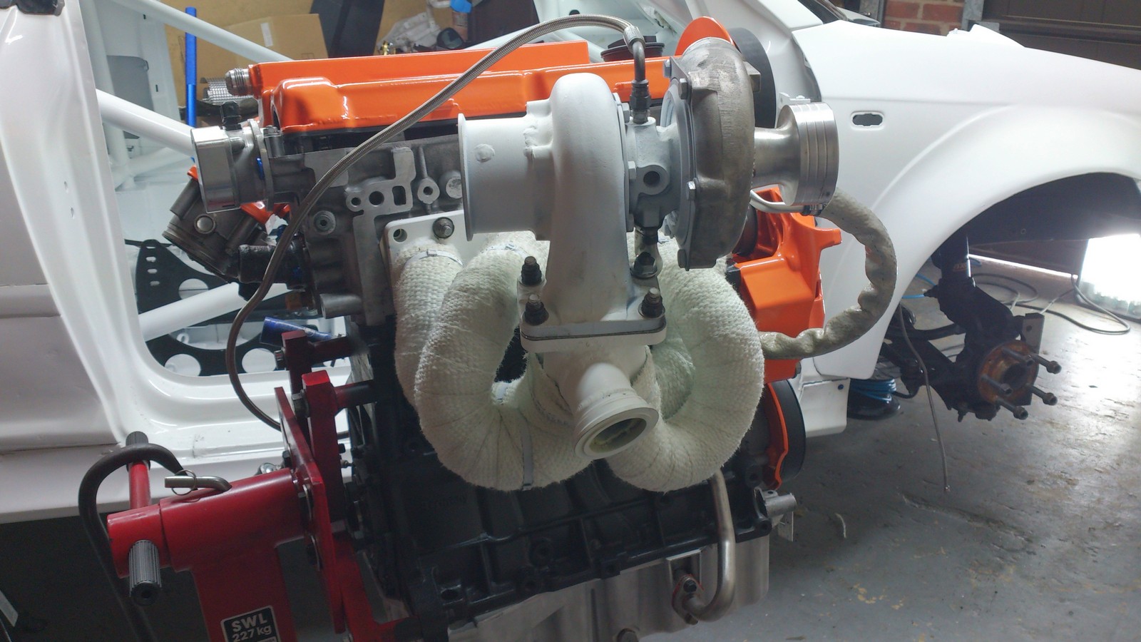

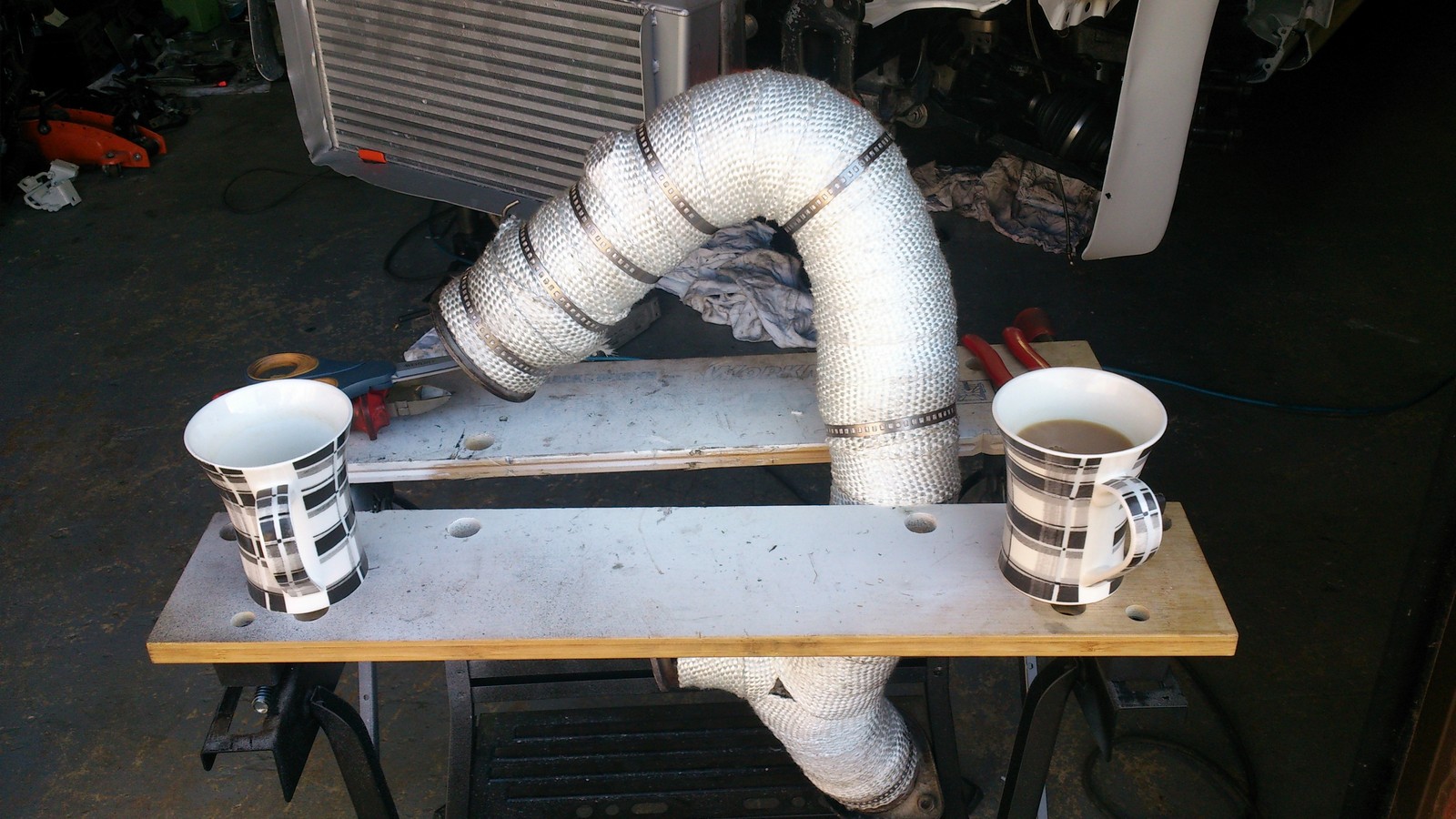

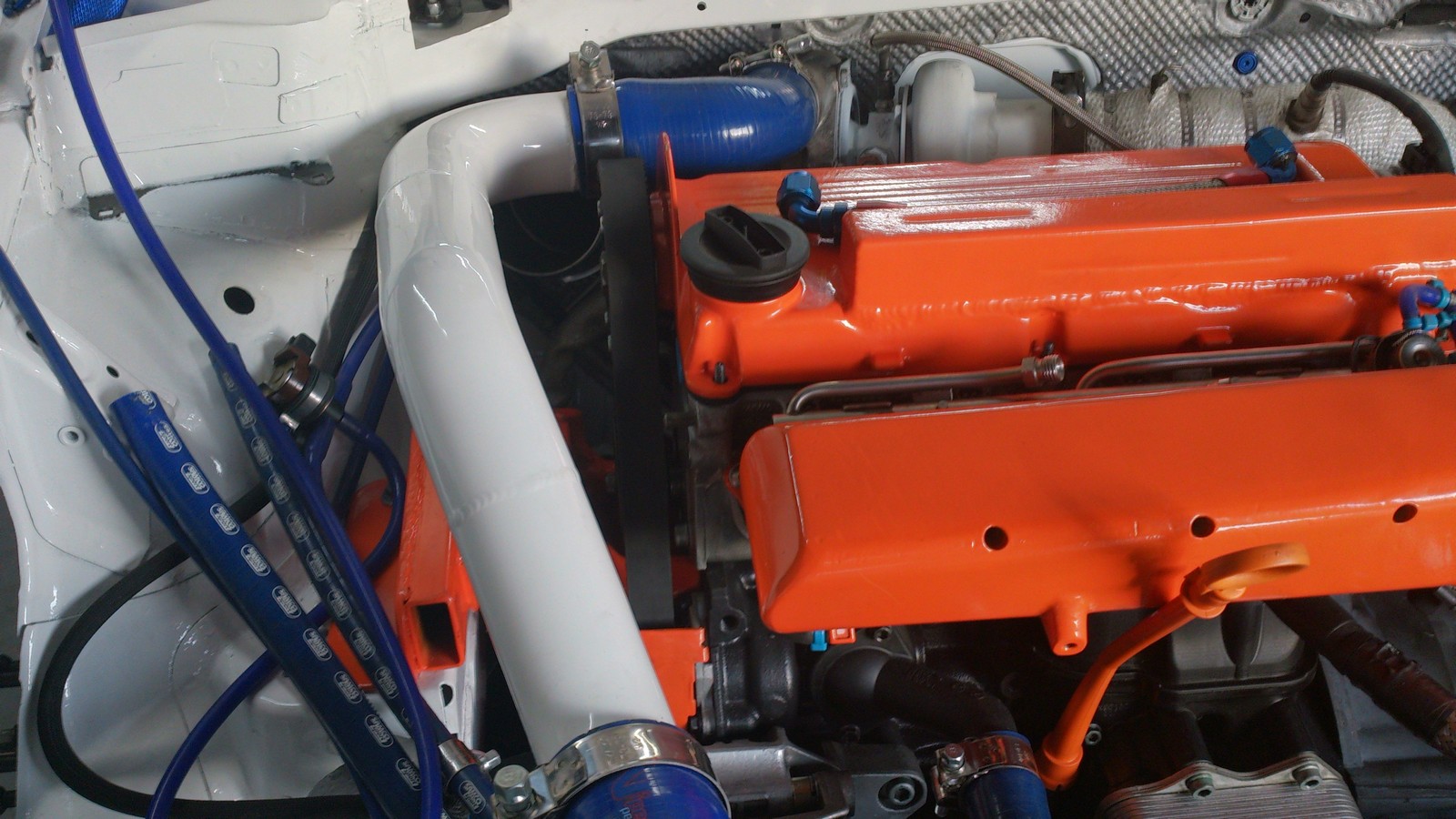

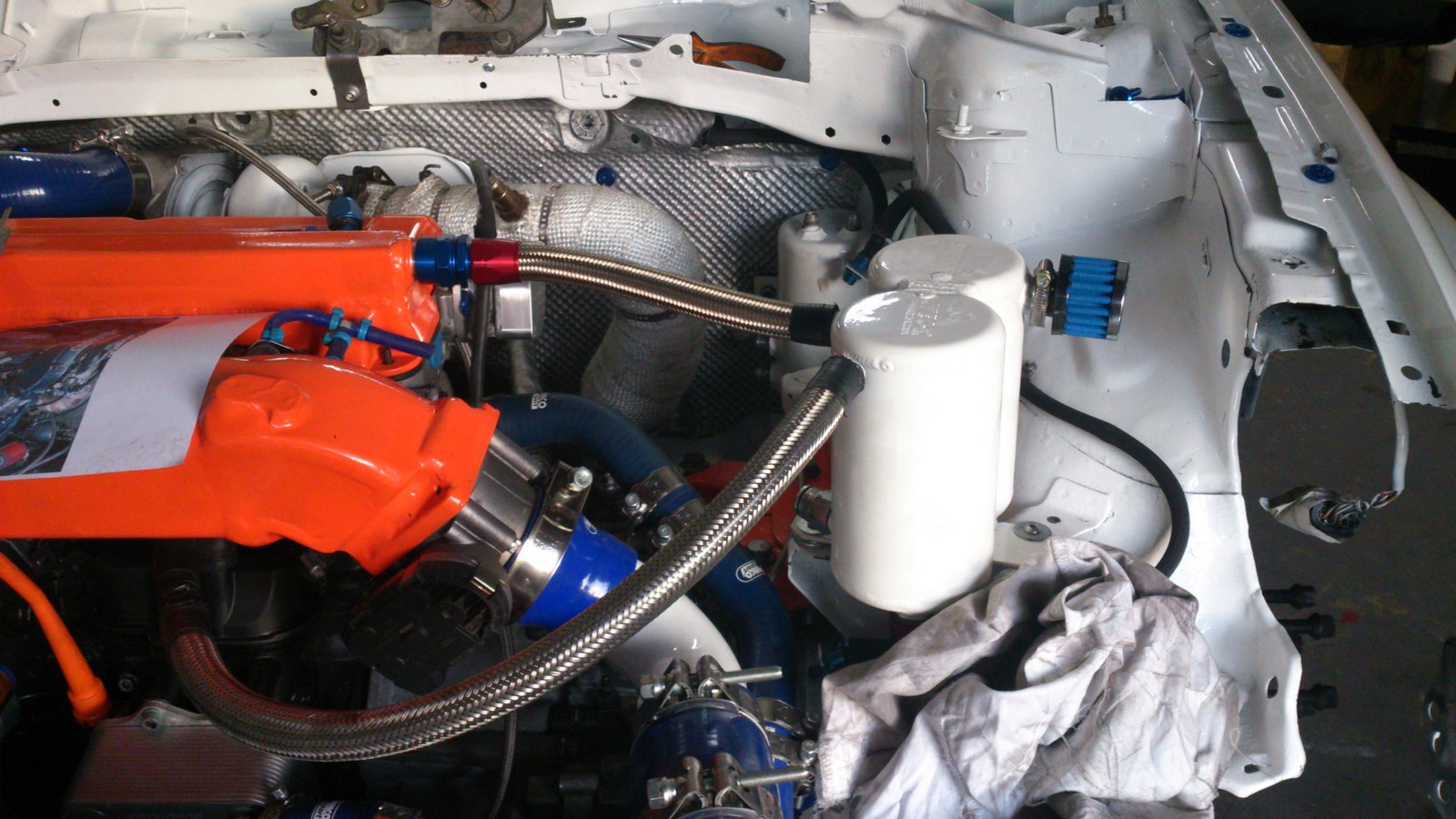

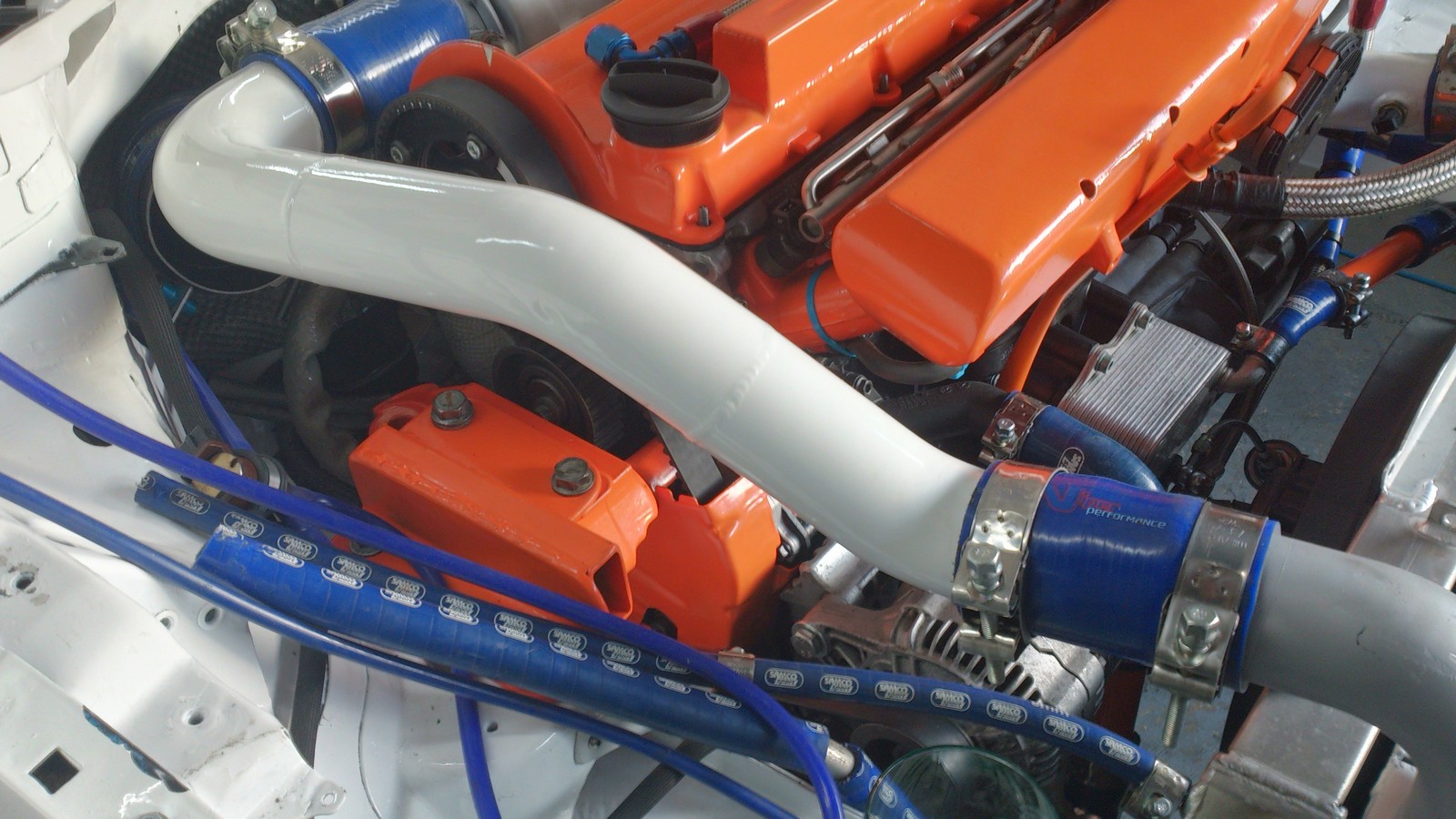

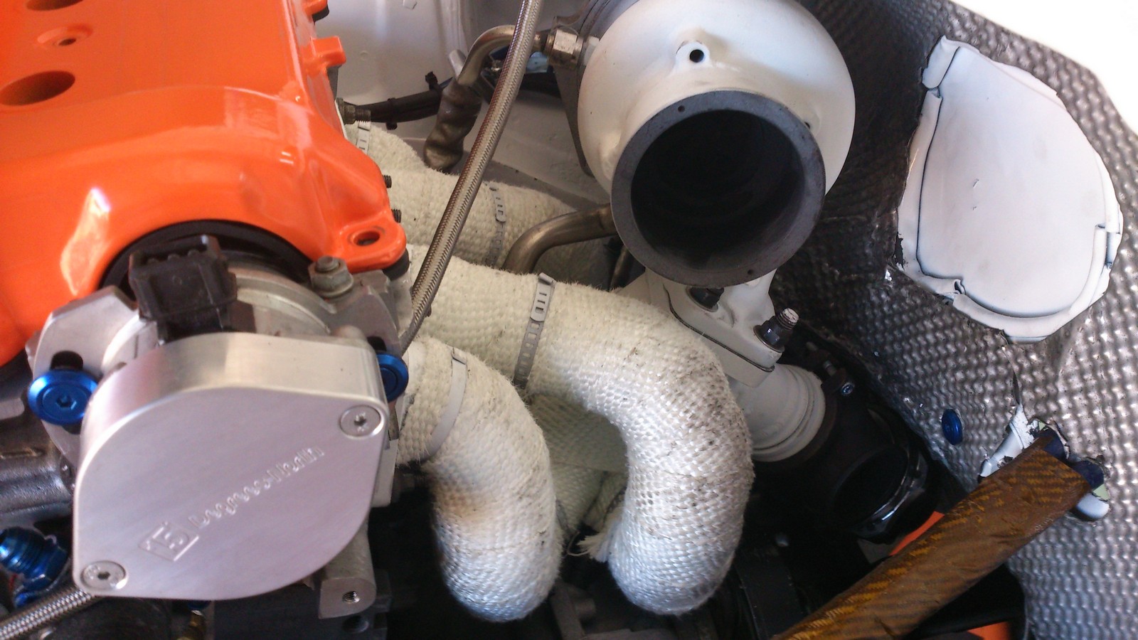

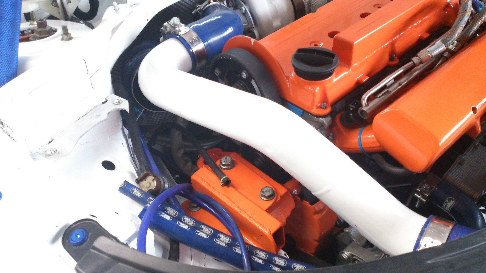

Much better wrapping on the downpipe. Should help with heat in the bay. I have also wrapped the manifold. I use Cv joint straps for this as they never come off!

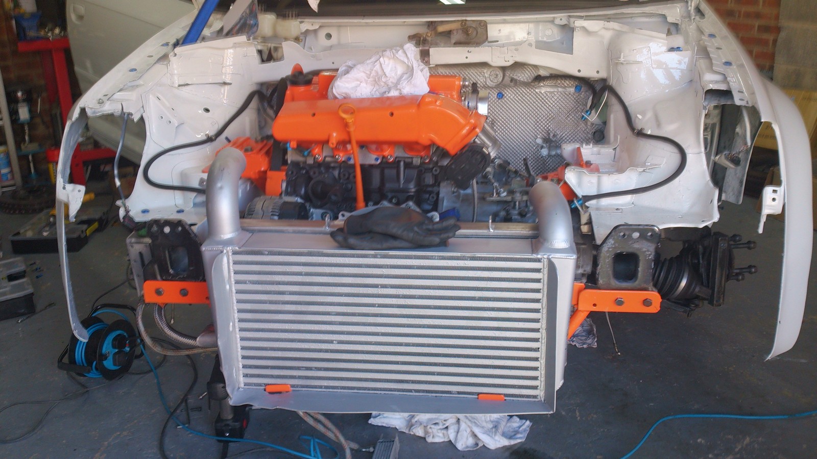

Gave the intercooler a lick of paint to tidy it up a bit.

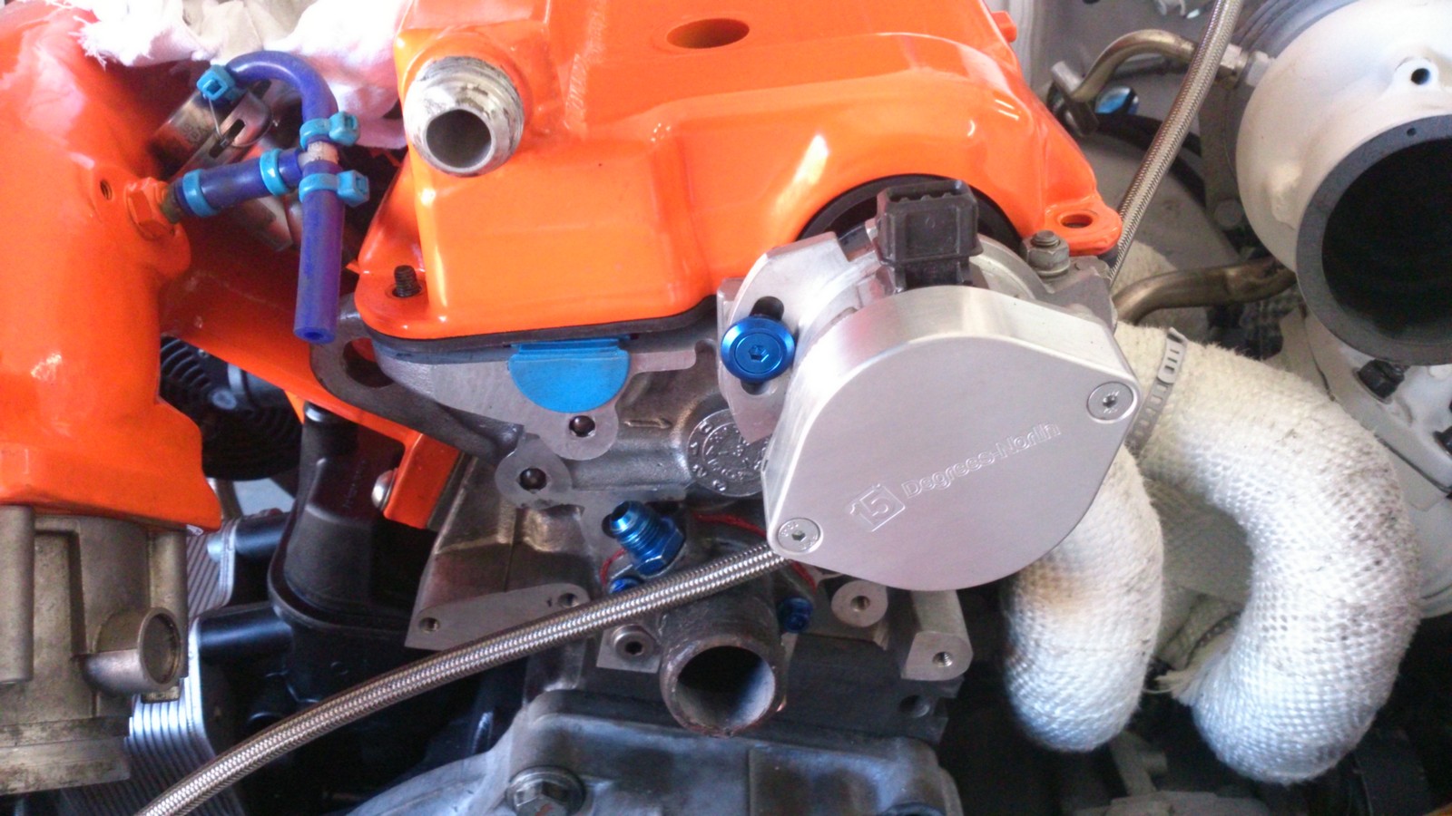

My nice new hall switch cap

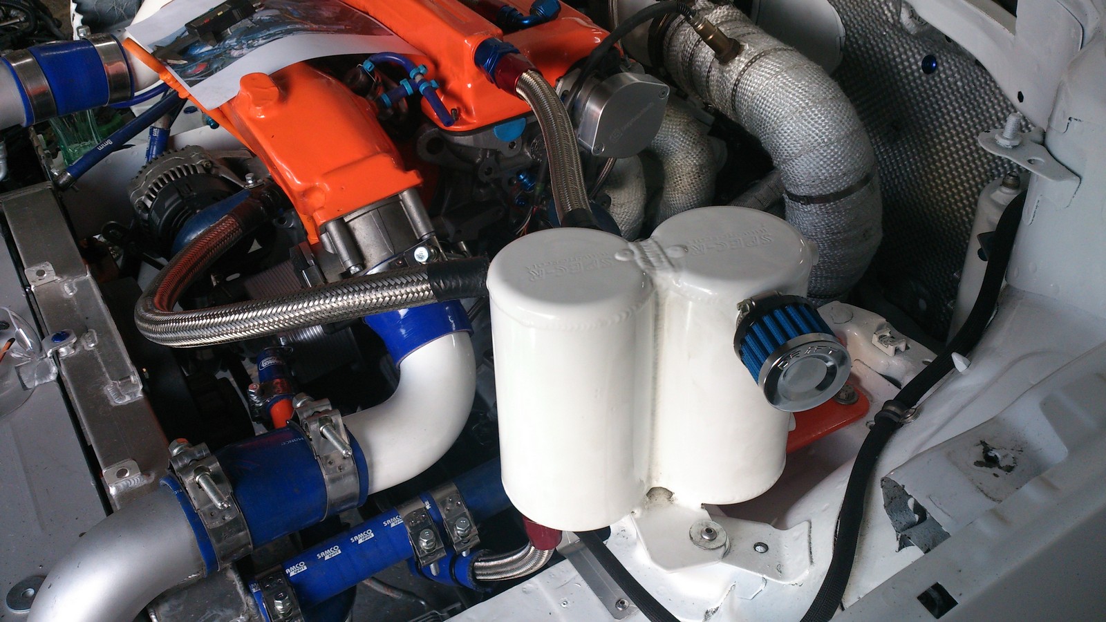

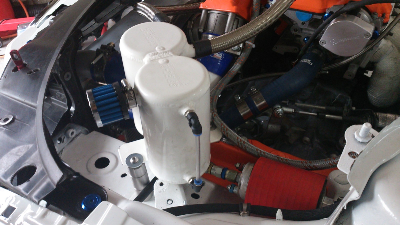

A much better looking condesate unit. I went with the white theme on ally pipes. Ally is such a pain to keep clean in an engine bay. I just have to be carefull not to scratch the white
