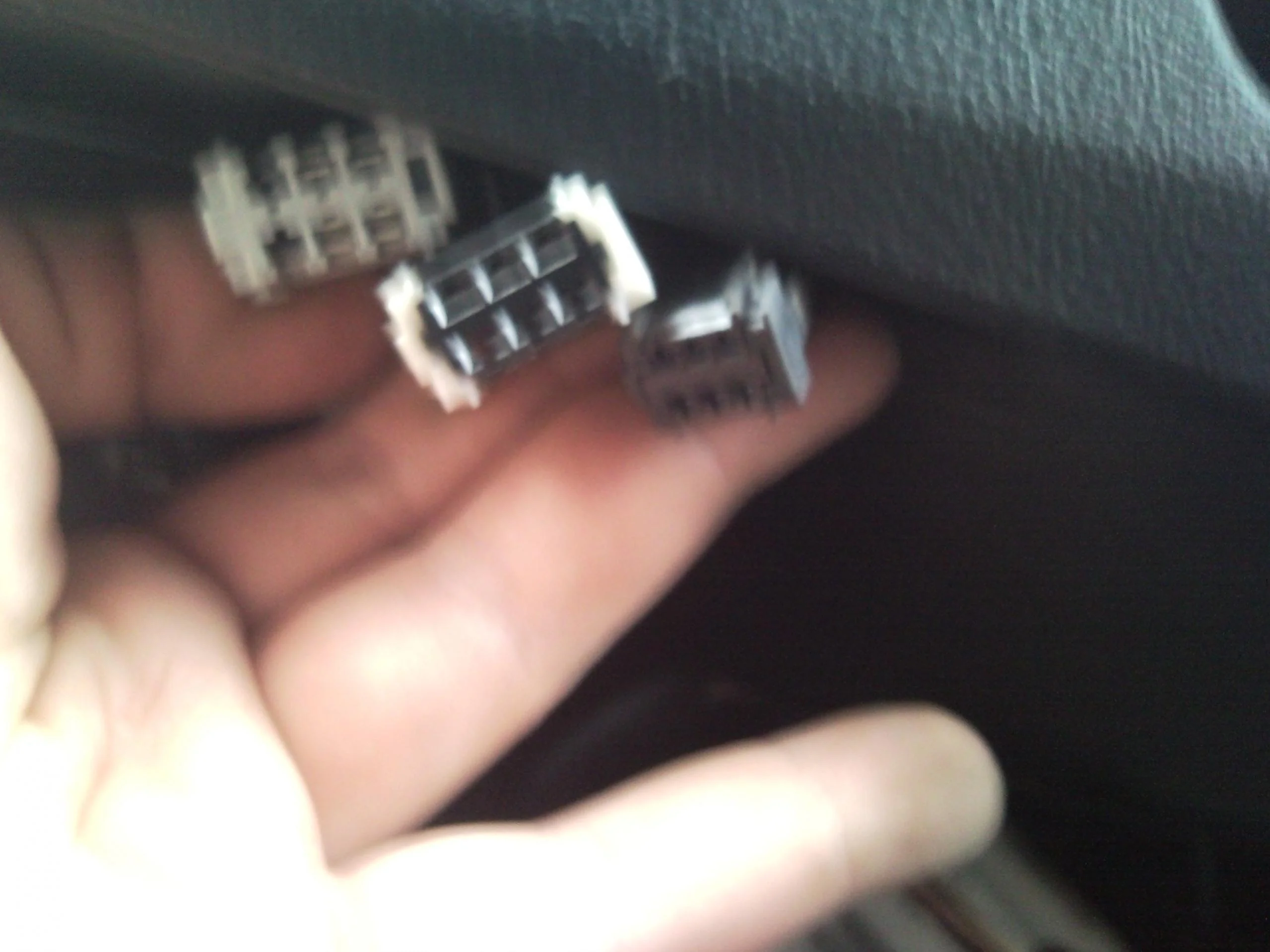

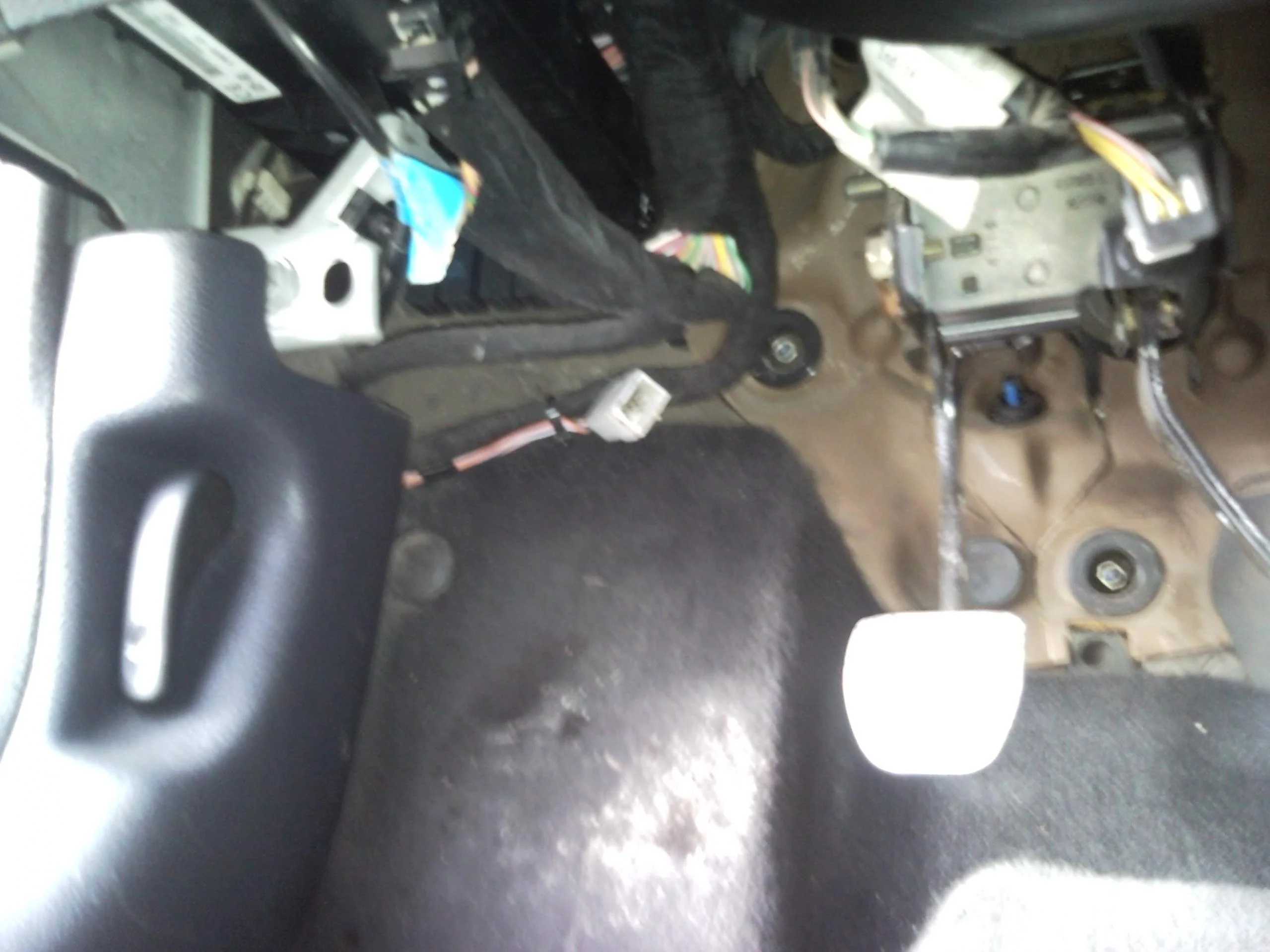

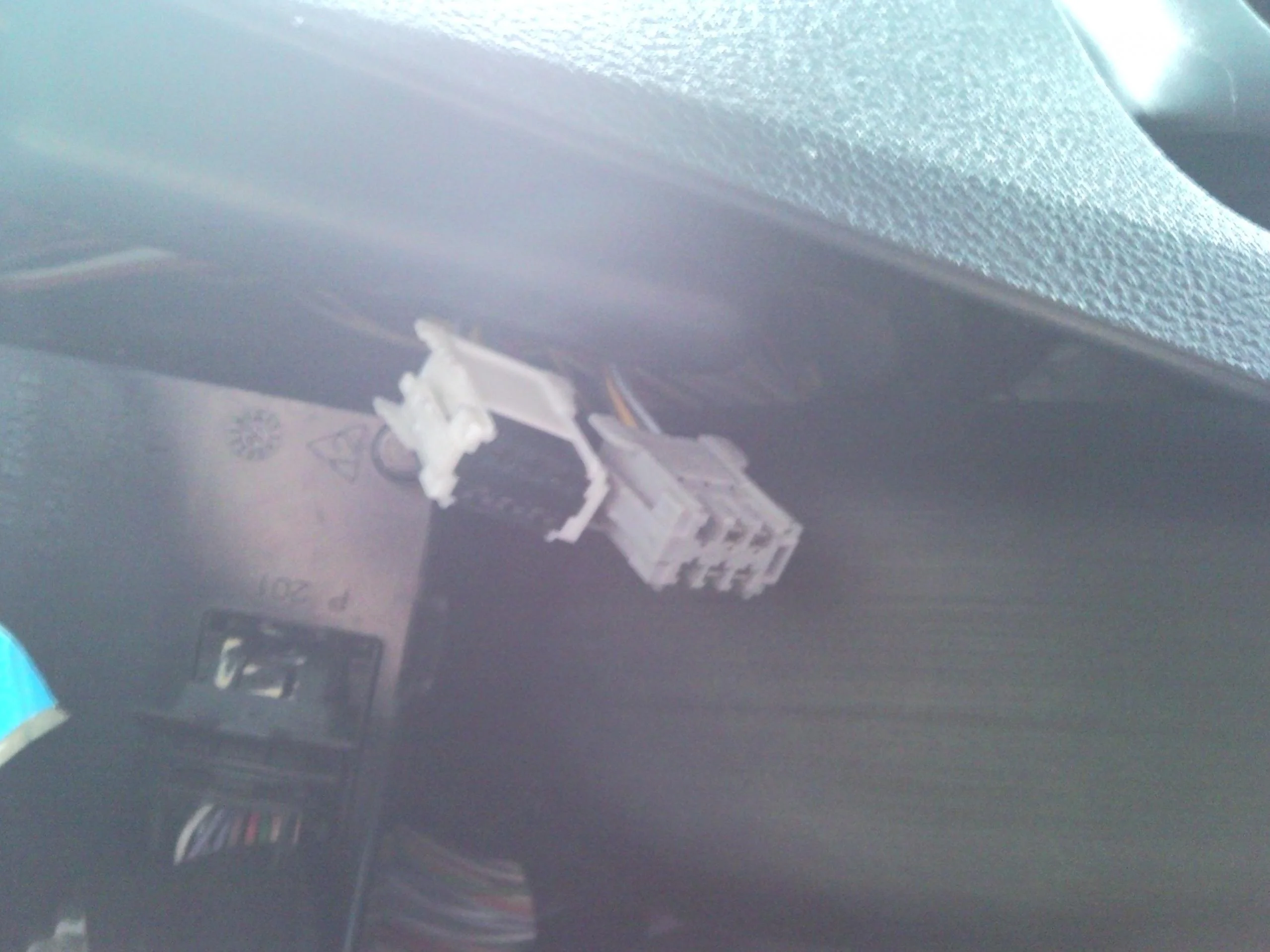

My front fog lights havent been functioning since I bought the car, although indications on the instrument panel light up normally when I switch them on. Relays on the far end of the UCH are all in place (6 of them I believe) but there are some connectors which are left unplugged, presumably by a previous owner. If anyone could help me identify those it would be great. Everything else is in fine working order except the seat heaters (both seats) so it is likely to suppose that everything should work if these connectors are connected properly.
One connector is coming out near the plastic covering the bonnet lever in the footwell, and three other connectors are located just below the cabin fusebox, or to be more precise below the tumblewheel used to adjust the dashboard light intensity. Two of of these three connectors seem to match the one in the footwell physically but they are approx one foot appart and dont seem to reach each other. Maybe a piece of loom is missing beetween these......

left hand drive car? i would check the connection behind the front bumper, they ALWAYS rust and the fogs stop working
those connectors are probably just spares
Yes left hand drive, you are correct. Thx I will check that and see if it is the problem. Are these connections hard to access, is it a bumper off job or the car may be jacked with the bumper undertray plastic removed?
I have read somewhere that the upper connectors are instalation left for the esp or whatever switches but I am curious about the footwell one shown on the first pic?
Bumper off i'm afriad. You're on your own with the heated seats as uk cars don't get them i've never seen any.
