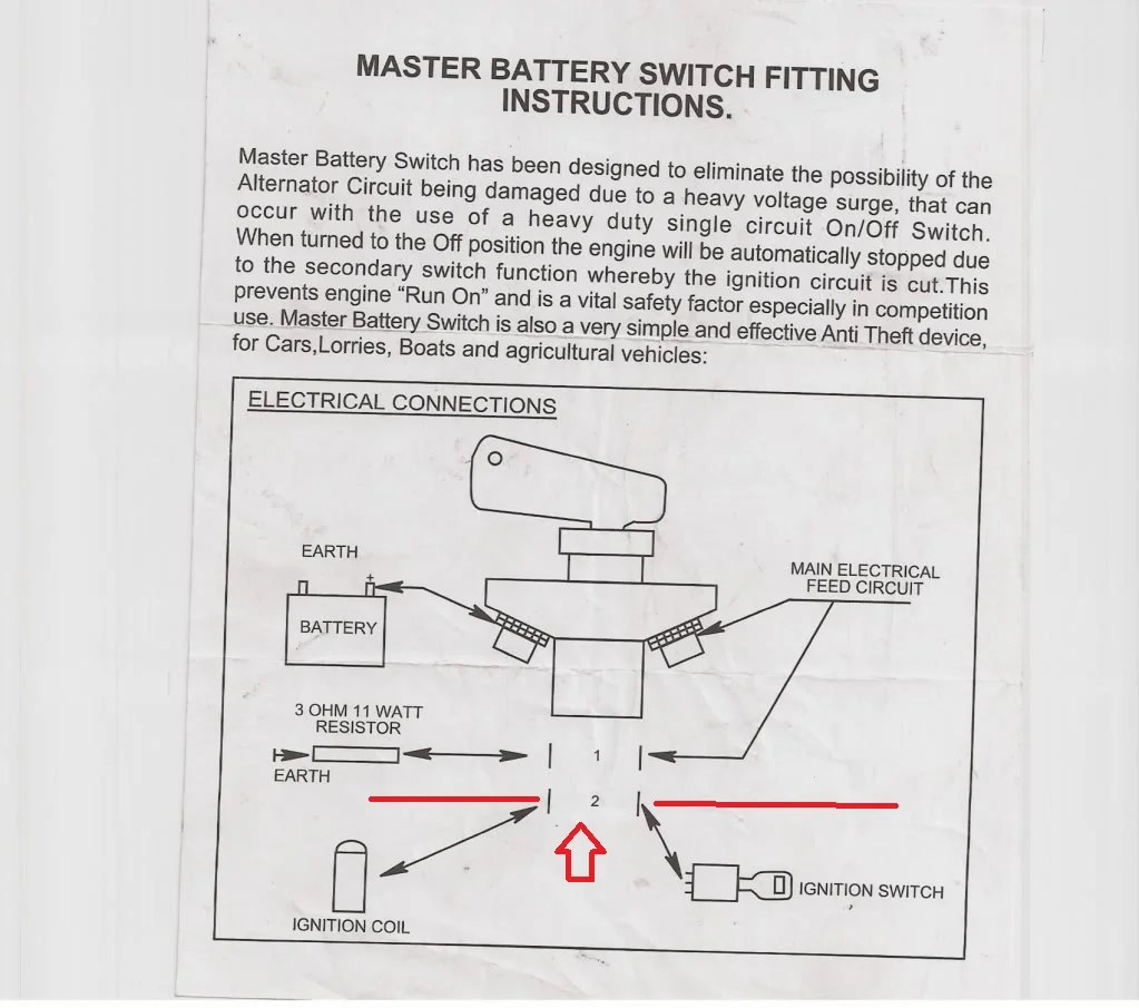

Im looking at fitting a FIA master cut of switch.
I need to locate and splice into the feed from the ignition switch to the ignition coil.
Looking at the wiring diagrams (without starting to cut wires up in the car) can someone point out what wire it is. Im guessing it could be the white wire from port 6?
I have looked at all the other wiring diagrams and cant see anything that mentions ignition coil.

So, what colour should I put the circuit breaker into to cut power to the ignition coil? Im guessing its red??

I had to cut the permanent live as my cut off was solid state and needed power even when the key was off. But your diagram in post 1 suggests you need to cut between the switch and the coil which would be the yellow wire.

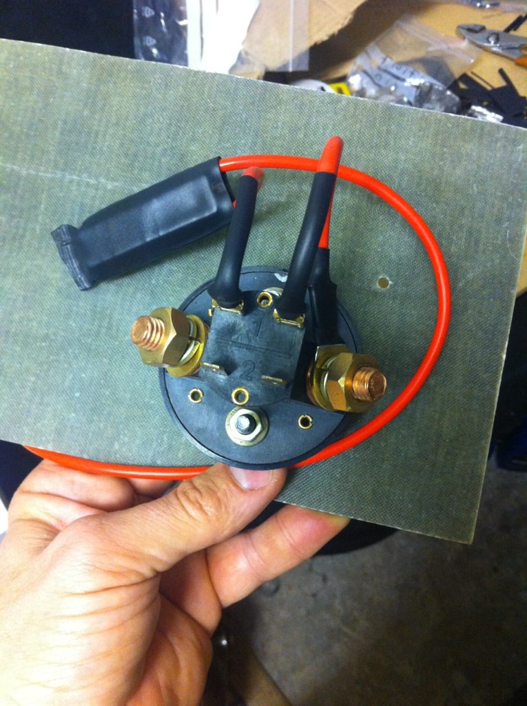

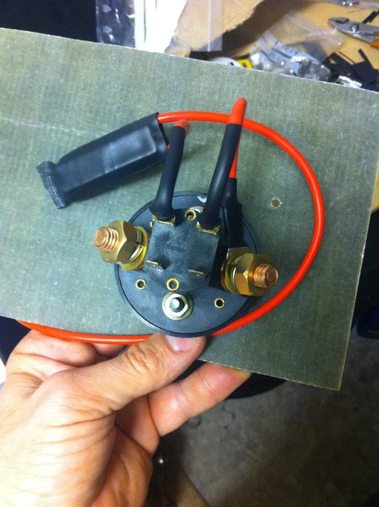

I've got a cartek solid state. I'm still unsure what one I need to go into it. What did you use to attach it/splice into it? I'm so useless at wiring and this is e most ill ever do lol
The bottom two pins attach to the feed from ignition to coil, i will just cut, attach wire with heat shrink and put some crimps on the other end slotting them on the pins.
Solid state im guessing will be different
I had an after market alarm on the car that I ripped put. I guessing it will go to the same wire as that did.
