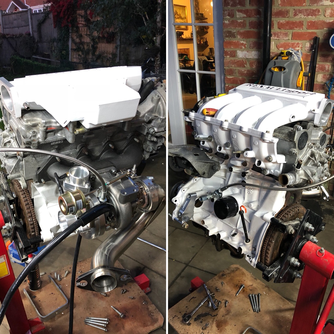

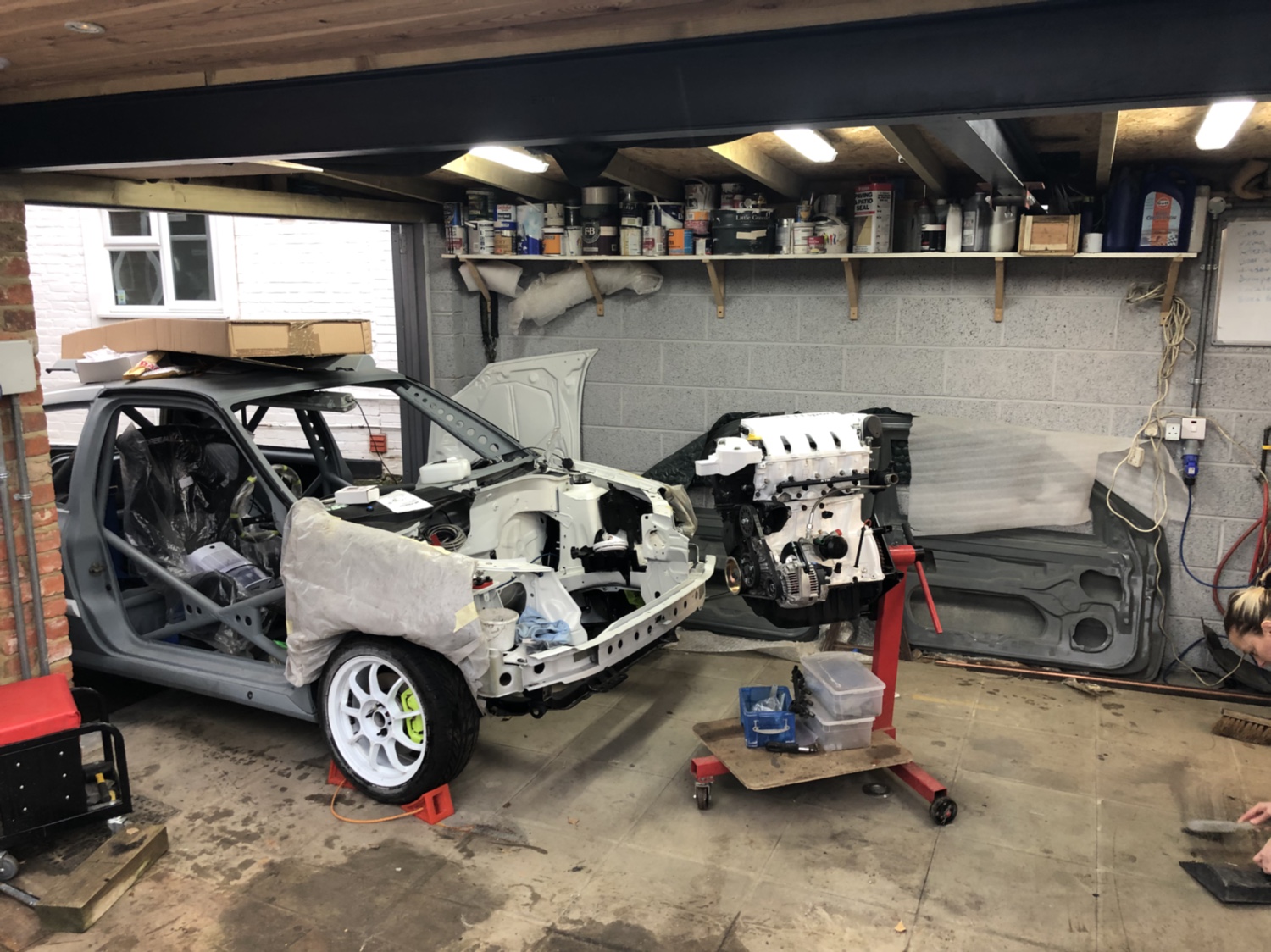

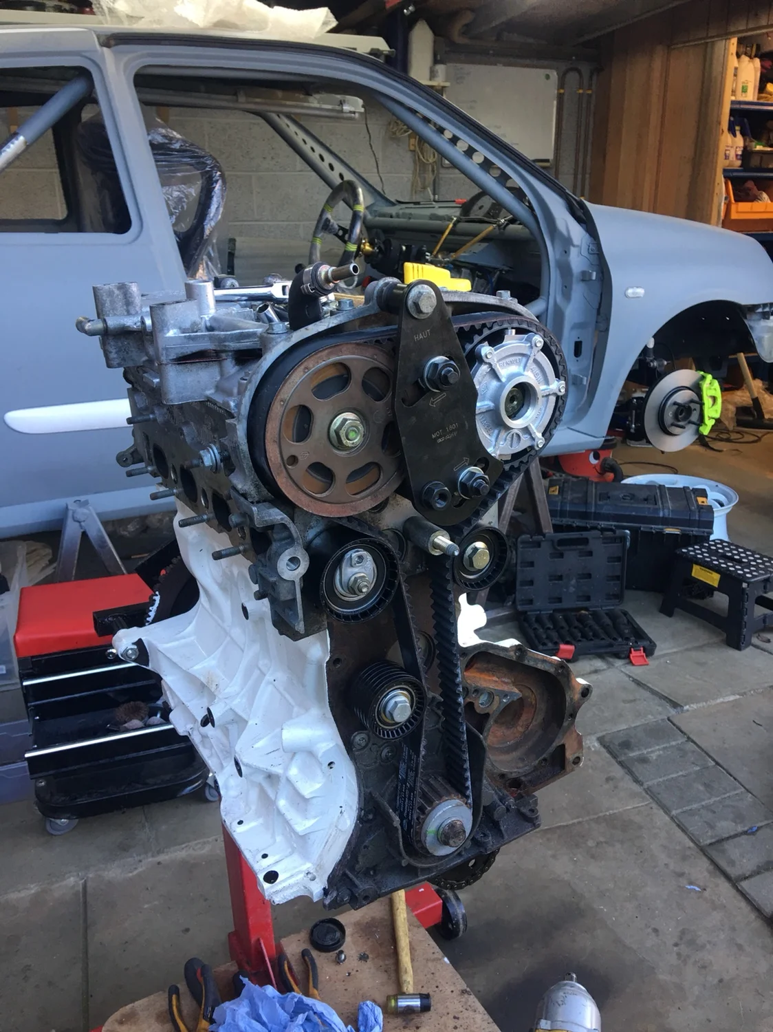

Been working on the engine mainly.
Dephaser and belt changed.
Also painted the engine white [emoji4]
Fitted ARP bolts while at it.

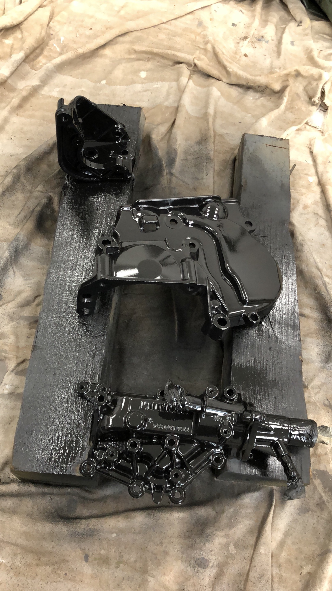

And cleaned/pained most brackets/housing/covers

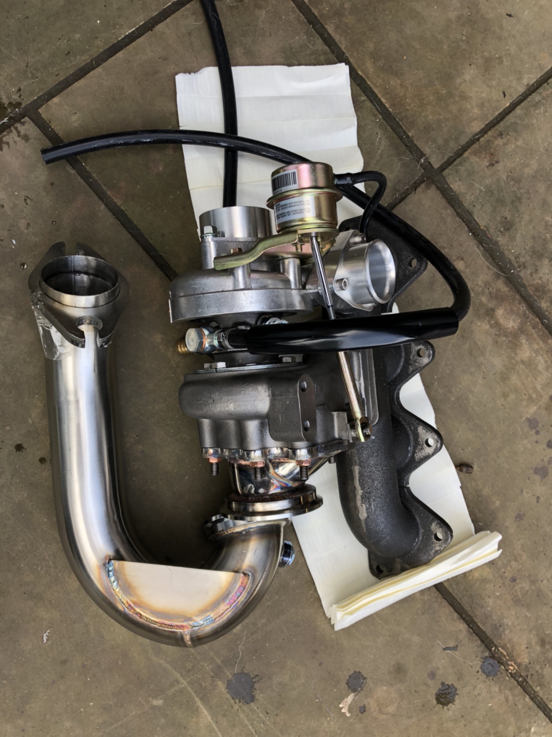

Started fitting the turbo etc.

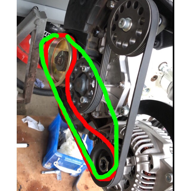

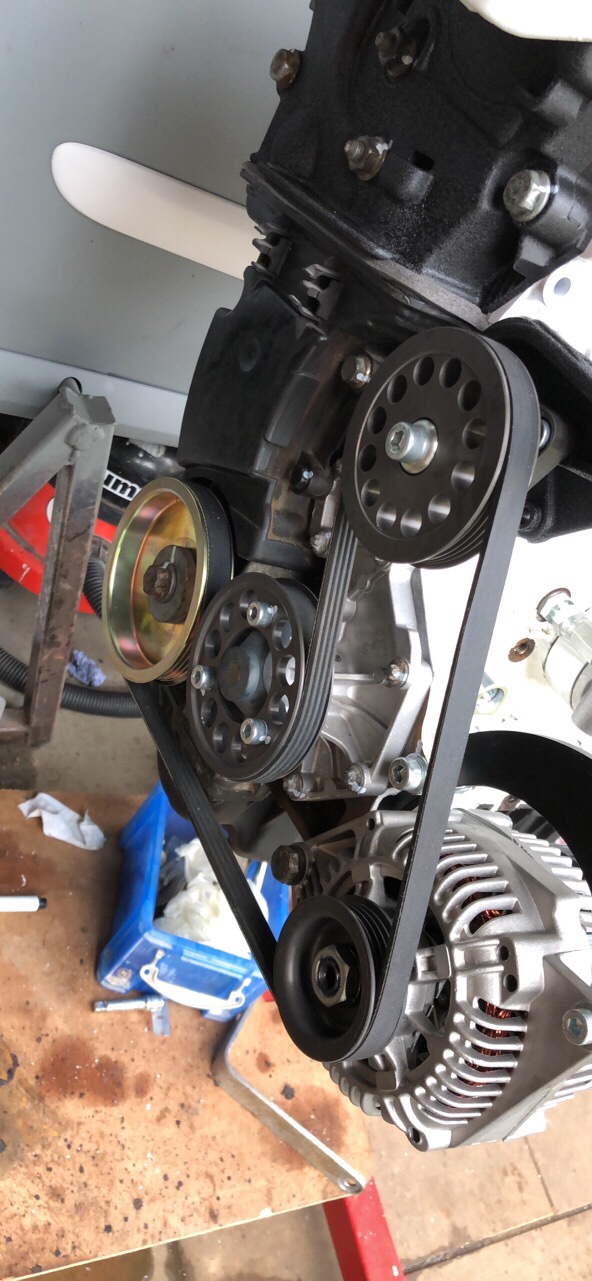

Also new alternator arrived so fitted the PMS 4rib belt and pulleys. And new water pump for good measure.

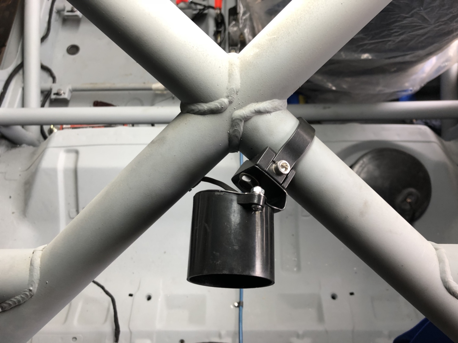

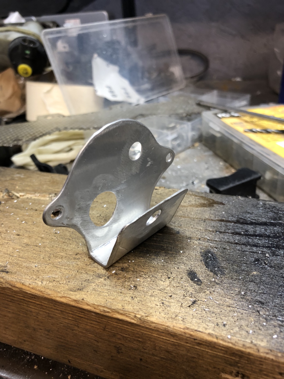

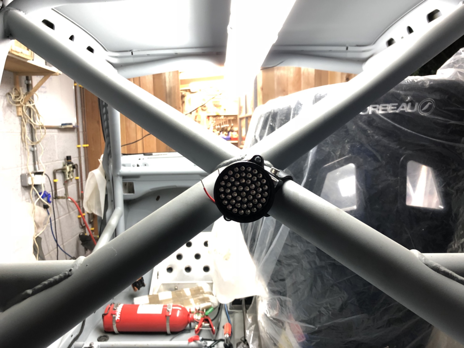

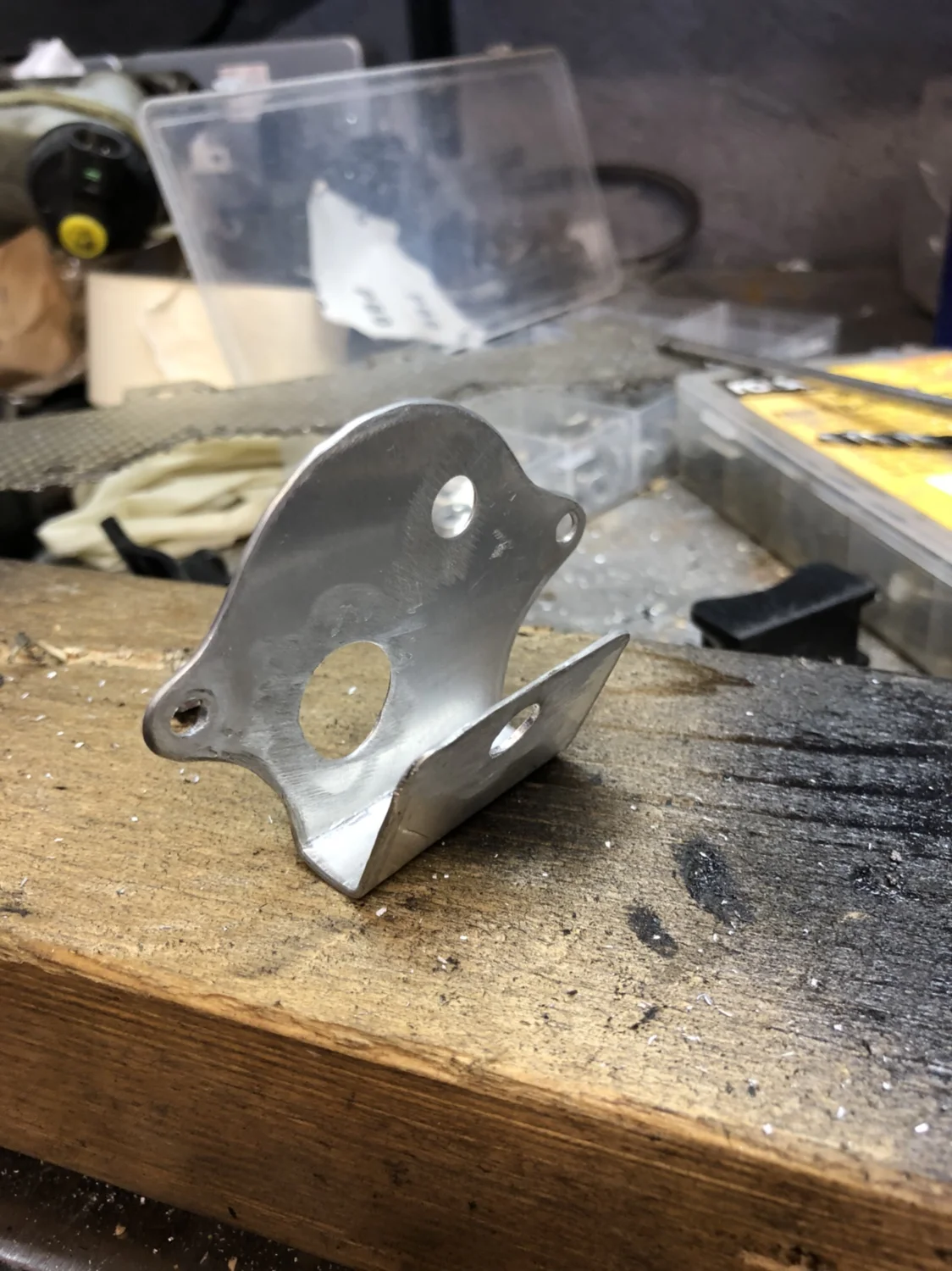

Made a little bracket for the rain light. Going to use it as third brake light for the time being.

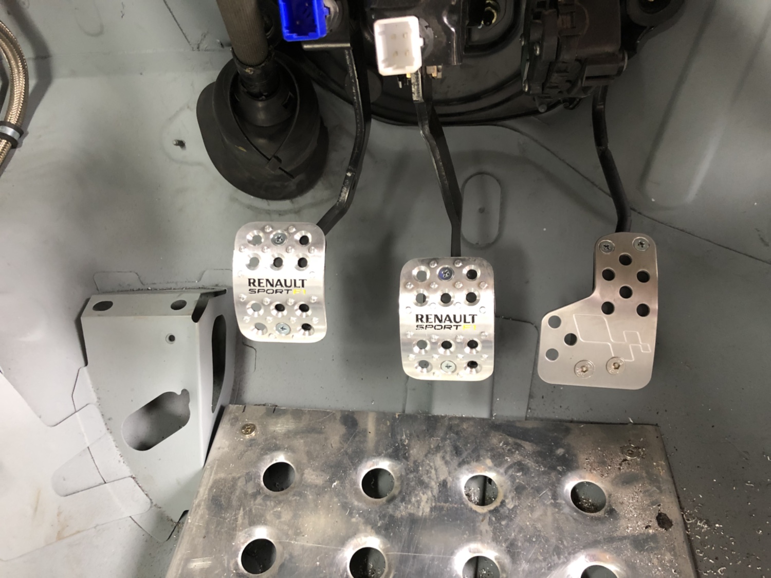

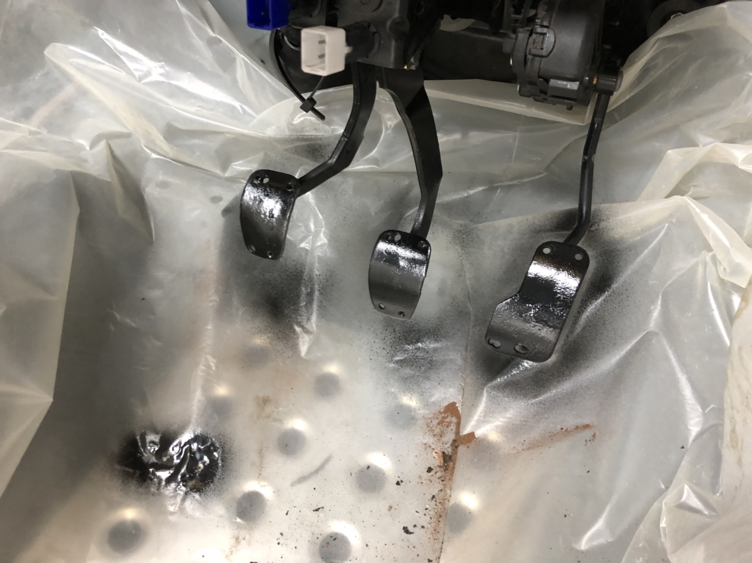

Also refreshed the pedals with heel’n’tow accelerator

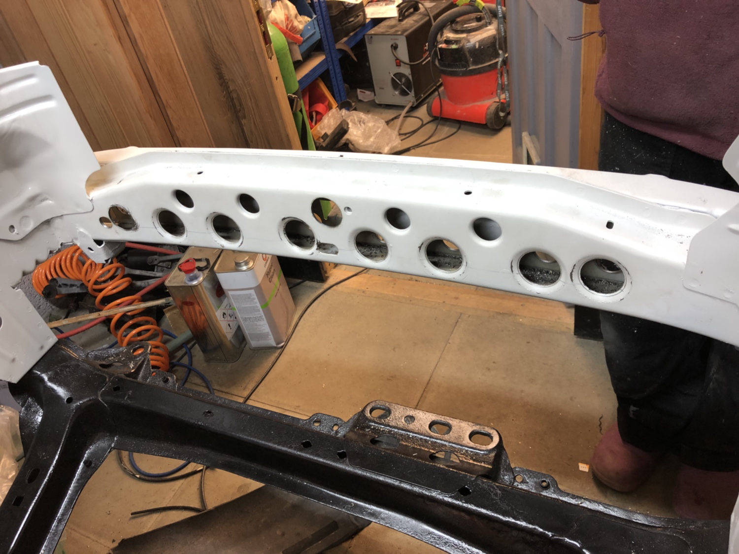

Oh and been making Swiss cheese :)

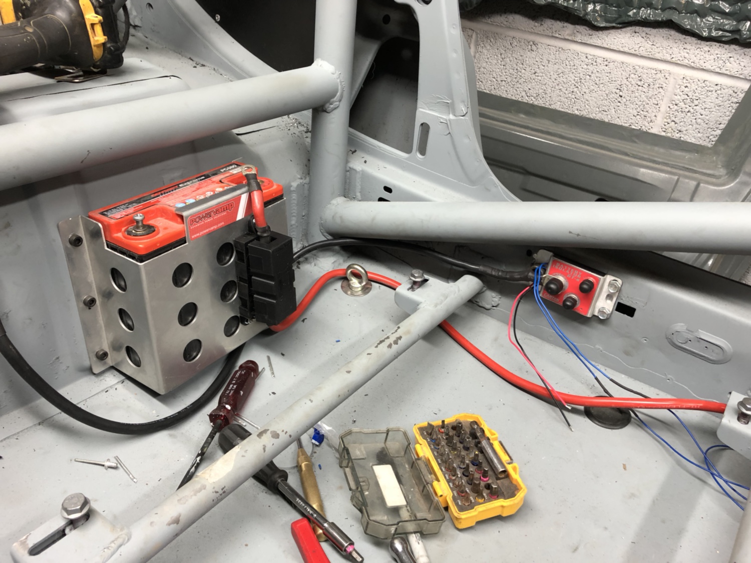

And started on the electrical systems.

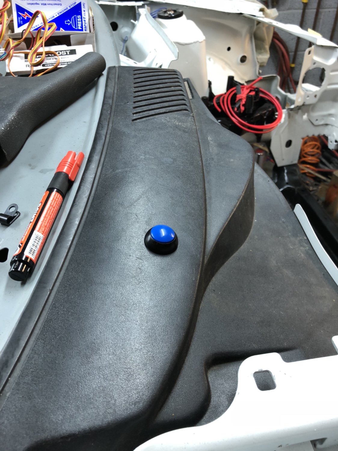

Cartek GT switch attached. Wires routed, external button in place.

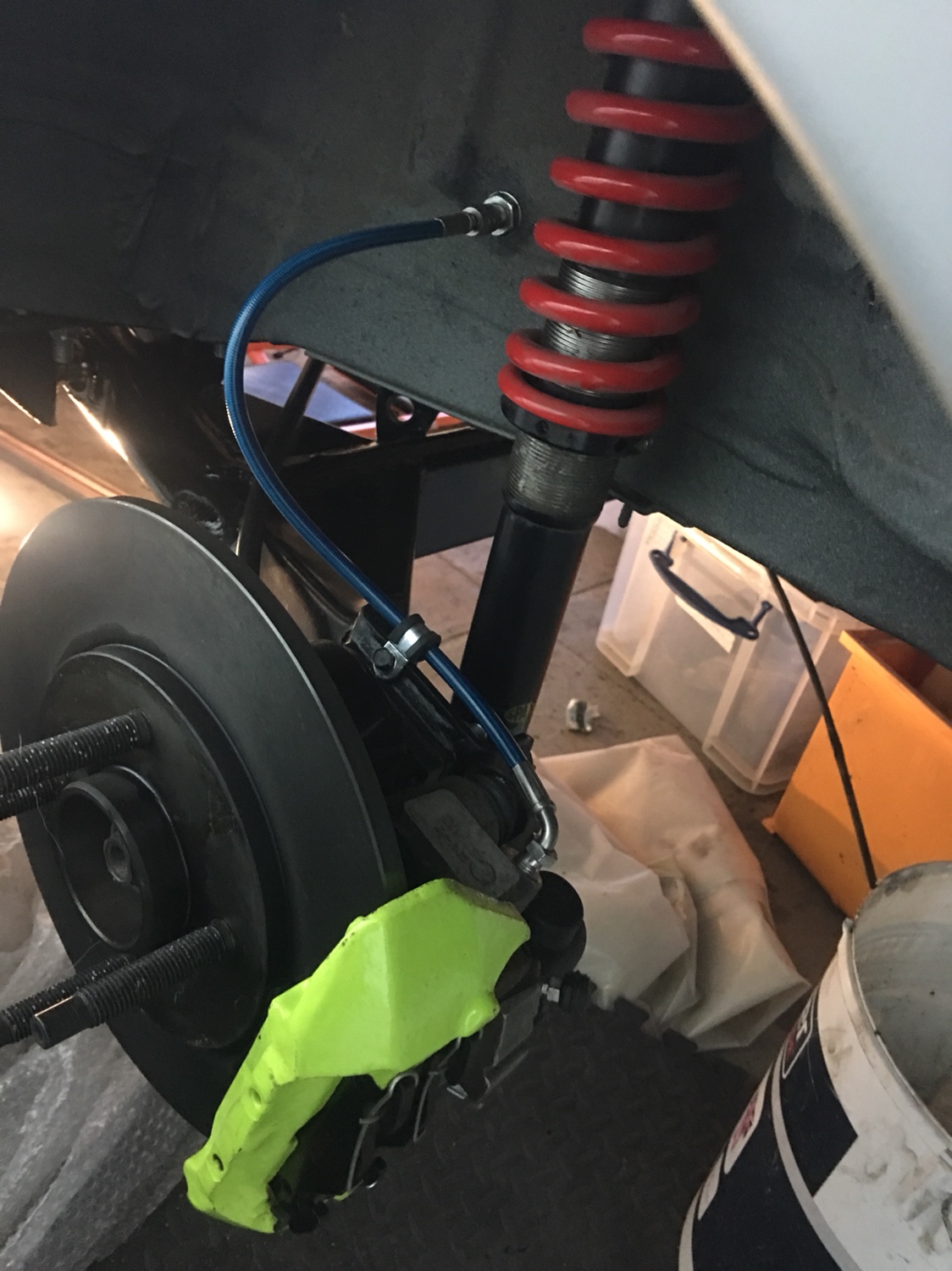

Also new handbrake cables fitted and secured brake lines to hub

bin the pas idler and bracket and just run a shorter belt.
Honestly thought about it, but figured belt won’t wrap around water pump much. Decided this was a better solution.

Have you tried a wheel on with the brake line like that? I went to fit mine like that but it's so close to the wheel

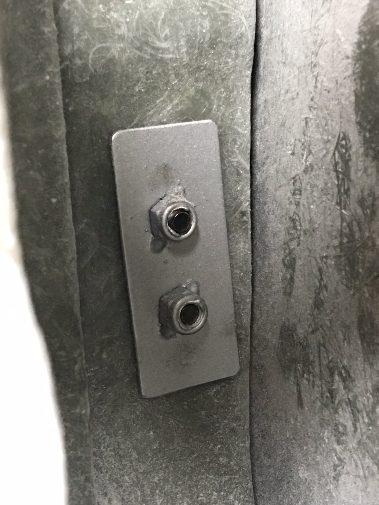

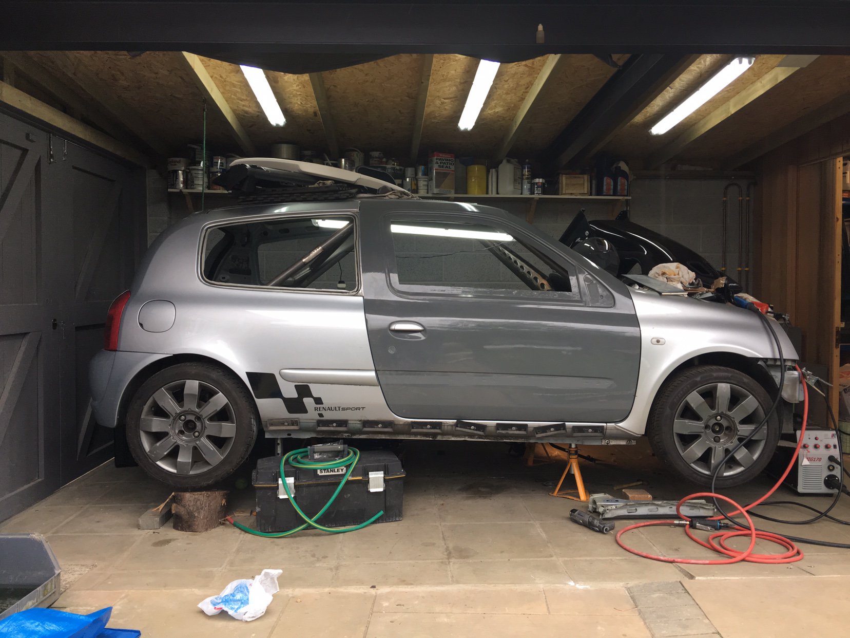

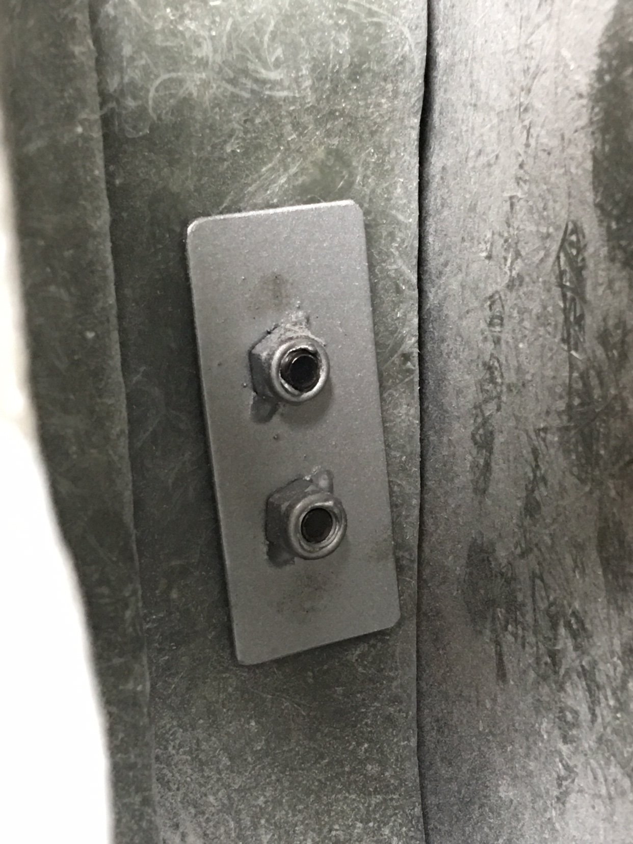

And finally fitted the fibreglass door(s) Made a little beaker to go on the inside to spread the load. View attachment 1333361View attachment 1333362
Hiya mate, looks like a great build, also looks like we are at very similar points of build (although yours has come through the process a lot quicker).
I am just about to hang my doors using the same method, I see you have captive nuts on the spreader plate inside the door,
Did you drill holes through the hinge and do you have the bolt heads on the hinge side? I didn't think there would be room
RuskiWeldFab
  Clio 172, RS4 B7
I thought this may have been the approach and I guess probably gives a better approach to adjustability, cheers
Yep. That’s one of the reasons. To tighten them from the inside would be hard if you threaded holes on hinge itself. Plus would need to cut bolts to size. This was way cleaner option.

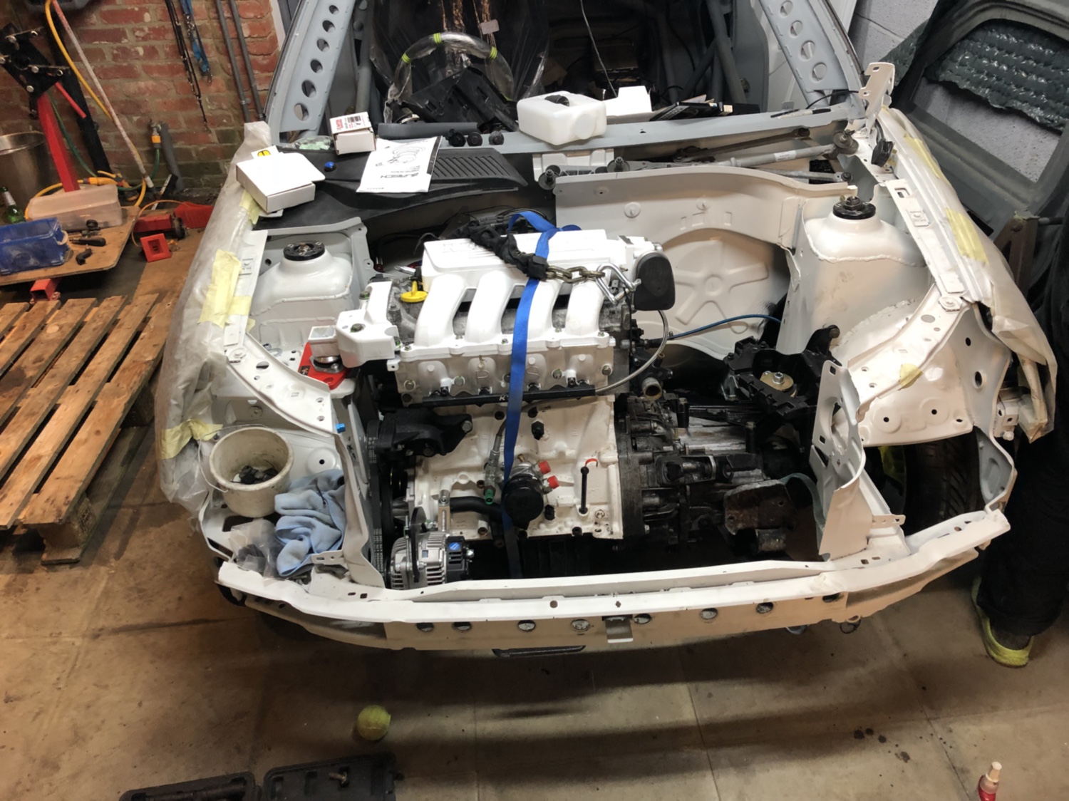

03/2018
Alright Guys it’s been way way too long!
Between waiting on some parts, exceptionally warm weather [emoji23], little bit of snow, few holidays and a festive season, nothing has been done on the car since beginning of December.
Yeasterday was the day when next stage of the build has began!
The “marriage”
Massive thanks to @NorthloopCup for rebuilding and fitting LSD to my gearbox! And helpful tips along the way [emoji6]
Next on list: all the engine plumbing and electrics...

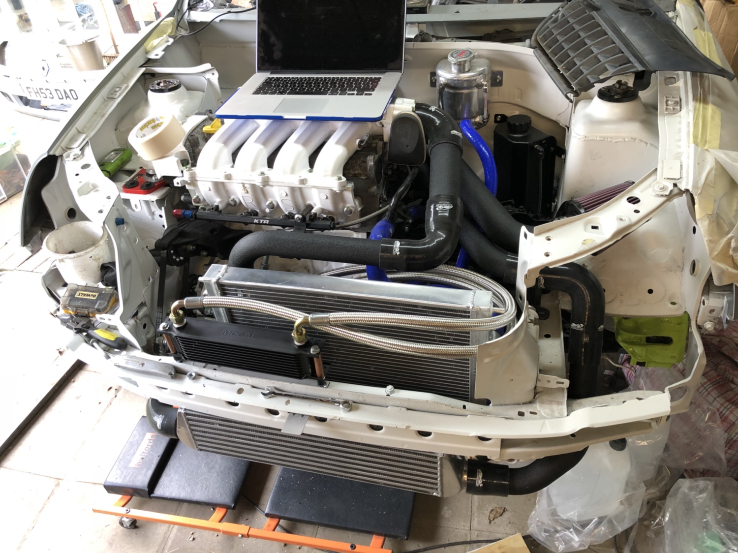

May 2018
It’s been rather slow progress on the car lately but progress nevertheless.

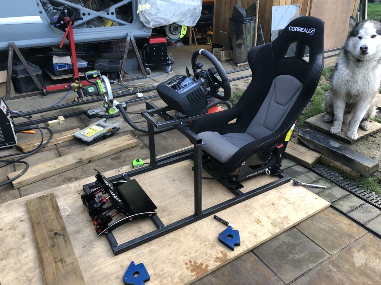

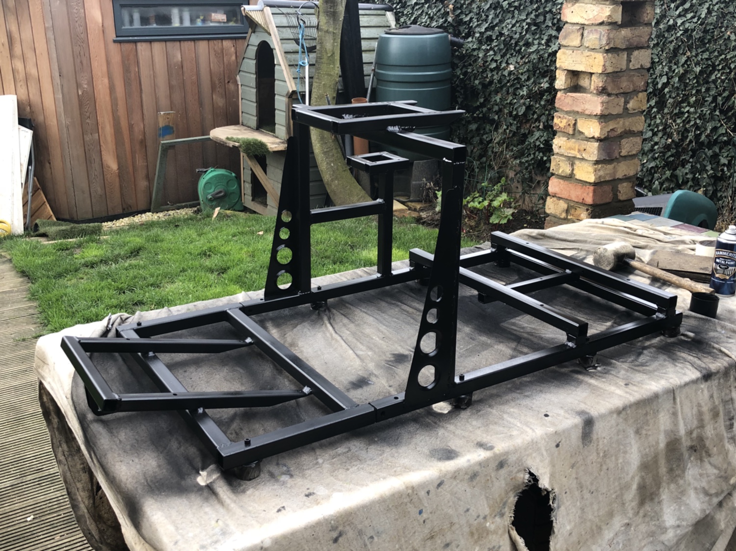

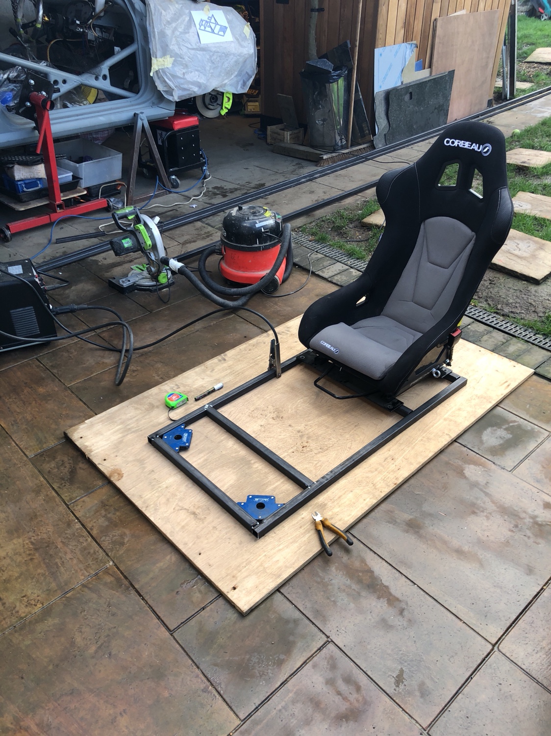

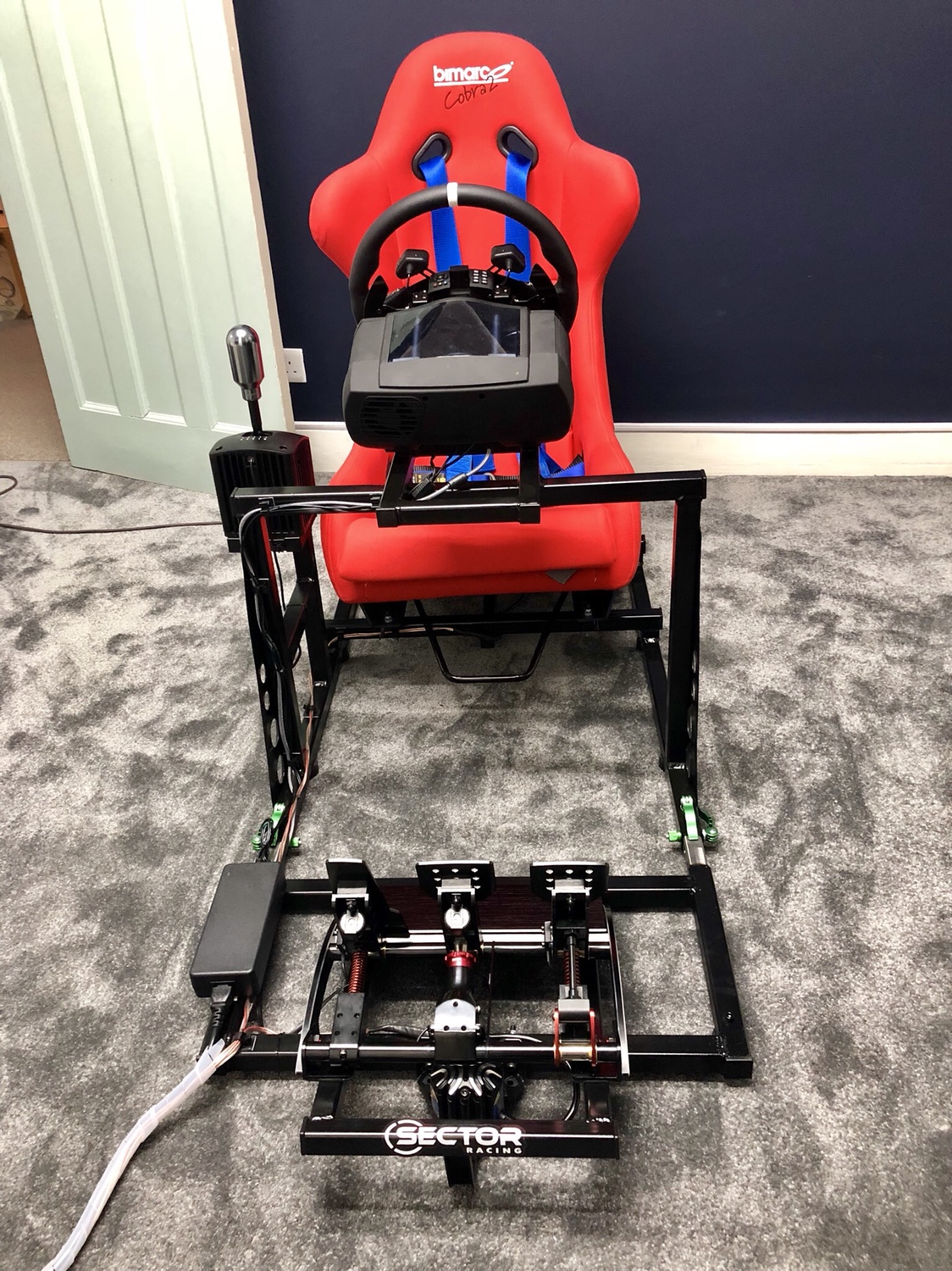

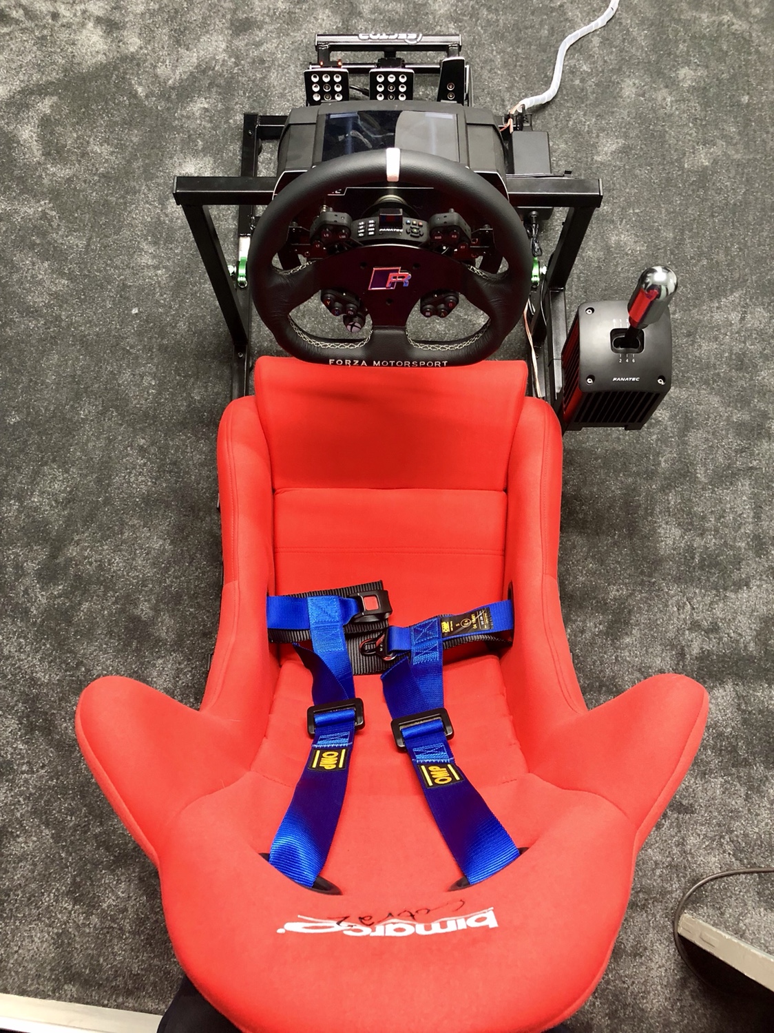

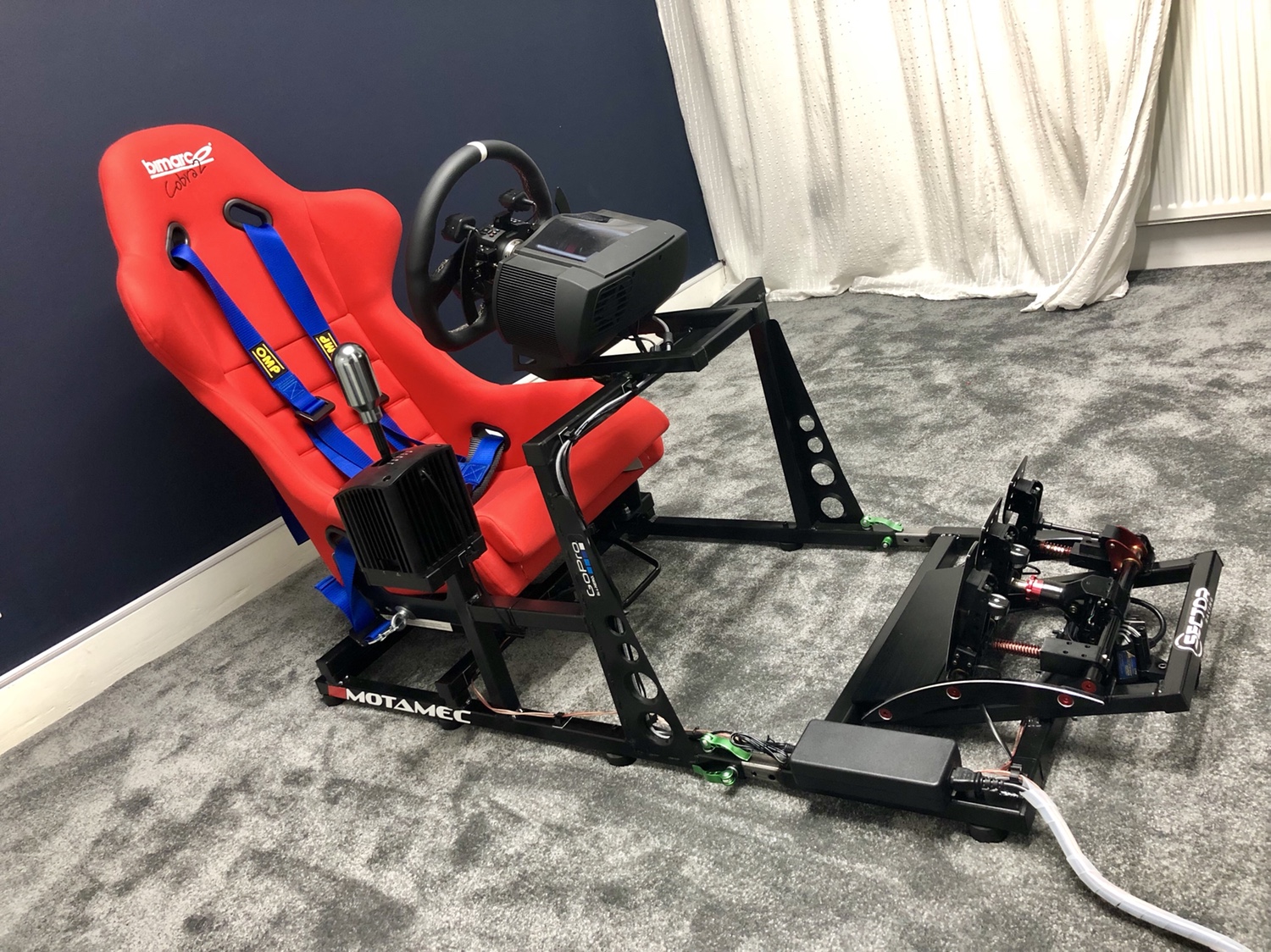

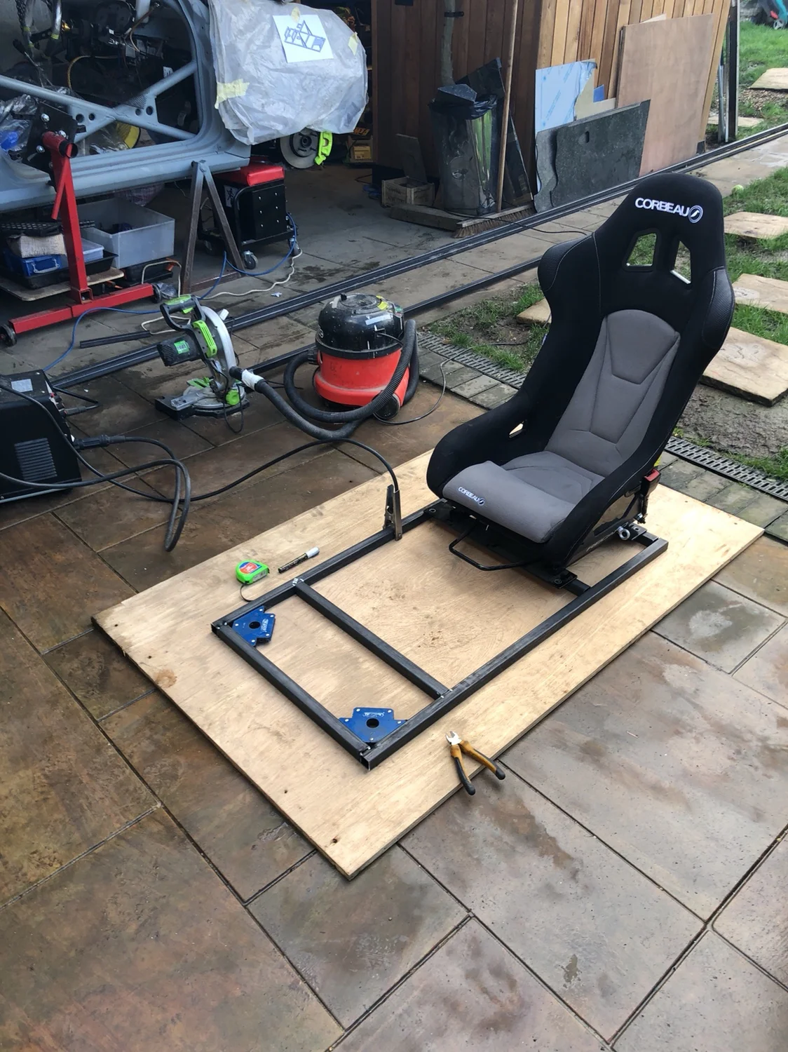

Partly because it was cold brrr and partly because I got distracted haha and built this [emoji41][emoji56][emoji28]
Now that days are longer and Warmer, time to progress with the Clio

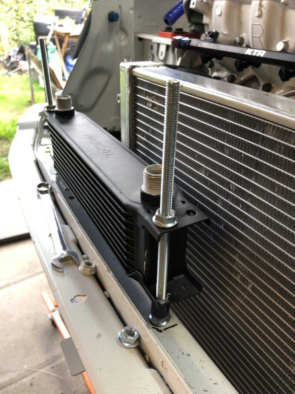

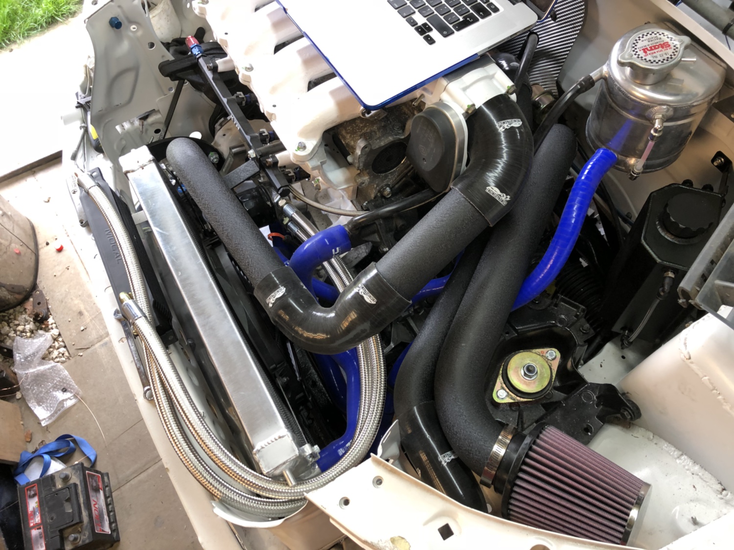

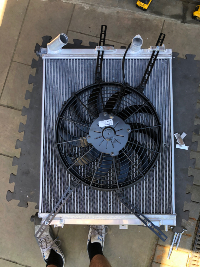

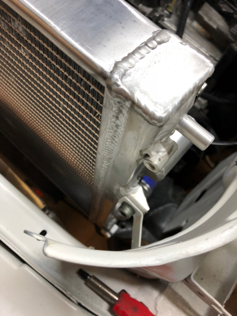

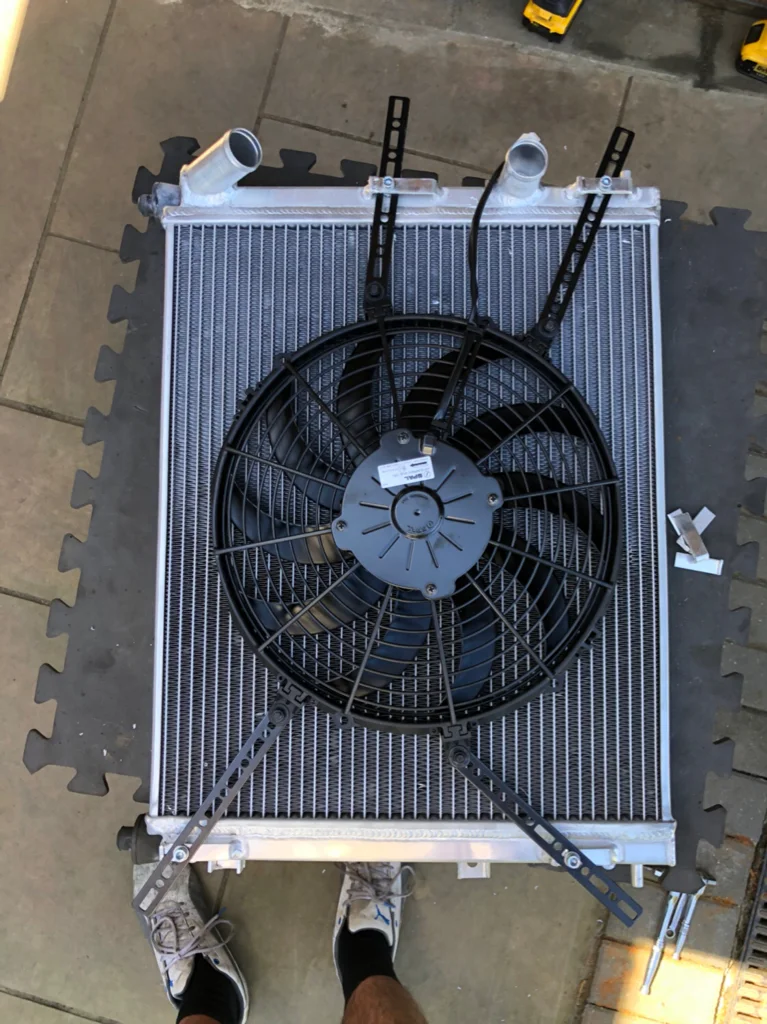

10inch radiator fan fitted. Stock one was too thick.

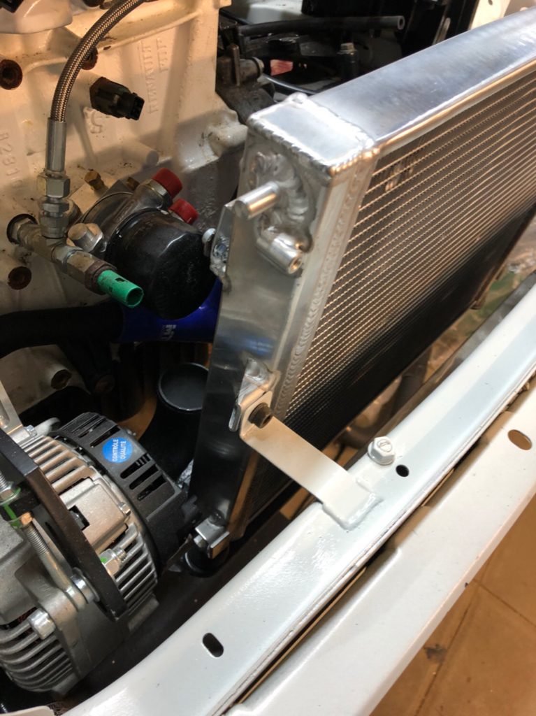

radiator fitted and some brackets fabricated. Nice and solid.

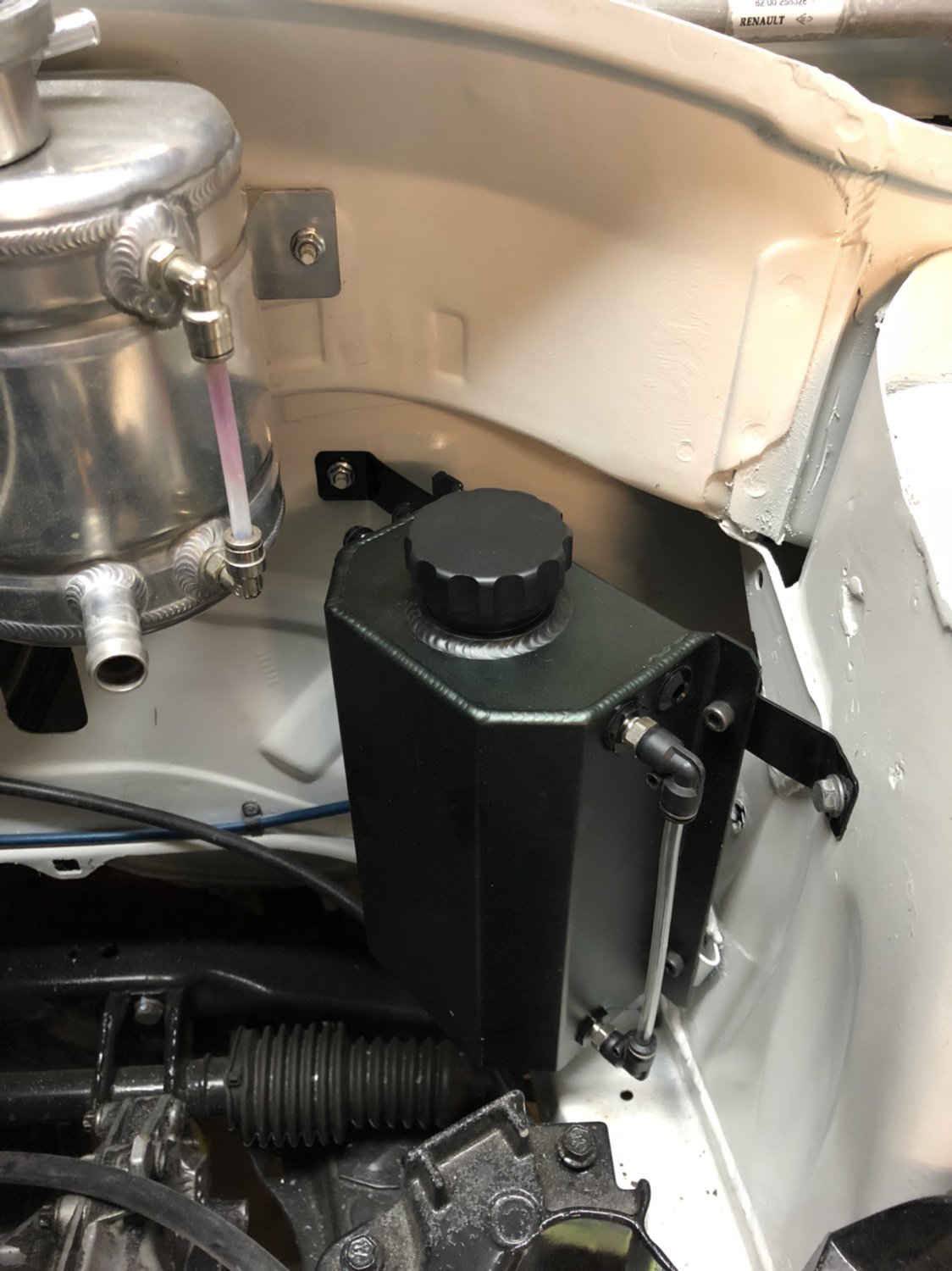

Made a bracket for 2L catch can.

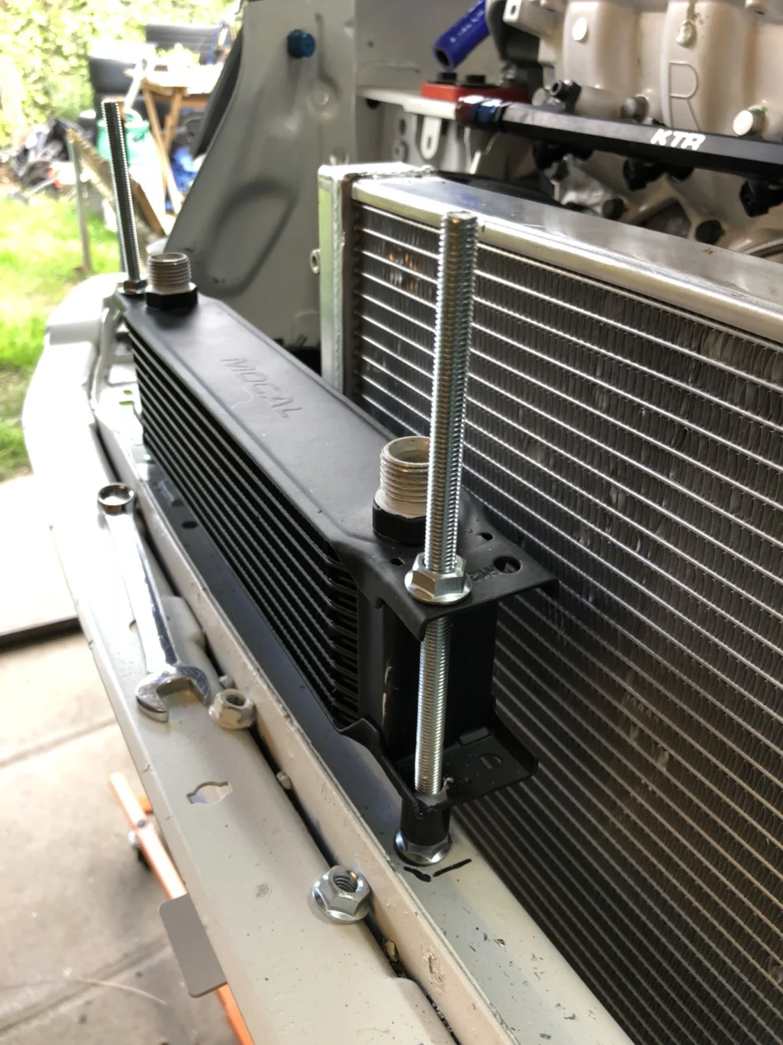

Next was oil cooler.
and intercooler + all the pipe work trial fitted.

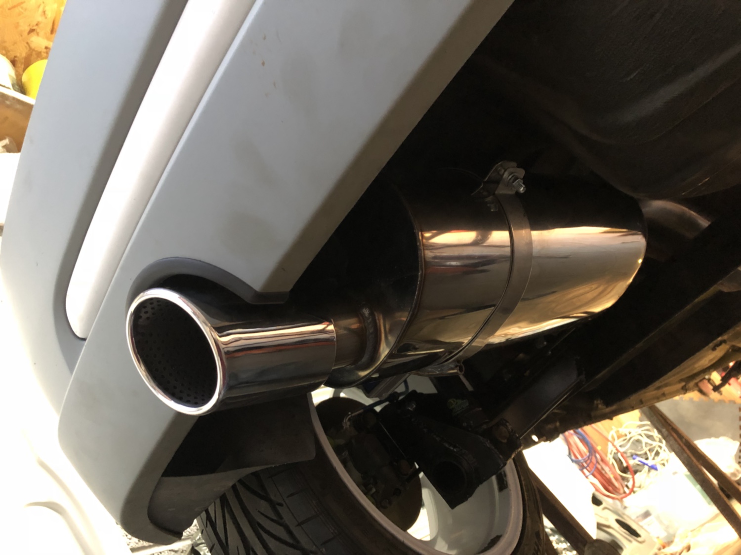

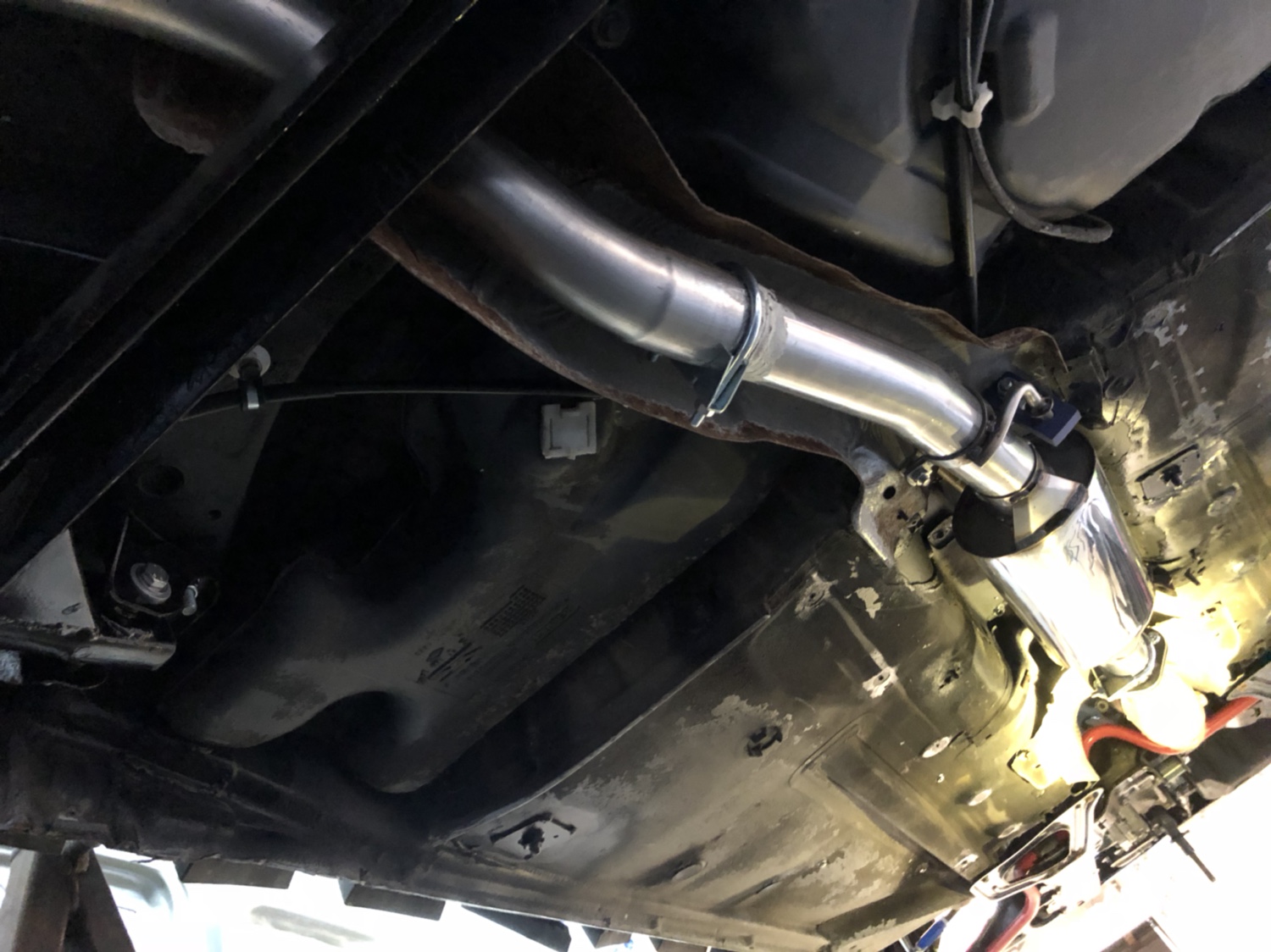

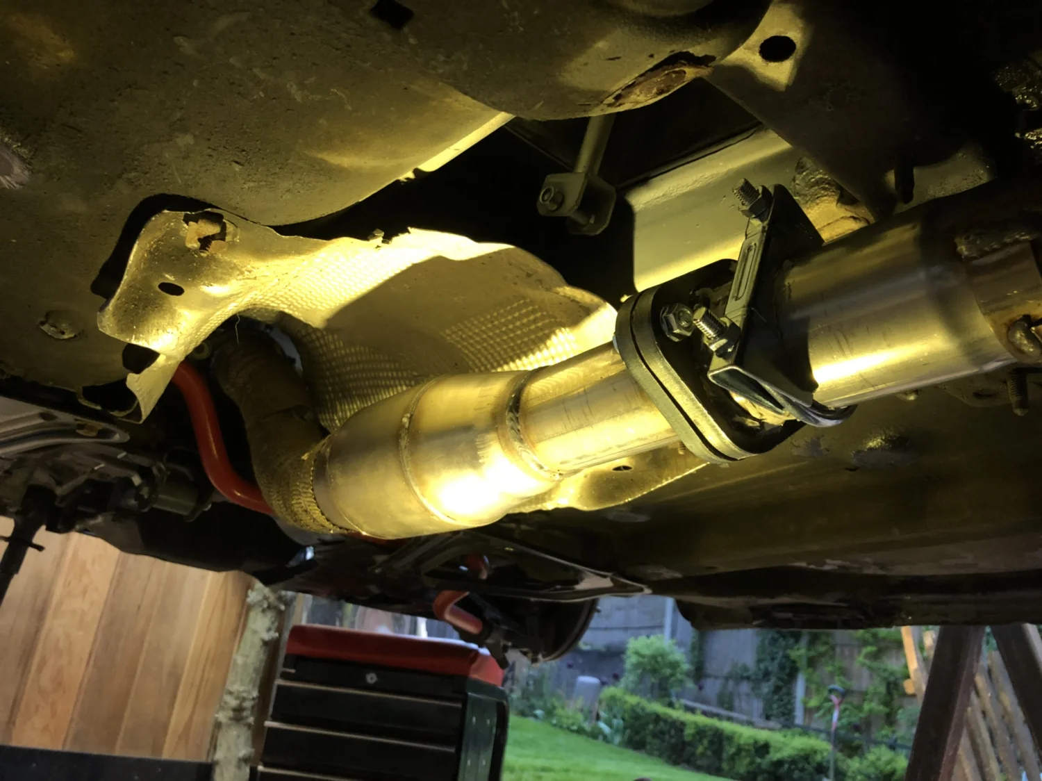

Also exhaust fitted, cut the bumper for the tip surround
Next trial fit the wiring, all the fluids and try start this b**ch up!

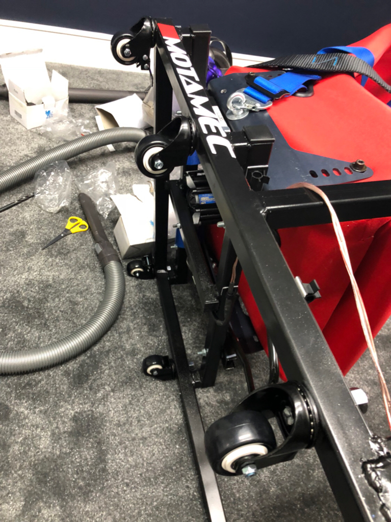

Nice one with the sim rig. I made mine out of PVC pipe, i bet that's bloody heavy being made out of box steel section. This is mine...
Are you running a sports cat ? If so, how comes ?
Yes it’s heavy :) but made it in 2 sections + has wheels now so no big deal
Sports cat because it has to be road legal MOT and all that, can’t be bothered with “friendly Mot” +on a turbo will make nearly no difference with or with out unless you are maxing out the BHP. I am going for 230-240.
