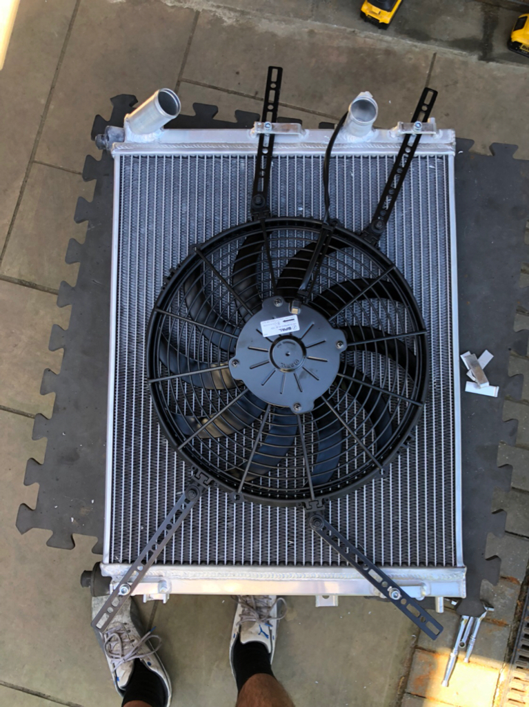

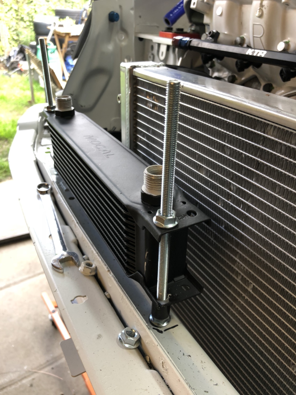

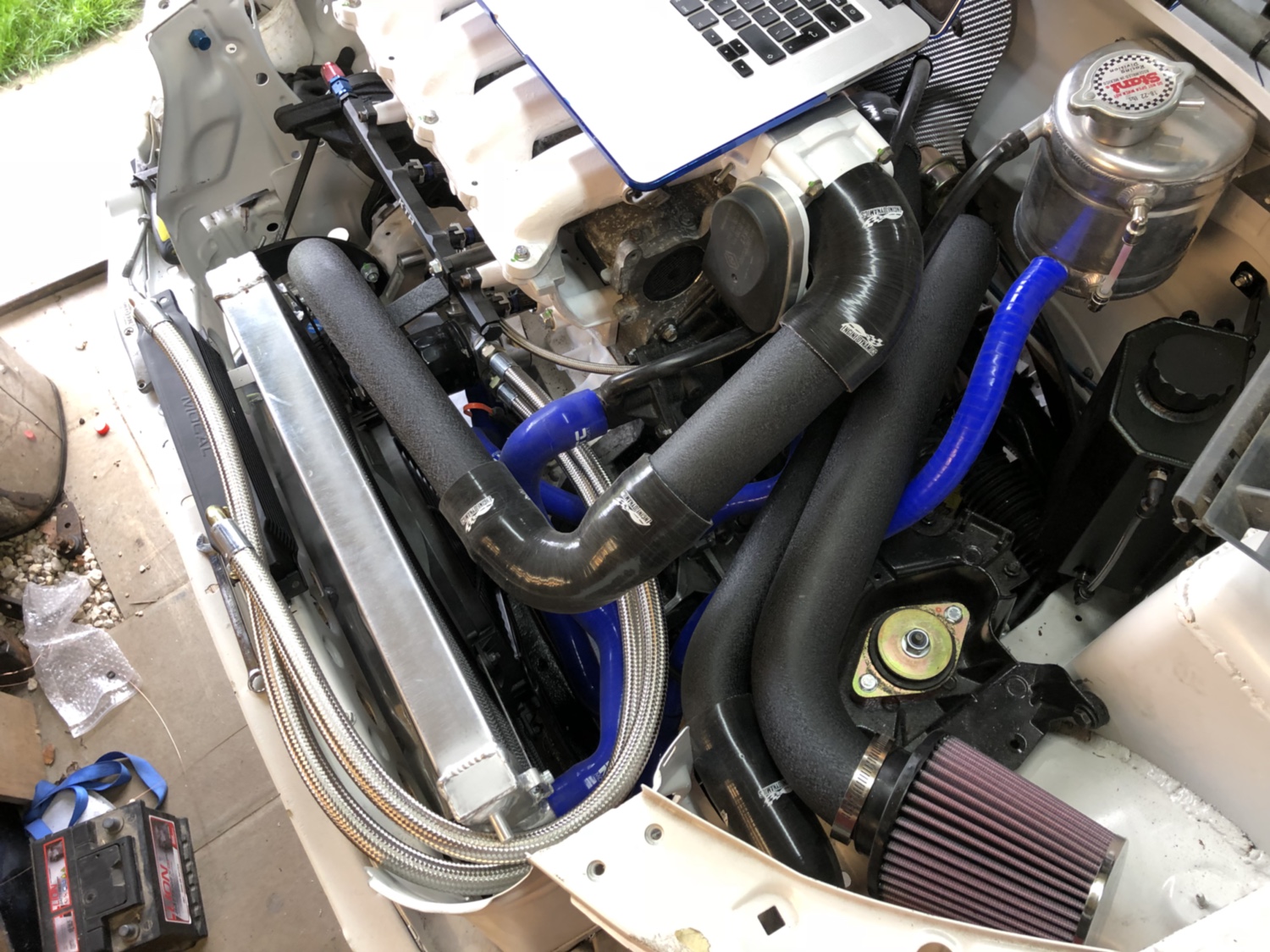

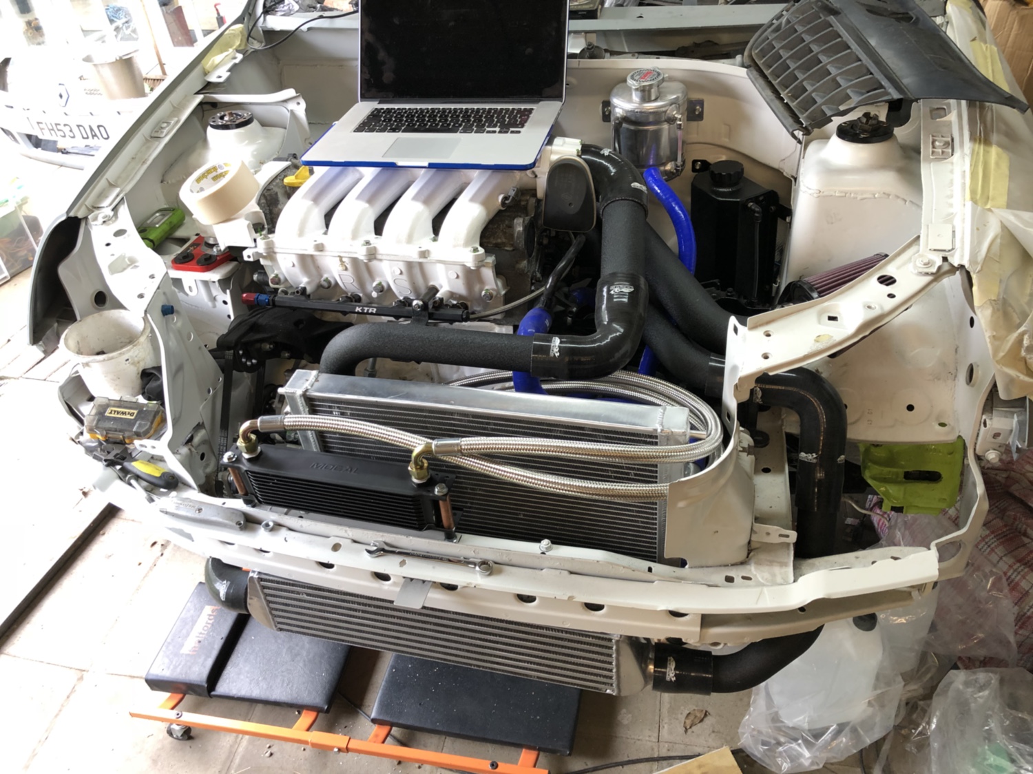

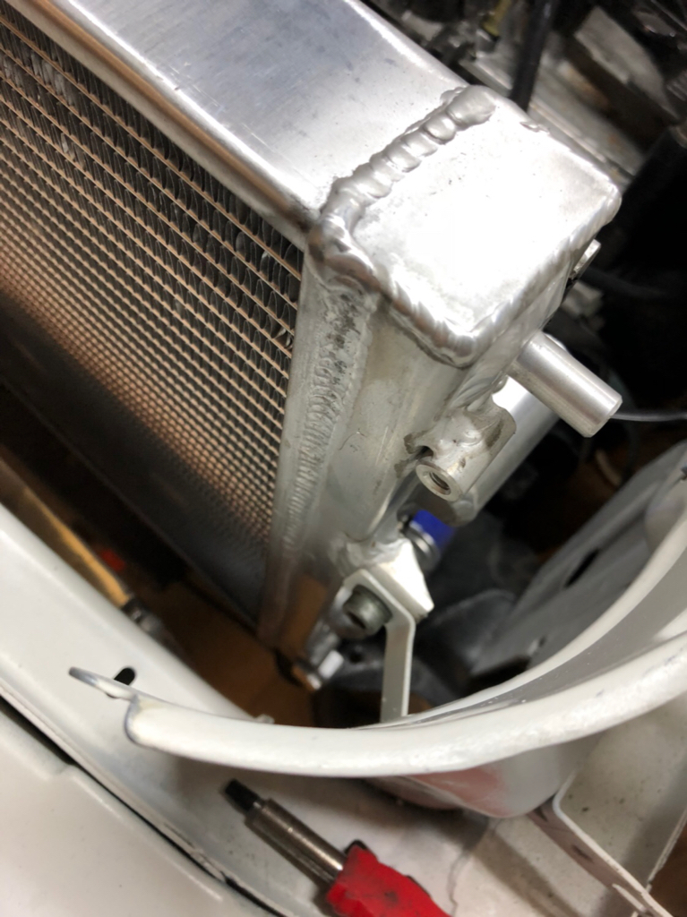

10inch radiator fan fitted. Stock one was too thick.

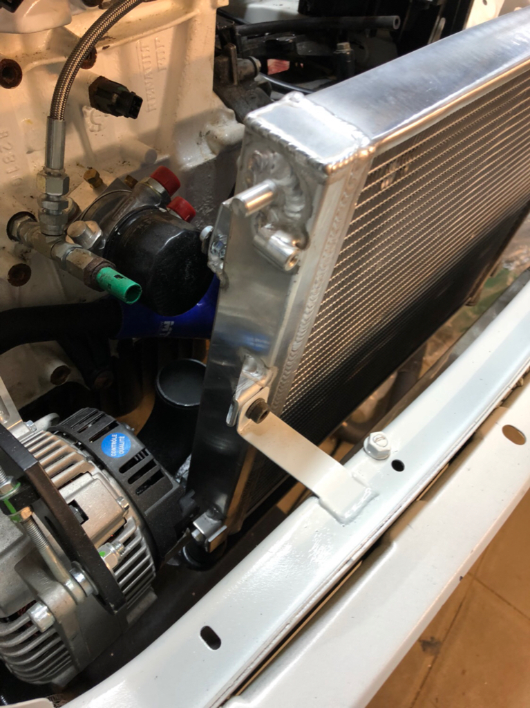

radiator fitted and some brackets fabricated. Nice and solid.

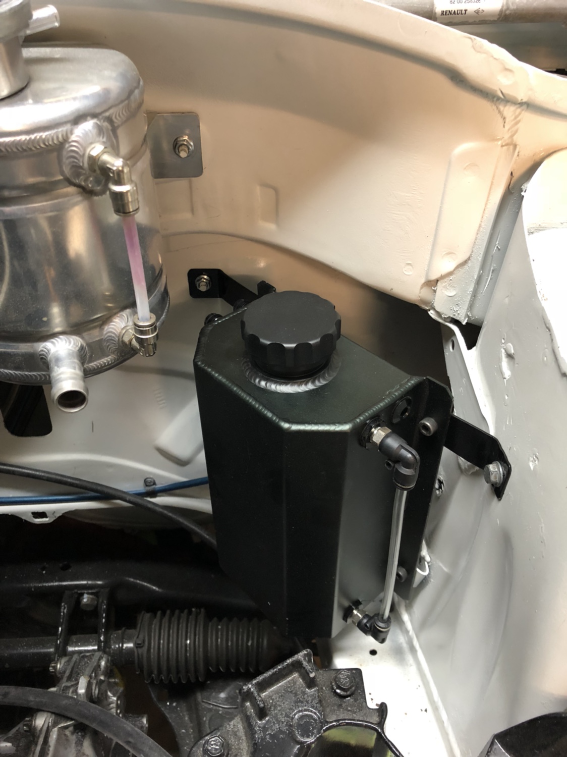

Made a bracket for 2L catch can.

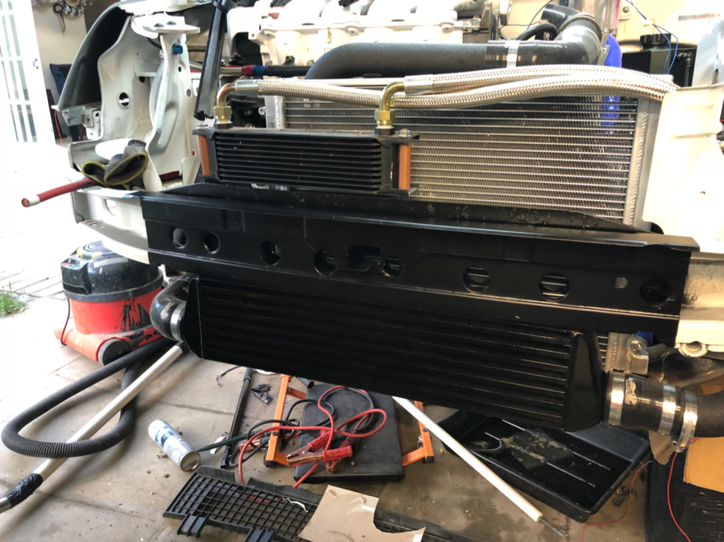

Next was oil cooler.
and intercooler + all the pipe work trial fitted.

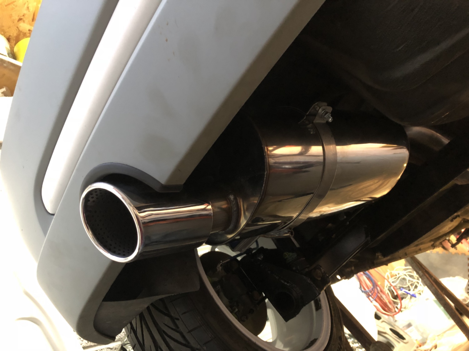

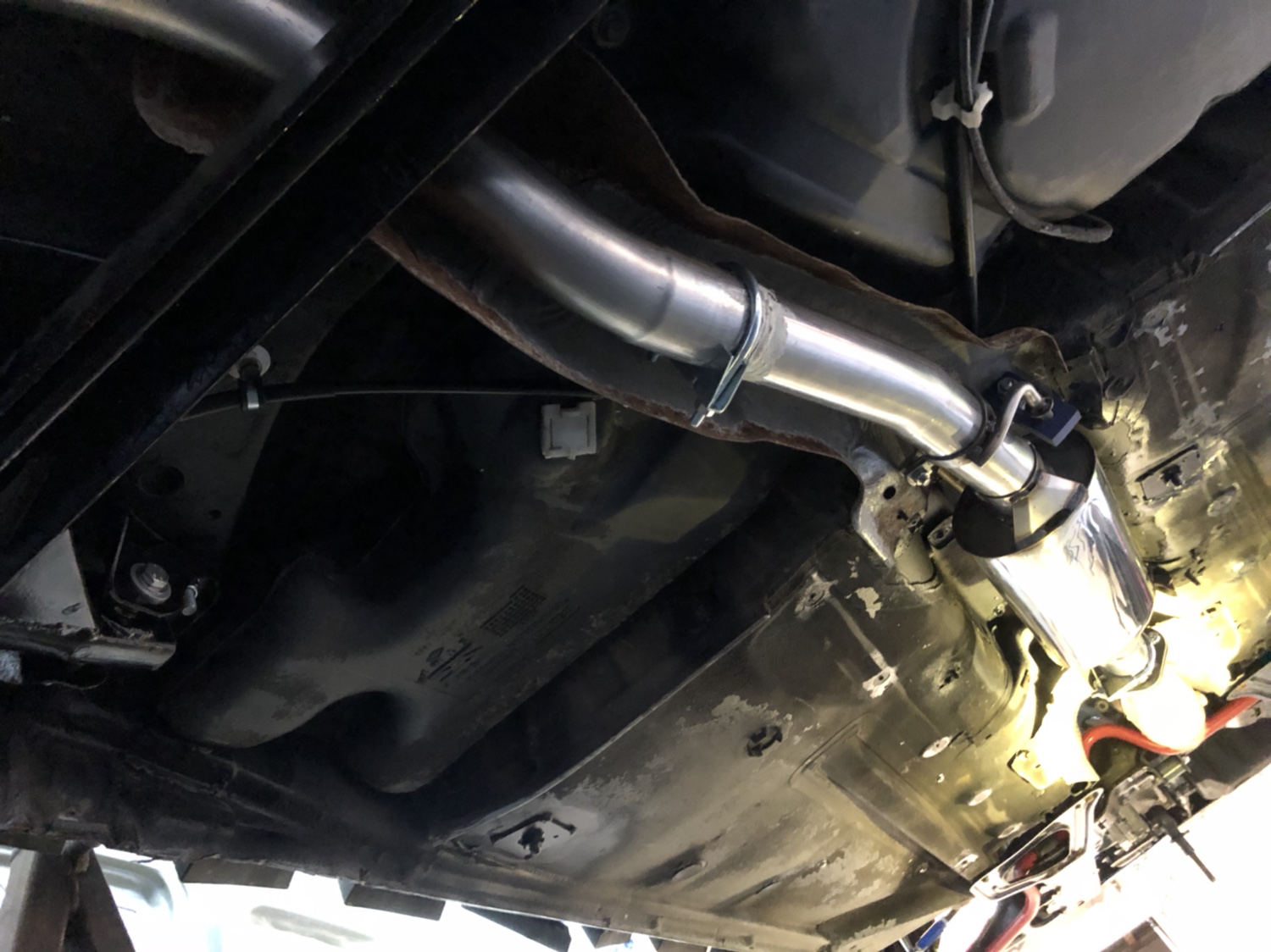

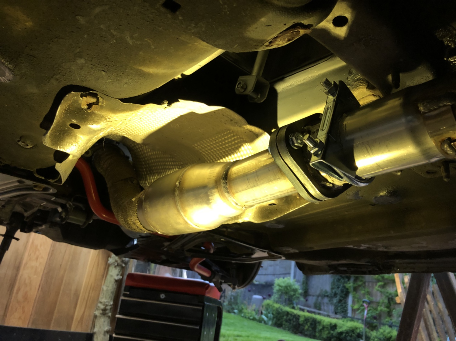

Also exhaust fitted, cut the bumper for the tip surround
Next trial fit the wiring, all the fluids and try start this b**ch up!

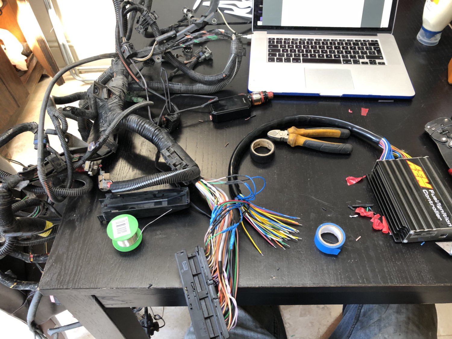

After the car run. I decided to trim the engine loom a bit. And I guess something went wrong. Immobiliser solid light. Tried absolutely everything! Spent around 40-50 hours trying to find a problem. No luck. So decided sod it! GO PENG OR GO HOME!

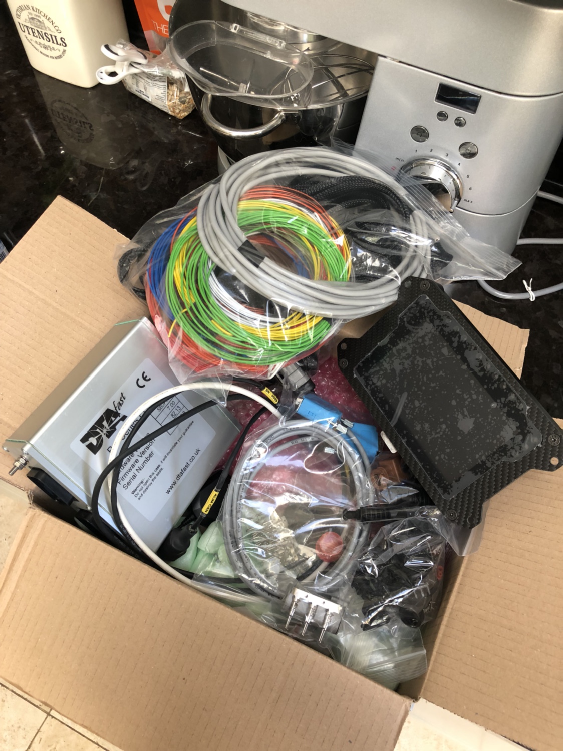

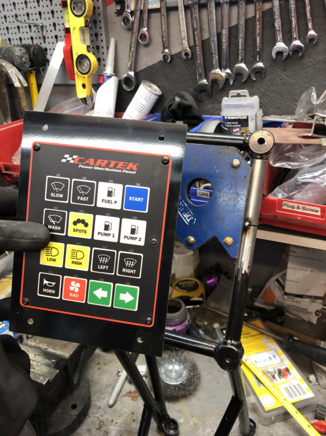

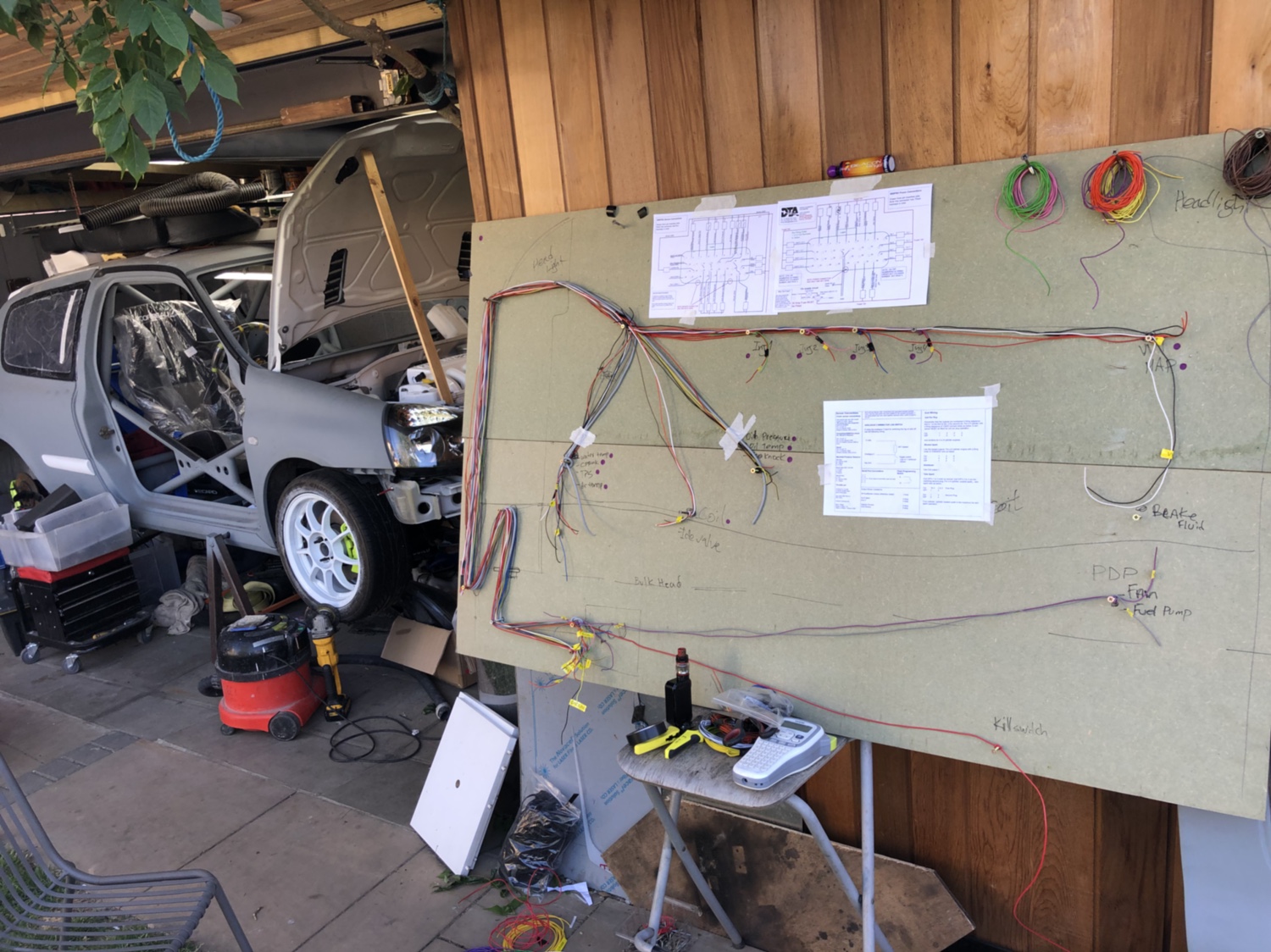

Decided to go stand alone ECU, CARTEK PdP, custom loom.
And now second problem sourcing everything I need at the price I am happy to pay! Let’s be honest, who likes to pay full retail?

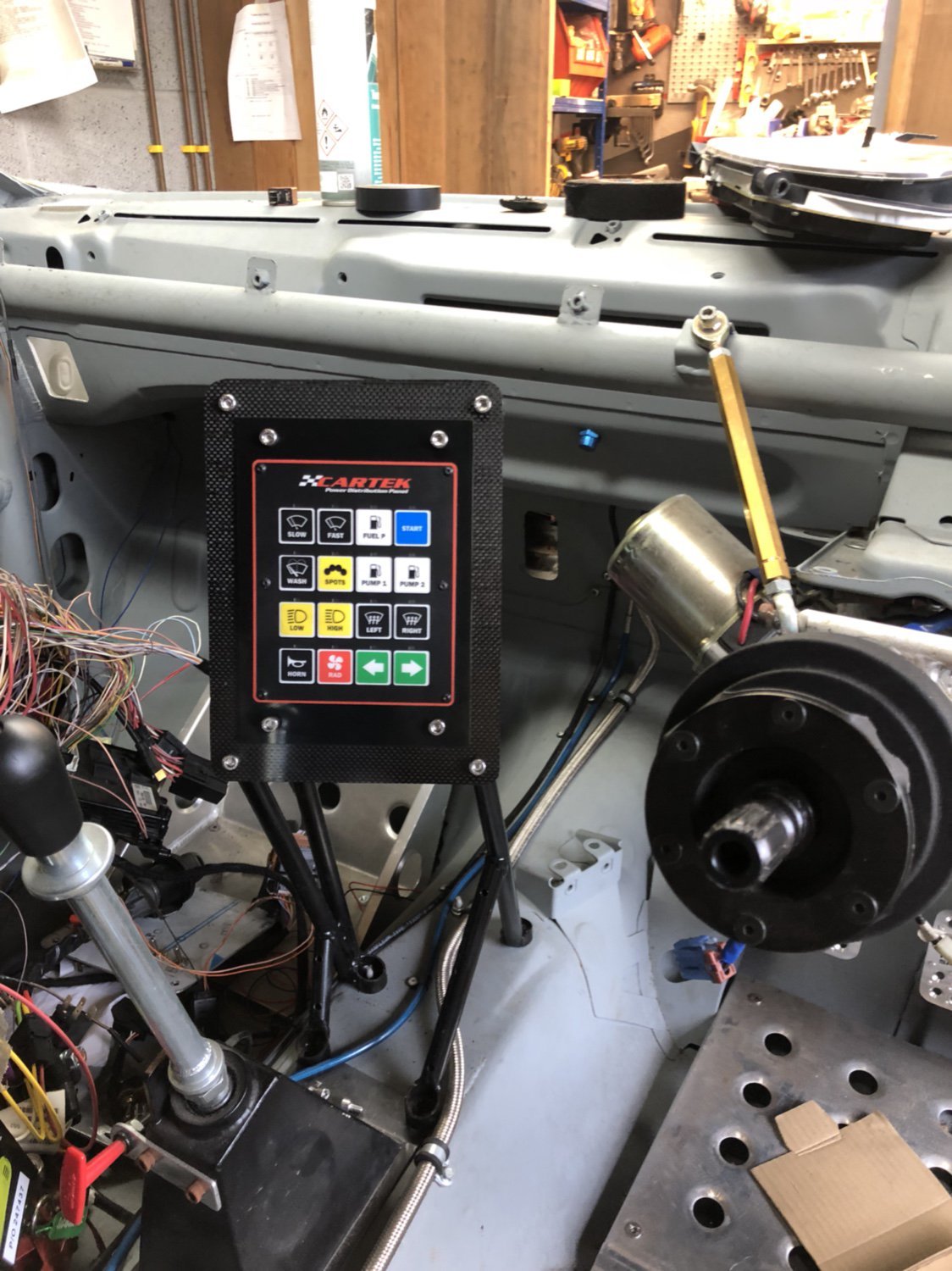

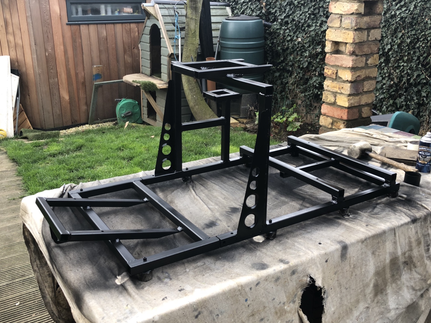

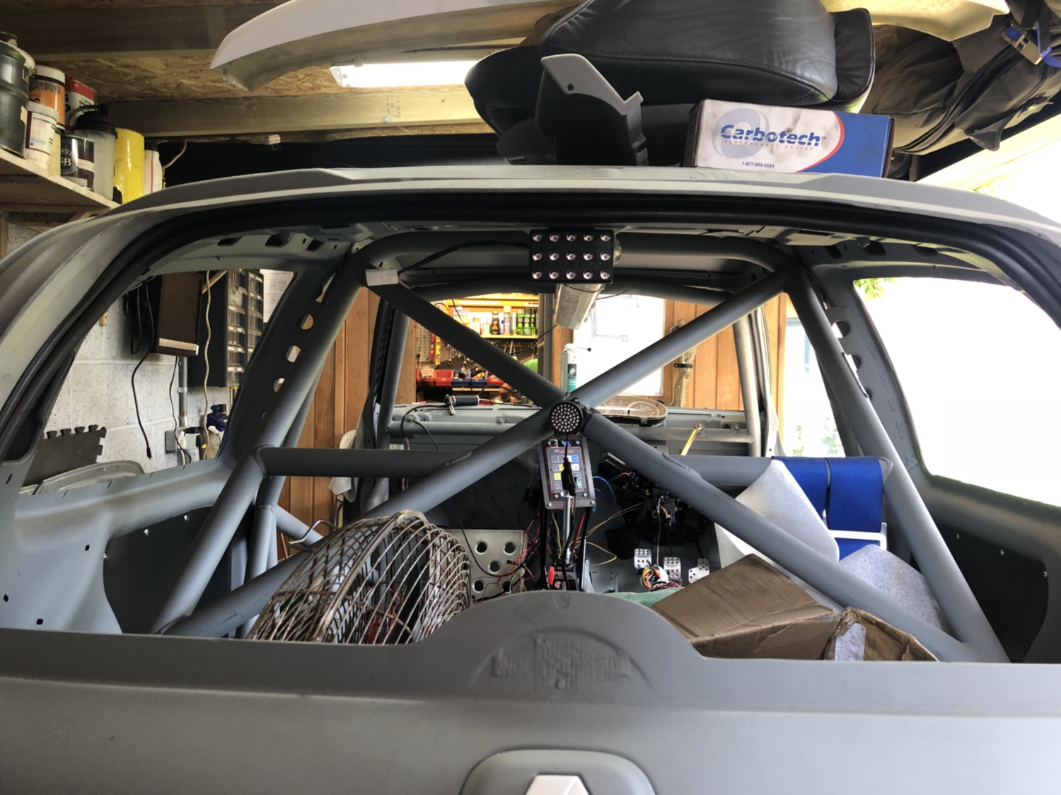

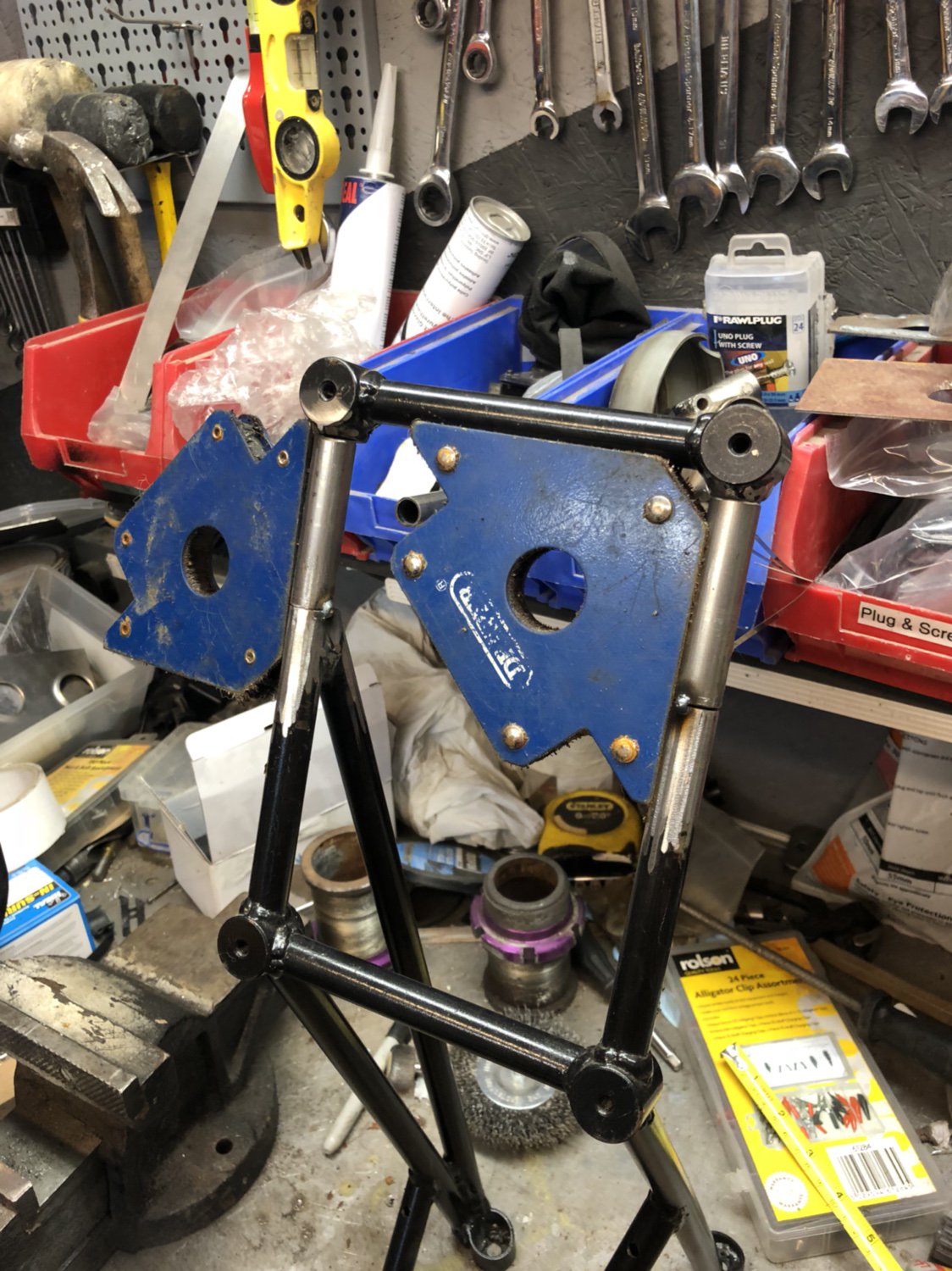

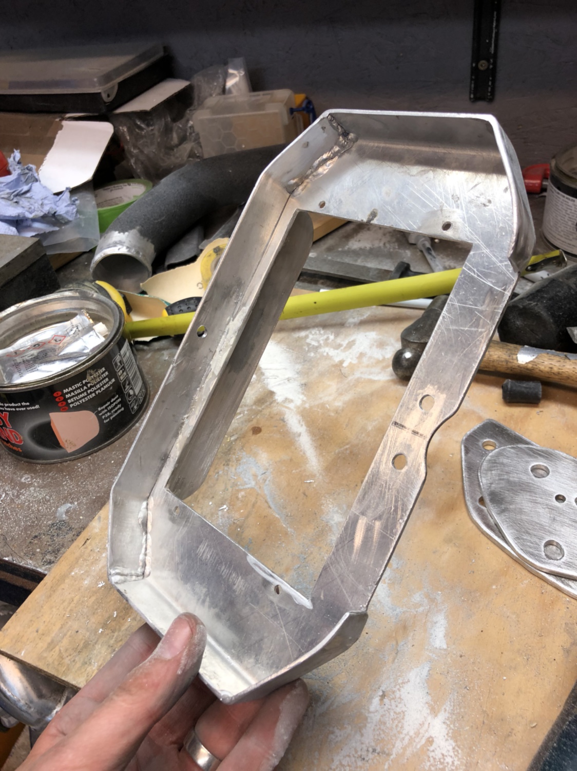

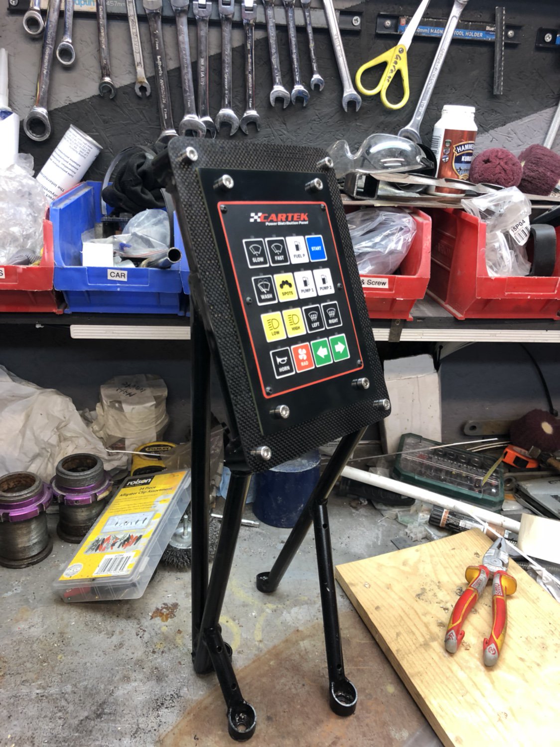

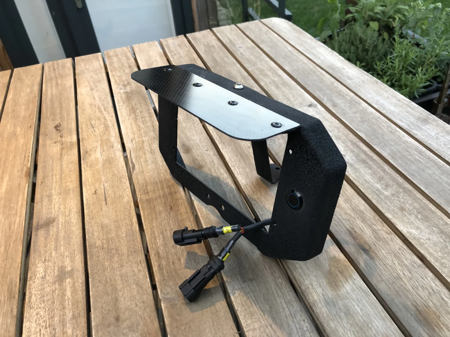

Anyways, had to modify my control panel cradle to accommodate PDP. A bit of welding, a dash of carbon fibre, some drilling and hey pronto!!

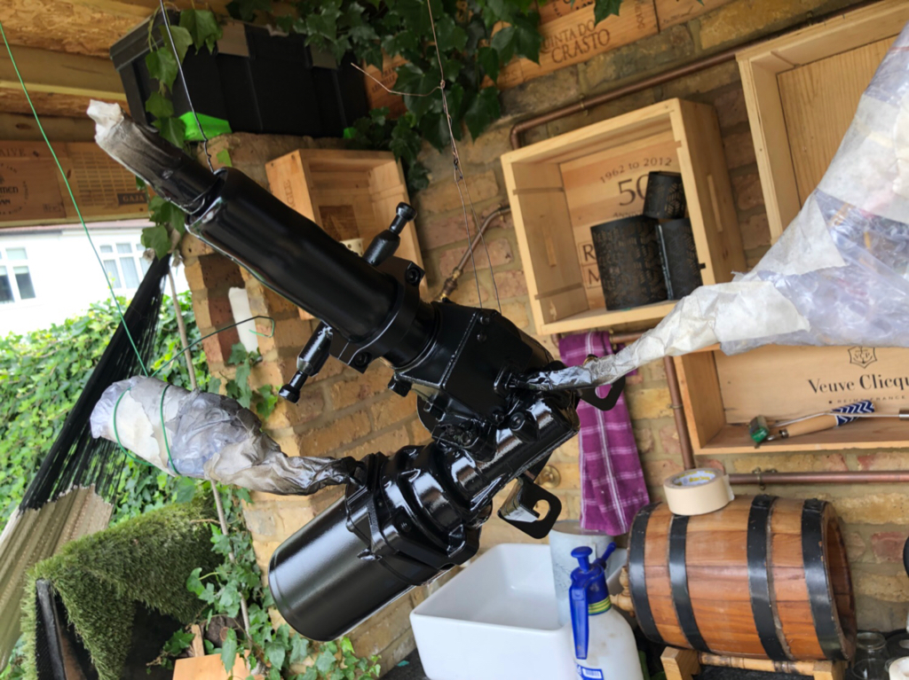

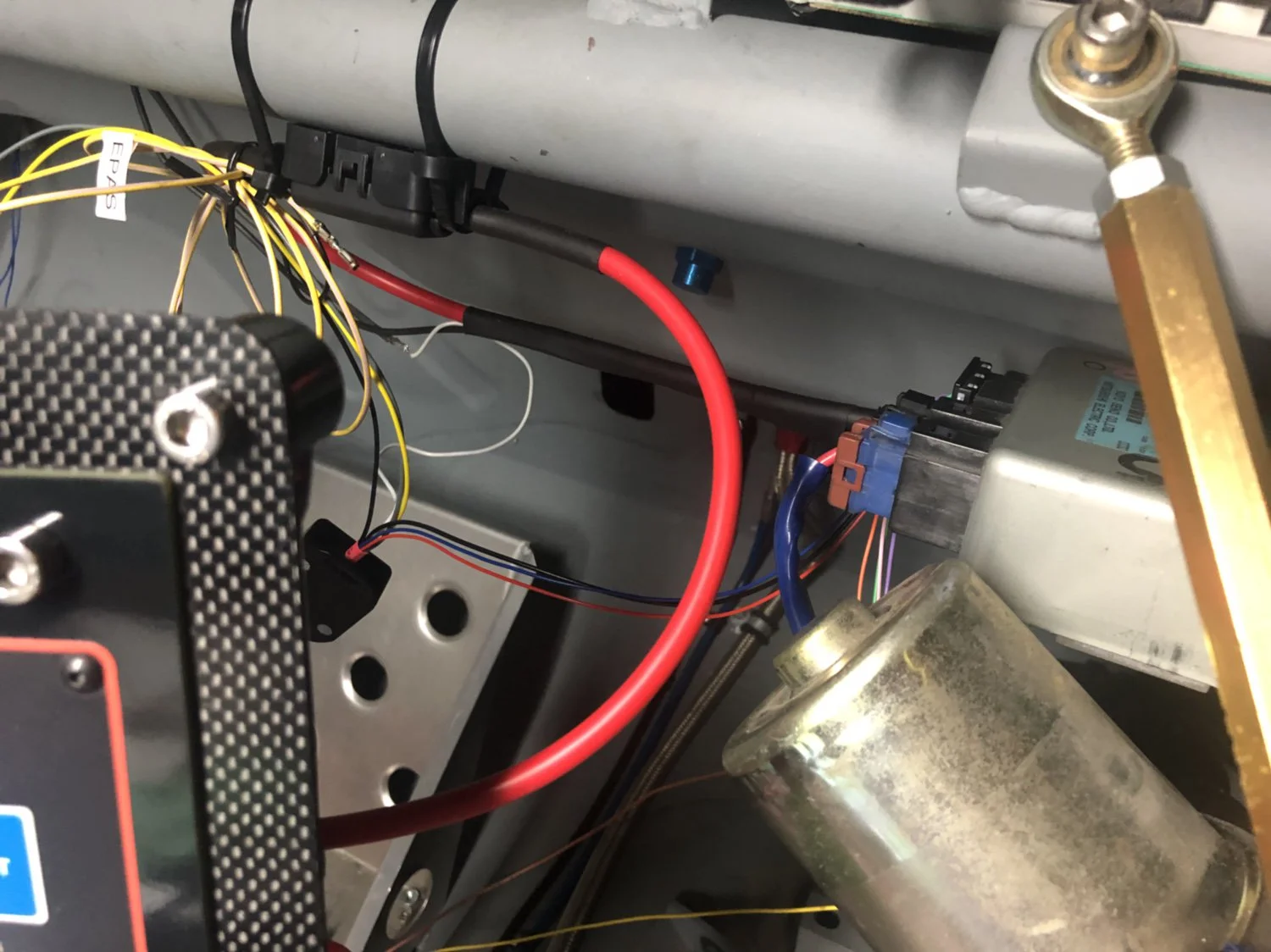

Next step was to wire the EPAs and mount the controller
Can’t test it properly as car is still up in the air.
Also wired the brake lights using stock brake switch. With 15amp in-line fuse wired directly through the switch, taking power form ignition.
Also made a separate loom for the wipers (hi/low) and washer bottle. Just waiting for some 16awg cable to wire the lights front and rear.
All is left, ECU, DASH and loom.

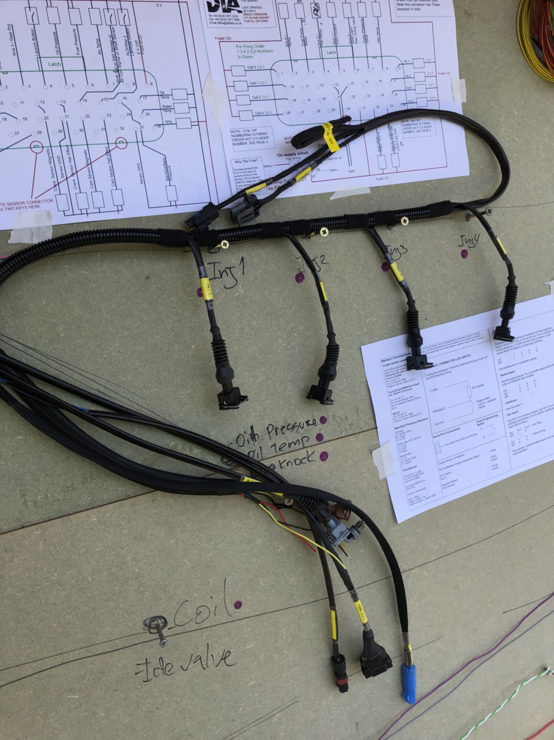

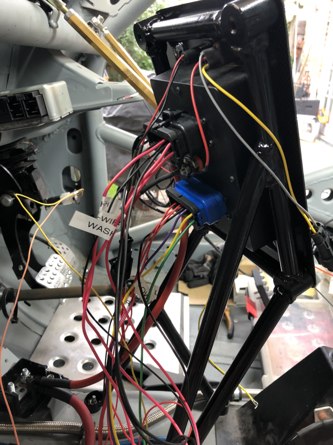

Interior loom is almost finished. Amazing how easy it becomes once you ditch the UCH.

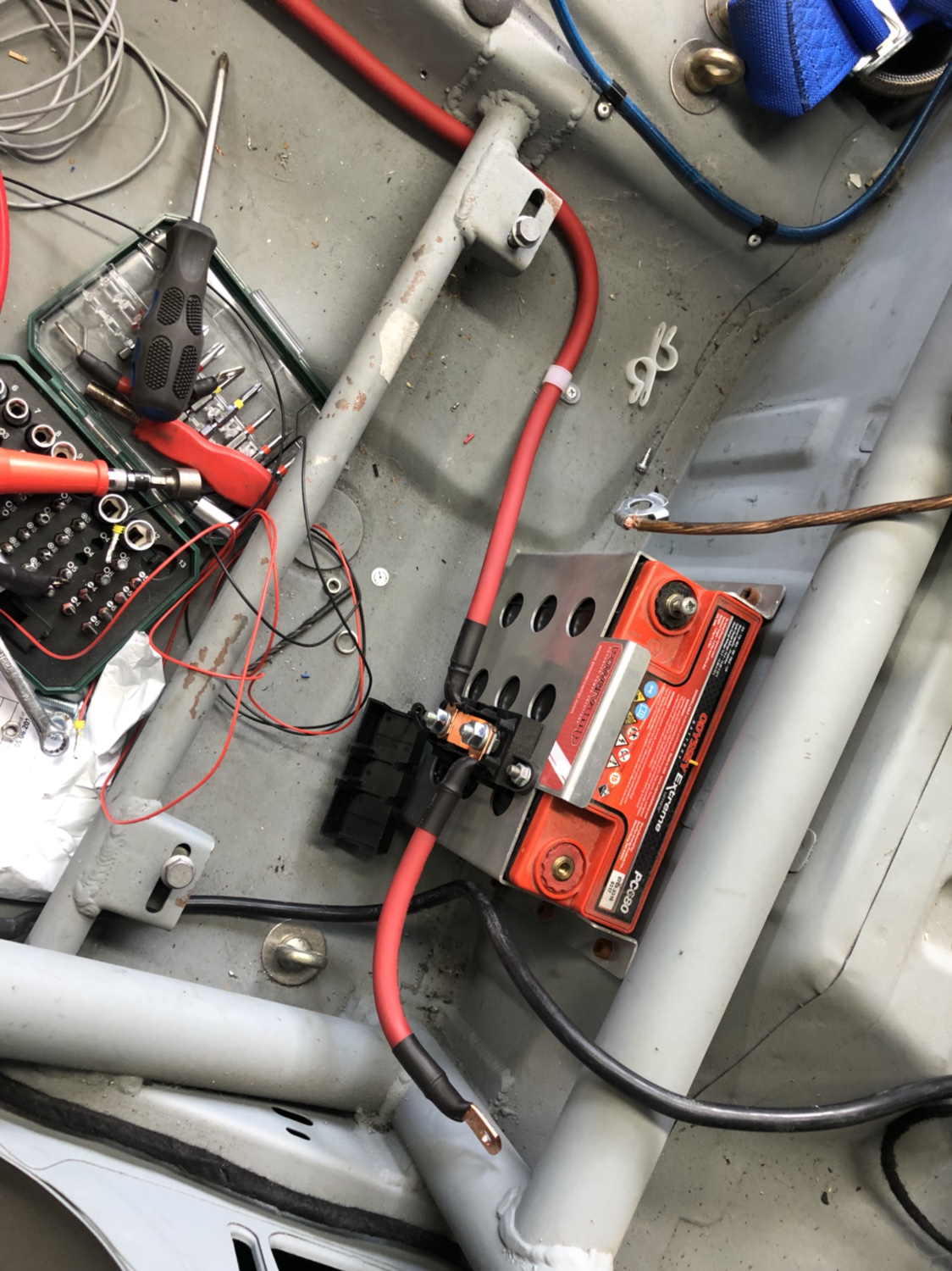

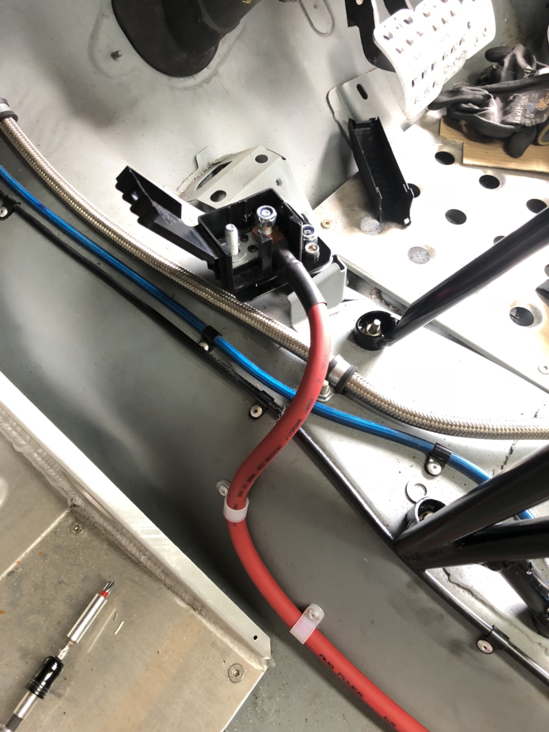

Upgraded the cabling slightly. 2awg mains cable run to junction box. From there it splits to starter/alternator and PDP.
Also ordered 0awg cable for the battery ground. Found a yellow one :)

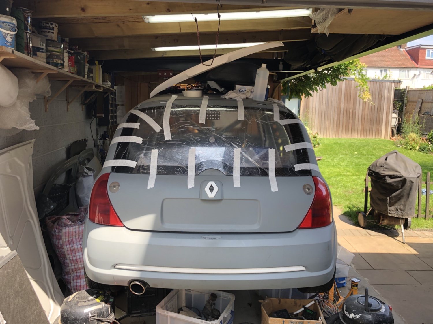

Also fitted rear windscreen and quarter panels. Very happy with the rear but I think I was a bit messy with the quarters.. guess this will have to do.

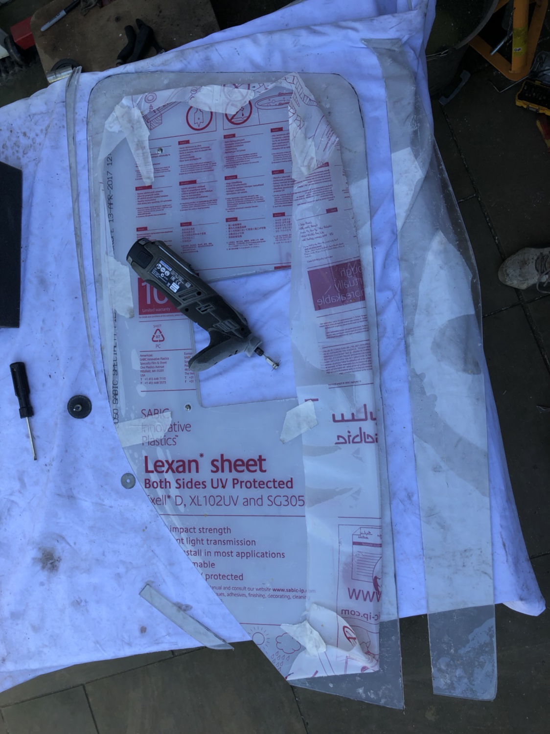

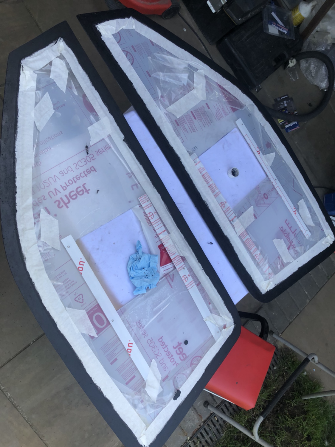

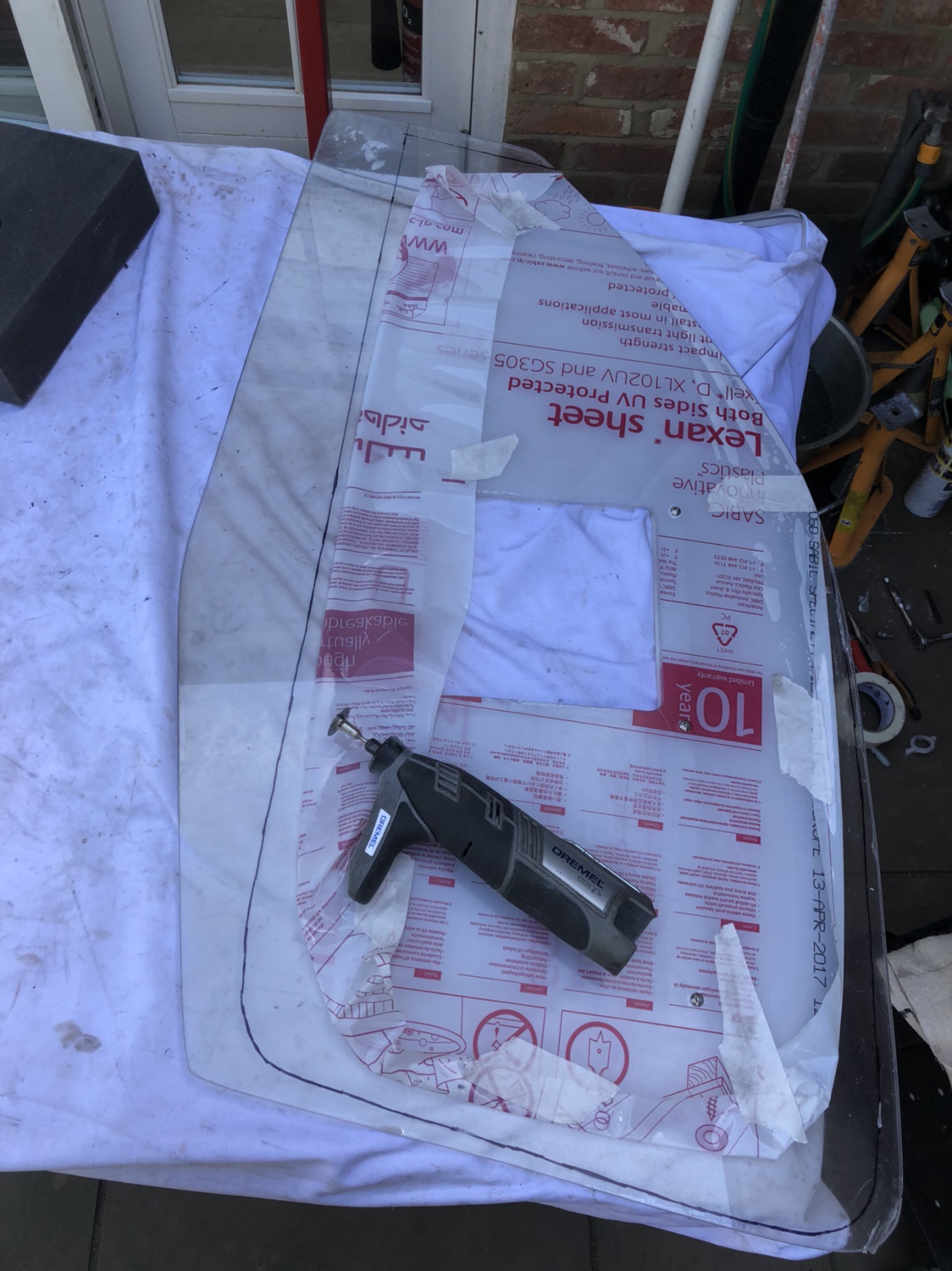

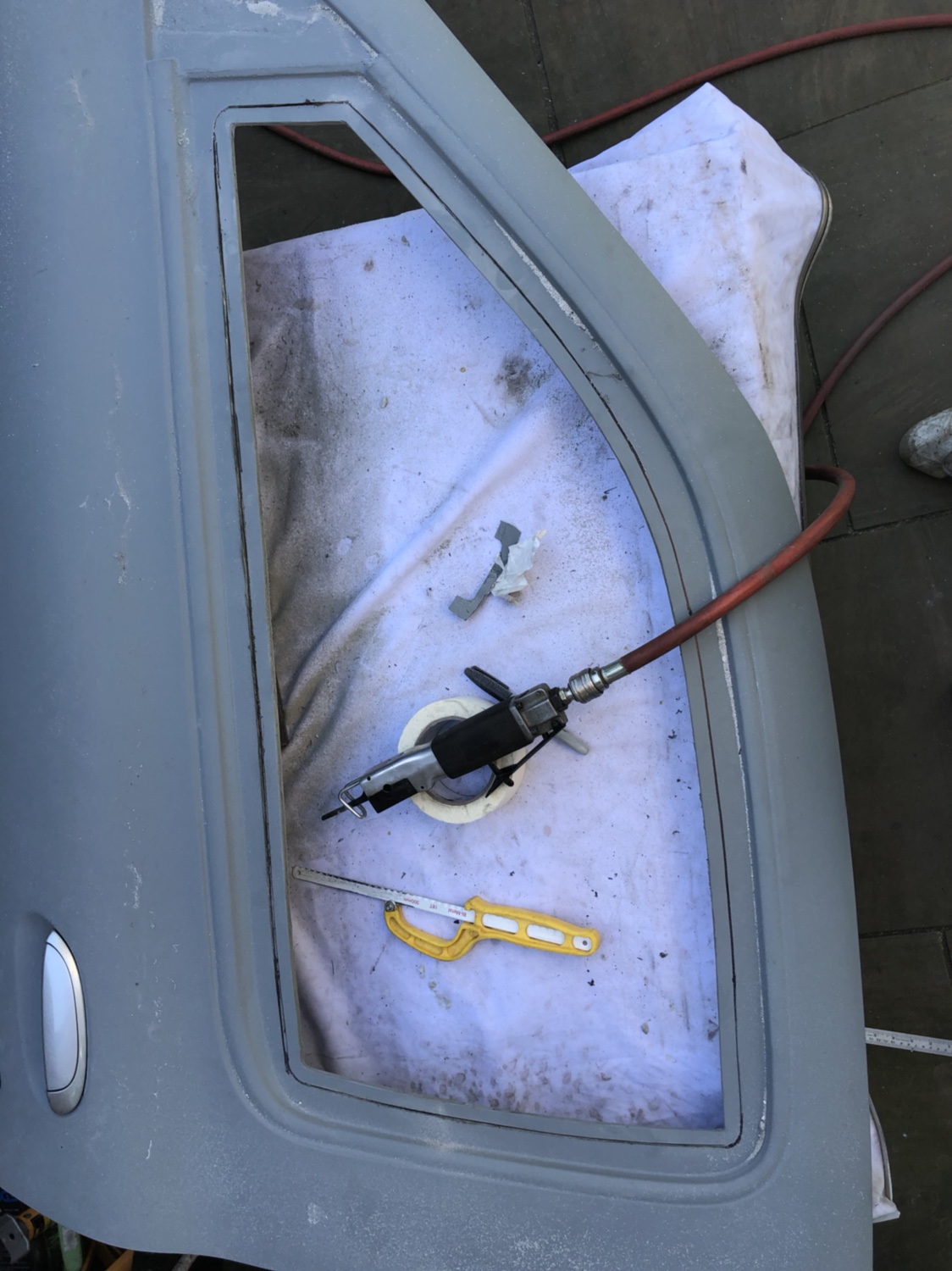

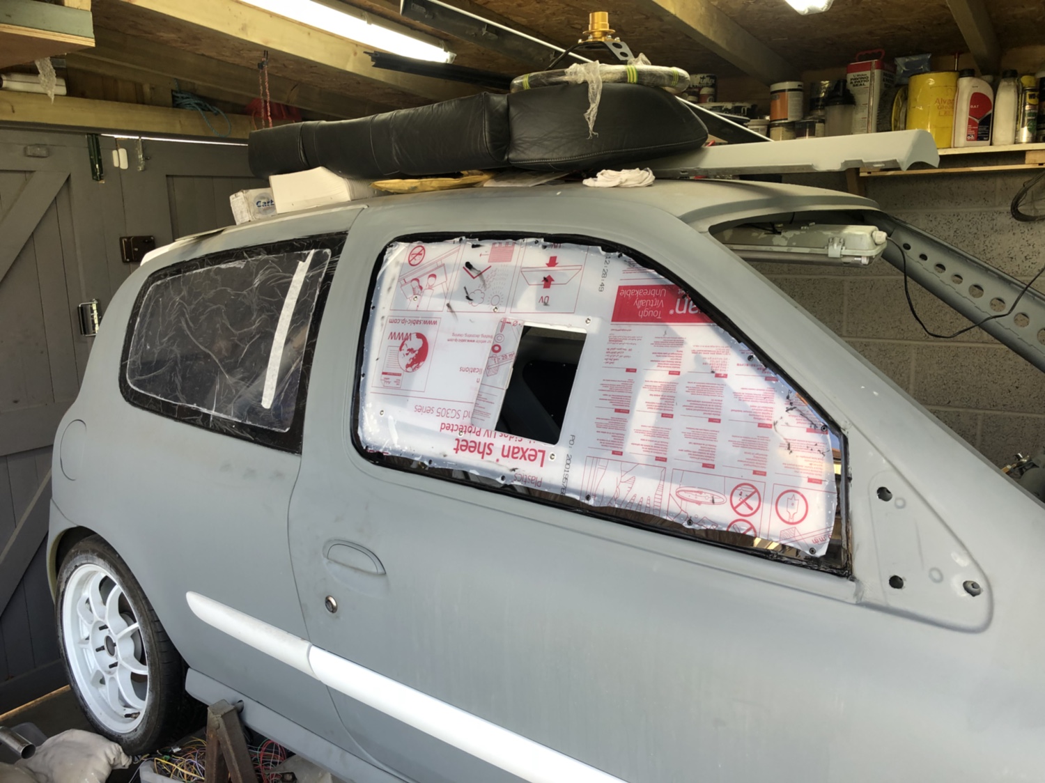

Ok today tried to fit glass to my front doors... what I didnt know is that they were meant to go on the inside of the door. Because they are same size as the originals.
As I have fibre glass doors... well here comes the Dremel!
d70b14a9e1cc39f96ffc78fe76ac516a.heic
856709a5dd00eb44c956248e2bfc3299.heic
Also trimmed the inside edge of the door as well.
7359d912e32c8c00f5cda736715c59a8.heic

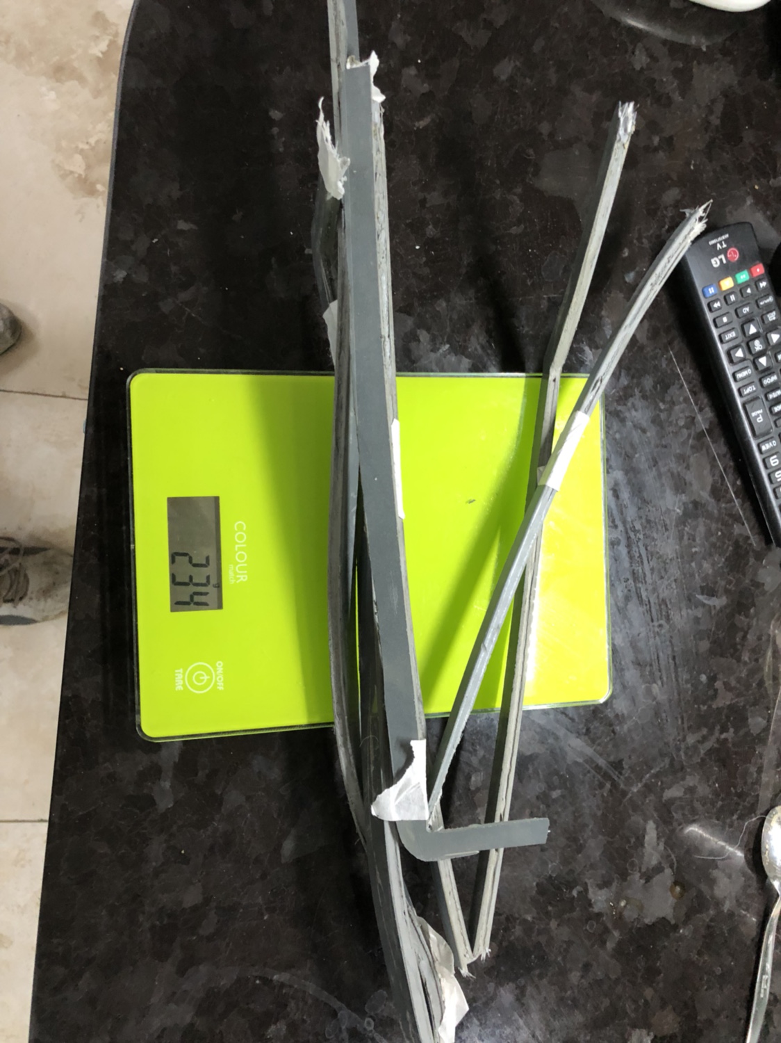

And saved 250ish grams per side hehe
36e8876a18348303ad7b4dd91683570d.heic

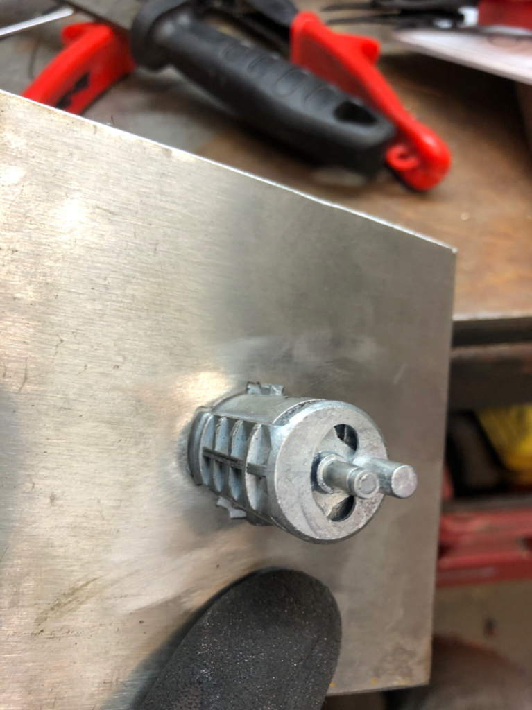

This update I will call: “An elegant (or not [emoji12]) solution to a problem you never knew existed”

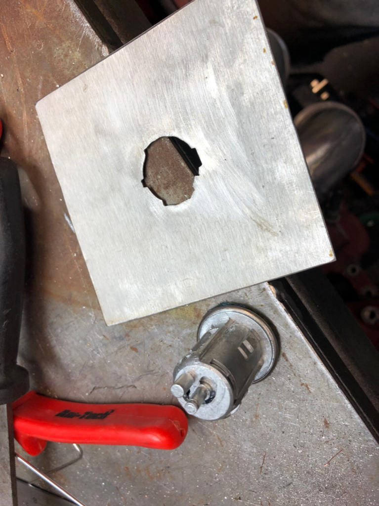

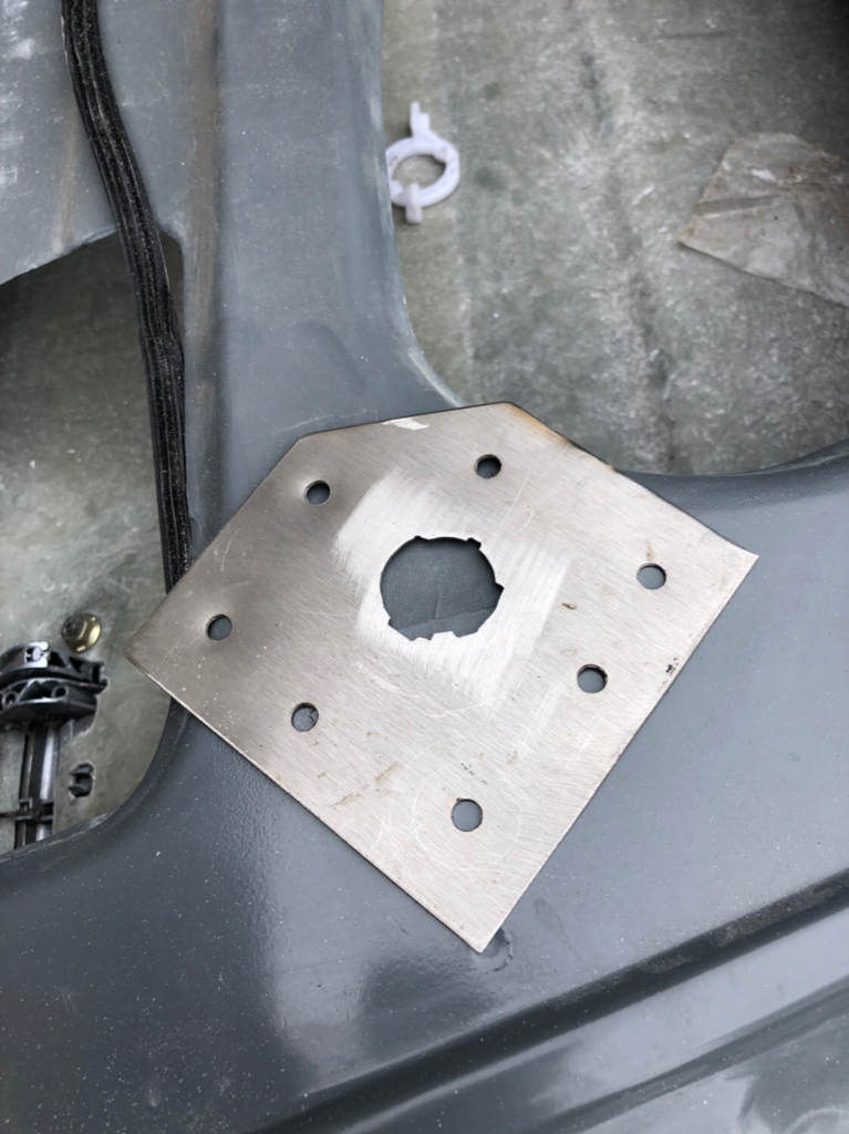

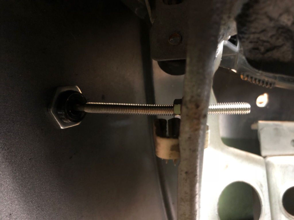

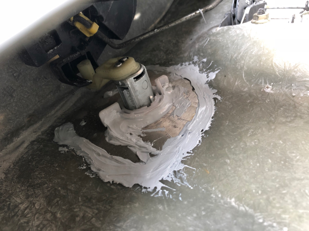

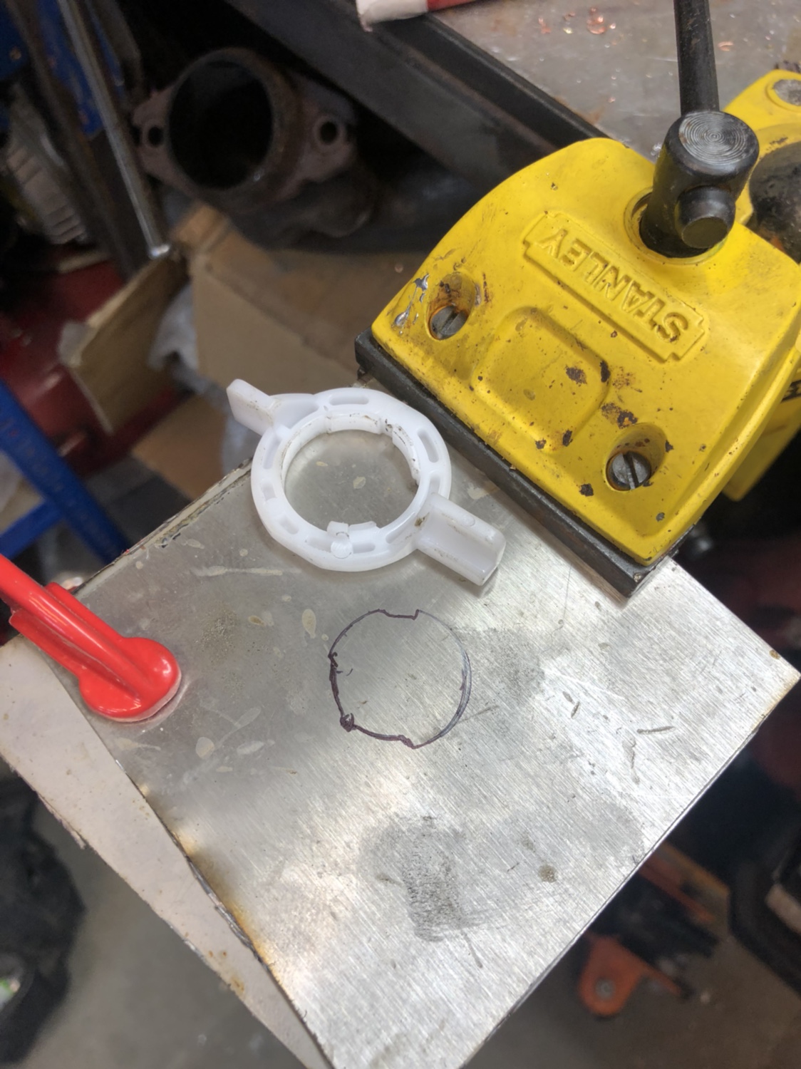

Basically I want to be able to lock the car with a key. For various reasons.
Originally car came with only passenger side lock barrel. No good for locking drivers side when you have no central locking.
So I had to order new set of key lock barrels. New drivers side actuator. An other problem was that fibreglass doors won’t locate and secure barrel inside to prevent from rotating. (Metal doors have key way slot for the barrel) are because it’s thicker than metal, plastic secure ring won’t lock in to place( well it did after I skimmed a surface by 1.5mm). Hope you still following... after a bit of head scratching, some 1.5mm stainless, manual filing and a liberal blob of tiger seal, I present to you...
Now I can lock the car [emoji851]quite chaffed with myself today hehe..

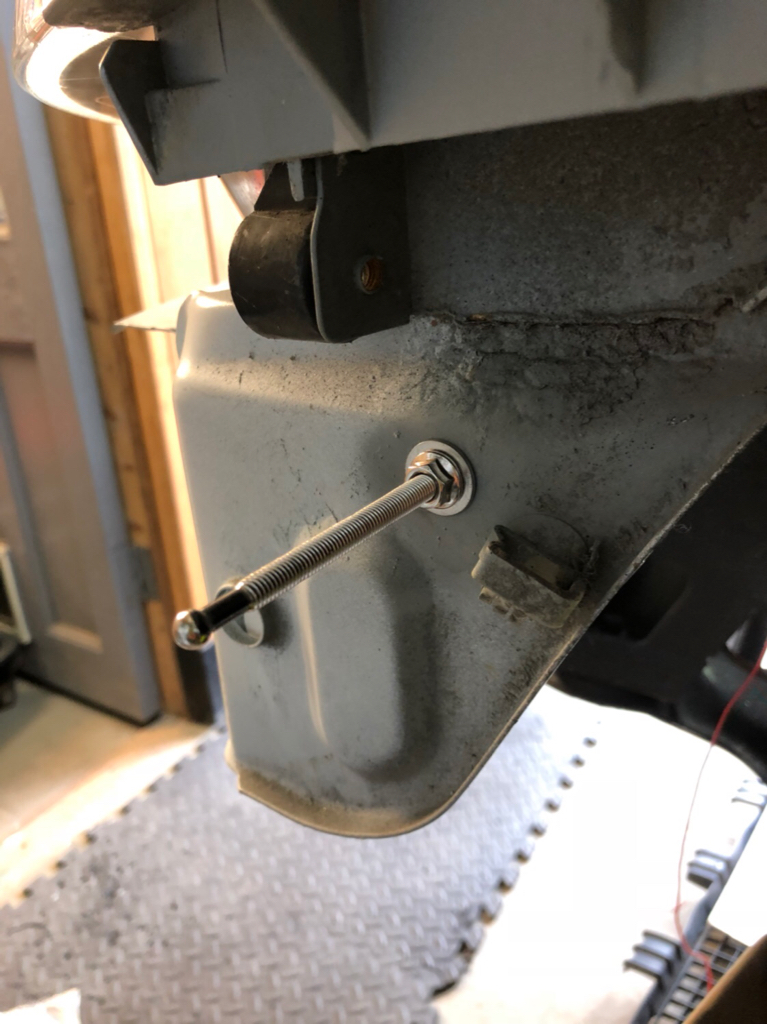

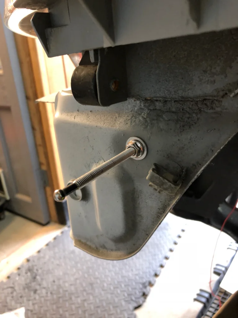

After that fitted bumper holding pins.
2 on each side and 2 in the Center.

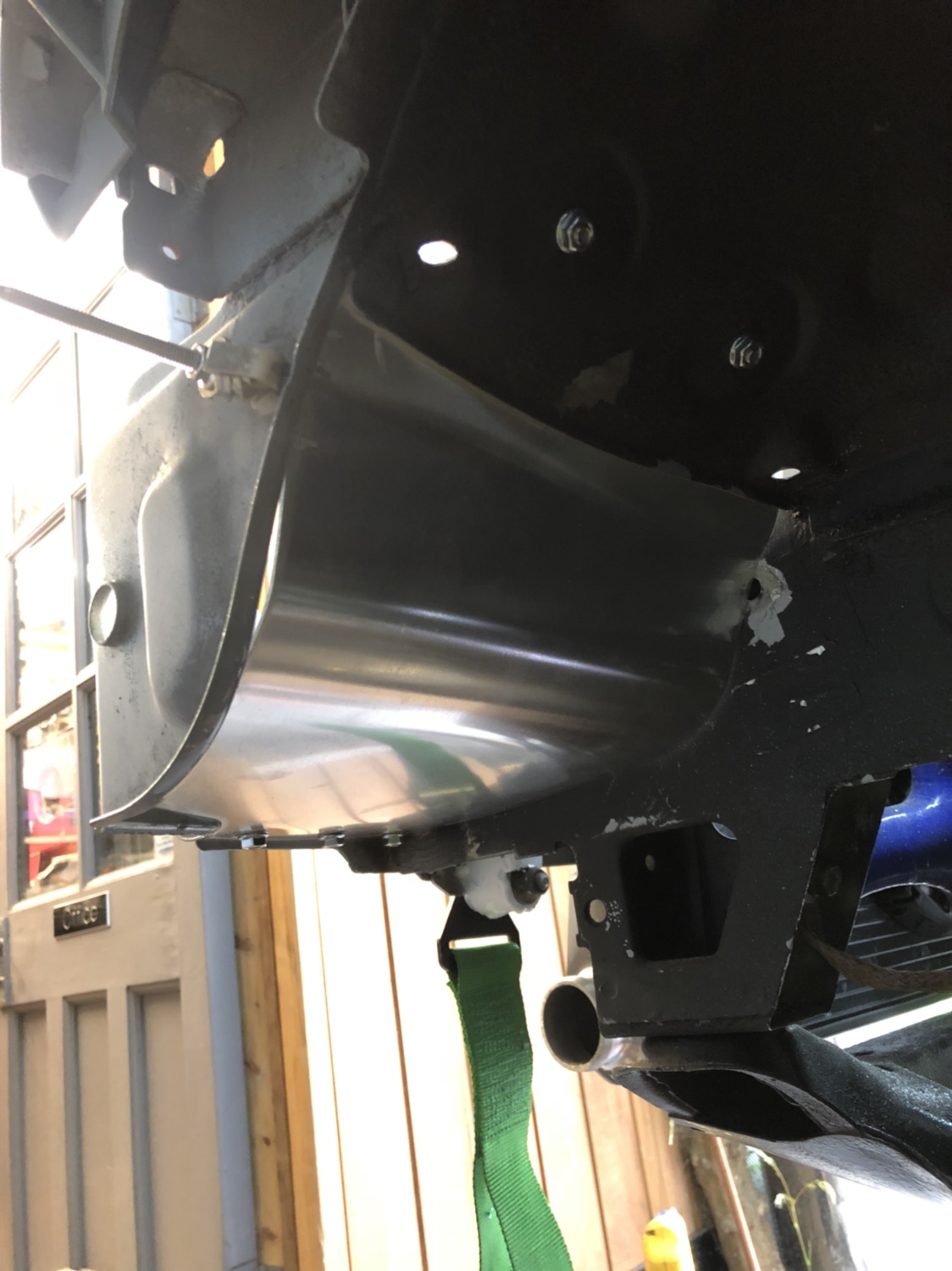

Oh and drilled some holes under the number plate and gave it a little black paint so it doesn’t stand out much through the holes. And fitted the tow strap.

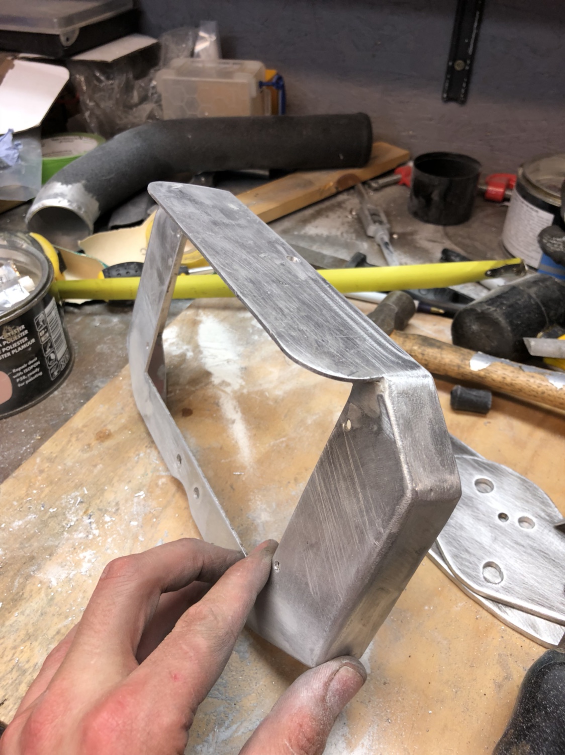

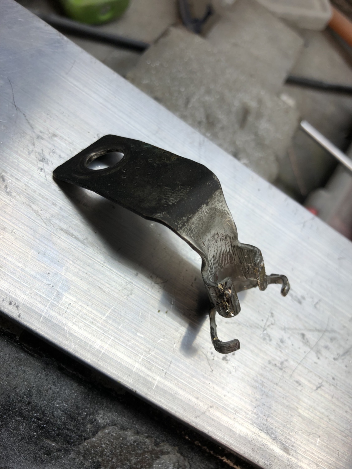

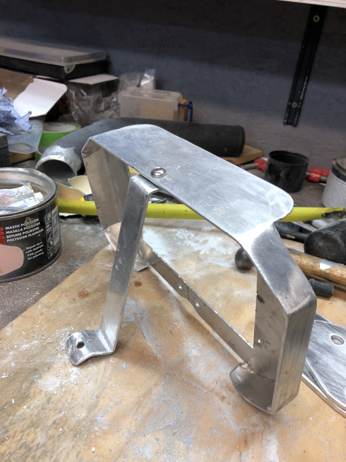

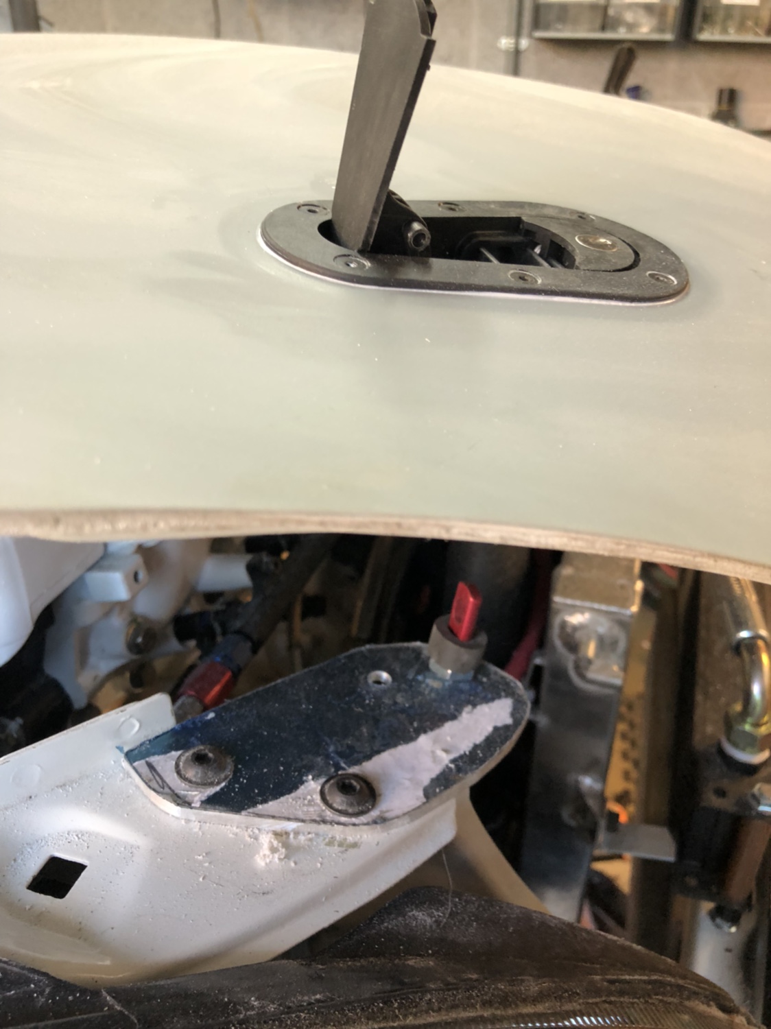

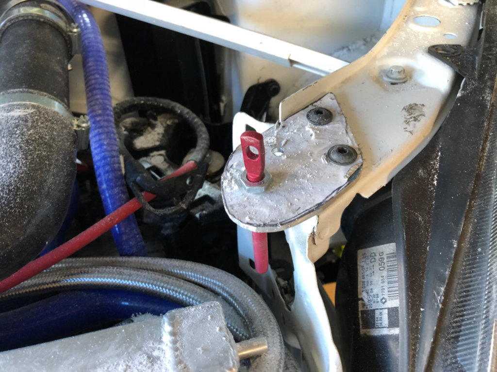

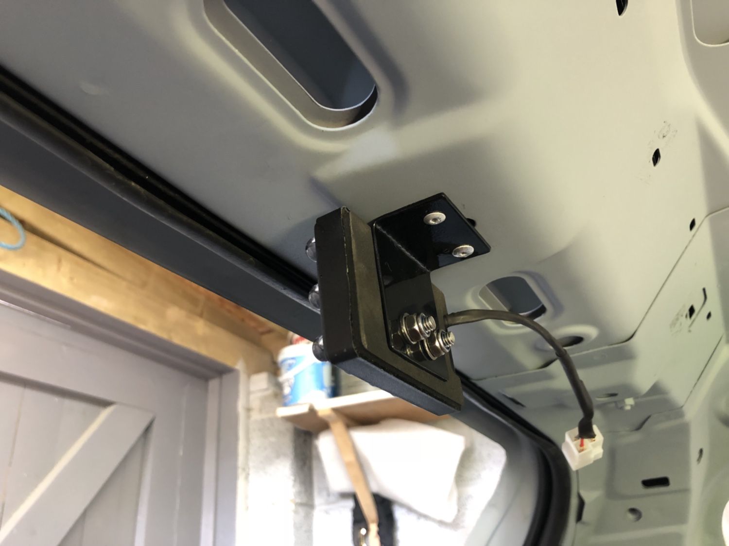

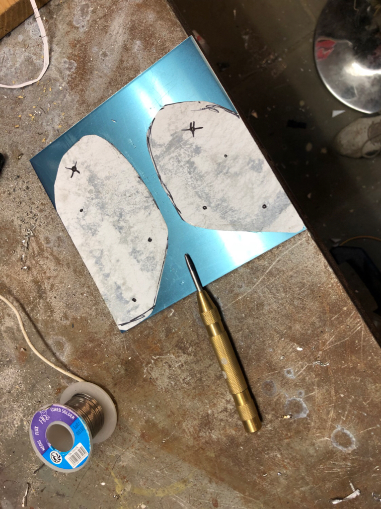

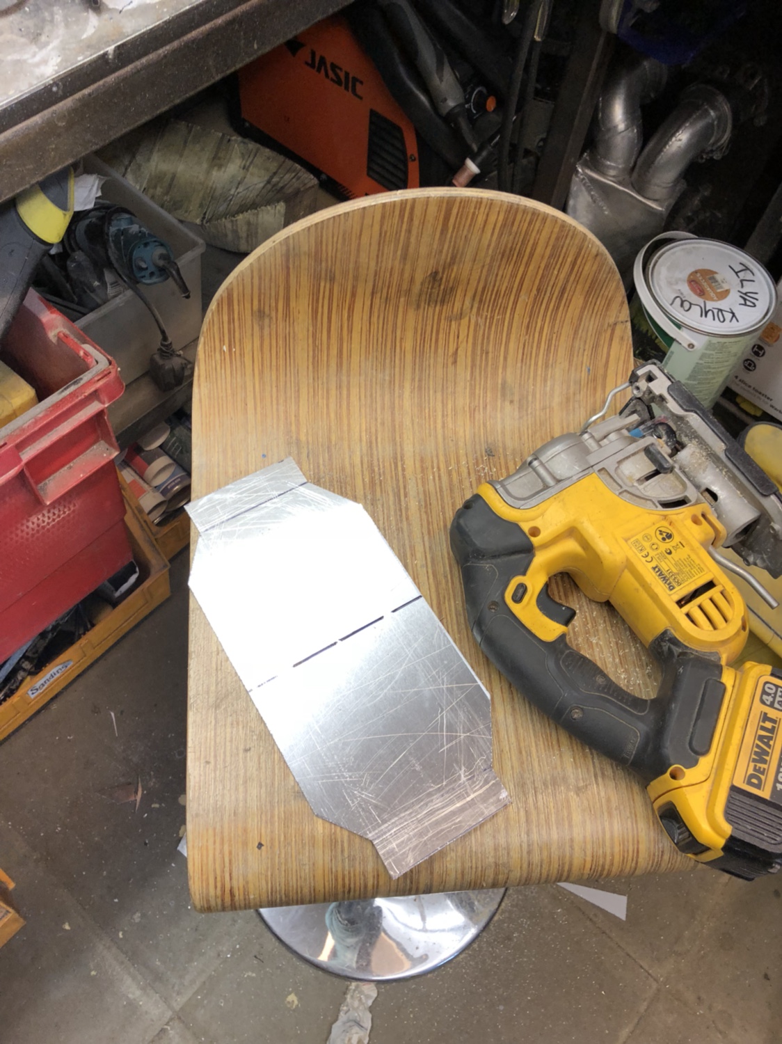

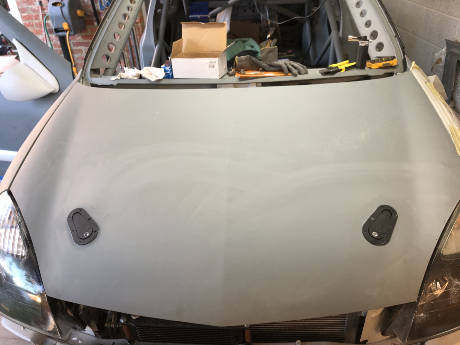

Next was bonnet. Made plates for catches out of 4mm aluminium
fitted catches with a bit of tiger seal around the edge
wasnt sure how to angle them so went with the most popular choice

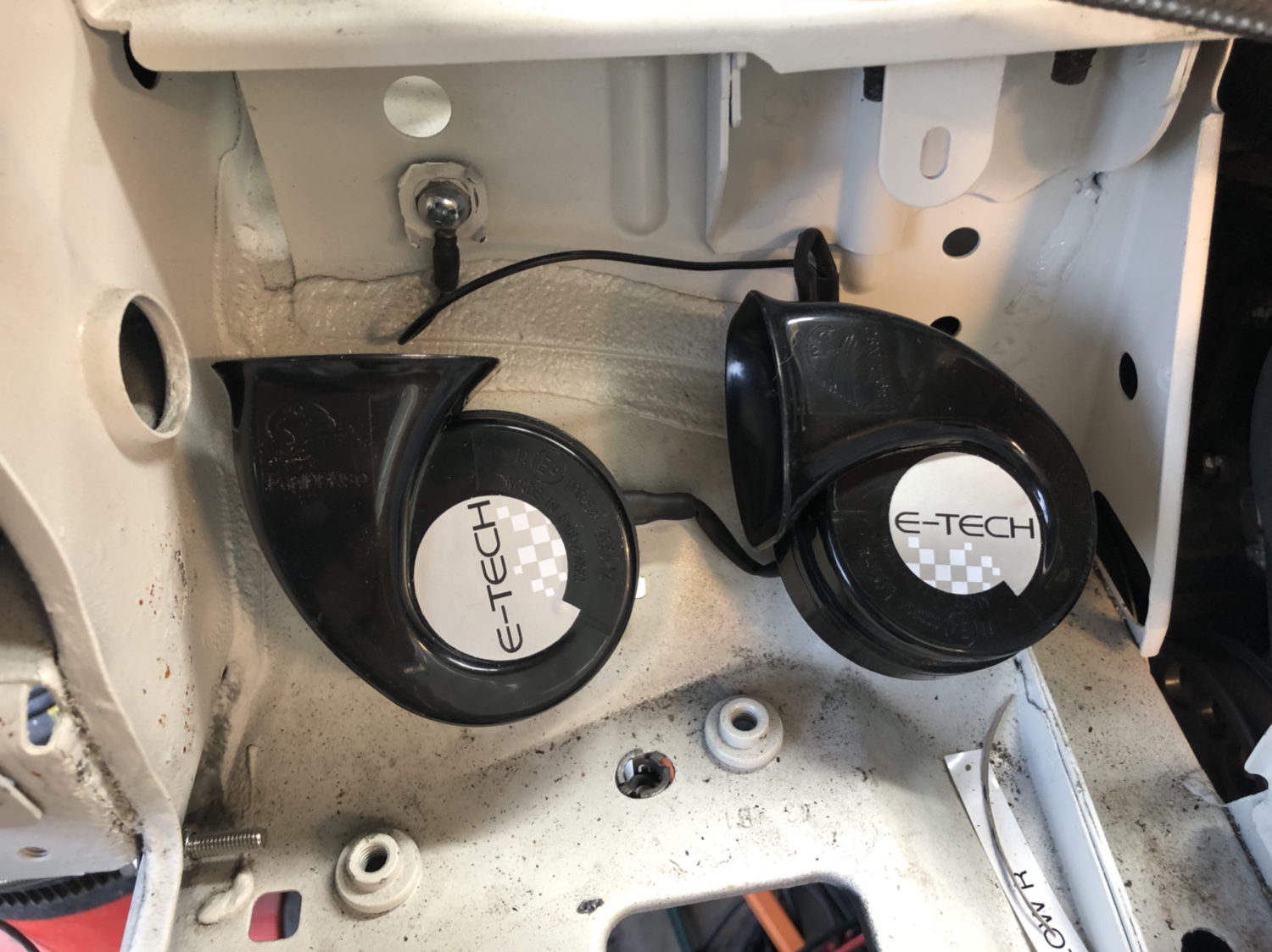

Also fitted new lightweight horns. They sit neatly behind drivers headlight

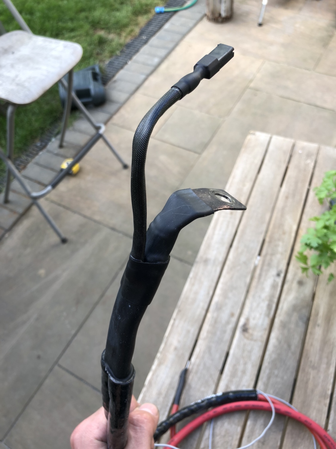

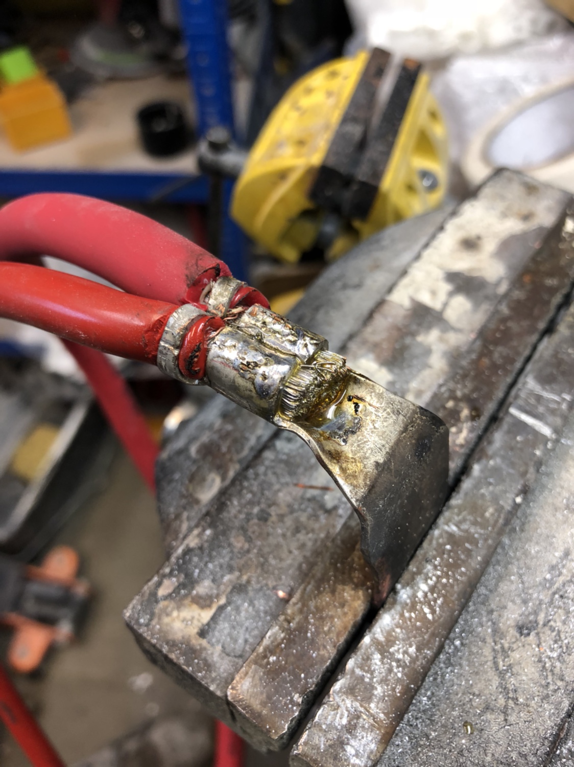

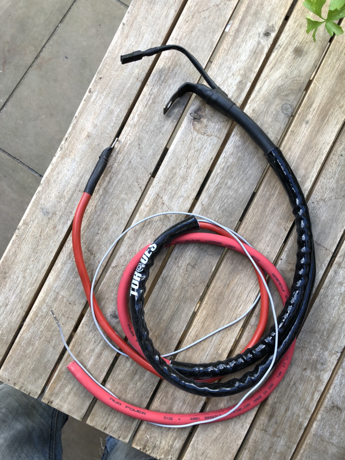

And in preparation for the engine loom, made new starter and alternator cable with 4awg cable, reusing original terminals
very happy how it turned out [emoji41]. Tested the starter motor through PDP and it all works!

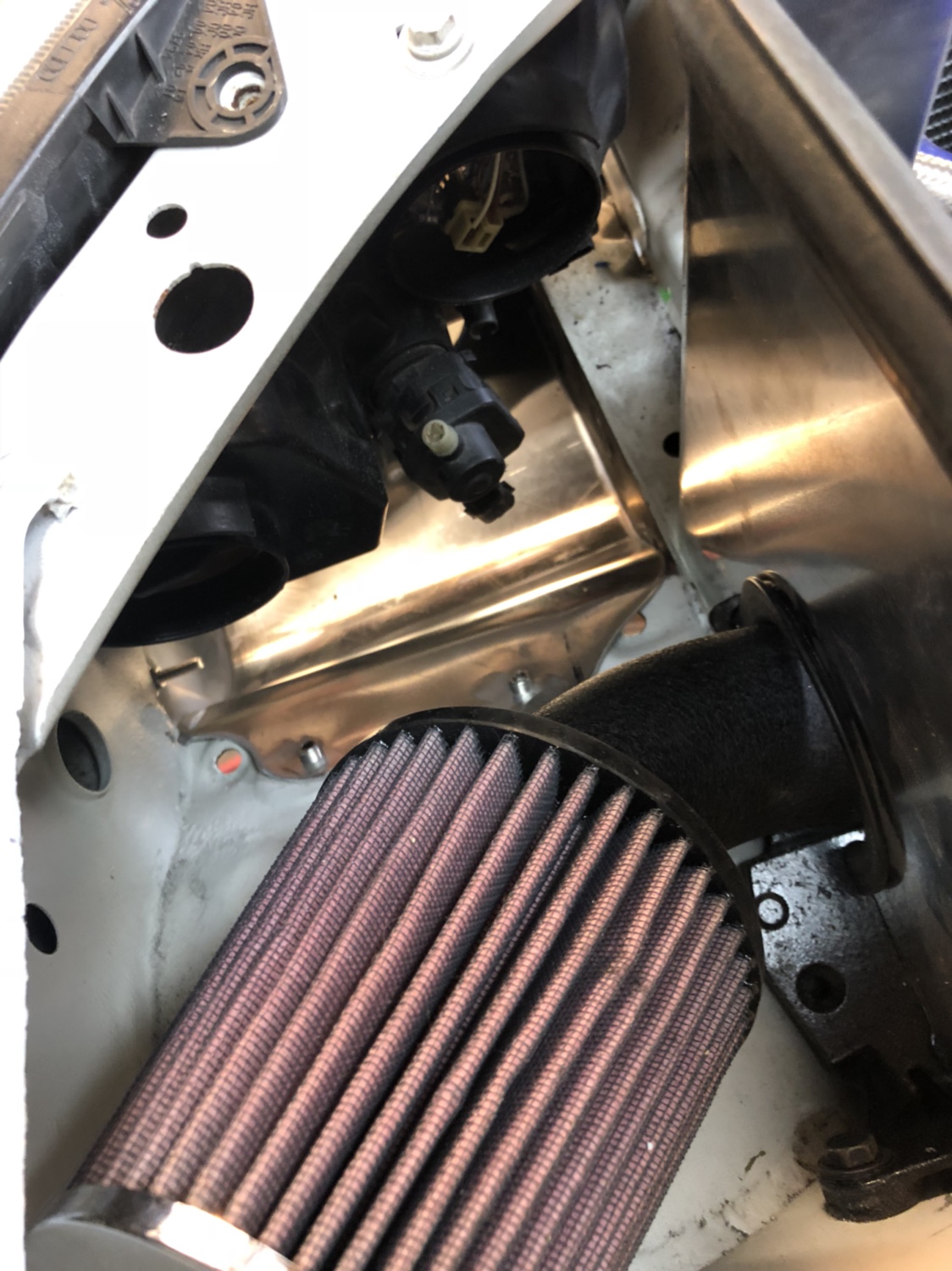

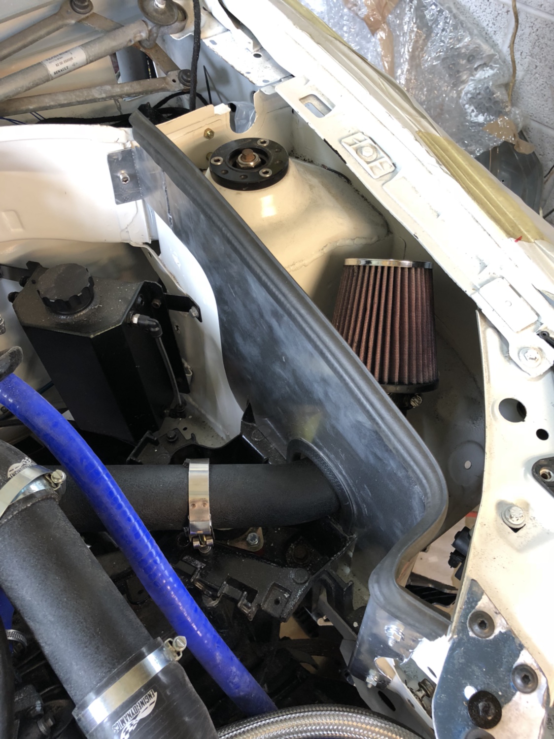

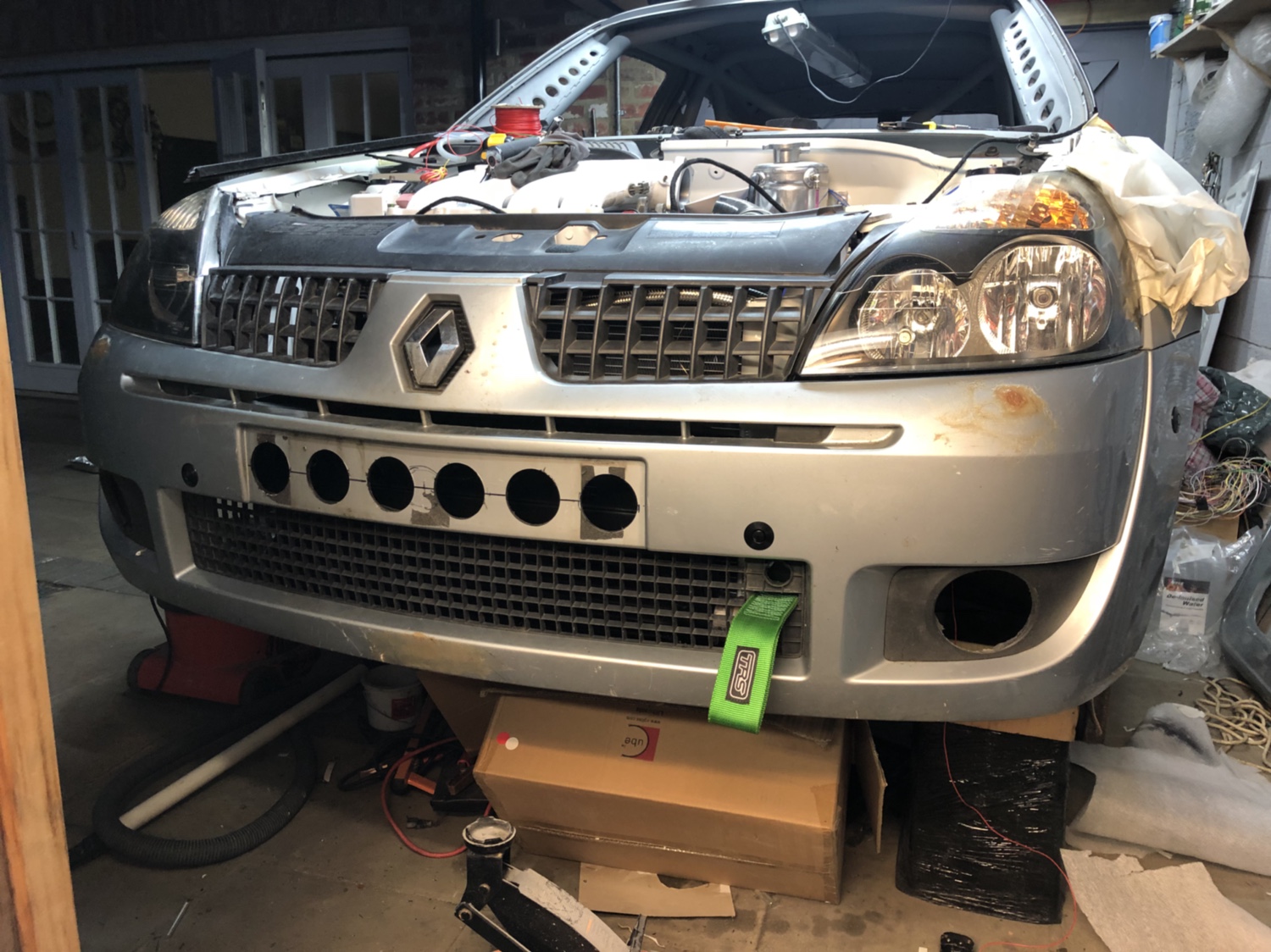

And decided that race cars with turbos need to breath fresh air, so decided to make my own hybrid air box/ ram air thingy. Extremely happy how it turned out. Just need to reroute my intercooler piping slightly so not to cut holes in my pretty work. So shiny! Might actually wrinkle paint the heat shield later.
air will come through the bumper. Will fit wide ducting above the fog light. Plenty of space between the headlight and the body

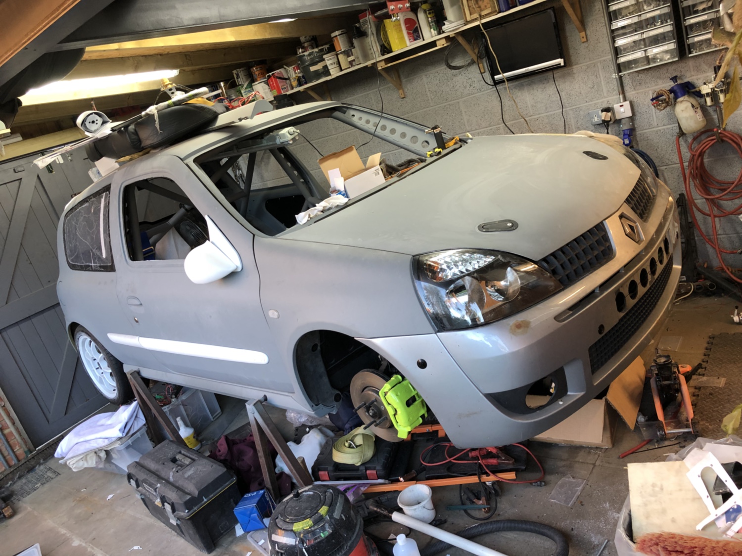

It looks like a real car now [emoji854]
Tommorow will fit rest of plexi glass and perhaps start prepping the bumper for paint.

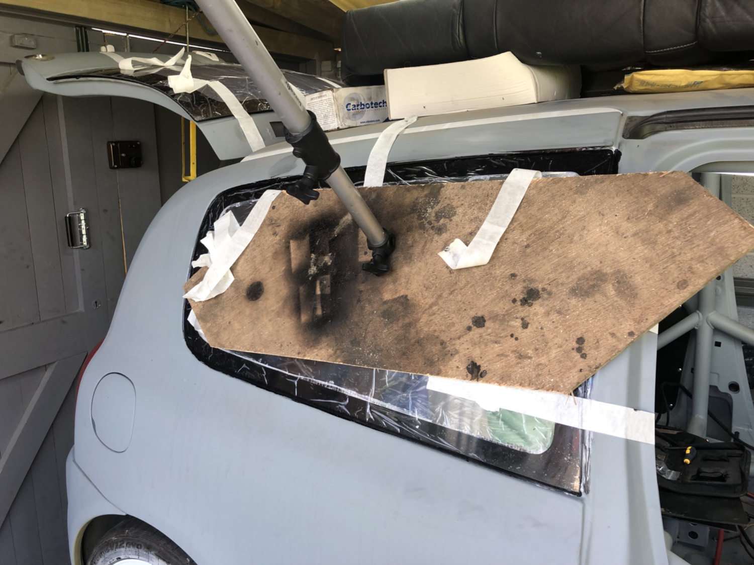

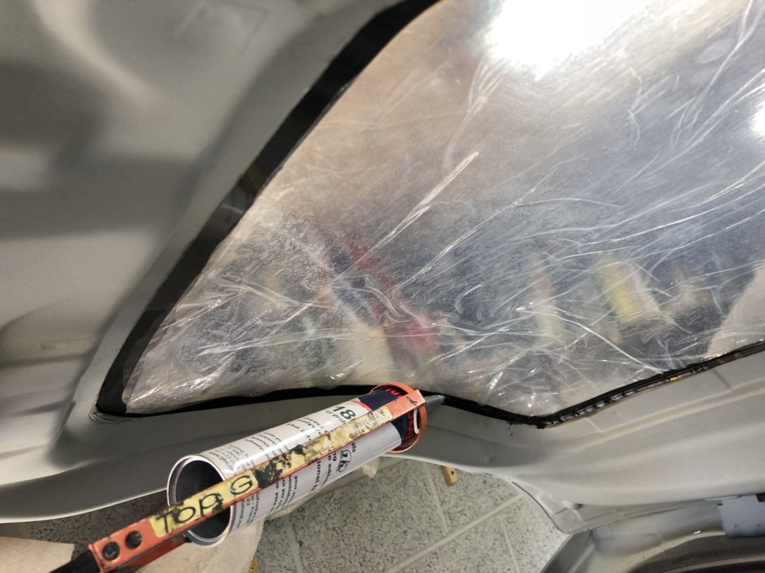

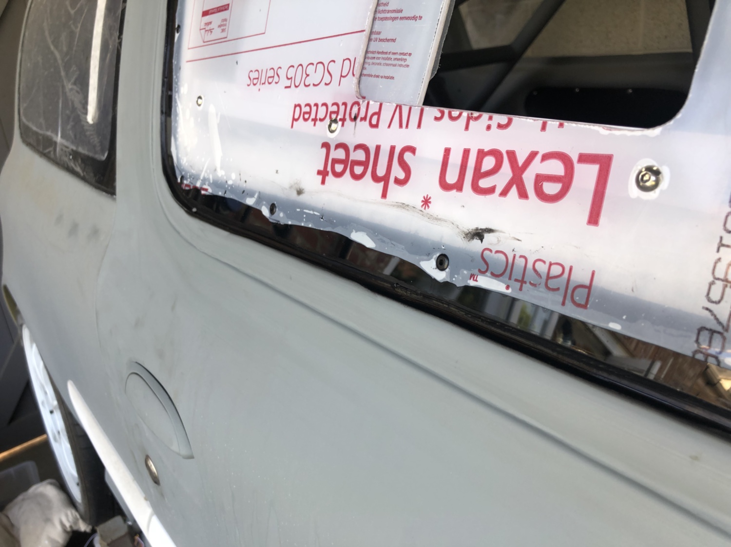

So finally all glass except for windscreen is now in.

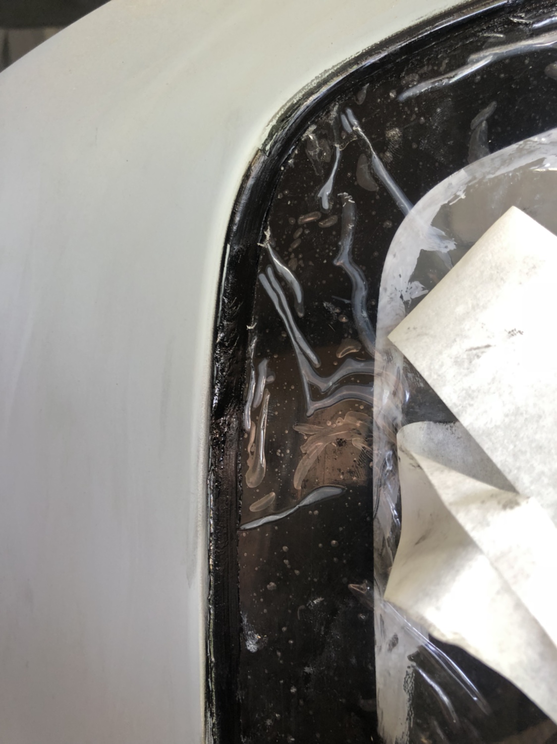

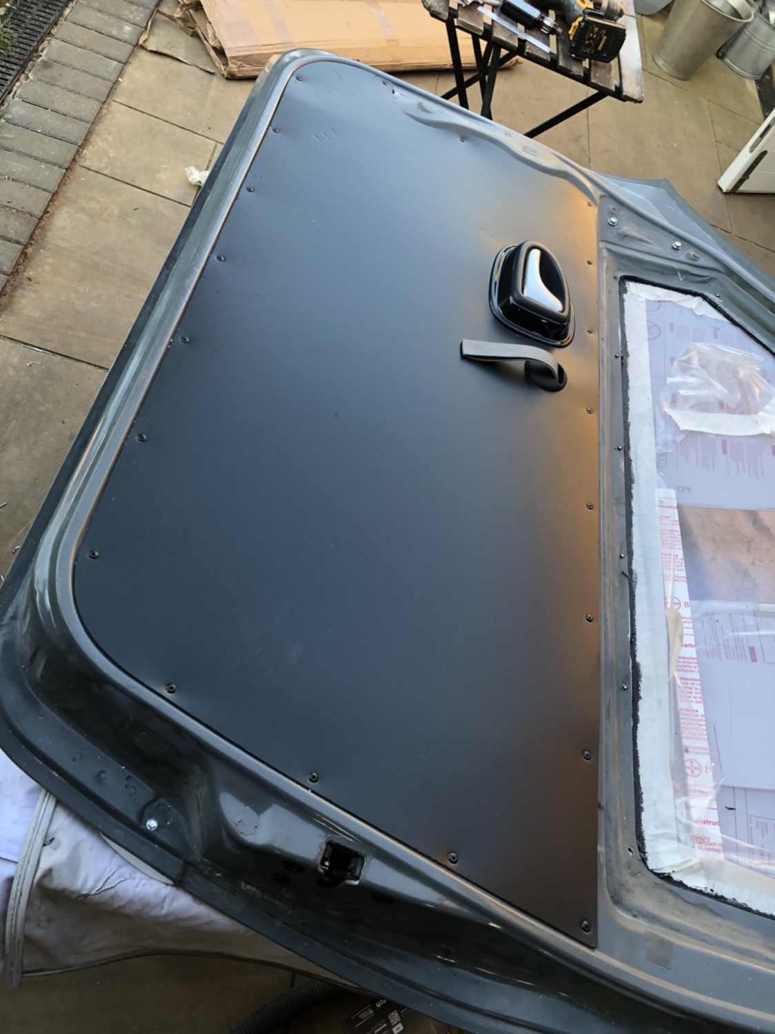

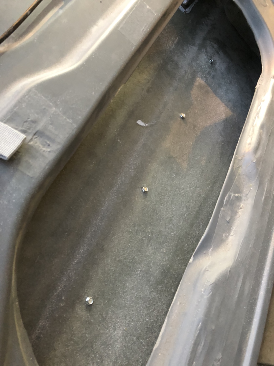

A little neater than rears. Used 4mm black rivers as well. Love black rivers! Unsurprising how rear quarters take 2 tubes of sealant each! But fronts only half each.
And riveted door cards as well. This are light weight 3mm panels.

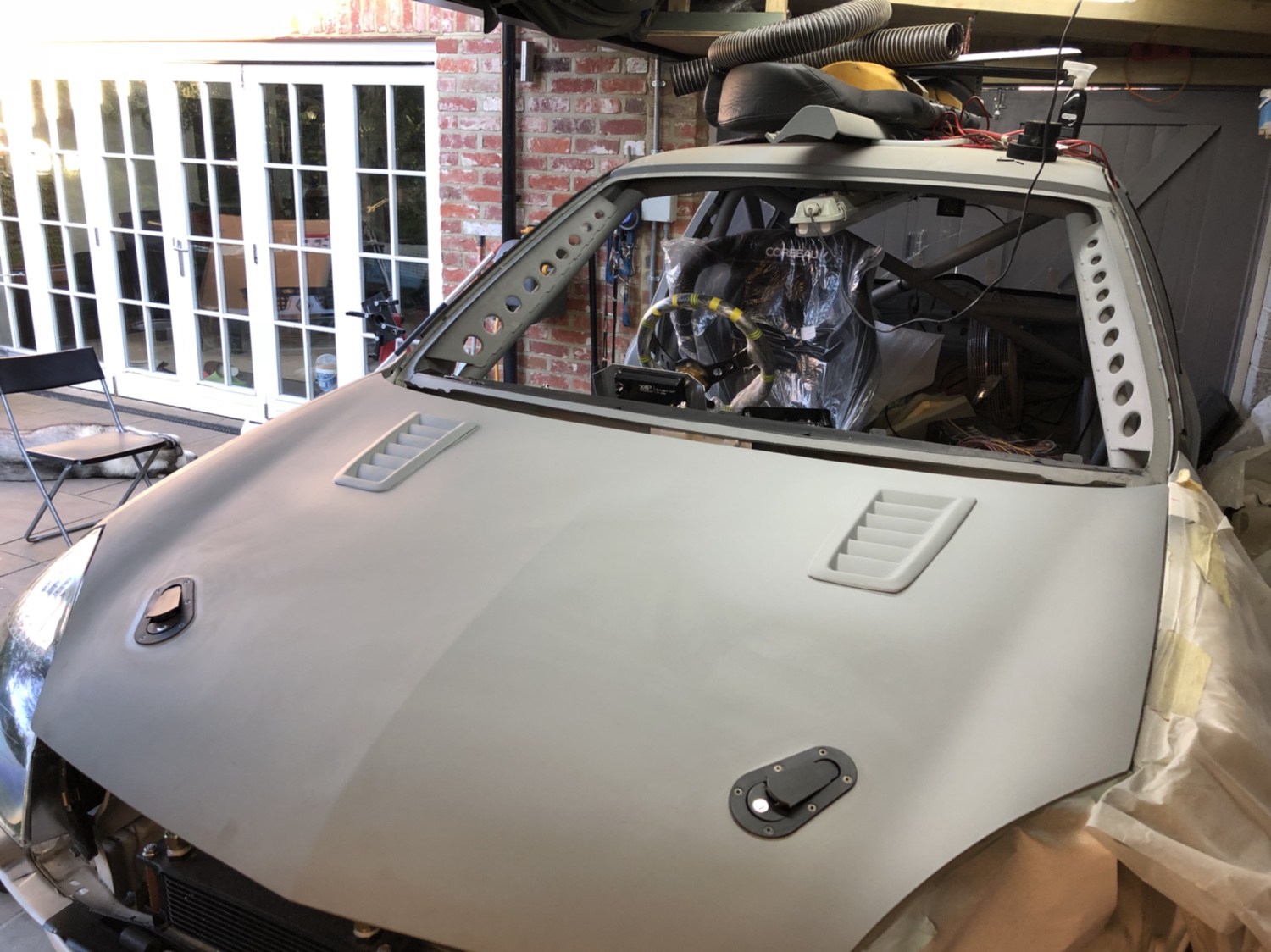

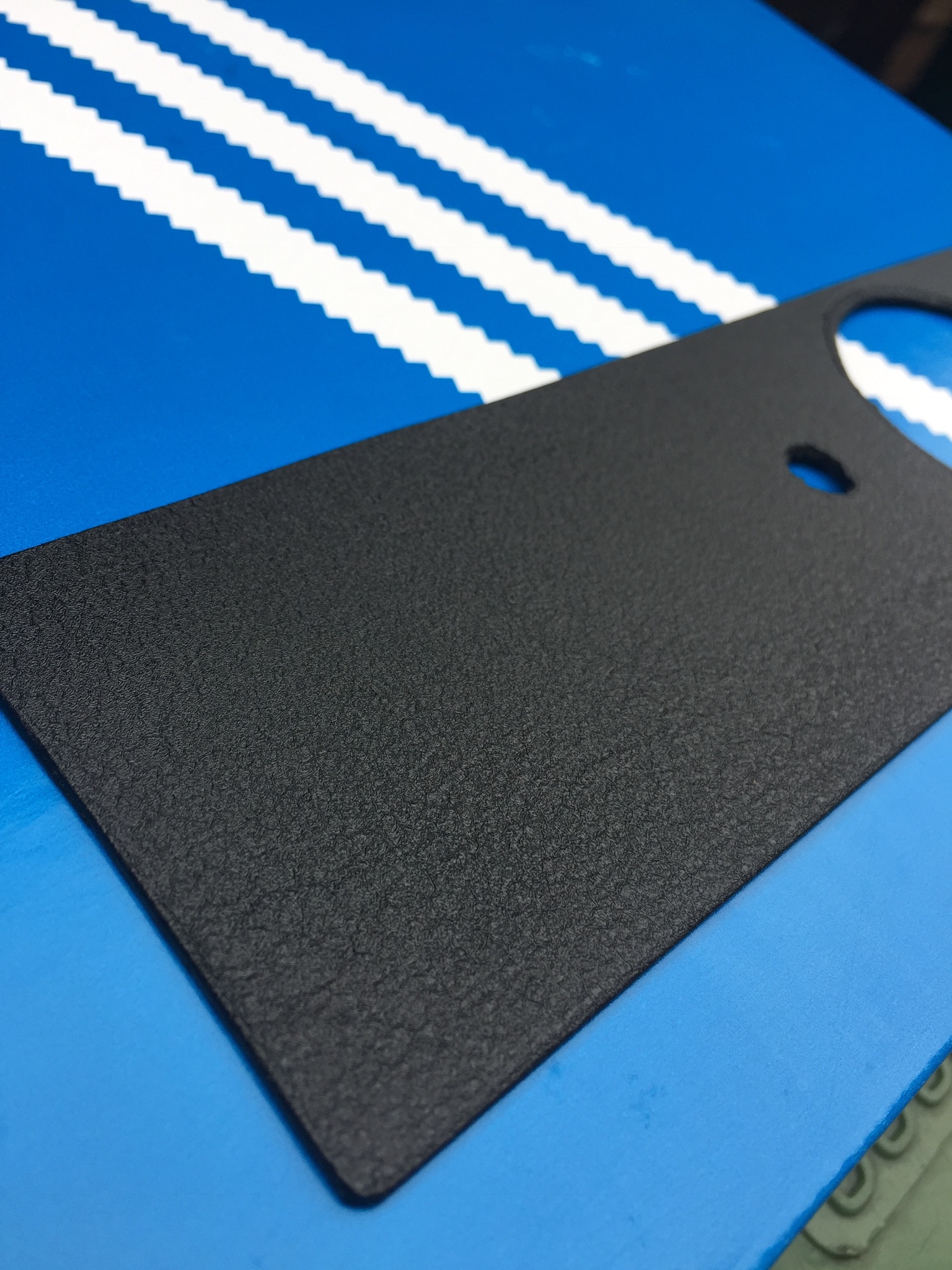

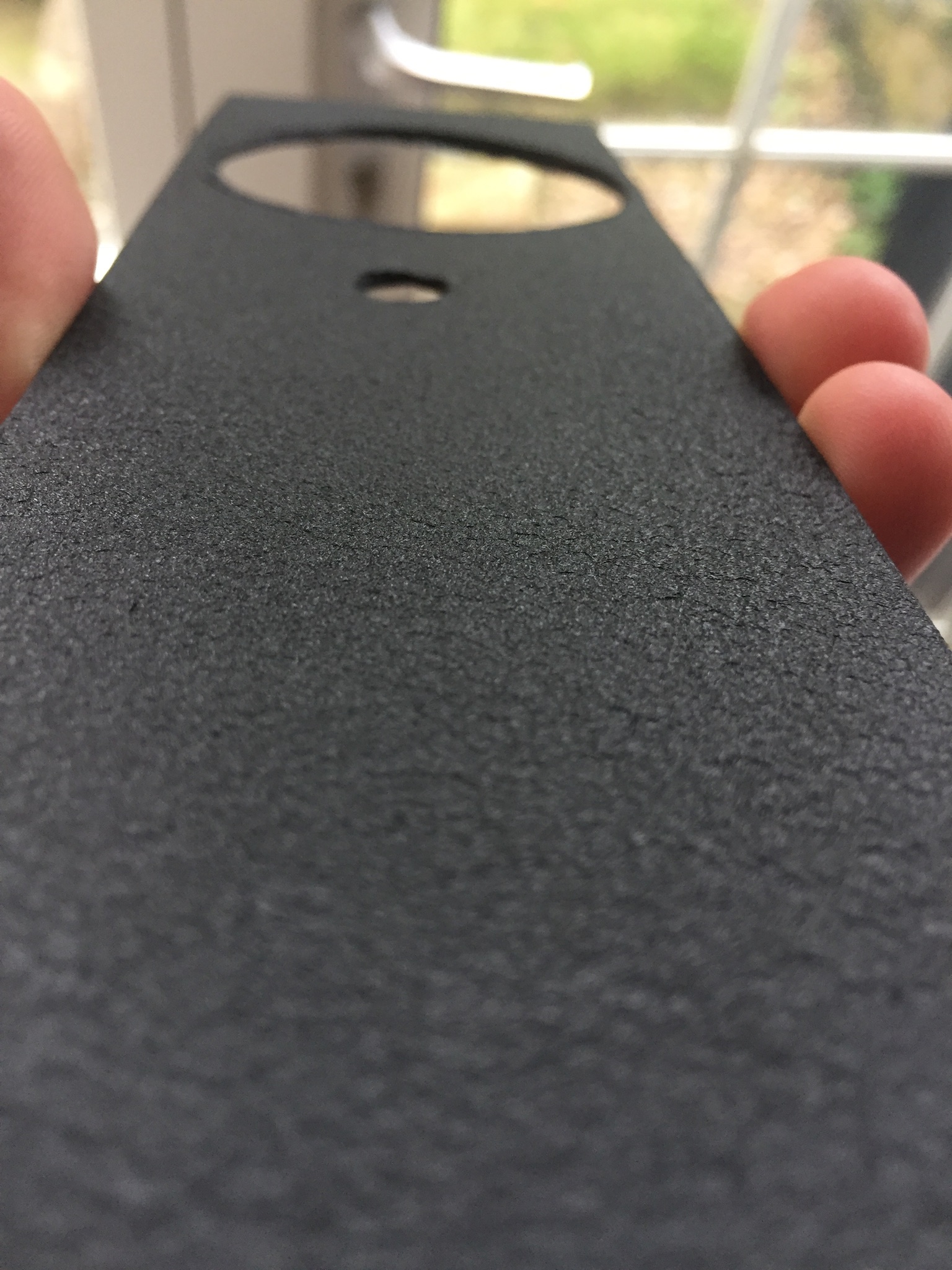

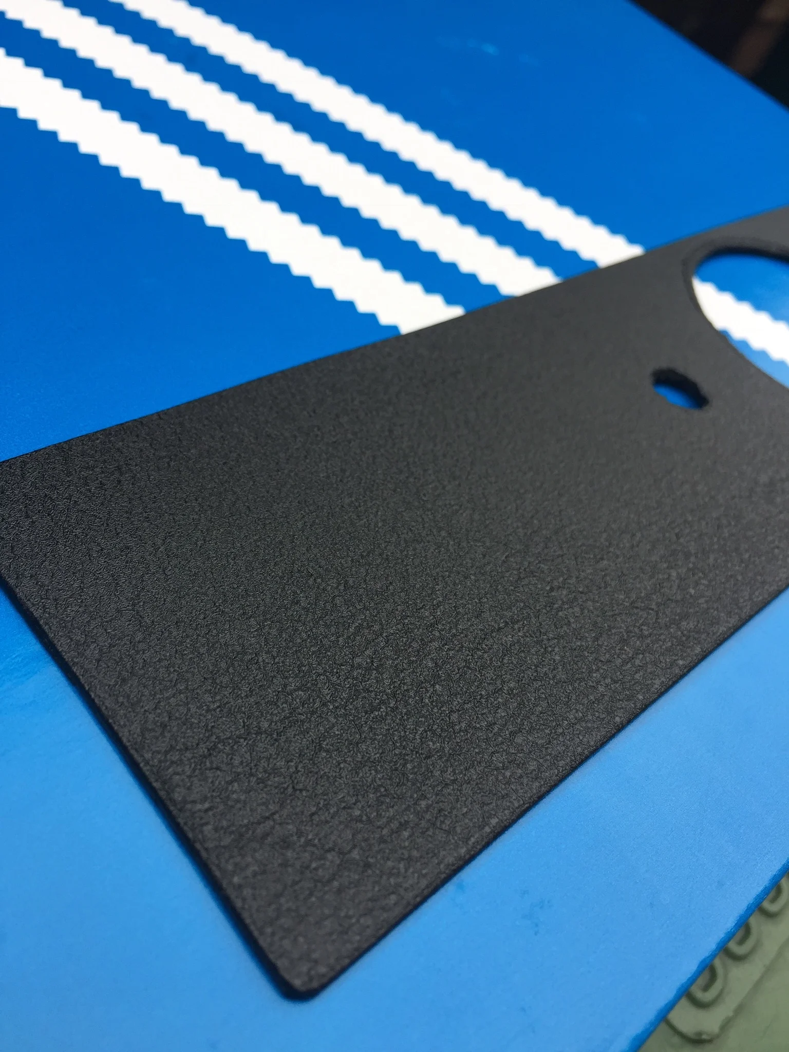

Good work with the airbox! Wrinkle finish ftw! I love that stuff
Are you going to put a vent into the lower part? Or a vent into the bonnet?

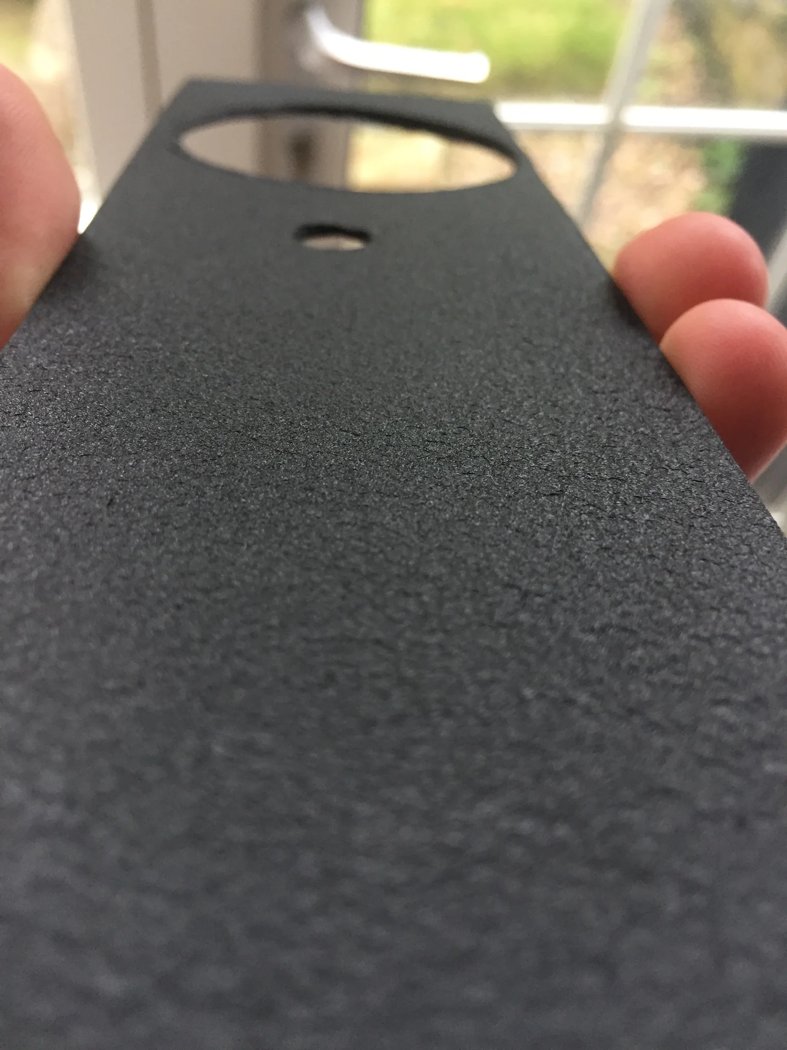

Thanks buddy. The only issue with wrinkle is that it don’t fit in my oven. Either have to make a box to serve as an oven or else.
And yes I have ordered one of this:
will bond it inside the bumper and paint same colour as the car should be seemless. Directly under the headlight.
I put an inlet manifold in the oven once, stunk the house out for days. When I repainted one I found a corner of the garden on a warm day and hungry it from a bungee chord, let it bask in the sun then sprayed it, just used a hair dryer then. imo it came out better than the oven! DId the same with the gauge panel I made too.
Depends how thick you put it on, I put it on quite thick on the panel. Inlet manifold has bigger wrinkles and was thinner coats

Thanks for this buddy! I have used my oven before. It does stink a bit. But I have huge patio doors and had large industrial fan blowing air as well. Did it while wife was at work and she dint even notice the smell. I did run the oven at max temp for 30-40 after to kill of the smell and gave it a good clean as well. But hanging in the sun and using heat gun, seems like a good shout mate!
Where did you get your polycarb sheets from ?
Bought it from Templarperformance.co.uk
But had to trim the fronts as they were meant for steel doors, not fiber glass.
wasted a bit of cash there as could have just bought flat sheets and the sliders separately, but hey ho. live and learn

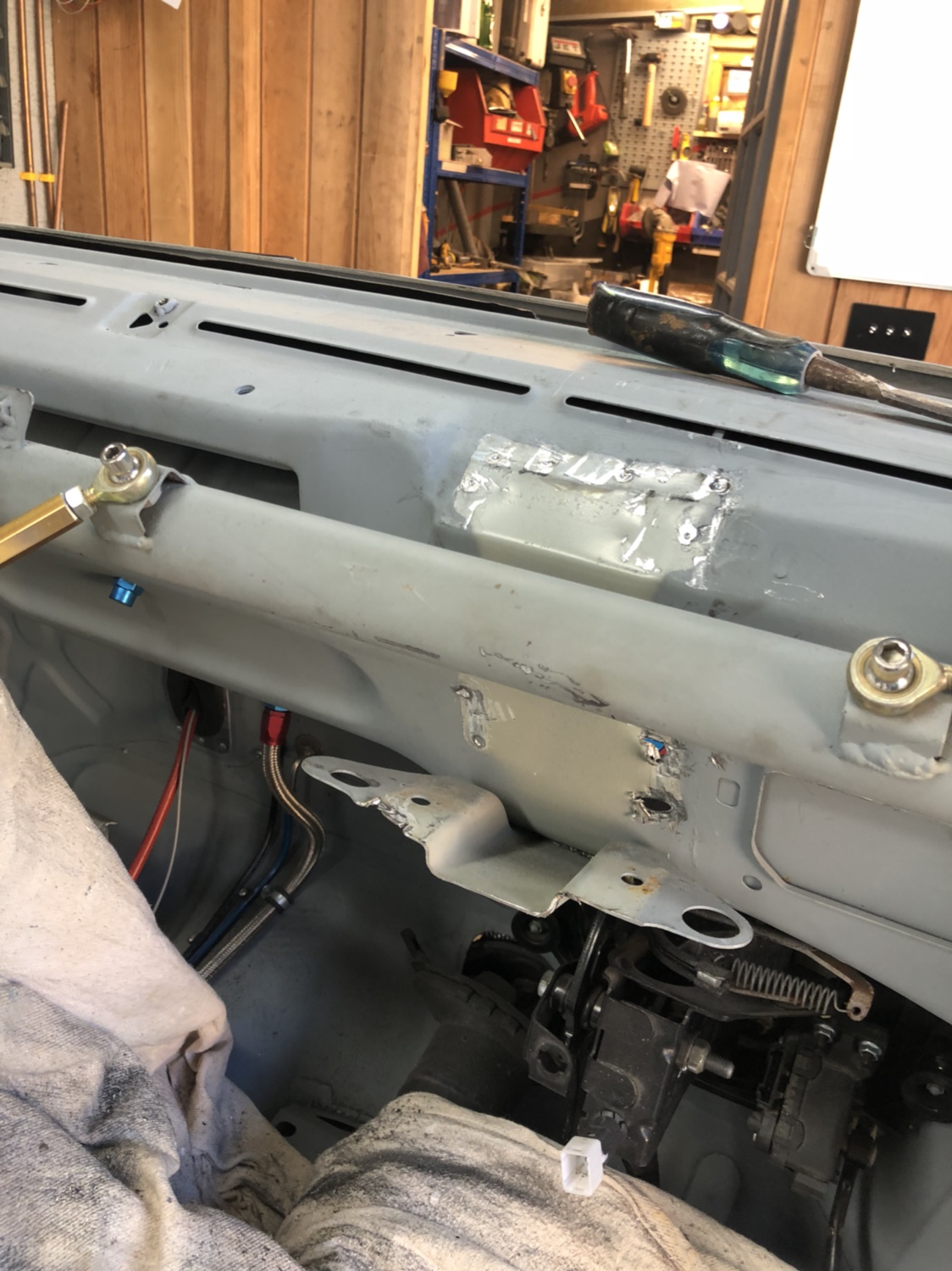

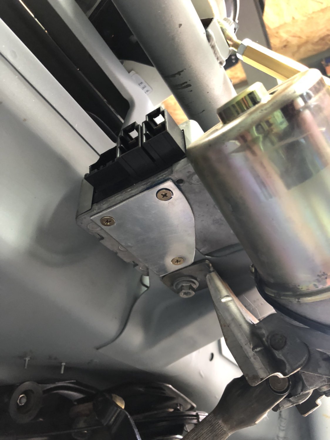

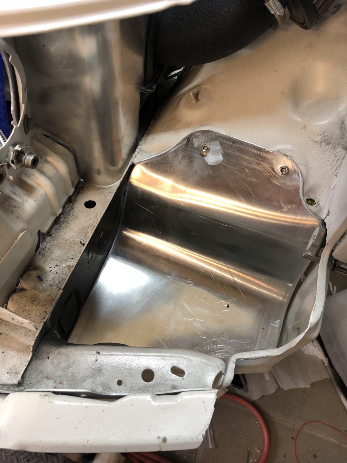

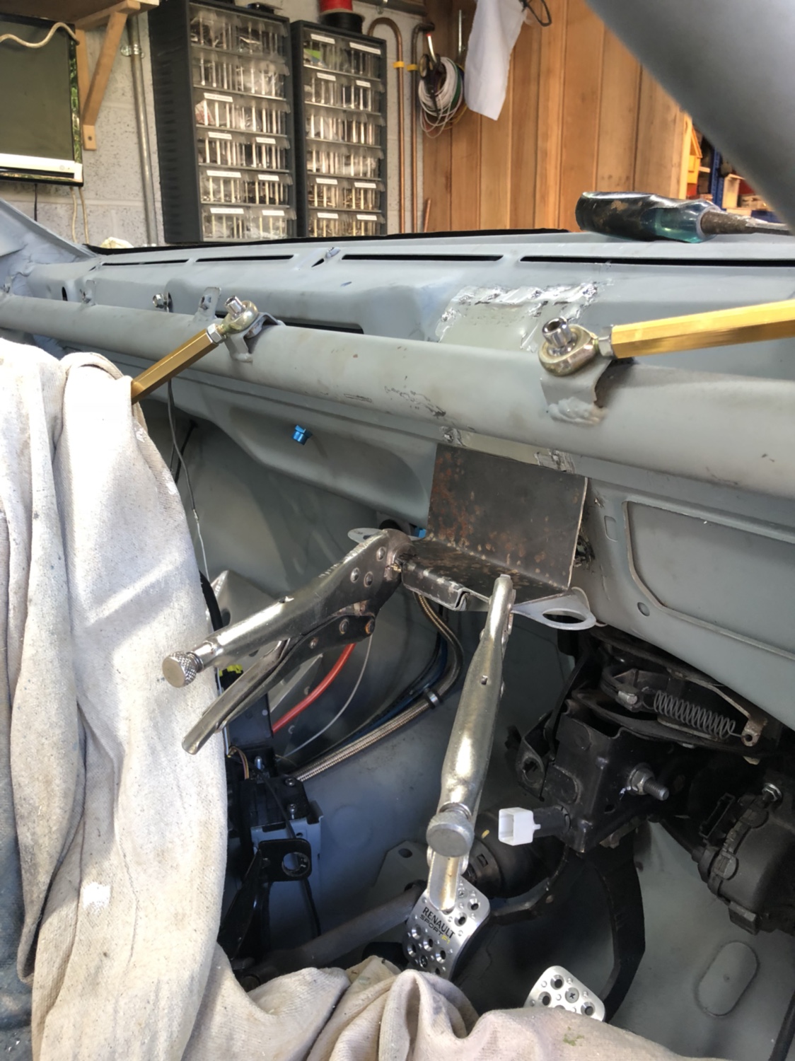

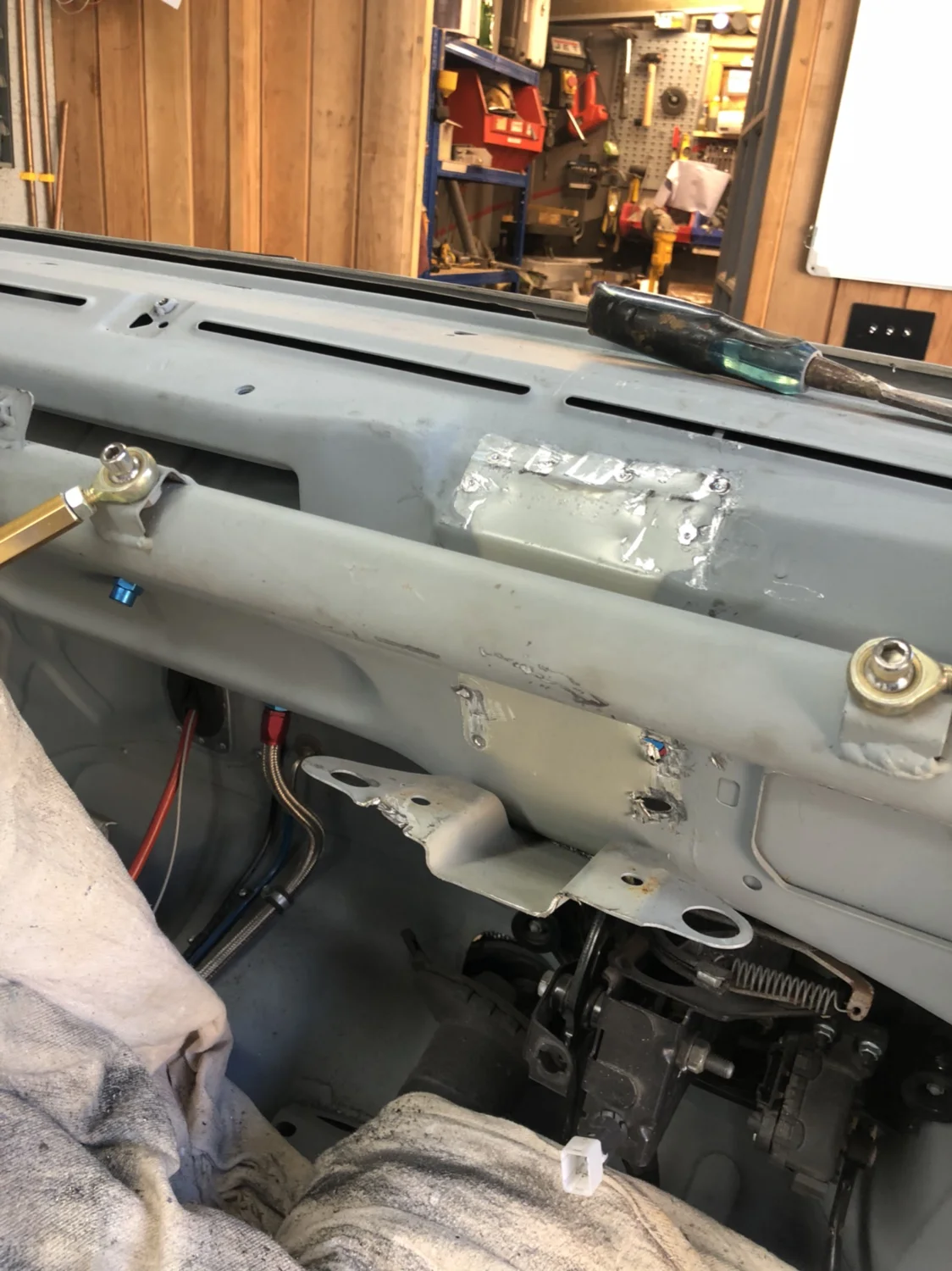

Did a bit more weigh saving. Somebody on Facebook asked me why do I still have the original steering column mount/bracket.. I honestly did not know how to answer that so decided I don’t need it [emoji23]

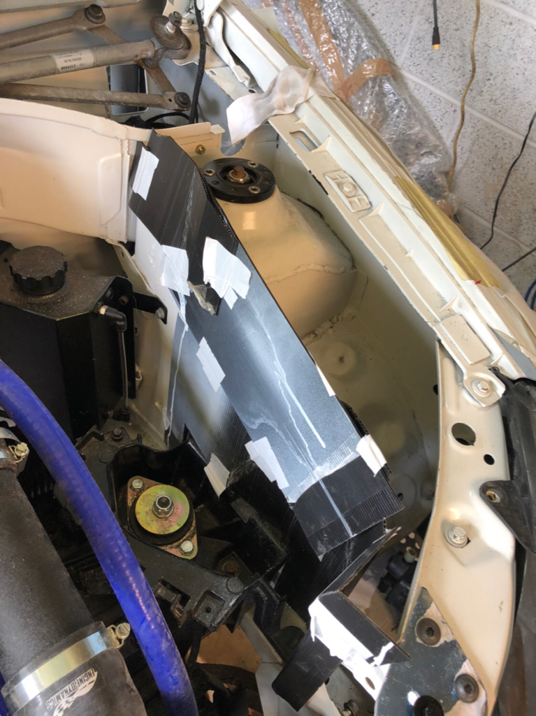

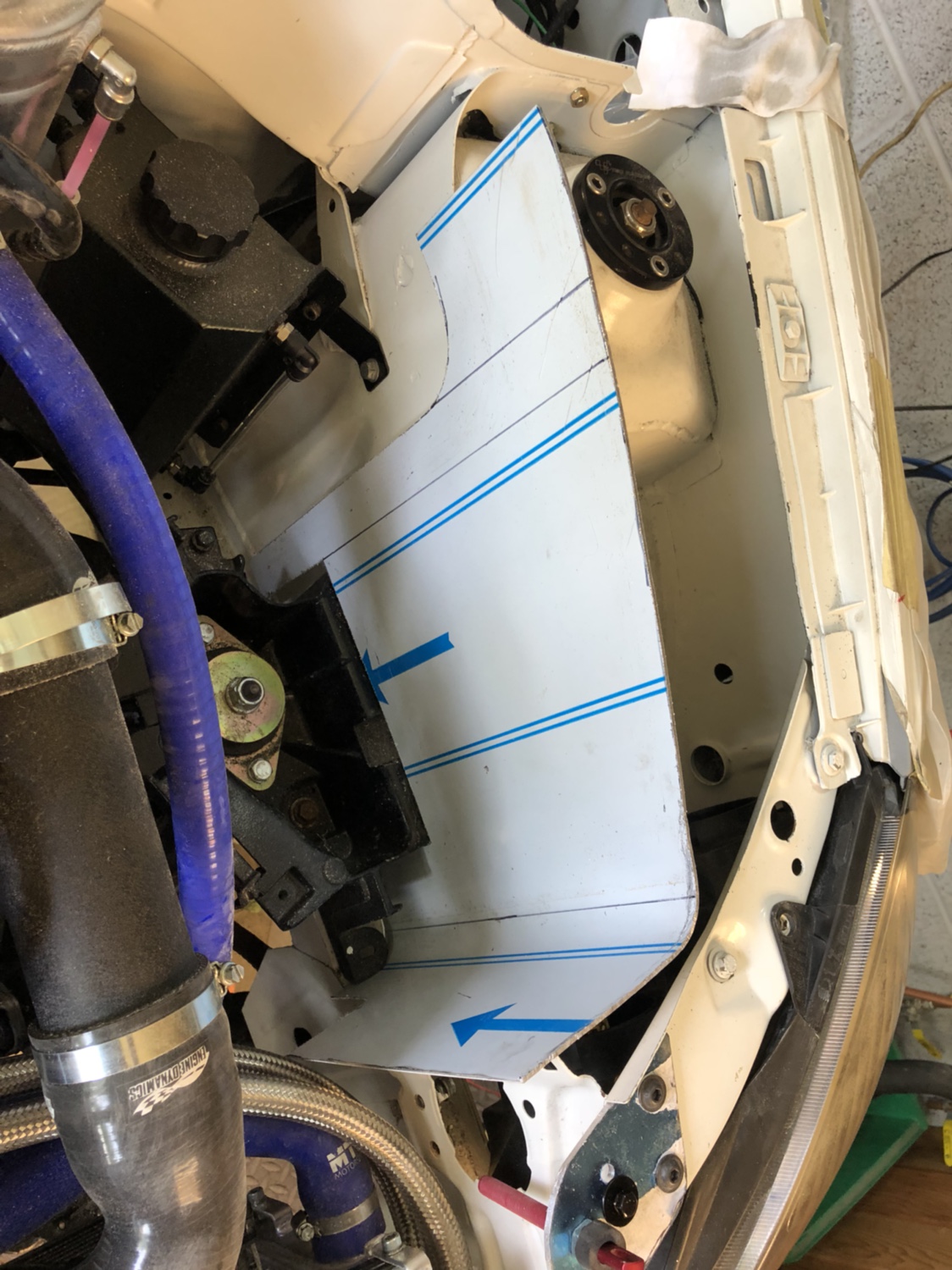

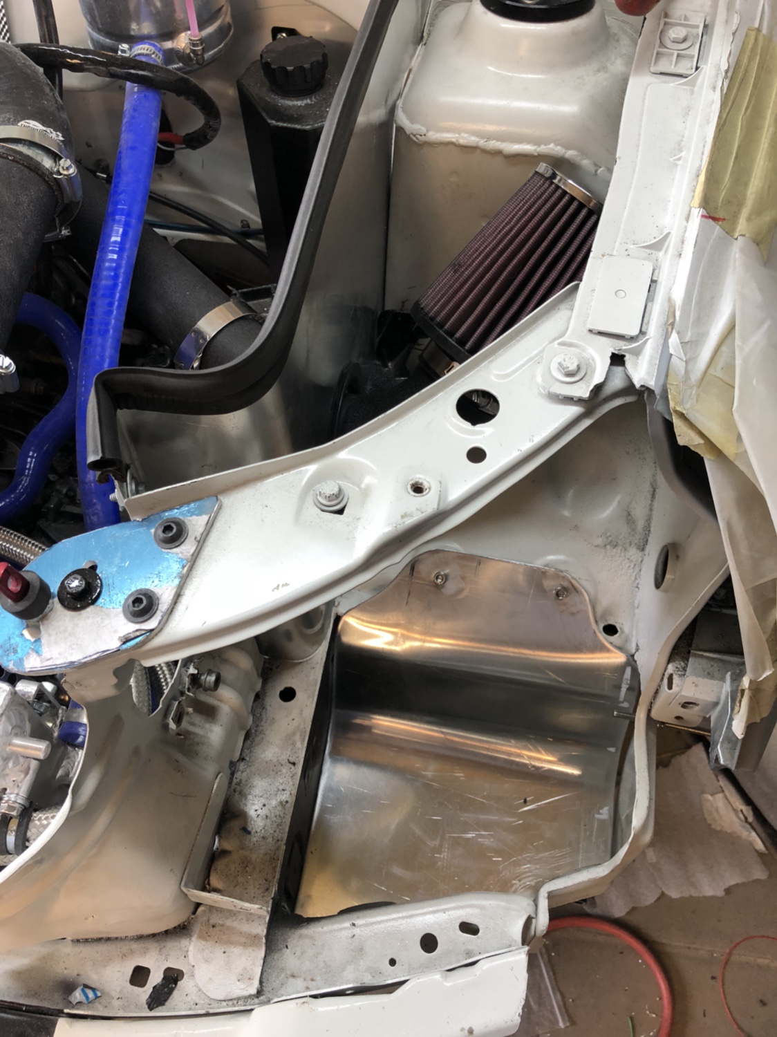

Also a bit more cooling for the engine bay.. because why not..

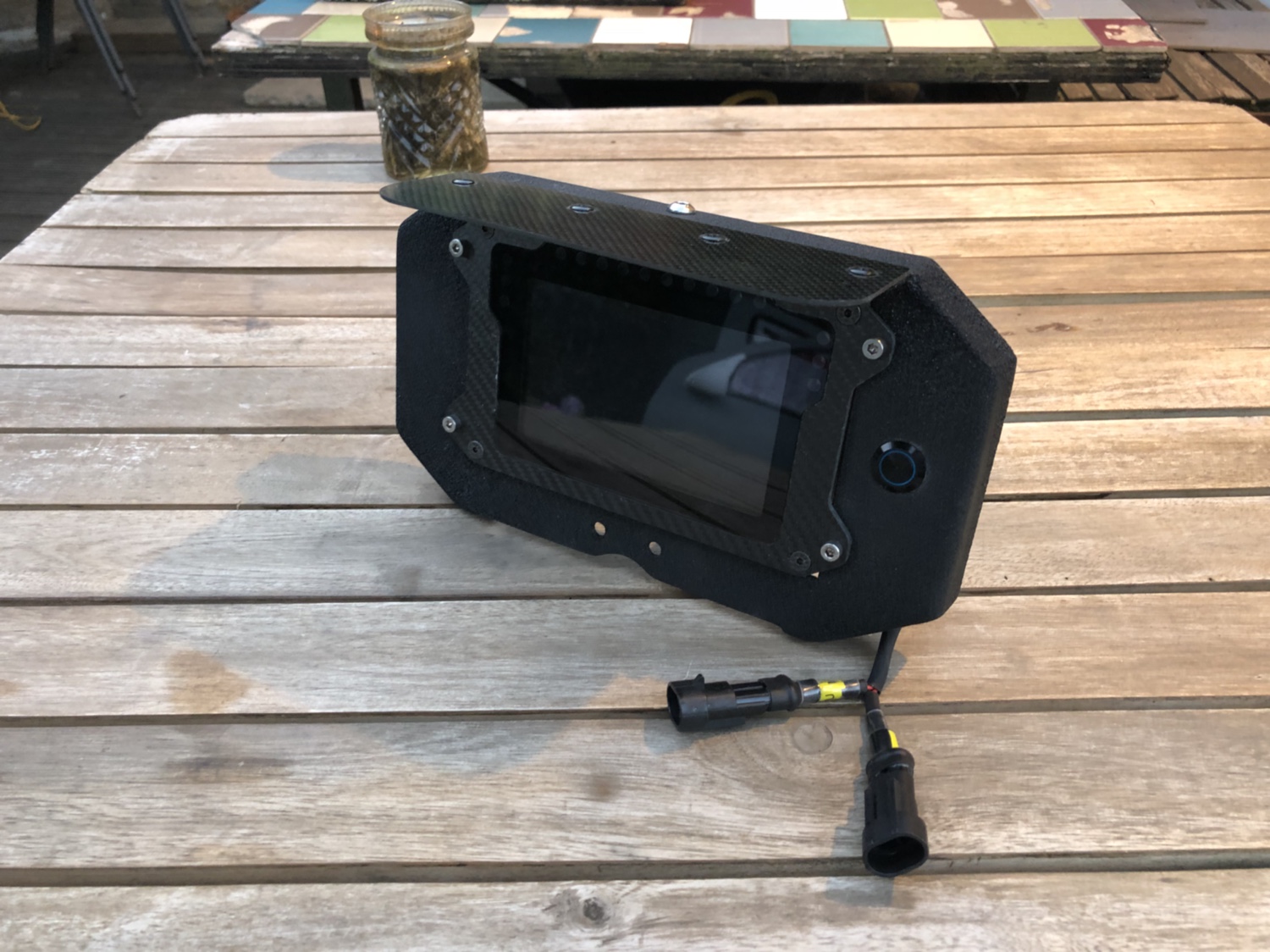

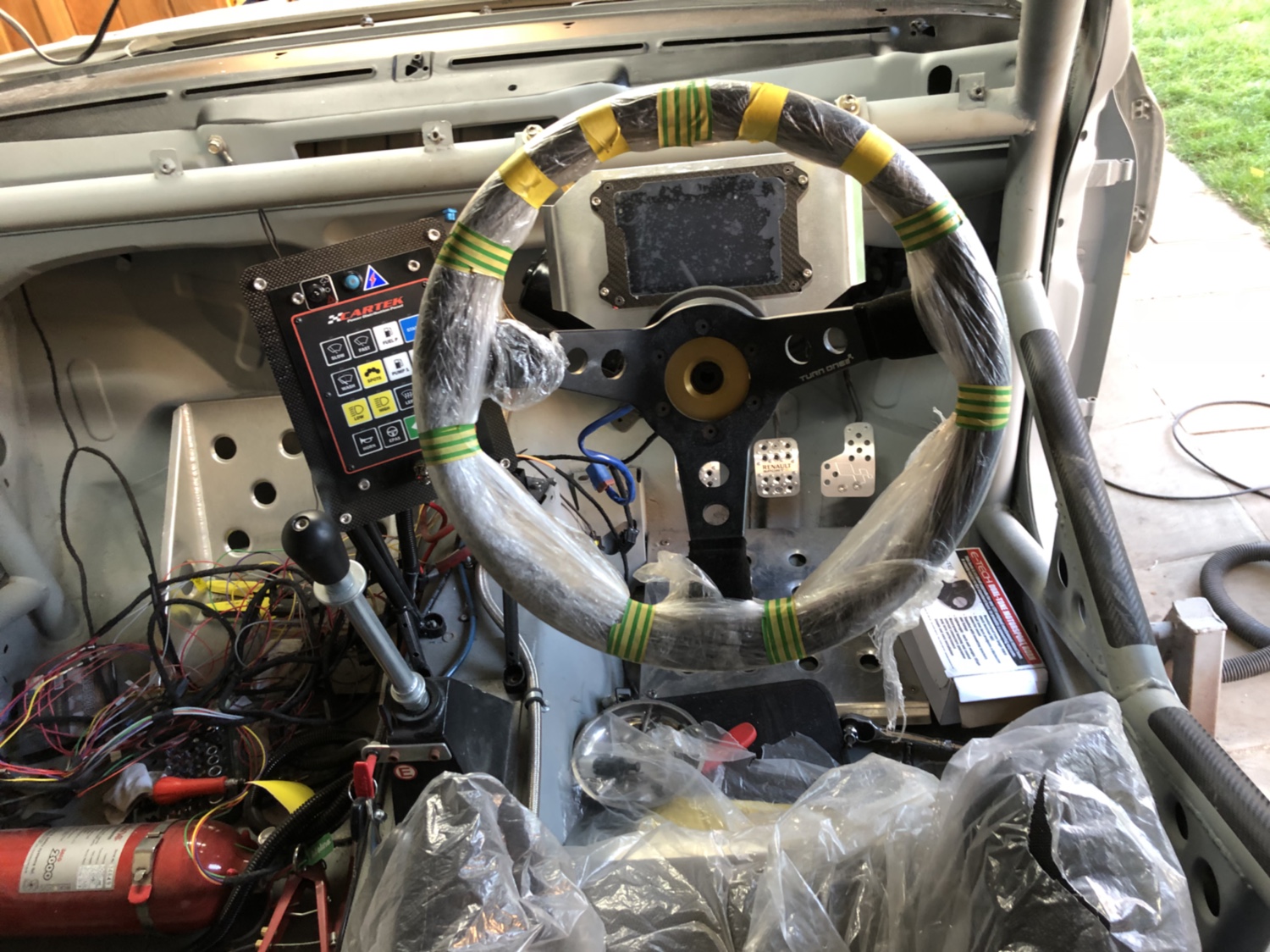

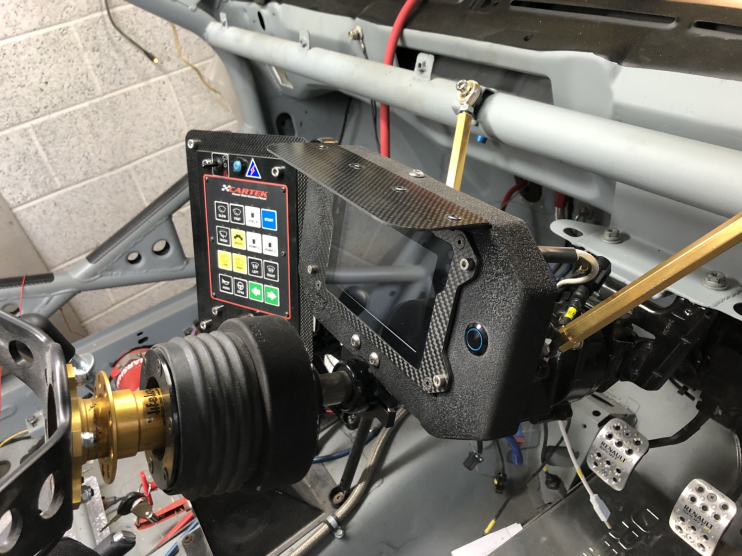

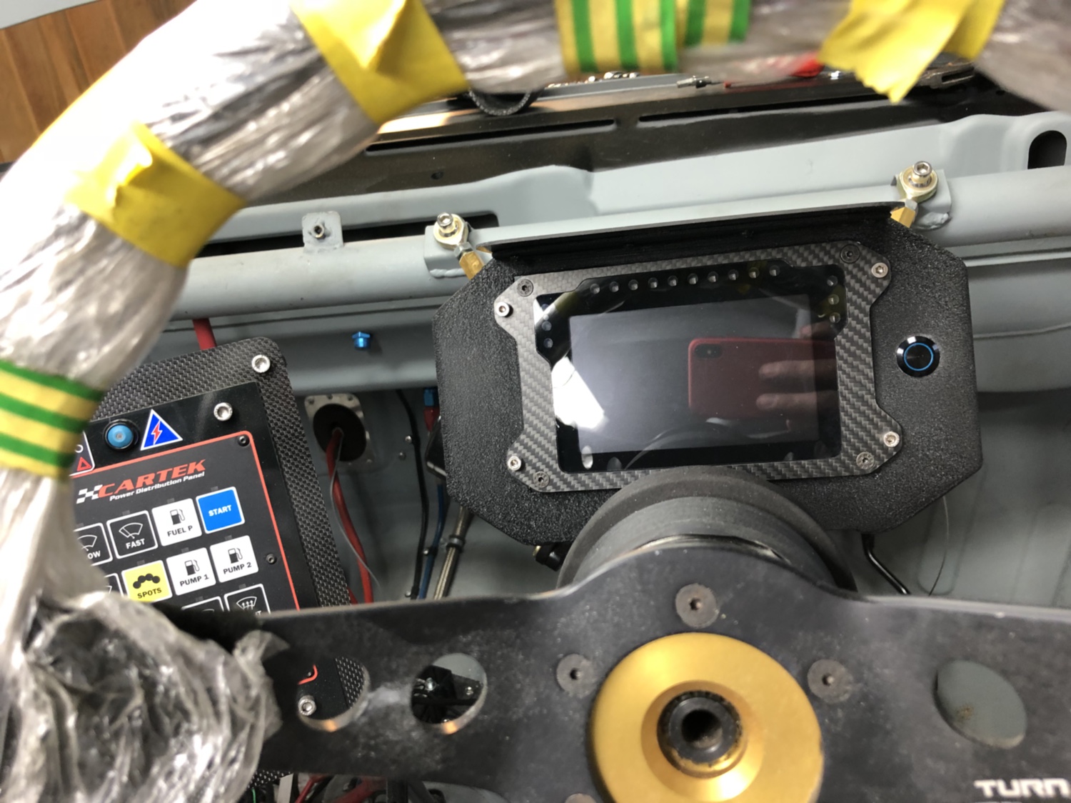

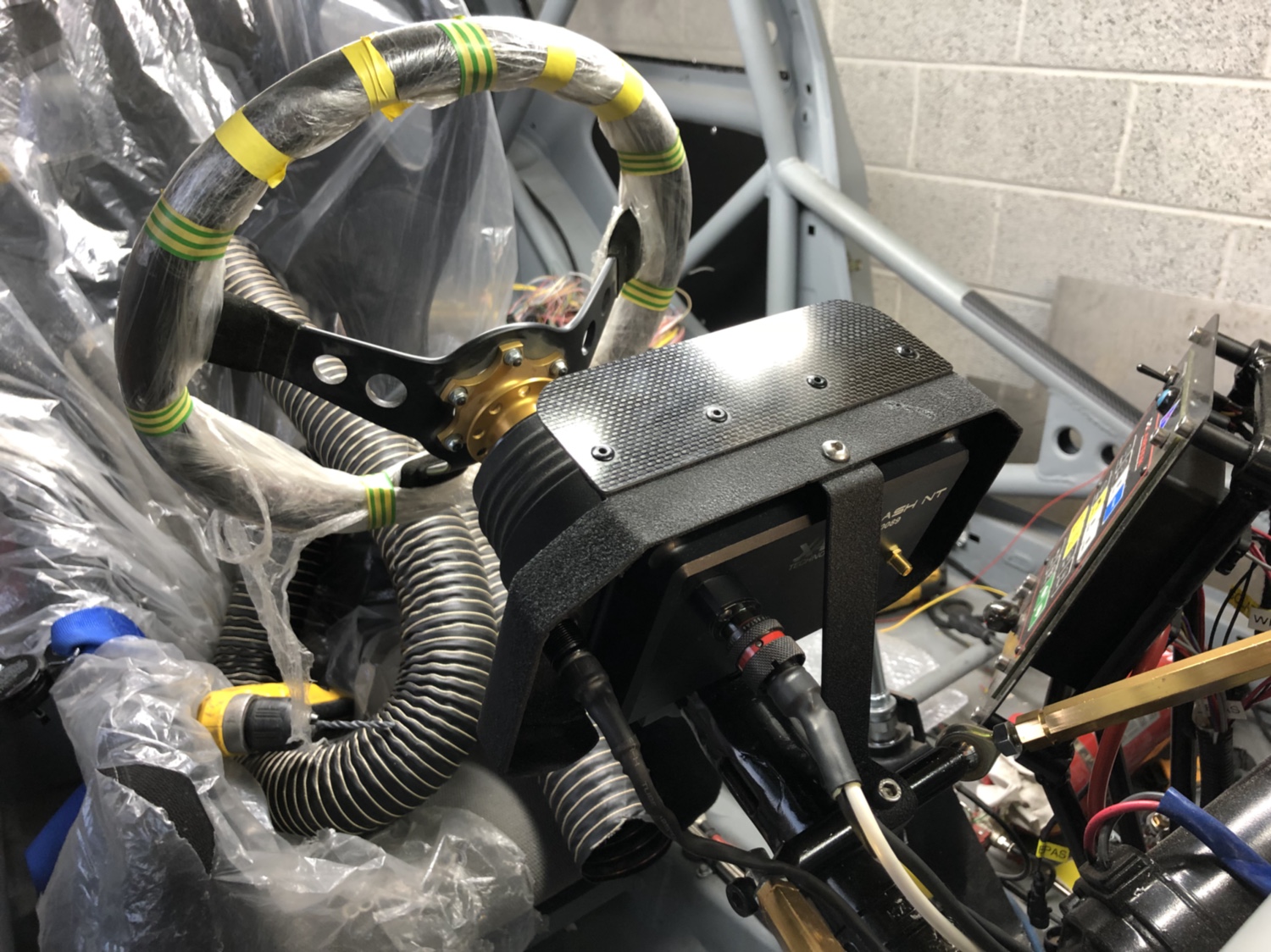

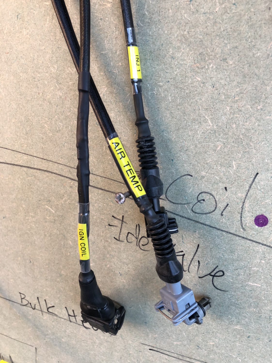

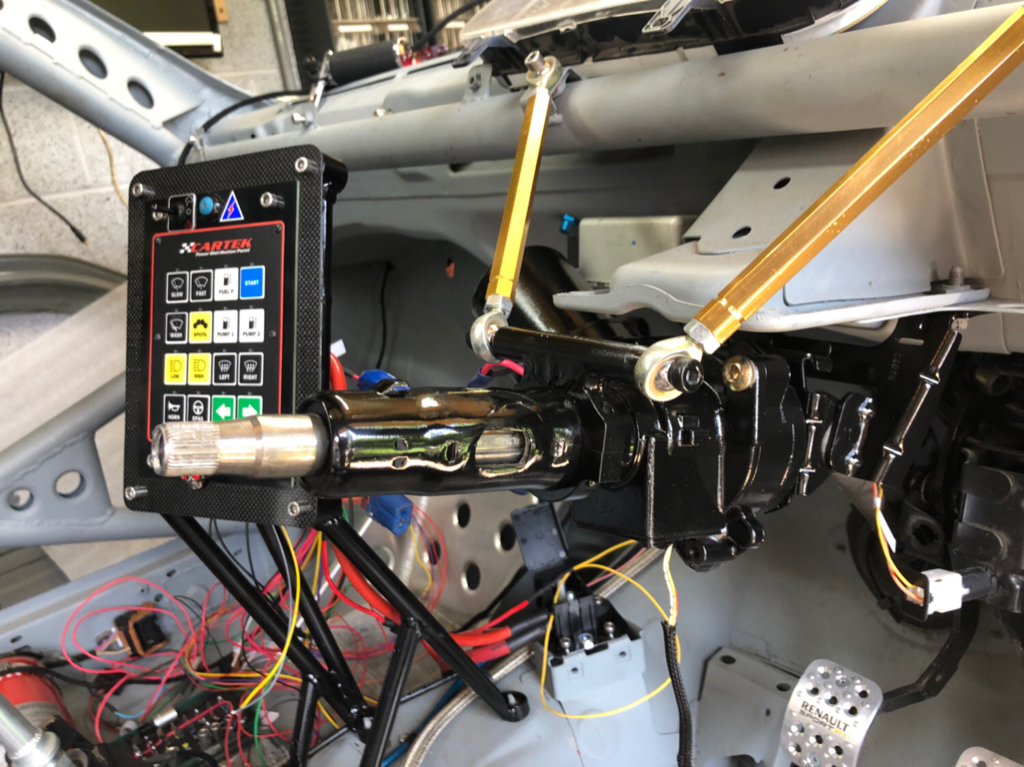

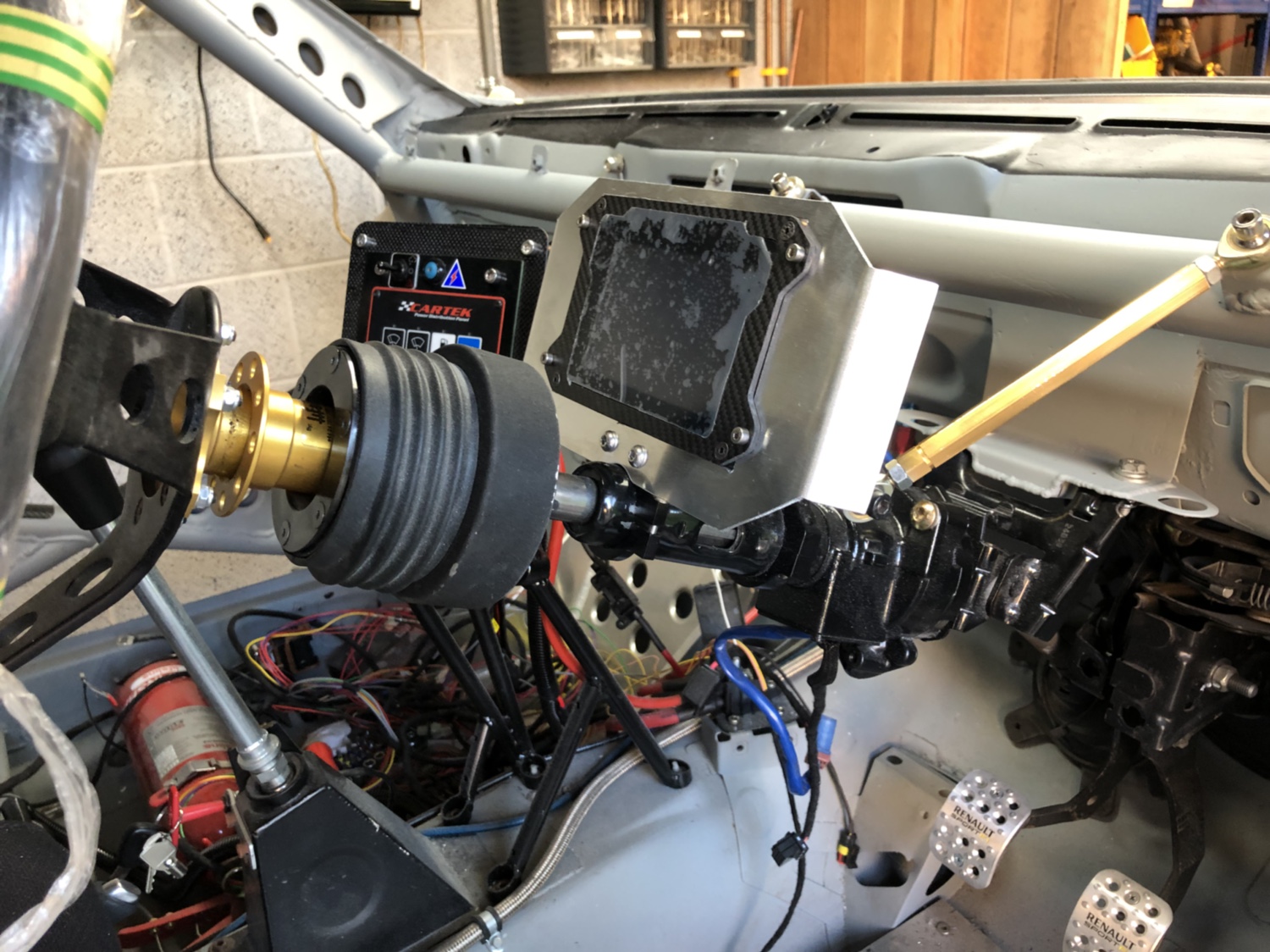

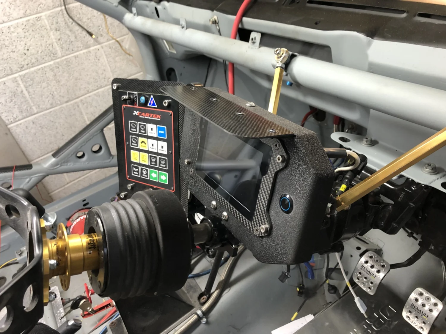

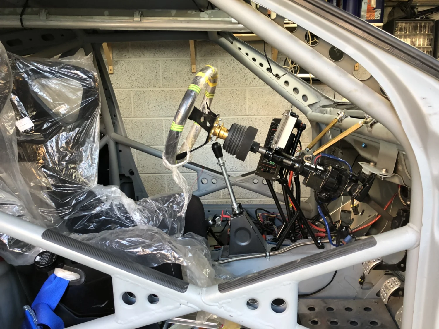

Found a better place for the dash. Directly on the steering column. Made a little plate for it.
Next is to wire it all.. exiting. I can almost see the light at the end of the tunnel... almost.

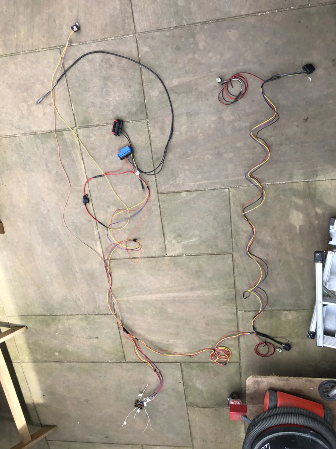

i told chris if you had the bits on a friday you'd probably have the loom built by the monday!!
Just want to drive this thing already [emoji28]? how i am still married is beyond me...
July.
There was no progress for 2 weeks at all due to work commitments. Screw you paid Jobs! [emoji23] only kidding!! Car won’t pay for itself.

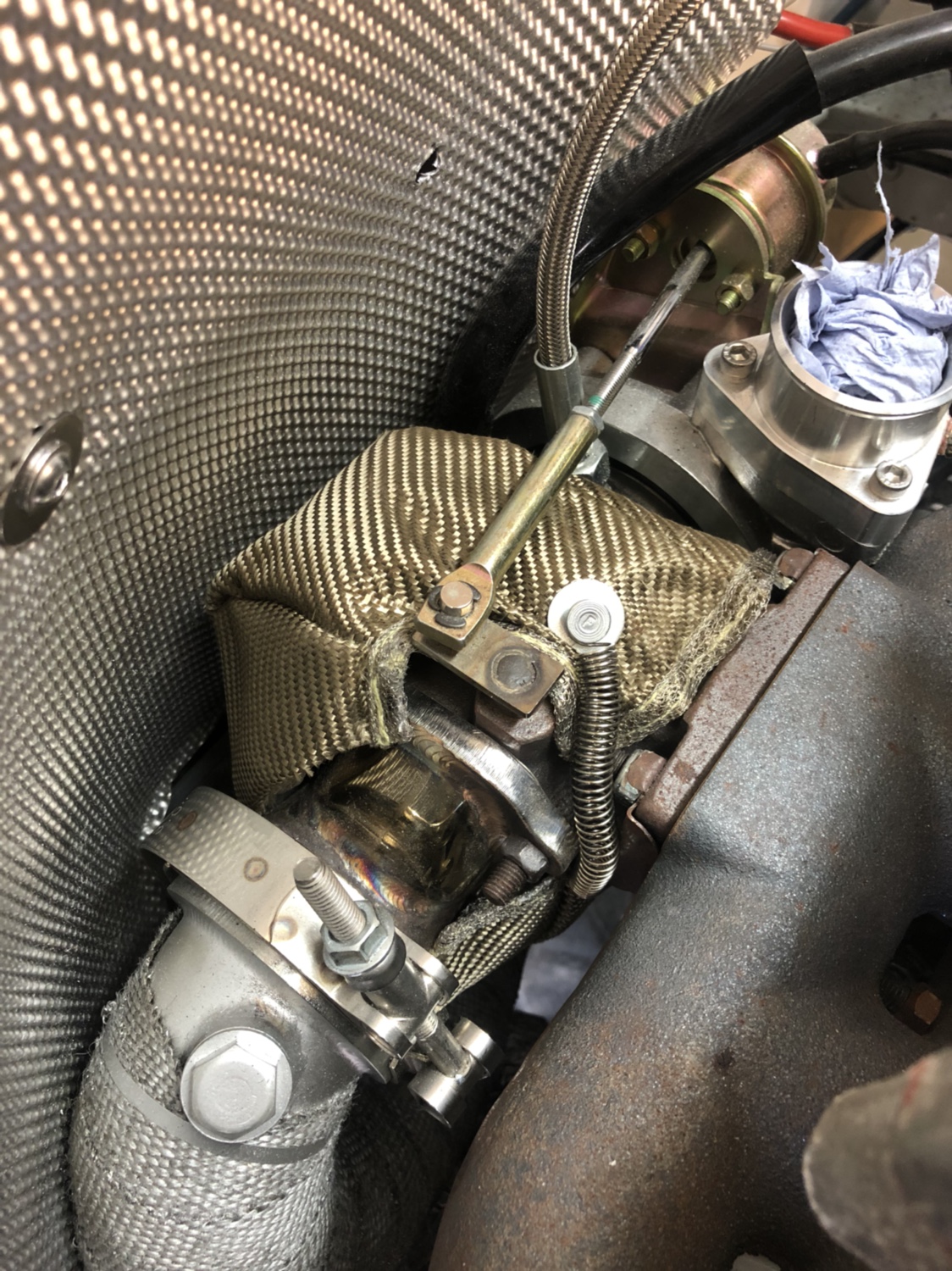

Right first thing was to fit turbo blanket. Not much of a job but will greatly reduce under-bonnet temp.
Courtesy of Funkmotorsports

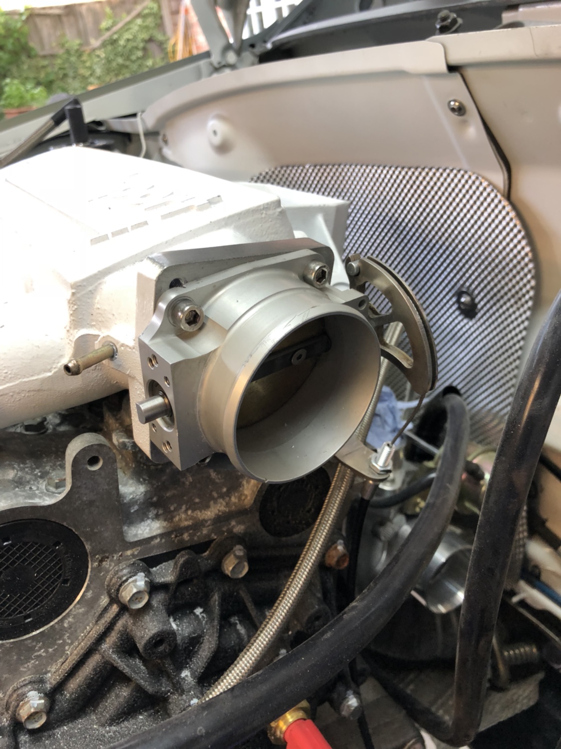

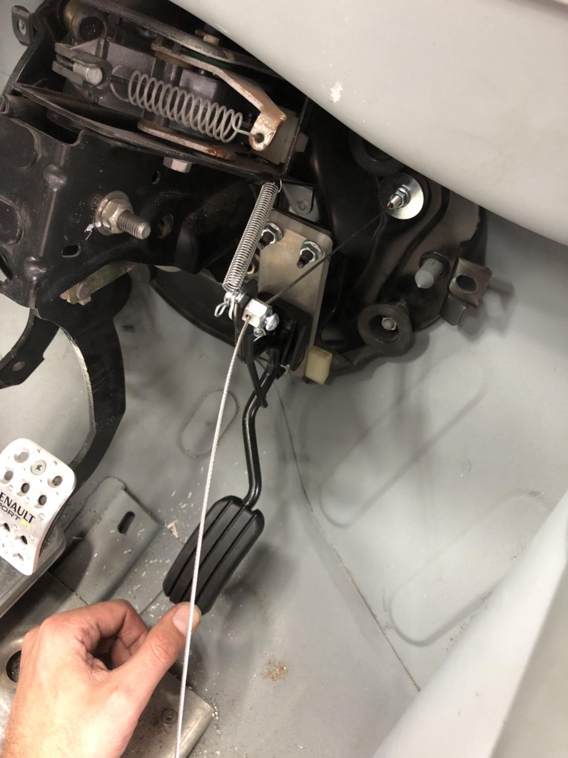

Than I fitted Ph1 throttle pedal and new throttle body.

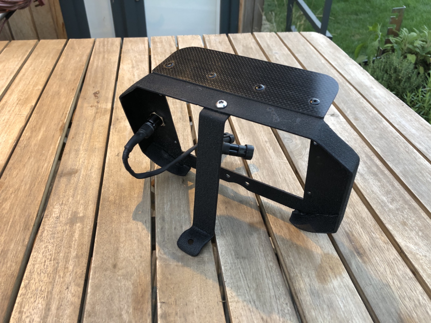

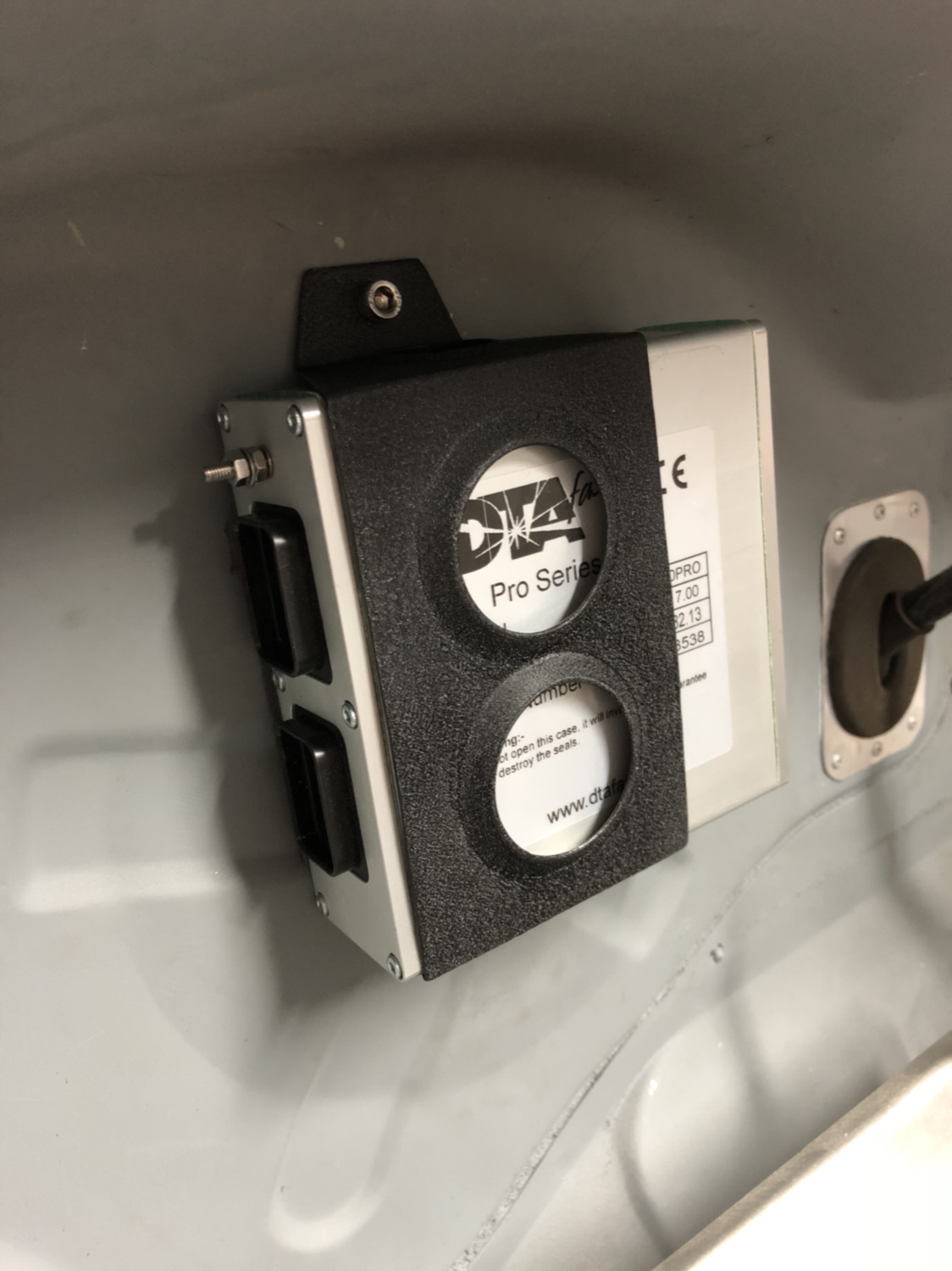

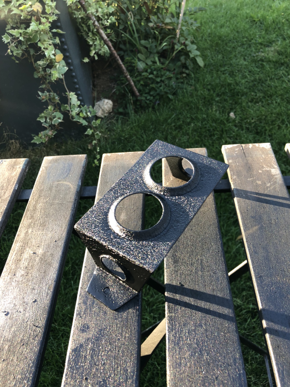

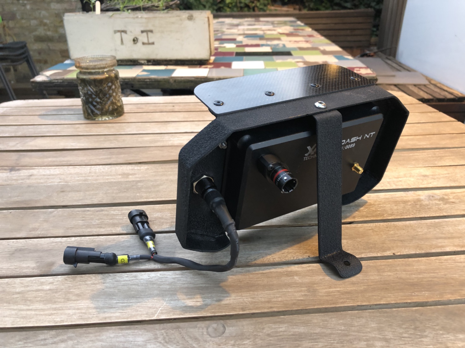

Now I needed to properly fit the dash. It’s one sexy bit of kit so it deserves some precision haha so I made this! Extremely happy how it turned out. Button on the right is for flipping through screens. 2mm ally and a dash of wrinkle, all home baked in the gas oven while the wife was out [emoji51]

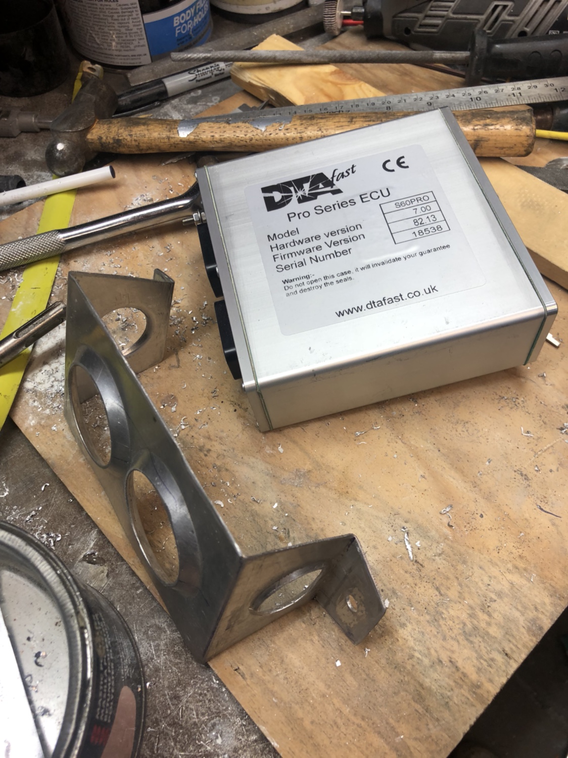

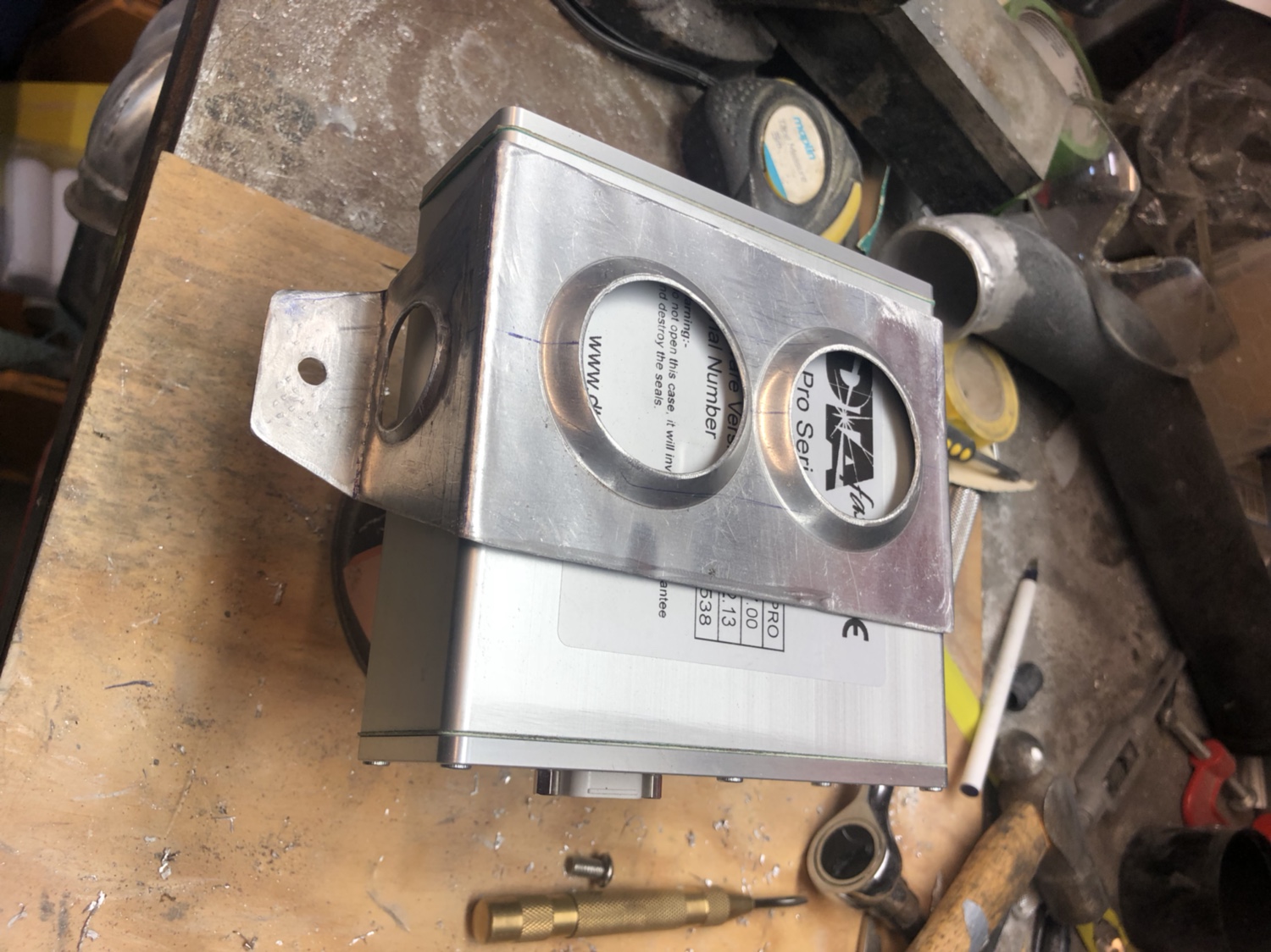

Also the ECU needed mounting, so 1.2mm ally off cut came in handy!
Loom is almost complete, just waiting for IDLE CONTROL VALVE. The plan is to have it running by the end of the week. ?

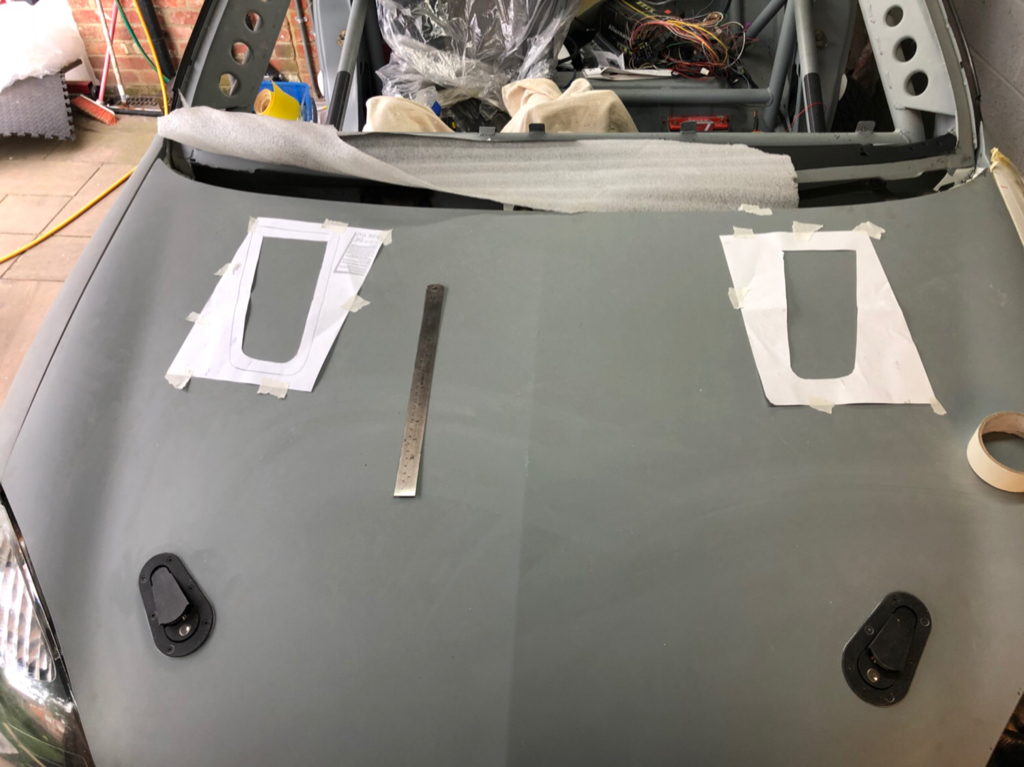

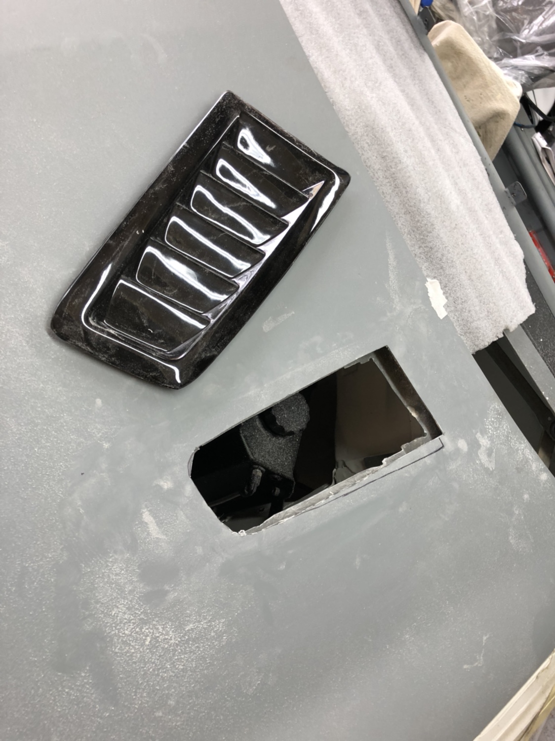

Dash pod and ecu bracket look great, I love wrinkle finish paint. Probably a bit too much tbh....
Bonnet vents look good too, not too ott
