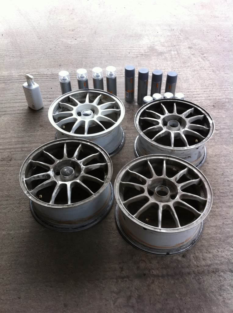

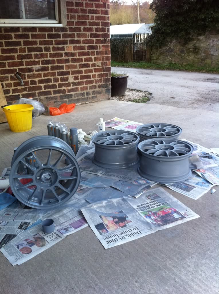

Been travelling all over Derbyshire today collecting things and having wheels stripped of tyres.

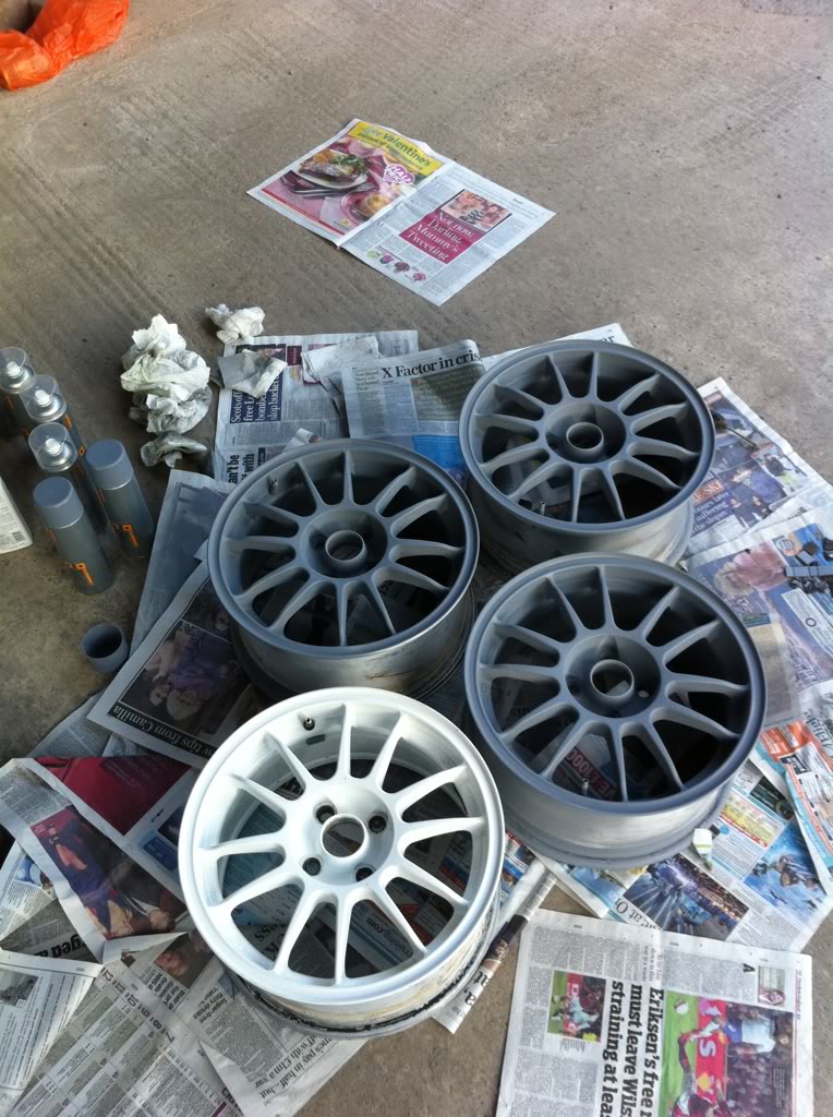

Managed to primer up all 4 superleggs today, paint shall commence tomorrow. Who knows what colour though ;)

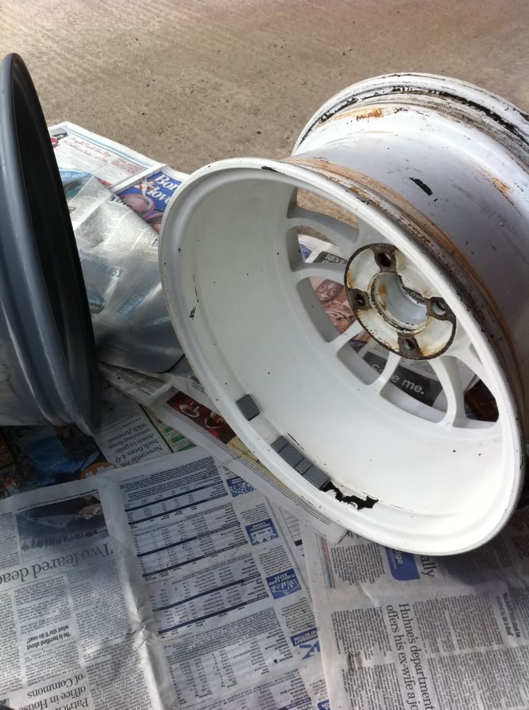

Removing the wheel weights and glue was a pain in the arse... much tar remover was needed.

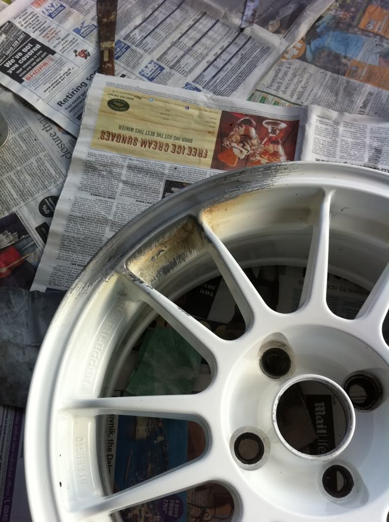

errrrr not sure what happened here....

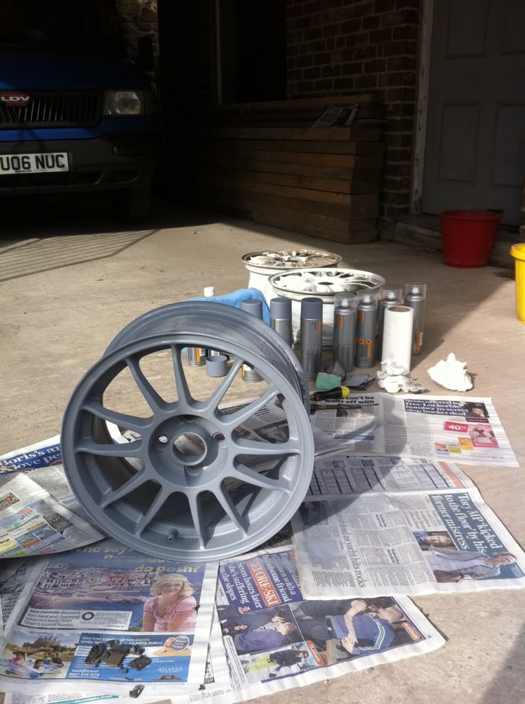

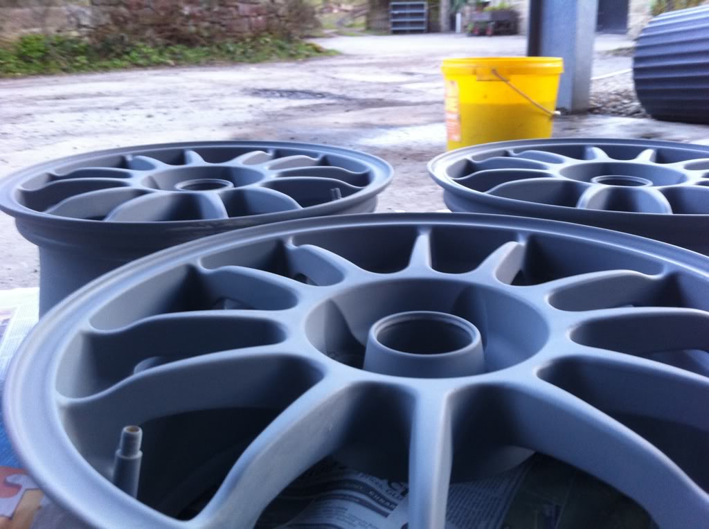

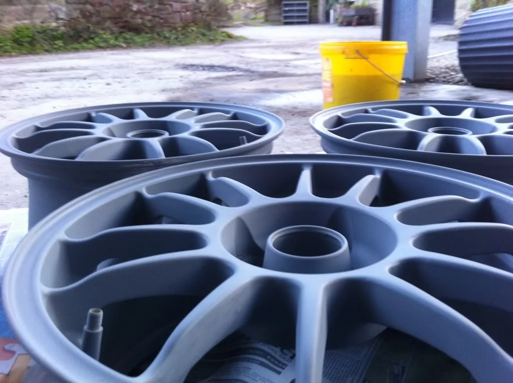

and one to show the finish so far in primer. Nice and smooth for paint :approve:
Firstly why didn't you pull the valves out? and secondly did you mask the part of the bolt holes where the wheel bolt collar/shoulder contacts the wheel?
  S4 Avant
Meh, no ones going to see under the valves, and the paint will be removed from the bolt holes and mating face of the wheel, I'm not an idiot ;)
I'd have done it on the logic they'll throw new ones in when the tyres are fitted and balanced anyway, as for the latter part this is CS so it's worth asking these things lol
  S4 Avant
I'd hope they fit new valves tbh, but as I looked at these and saw that the design meant they're pushed in, but can't be pushed back out, I couldn't be arsed with cutting them.

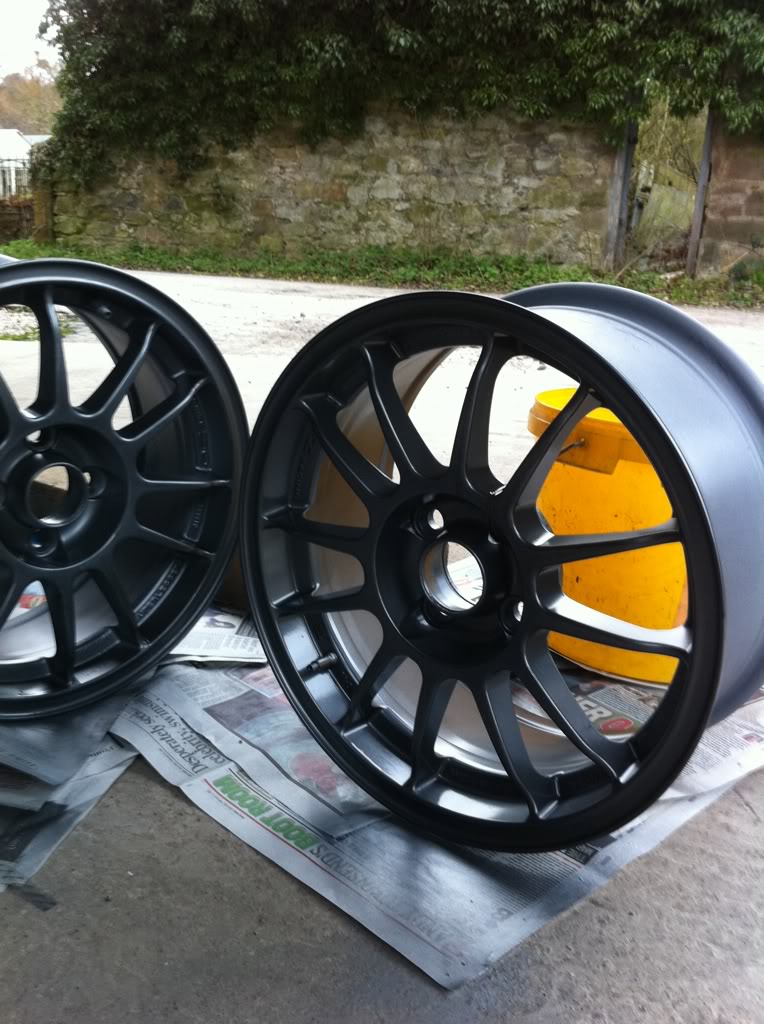

I know ;) Gay colour tbh, gonna just look dirty. White was correct. Fail. Again.

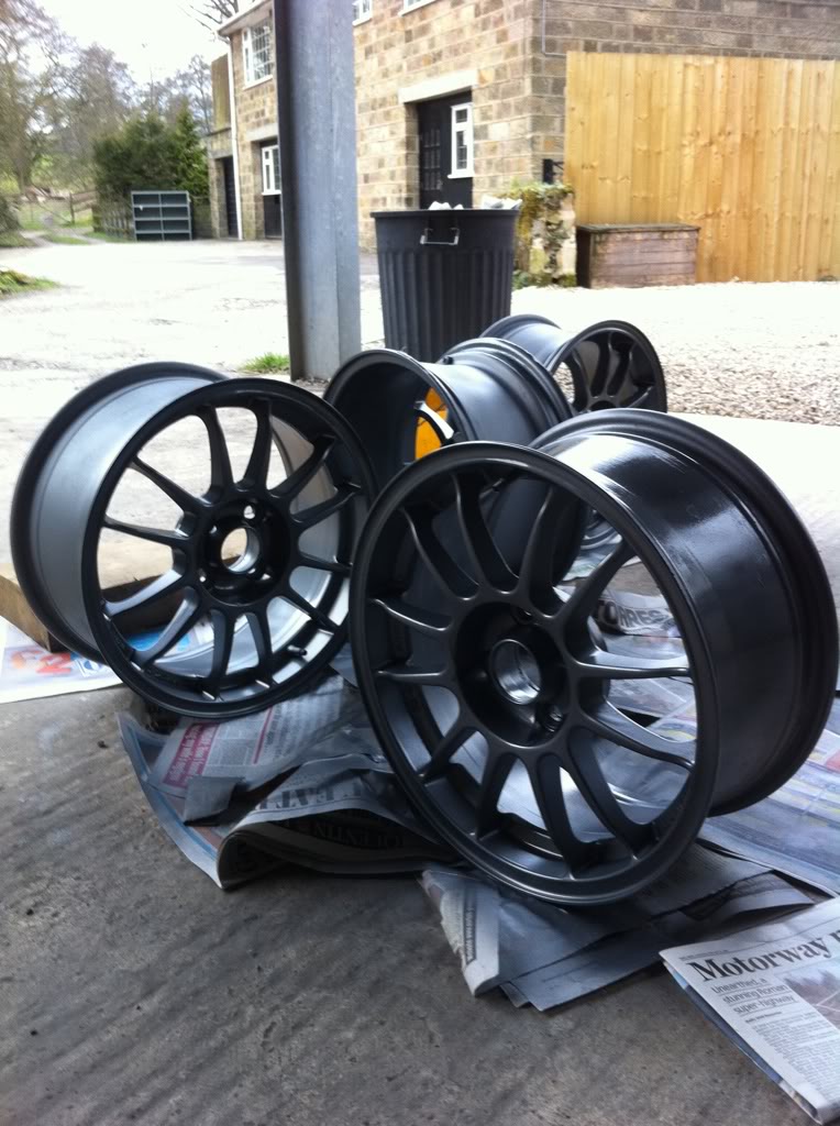

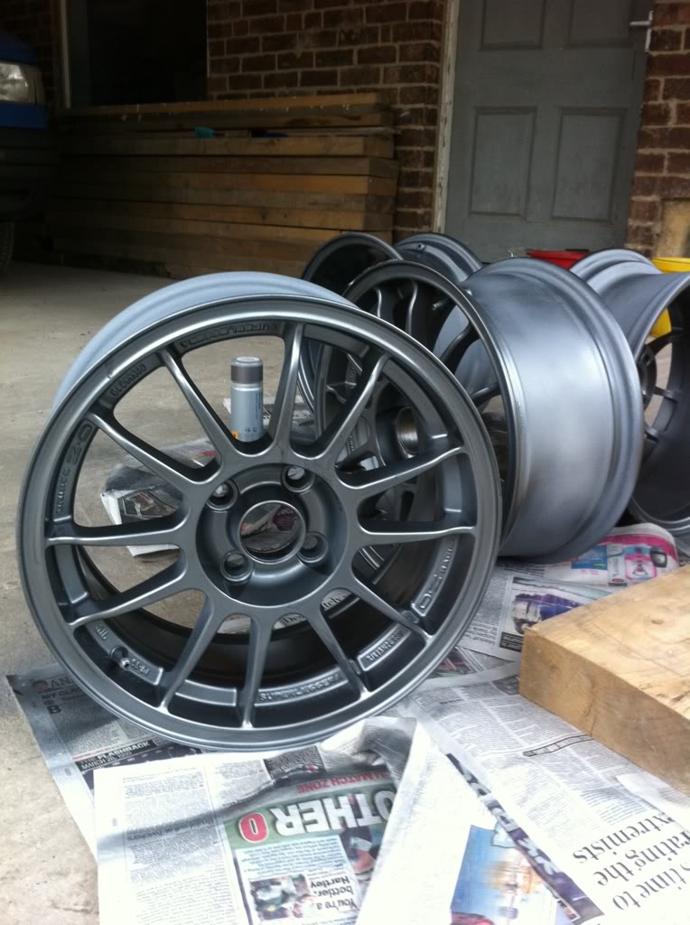

Gentlemen, I present to you Rover Stone Grey (Metallic) 300ml.
Just got to sort out the runs :dapprove:
  BMW M5 & E36
Flat the runs back with 1200 wet/dry and give them another coat of colour after. You'll not tell when theyre lacquered.
  S4 Avant
That's the plan!
Pain in the arse trying to get all the spokes covered, but avoid getting too much paint on them and running :dapprove:
